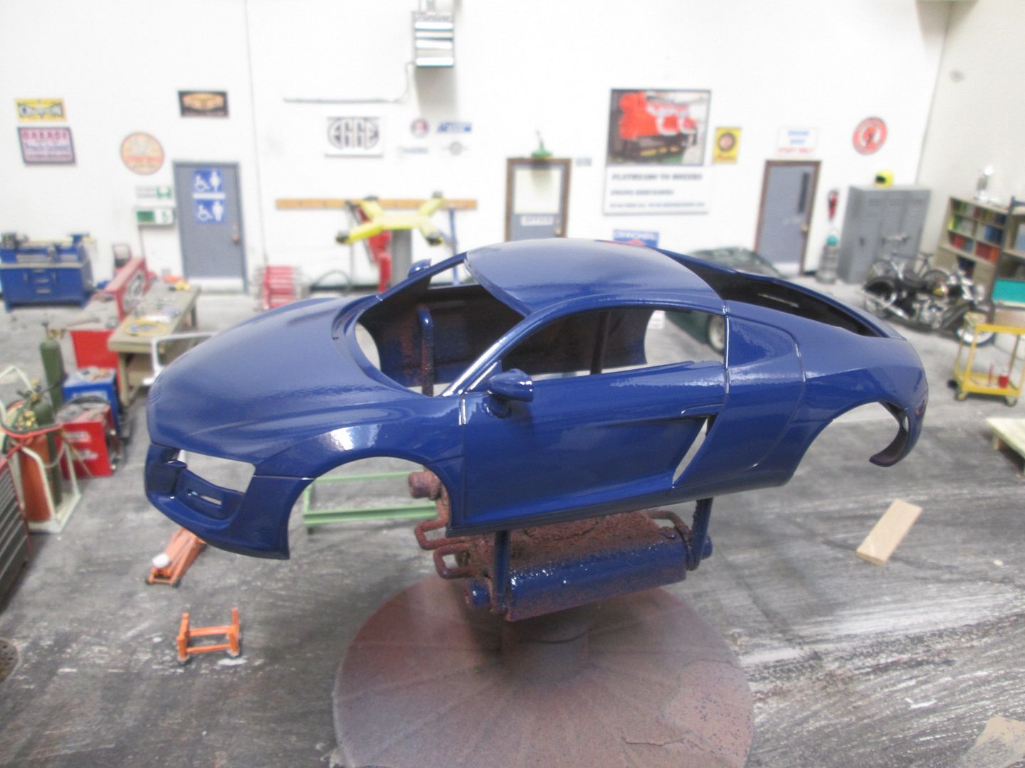

robertw Posted August 26, 2018 Posted August 26, 2018 That is so depressing when something like that happens to a paint job but I'm glad to see that you've not given up. I've had a few "what the h..." experiences using MotoMaster & duplicolor lines so try to do most of my paint jobs with the TS line from Tamiya and have yet to have a paint failure. Yours is going to look nice in orange and keep the blade in a dark colour it will make a nice contrast.
Dann Tier Posted August 26, 2018 Posted August 26, 2018 That paint is looking great!!...cant wait to see more!!
landman Posted August 27, 2018 Author Posted August 27, 2018 That is good guys. That is the primer you are looking at. It was still wet.
Dann Tier Posted August 29, 2018 Posted August 29, 2018 On 8/26/2018 at 9:32 PM, landman said: That is good guys. That is the primer you are looking at. It was still wet. LMAO!!!!

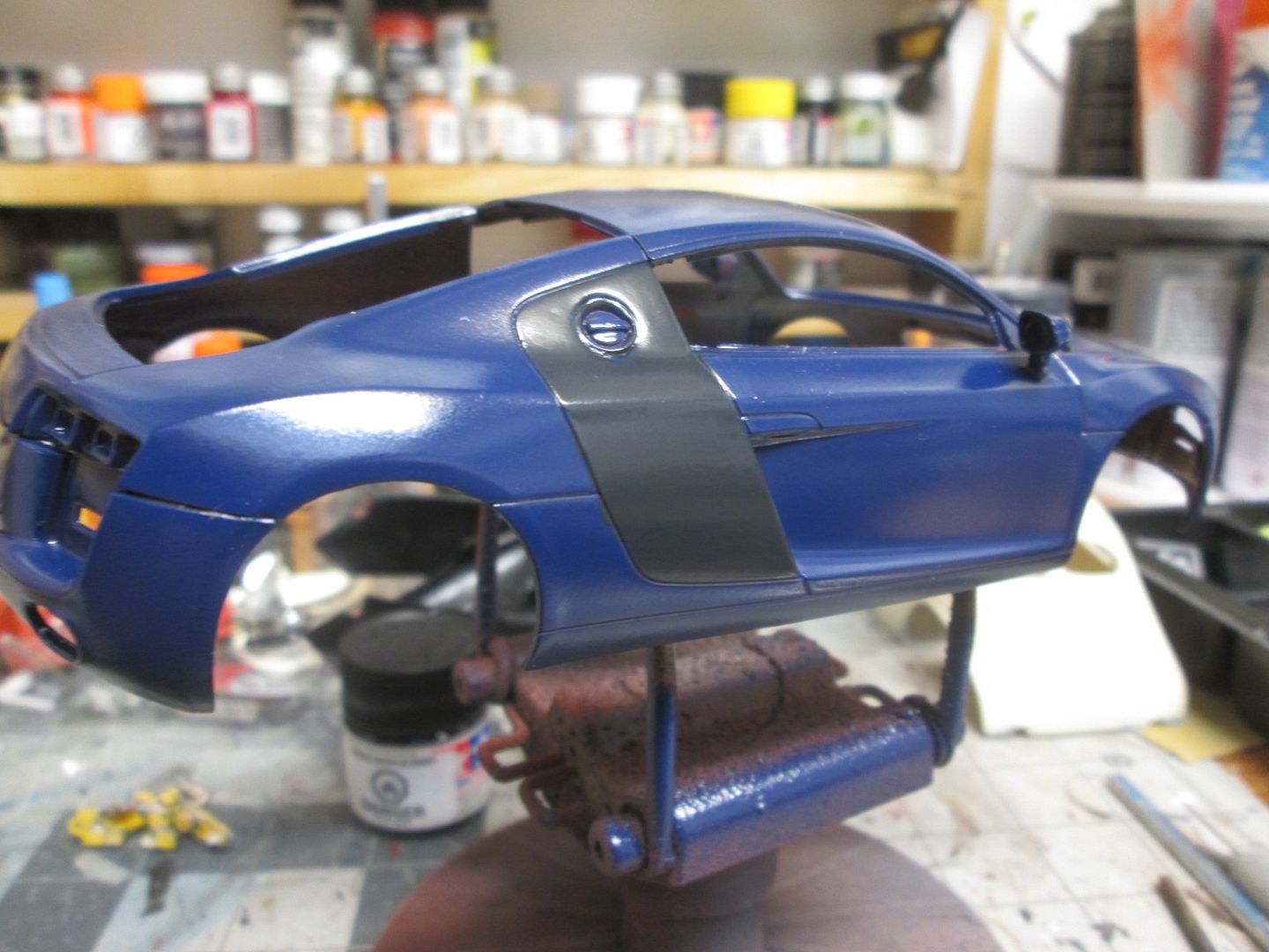

landman Posted September 6, 2018 Author Posted September 6, 2018 (edited) Hand brushed the accent panel with Model Master acrylic gunmetal. That stuff is wonderful. Have to stock up on many more colors. Edited October 29, 2020 by landman
Dann Tier Posted September 6, 2018 Posted September 6, 2018 19 minutes ago, landman said: Hand brushed the accent panel with Model Master acrylic gunmetal. That stuff is wonderful. Have to stock up on many more colors. EXCELLENT brushing skills there!!….looks clean too!!
mustang1989 Posted September 6, 2018 Posted September 6, 2018 I'll say!!! I've used the heck out of that stuff and have never gotten it to lay down that smooth.
landman Posted September 6, 2018 Author Posted September 6, 2018 Thank you Dann & Joe. I'm actually quite impressed myself on how that turned out.

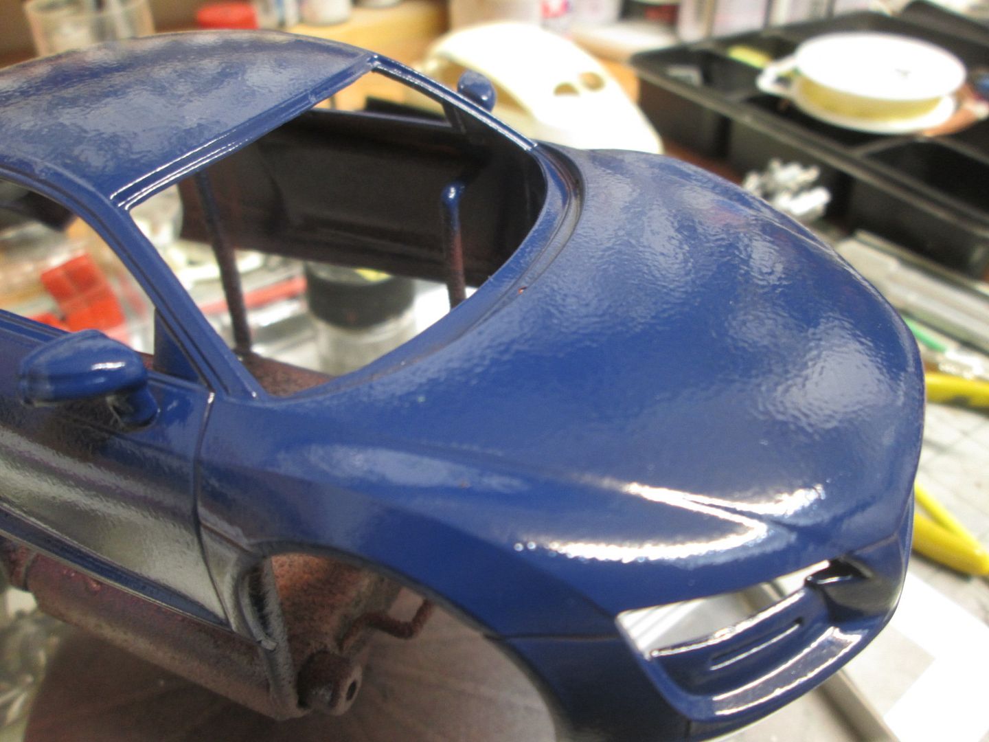

landman Posted September 8, 2018 Author Posted September 8, 2018 (edited) Should have left well enough alone!!!!!!!!!!!!! Edited October 29, 2020 by landman
Dann Tier Posted September 8, 2018 Posted September 8, 2018 2 hours ago, landman said: Should have left well enough alone!!!!!!!!!!!!! WOW!!…...what did you use as clear?!
landman Posted September 8, 2018 Author Posted September 8, 2018 28 minutes ago, Dann Tier said: WOW!!…...what did you use as clear?! I used the only one I had that wasn't lacquer, It was the clear from Spaz-Stix which is an enamel. Should have followed my first impulse which was to use floor polish.
Dann Tier Posted September 8, 2018 Posted September 8, 2018 1 minute ago, landman said: I used the only one I had that wasn't lacquer, It was the clear from Spaz-Stix which is an enamel. Should have followed my first impulse which was to use floor polish. Wow!.....sorry, bud, can you just wet-sand, and polish/ wax it ?
landman Posted September 8, 2018 Author Posted September 8, 2018 6 minutes ago, Dann Tier said: Wow!.....sorry, bud, can you just wet-sand, and polish/ wax it ? I'll try. We are getting close to the wall flinging episode.
Dann Tier Posted September 8, 2018 Posted September 8, 2018 48 minutes ago, landman said: I'll try. We are getting close to the wall flinging episode. You,ve come so far!....its worth the shot...just let it cure a bit longer first, or that'll be it. Have you tried Tamiyas Model Wax?....its AWESOME!!!
landman Posted September 8, 2018 Author Posted September 8, 2018 1 hour ago, Dann Tier said: You,ve come so far!....its worth the shot...just let it cure a bit longer first, or that'll be it. Have you tried Tamiyas Model Wax?....its AWESOME!!! I'll be able to attend a hobby shop next week. I'll look for some. At the same time I hope to attend the Ottawa show while I am there.
Rider Posted September 8, 2018 Posted September 8, 2018 57 minutes ago, landman said: I'll be able to attend a hobby shop next week. I'll look for some. At the same time I hope to attend the Ottawa show while I am there. Too bad about the orange peel. Wet sanding should get that out. Which show, London or Ottawa?
landman Posted September 8, 2018 Author Posted September 8, 2018 39 minutes ago, Rider said: Too bad about the orange peel. Wet sanding should get that out. Which show, London or Ottawa?
landman Posted September 9, 2018 Author Posted September 9, 2018 (edited) Started on the wet sanding. What next? Reshoot some blue or clear over the wet sanding? Edited October 29, 2020 by landman
dino246gt Posted September 9, 2018 Posted September 9, 2018 That looks like clear will finish it off, light coats. IF I was in that spot, that you are in, so as not to be upset with it, I'd let a couple of light coats dry for a week! Then sand it again and finish with more clear. Just a suggestion, do you have a dehydrator? It's a very worthwhile investment, cuts dry time by about 10. Almost eliminates frustration when this sort of thing happens to me, and it does, it happens to all of us I'd say, at one time or another.
Rider Posted September 9, 2018 Posted September 9, 2018 Good work man, More sanding. You should have no orange peel showing.
