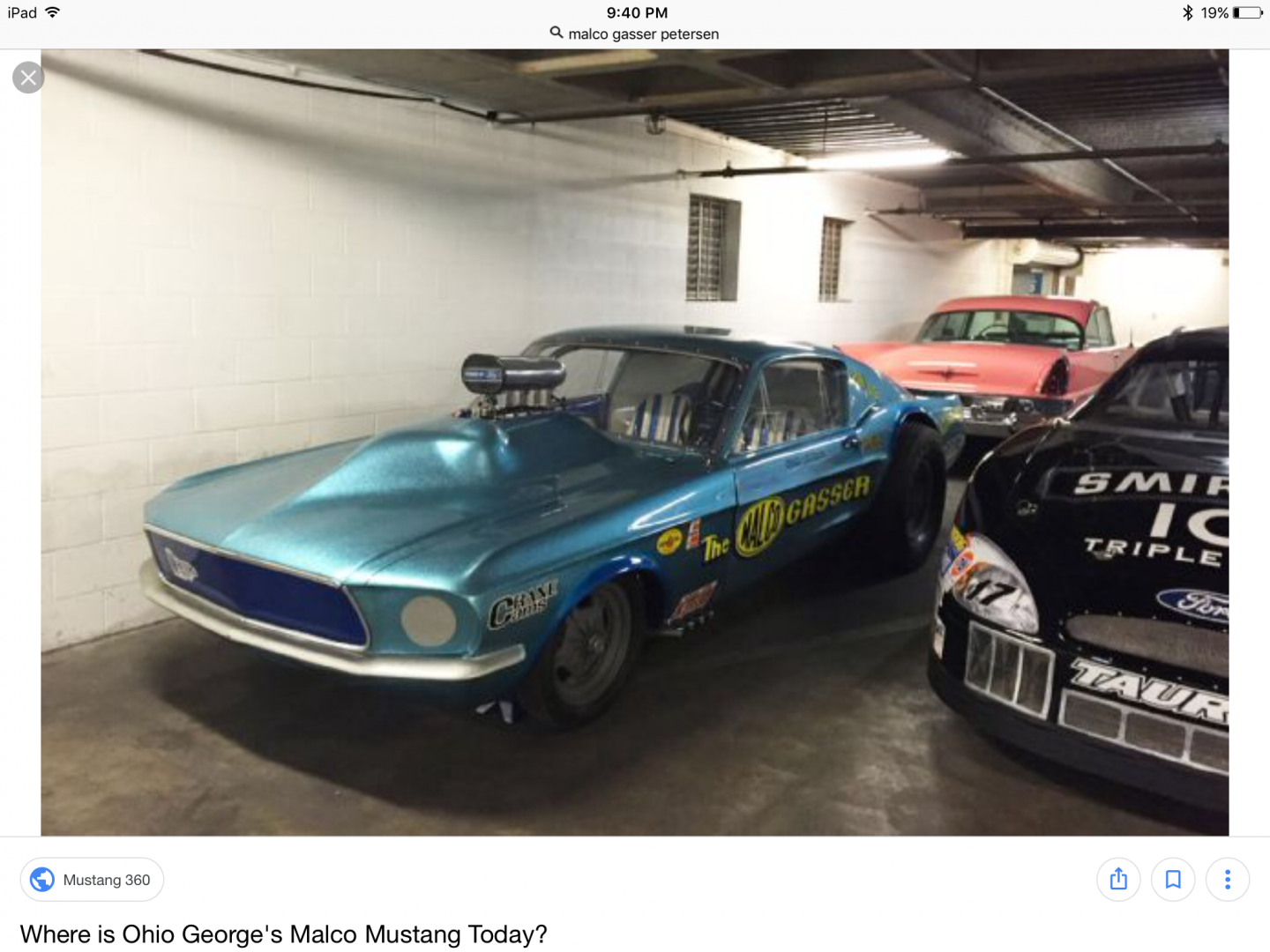

Maybe someone has posted pics of the real car which is in the Petersen museum in Los Angeles.  I could not find any recents pics with the front end off.  Kind of sad to see it hidden in the basement.

vamach —. Next stop is to contact Peterson museum to see if additional pics (beyond what’s already online) can be obtained.

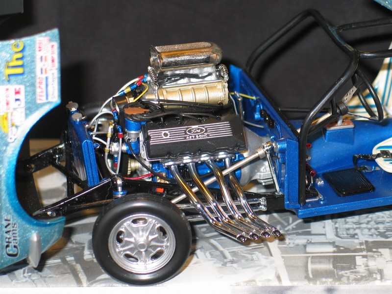

I have gone through all my "Ohio" George car pictures on my hard drive but haven't found any good pictures that explains the fuel and cooling system in an easy way on the 67 Malco Gasser Mustang, but the car didn't have a regular radiator, it looks like a kind of combined fuel tank/ coolant overflow tank in front of the engine wich holds fuel and water, the water was circulated through the engine and connected to the tank with small diameter tubes and hoses wich goes in where the water pump normaly sits on the engine block, I don't think he used a water pump on the car, at least the engine didn't have one.
Another thing I noticed is that this tank was changed and the version of the Malco Gasser that exist today has a different tank from the one used on the early version and he used the same setup on the 69 Mr Gasket Gasser Mustang.
Here are some of the pictures of this area I have saved in my files over the years.
First the early version of the tank/radiator wich is in the MPC kit.
5b9beb7c388cf_ccrp_1102_01_ogeorge_montgomery_sohc_cammersupercharged_ford_427.jpg.5525be3e269c1a91f066e7c80620b3f5.jpg
And the late version as it is today, now it's a combined fuel/water tank.
The fuel/water tank on the Mr Gasket Gasser before the turbo version.
I hope they will show what you need...or at least give you a hint.

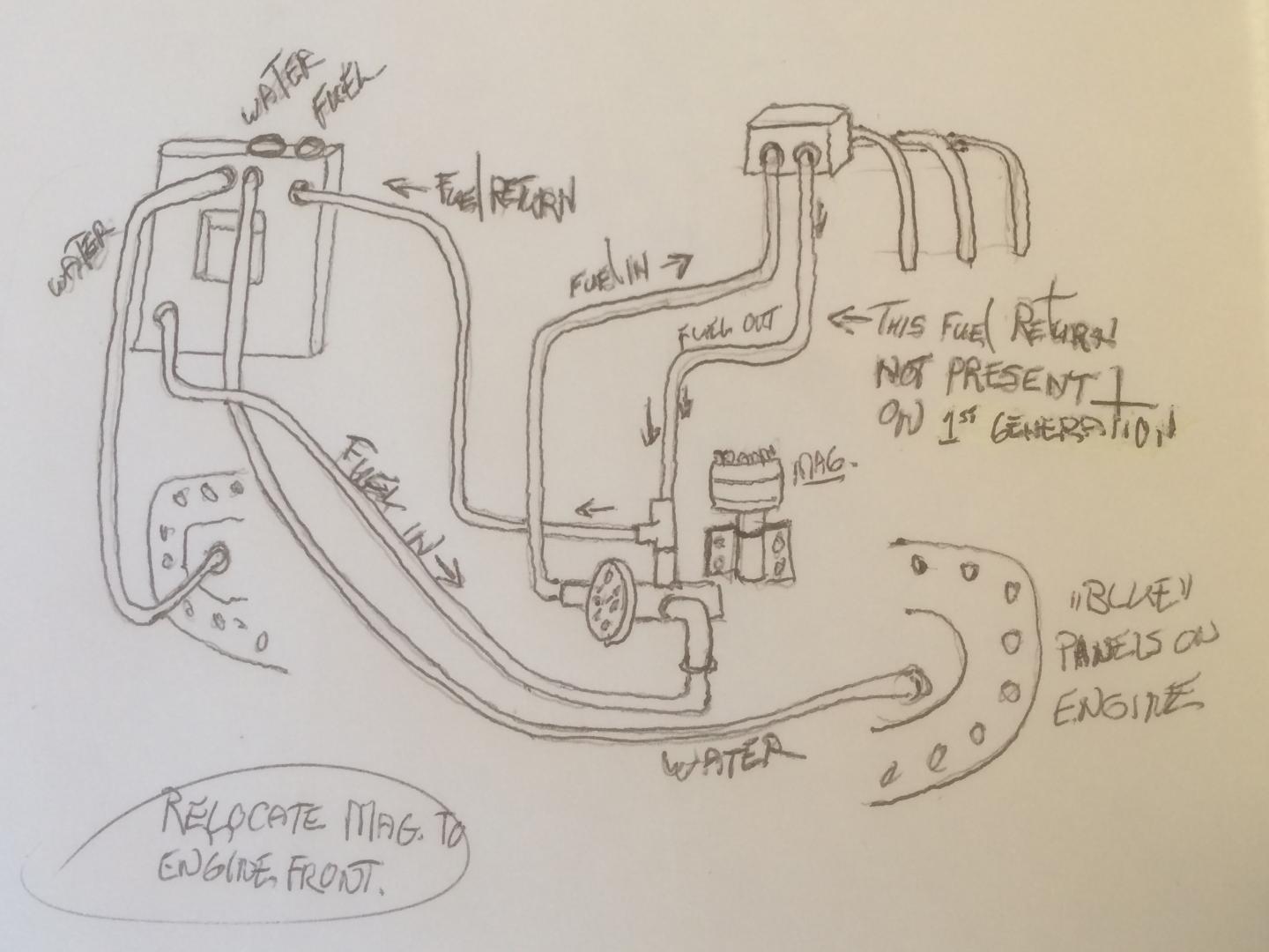

As best as I can tell there is no return or drain line from the injectors on the 1st generation build which is what I'm modeling but I think I will add one anyway just to busy it up a bit.  I spent some time drawing it out and will note this in the post.  I do not claim 100% accuracy as it is a bit confusing between photos and actual car years.  I'm not building a replica as mine will be a pearl white without the Malco decals, but the up front plumbing is important.  I'm planning a tut on the engine build for anyone interested.....
Yeah you are right, the SOHC engine in the early version of the Malco Gasser Mustang doesn't seem to have a return line from the metering valve at the injector on top of the blower.
But there has to be a bypass return line somewhere in the system as you tune these mechanical fuel systems with how much fuel you send back to the tank, otherwise the engine will drown as the fuel pump delivers more than the engine needs to run, so maybe he just used a bypass return only from the fuel pump on the early versions of the SOHC engines in his cars because the Malco 33 Willys Coupe and the early 427 SOHC powered Mr Gasket Gasser Mustang doesn't have a return from the metering valve either.

ok, here's what I've been able to put together from photos received and pics I also had on file.  It's pretty simple, but it was a real bear to find lines that went from point a to b.  Later model Malco's look like they had an electric pump (?) between the newer rad and engine.  I ignored this.  I also added a fuel return line from the valve on the blower.  This was not on earlier generations but it could have been.
The magneto is ok where it is, ignore the note.  A gear cover is all that’s really needed if so inclined.  The water lines in early versions were black hoses, later changed to narrow diameter metal tubing.  I did not see a water pump
There appears to be two oil lines (not in the diagrams) entering the lower front corner of the heads.  I'm not sure on this so did not include them.
oh, I called this the Un-Official Malco Gasser Mustang Fuel and Cooling System Plumbing Schematic".
If there's issue or bad info in the diagram, let me know.  I will amend it if necessary.malco.thumb.jpg.45028c8bdc2a97ecfb8044805a66d669.jpg

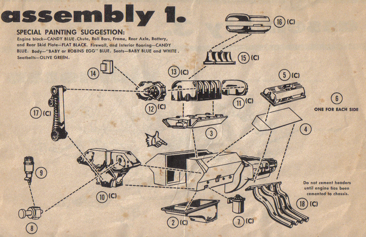

The magneto already is at the front on the left side on the timing chain cover driven of the fuel pump drive on the Malco Gasser.
The mag is driven by pump gearing but it’s beside the fuel pump on the engine  held there by a bracket on the 1:1.  The kit has the mag sitting right on top of the pump.
