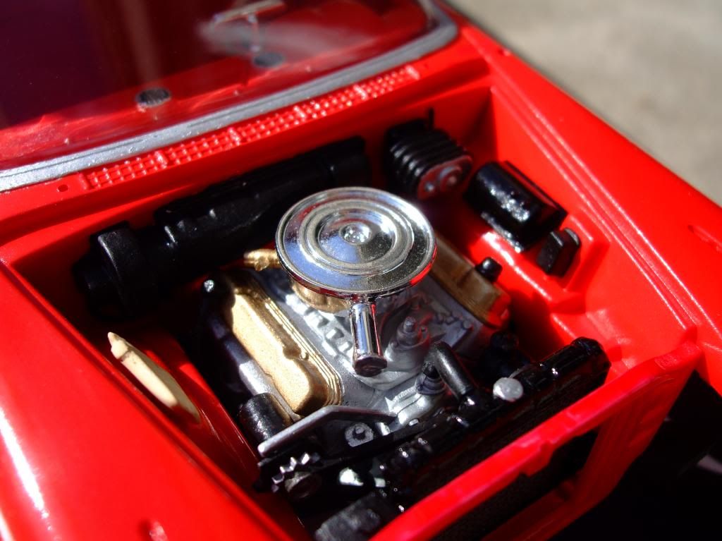

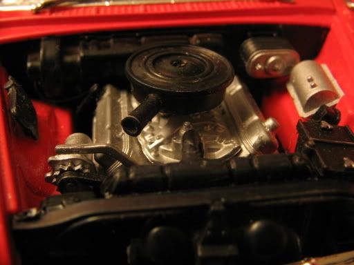

Casey Posted September 23, 2018 Posted September 23, 2018 (edited) 12 hours ago, espo said: I think that in the 1:1 world that the 361 - 383 - 426 wedge & the 440 are based on the same basic block design and from the outside would be hard to tell apart from one another except for say manifolds and paint colors. You might try to find the most visually accurate looking Mopar engine and then paint it the correct color for the 361 in your Newport. The B-series Chrysler big block has a slightly lower deck height than the later RB-series V8s, but the difference is hard to notice in scale, and that's if all of the block dimensions are accurate. The Wikipedia page does a good job of explaining the differences: https://en.wikipedia.org/wiki/Chrysler_B_engine#361 So yes, the IMC/Lindberg Dodge L-700's basic 361 V8 is the same externally as used in cars, but the details will be slightly different. L-700 361: '62 Newport 361: Edited September 23, 2018 by Casey better image of stock/non-restored engine

Casey Posted September 23, 2018 Posted September 23, 2018 47 minutes ago, Deuces said: So, that ^^^^^ 2x4 intake will fit a 383/400 B motor???? I edited the image, as I wasn't sure that engine block/heads/valve covers were original to the car, which is what I believe Chris is aiming for on his model.
restoman Posted September 24, 2018 Posted September 24, 2018 If I recall from my build a few years ago, the water pump on the L700 engine is truck-specific, and of course, the bell housing and transmission are different. I added some HP exhaust manifolds and a round Road Runner-style air breather to mine, so the basic engine dimensions are close enough to get away with. It's a lump of an engine, though. Not much detail there...
