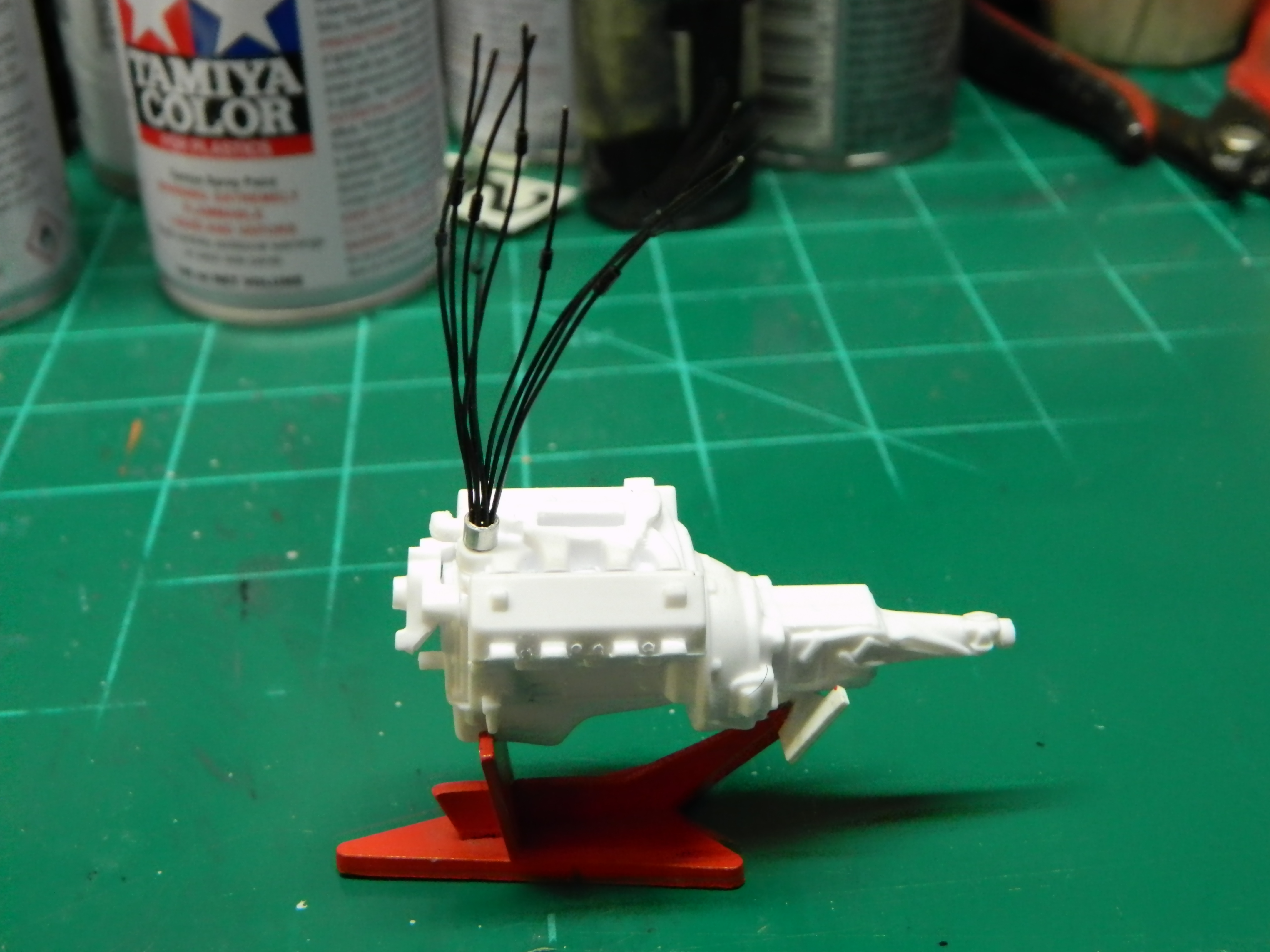

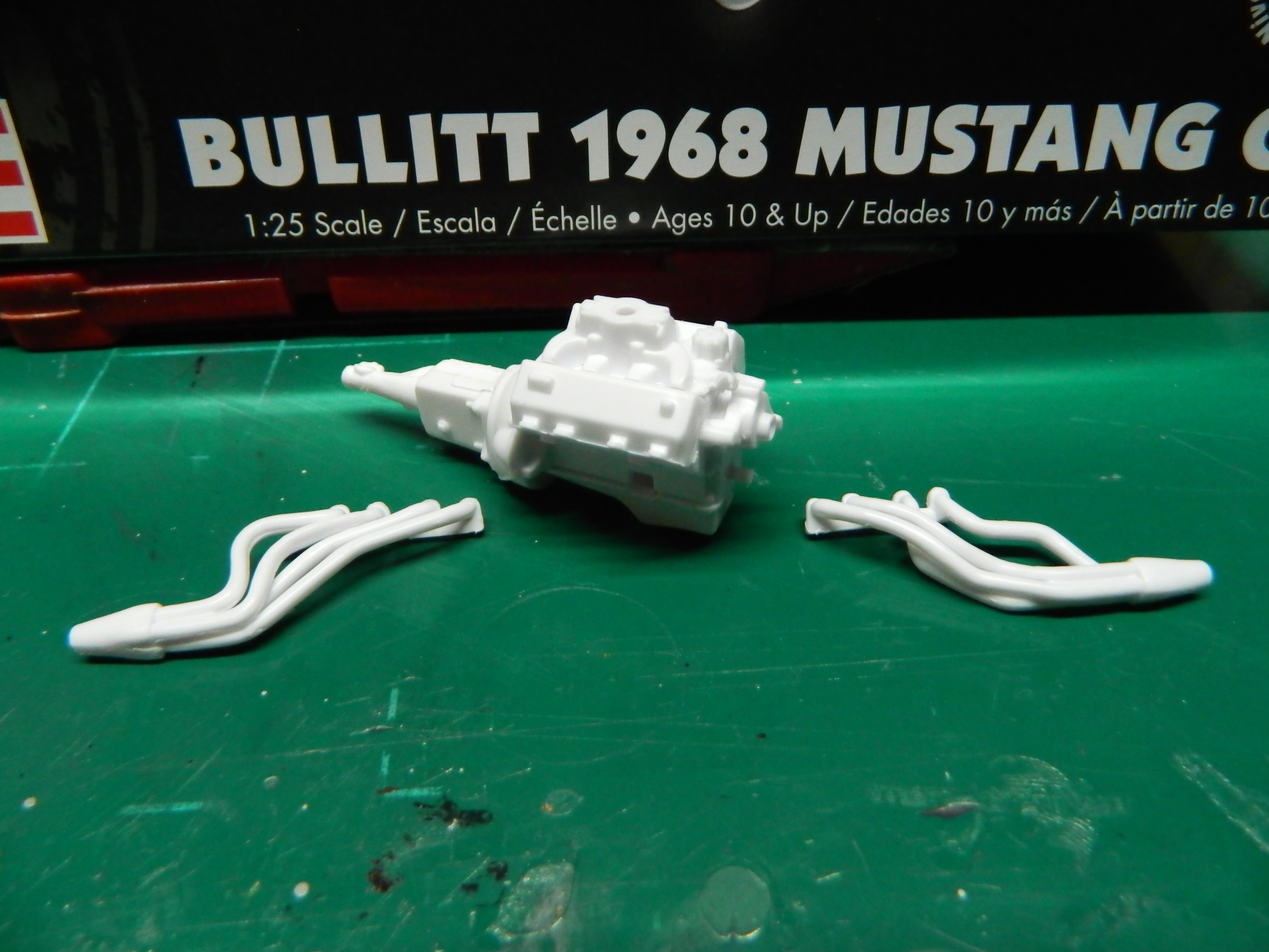

mrmike Posted November 25, 2018 Posted November 25, 2018 I have had this kit in the stash for some time now and with the recent articles about the Bullitt Mustang now in print and the hero car being found on the East Coast as well as the jump car being found in Mexico, I was influenced to build mine now. I am starting with the Revell Bullitt 1968 Mustang GT kit 85-4233. I also have the '68 Mustang GT kit 85-4215 that I will use the Cobra Jet headers from. I will be following the build by Marcos Cruz for mine. I will eliminate the metal axles from this kit, close the gap in the engine bay to the front fenders, and try to find a close paint color match. I started assembling the engine and the headers. I'll wire the engine and I'll rummage through my parts box for a separate carb and an open element air cleaner. And, I am done...not! This is a diecast Revell Bullitt Mustang that I built many years ago. This came from the same molds that Revell used for the plastic version that I am about to build. As the market changed, Revell converted many of their diecast molds to plastic and this is one of them. The only change I can find is to the dash. The current version has two gauges mounted under the dash and my diecast version does not have them. I'm surprised that no one has built a '68 Charger R/T from the Revell '68 Charger kit and yes, I have the diecast version of that car, too! More to come...

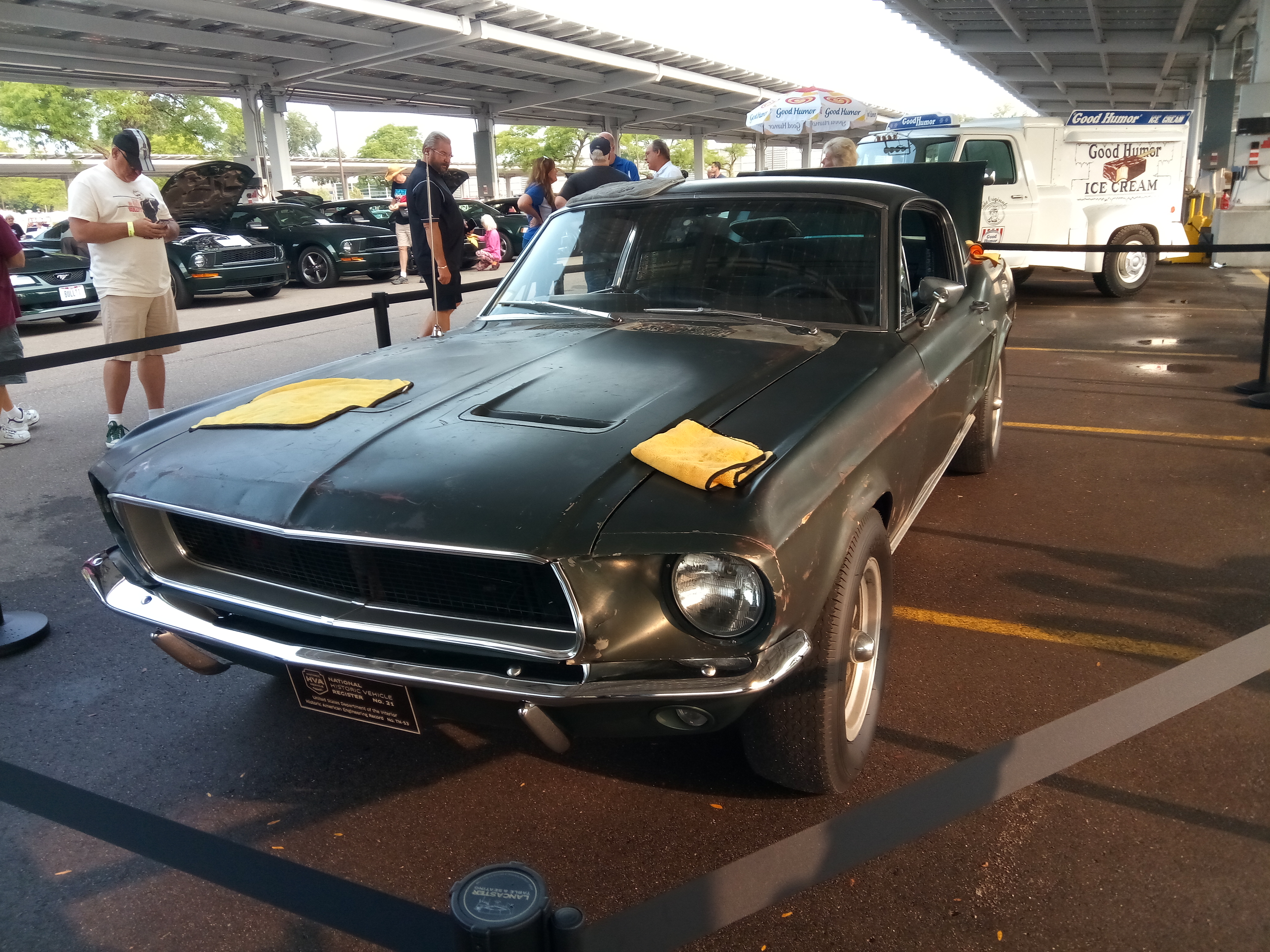

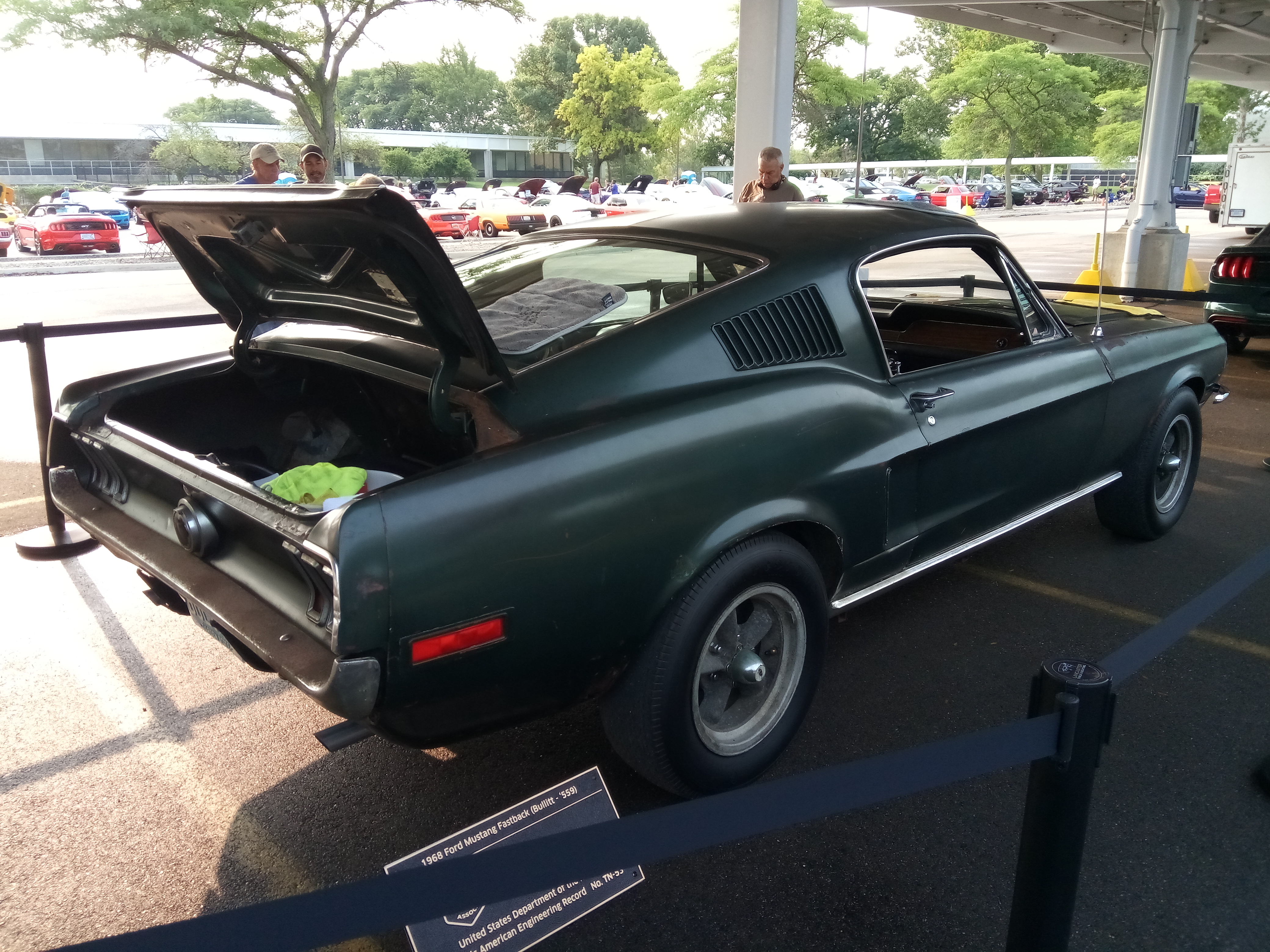

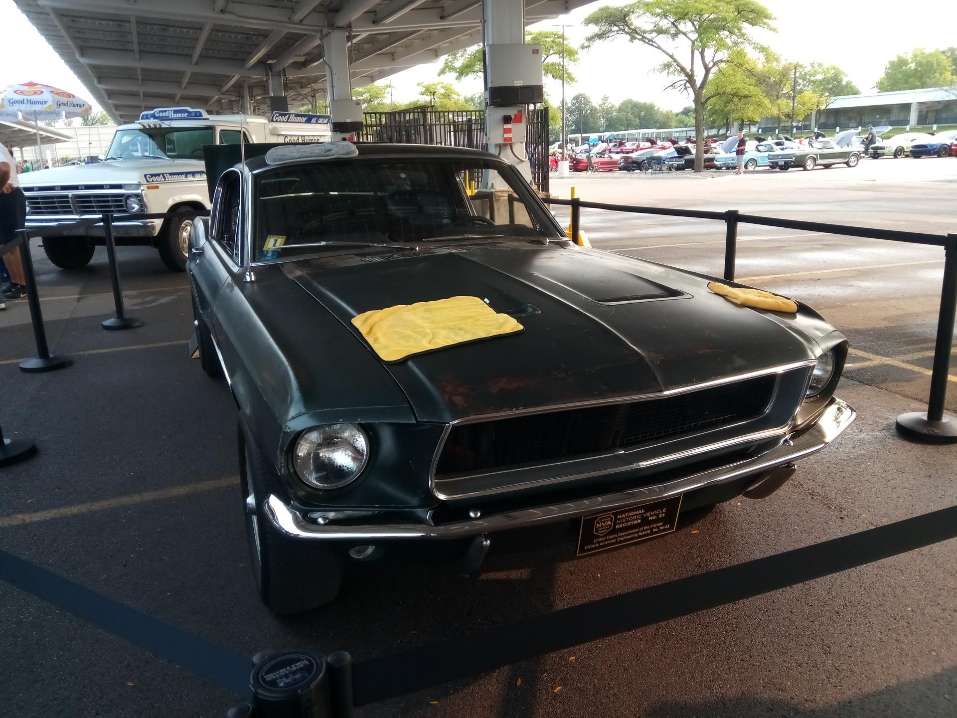

Deuces Posted November 26, 2018 Posted November 26, 2018 11 hours ago, vamach1 said: You could always do a what it looks like now version and you will just have to replicate rusty and faded Ivy green. You mean this one????..... Yep! The genuine article..? I took these pictures at the Ford world headquarters in Dearborn last August....

Deuces Posted November 28, 2018 Posted November 28, 2018 The one I posted above has the camera mounts bolted underneath.... Sorry I didn't get a picture of that..... ?

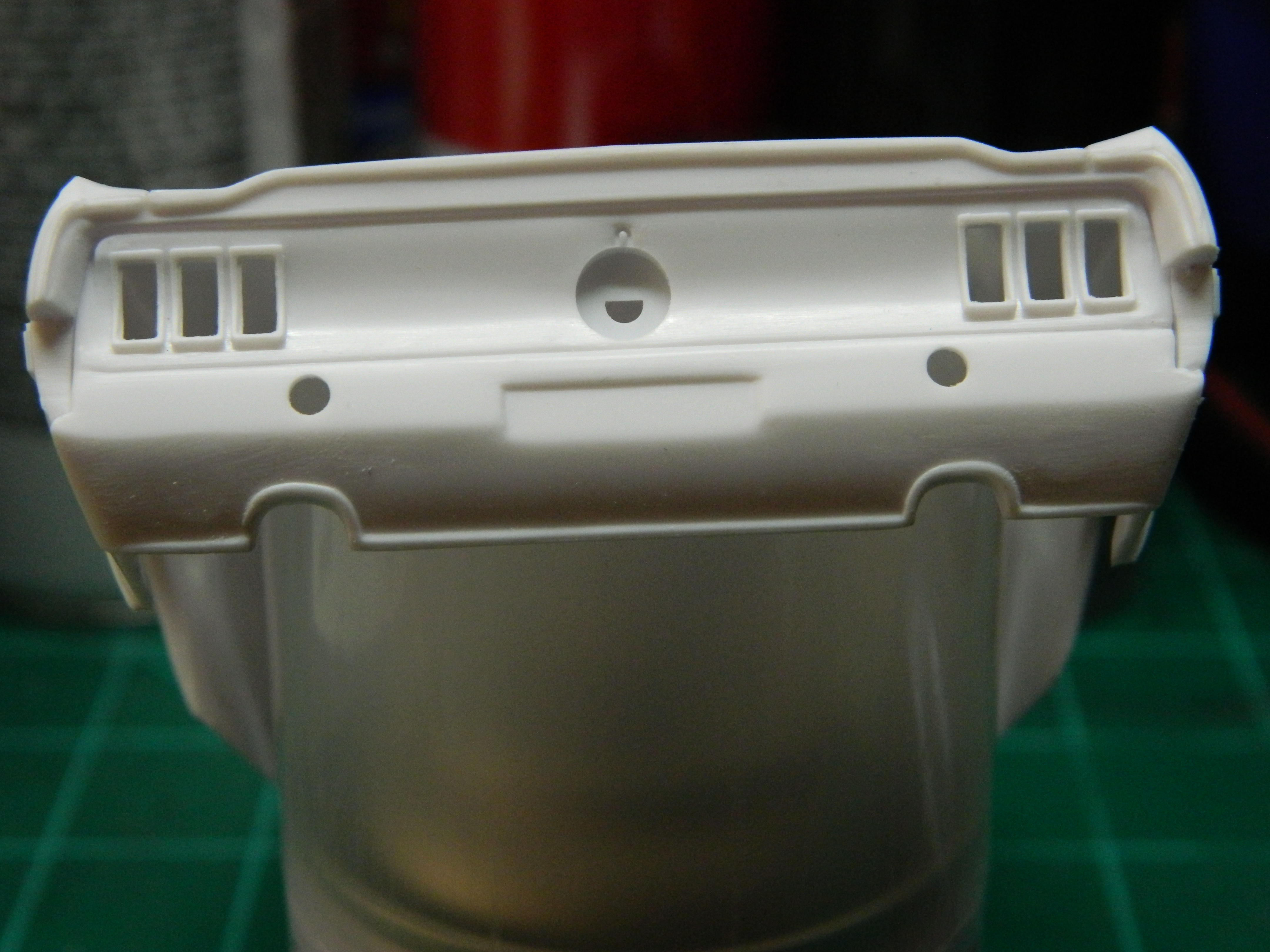

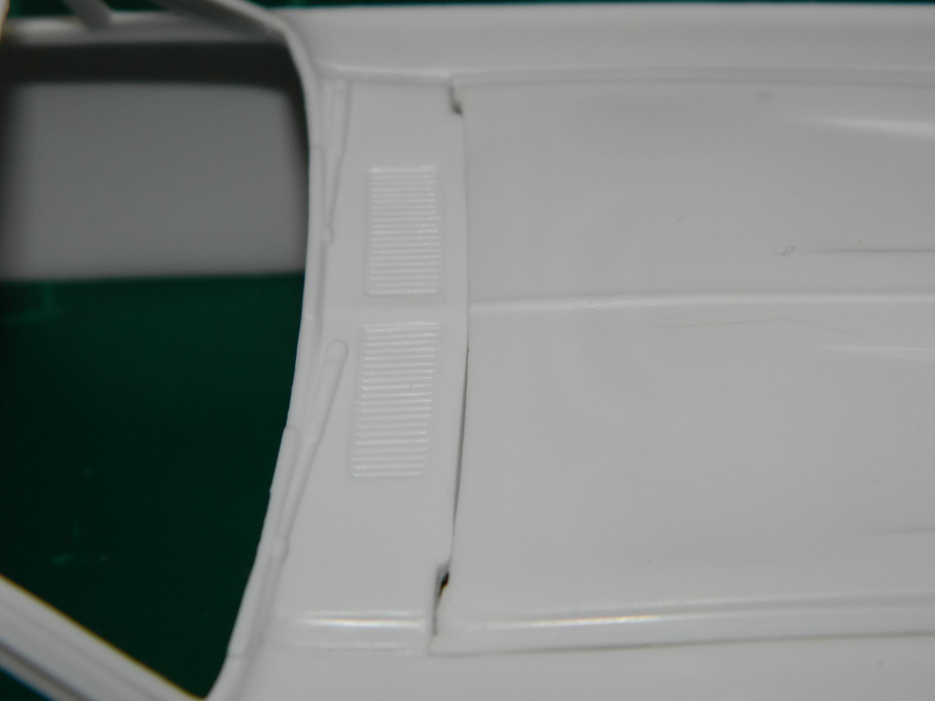

mrmike Posted December 3, 2018 Author Posted December 3, 2018 I filled the hole in the engine block and added plug boots to the wired distributor from Parts by Parks. Part of the die-cast molds is the notches on the cowl and the hood. Unless I want to do extra bodywork, which I don't want to, these are staying. There was two raised circles for the backup lights and the Bullitt Mustang doesn't have any. Out came the sanding stick and away went the raised circles. A fellow Club member has a 2 oz. bottle of Ford Highland Green Metallic by ScaleFinishes that he is going to give me. Thanks Joe Angers! More to come...

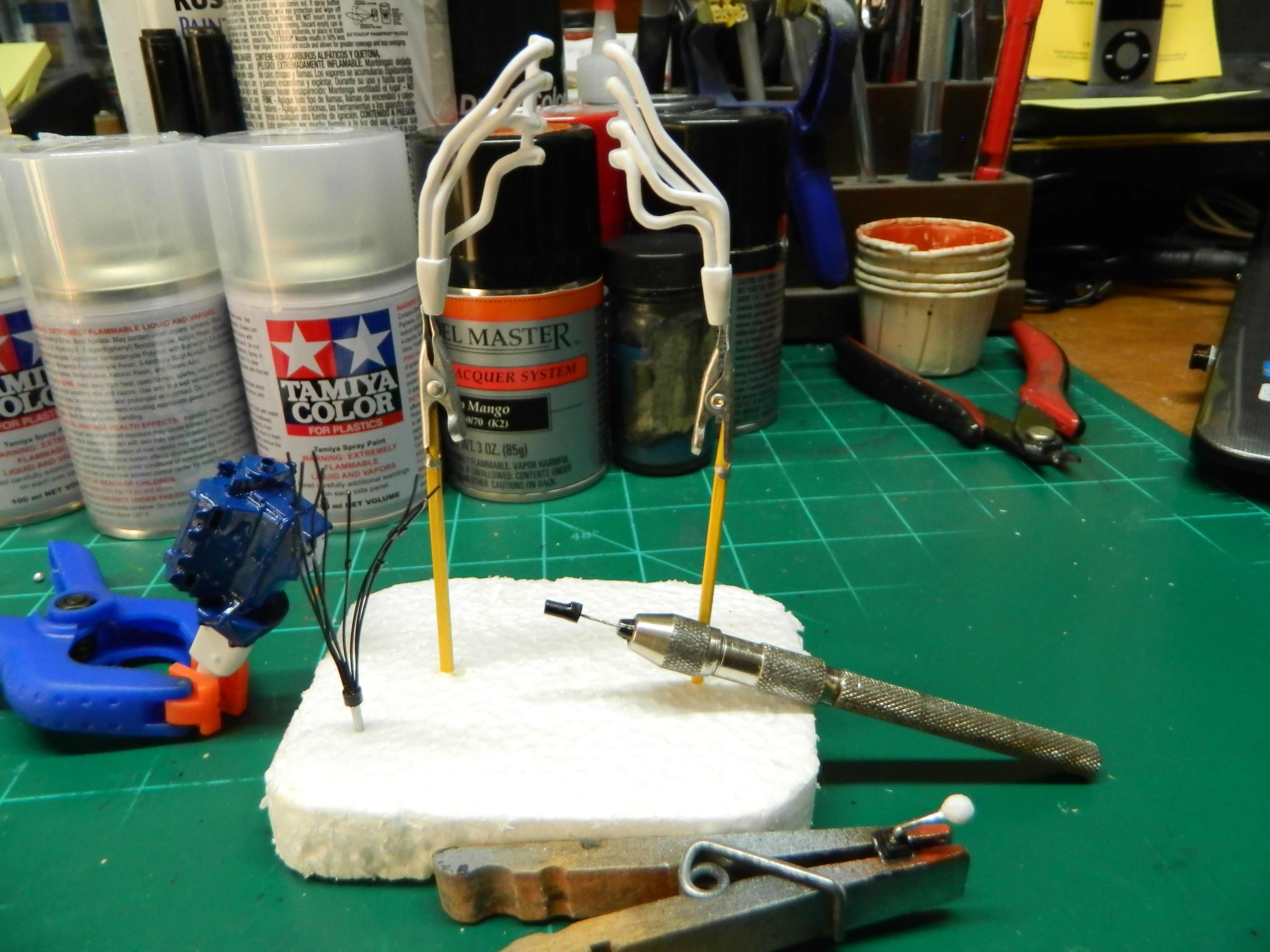

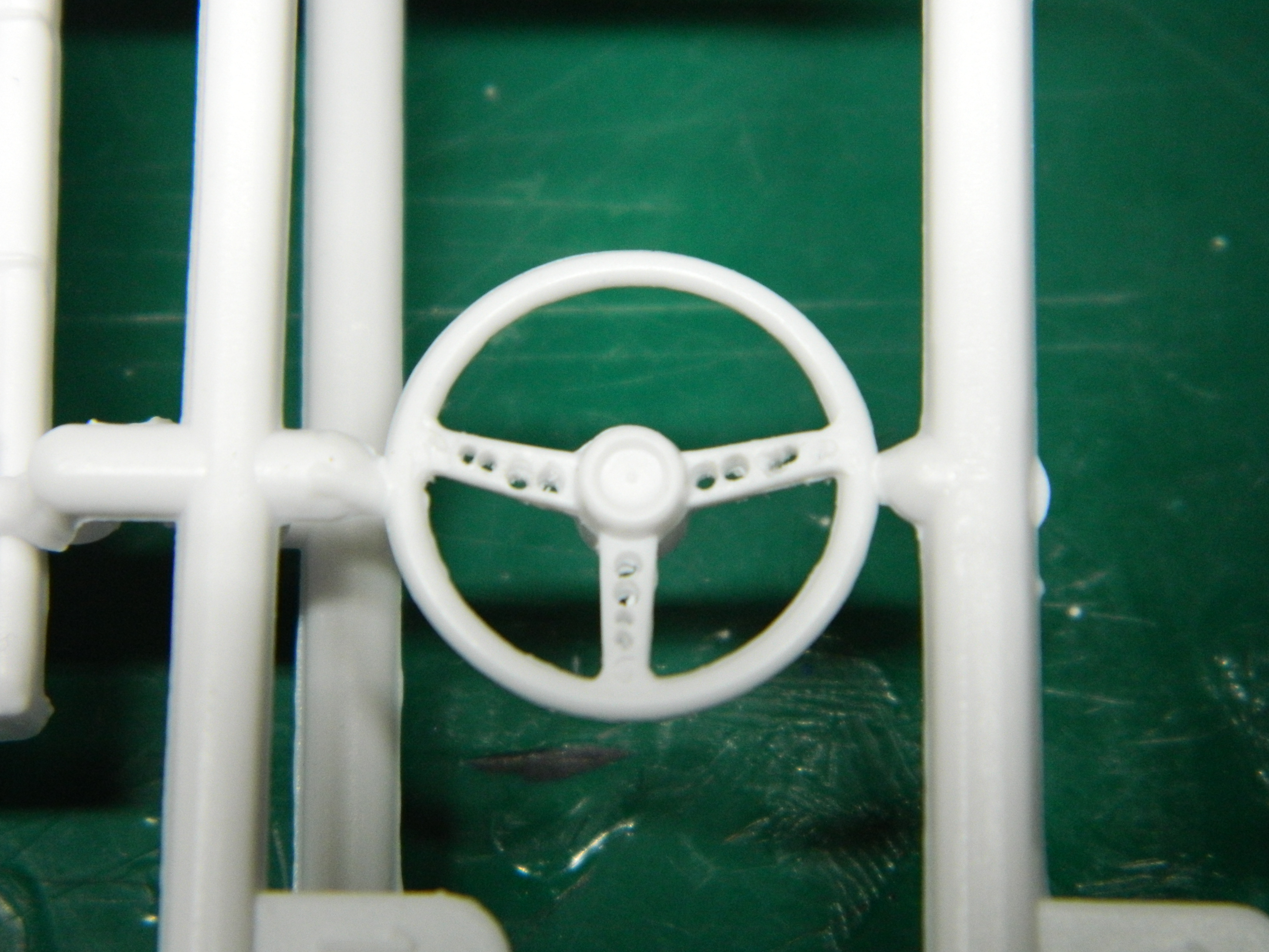

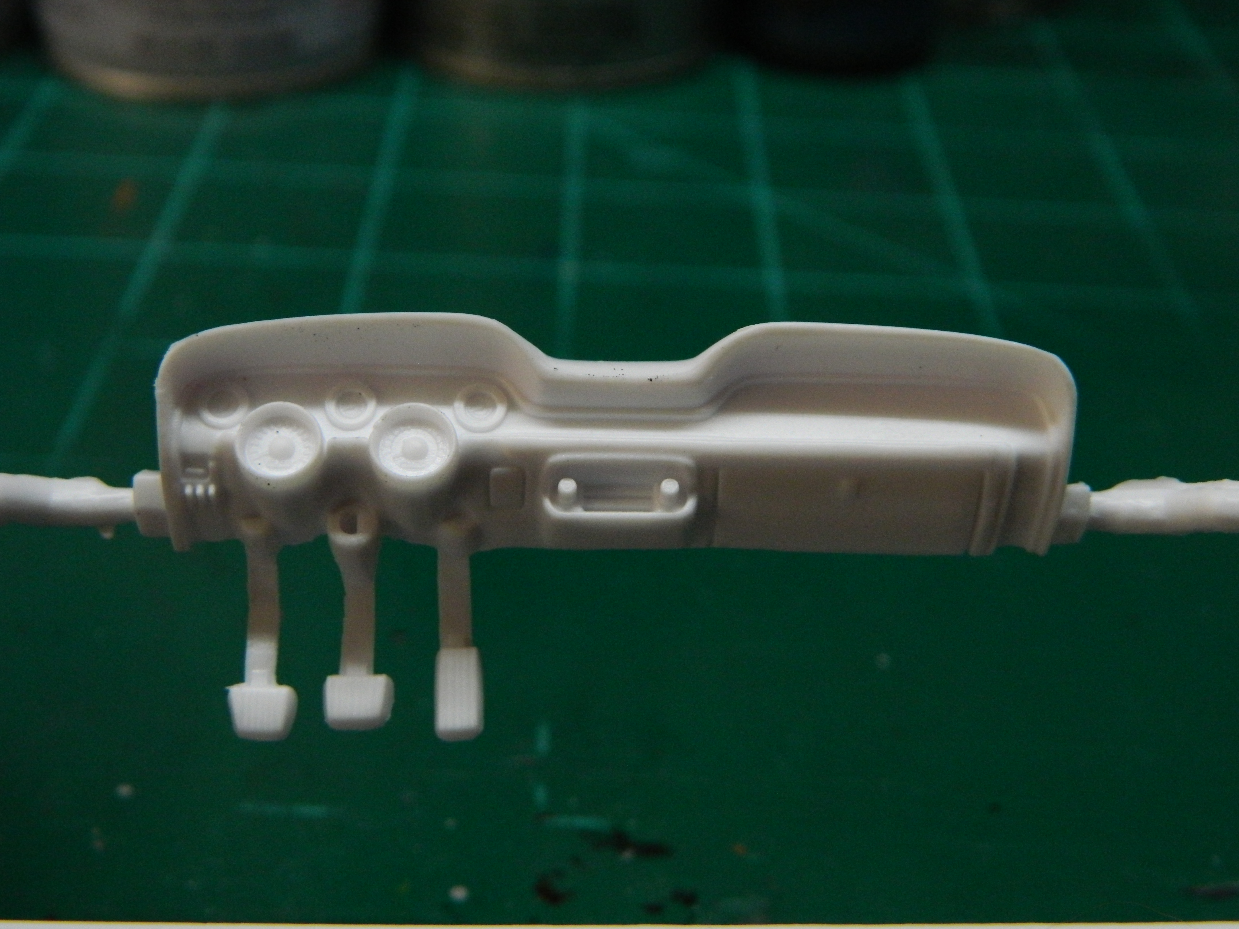

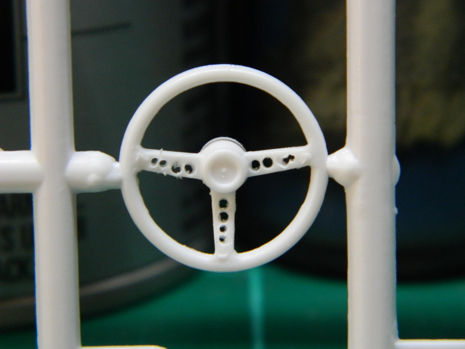

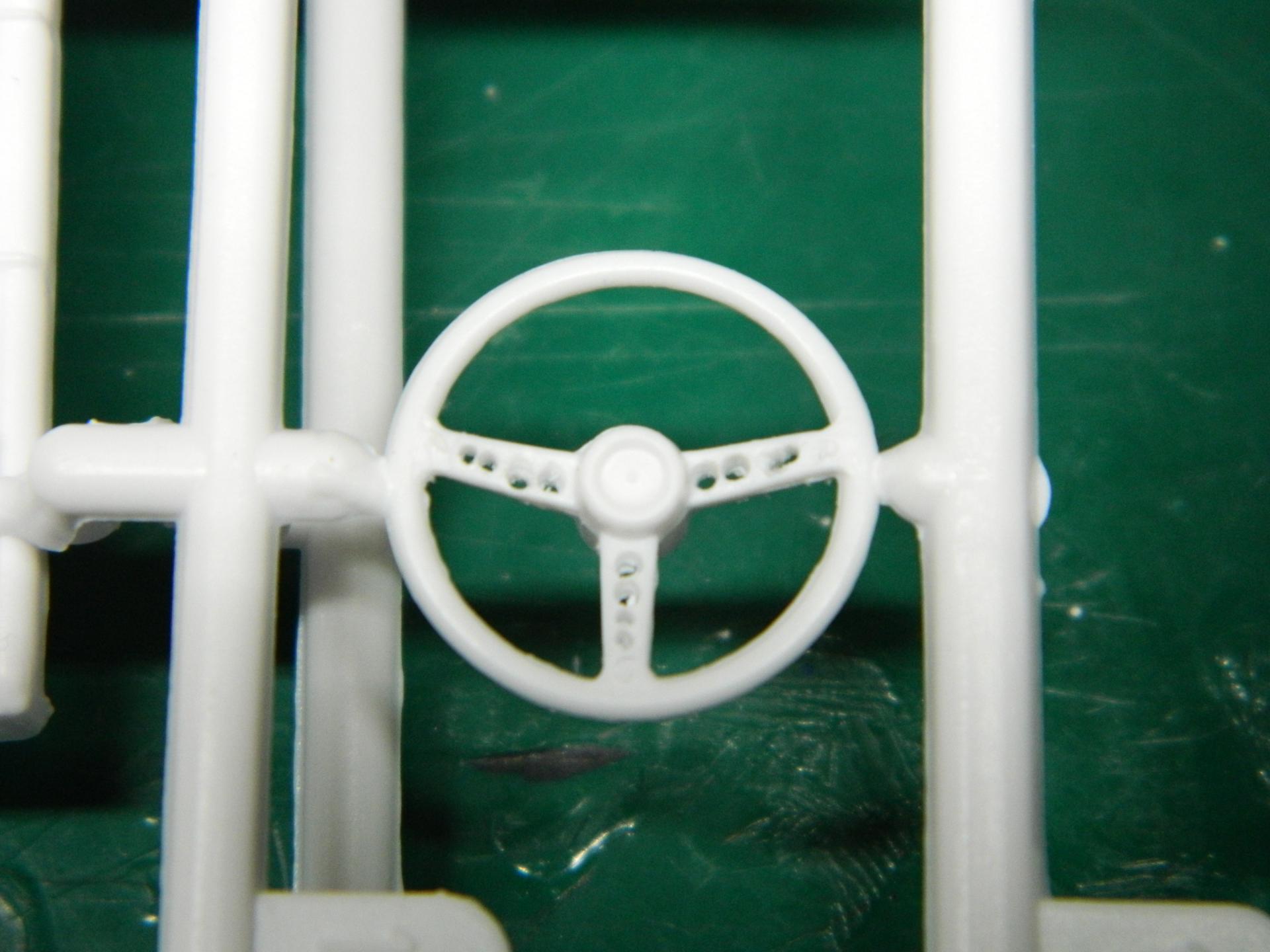

mrmike Posted December 4, 2018 Author Posted December 4, 2018 I've been picking away at the Bullitt Mustang. I painted the headers flat white, the distributor semi gloss black, the engine block got a second coat of paint, and I made an ignition coil since there is none in the kit. The shifter got a new shifter ball made from a piece of jewelry bead and painted flat white. Now, if I can only find a 4-speed shift pattern decal. There was a set of gauges under the dash and I cut them off since the Bullitt Mustang doesn't have them. I drilled some holes in the steering wheel spokes and I messed up on some of them. More to come...

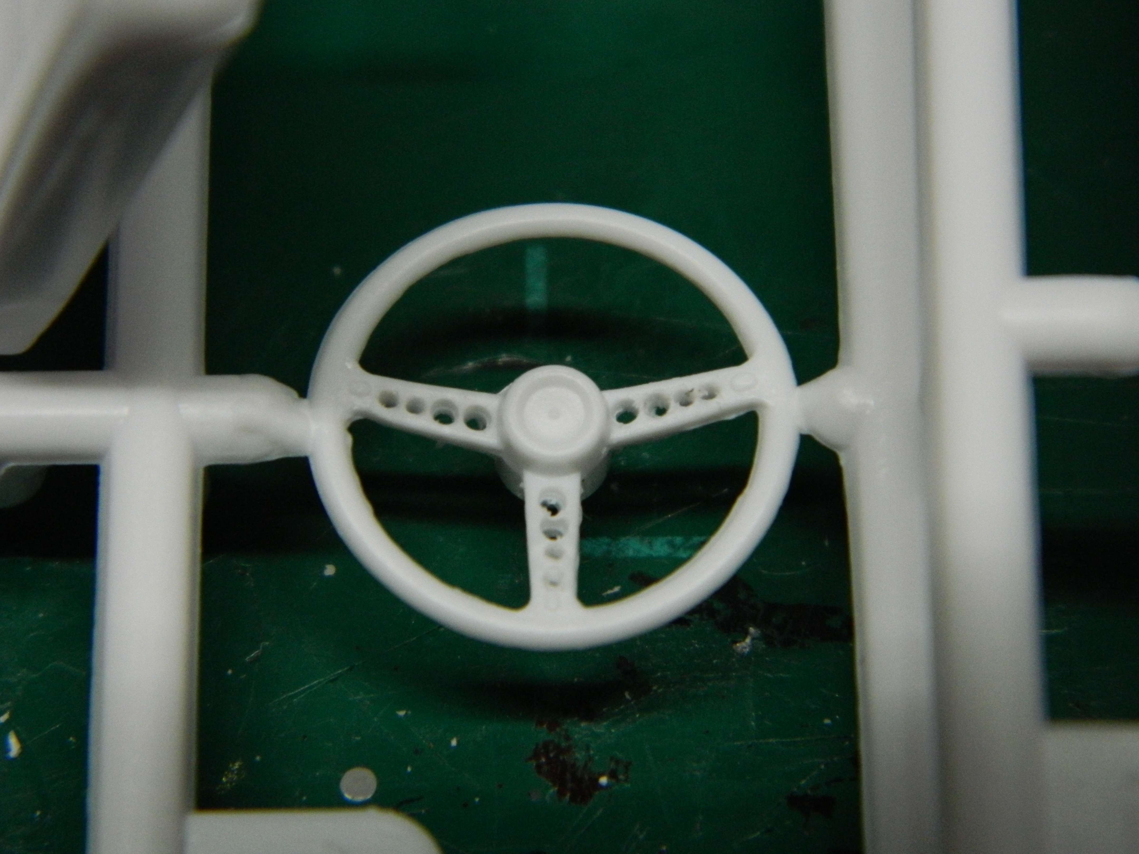

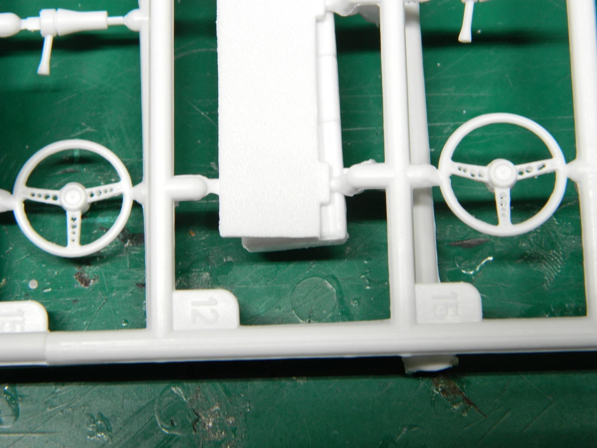

mrmike Posted December 4, 2018 Author Posted December 4, 2018 (edited) As I was looking at the steering wheel and the mis-guided holes, I remembered that the Revell '68 Mustang kit 2 'n 1 kit has all the extra parts in it for the Bullitt Mustang. This time I used my magnifier and carefully, well much more carefully, drilled 12 new holes in the steering wheel spokes. Some cleanup and Bob's your uncle! More to come... Edited December 4, 2018 by mrmike

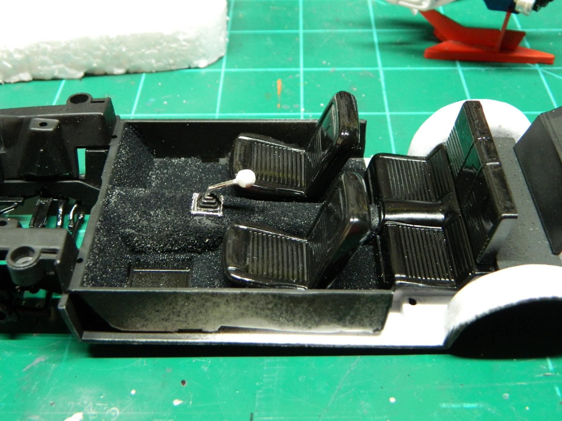

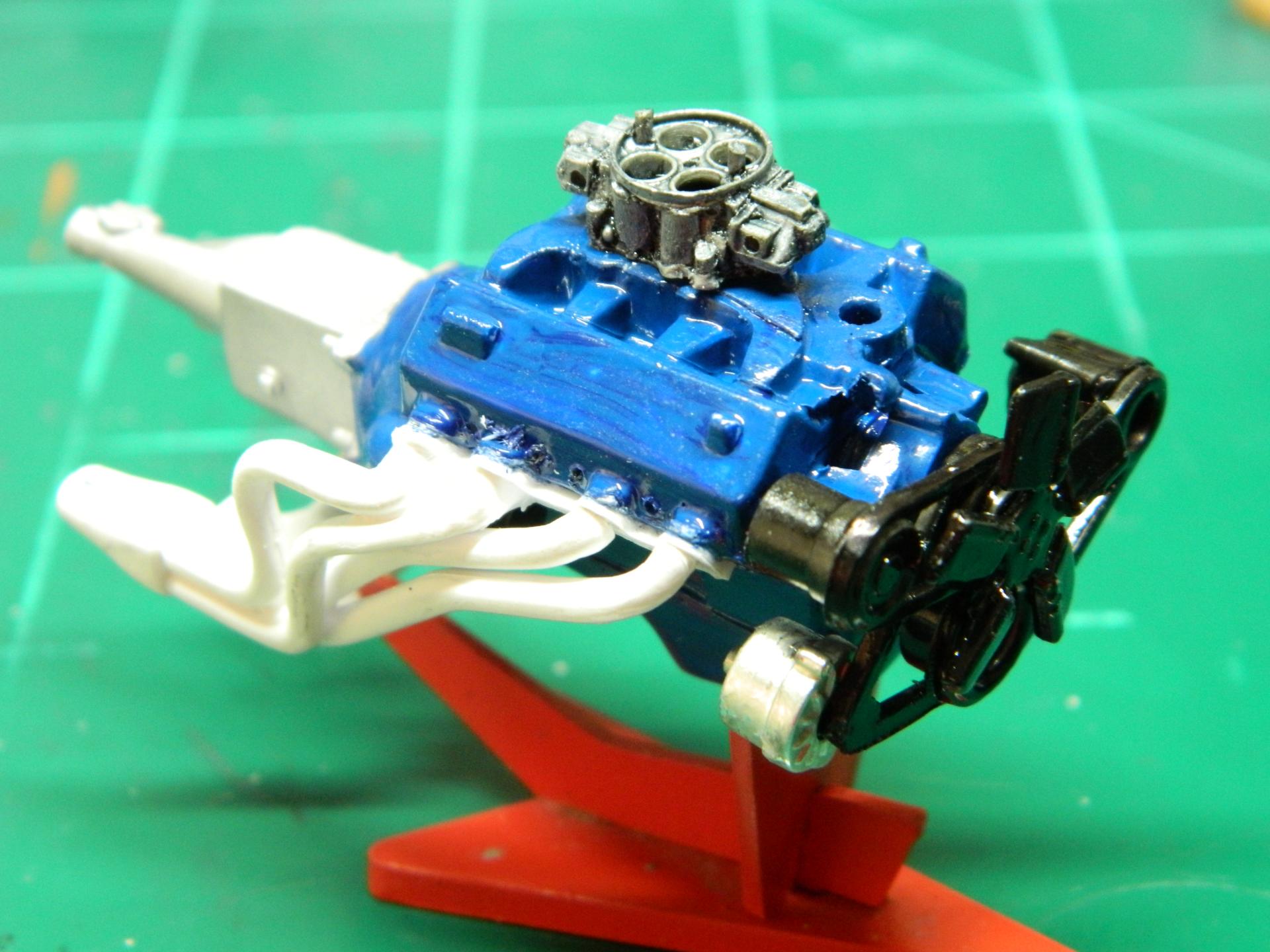

mrmike Posted December 8, 2018 Author Posted December 8, 2018 Been working on the 390 CID engine. I added the headers, the fan and fan belt assembly, and a Demon carb. I choose this carb since it does have a lot of detail to it, even if it is not correct for the Bullitt Mustang. The interior is under construction. I used embossing powder for carpet, added the shifter and front bucket seats. I painted the wheel backs for the American Racing wheels and detailed the steering wheel.

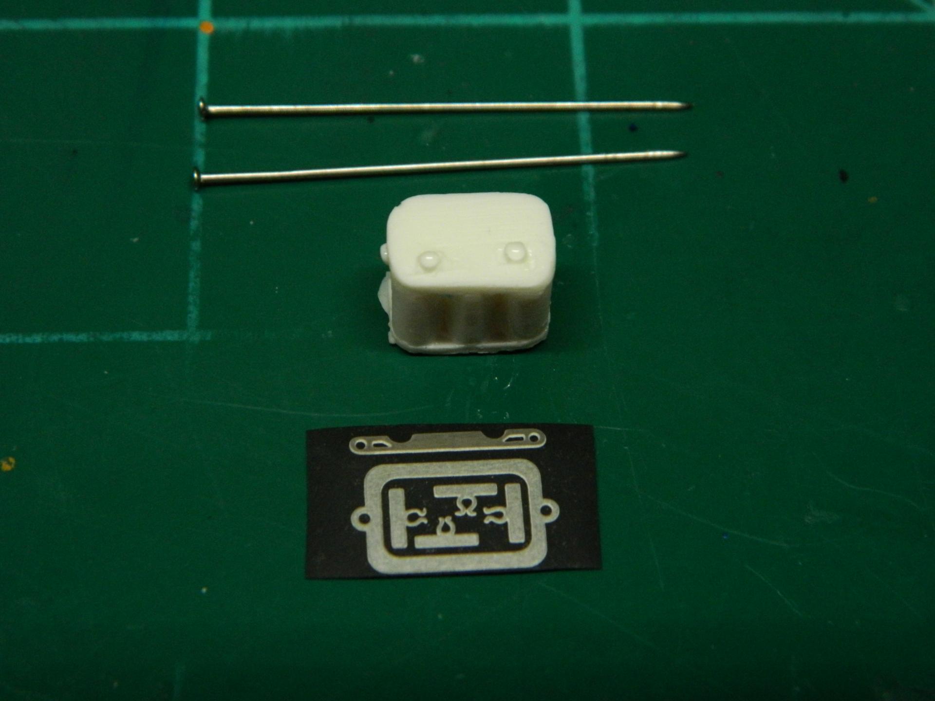

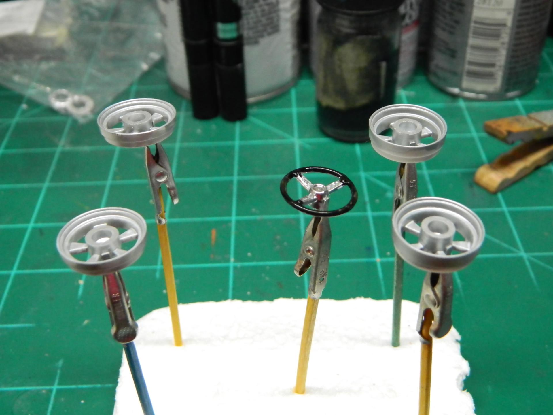

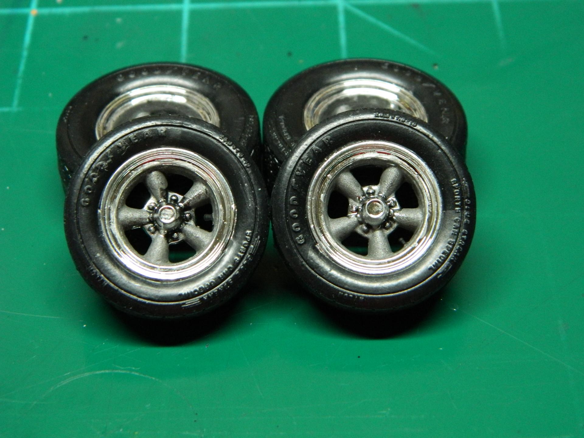

mrmike Posted December 10, 2018 Author Posted December 10, 2018 A little progress on my Bullitt Mustang. The wheel spokes were painted on the wheels I plan on using for this build. I still need to do some touchups. b bAt last weeks Classic Plastic Model club meeting, I had talked about my plans for this build and Club member Joe Angers offered me his bottle of Highland Green paint from Scalefinishes. Thank you very much Joe! At our last Play Date, my friends Paul, Barry and I were looking at pictures of the "hero" Mustang and we had noticed an Optima battery in the picture of the 390 CID engine. Paul offered me this resin Optima battery. I'll cut out the regular battery, make a new battery shelf and added this resin battery once I get it painted and detailed. More to come...

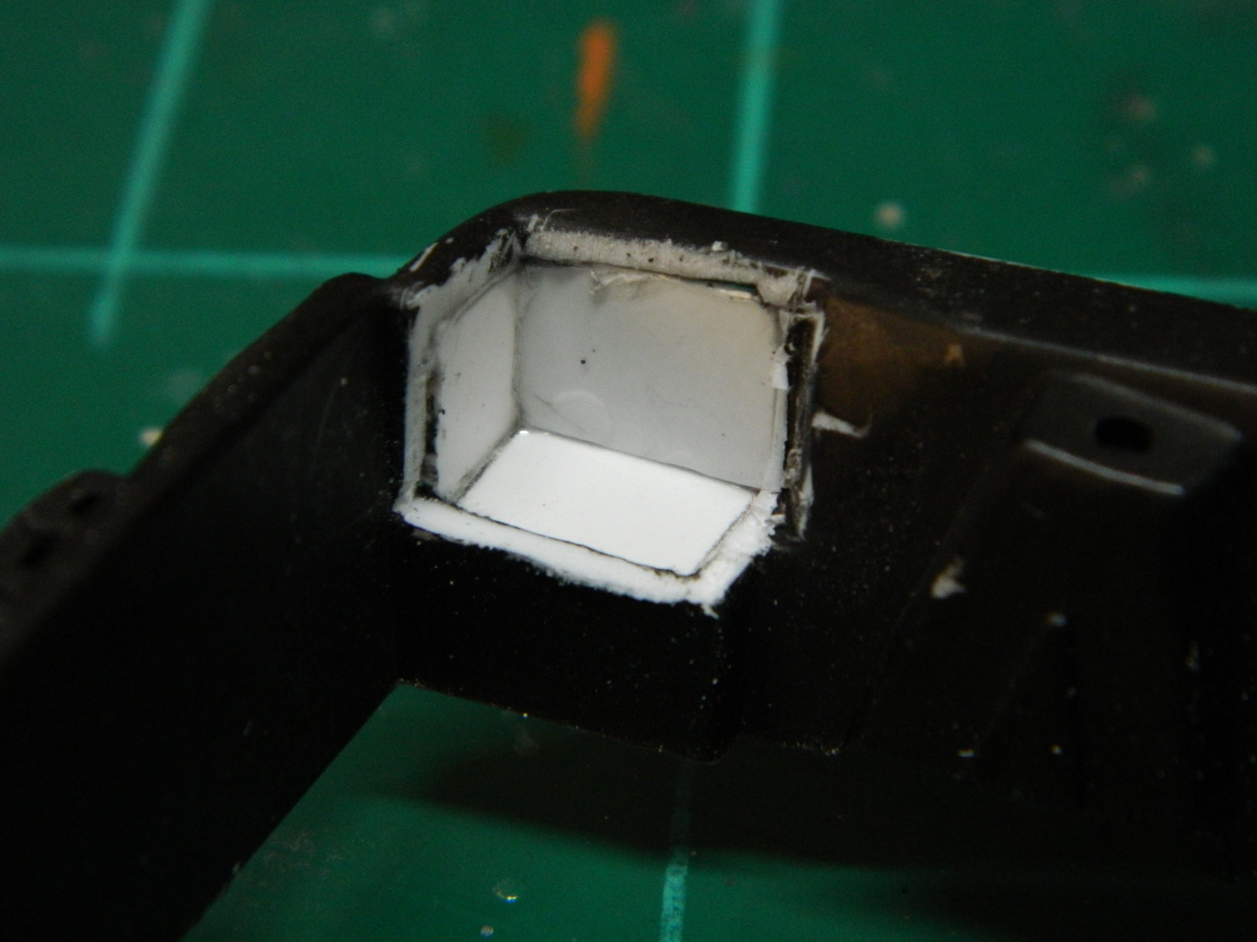

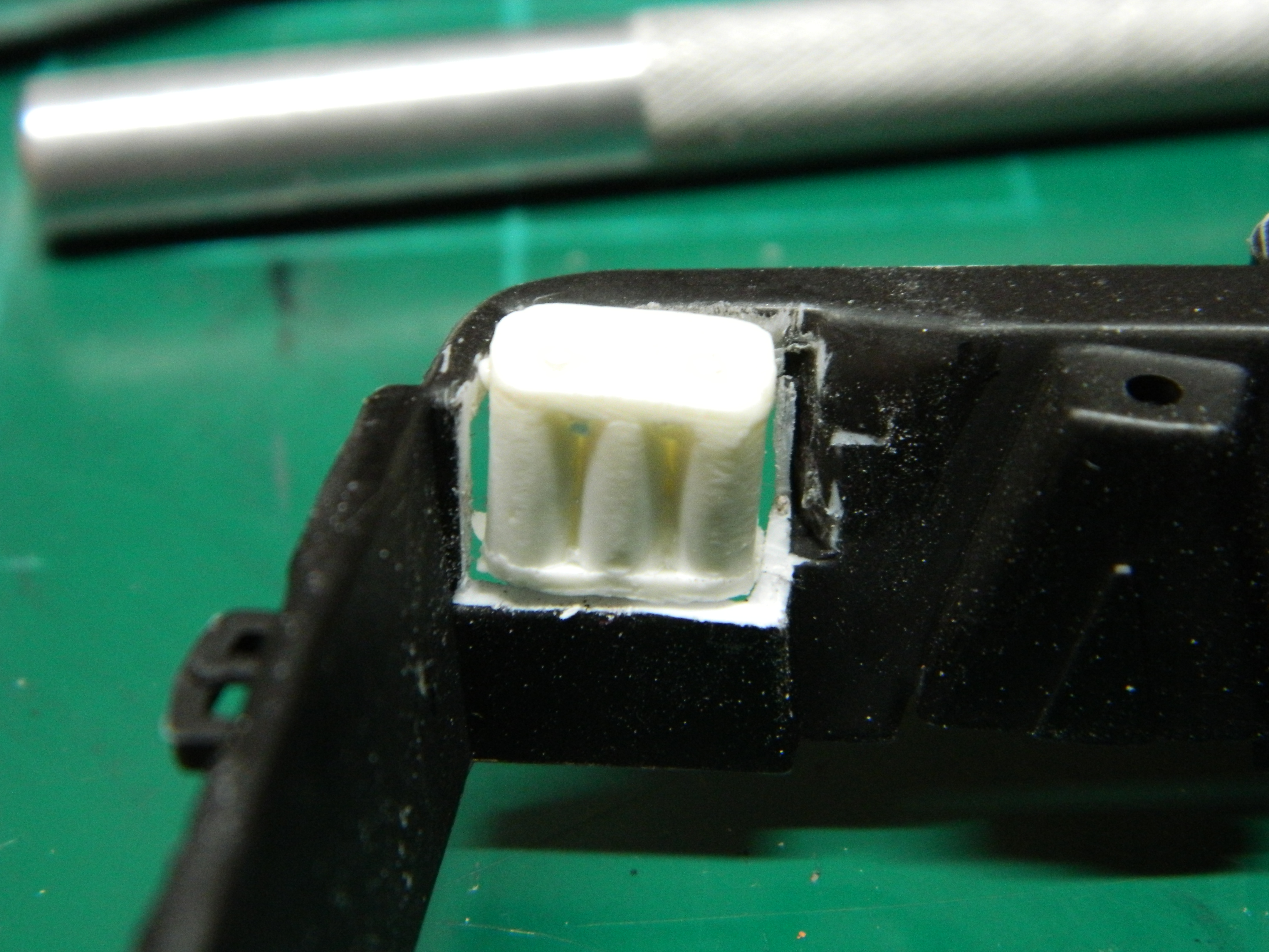

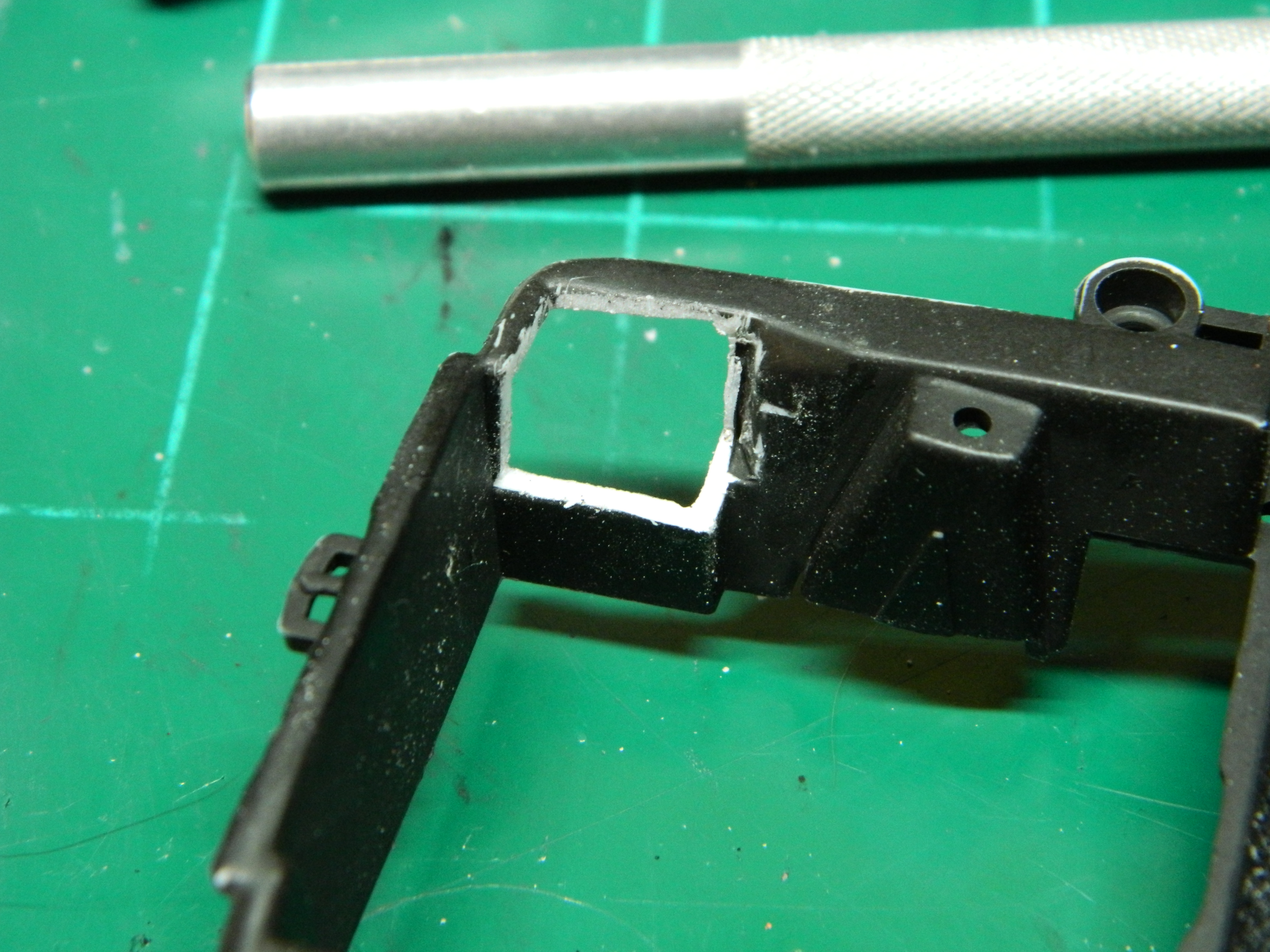

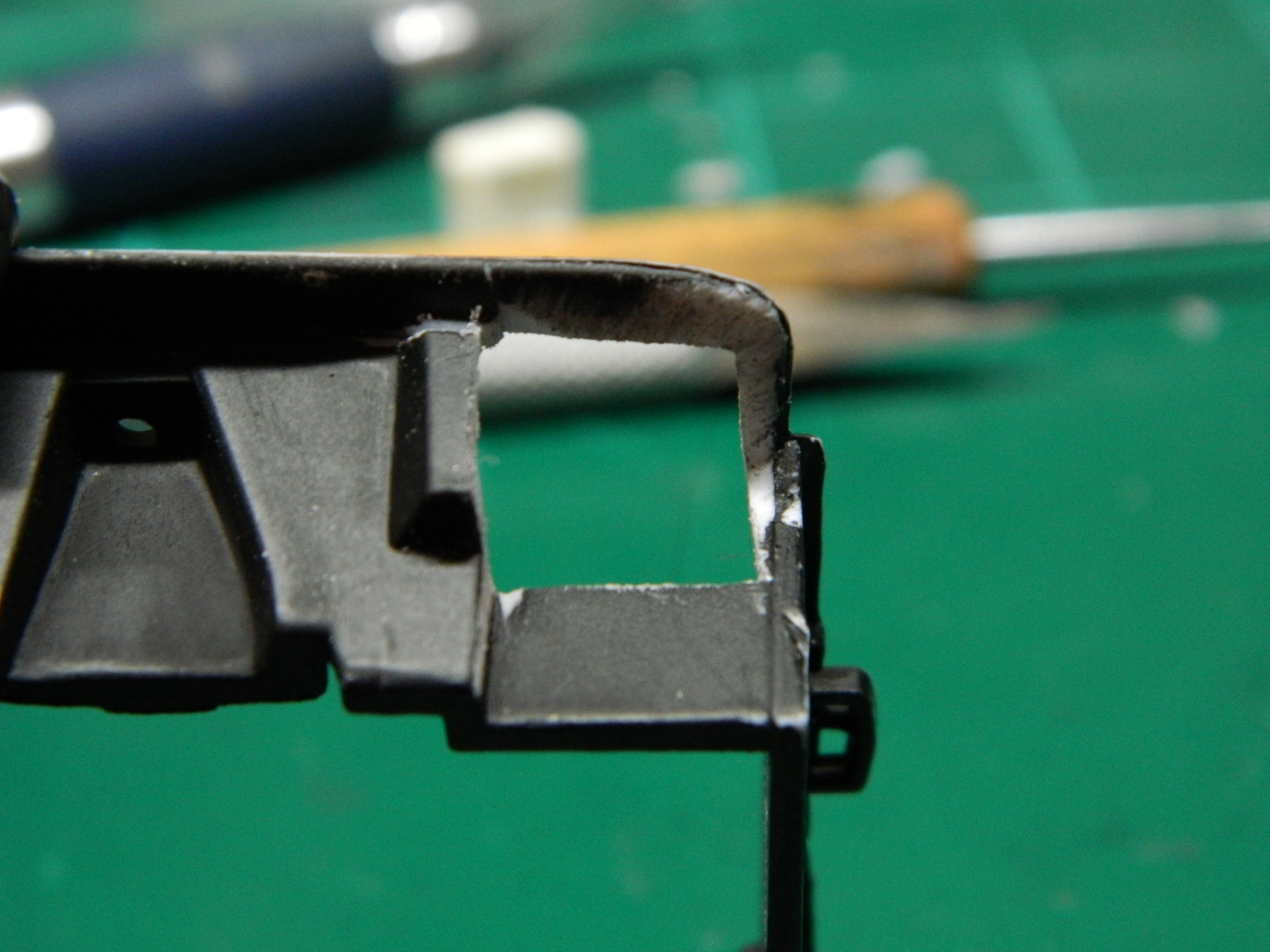

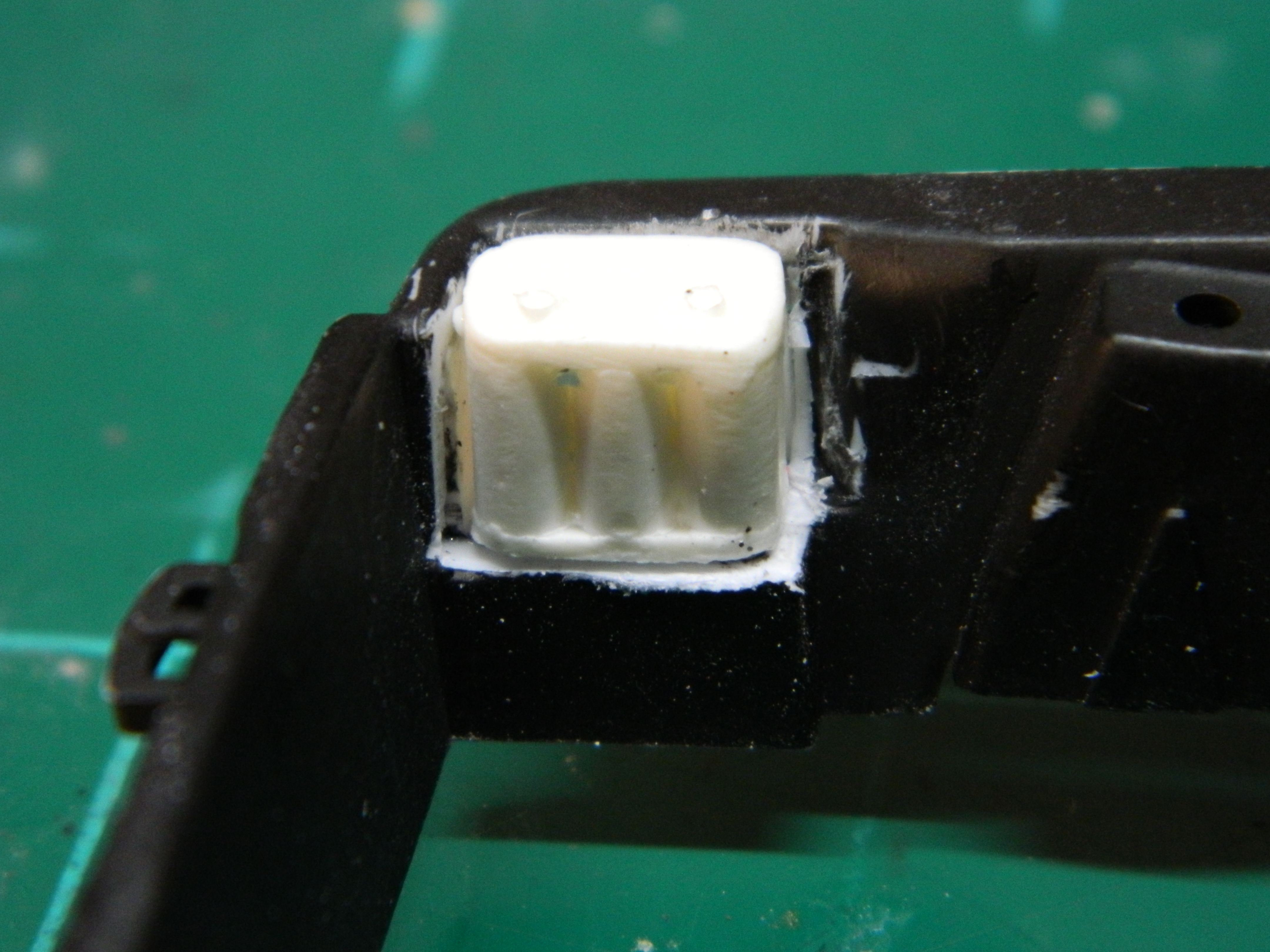

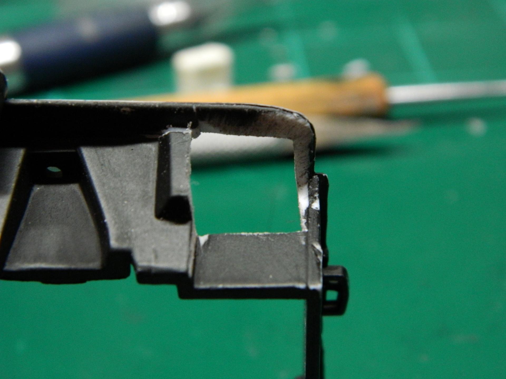

mrmike Posted December 11, 2018 Author Posted December 11, 2018 I took the interior apart and got out my photoetch saw and started cutting out the kit battery from the engine compartment. A mock up with the resin Optima battery shows that I need to clean up the battery and maybe remove some more material from the engine compartment and create a new battery shelf. More to come...

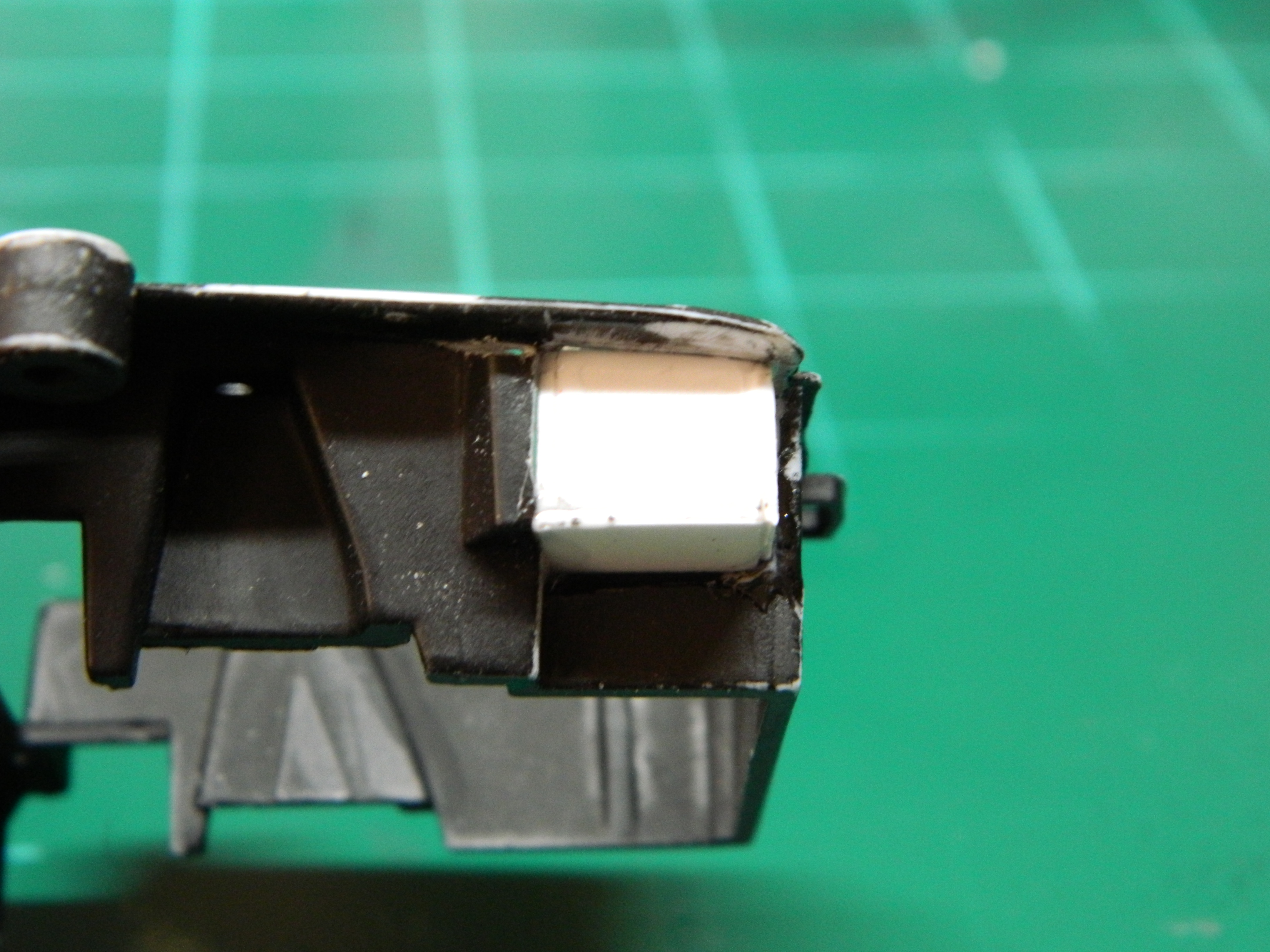

mrmike Posted December 12, 2018 Author Posted December 12, 2018 With some careful measuring, I cut some 0.020 styrene into three squares and added them to the hole I had cut into the engine bay. All the pieces were glued with Testors Liquid Cement. I mock up the resin Optima battery and the new battery tray looks perfect. Before someone panics and says that the battery will hit the hood, there is a 1/16" gap that runs between the fender and the engine compartment that is a leftover from the diecast mold. The gap will be filled at a later date. I need to repaint the engine compartment and the new battery tray. More to come...
