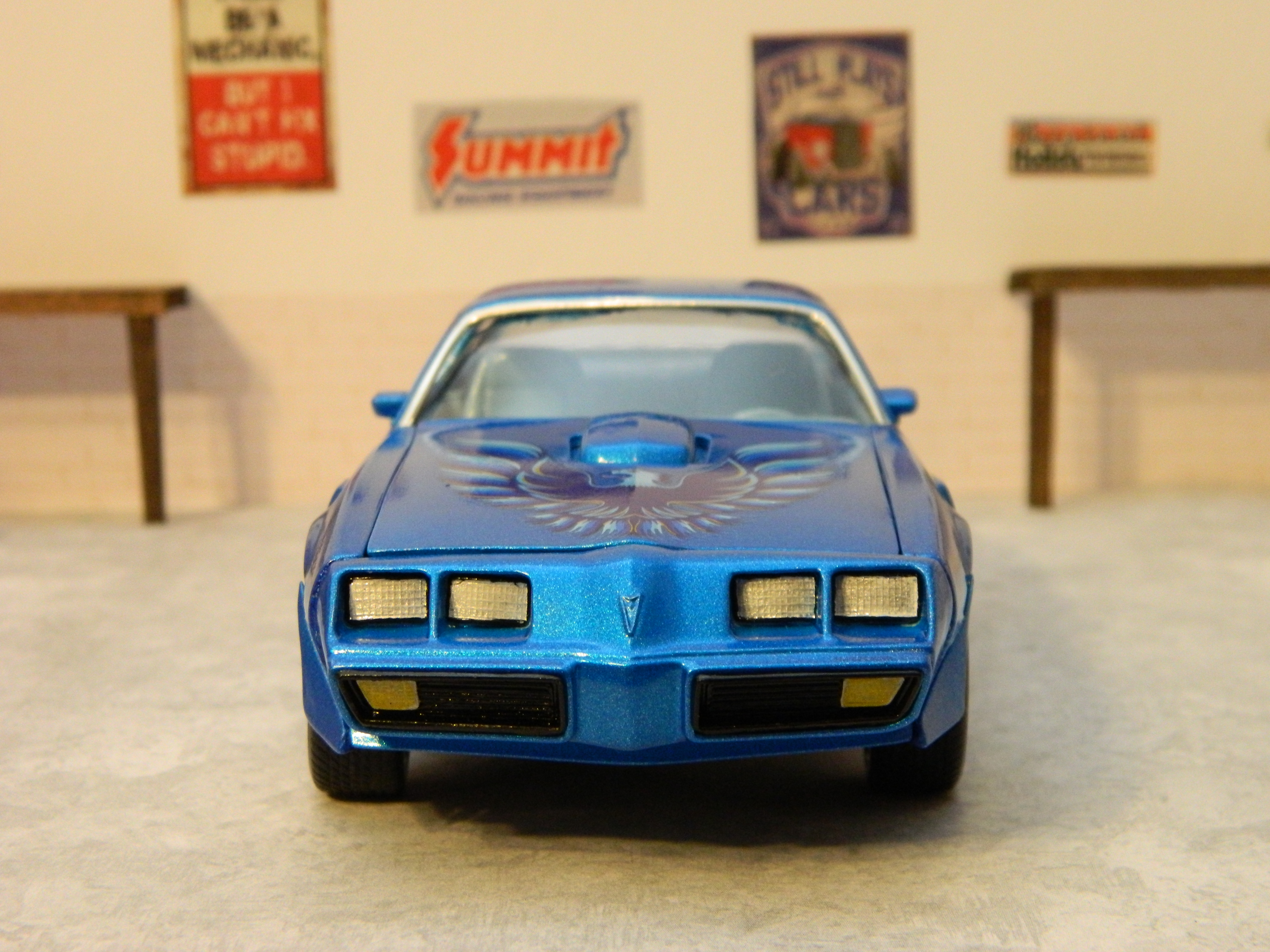

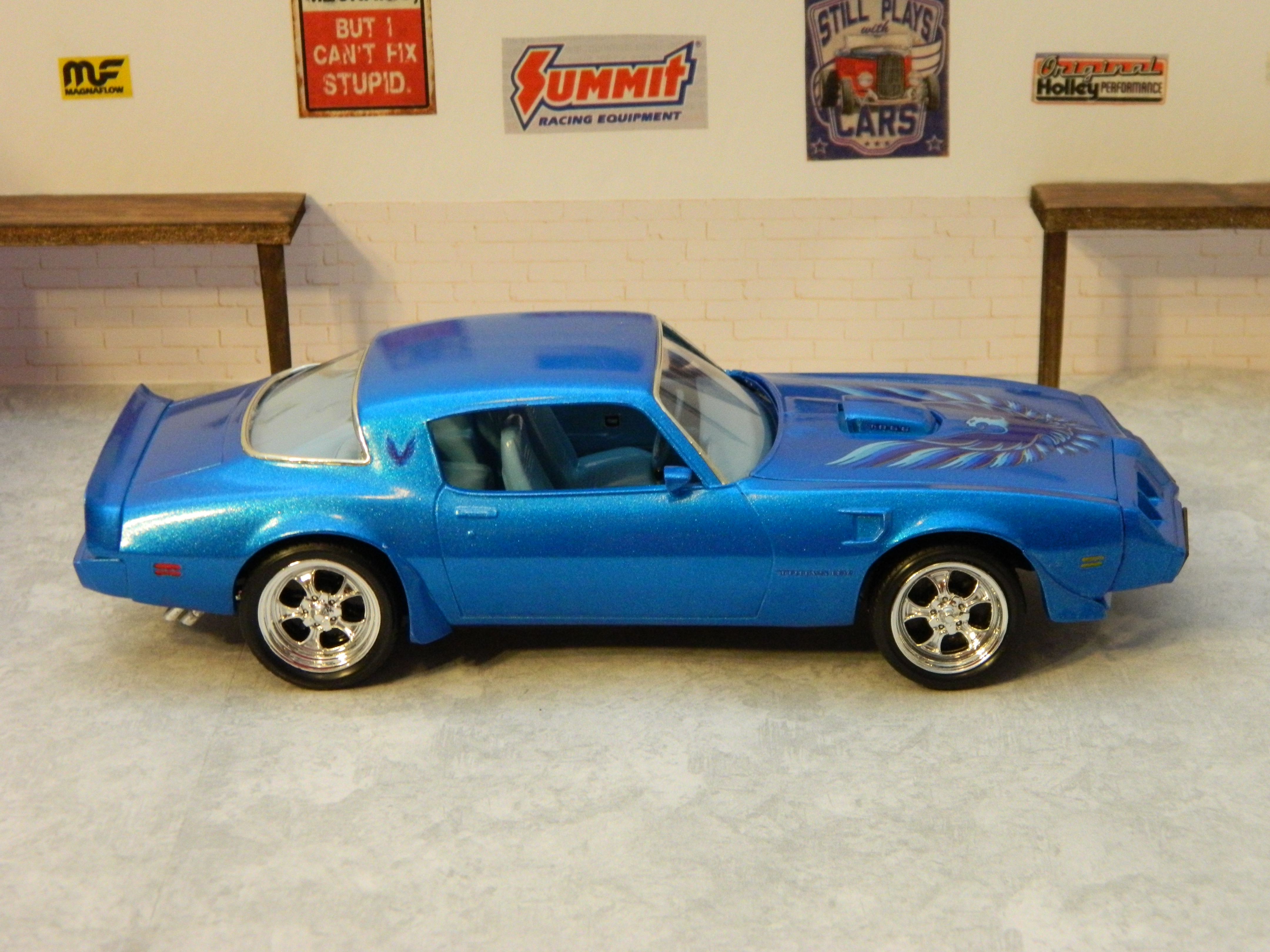

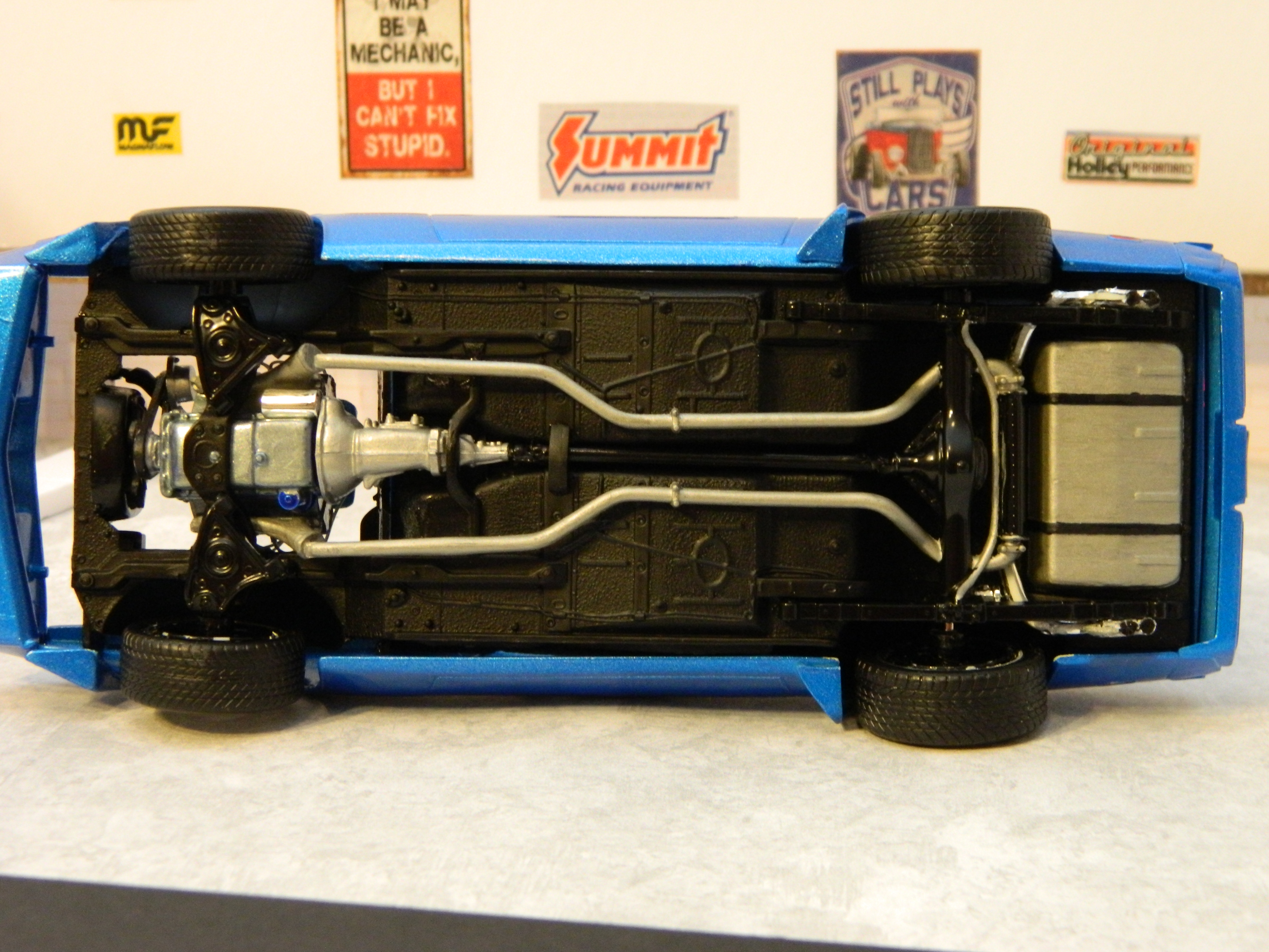

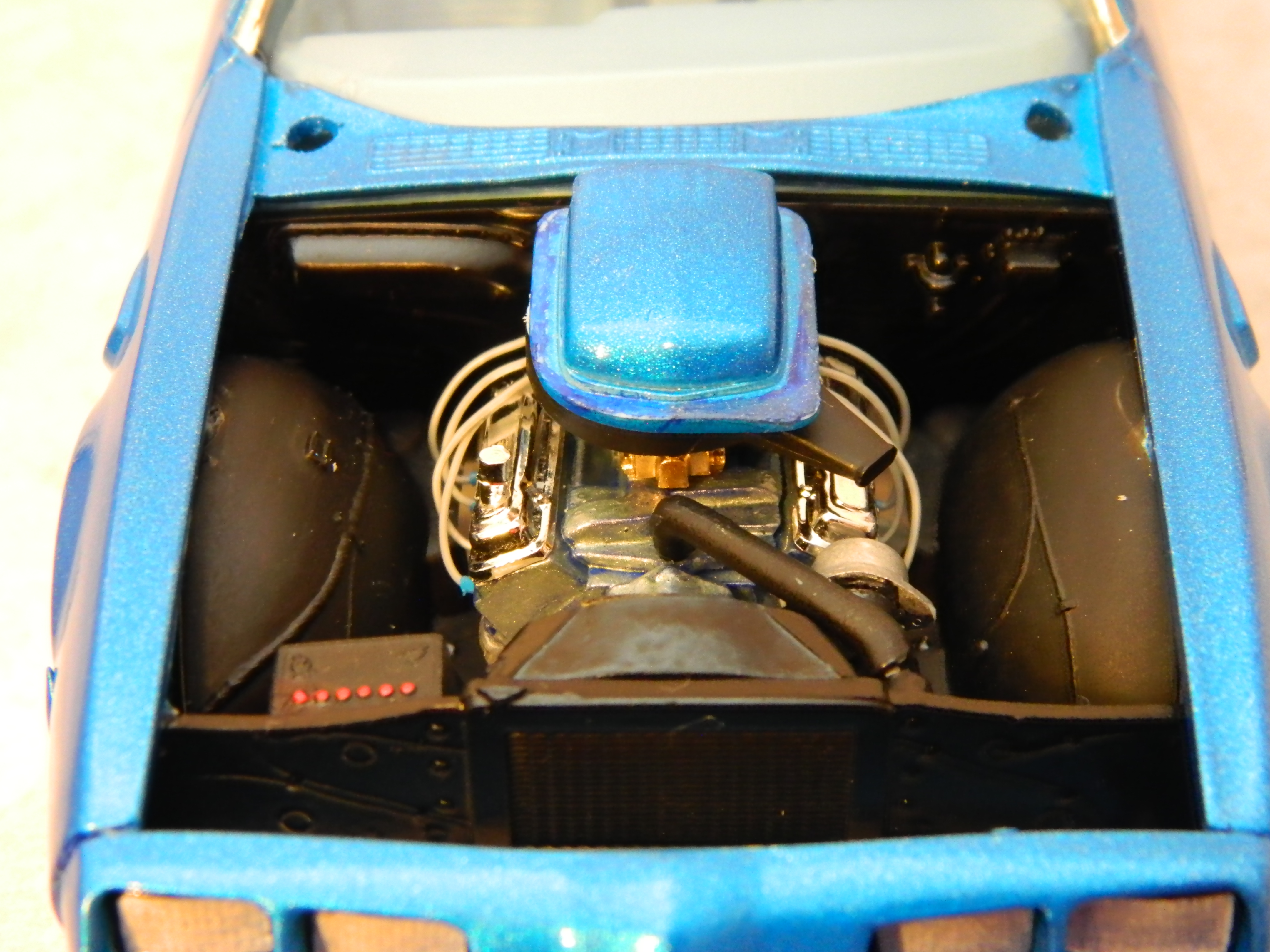

Dragonhawk1066 Posted December 1, 2018 Posted December 1, 2018 Calling build #8 done. MPC 1979 Pontiac Firebird T/A. Admittedly not my best work and I will surely revisit it in the future, but I feel the need to call it done for now. It fought me pretty much all the way with a warped body and chassis, a too thick windshield that I had to replace with a self made one for my very first time, and a lot of Murphy showing up, lol. Since it's the old 10th Anniversary kit with 3 color options for the decals instead of the Anniversary decals, there was a lot of flash and the same problems that were present, as memory now recalls, when I did said Anniversary kit some 30-35 years ago as a teen. Anyways, the color is Testors One Coat Lacquer Icy Blue and the interior is done in a custom shade expertly mixed by my wife. Rustolem Satin Black was sprayed on the chassis and the usual Steel and Aluminum to round out the details. I decided to paint over the basic blue that I had painted the engine with using Pontiac Engine Blue that is rather thin, so not the best job there. The interior mold is not very well detailed, but I did what I could with it and I think it turned out ok. The wheels are from my Revell '67 Chevelle kit and I had a little trouble getting those to work with the kit parts. I also added plug wires for the engine. When I revisit this one, I will concentrate on adjusting the windshield, fixing the stance and center the wheels in the wheelwell, and a couple of more details that I overlooked like the front emblem and door handles. Well, that pretty much sums up this one. Thanks for looking.
