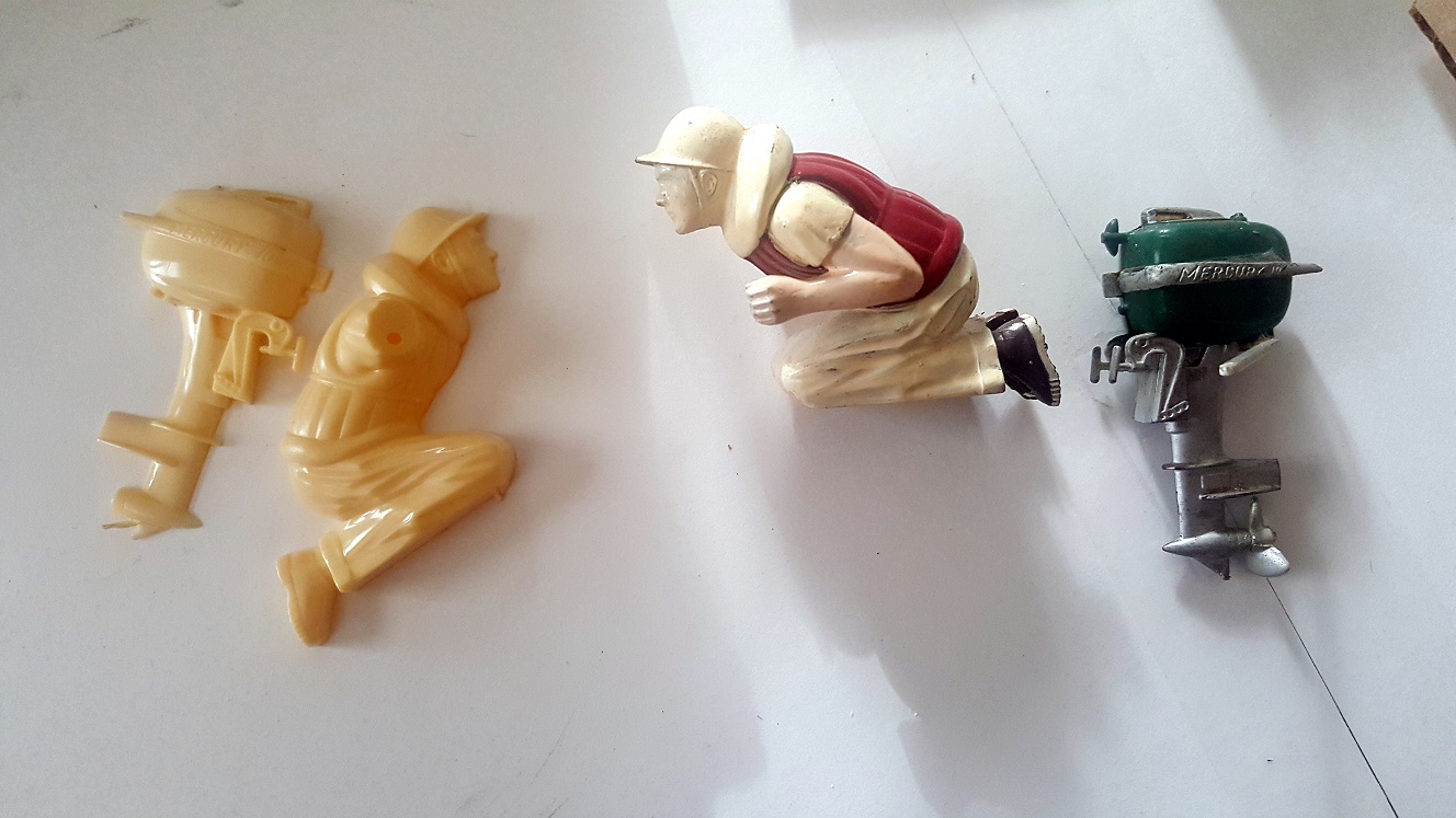

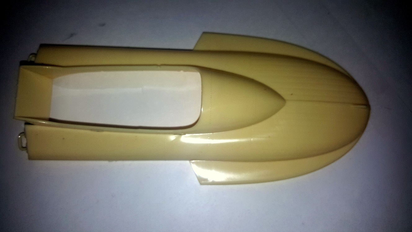

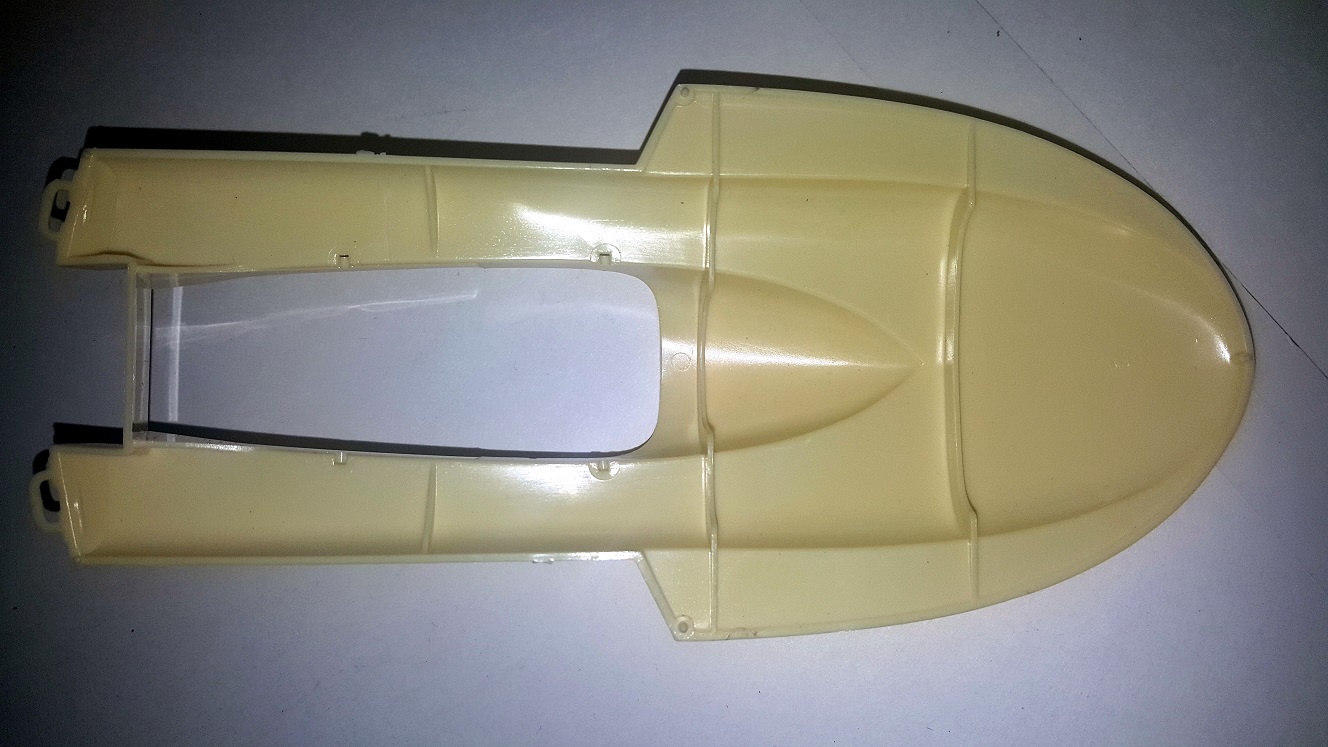

PB1983 Posted December 10, 2018 Author Share Posted December 10, 2018 It's definitely vintage. Around 1955. Here are two images of the model. This model was offered through Kelloggs company. I have no idea who produced these for them. Quote Link to comment Share on other sites More sharing options...
Ace-Garageguy Posted December 10, 2018 Share Posted December 10, 2018 Pretty cool. Definitely one I've never seen. I assume outboard-engine powered. About how long is it? Any nominal scale? Quote Link to comment Share on other sites More sharing options...

PB1983 Posted December 10, 2018 Author Share Posted December 10, 2018 20 minutes ago, Ace-Garageguy said: Pretty cool. Definitely one I've never seen. I assume outboard-engine powered. About how long is it? Any nominal scale? It's just over 7" long. My father built this same model when it was first released. I still have the man and outboard motor from his model but the boat was lost many many years ago. I've been looking for one of these kits for a long time and finally found one. It was still sealed in plastic with all the paper work and even the original glue tube! Here's an image of man and motor. Quote Link to comment Share on other sites More sharing options...
Ace-Garageguy Posted December 10, 2018 Share Posted December 10, 2018 That's really interesting. It would stand to reason that Kellogg's got the boat from Monogram as well (the other models are almost certainly the Monogram kits I showed above, 99.999% probability), as the "art" style of the figure is just like the driver figure style in the little Midget racer, and their slightly later Indy car. Man that's cool. Now I'm going to have to try to find one. Quote Link to comment Share on other sites More sharing options...
