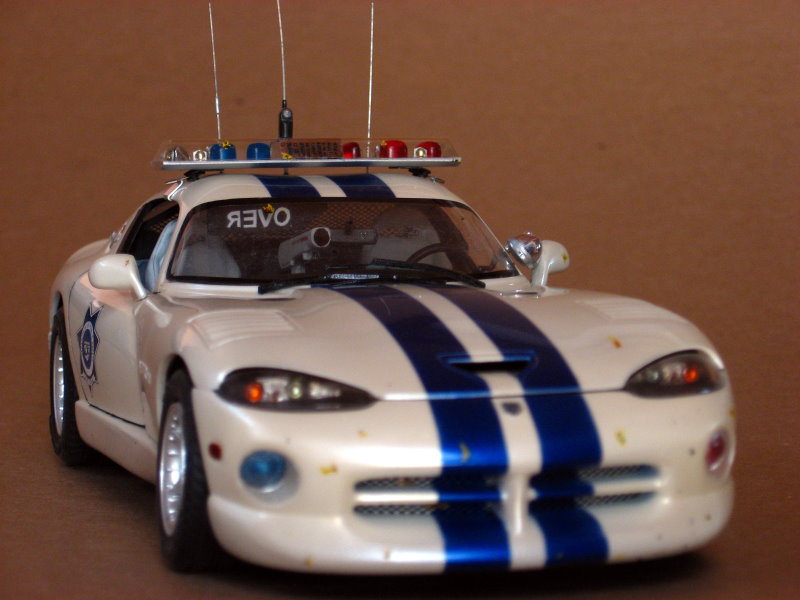

89AKurt Posted January 12, 2019 Share Posted January 12, 2019 I built that last century! The headlights bugged me too. I used MV lens for starters. Then I vacuum-formed new covers, because the kit parts are terrible. Quote Link to comment Share on other sites More sharing options...
DiscoRover007 Posted January 12, 2019 Author Share Posted January 12, 2019 1 hour ago, 89AKurt said: I built that last century! The headlights bugged me too. I used MV lens for starters. Then I vacuum-formed new covers, because the kit parts are terrible. That looks great! What did you mean by MV lenses? Quote Link to comment Share on other sites More sharing options...
89AKurt Posted January 13, 2019 Share Posted January 13, 2019 2 hours ago, DiscoRover007 said: That looks great! What did you mean by MV lenses? Thanks. Model railroad product brand is MV Products, there is a large choice of various sizes and colors. I'm posting this link just for reference, not suggesting as a source, but a decent *real* hobby shop should carry them. https://www.hobbylinc.com/m-v-products-model-trains Quote Link to comment Share on other sites More sharing options...
