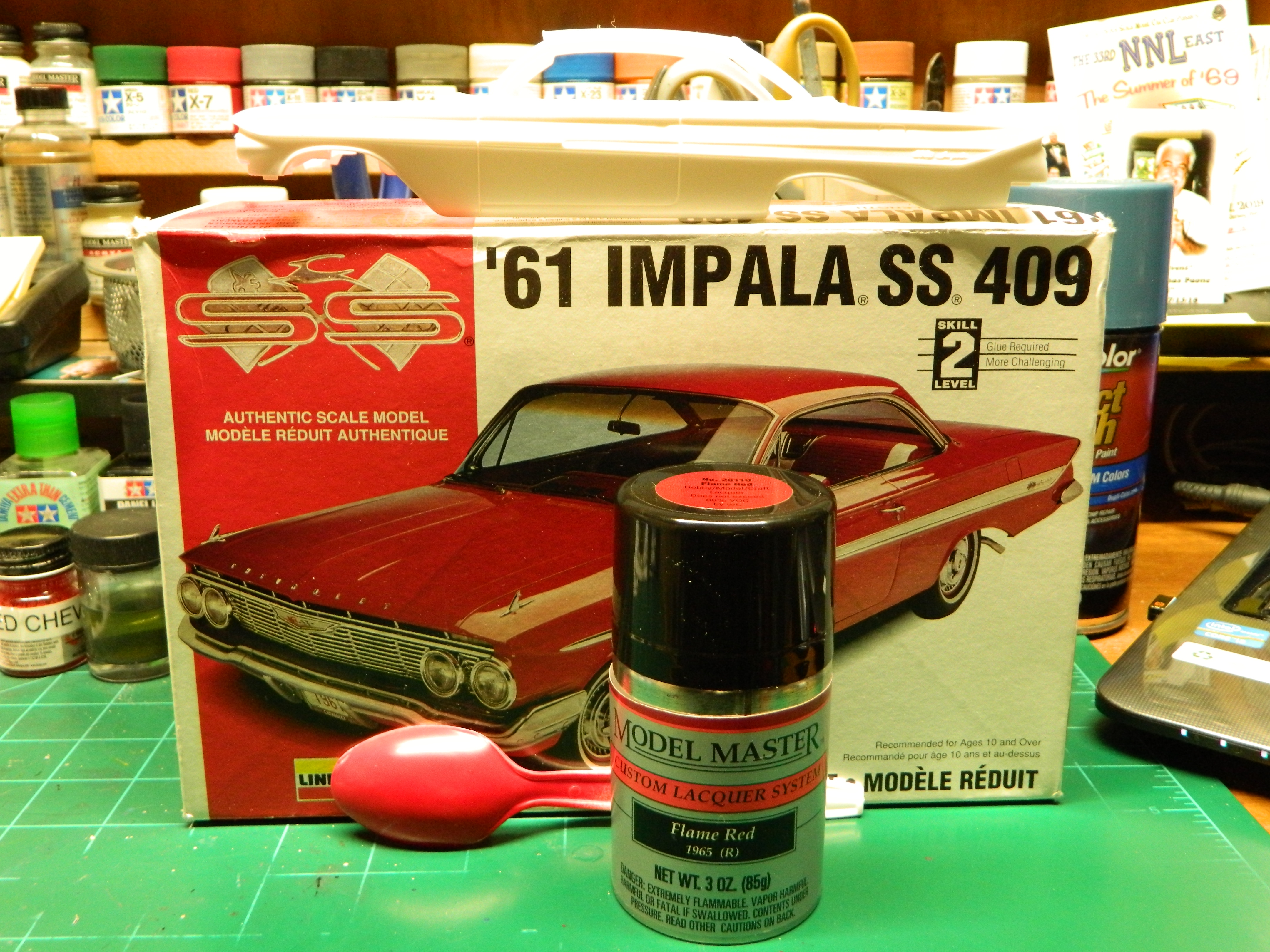

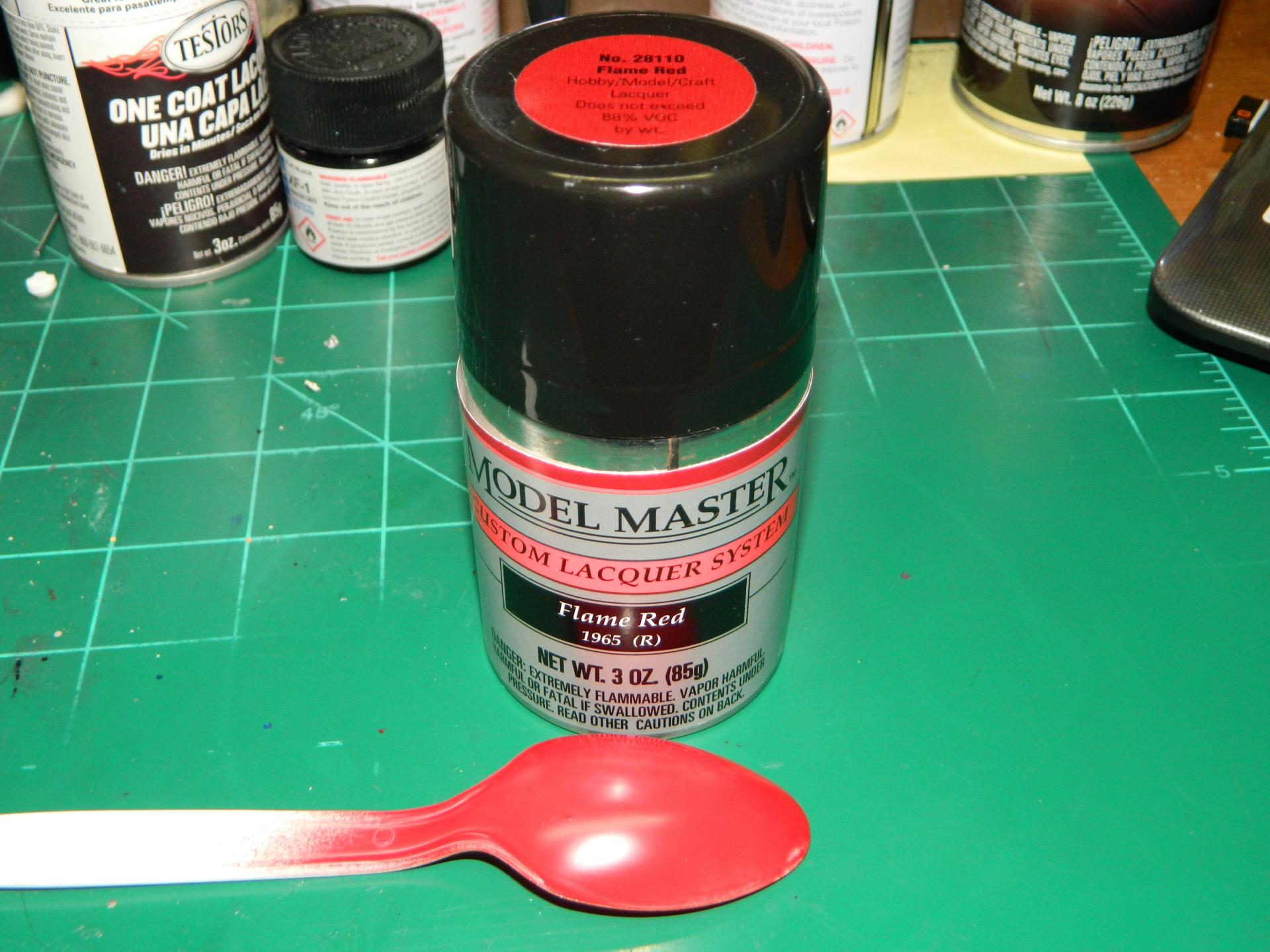

mrmike Posted February 8, 2019 Posted February 8, 2019 Every year, the Classic Plastic Model Club holds a Club Challenge for our annual Club Exhibition in October. This year it is box stock with any finish you want. My project for the Club Challenge will be the Lindberg 1961 Chevrolet Impala SS 409. My paint will be Model Master Flame Red with a matching red and white interior. I did a spray out on a plastic spoon to get a sense of what the color actually was, since I have seen several shades that range from bright red to almost a maroon and they are referred to as Flame Red. The color is a little dark, but I like it. Time to start is now. If I wait until the last minute, it'll never get done. More to come...
espo Posted February 8, 2019 Posted February 8, 2019 That's a great color, they even used it in the box art.
mrmike Posted February 9, 2019 Author Posted February 9, 2019 Thanks David! My first thought was that the color would be too dark as I have seen several pictures of this color all labeled as Flame Red. The color varied from a bright red to a maroon and I wasn't too sure about the paint until I tried it on a spoon. This is the color for this Chevy!

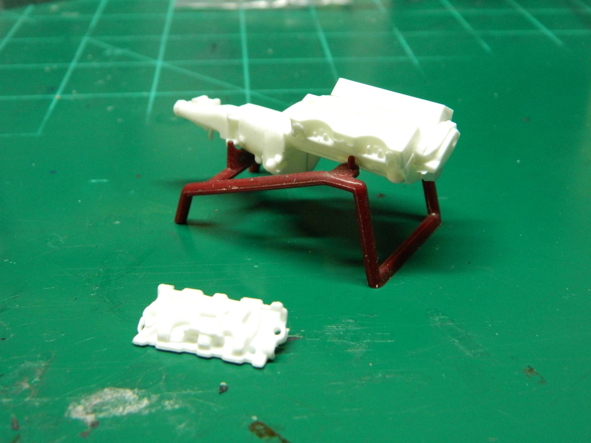

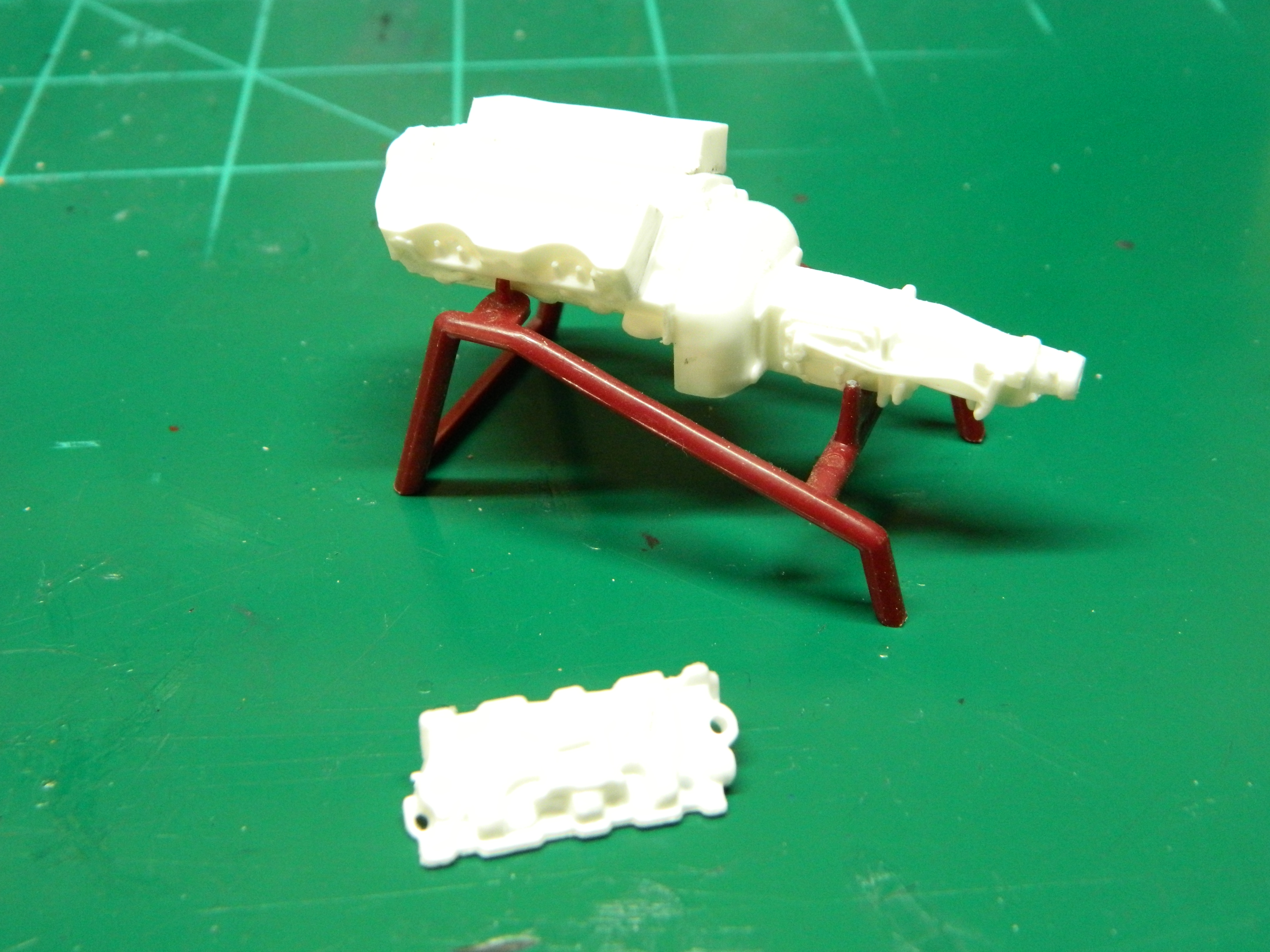

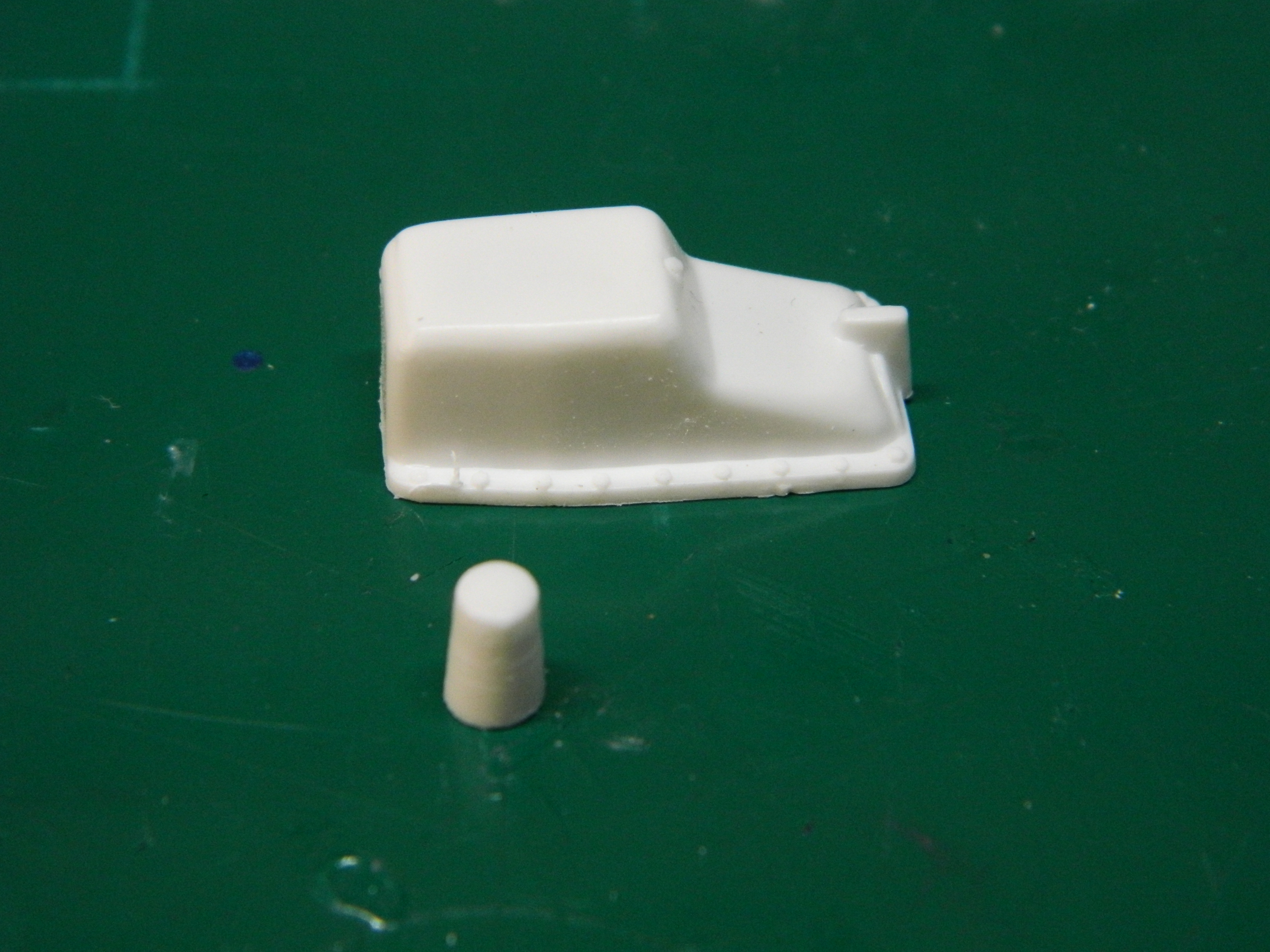

mrmike Posted February 14, 2019 Author Posted February 14, 2019 I got tired of polishing my Bullitt Mustang and the '70 Charger R/T, so I decided to start a little assembly of the 409 CID engine. One thing I didn't like about this engine was that the oil filter was moulded with the oil pan. I used a P/E saw and removed the oil filter. More to come...
espo Posted February 15, 2019 Posted February 15, 2019 Separating the Oil Filter in this way will make it more realistic and easier to detail. At that time Chevrolet still used a semi gloss black canister with the filter cartridge inside.
BigTallDad Posted February 15, 2019 Posted February 15, 2019 (edited) 2 hours ago, espo said: At that time Chevrolet still used a semi gloss black canister with the filter cartridge inside. My '64 Impala SS had the same arrangement on its 327 cubic inch engine. As I recall, the housing was straight, not tapered. The decal looked like this Edited February 15, 2019 by BigTallDad
carnut Posted February 15, 2019 Posted February 15, 2019 (edited) mrmike, and anyone else for that matter. Before you toss out your color of paint you might want to shoot your color over a white primer. It’s an old car painters trick I learned from my dad years ago. Simply light colors and warm colors shoot over white it makes the color more vibrant. Also the paint colors would very a bit from day to day during assembly (atmospheric conditions). It looks good so far, keep it going. Best Regards Edited February 15, 2019 by carnut
mrmike Posted February 16, 2019 Author Posted February 16, 2019 Thank you Ray! The tapered canister was part of the kit and I can't change it. I have to use what's in the box. Thank you Michael, but I already knew that primer color can change the shade of your basecoat.
espo Posted February 16, 2019 Posted February 16, 2019 BigallDad is correct on the Oil Filter canister. I don't recall when GM started using the spin on type filter but I think it was in the early '70's or late '60's. 3 hours ago, mrmike said: Thank you Ray! The tapered canister was part of the kit and I can't change it. I have to use what's in the box. Thank you Michael, but I already knew that primer color can change the shade of your basecoat. Who is to say you can't sand it to correct the inaccuracy much like the body mold lines ?
mrmike Posted February 17, 2019 Author Posted February 17, 2019 (edited) The rules for building Box Stock in the Club Challenge state that I can correct any manufacturers defects and while the shape of the part has a slight taper to it, it is not really a manufacturers defect and therefore, cannot be altered. You really have to look at the part to see the taper and once painted, decaled and installed, the taper does not show. Edited February 17, 2019 by mrmike

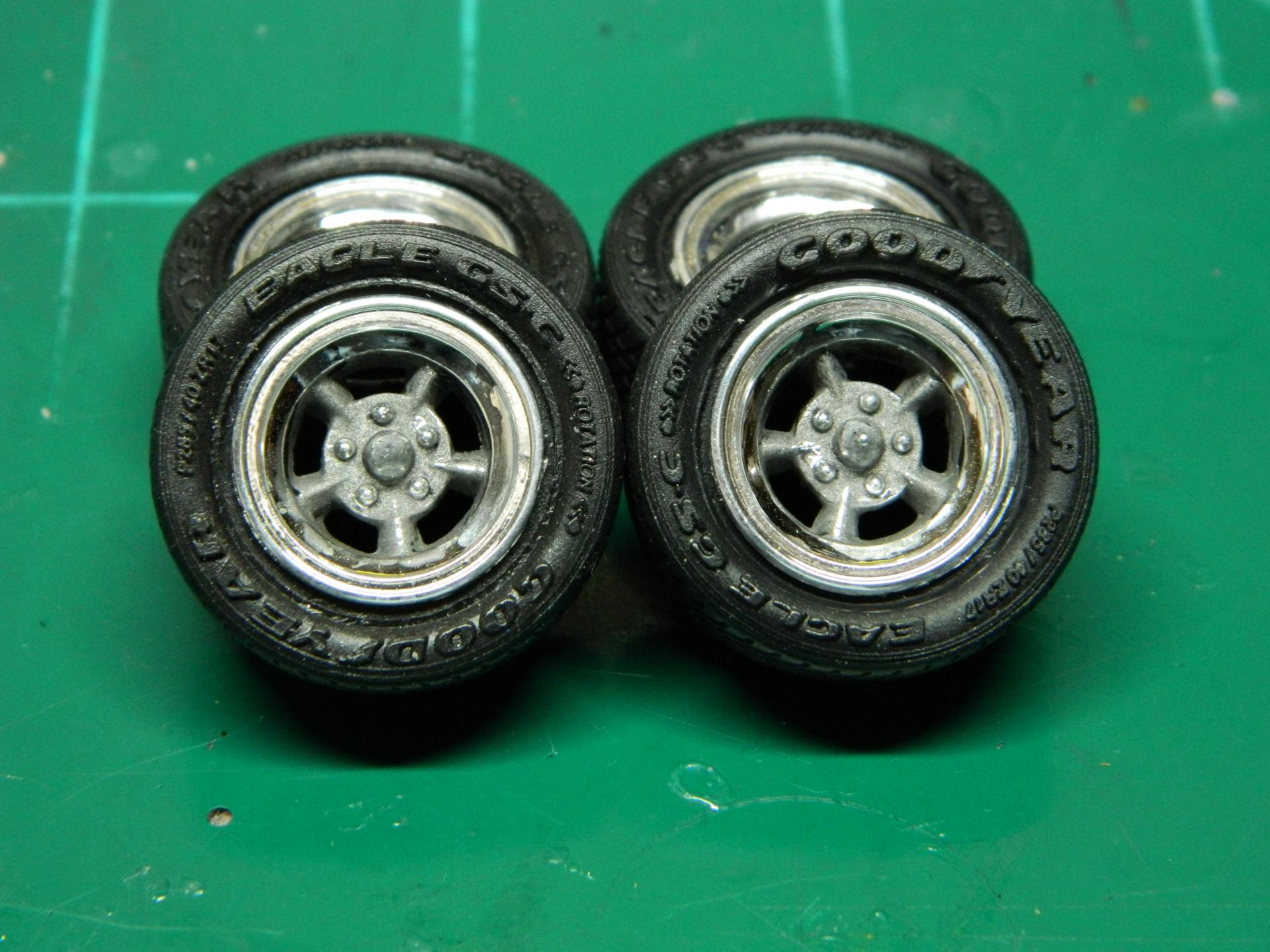

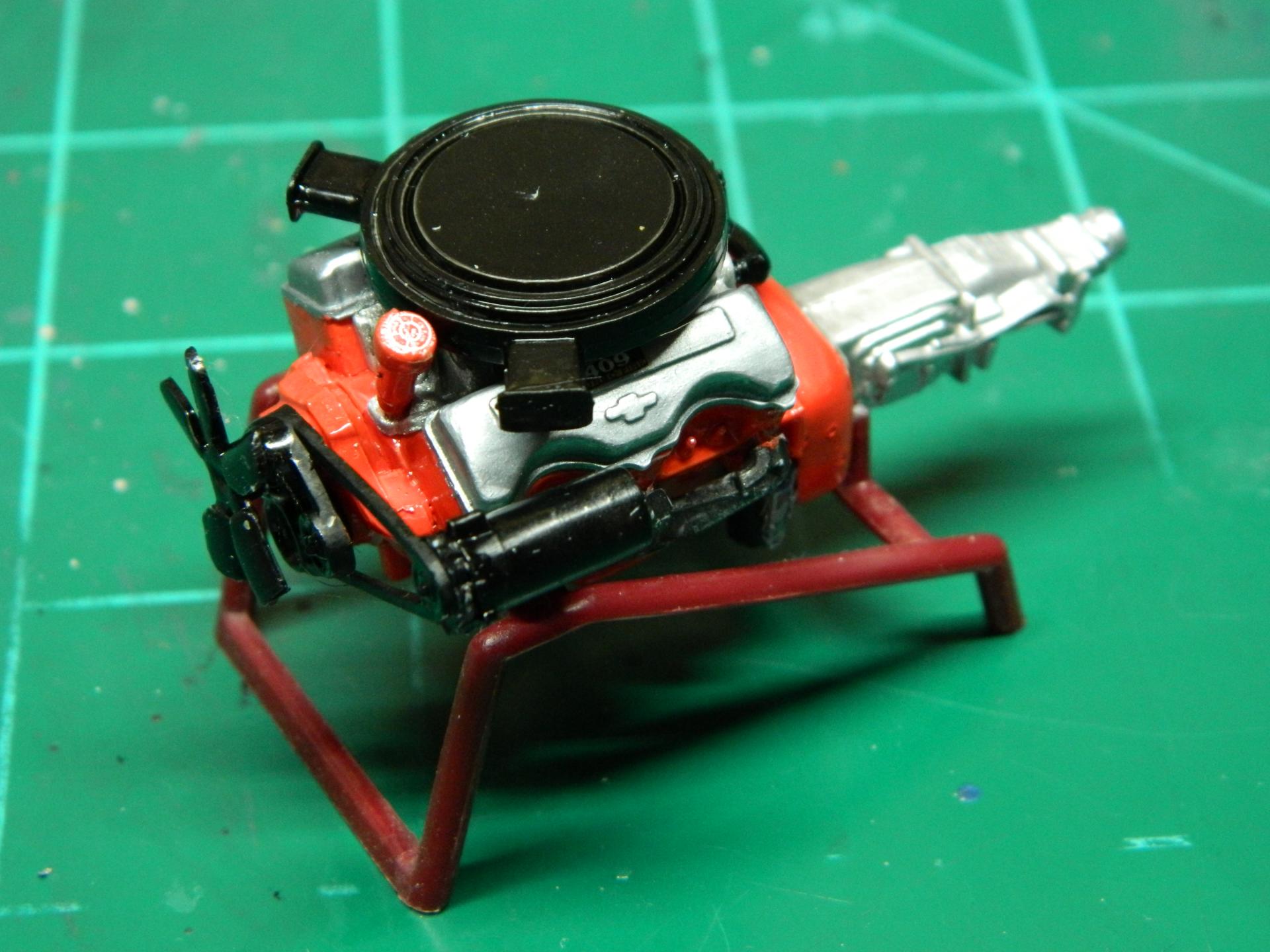

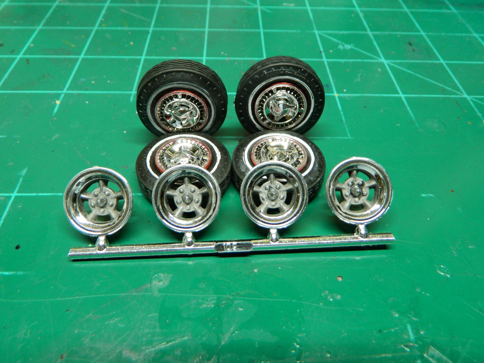

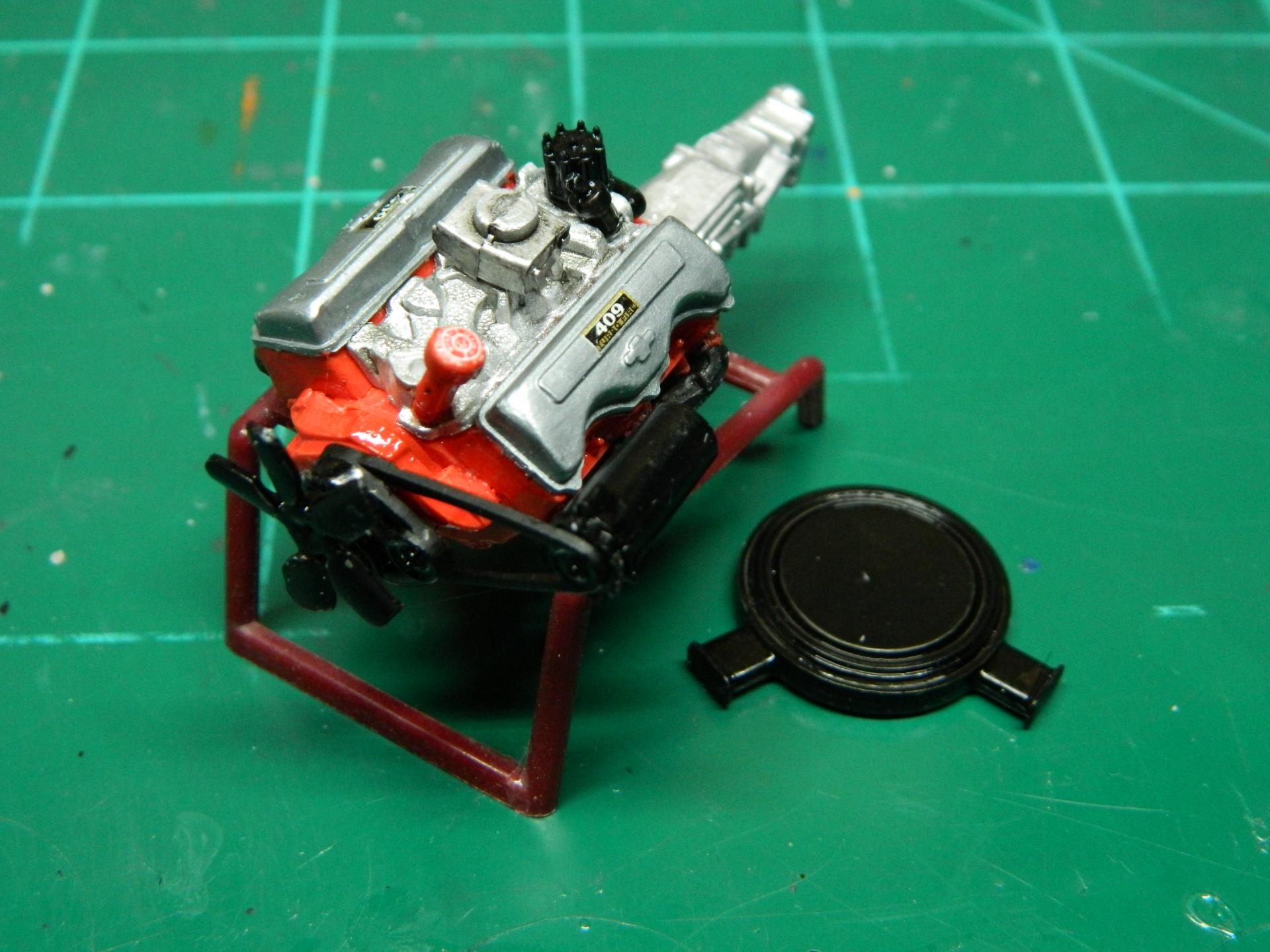

mrmike Posted February 22, 2019 Author Posted February 22, 2019 I got the 409 CID assembled and decaled. I assembled the stock wheels and tires. The American Racing mags are for after the Club Challenge and will replace the stock wheels and tires. I just need to find a set of tires in the parts box for the mags. More to come...
espo Posted February 22, 2019 Posted February 22, 2019 I like the looks of the Americans. A thought on the tires. The Good Year Polyglass tires in the new '68 Chevelle would look good, or if you have them the tires from the Round 2 '62 Pontiac are also nice.

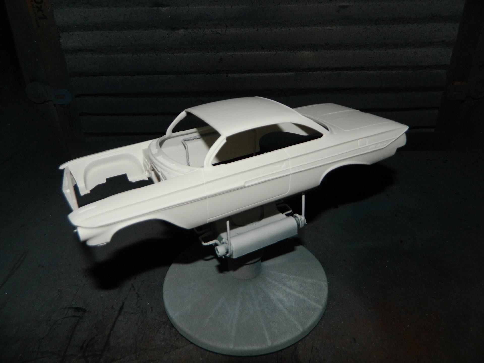

mrmike Posted February 22, 2019 Author Posted February 22, 2019 I rummaged through my parts box and found a set of Goodyear GS-C Eagles for the American Racing mags. But, after looking at the mags, I need to clean them up some as I was a bit sloppy painting the spokes. The body and associated parts are now in a coat of Dupli-Color White Primer. Now for a some light sanding. More to come...

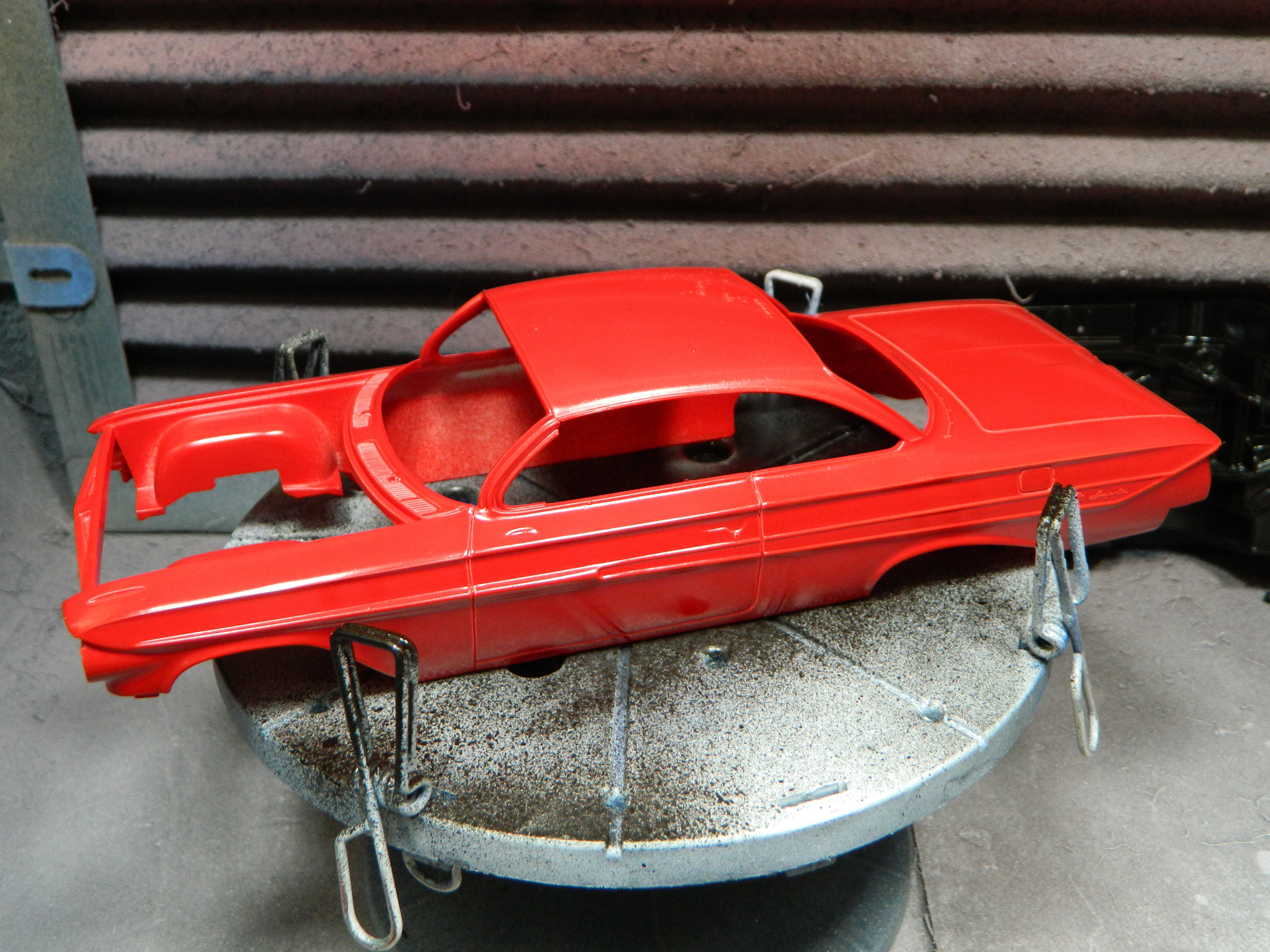

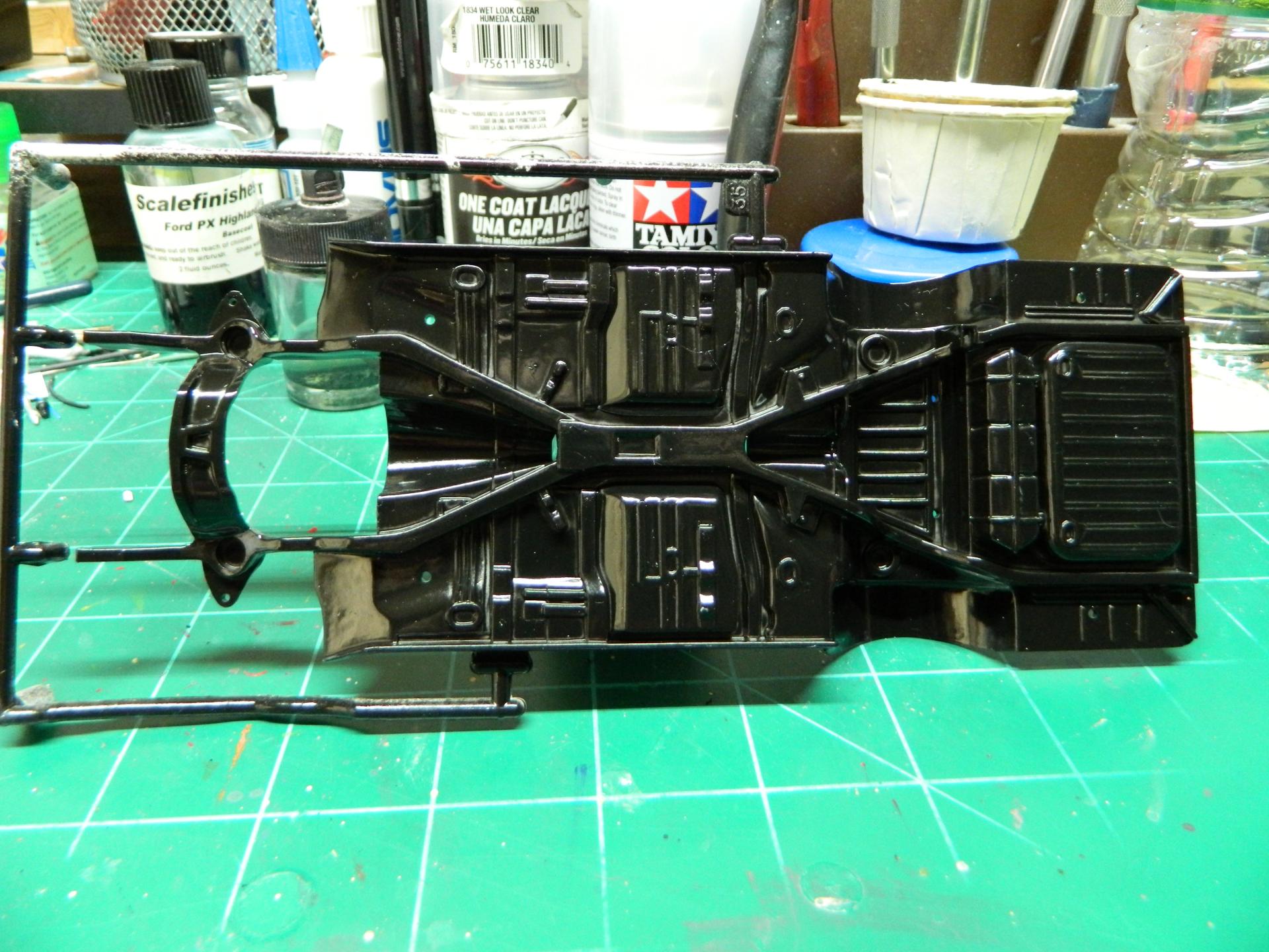

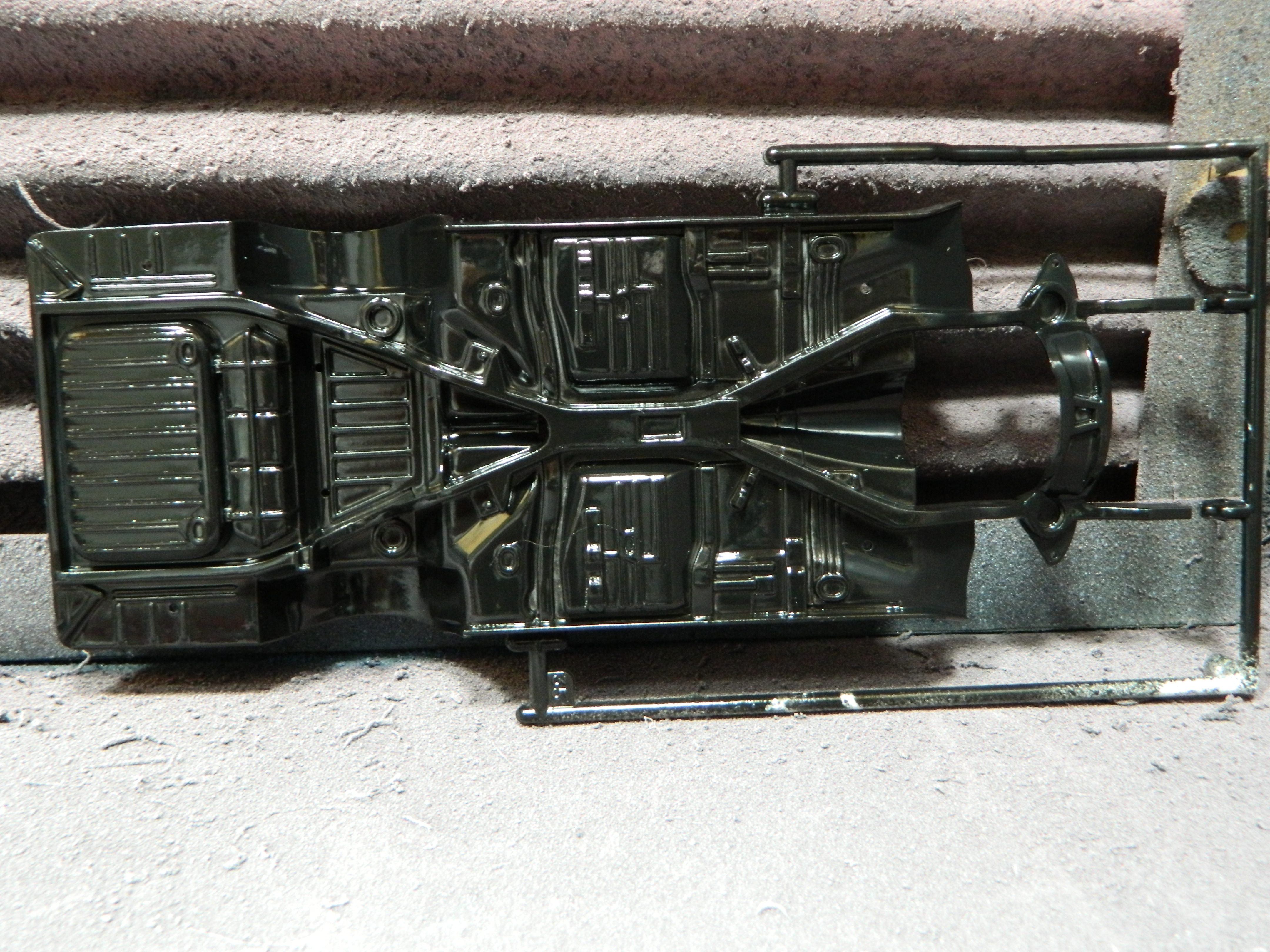

mrmike Posted March 6, 2019 Author Posted March 6, 2019 While I had the paintbooth up and running, I painted the Impala with Model Master Flame Red Lacquer. I painted the chassis with Rustoleum Painters Touch Semi-Gloss Black. It's a touch glossy and tacky, so some time in the dehydrator is in order. More to come...

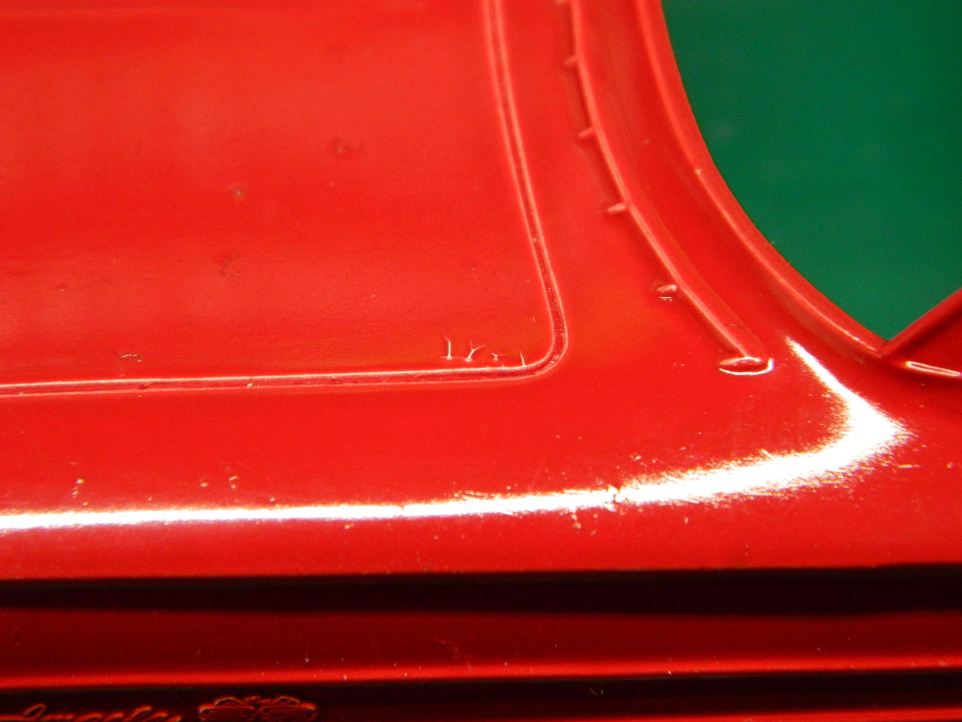

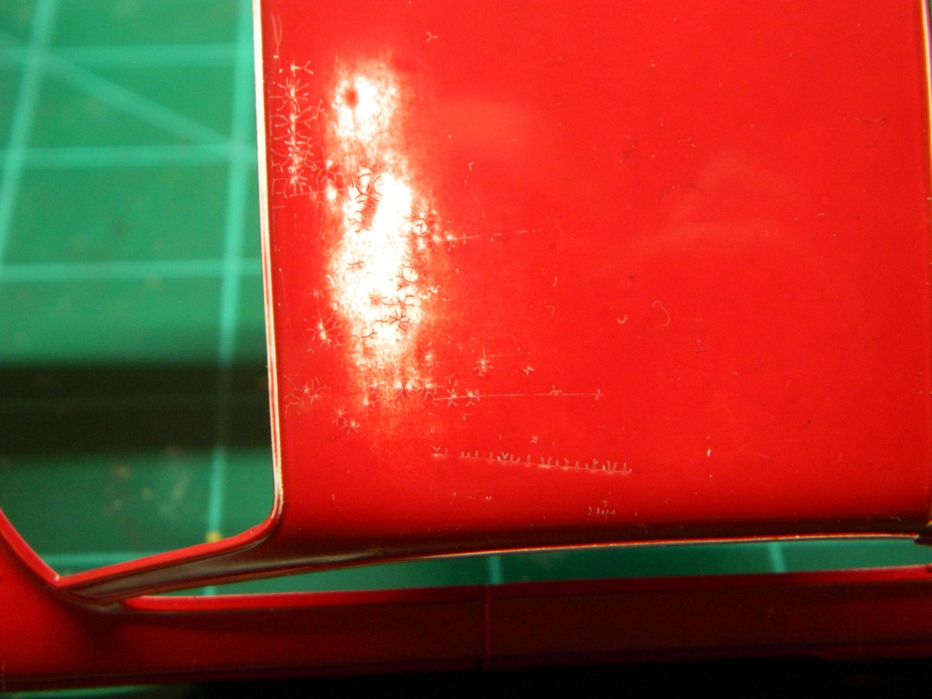

mrmike Posted March 14, 2019 Author Posted March 14, 2019 Well, my bad painting luck has returned! The paint cracked on top of the primer. I think I'll strip the paint and start all over again with the same brand primer and paint. This is the chassis and it is supposed to be semi-gloss black and it looks like gloss black. This is enamel paint, so I'll have to clear coat it with Acryl Semi-Gloss Clear. More to come...
Vince66 Posted March 14, 2019 Posted March 14, 2019 Nice I have 2 of these the original error car and the corrected version. Following along with interest. Shame about the paint.
mrmike Posted March 15, 2019 Author Posted March 15, 2019 The body is in the stripper and I'll start over again with a clean body, and Model Master primer and paint. When life gives you lemons, make lemonade!
