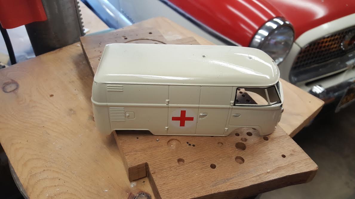

the goon Posted February 25, 2019 Posted February 25, 2019 Howdy, I've decided to take a try at redoing a diecast. Picked up this 1/24th VW type 2. Disassembly was easy, now comes the time to strip off the factory paint. What is the best way/product to remove this paint? I sure this question has come up/been answered before, but any info will help. Thanks, Mark
Gramps46 Posted February 25, 2019 Posted February 25, 2019 I tried brake fluid on one and it took days to remove the paint. Have not tried Super Clean or Easy Off yet.
the goon Posted February 25, 2019 Author Posted February 25, 2019 Thanks for the reply. That paint is super tuff, like baked on refrigerator paint.
cobraman Posted February 25, 2019 Posted February 25, 2019 I used to use a gel paint stripper I bought at an ACE hardware. It worked great , sorry I don't recall the name of the product. I wonder it EZ Off in the yellow can would work ???
Snake45 Posted February 25, 2019 Posted February 25, 2019 Why strip it at all? Remove the tampo graphics with Non-Acetone Nail Polish Remover, then just sand the paint with #800 Wetordry, wet, and it should make a perfect primer for whatever you have in mind--especially since it's already white.
ibj40 Posted February 26, 2019 Posted February 26, 2019 I use a product called Klean Strip. It is an aerosol, and comes in a couple of different strengths, including one intended for airplanes. My experience is that they all work the same. Spray it on, the paint will bubble up, and you wash it off with high pressure water. Make sure you get all the plastic pieces off before your strip diecast, most solvent will turn plastic into unrecognizable goo. One caution on repainting diecast is that the tolerances between pieces is a lot closer than on real vehicles, and paint doesn't understand that. If a paint supplier tells you two coats of primer and two coats of paint, for example, that is for a real vehicle. On pieces such as doors and hoods/trunks, on diecast (I work in 1/18 scale, for example), that will use up all the factory room between these pieces. Good luck on your first one, and keep us up to date.
the goon Posted February 26, 2019 Author Posted February 26, 2019 Thanks for the replies guys. I thought about sanding the factory paint/painting over it, but would like to try stripping once. I will post which way I go, and do a build thread. Mark
