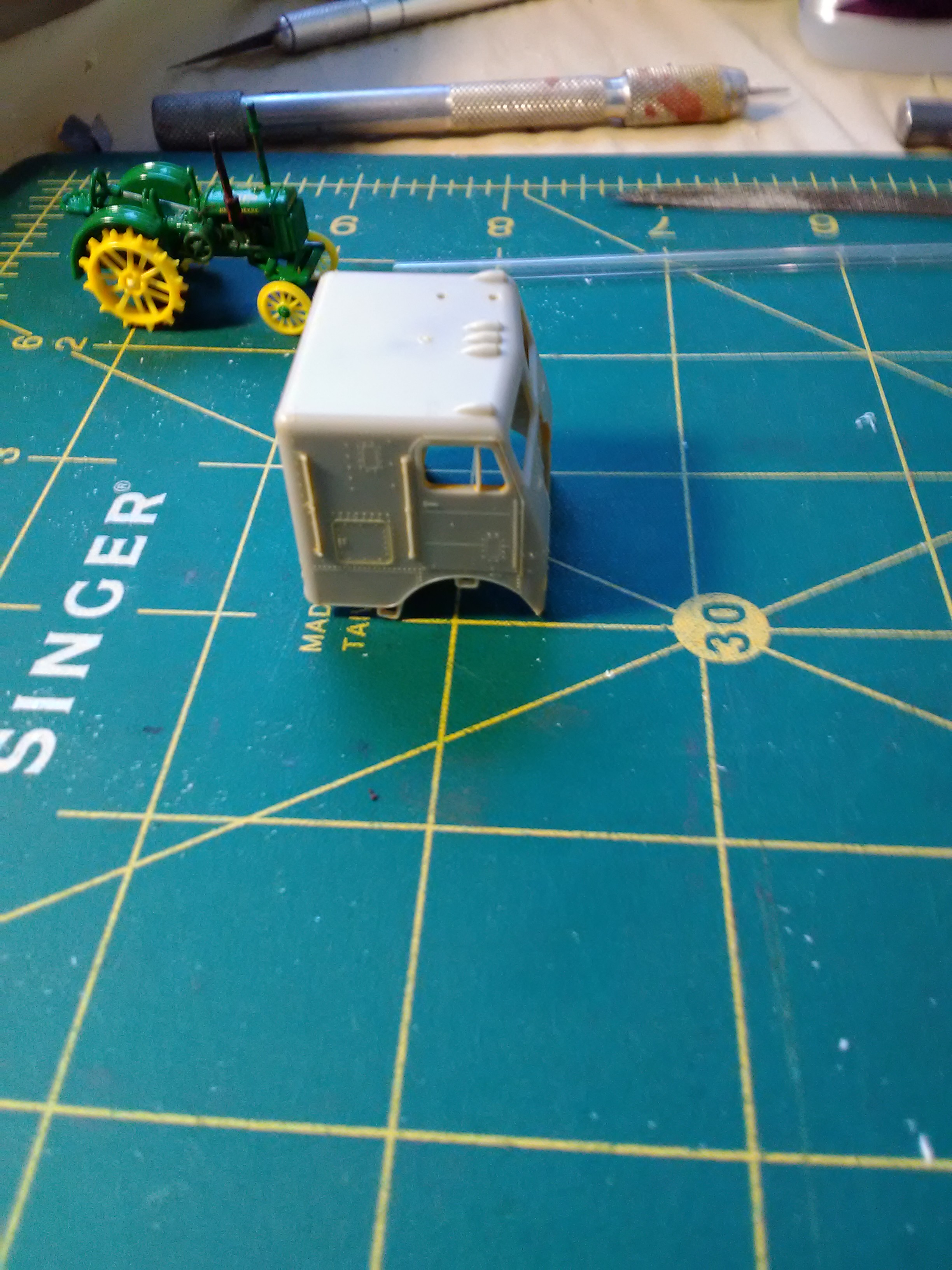

Vince66 Posted March 22, 2019 Posted March 22, 2019 (edited) This will get a mid length frame with lots of scratchbuilding going on. Even considering opening the doors and cabinets. Will be replacing the hand grabs and a bunch of other stuff to happen to this truck. Will either be pulling a 43' cow chow wagon or a 40' skateboard and 28' rollerskate not sure just yet had the paint idea picked out. So we'll see where this one ends and at least i have a one piece cab sorry gang so much easier. Edited March 22, 2019 by NothingAsFineAsaW9

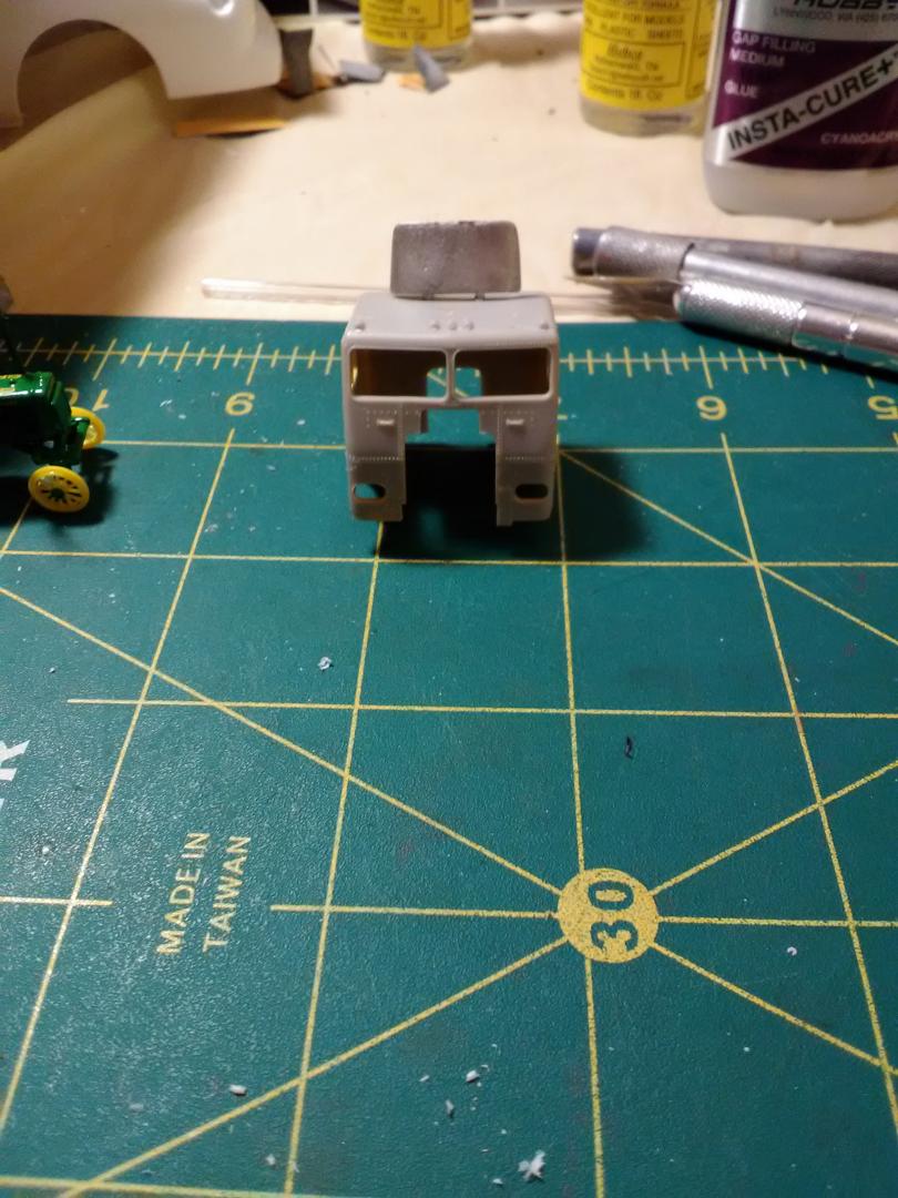

Vince66 Posted March 28, 2019 Author Posted March 28, 2019 okay hope this pic posts and excuse the blurriness of it going into doctor tomorrow for arm issues this is a base idea of where I want to go with this truck .

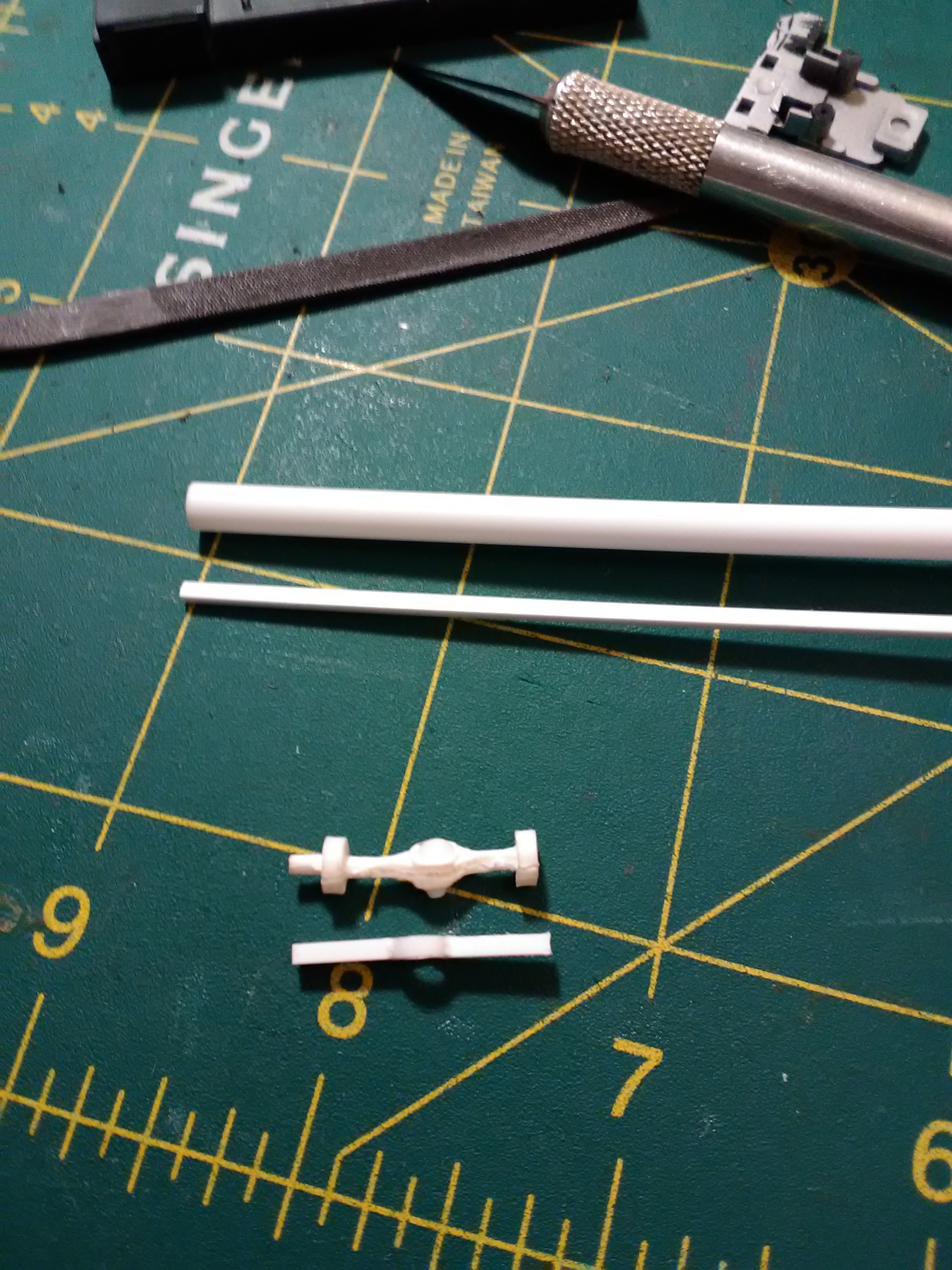

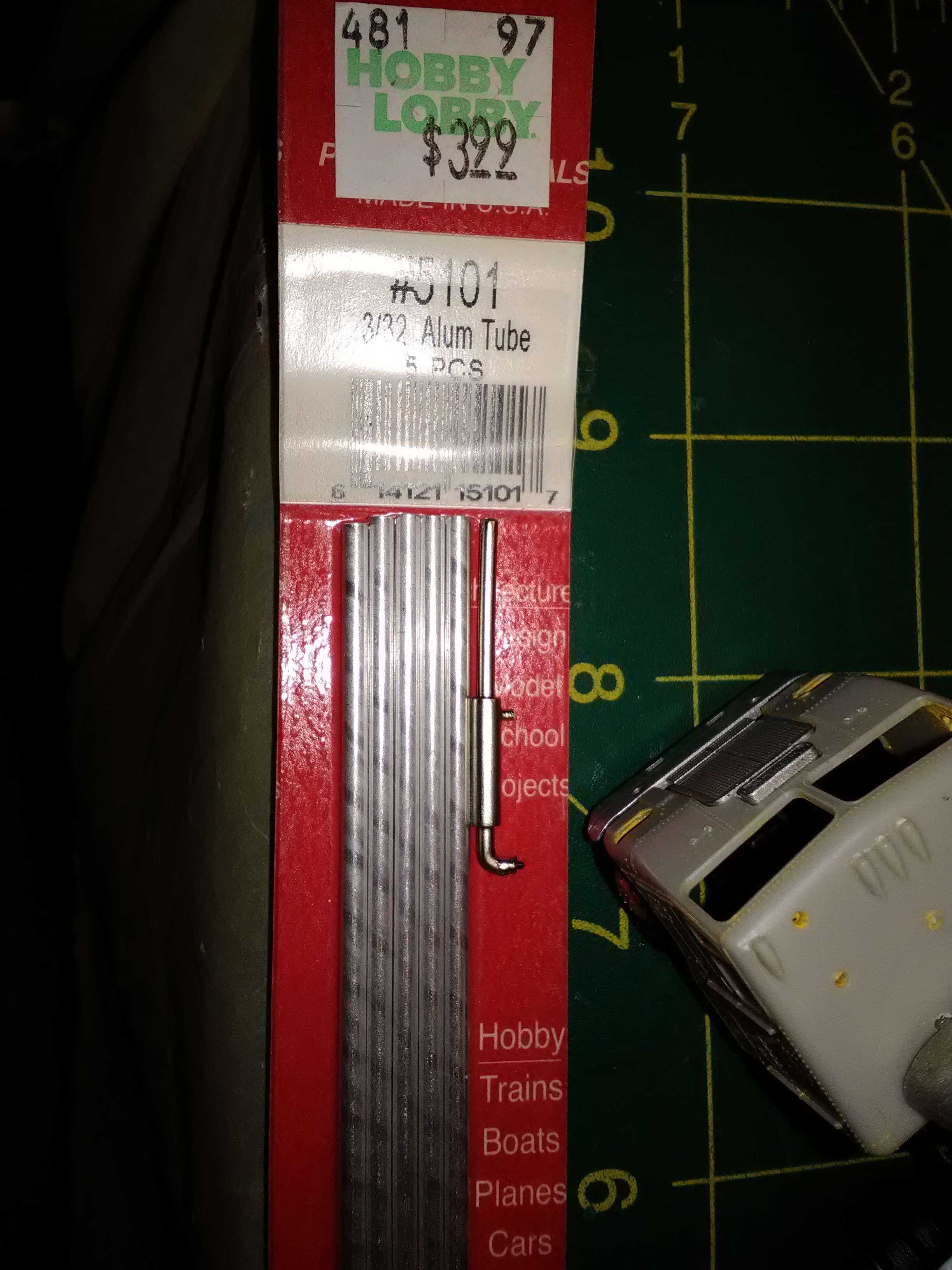

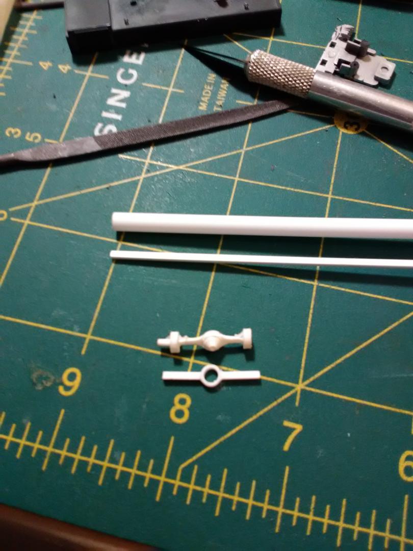

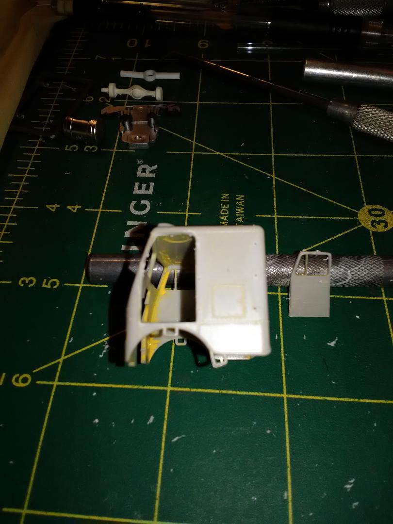

Vince66 Posted April 5, 2019 Author Posted April 5, 2019 Otay Buck wheat here's a minor update. Got a 1mm & 4mm Molotow pens did a little test on the freightliner logo and tested a spot on the bumper wow what a difference it makes. Also using an HO Sylvan scale models GMC crackerbox rear axle as a guide to making my own rears the pics are of the rear locker axle beside the sylvan part. Heck might even plumb this truck ROFLOL ?. This trucks been in the works about 3+/- years time to build it.

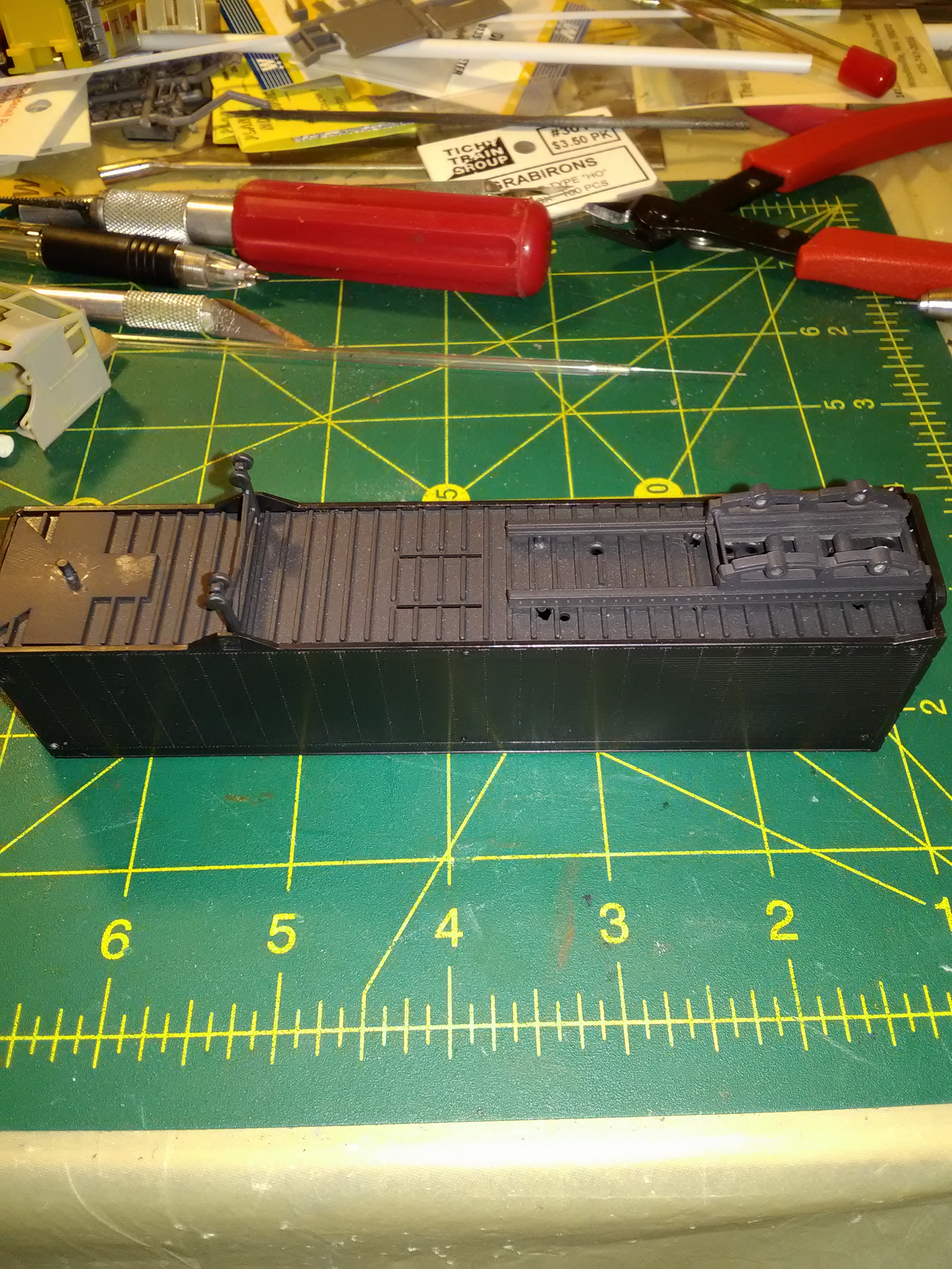

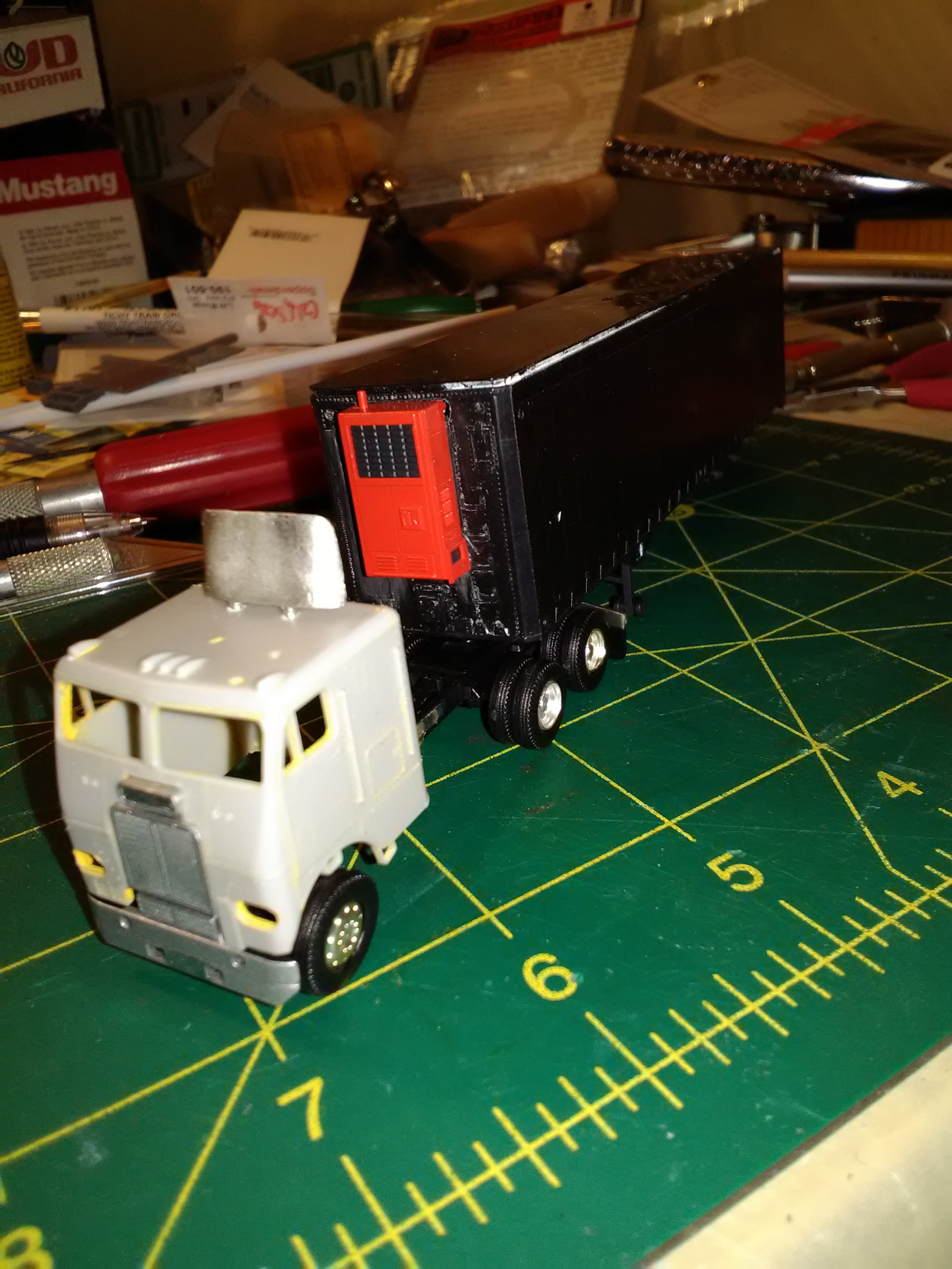

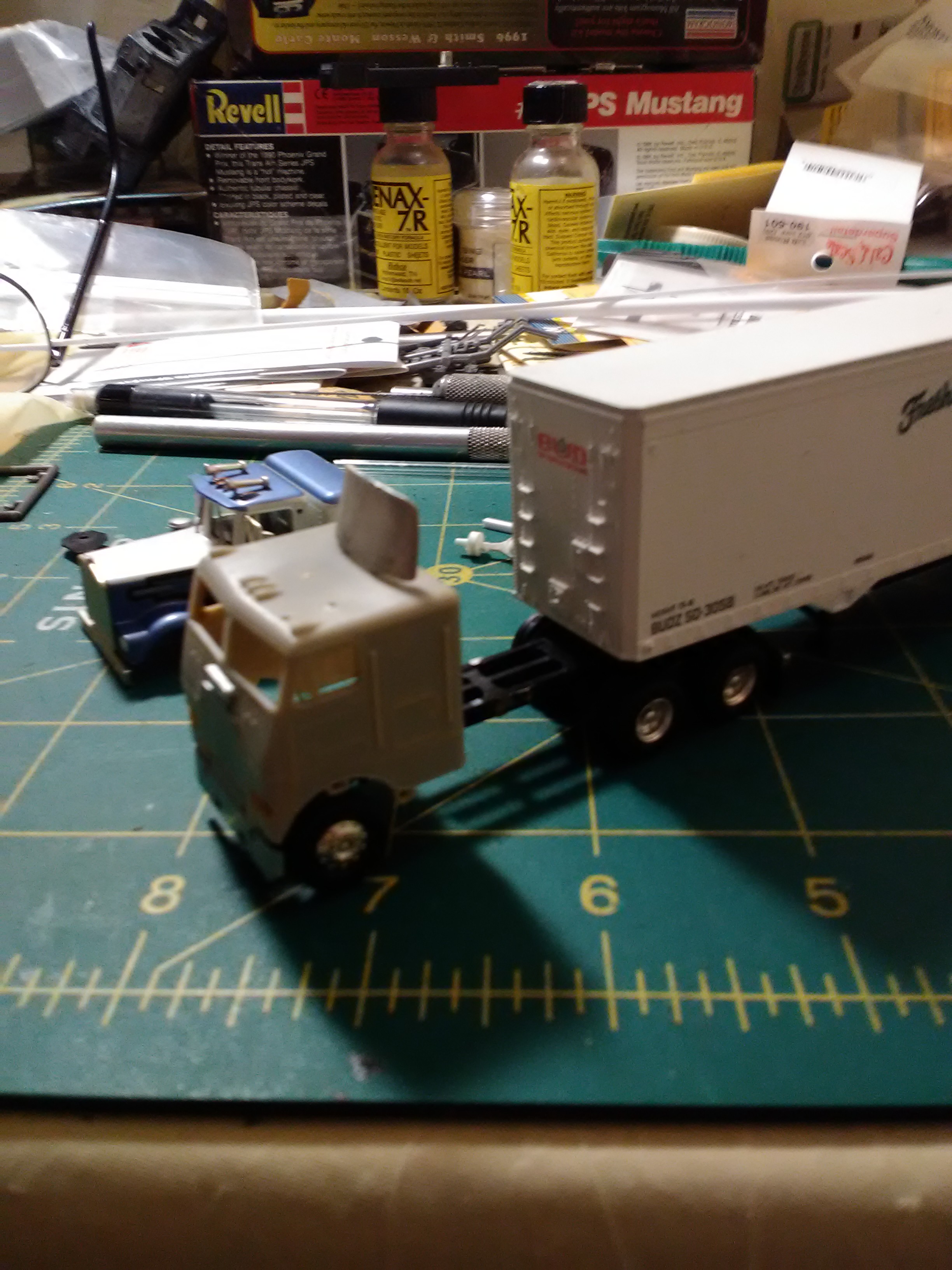

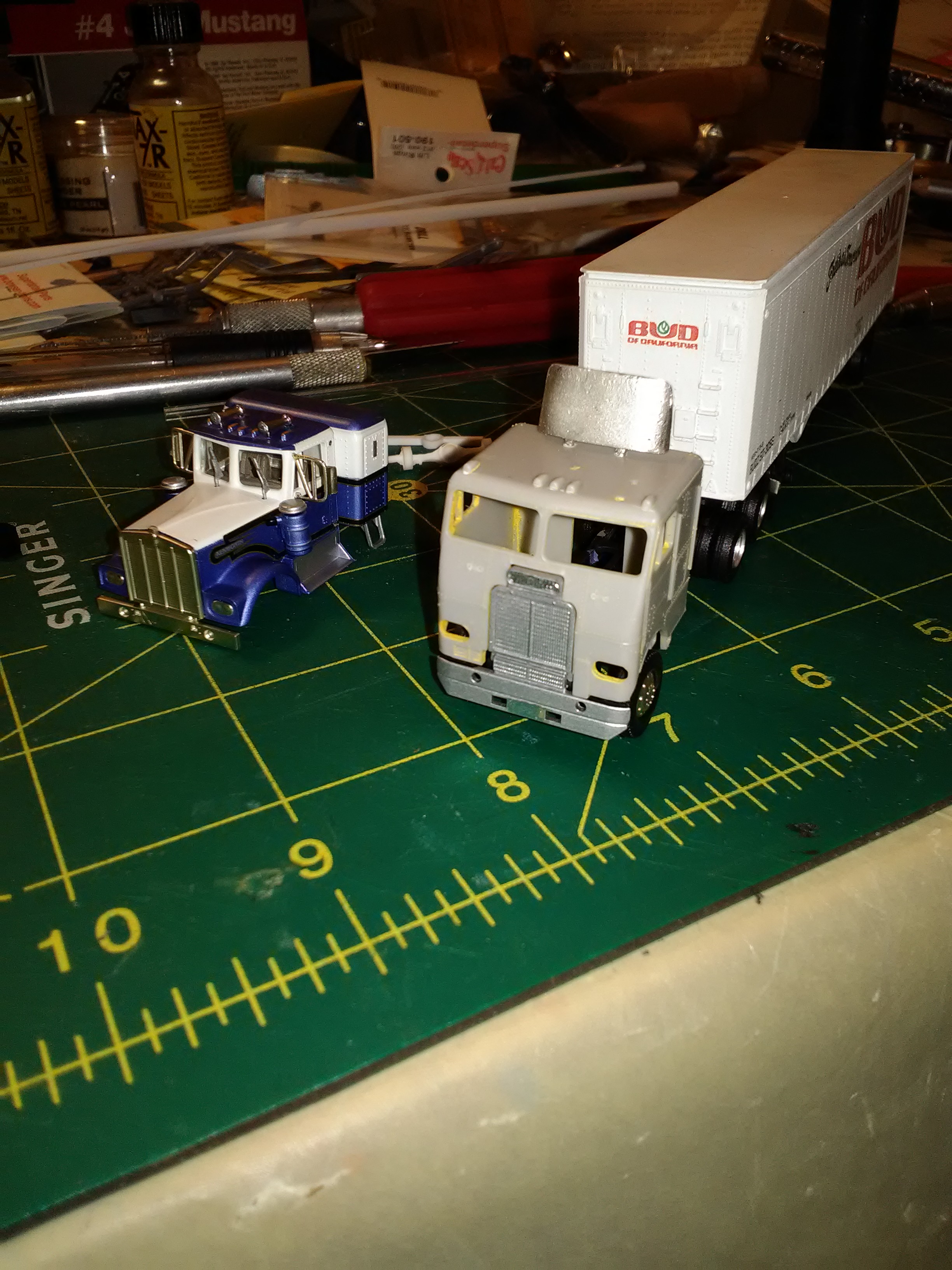

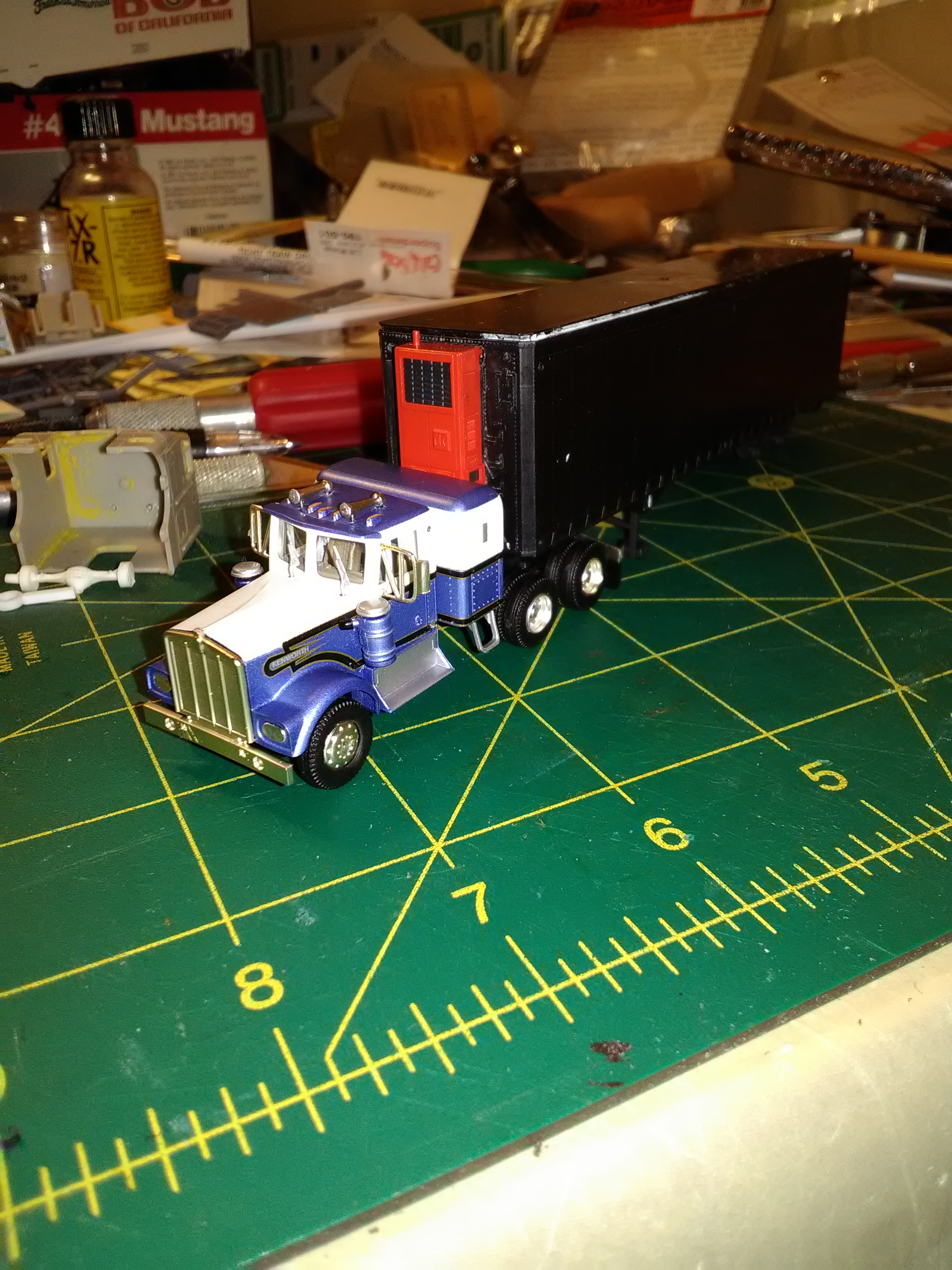

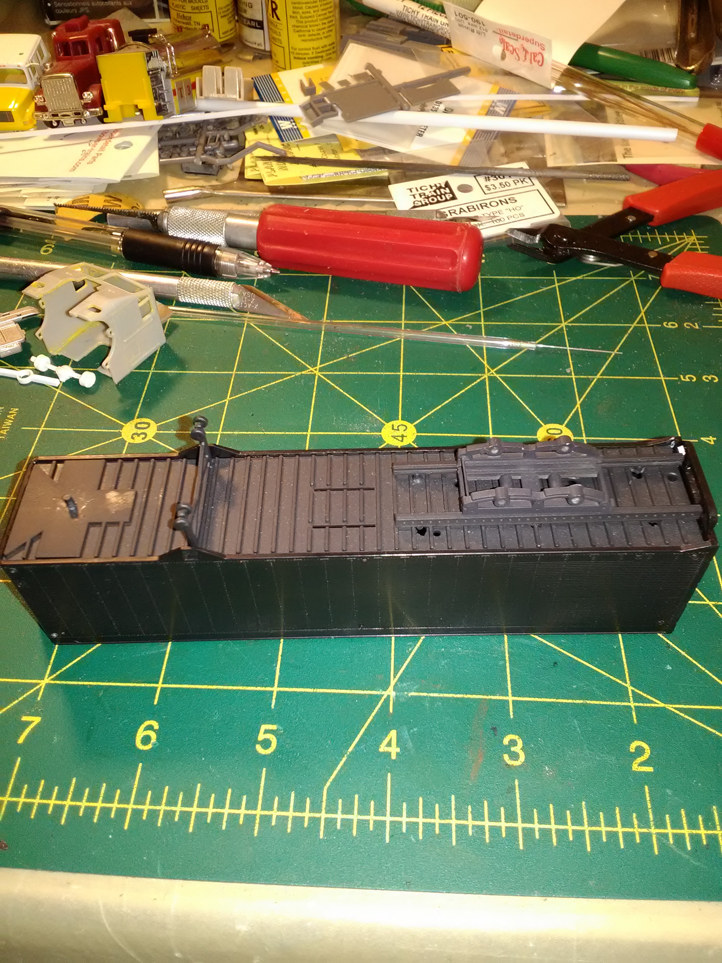

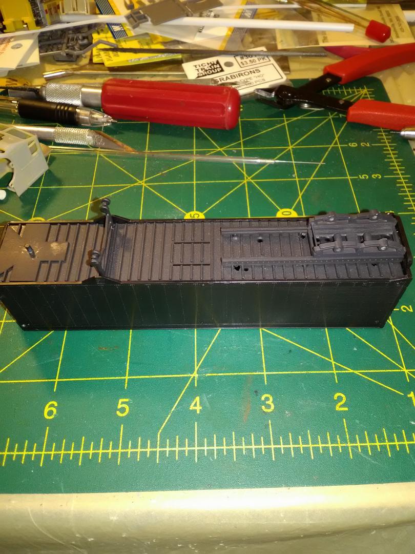

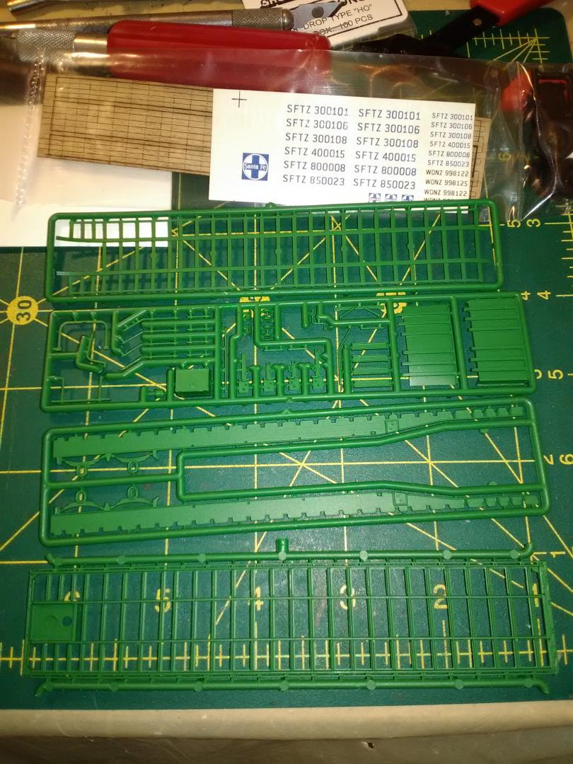

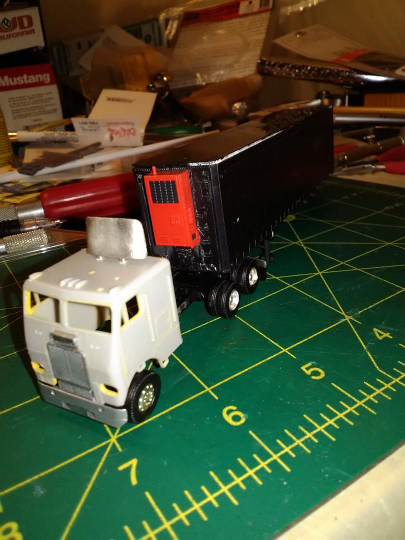

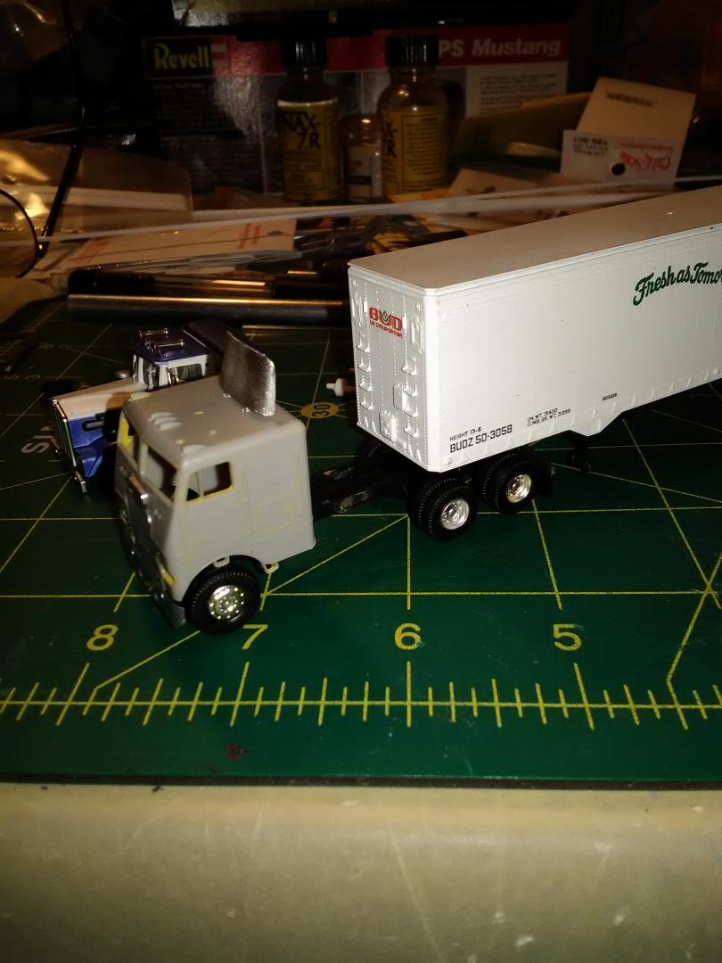

Vince66 Posted April 8, 2019 Author Posted April 8, 2019 Update as i slowly progress found my 0.010 fiber optics and my. 0402 micro smds let there be light Hehehehehe. Tested it on a longer frame kw i'm also working on along with testing a couple of trailers behind it to get a feel for where this truck is going. Thinking the kw chassis will look about right length wise for a western truck give it the look i'm after. So as soon as i find my frame material I can get started on that found most of my engine block plastic so will be able to get started on that now. Also found the tubing for my mufflers so making some progress. The black trailer i stripped the silver off took 2-months to get it to bare plastic. Added an aftermarket TK reefer unit along with a working slider for this trailer will have wobblies on it the red is tru-color CB&Q Chinese Red. The floor was painted with MM aircraft interior black have a really cool idea for this trailer. The white bud of California trailer is the stock athearn trailer. The green trailmobile 40' skateboard has a real wood deck in the kit might hook this behind it and throw a 28' rollerskate behind that with a termite load lol. The W900A might be the next truck could end up with a dry bulk doubles set like i used to drive after the freightshaker is done not sure yet as found a bunch of unfinished 2+ year old projects today.

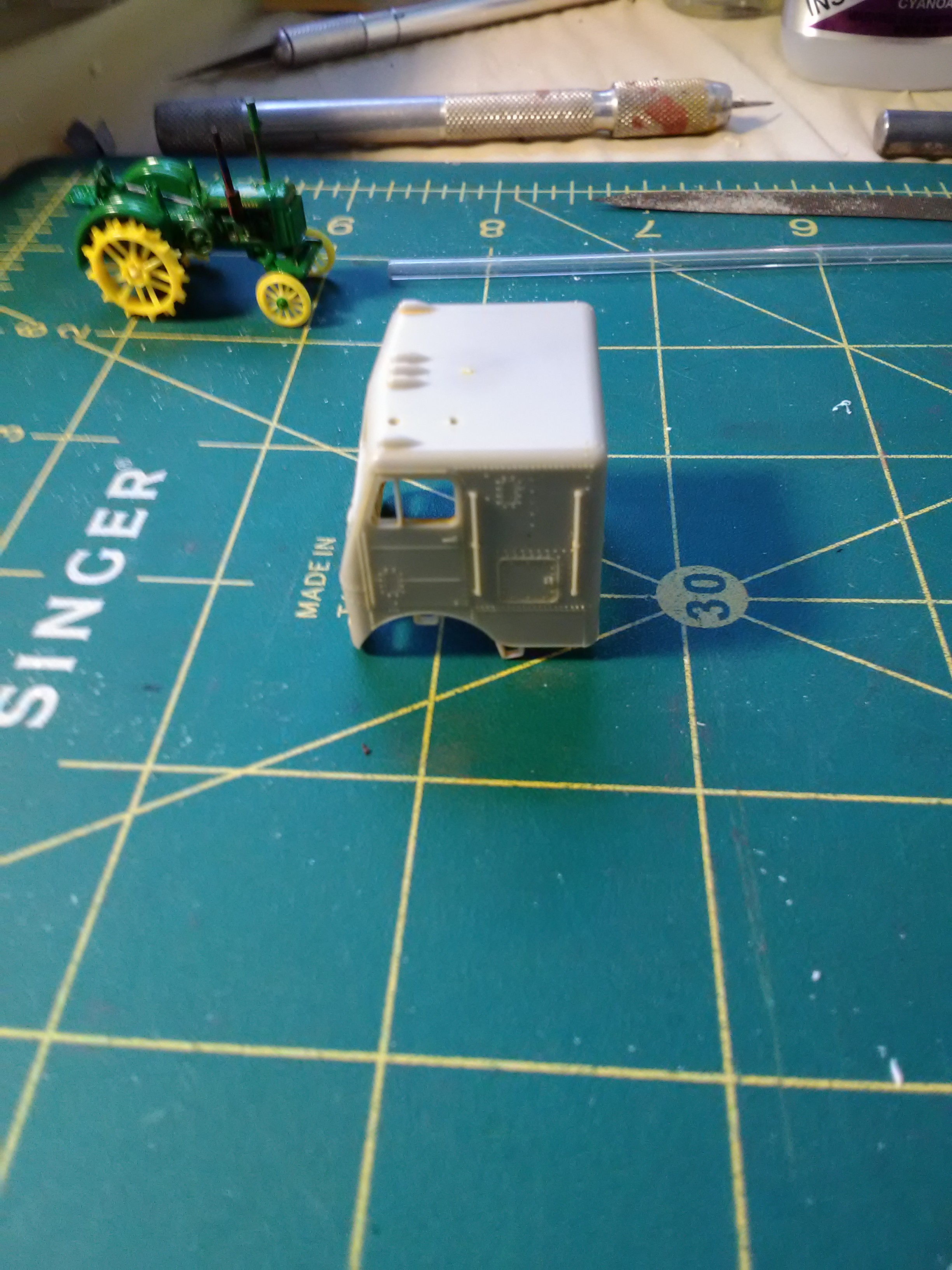

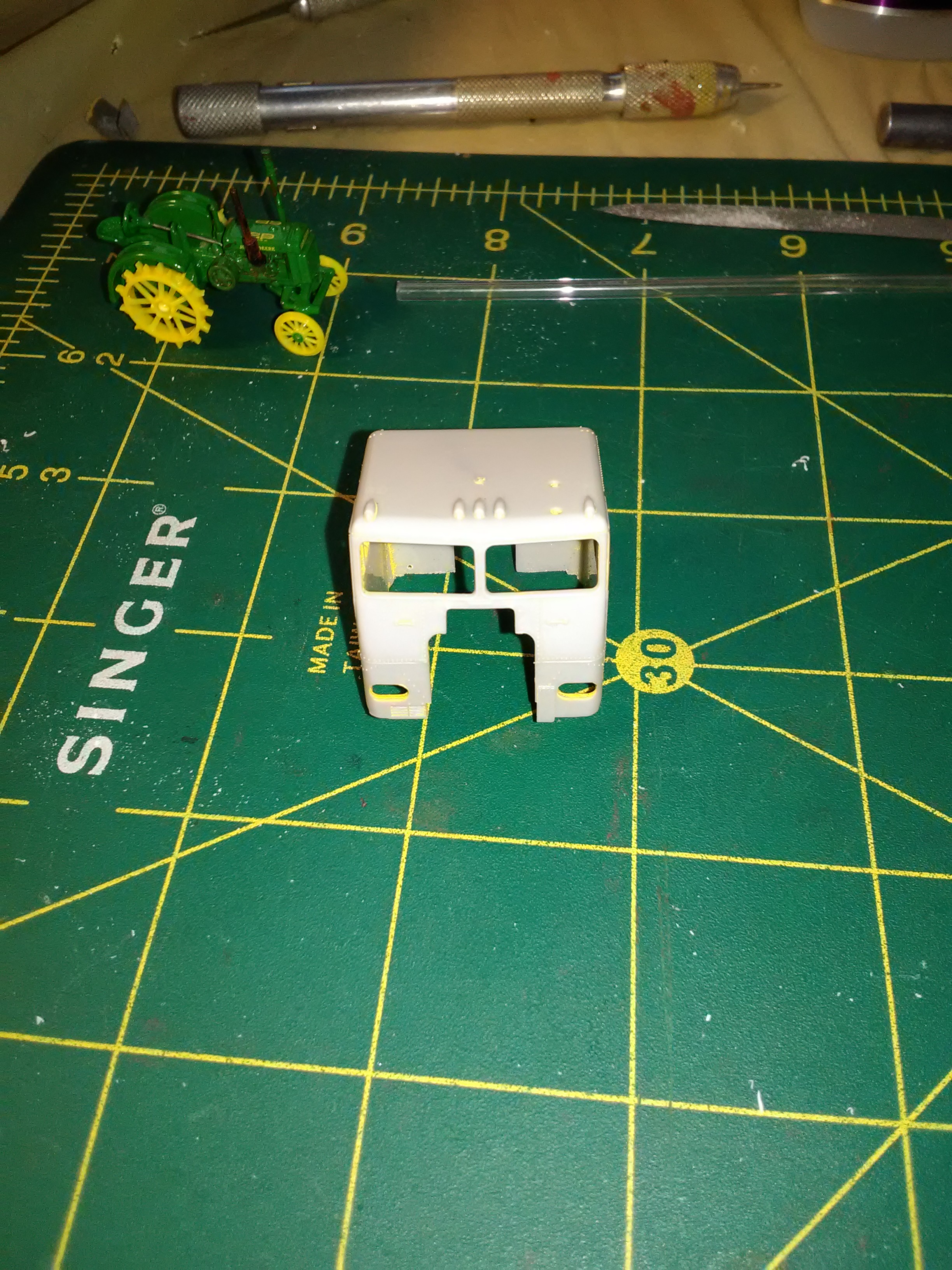

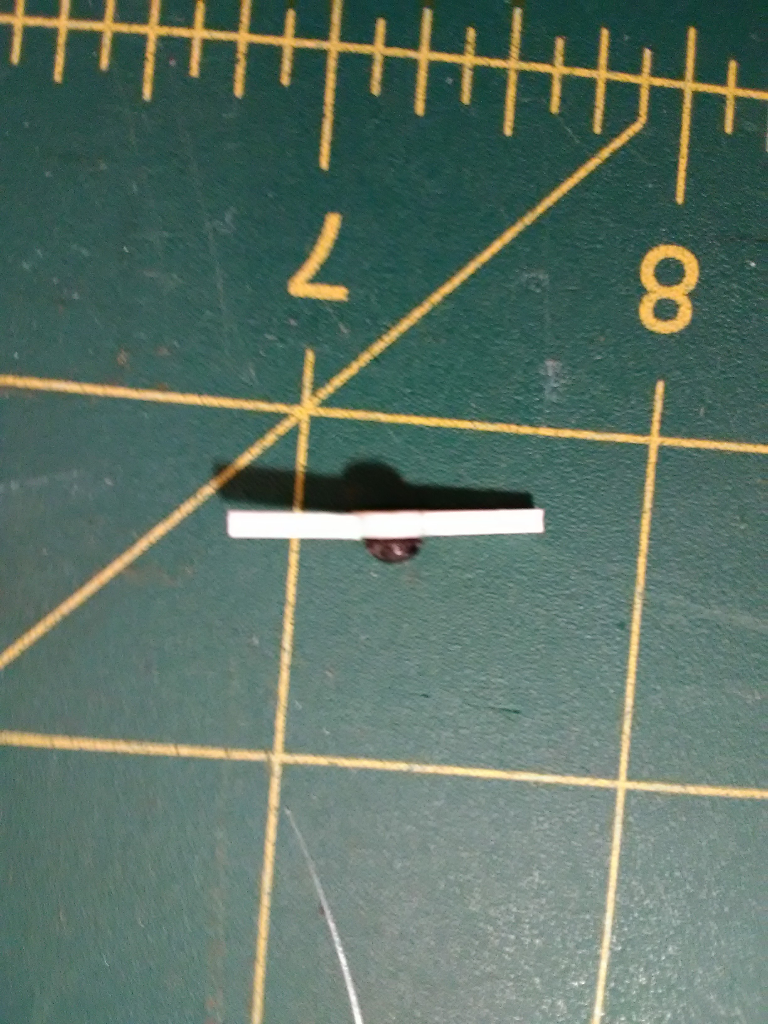

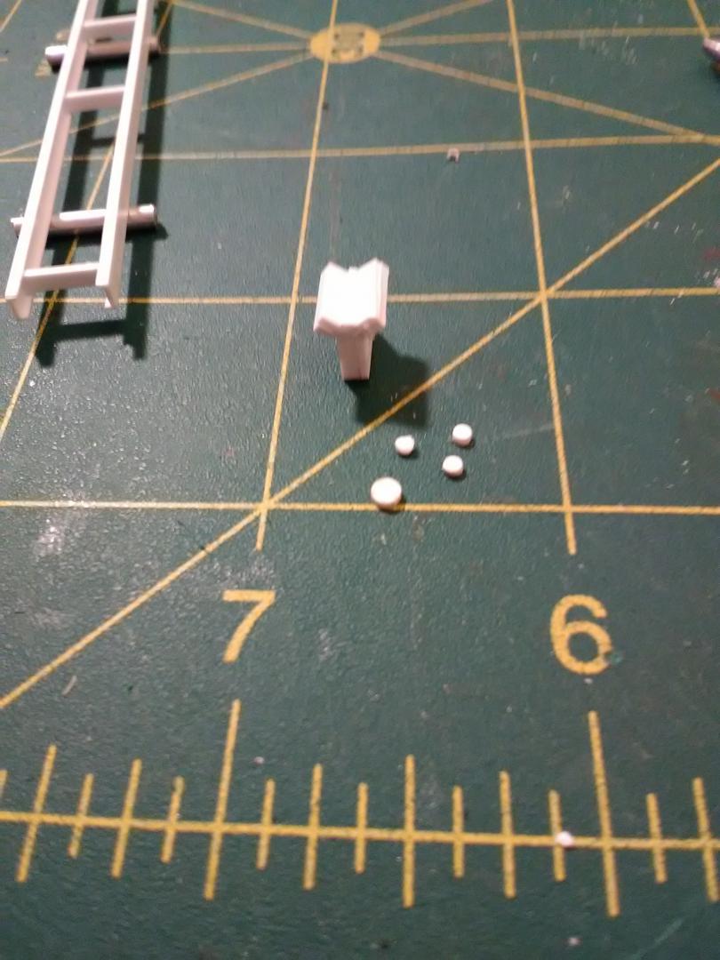

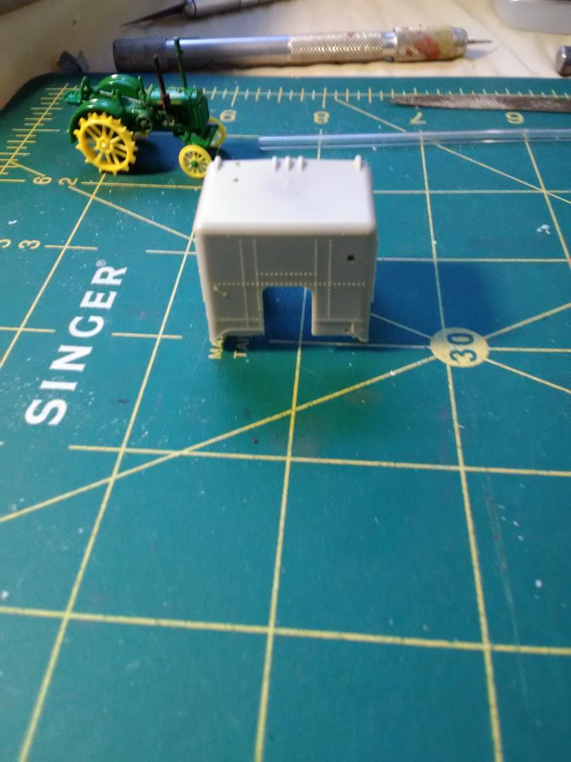

Vince66 Posted April 8, 2019 Author Posted April 8, 2019 (edited) Welp got a wild hair to see if I could do it. Success yes I know i'm crazy but that's half the fun. The door is resting against a #11 Xacto handle for comparison Enjoy. Night all headed for the DDS today for some Tooth removal Uggggggh. Edited April 8, 2019 by NothingAsFineAsaW9

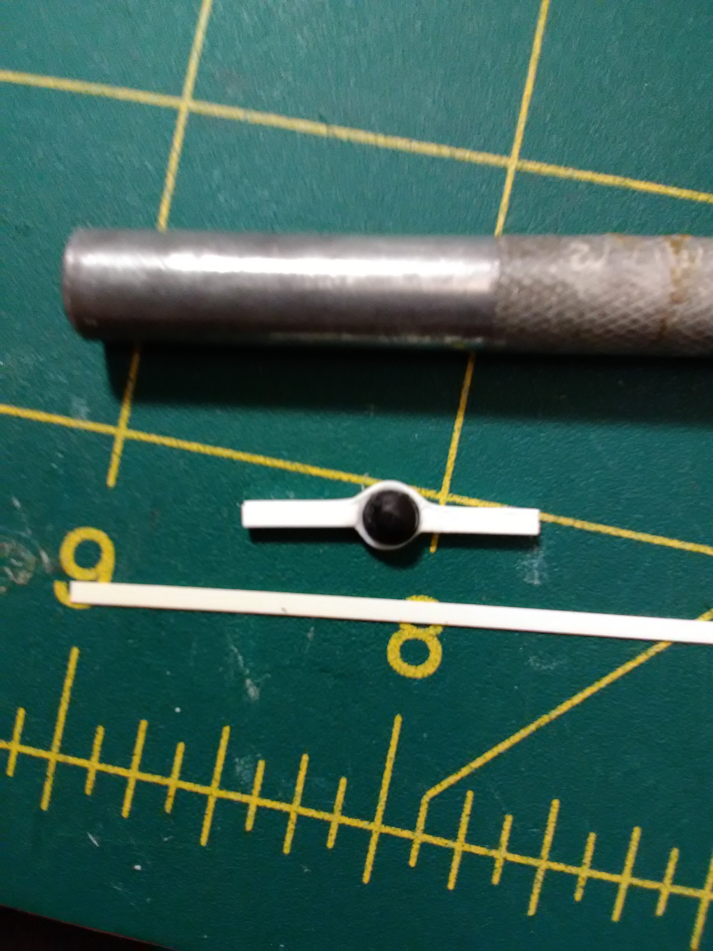

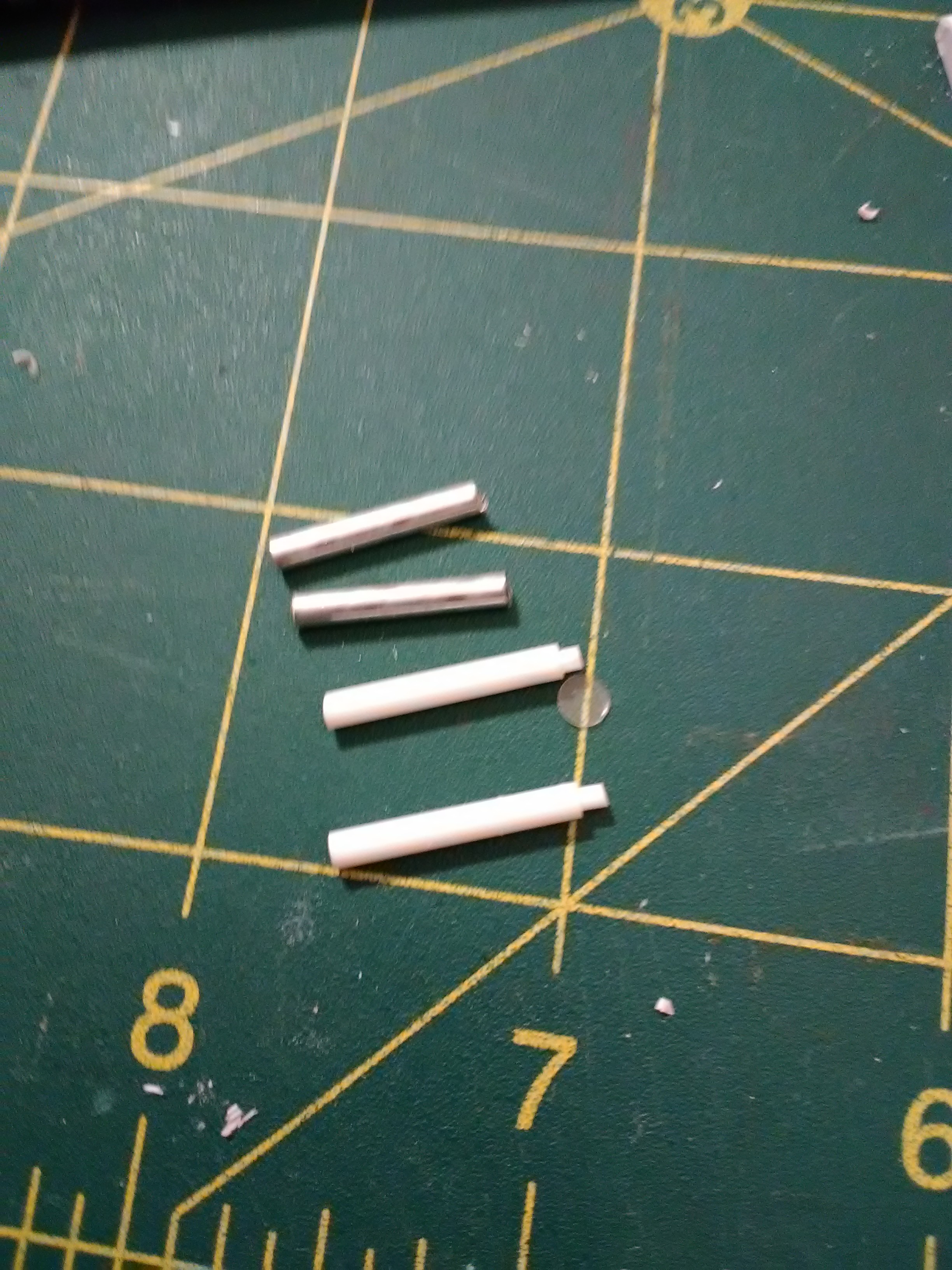

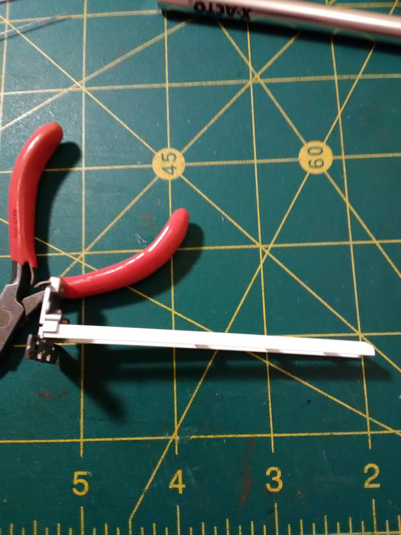

Vince66 Posted April 12, 2019 Author Posted April 12, 2019 (edited) Minor update as i'm getting a cat scan in the morning JK. Seriously though a little more work on the rear interlock axle. Went to hobby lobby found some plain black rhinestones that are about the perfect size needed for the rear housing of the axles. Super glued it to the top of a paint jar so i could sand it round instead of faceted. Added top and bottom strips of .010X.060 strip on the axle to help give it slope at the housing. It's getting there these are the hardest parts of the build once past this it's somewhat smooth sailing. Also found my frame material so i'll be able to start on that now to. To also give you a better understanding it's next to a #11 exacto handle. ? Edited April 12, 2019 by NothingAsFineAsaW9

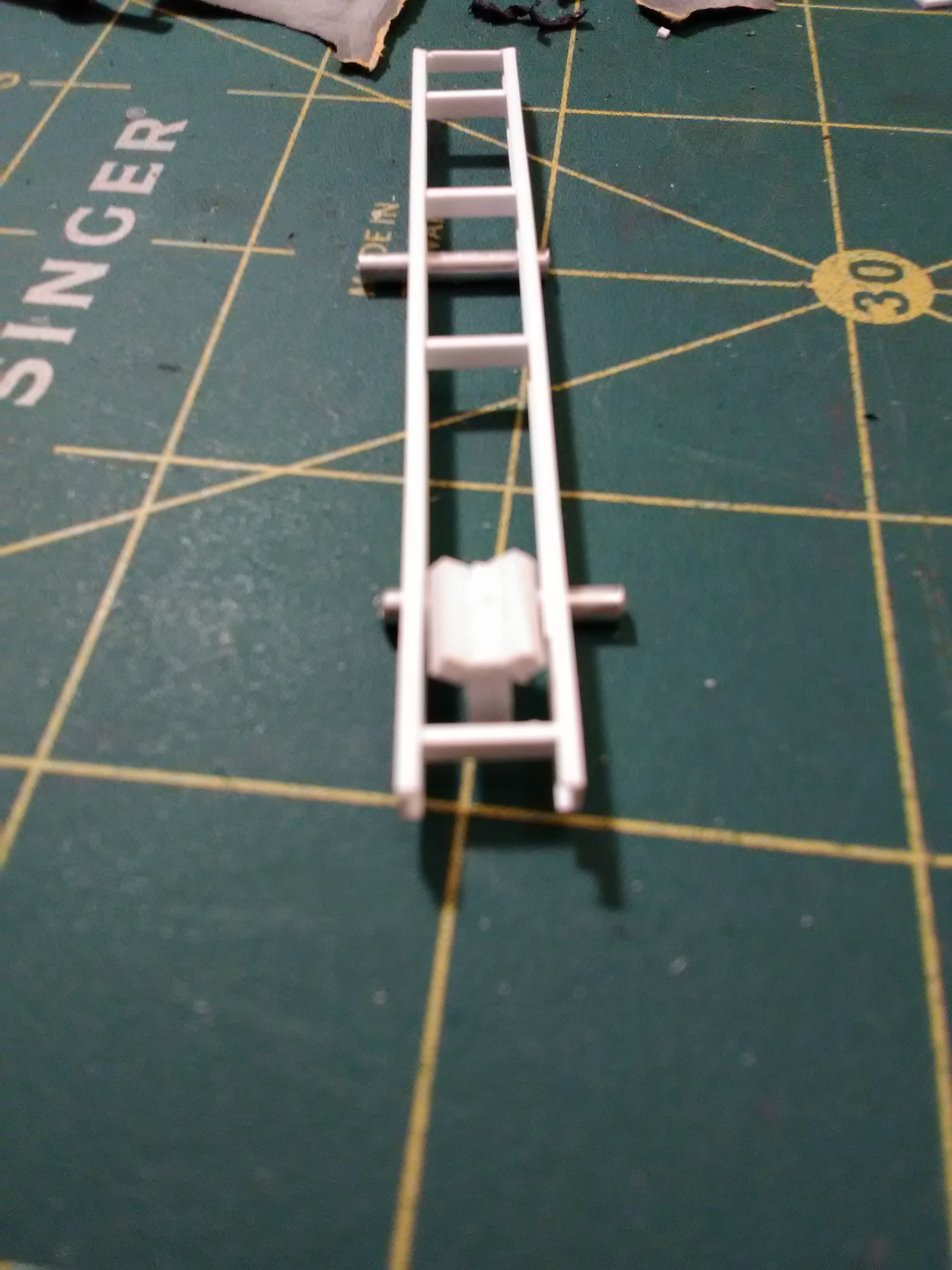

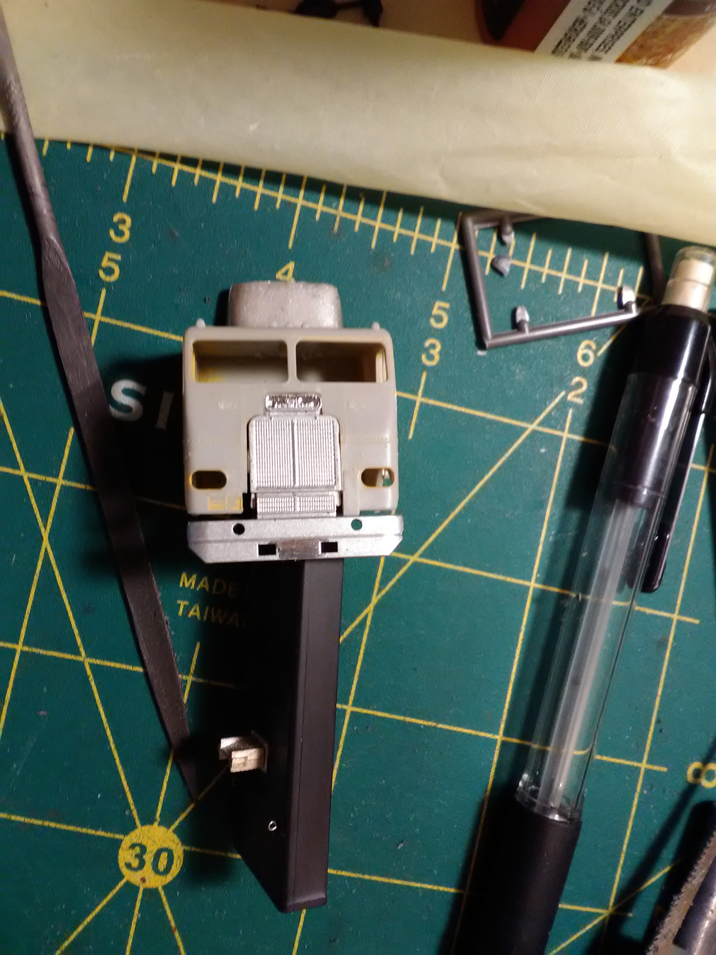

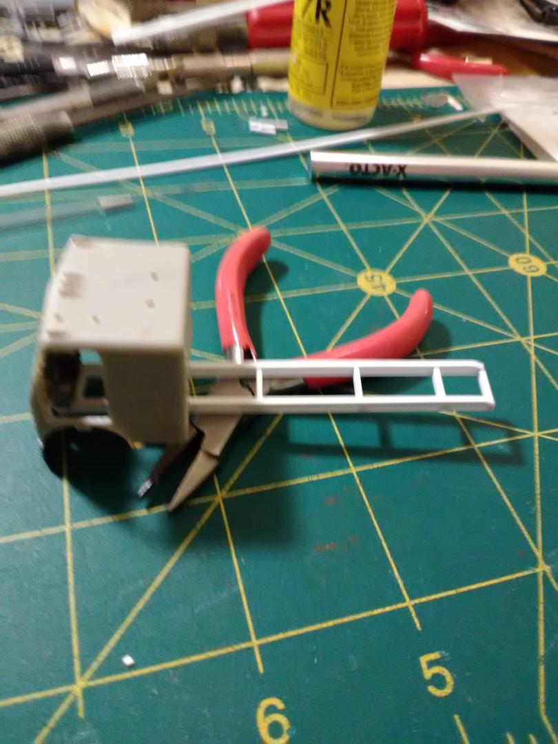

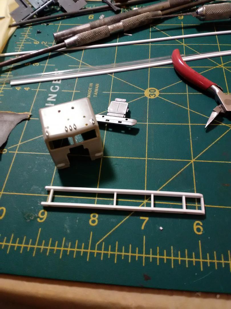

Vince66 Posted April 12, 2019 Author Posted April 12, 2019 B4 calling it a night here's a quickie frame I did for this truck. Let me know what you think good bad or ugly ? Filled in the headlight area as the stock cab is missing the raised headlight area at the corner of the cab like it should be. Enjoy as i'm getting a cat scan in the morning JK. Seriously enjoy

Vince66 Posted April 14, 2019 Author Posted April 14, 2019 Frame overall length is a whopping 3.18 inches long lol. Just a tad longer than the stock kw test frame. I'm in trouble just ordered more photo etch for this truck. Thanks BR63 it's getting there. Might end up regretting titling this truck not sure yet lol. Next one is going to be a surprise already have it figured out.

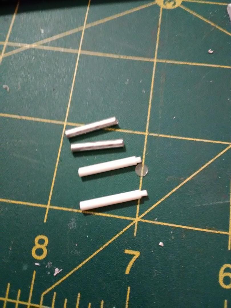

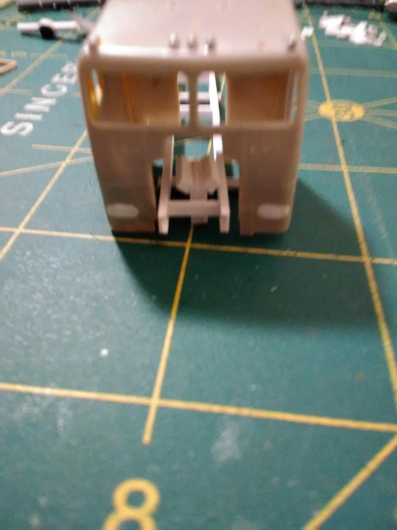

Vince66 Posted April 14, 2019 Author Posted April 14, 2019 (edited) Here's some test pics of the engine in progress along with some pullies. 2 test shots in the frame without & with cab. Also started the mufflers & air cleaners Edited April 14, 2019 by NothingAsFineAsaW9
