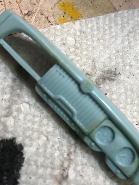

ShawnS Posted May 13, 2019 Posted May 13, 2019 While some dashboards are easier than others to convert there is no single easy method to do the conversion, scratchbuilding skills are a must. The last dash that I converted to RHD was for a Beemax Volvo. I made 4 resin copies of the kit LHD dash then I cut them up into sections and re-assembled them into one unit. Because of the amount of cutting required there was no way that I could have done it with just the original kit dash. It took a bit of problem solving and two weeks to do and it came out great in the end. I had also previously used a similar method to do a RHD Sierra dash but I didn't need to make resin copies as I had a few spare LHD dashes to work with. Here is the Volvo dash. What kind of dashboards were you wanting to convert? Cheers ShawnS

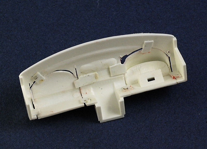

Foxer Posted May 13, 2019 Posted May 13, 2019 Many modern dashboards do convert well. I did a couple by just cutting out each side the same amount and puttying them back in. This was a right to left hand drive

DaveP Posted May 19, 2019 Author Posted May 19, 2019 On 5/13/2019 at 9:07 AM, ShawnS said: While some dashboards are easier than others to convert there is no single easy method to do the conversion, scratchbuilding skills are a must. The last dash that I converted to RHD was for a Beemax Volvo. I made 4 resin copies of the kit LHD dash then I cut them up into sections and re-assembled them into one unit. Because of the amount of cutting required there was no way that I could have done it with just the original kit dash. It took a bit of problem solving and two weeks to do and it came out great in the end. I had also previously used a similar method to do a RHD Sierra dash but I didn't need to make resin copies as I had a few spare LHD dashes to work with. Here is the Volvo dash. What kind of dashboards were you wanting to convert? Cheers ShawnS Expand 53 and 56 AMT Ford pickups
DaveP Posted May 19, 2019 Author Posted May 19, 2019 Thanks to all above, especially with pictures. Foxer your fine cutting skills are impressive. I've ordered some mould making silicon putty that I'm hoping I can make a mould with to make resin copies that I can use like Foxer and ShawnS have done. I dunno about 3D stuff. Dave
