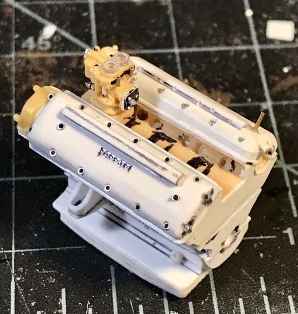

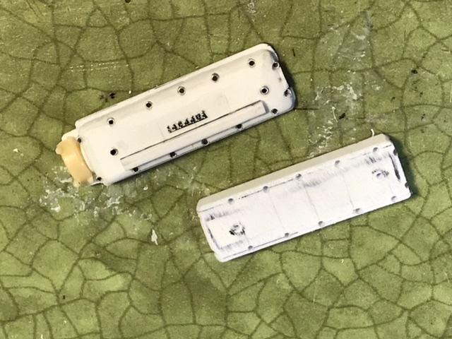

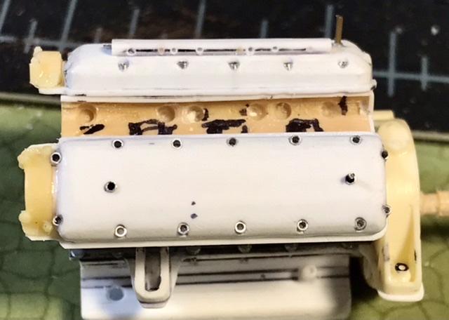

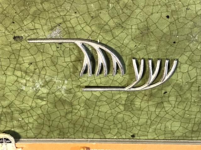

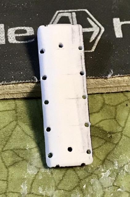

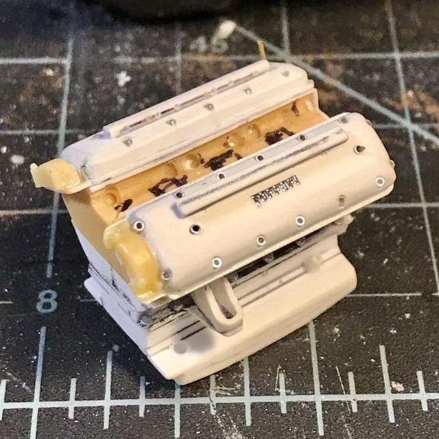

absmiami Posted December 11, 2021 Author Posted December 11, 2021 On the left hand valve cover marking and drilling …

Mattilacken Posted December 12, 2021 Posted December 12, 2021 (edited) Can’t wait for primer on that engine! Looks beautiful! Edited December 12, 2021 by Mattilacken

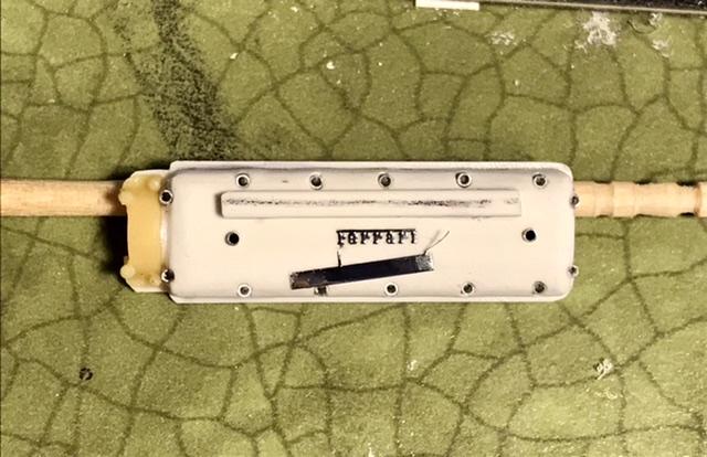

absmiami Posted December 13, 2021 Author Posted December 13, 2021 Thanks - may not paint these yet - hoping to have them cast first …. Got the badge and wire loom onto the left hand valve cover … there is very little depth to the letters on the surface of the valve cover- but if I can get the parts cast - I think I can apply another badge on top to make “taller” letters ??

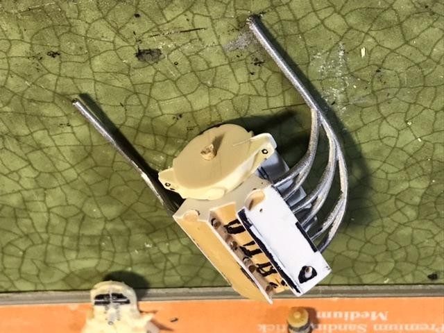

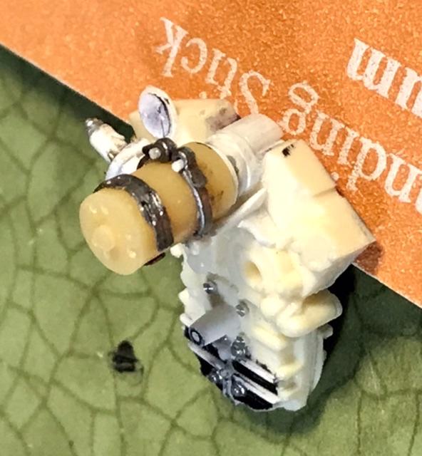

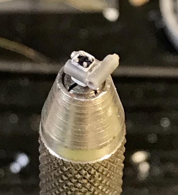

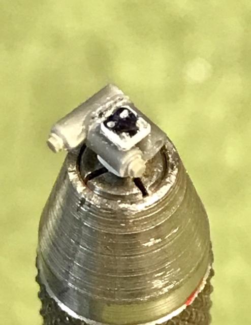

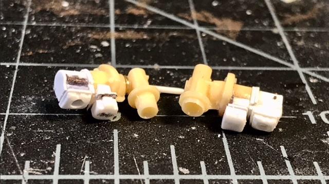

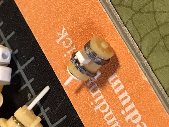

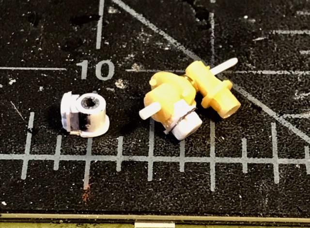

absmiami Posted December 18, 2021 Author Posted December 18, 2021 Working on the second magneto - the white parts are replacements/changes to the Reps and Mins GTO engine casting - and I cut the second one apart - because the magnetos are on offset posts - so there’s a right and left hand magneto - hard to explain …

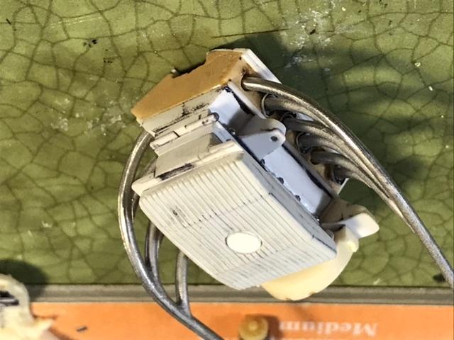

absmiami Posted December 18, 2021 Author Posted December 18, 2021 Just about done - but I’ll machine an aluminum ring that the plug wires will feed into …. That will be a challenge - as it will require cleaning up the other side of my workshop - huge challenge …

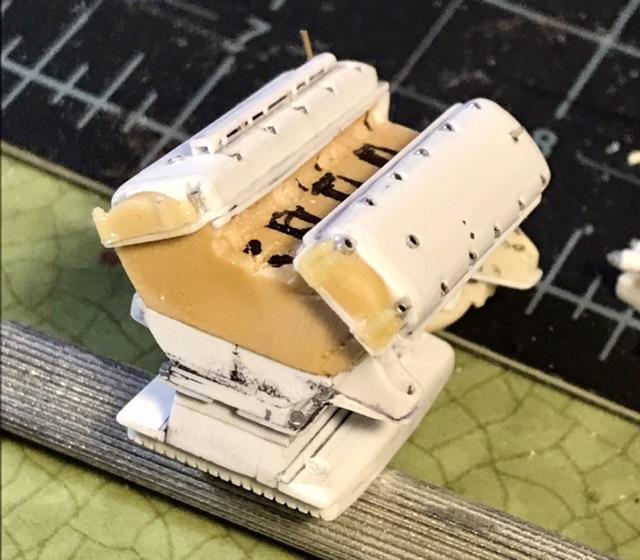

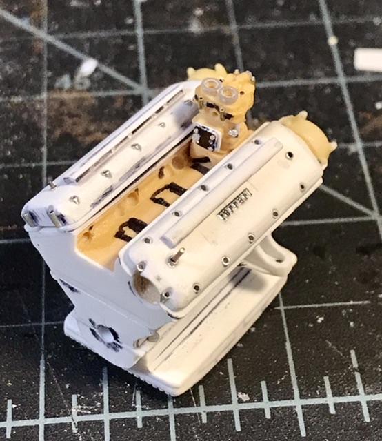

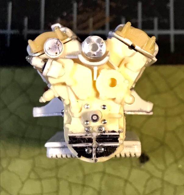

absmiami Posted December 18, 2021 Author Posted December 18, 2021 The early Colombo 12s mostly used mounts at the back of the cyl head - that’s what these two holes are for …

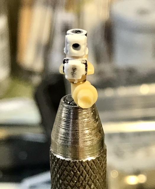

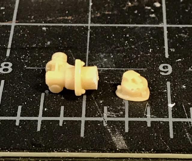

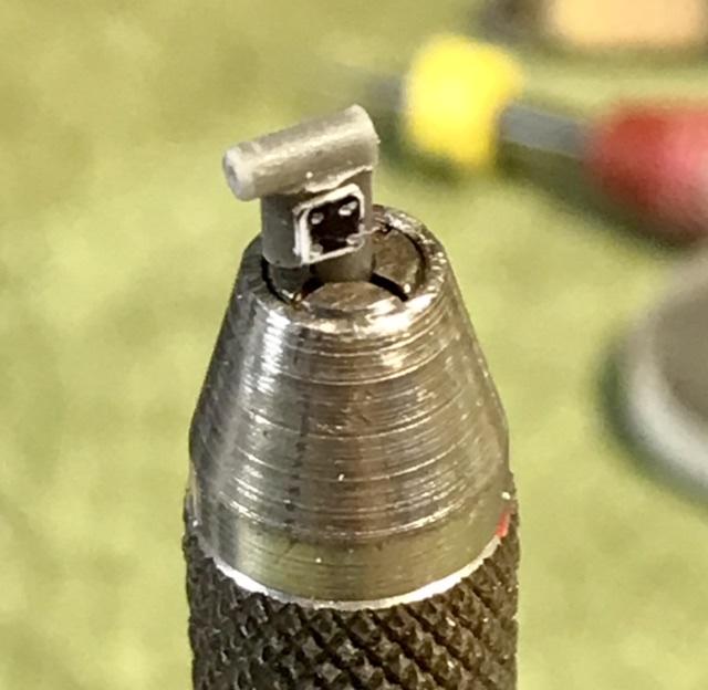

absmiami Posted December 24, 2021 Author Posted December 24, 2021 Fuel pump. Styrene rod and some Evergreen and some .015 RB Motion bolts. And some Master Club resin bolts…. Will be attached to the nose of the left hand Cyl head …

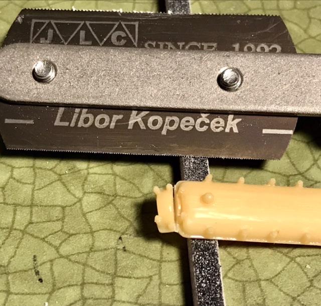

absmiami Posted December 24, 2021 Author Posted December 24, 2021 I think I mentioned this - the UMI Barchetta kit had a bag of white metal castings done by Herb Deeks - the exhausts were cleaned up and shaped for casting - this will be tricky - the rubber mold casting may effect the shape - but it’s worth a shot …
absmiami Posted December 24, 2021 Author Posted December 24, 2021 The alternator is based on the Reps and Mins GTO casting - Shortened a bit and garnished with some straps and things - the straps are made from some squashed tin wire - rolled around short lengths of .015 Plastic rod ..
absmiami Posted December 24, 2021 Author Posted December 24, 2021 Now for the “casting call”. Hopefully have some resin castings later in the spring …. Meantime, let’s see …

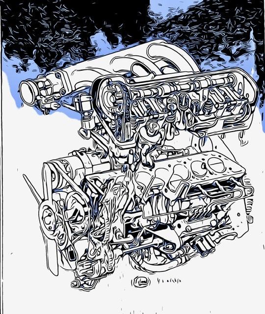

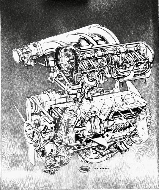

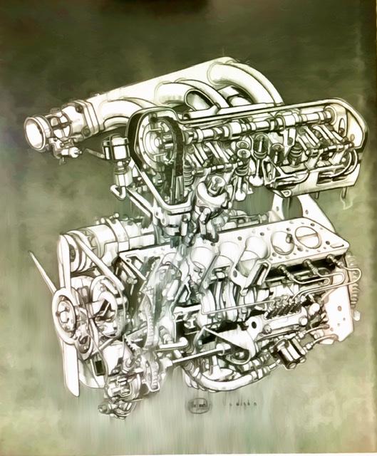

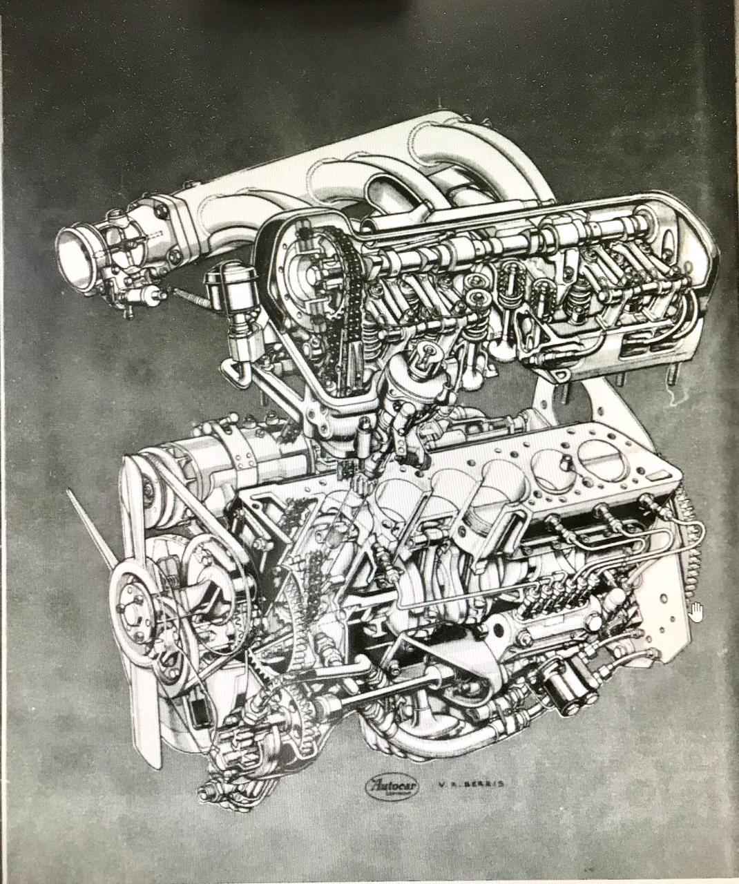

absmiami Posted September 30, 2022 Author Posted September 30, 2022 whilst the Ferrari engine is marinating - always great to find an obscure engine cutaway drawing, right ?? ...
absmiami Posted September 30, 2022 Author Posted September 30, 2022 Back in the day - Sports Car Illustrated was known for featuring some great cutaway illustrations - this one - first done for Autocar (british pub) was by Victor Berris - I’ve seen many of his cutaways - but this is a new one to me …. Its the Mercedes 300SL engine …
absmiami Posted September 30, 2022 Author Posted September 30, 2022 Edited with the Becassa phone app …. Cool. Now. Did Berris do the W196 engine for Autocar ?!
