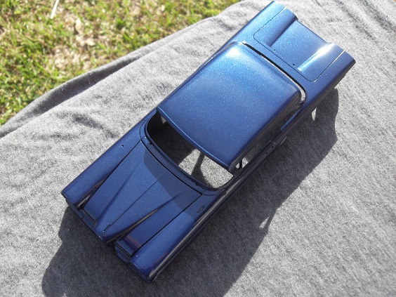

DDD Posted July 7, 2019 Posted July 7, 2019 Before I go any further, I wet sanded ( above the door handle) and there is still a little white texture and afraid to keep sanding as you see I already cut thru the paint So I need to repair that any thoughts? the top of the car (pic )do I sand it smooth ( without any shinny spots) all with the 1st grit and then continue on with the different grits after it's smooth or start with the 1st grit and continue on thru the grits until it's smooth? after the paint repair job of the cutting thru should I shoot another coat of clear on the whole body? then re-sand? or what? Thanks again for all the help.

Claude Thibodeau Posted July 8, 2019 Posted July 8, 2019 Hi Doug! Since you sanded trough the color coat, you will have to shoot some color coat again. Close pictures show rather severe orange peel on the top and on the upper edge of doors. Therefore, you may want to sand the whole car, wet, with, say, 600 grit paper. It should get rid of most peel, but don't forget to sand down your bubble "strings" along the rain gutter, or it will keep showing through any color coat you may apply later... A sanding cushion pad would help you avoid sanding streaks. Since your blue is acrylic, a well sanded WetLook clear (lacquer) should accept it without any chemical reaction, or "wrinkling", as you might get stacking on additionnal lacquer, for example. After your new complete blue base coat is on, let it dry for a few hours, and inspect for any remnant of bubbles in problematic sections of the current paint job. If any remain, wet sand again with 600 grit, and go with a final color coat that should then flow well and bury any remnants of your current "problem". Then, after a couple of days of thorough drying, time for the WLClear again. Only this time, put all chances on your side, and warm a new can of WLC in very hot water for 90 secs. before shooting. The paint will flow more evenly, and get you a proper gloss WITHOUT having to put heavy coats on it. Since you are in so-Cal, and it's hot summer time, I suggest a few light mist coats, 5 or 6 minutes apart, and then a third HEAVIER final coat. Then, a week to gas out and cure, during which some of your gloss will seem to vanish... Typical solvent evaporation, normal process. You may then wet sand your clear coats perfectly smooth, with a succession on 2000, 3000 (3000 3M pads are avail in auto stores). Tamya even offers finer grades of sanding medium, if you feel like it. Some electronics stores sell abrasive films, so fine you can resurface CD's or DVD's with them! Follow with polishing compound, and Meguiar's swirl remover (by hand) at the end. Only downside of this "re-coat" solution is you may loose some definition of caracter lines in some sections of the car: roof gutter molding, windshield moldings, etc. Foiling it later will be a litle more tricky, but as they say, countless hours of fun with styrene!!! Good luck, and keep us posted on your operation. Regards, CT
Snake45 Posted July 8, 2019 Posted July 8, 2019 On 7/8/2019 at 1:53 AM, Claude Thibodeau said: Therefore, you may want to sand the whole car, wet, with, say, 600 grit paper. It should get rid of most peel, but don't forget to sand down your bubble "strings" along the rain gutter, or it will keep showing through any color coat you may apply later... After your new complete blue base coat is on, [etc etc etc]... Only downside of this "re-coat" solution is you may loose some definition of caracter lines in some sections of the car: roof gutter molding, windshield moldings, etc. Foiling it later will be a litle more tricky, but as they say, countless hours of fun with styrene!!! Expand One other downside of this plan is that you will have several hours of careful and tedious work in it. Claude's plan will work just fine, but IMHO you'd be WAY ahead to just drop the thing in a tub with $1 worth of rubbing alcohol for a couple hours (maybe as much as 24, maybe much quicker than that) and strip it back to bare plastic and start over. And if I might offer one other piece of advice: Apparently you don't have any problems (health, environmental, moral, etc.) with using the Testor WLC lacquer (neither do I), so why mess around with that acrylic that's giving you such problems? Get a can of Model Master Nassau Blue lacquer, which is very close to the color you're using (and metallic to boot) and sprays magnificently. Lay on one or two coats of that, then two or three coats of the WLC, and I think you'll have a MUCH easier time getting a great polished out finish. Just sayin'....
DDD Posted July 8, 2019 Author Posted July 8, 2019 Thanks Claude and Snake for your help and great advice. I don't want to sand it because this is the 2nd time stripping this model down. I'm going to soak it in 91% Isopropyl alcohol and strip it and start over!! Kinda want to stay away from rattle cans because I really want to get good at airbrushing. I might try different brand of lacquer paints or maybe enamels, not really sure yet but I'll figure something out. Like every one says you just have to find out what paints to use that works for me and practice makes perfect and I sure need a lot of practice. I really appreciate the time you guys take to help out other modelers like myself. Thanks again

DiscoRover007 Posted July 8, 2019 Posted July 8, 2019 I've had the same reaction with WLC before. It has nothing to do with your acrylic base coat. The bubbles happen when you spray too close or spray too much clear at one time. It causes it to pool and bubble up. Just use lighter coats and you should be fine. I would recommend a switch to lacquer for the basecoat though just to have a tougher finish. Duplicolor paints have their own issues also though.
