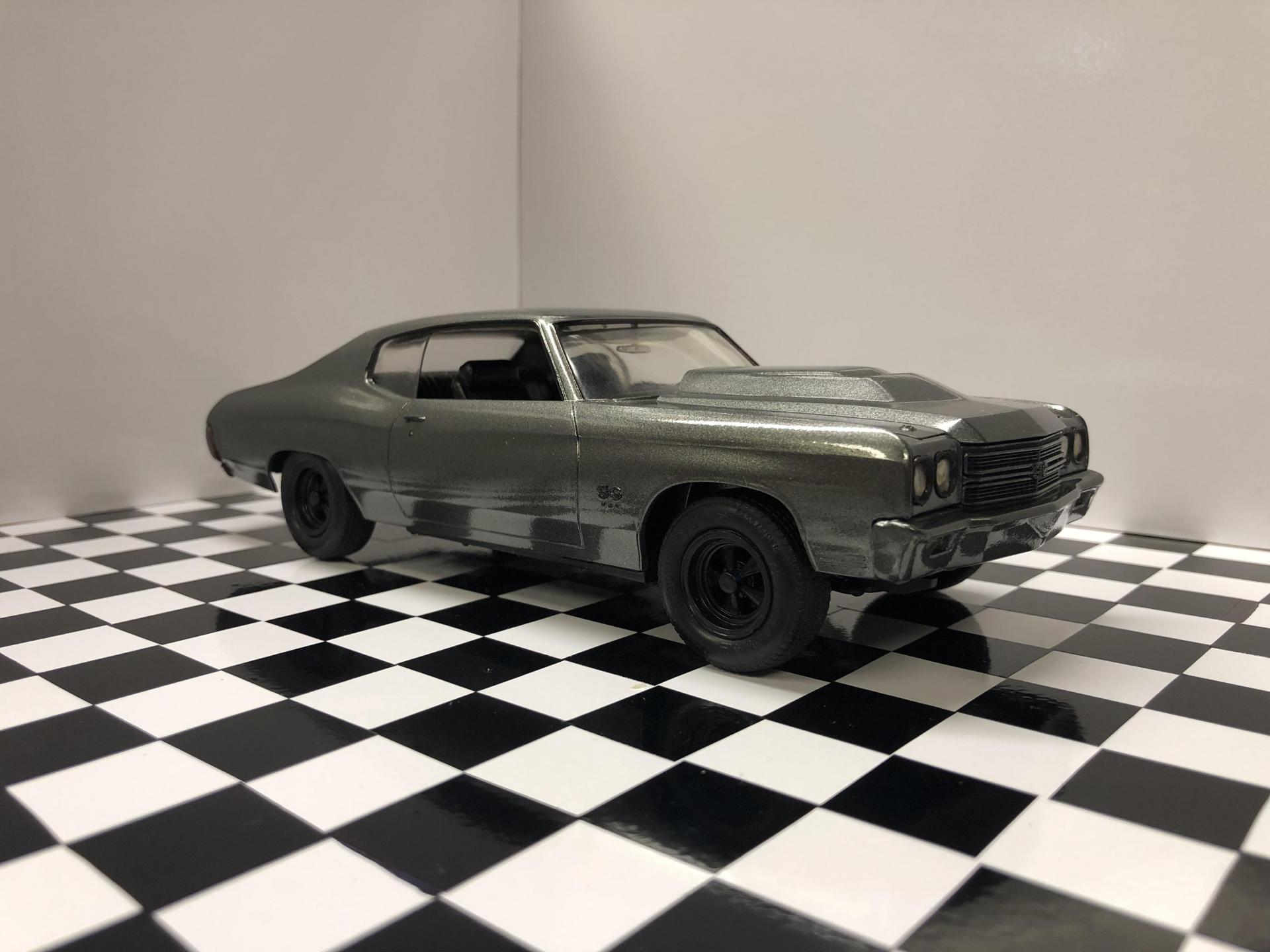

I know I have a old Monogram 70 Chevelle SS454 1/24th I built years ago that I wanted to redo but was in to bad of shape to do as stock like I wanted. So I picked up in trade the Revell Baldwin motion 70 Chevelle 1/25th. Come to find out it's the same kit with a different hood and exhaust so I put the stock hood and exhaust on the new kit and did a custom on the old kit...
Old Monogram kit with the New Revell hood
