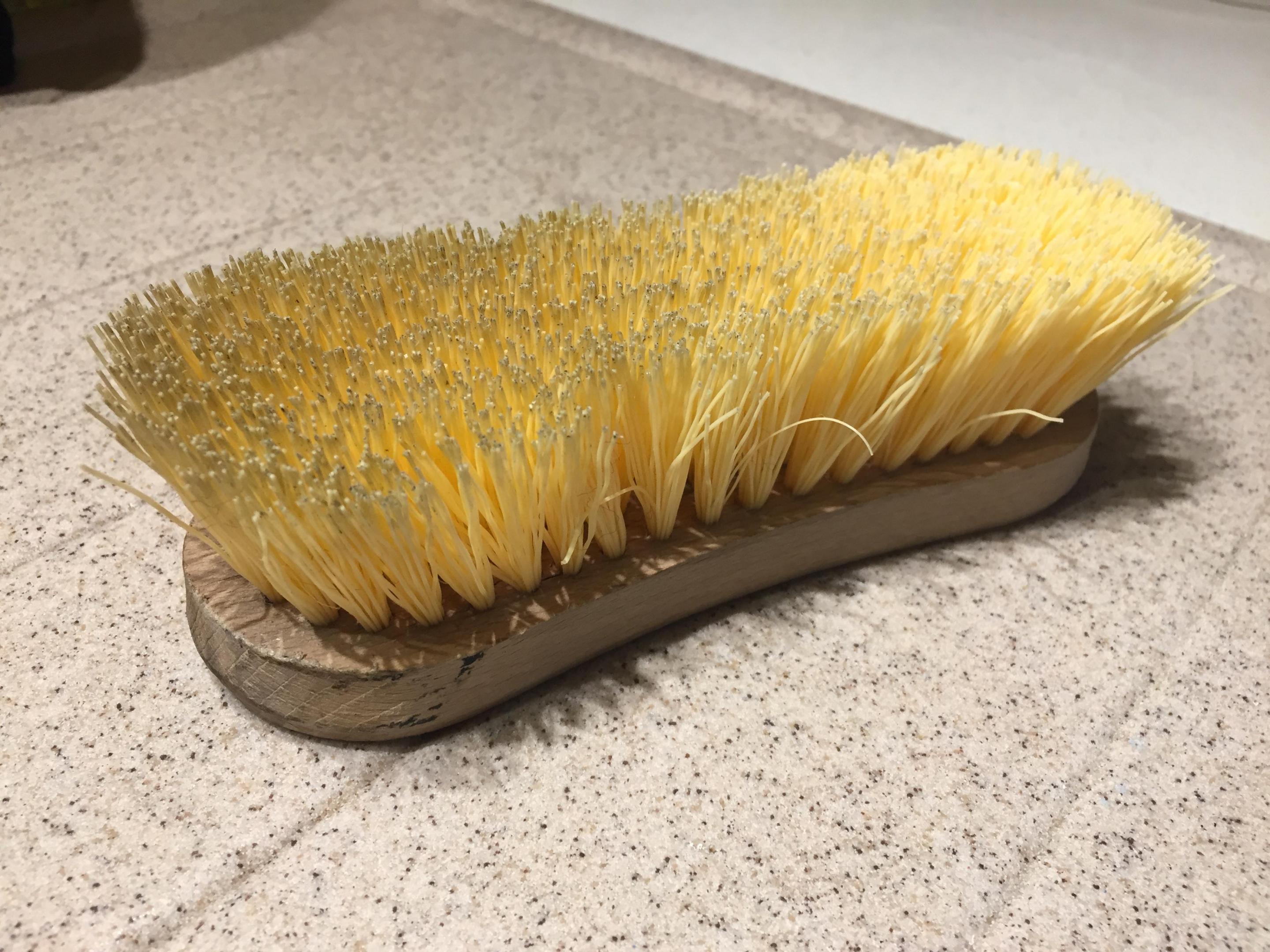

grodudulle77 Posted April 4, 2020 Posted April 4, 2020 (edited) On 11/27/2019 at 4:08 AM, tbill said: As I’m working on my garage dio, I’ve decided I need a ‘lot’ to put it on. My dilemma now is how to replicate pavement/ black top. I had thought of either black sandpaper, or rubberized undercoat ( not sure how that would work out), what else is out there? I’ll be using plywood as the base if that makes a difference for any other products you may recommend. thanks, tom Hello Tom , to make asphalt, i use a piece of a coating that is used for waterproofing sheet metal or concrete roofs . You have to erode the surface to get a more realistic look using a stiff brush or household alcohol .I hope that it will be able to help you. Philippe. Edited April 5, 2020 by grodudulle77

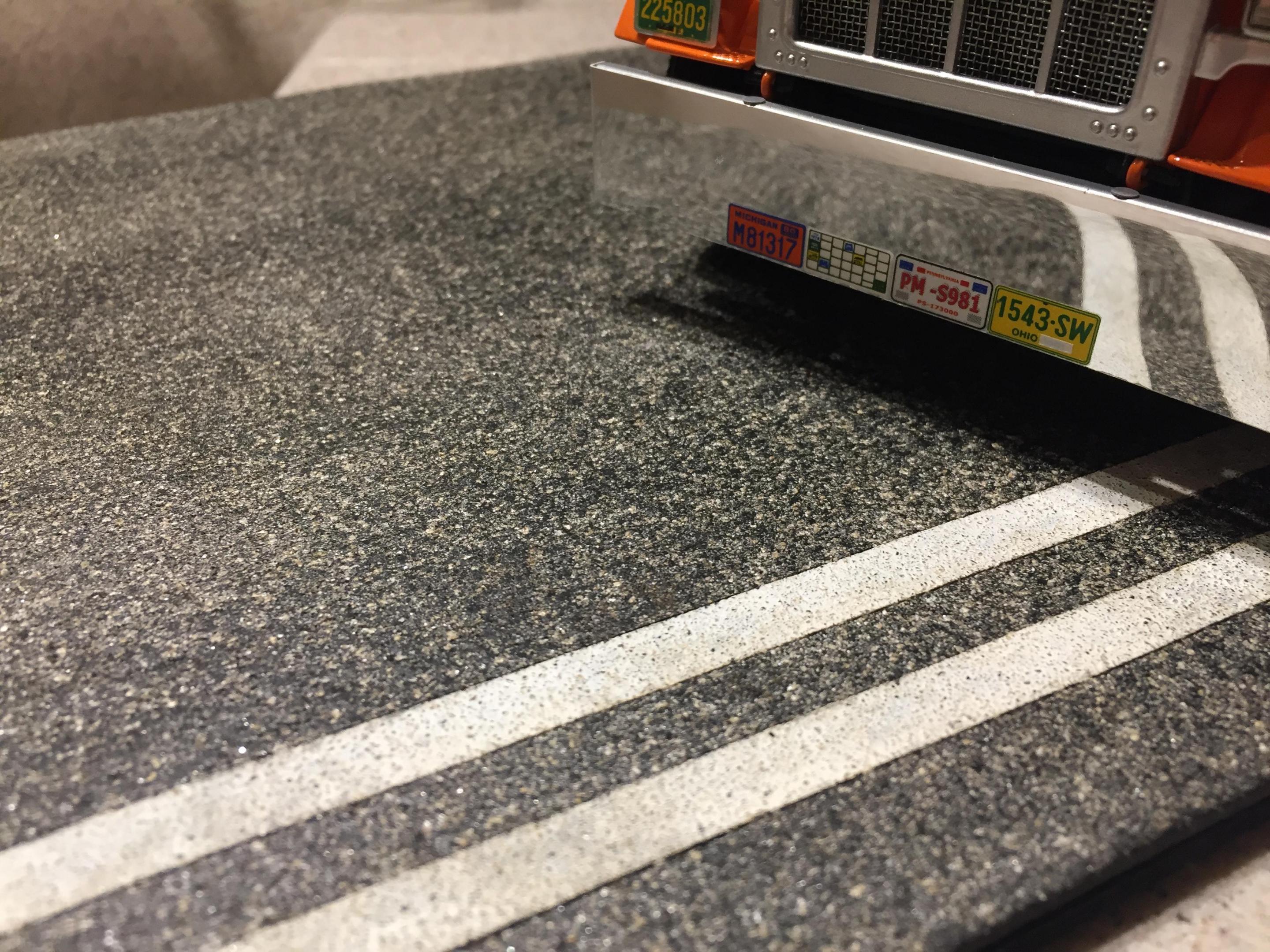

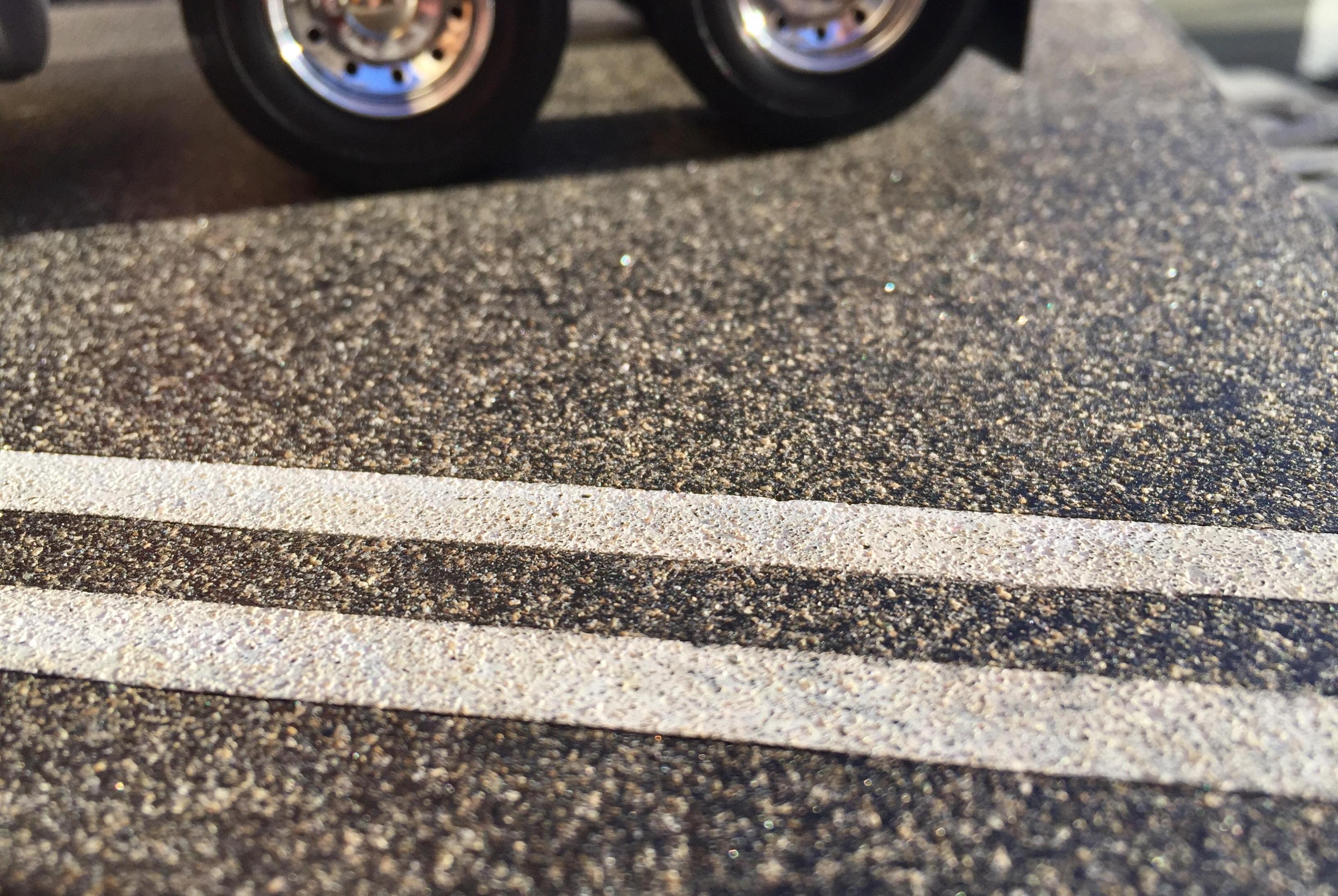

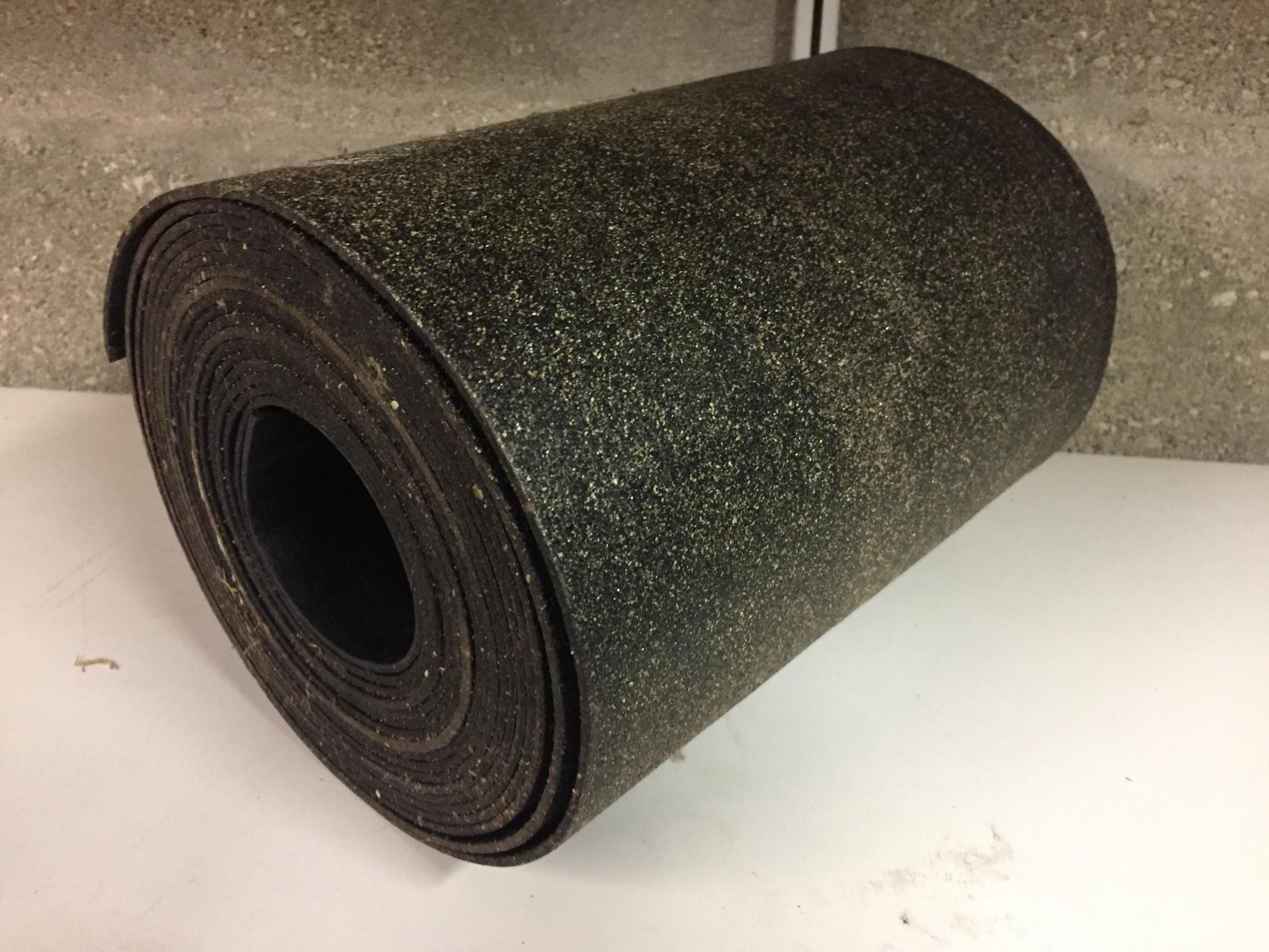

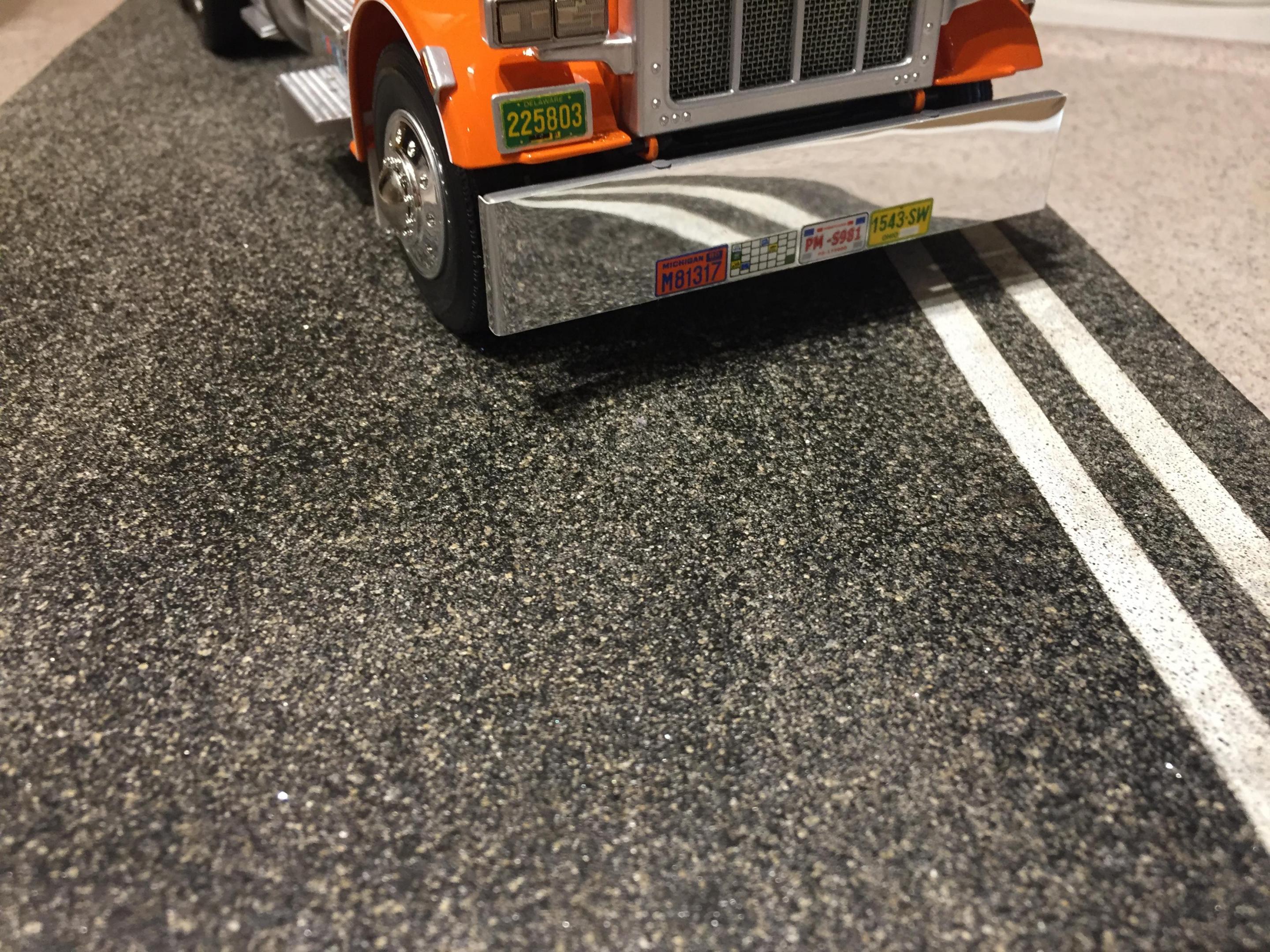

wrenchr Posted April 5, 2020 Posted April 5, 2020 (edited) On 11/27/2019 at 12:27 AM, Bucky said: I once used a sheet of fine grained cork to represent an asphalt driveway. Painted flat black and weathered a bit, I thought it looked pretty good. I found some very thin adhesive backed cork @ dollar tree and used it on this base, took me minutes to do this and all is painted it with was gray primer and apple barrel yellow paint. Is it the best, no but I think it looks convincing. Edited April 6, 2020 by wrenchr added pic
