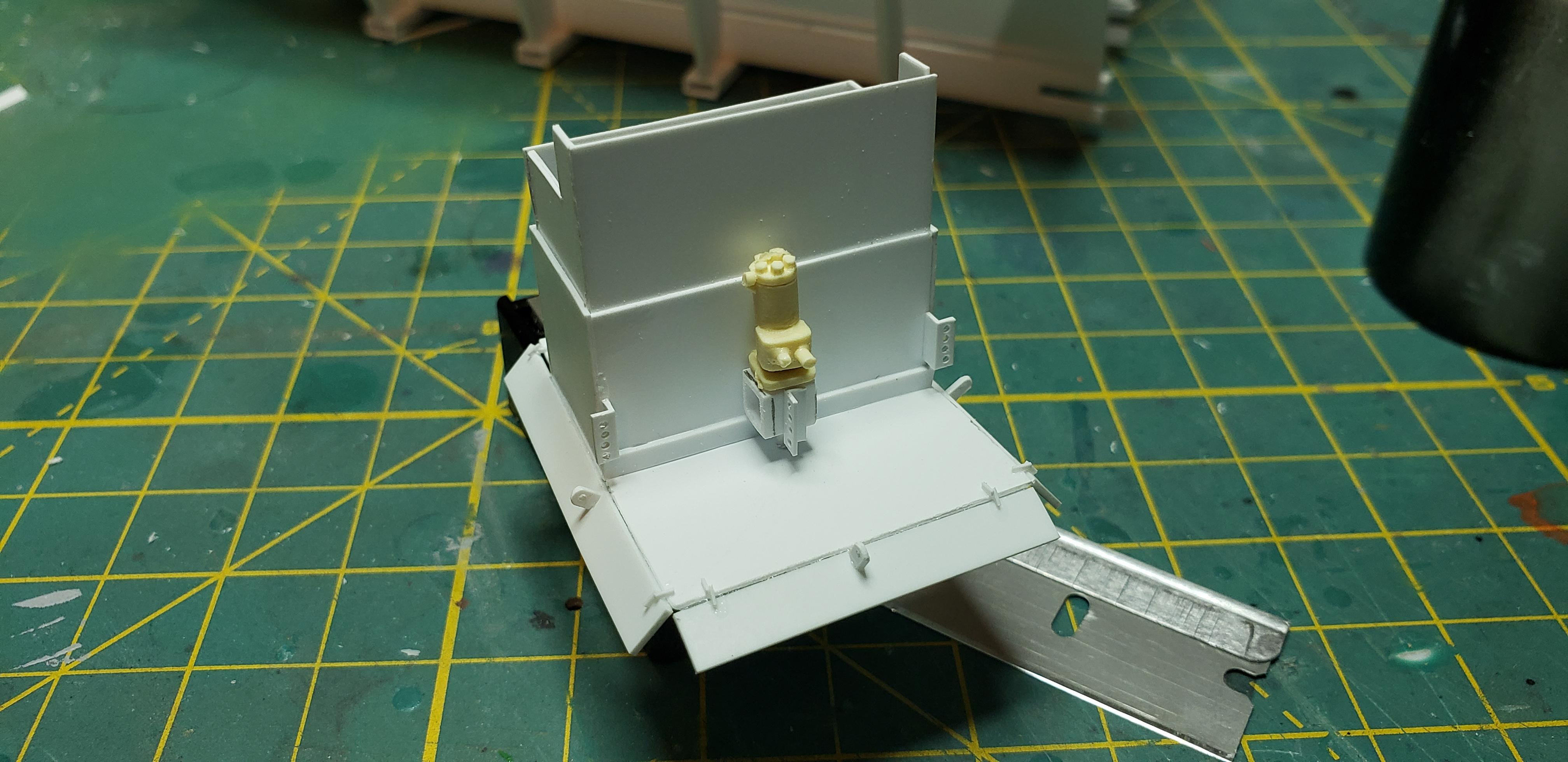

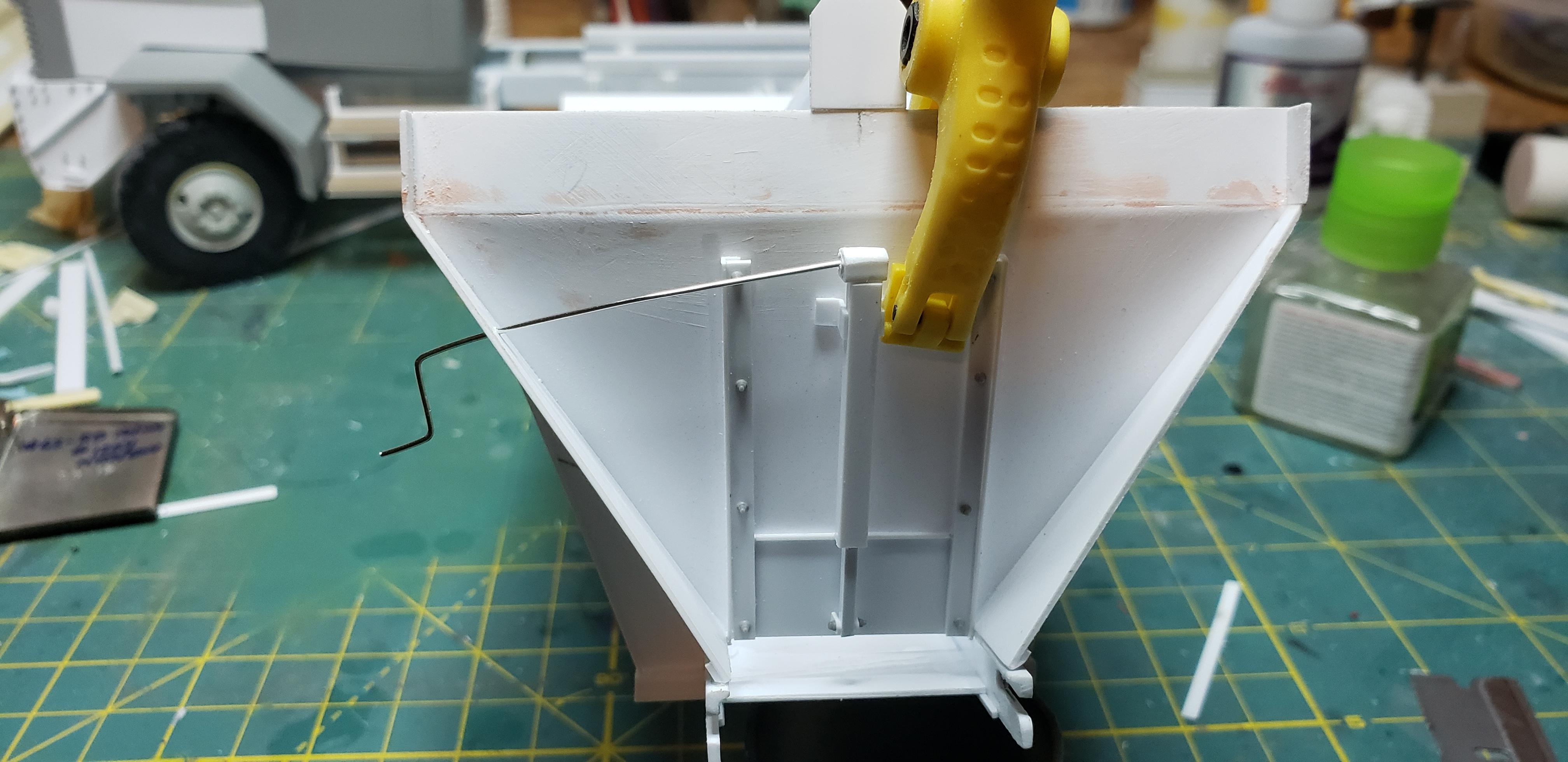

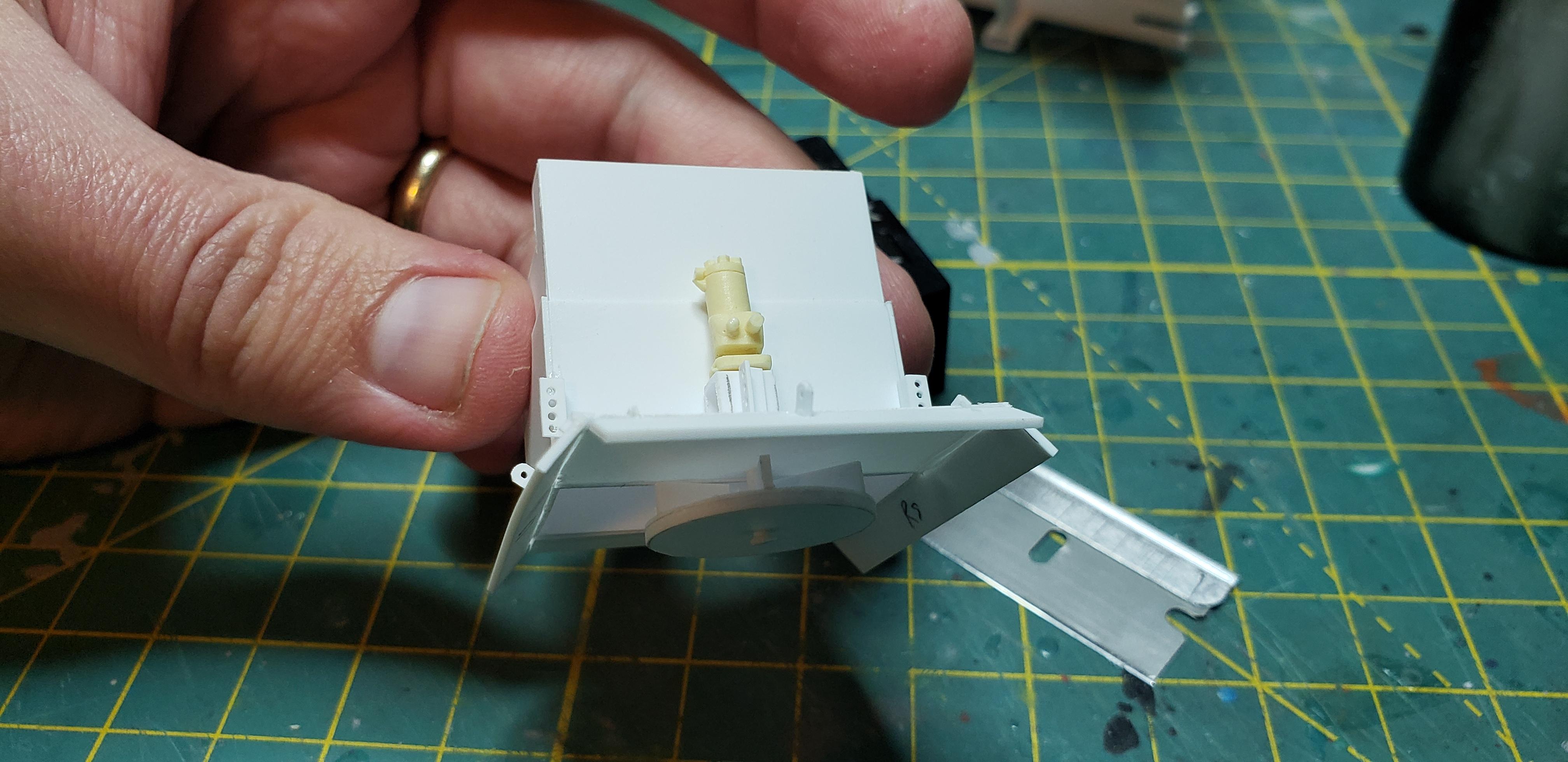

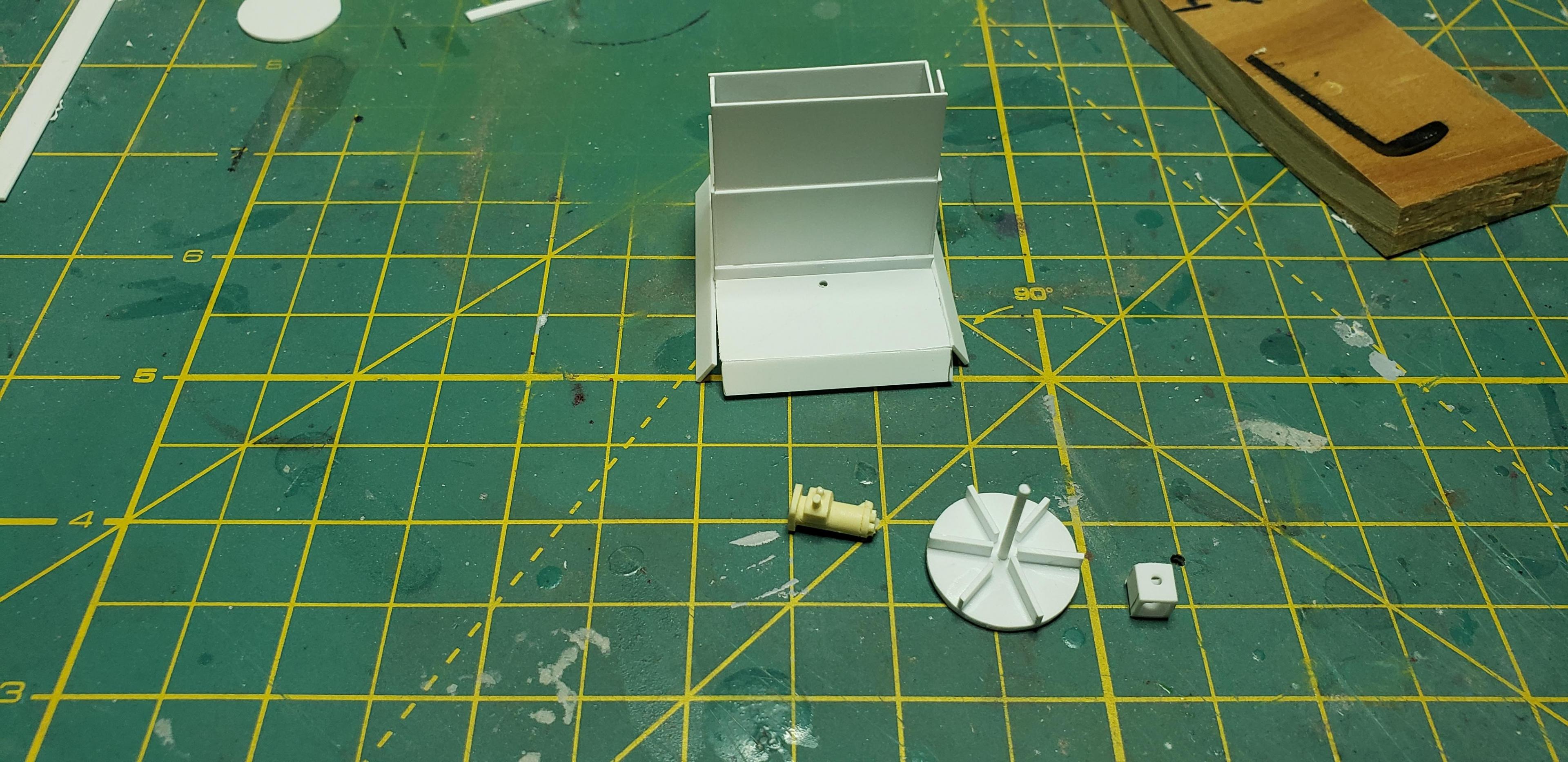

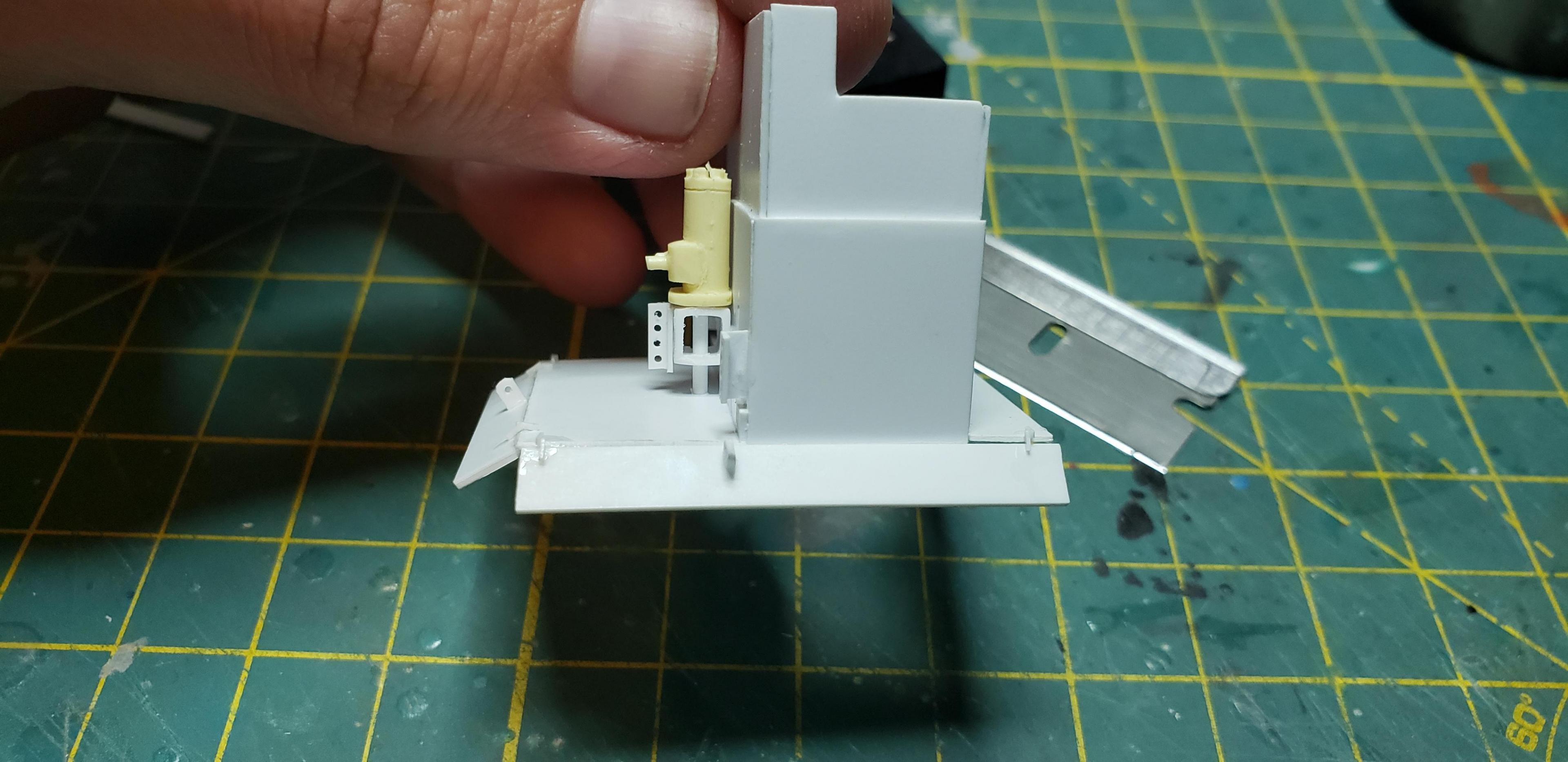

gotnitro? Posted January 29, 2020 Author Posted January 29, 2020 The sander chute looked pretty bland , being a fairly large part , I figured it needed some details . The spinner wheel is a scrap piece of 060 " drilled out for its driveshaft . A few small paddles went on next . Ryan Pedone sent me a couple hydraulic motors, so I drilled out the base to fit the driveshaft. The real one had small brackets welded on the chute body w linkage rods to adjust the angle on side flaps..and small hinges . A few pieces of 90 angle drilled out and strip made a fair representation. The product door needed its lift bar still. I made one from square tube , and small brackets. The crank rod is copper wire mocked up. I may make a handle from wire insulation to fatten up the crank rod . I'm getting very close to primer now ...
Chariots of Fire Posted January 29, 2020 Posted January 29, 2020 Attention to detail is what it is all about! I'm betting that when you get to the primer stage it will present an opportunity for a lot of fine tuning. I've found that out in my own scratch building. Just when I think something looks great, I do the primer thing and every little flaw stands out. There's something about working in white plastic that hides everything until that first coat of primer goes on. But taking the time to clean up a lot of little areas will reward you spades! Keep up the great work! It's fun watching the progress.?
gotnitro? Posted January 29, 2020 Author Posted January 29, 2020 Charles - I'm noticing several areas that need sanding w finer grits after taking photos, so I see a few primer sessions

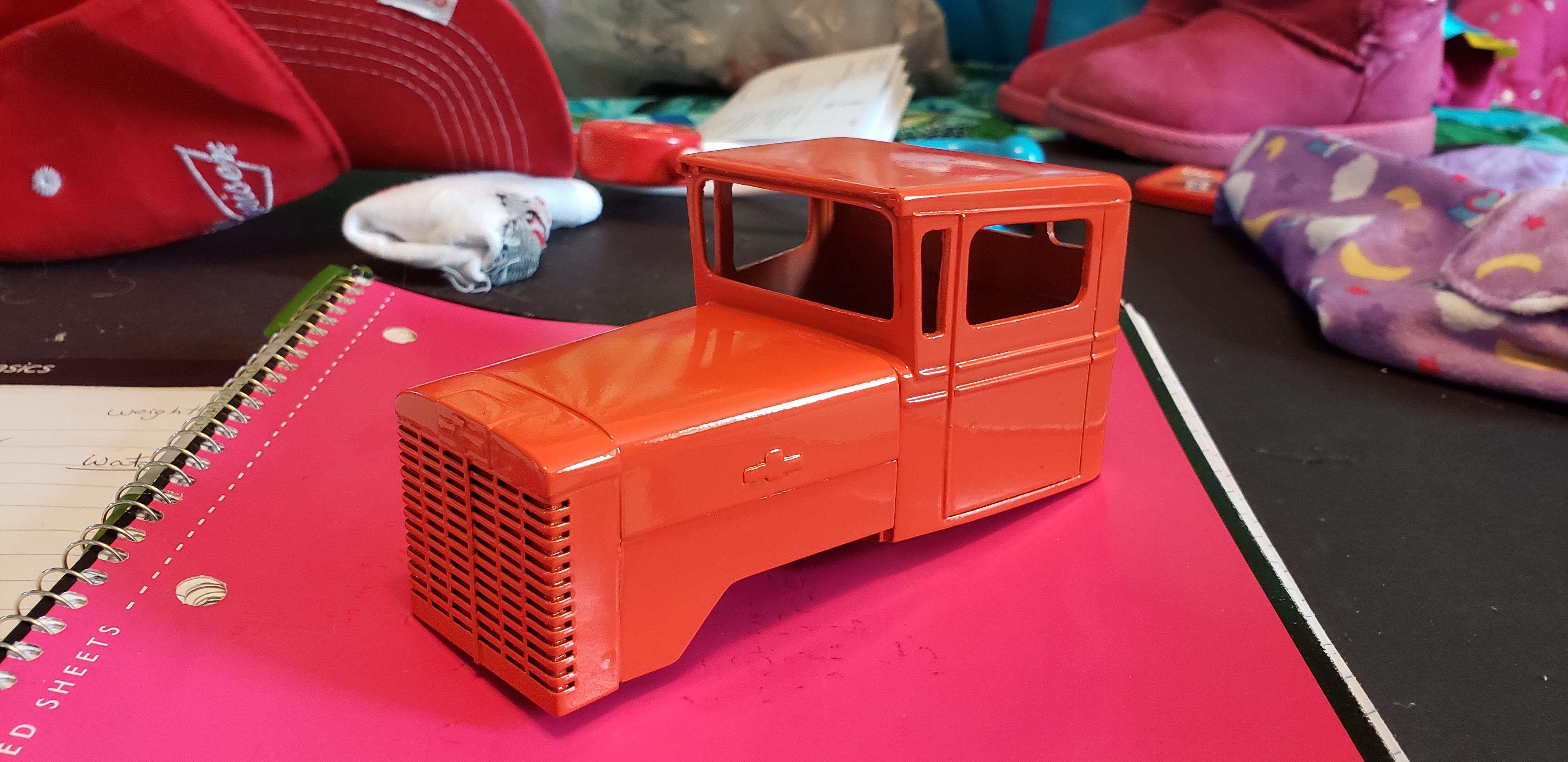

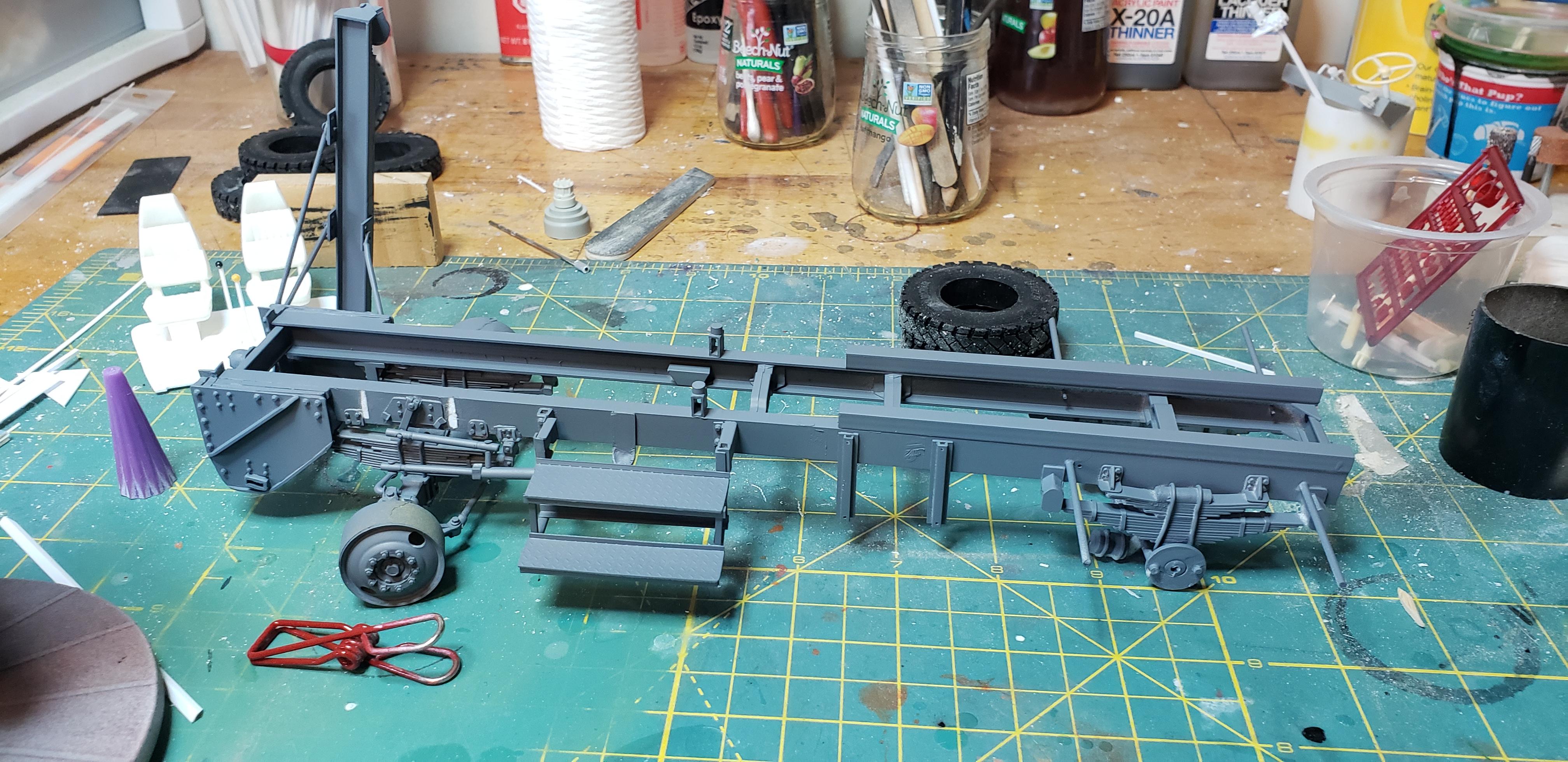

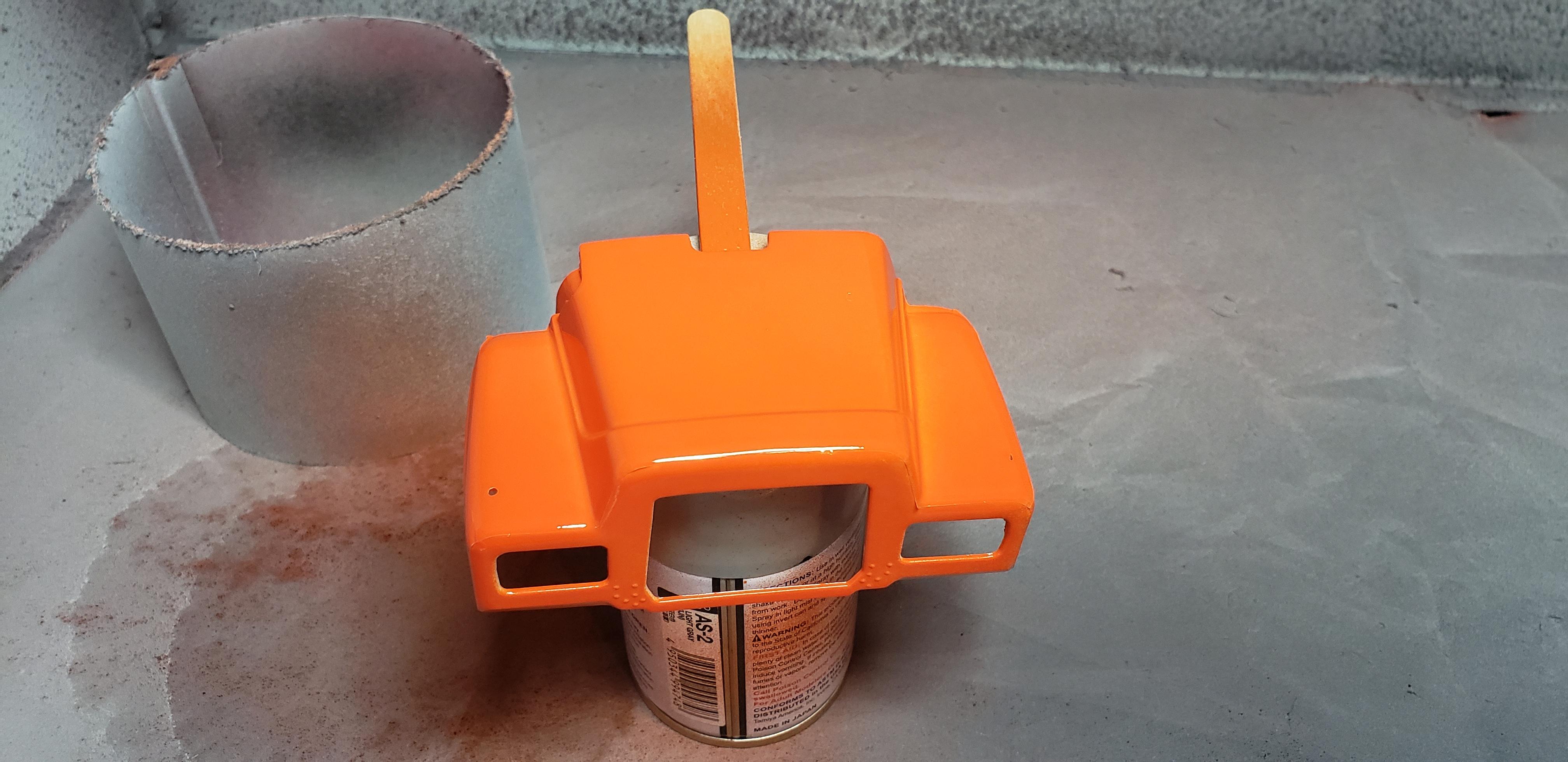

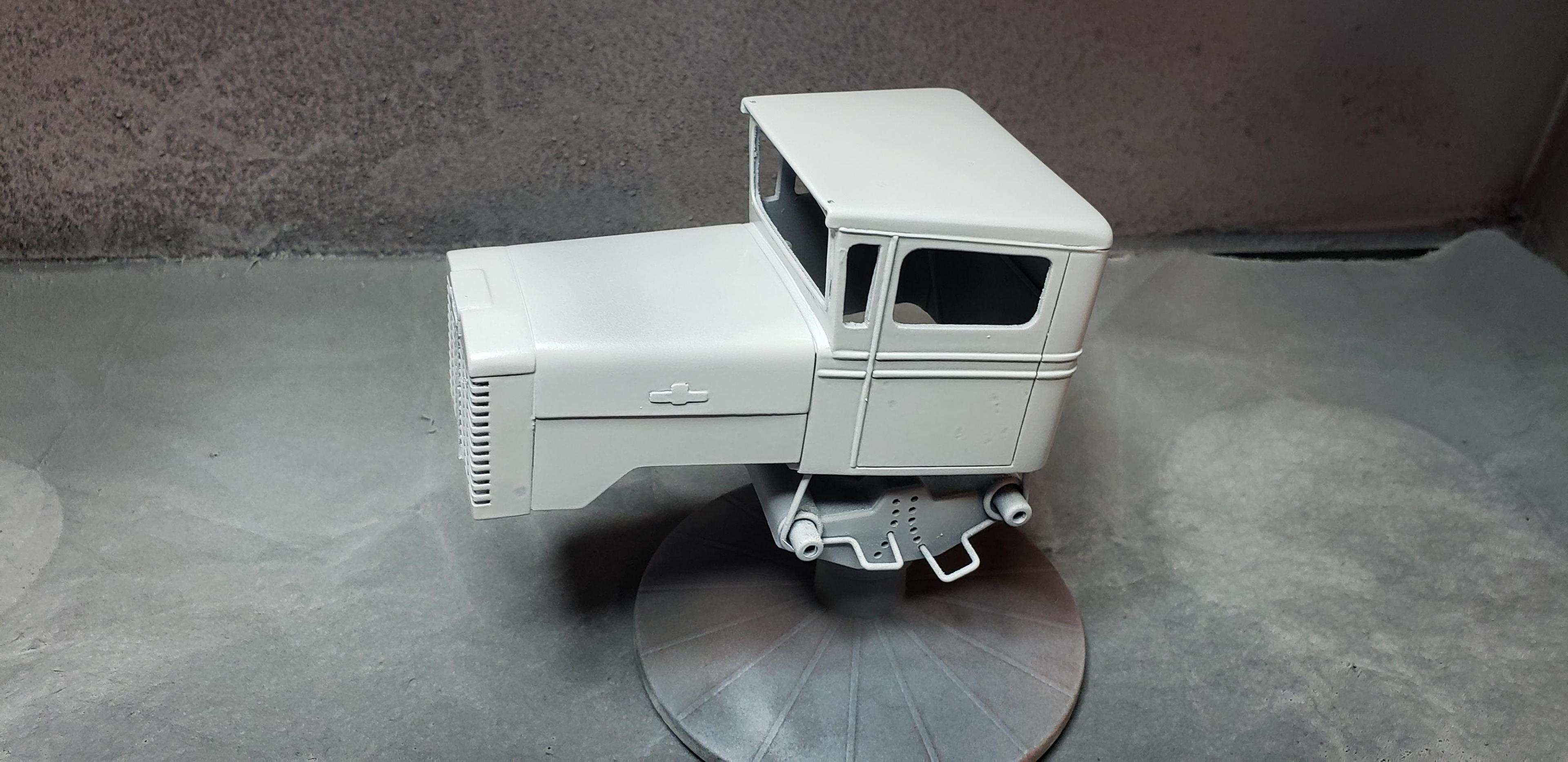

gotnitro? Posted February 1, 2020 Author Posted February 1, 2020 Reached the primer stage today on the frame and got the orange sprayed! I picked up a can of rusto allis Chalmers orange for the body , and wanted to see how it looked . Sprayed a test on a spare mack hood.. Weird how lighting makes frame look blue..its light gray primer lol. Planning to paint the sander hopper / frame semi gloss black. The hood will get its flat black anti glare panel also
Chariots of Fire Posted February 1, 2020 Posted February 1, 2020 The details on the frame really pop now that you have primer on it. That's a lot of widgets!!
Tesla Posted February 2, 2020 Posted February 2, 2020 5 hours ago, Chariots of Fire said: The details on the frame really pop now that you have primer on it. That's a lot of widgets!! X2...Looks great!!

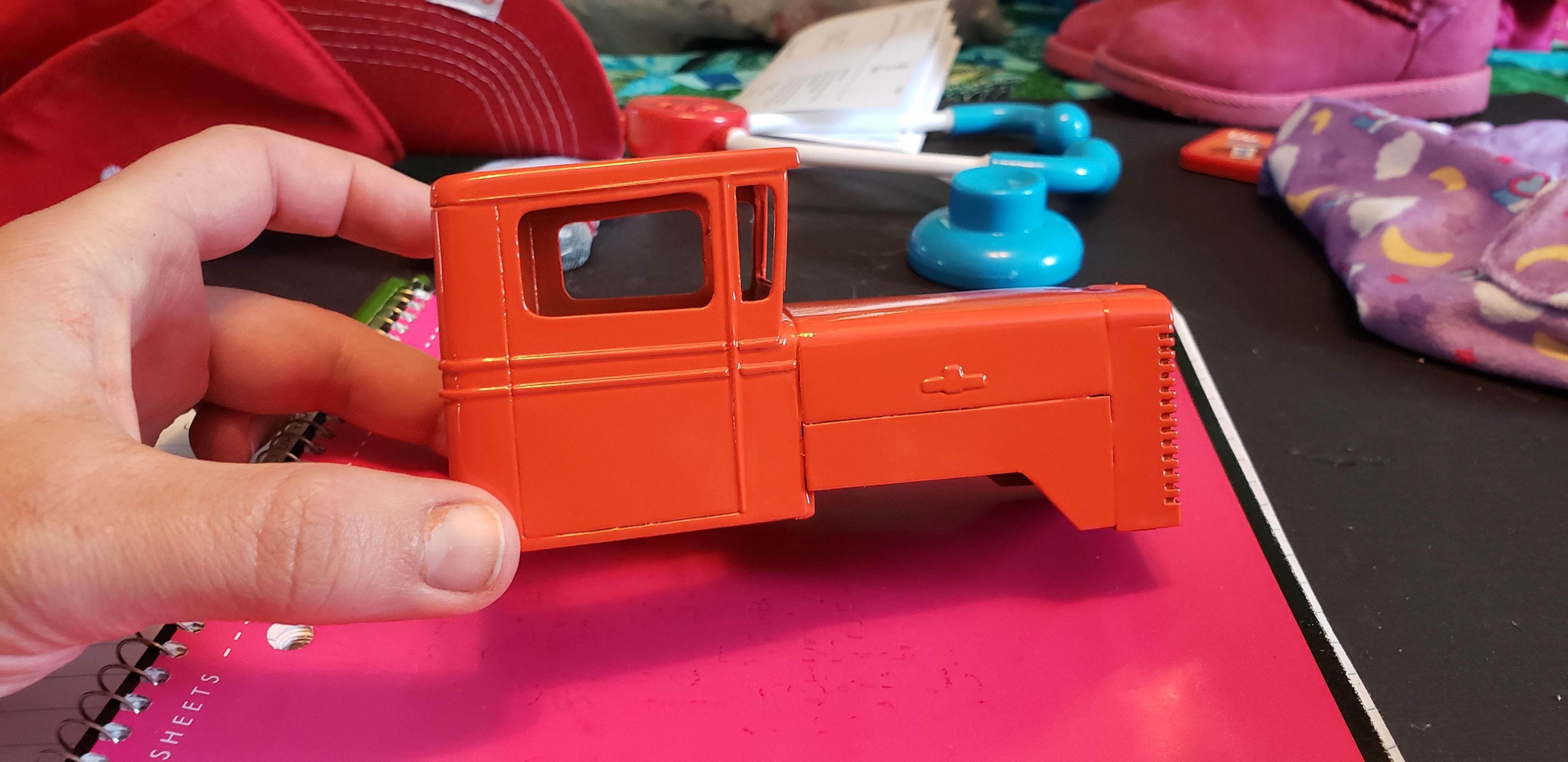

gotnitro? Posted February 2, 2020 Author Posted February 2, 2020 11 hours ago, Chariots of Fire said: The details on the frame really pop now that you have primer on it. That's a lot of widgets!! Yeah , I actually meant to lightly tack most of the parts on making the painting easier..but enjoying the work so much , most of the parts stayed put. The white areas are where I removed the fender hangers to paint them orange. The details really jump out now 5 hours ago, Tesla said: X2...Looks great!! Thanks ! I'll take a few pics of the painted body today, I'm really happy with the results

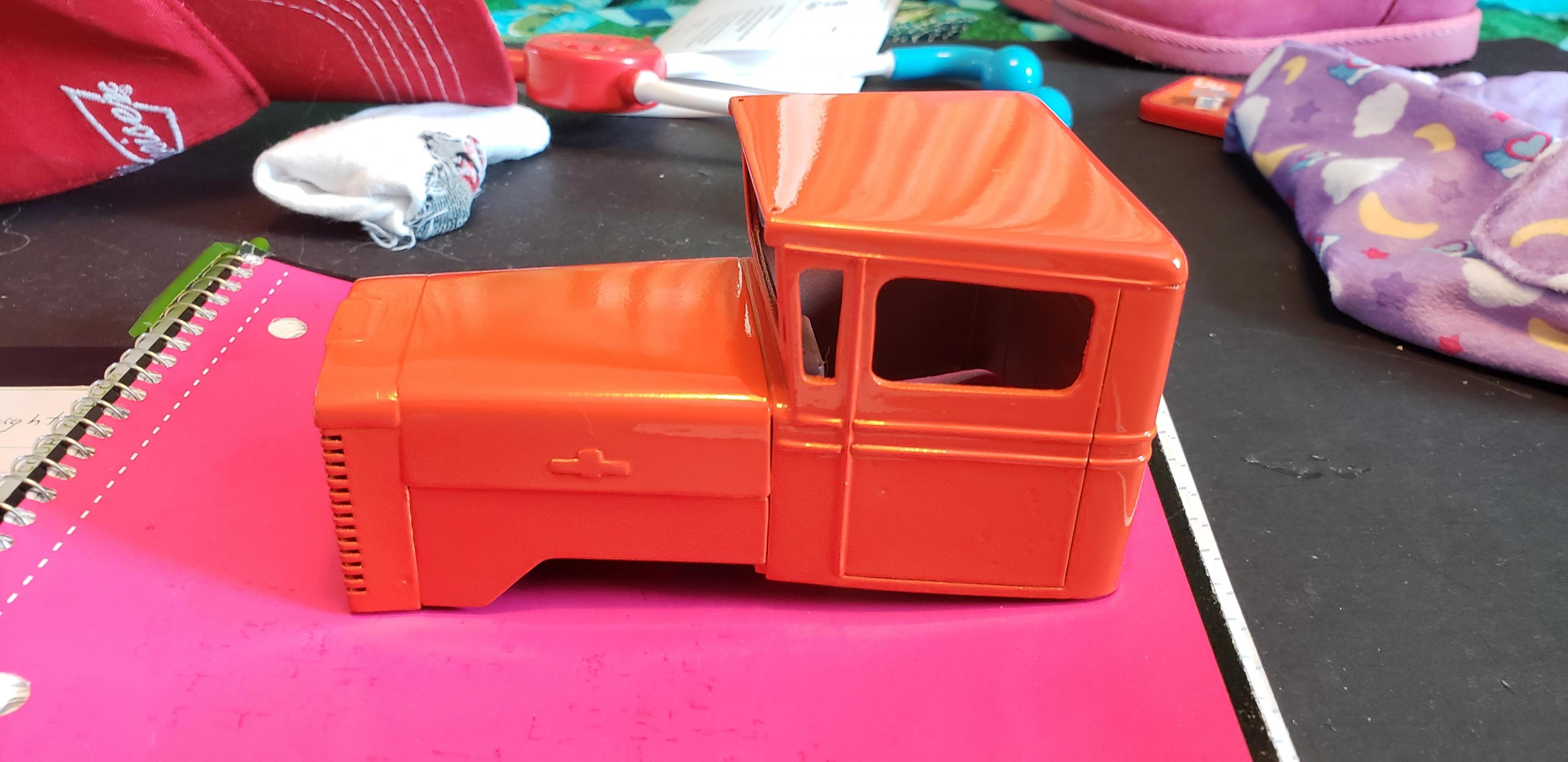

gotnitro? Posted February 2, 2020 Author Posted February 2, 2020 Heres the orange after drying overnight...later I'll airbrush the anti glare hood

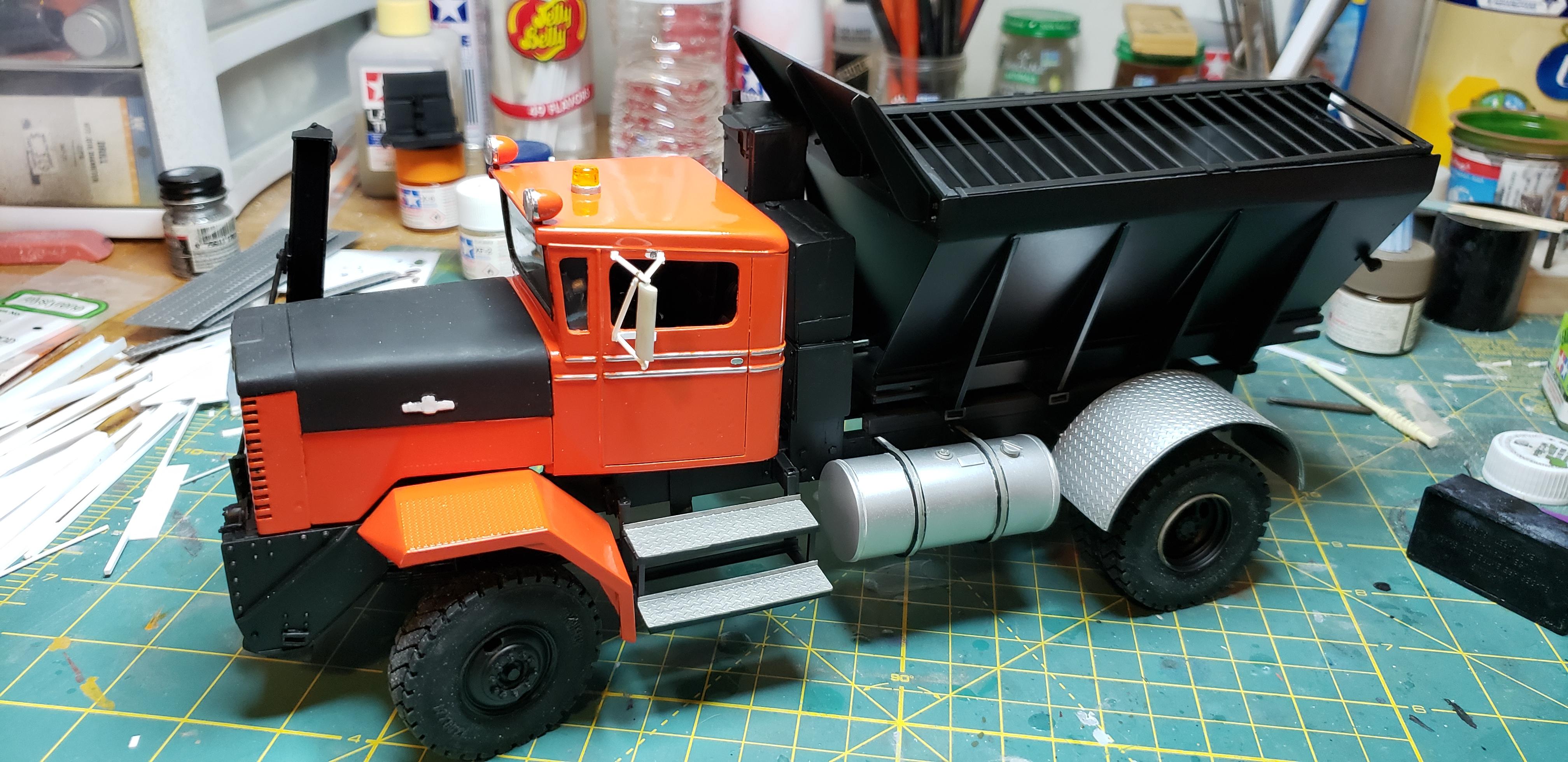

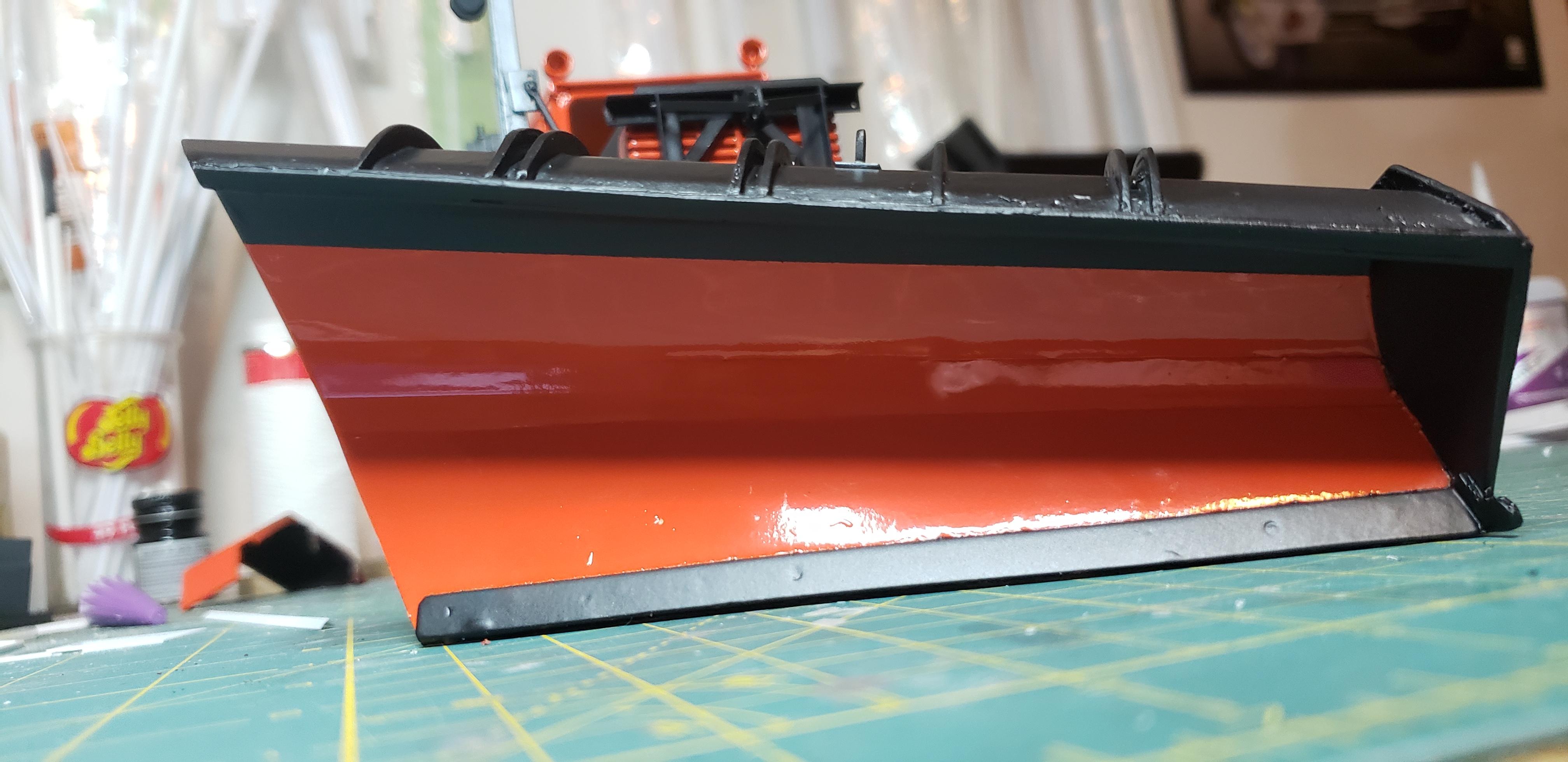

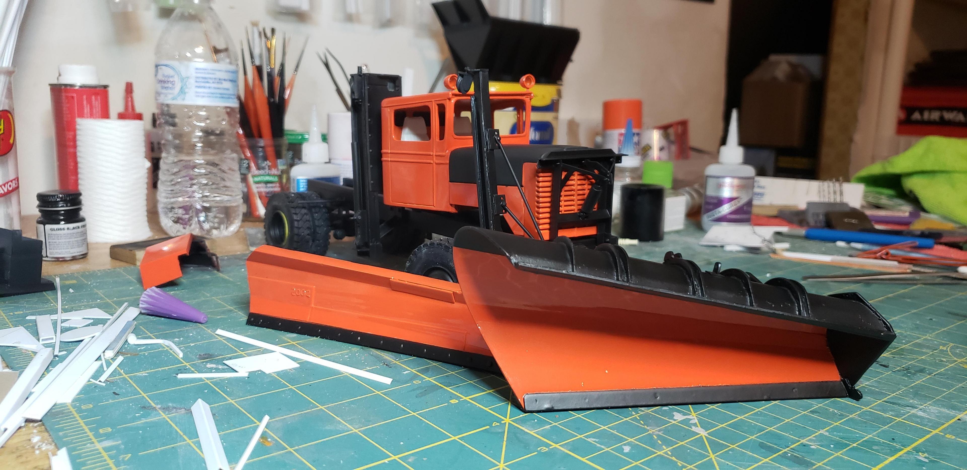

gotnitro? Posted February 3, 2020 Author Posted February 3, 2020 The paint is dry, so it's time to start final assembly!!! The plow got a few touches of black along the discharge end , and the road scraper The frame and sander hopper is semi gloss black , the diamond plate fenders is buffed aluminum plate, and fuel tank ended up dull aluminum. I might lower the black area on plow , the real one had more showing from the side ..we'll see
Chariots of Fire Posted February 7, 2020 Posted February 7, 2020 That is pretty cool, Jeff! What a great build!
mikemodeler Posted February 8, 2020 Posted February 8, 2020 Incredible build, lots of great details and looks so realistic.

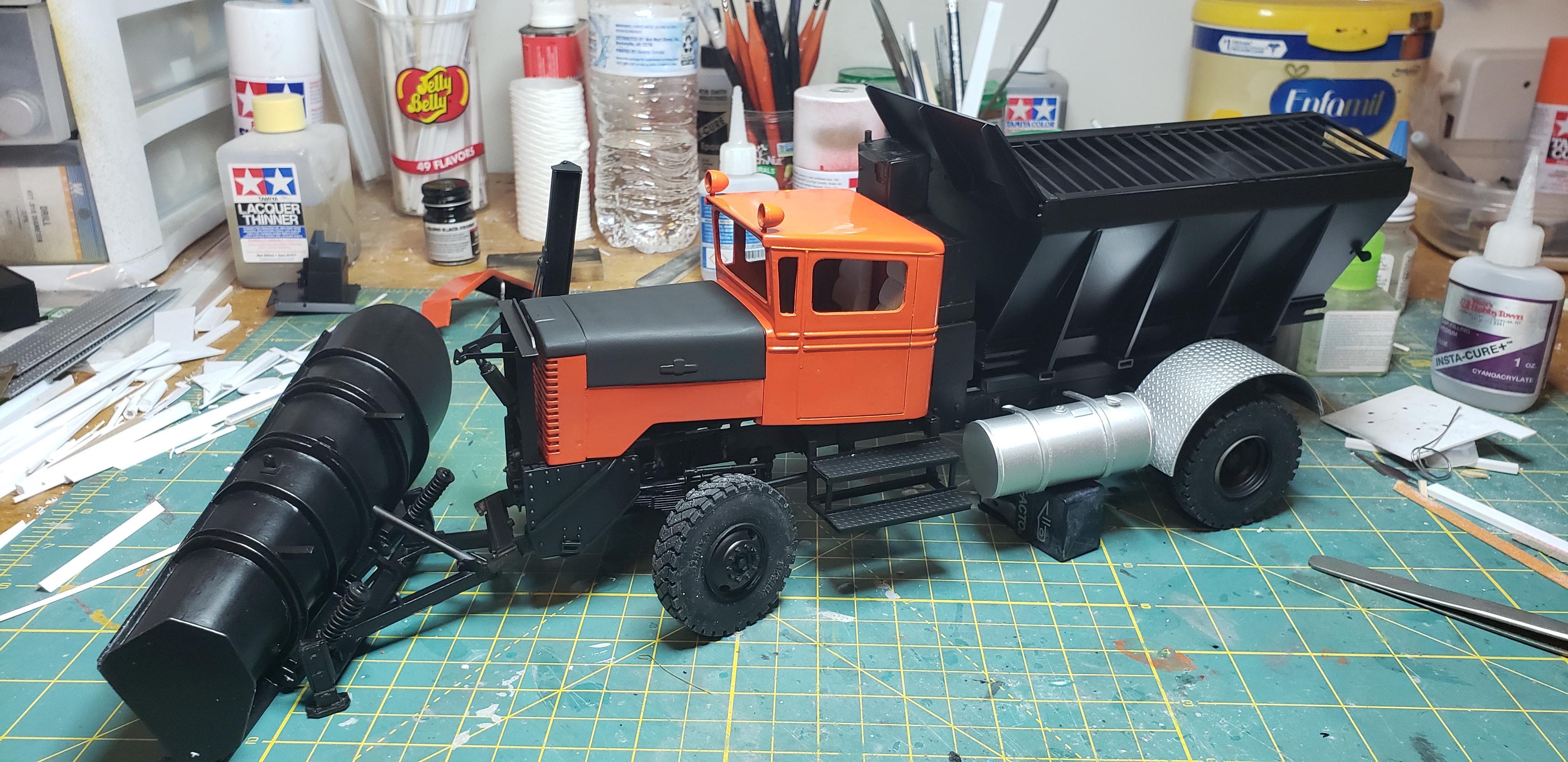

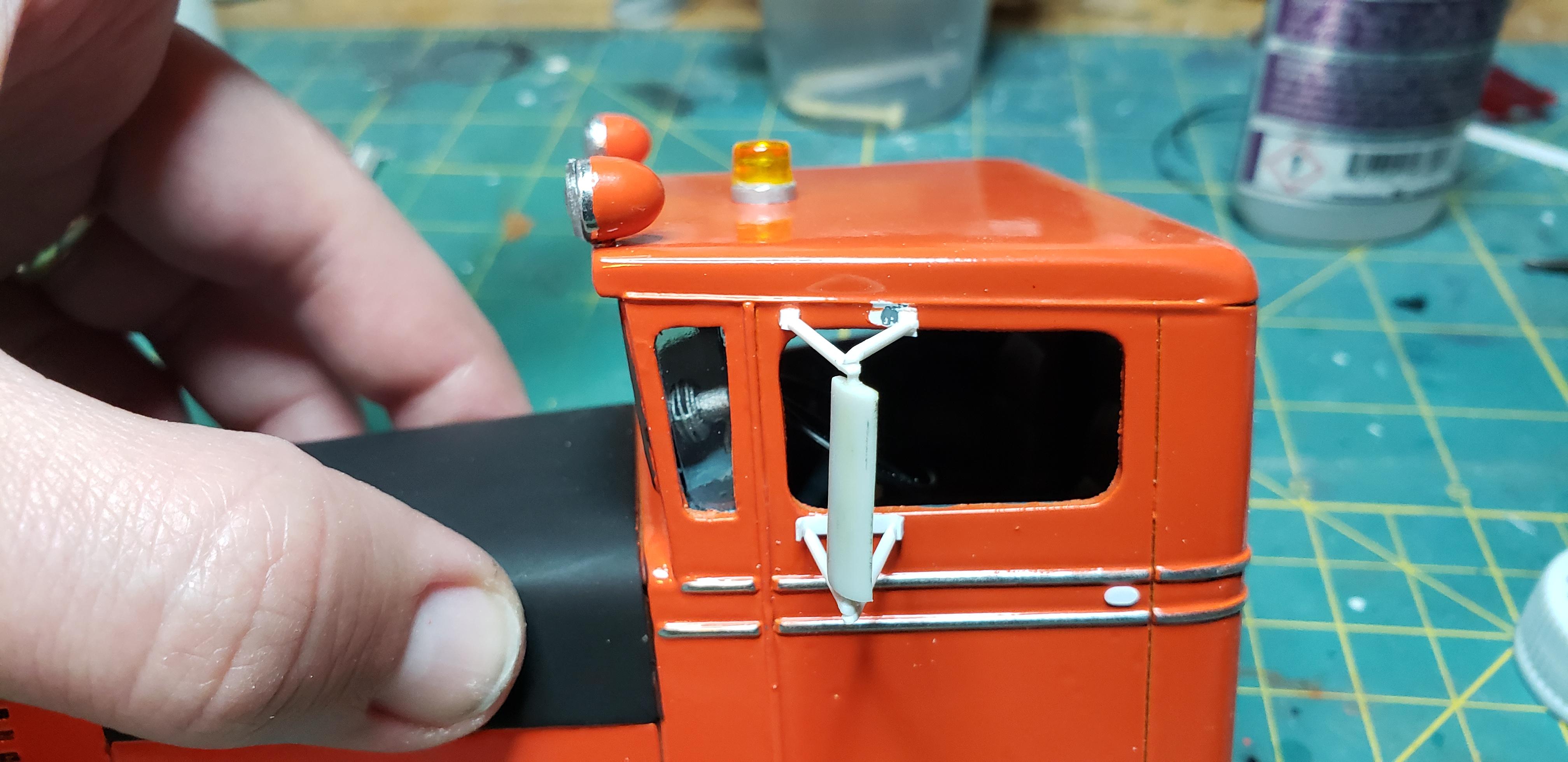

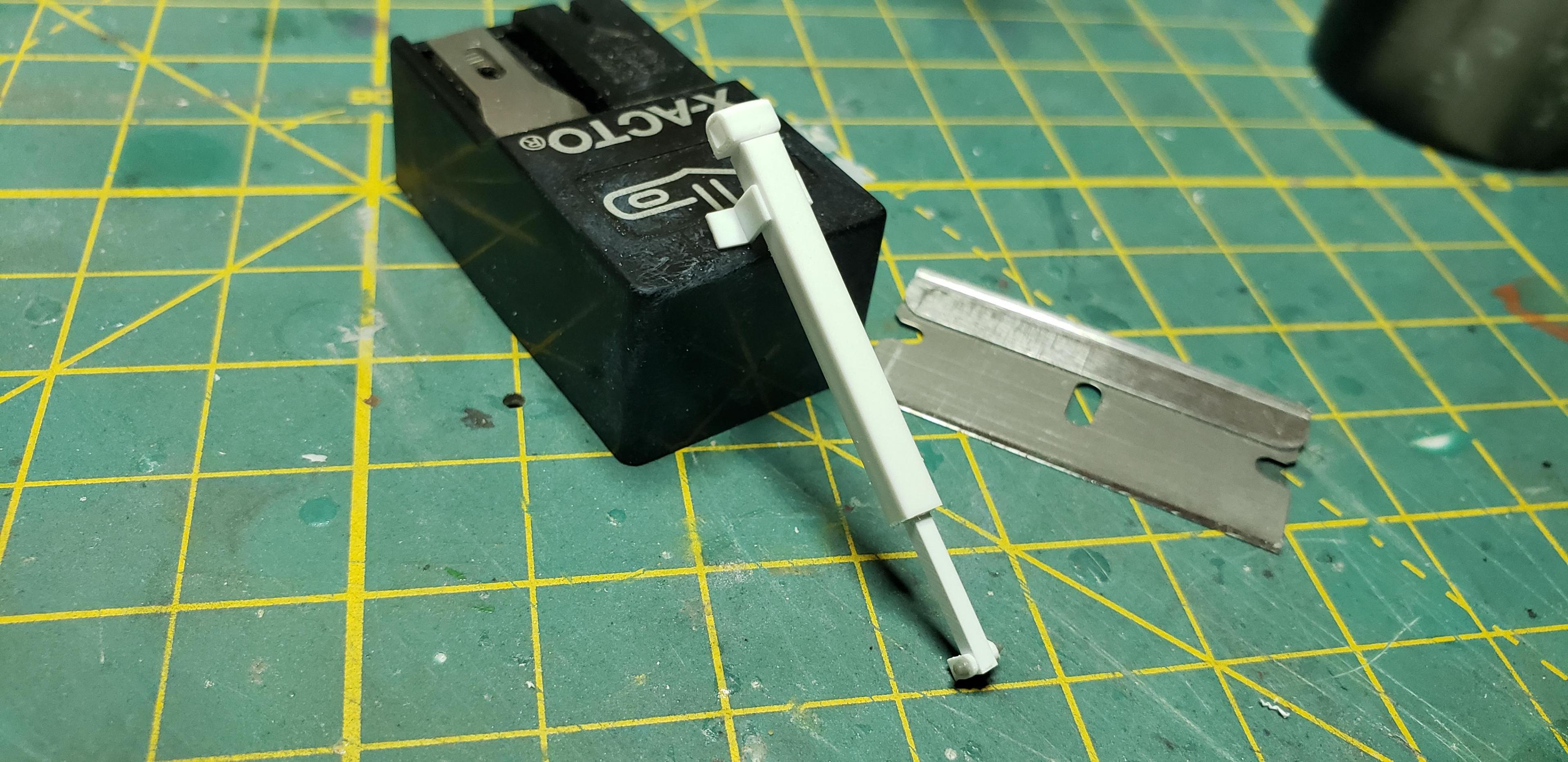

gotnitro? Posted February 10, 2020 Author Posted February 10, 2020 One last bit of fabrication left and it's off to the assembly shop ! The dreaded mirrors..I decided to suck it up and make em , 3/64 rod and a mirror head from the Ollie's 4300 parts kit. Squish the ends flat, glue , repeat.. I've also reached the milestone of the build finally reaching a rolling chassis! Everything except the sander hopper and cab is permanently attached...then I remembered the muffler..oops !!! That's getting done now wont be long now and itll be under glass

Tesla Posted February 10, 2020 Posted February 10, 2020 What a gorgeous build!! You definitely aced the mirrors ?
gotnitro? Posted February 10, 2020 Author Posted February 10, 2020 1 hour ago, tbill said: I can’t believe I haven’t posted on this ( probably cause I get pre post updates,lol), this is really looking good Jeff! Hahahha yeah we both get preview pics of ongoing builds before the forums gotta have someone check work before its posted 14 minutes ago, Tesla said: What a gorgeous build!! You definitely aced the mirrors ? Thanks , I still need those round mirrors mounted
