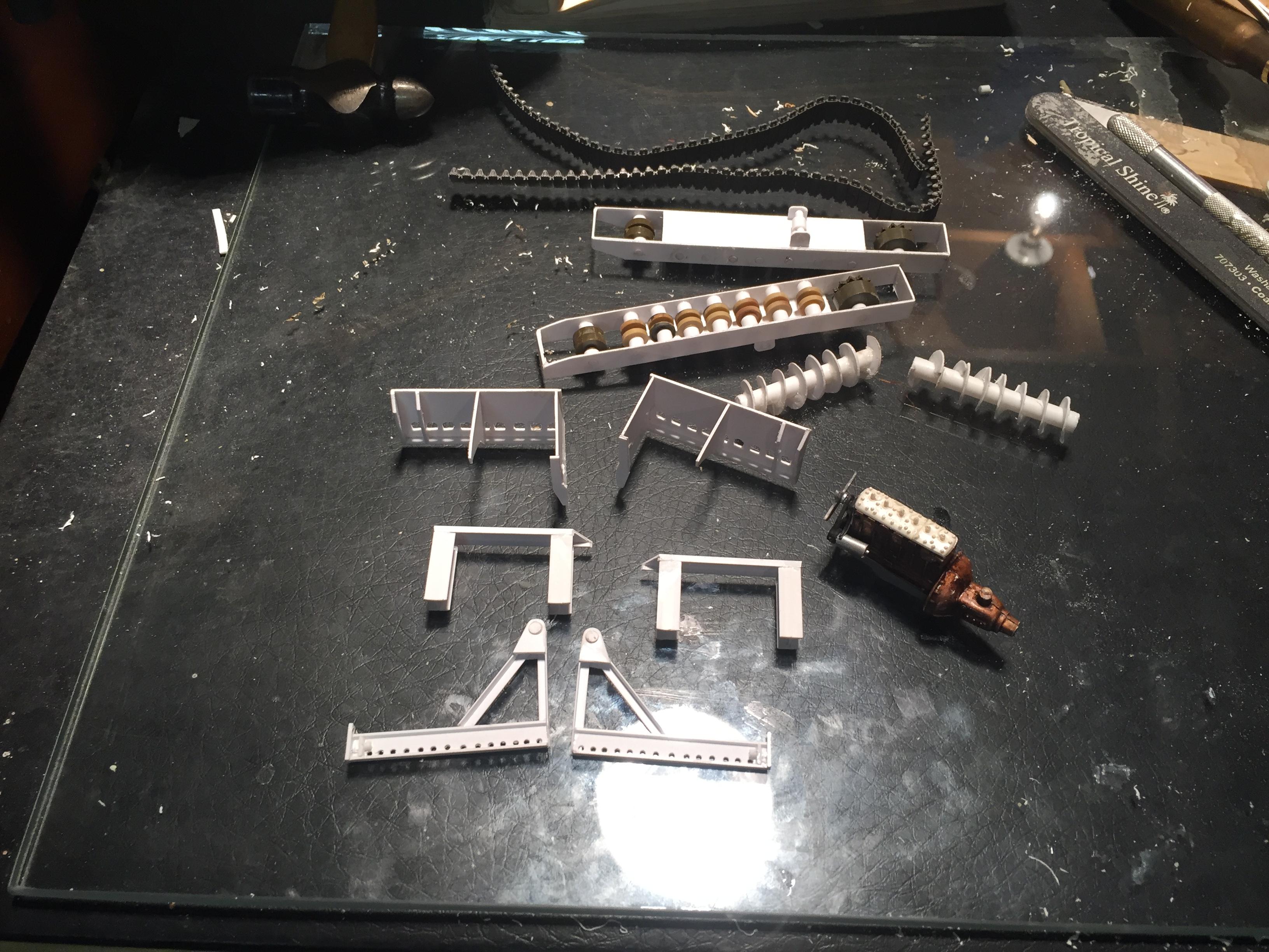

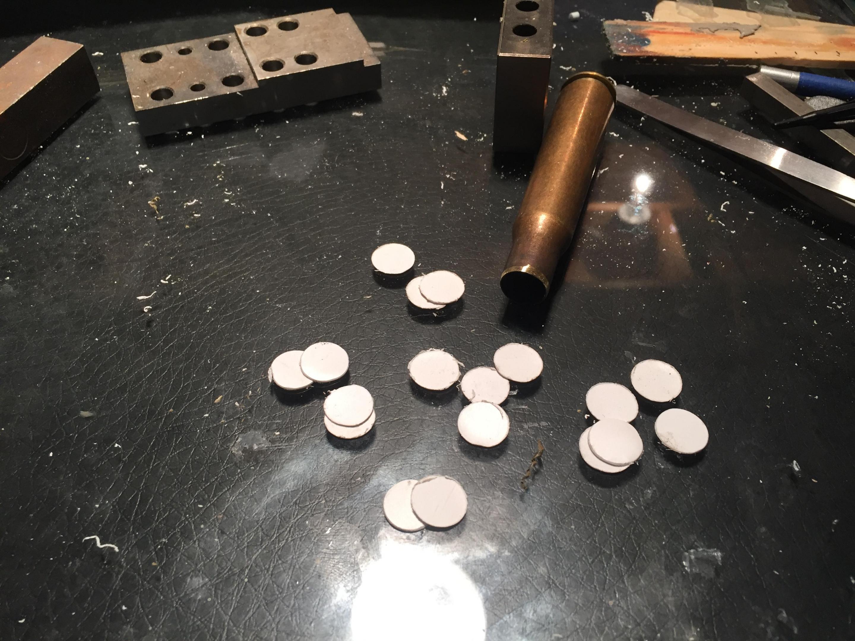

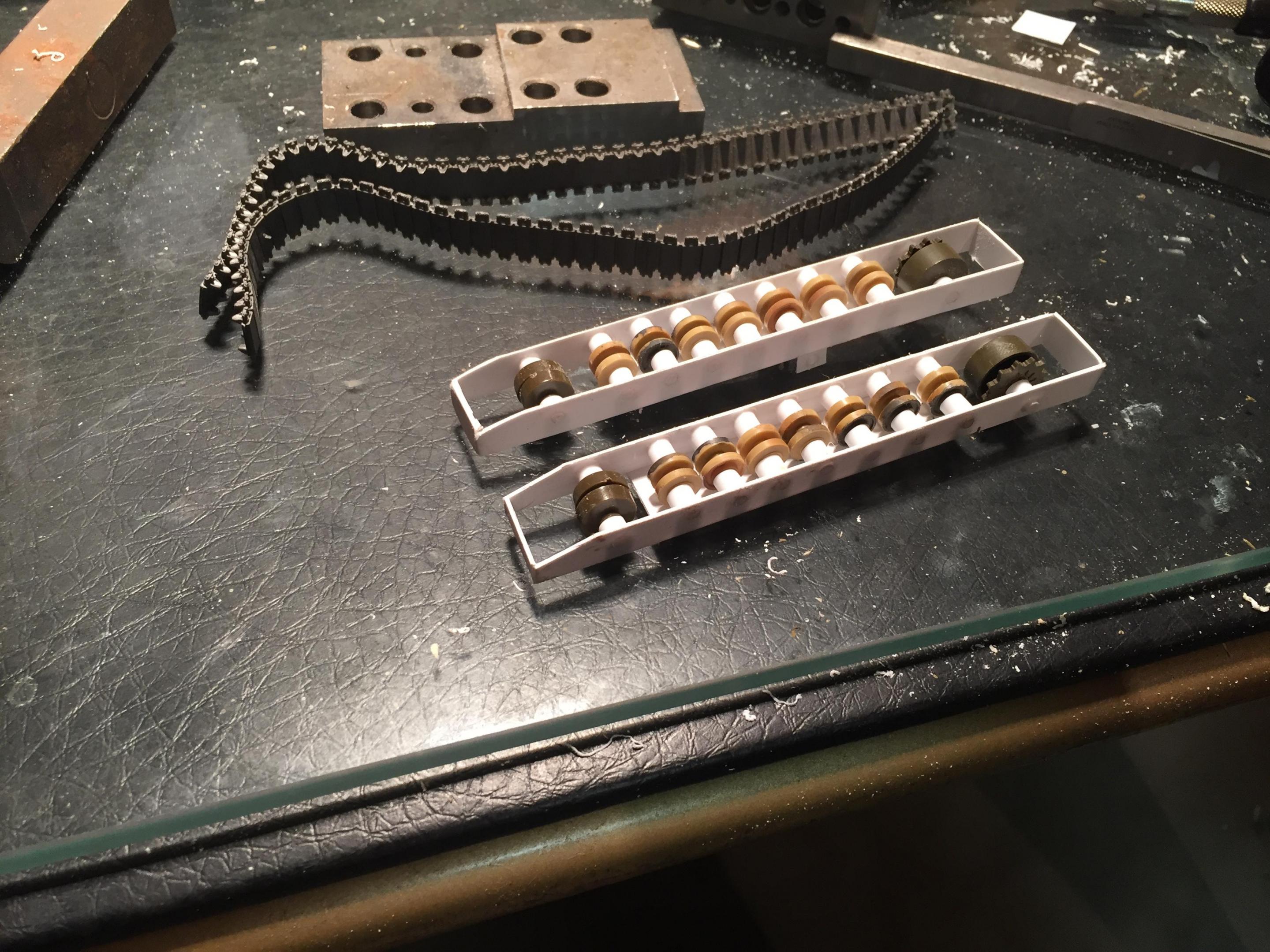

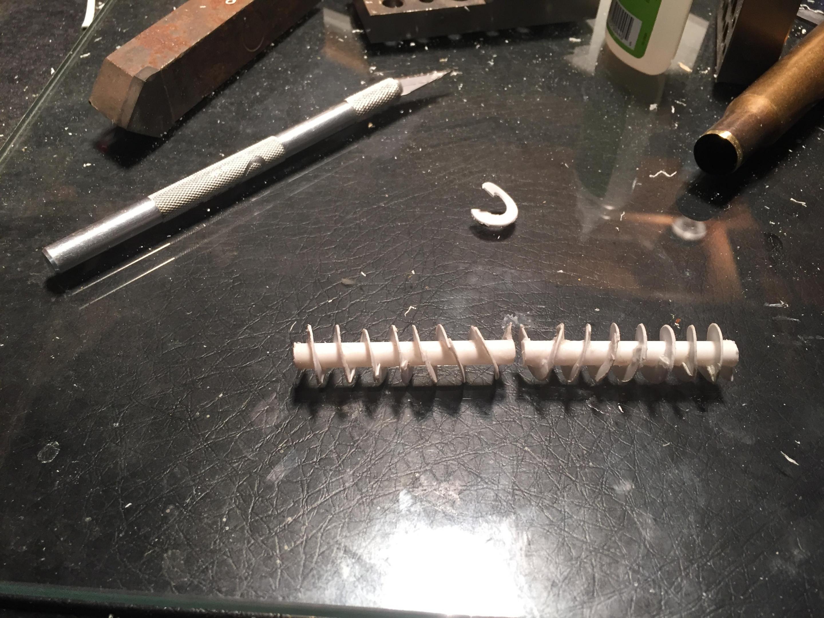

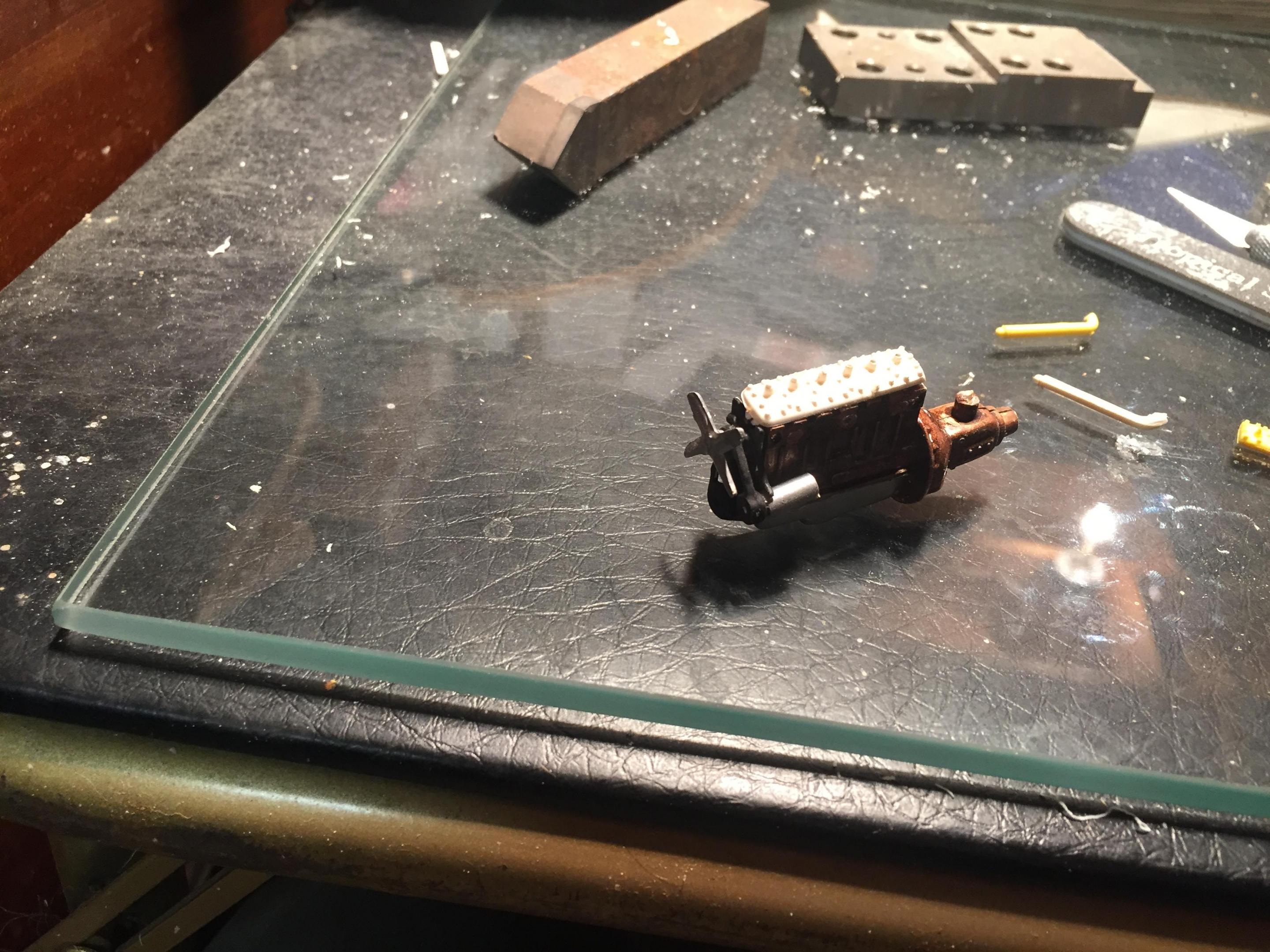

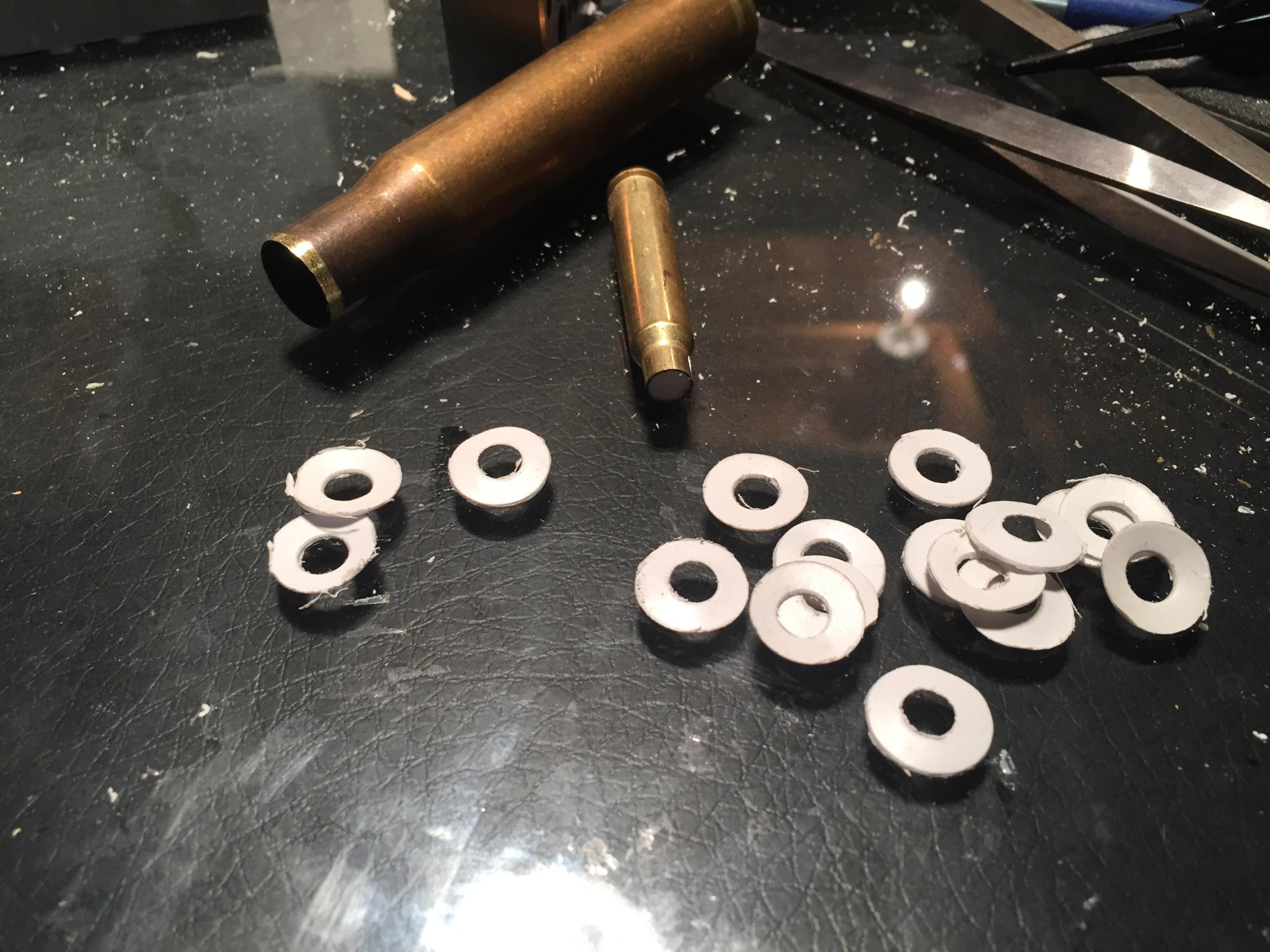

Got the right hand crawler frame done.  Then it was on to the feed auger, right hand and left hand. This was a bit of a challenge but it came out okay. I used a .50 BMG case to punch out .50 diameter discs and then used a 5.56mm case to punch out the center and assembled them on the center shaft.  Started bashing together a Continental F244 flathead six power plant.  This build is a huge challenge as it is a very large number of subassemblies with seemingly zero relationship to each other.  But it's coming along!

Outstanding work  ! I had to chuckle about using 50 bmg for punches , perfect tool for the task
Your auger turned out fantastic,  actually been head scratching about how to make one for sicard blower...and you've done it !

When you own and run a gun shop, you have all sorts of interesting bits and pieces around!  Racked my brain how to get 1/2" diameter discs and bingo, it just popped into my head!
The auger was actually not hard to make though I had to give it a lot of thought and look at real 1:1 augers.  I made the discs as noted and used a proper sized tube for assembling the discs onto. I slit the discs as shown. Then giving them a proper twist either left hand or right hand, I put them on the tube. I tacked the first one in place at the very beginning with CA cement and accelerator. Then I twisted it out to the pitch I wanted and attached that end. The next piece was overlapped on the first one about 1/16" and a drop of CA was applied between the two disc edges and clamped with a pair of tiny pliers and accelerator was applied. I proceeded on to the end of the auger in this manner, rinse and repeat, until I got the length I wanted and then made a mirror image. I then went back and added more CA as needed to make it permanent. Only glued my fingers together once! Pretty happy with the way it came out, and if I make another one for something in the future, it will be all that much easier!

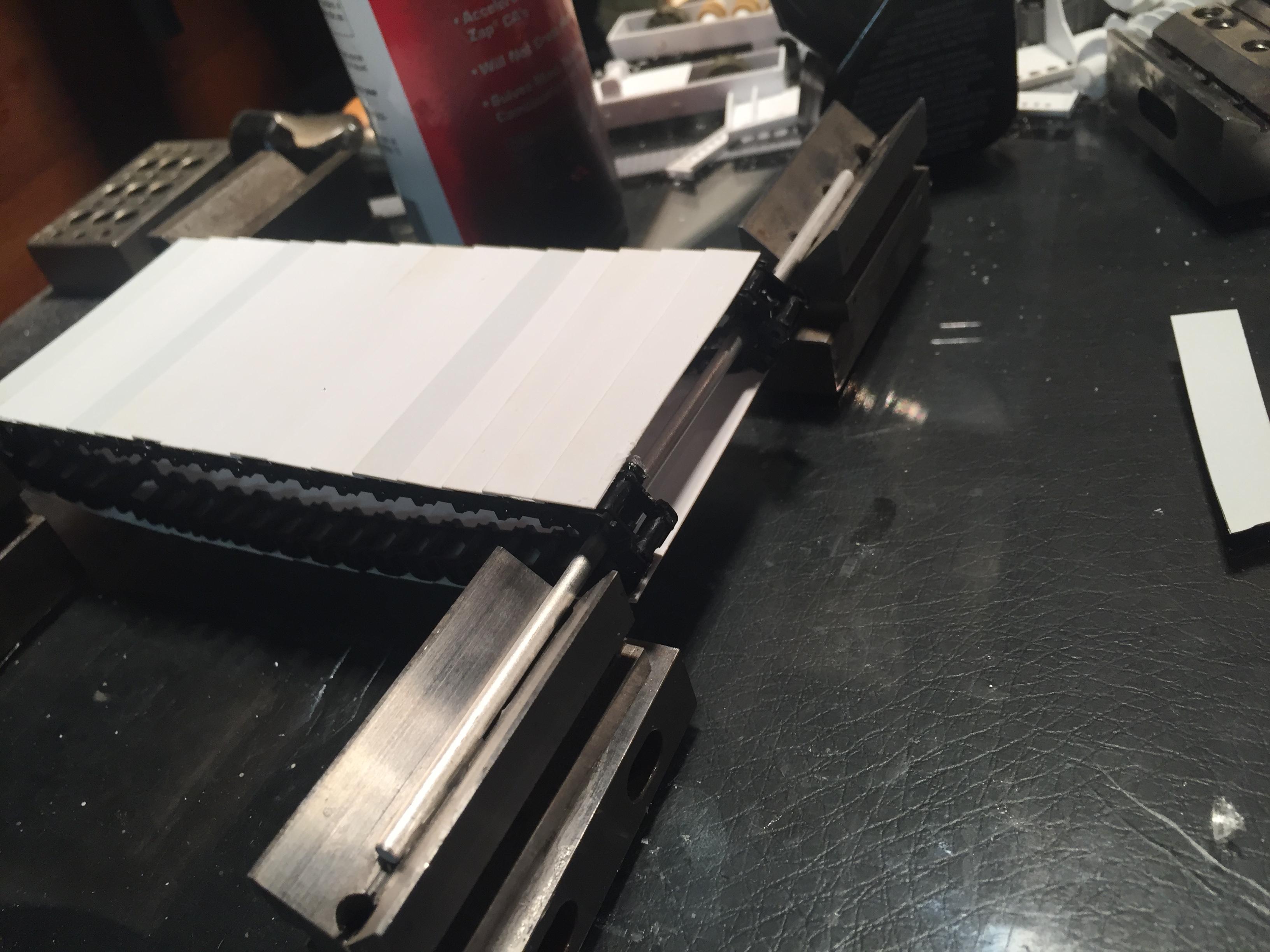

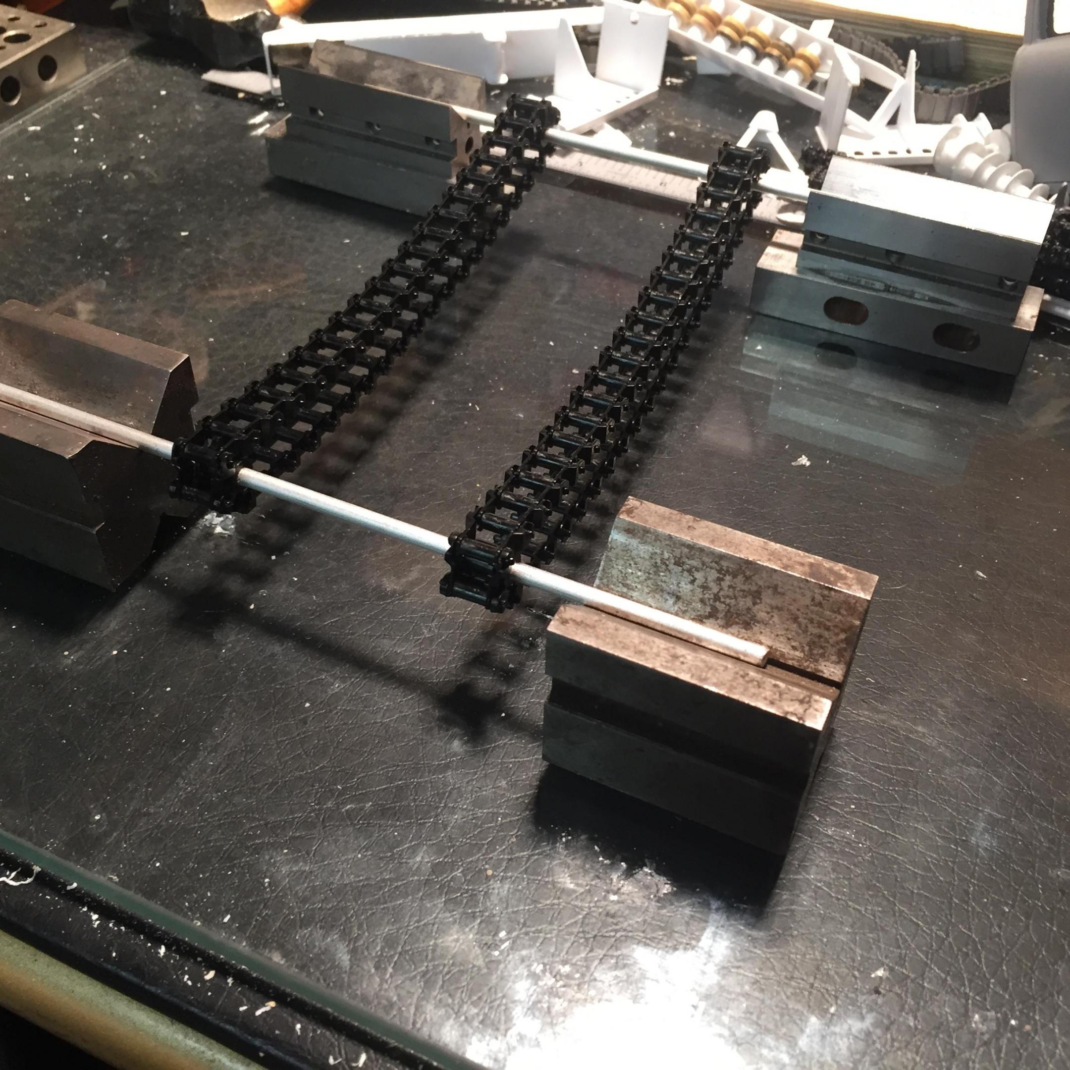

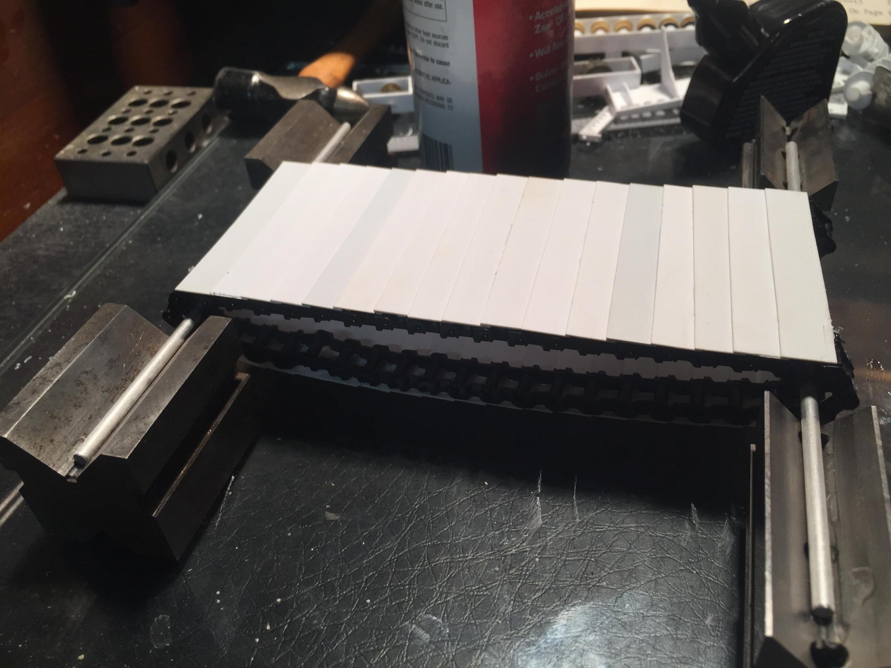

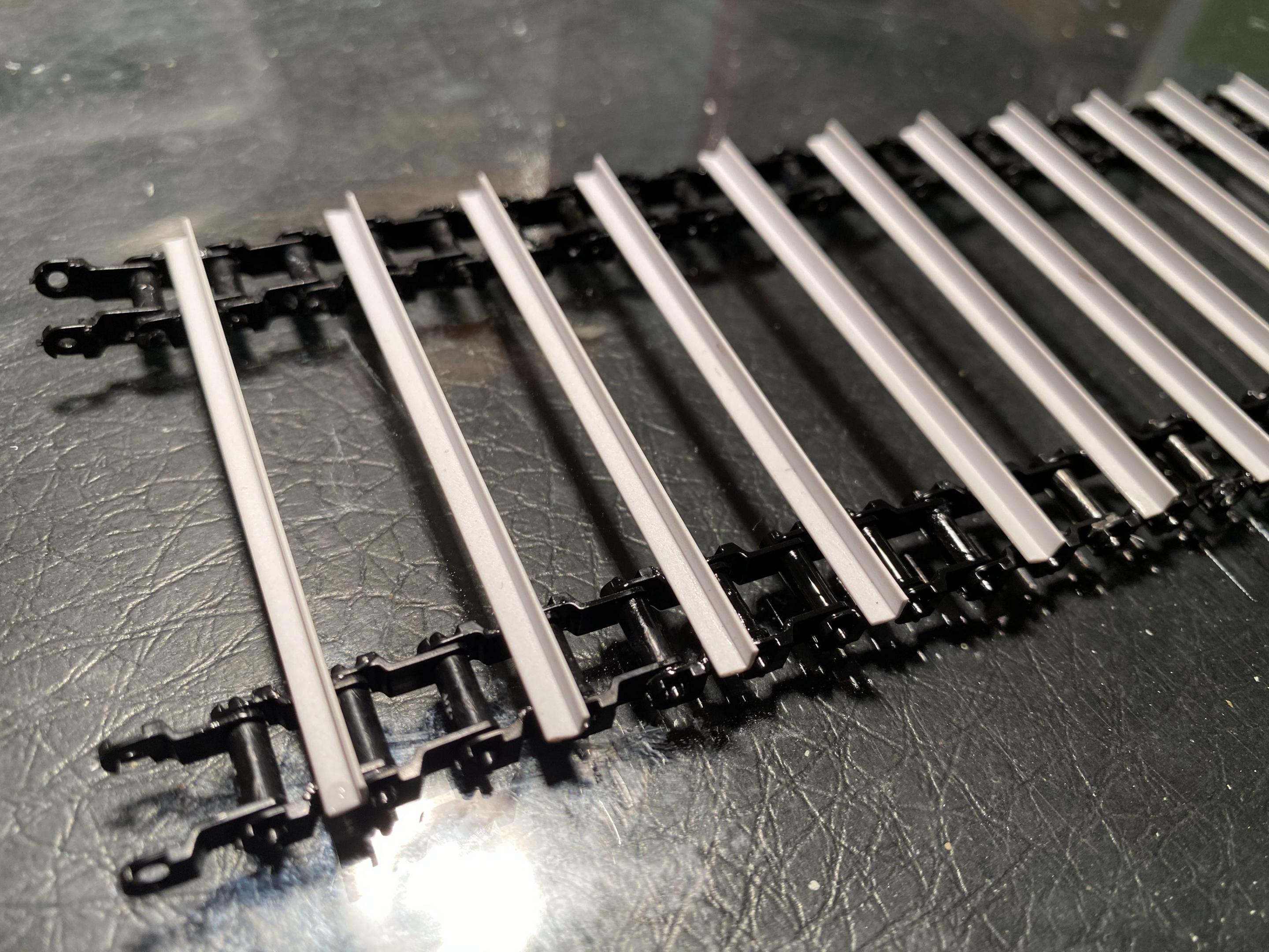

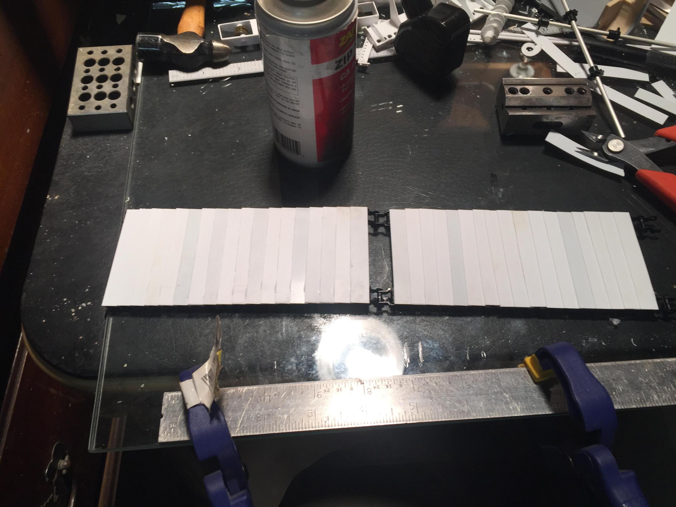

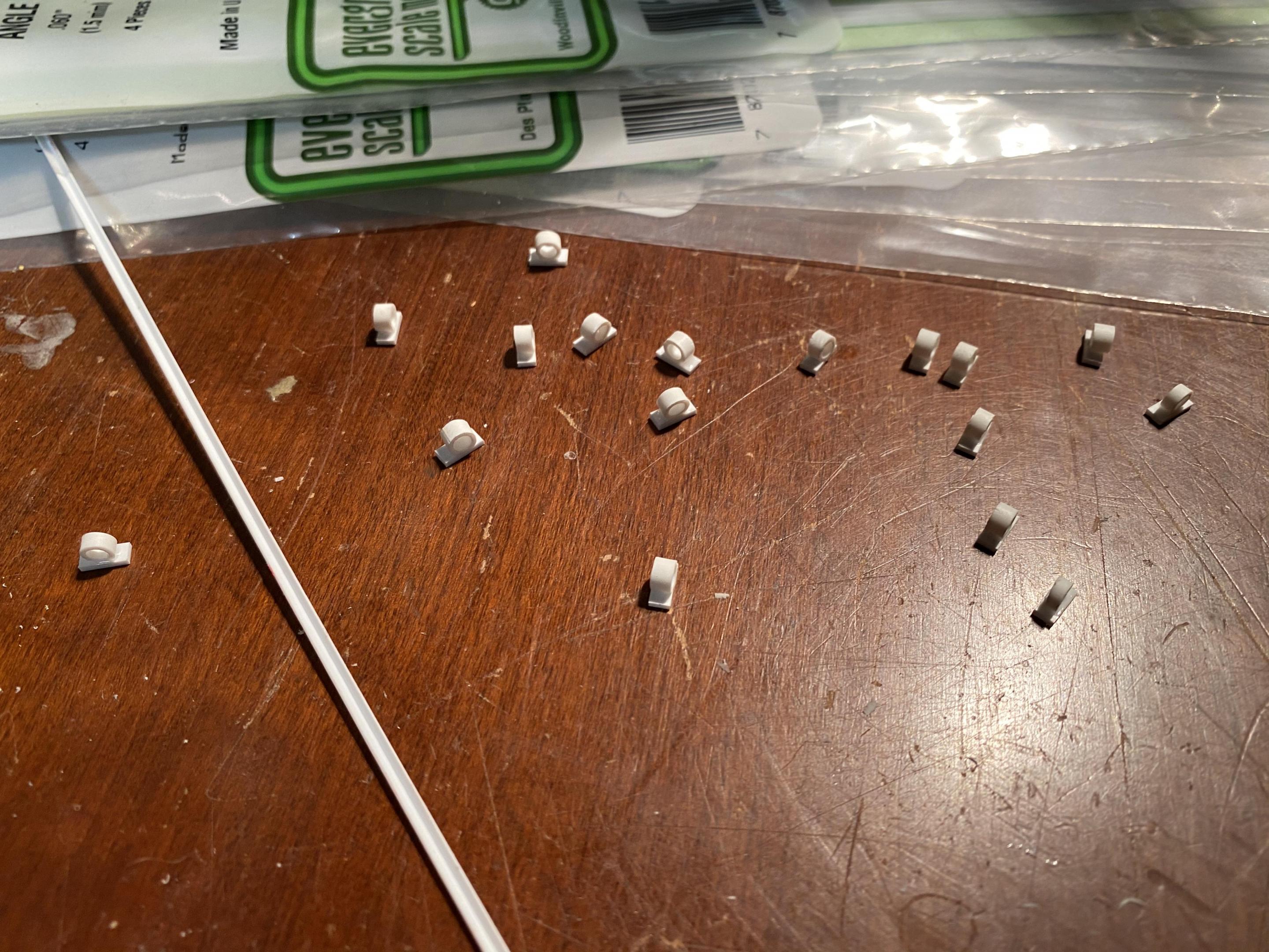

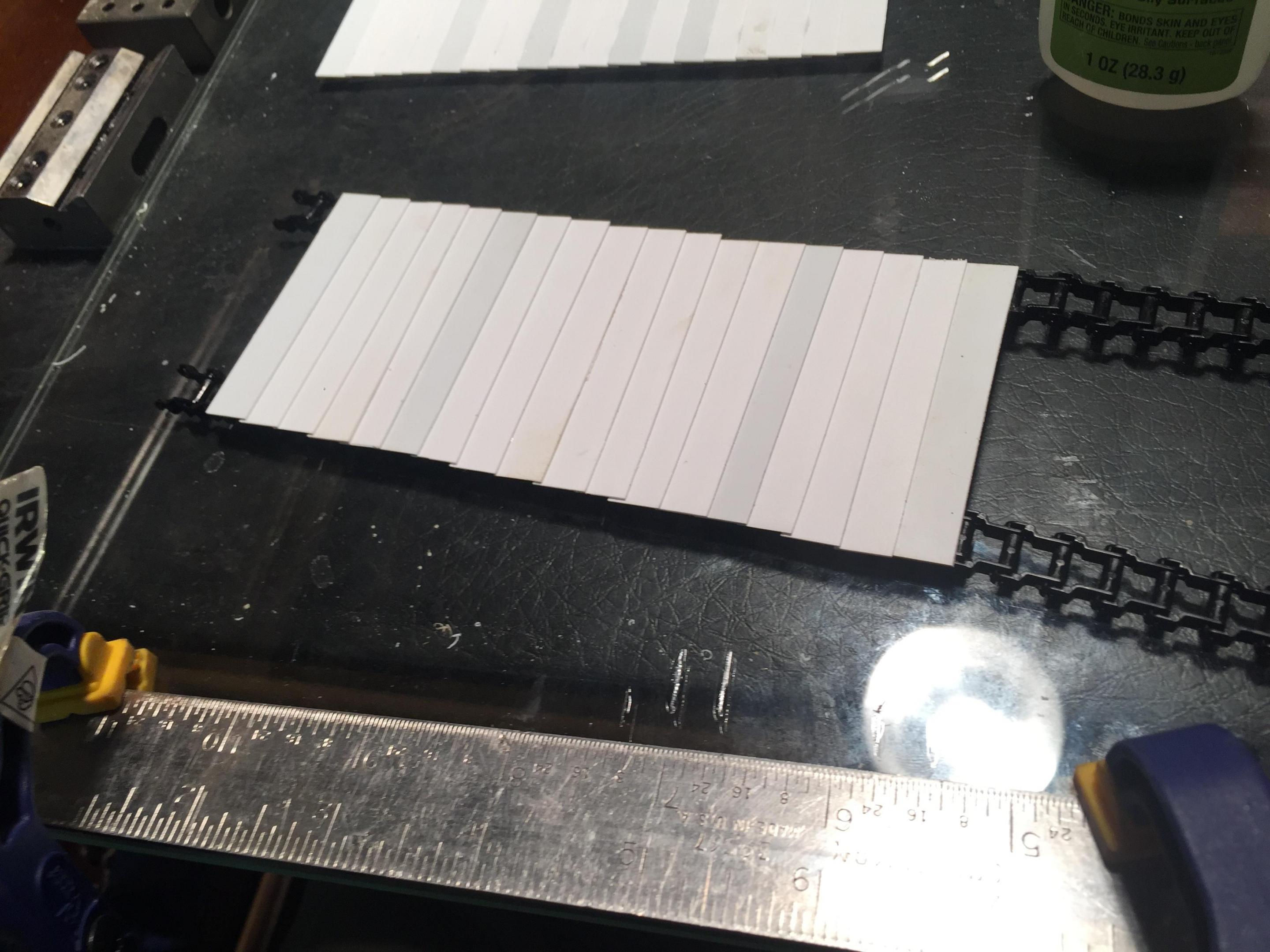

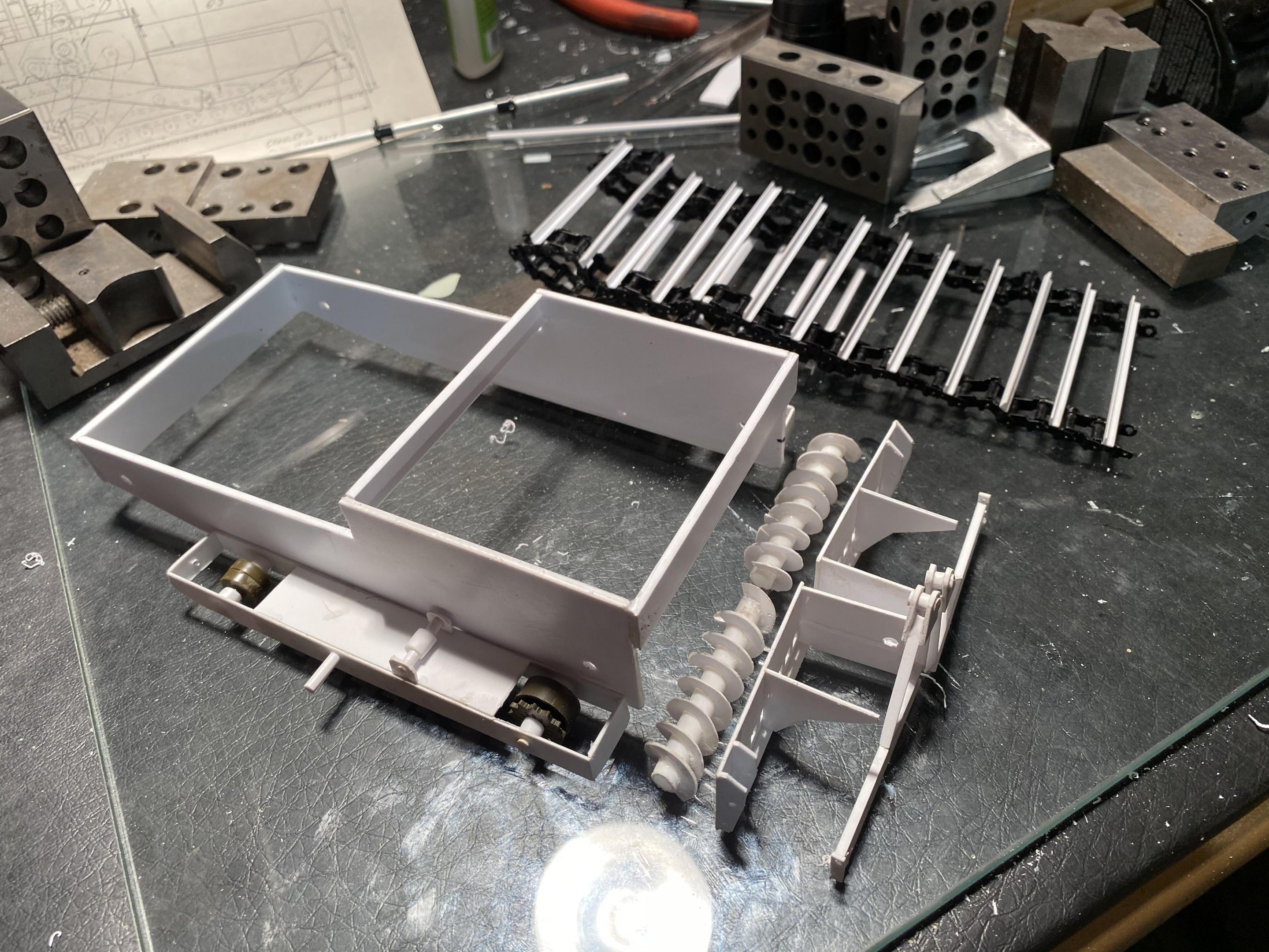

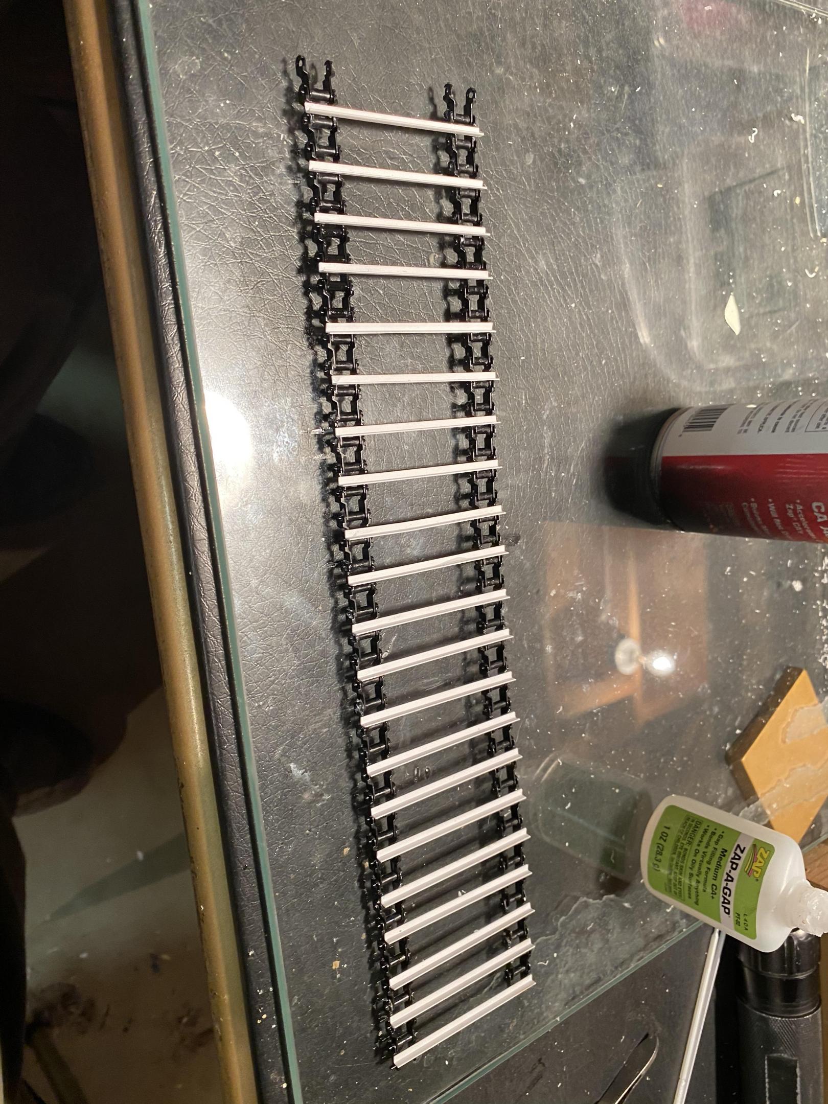

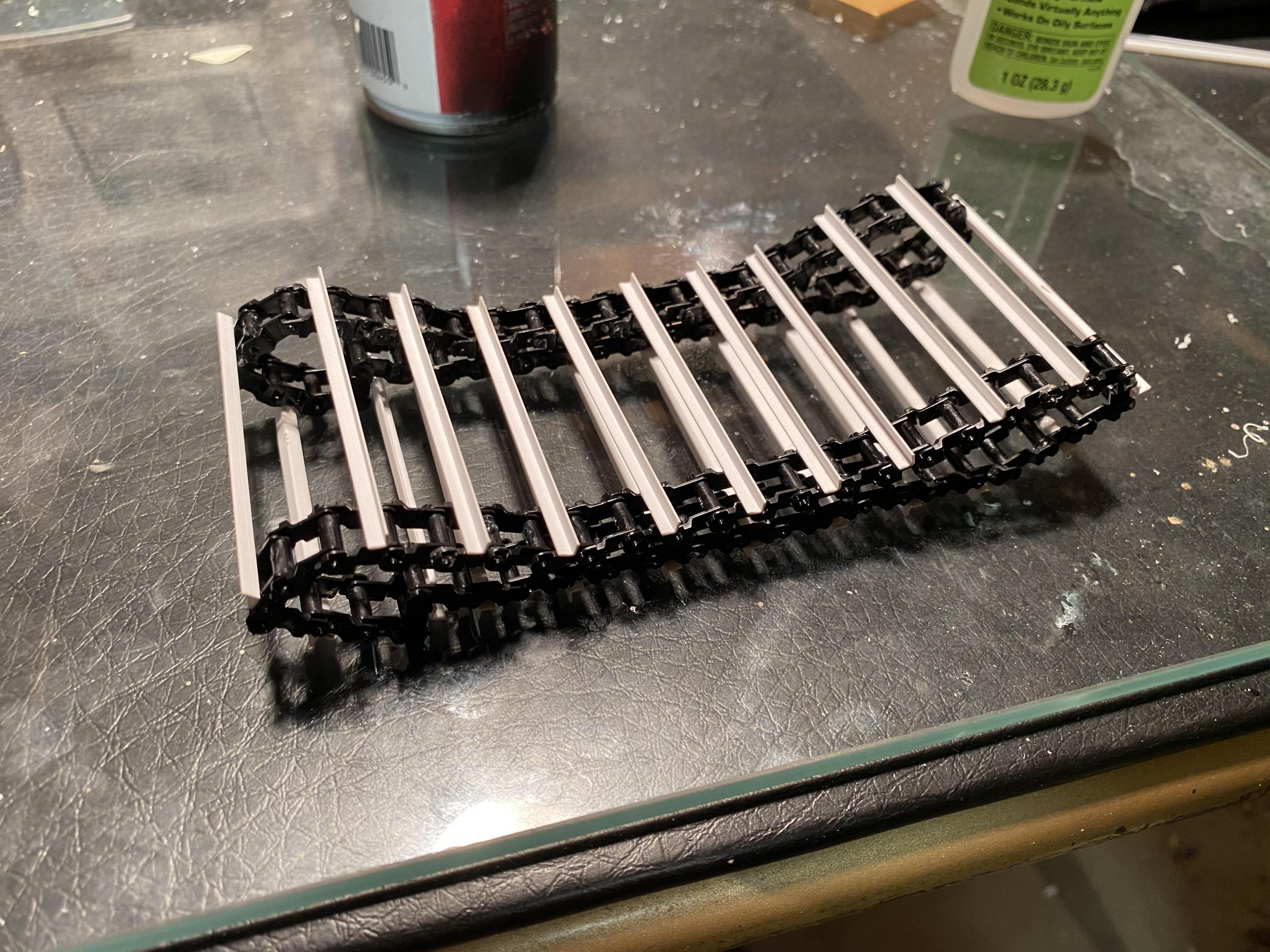

Worked on the feed conveyor today. Am trying three different designs.  For the very old metal slat style,  I used a chain assembly from a Tamiya RC truck as the conveyor chain. Sprockets from MicroMark on 1/8" aluminum rod and overlapping slats attached, and it looks pretty good.  Will attach the end slats at the sprockets at final assembly.  For the second type will use drag bars instead of slats. For the newer design, I will do a rubber belt. How they come out will determine which I use. Getting there!

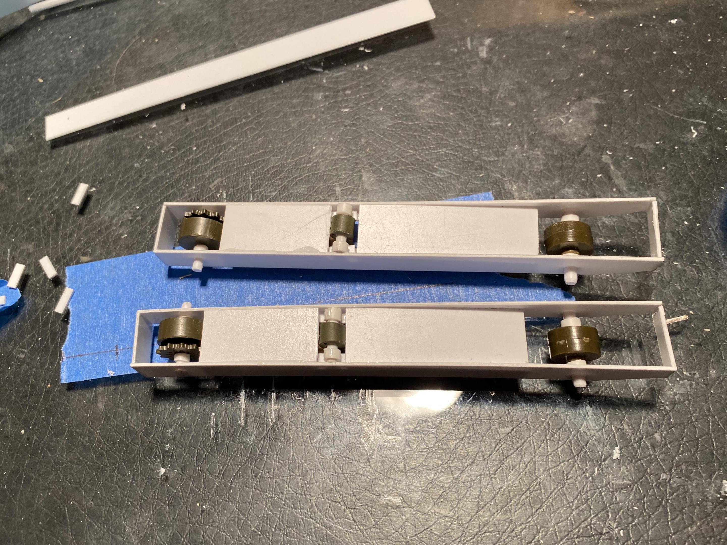

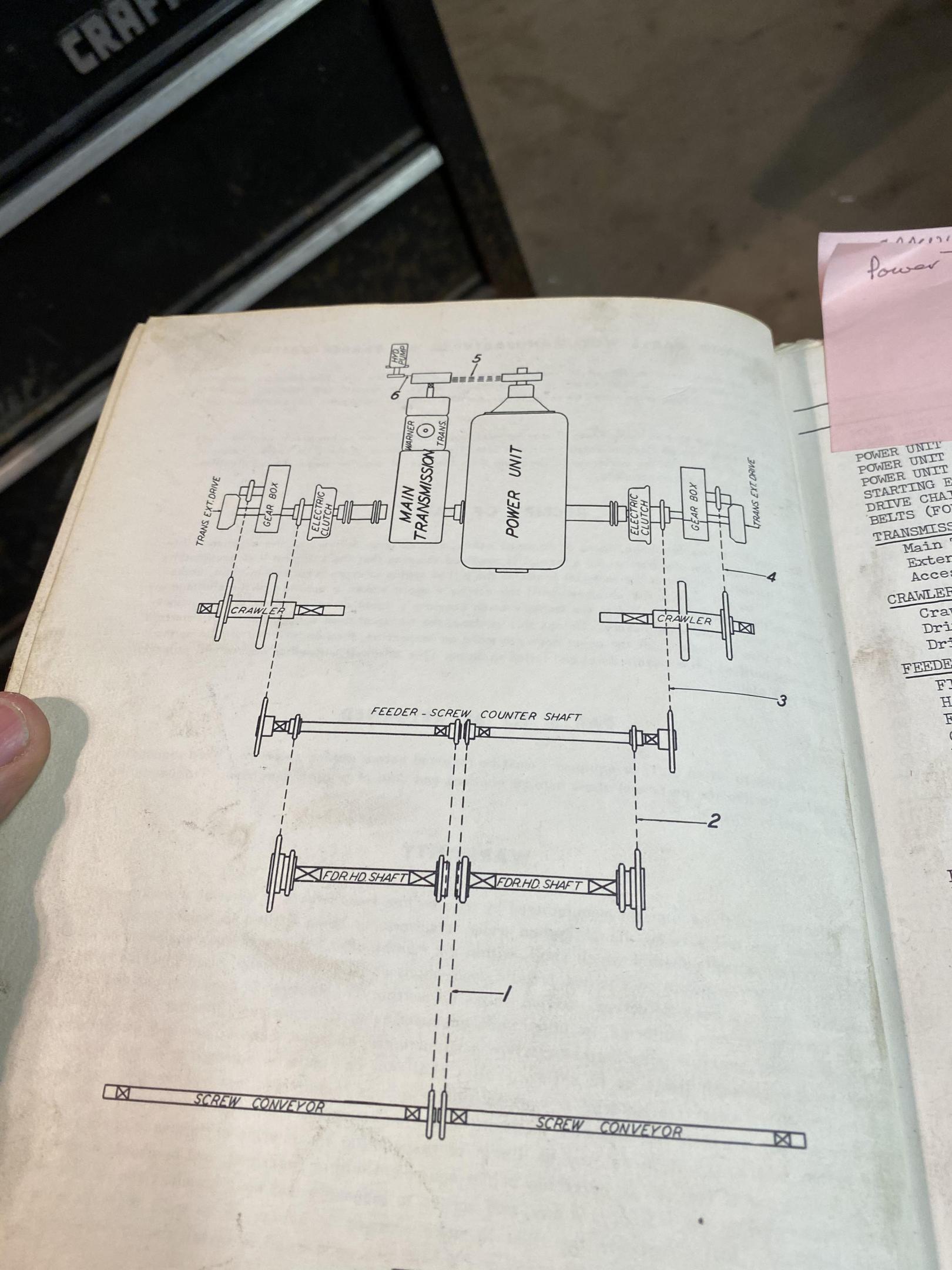

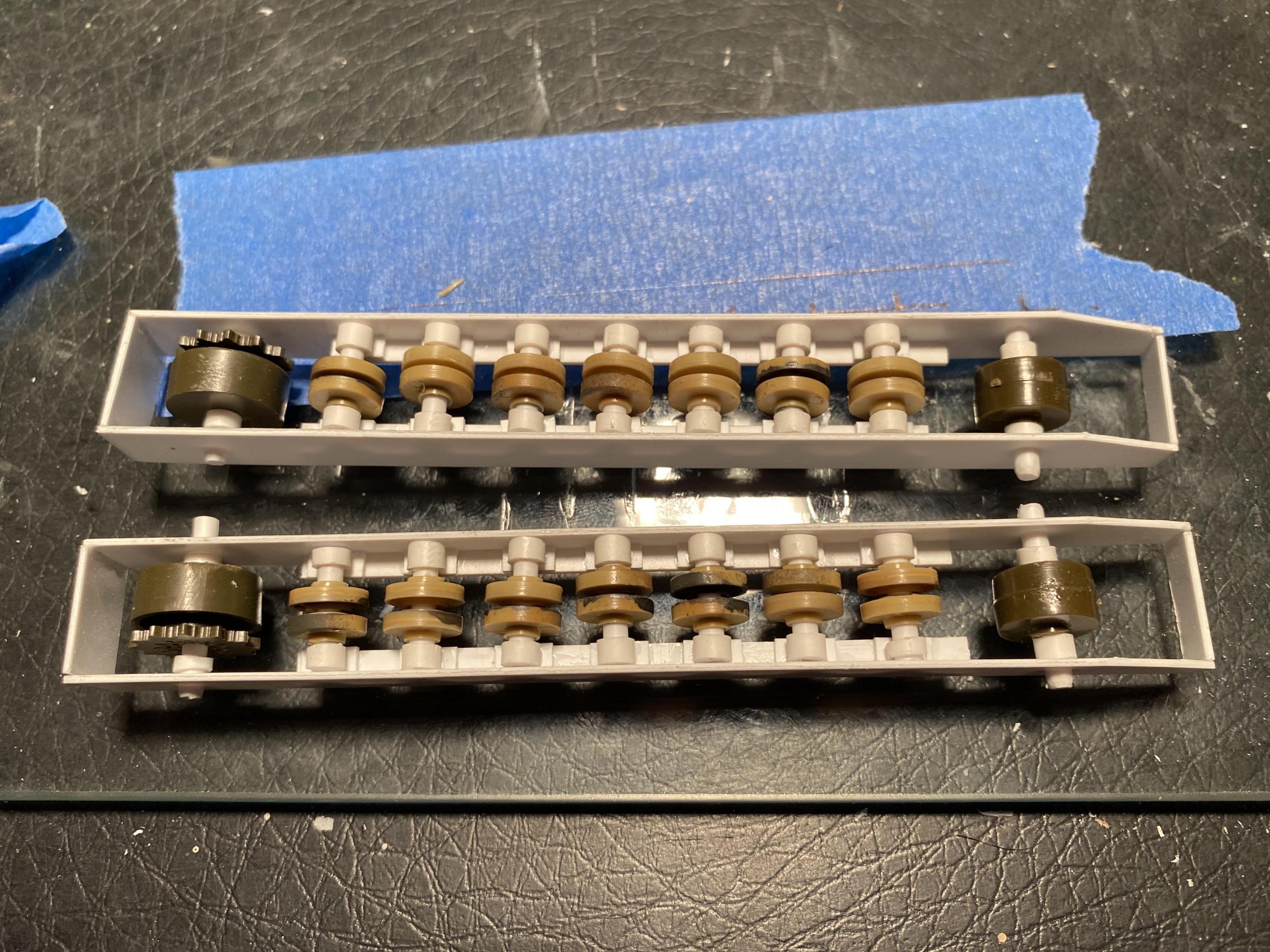

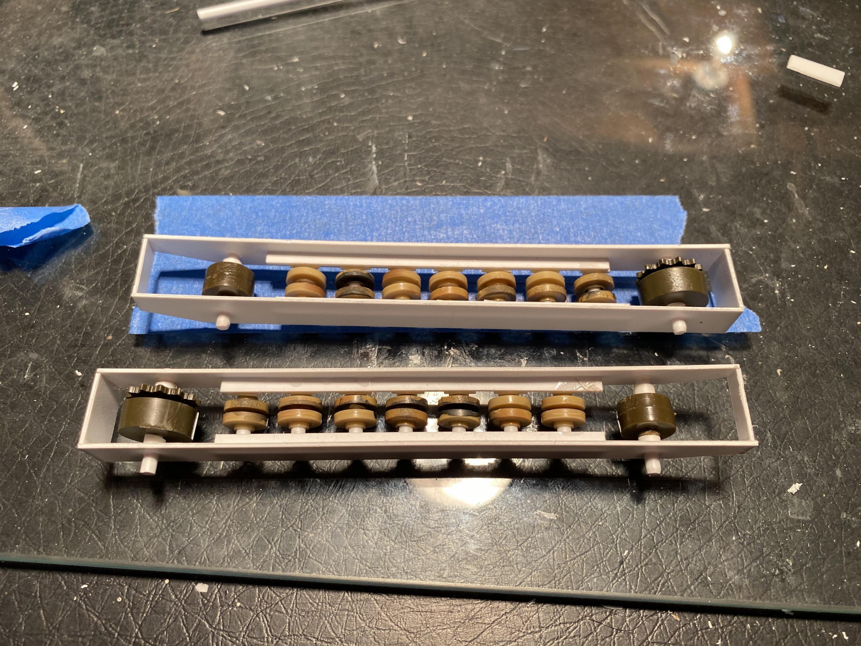

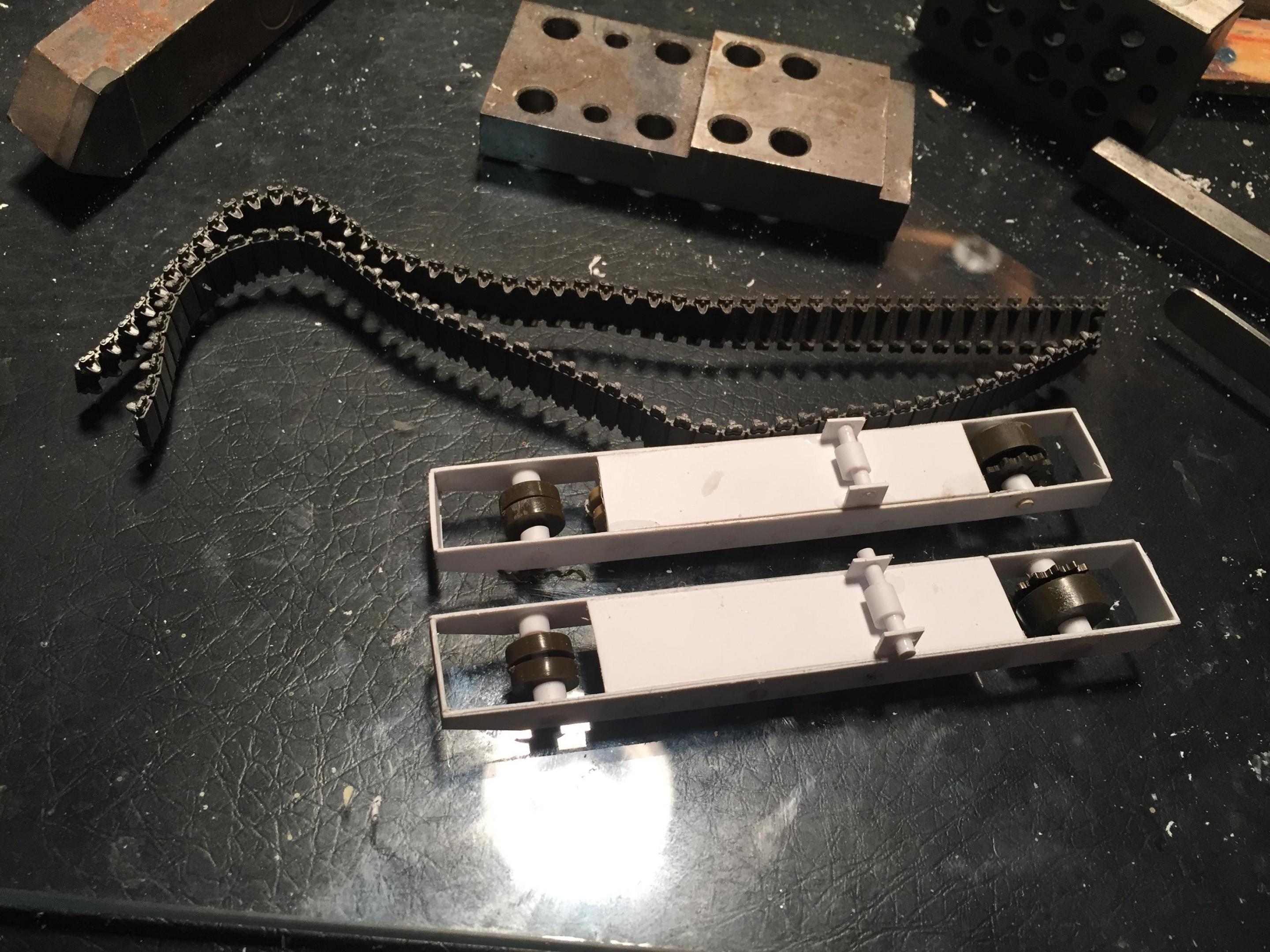

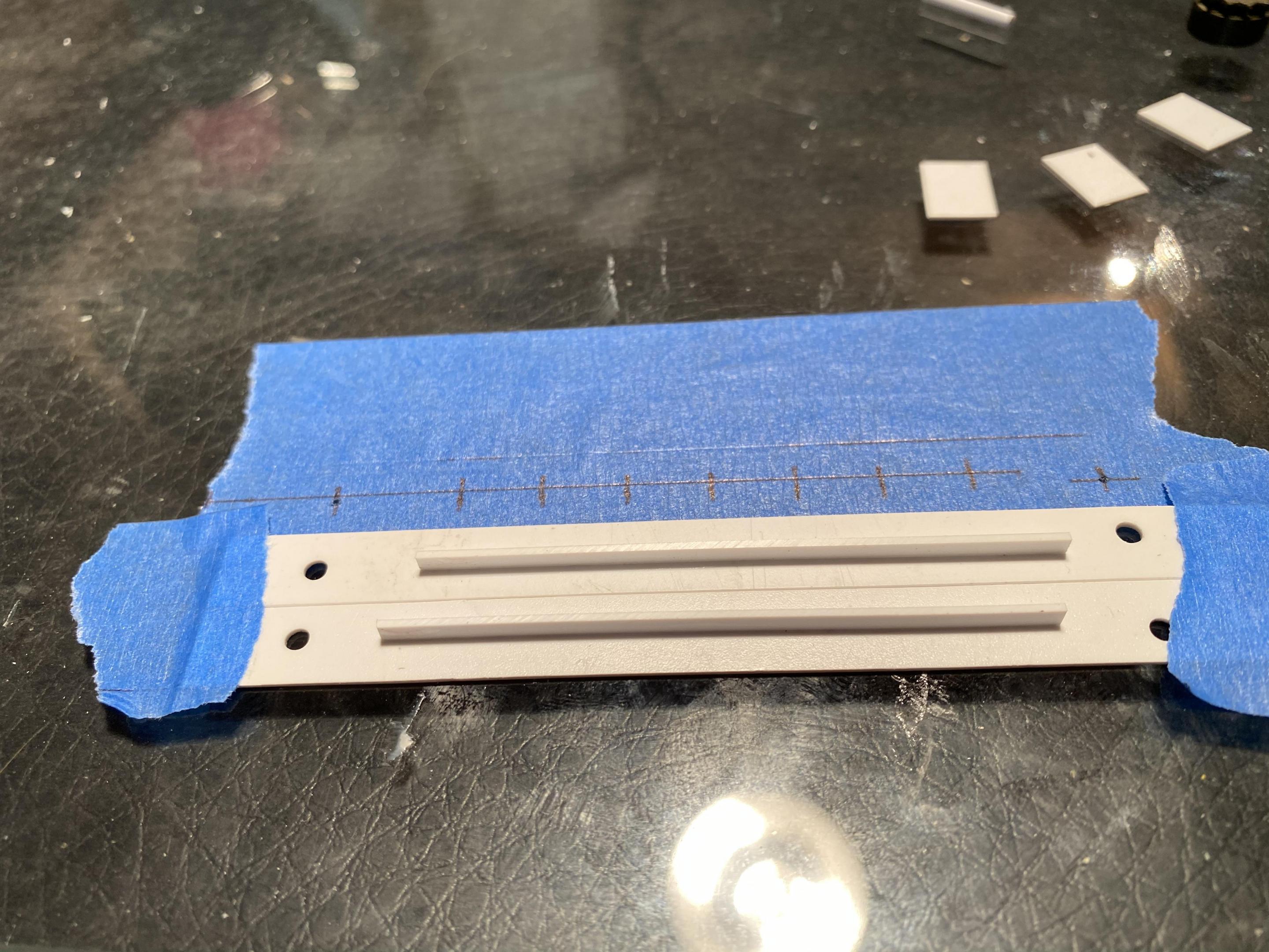

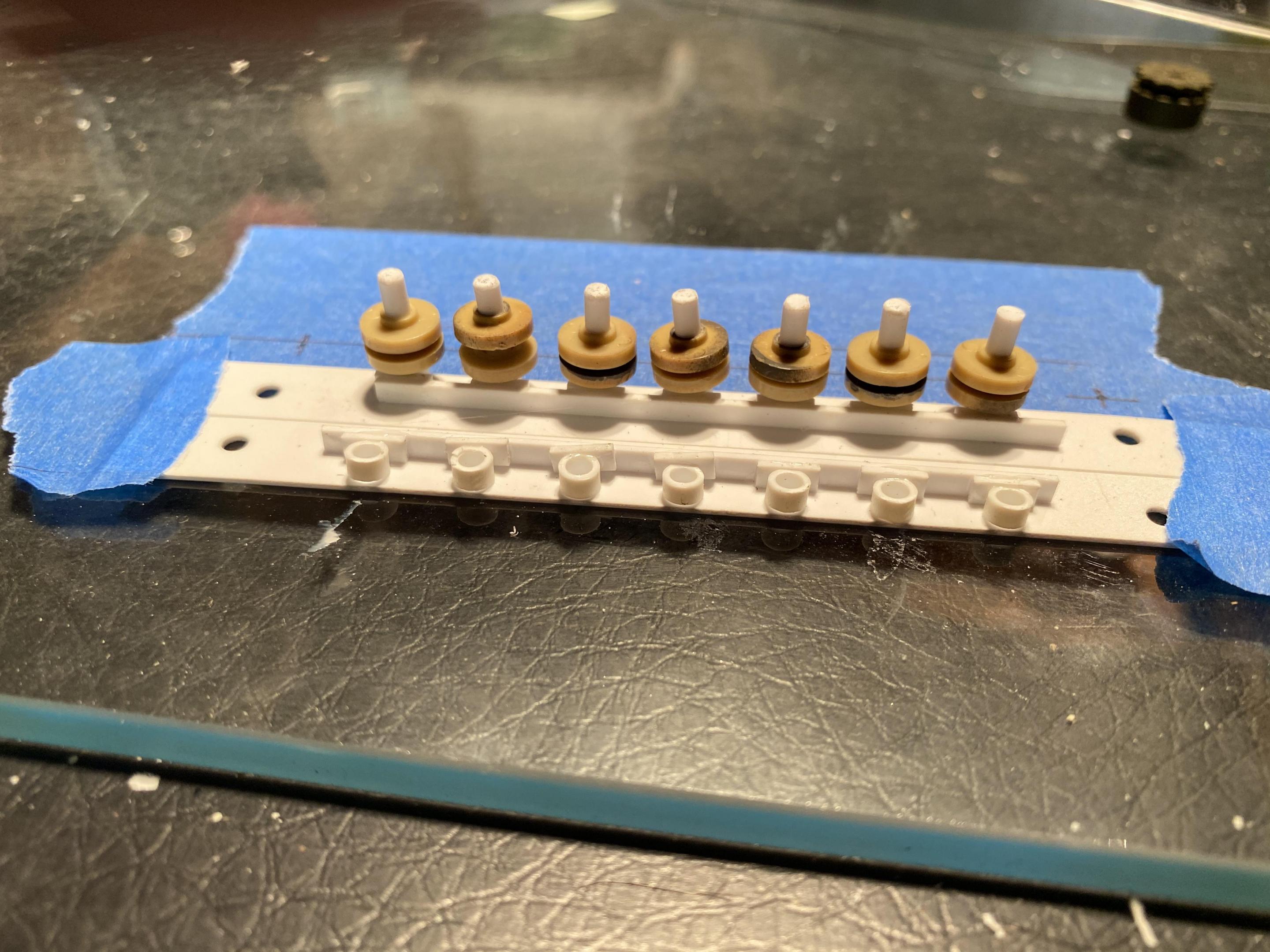

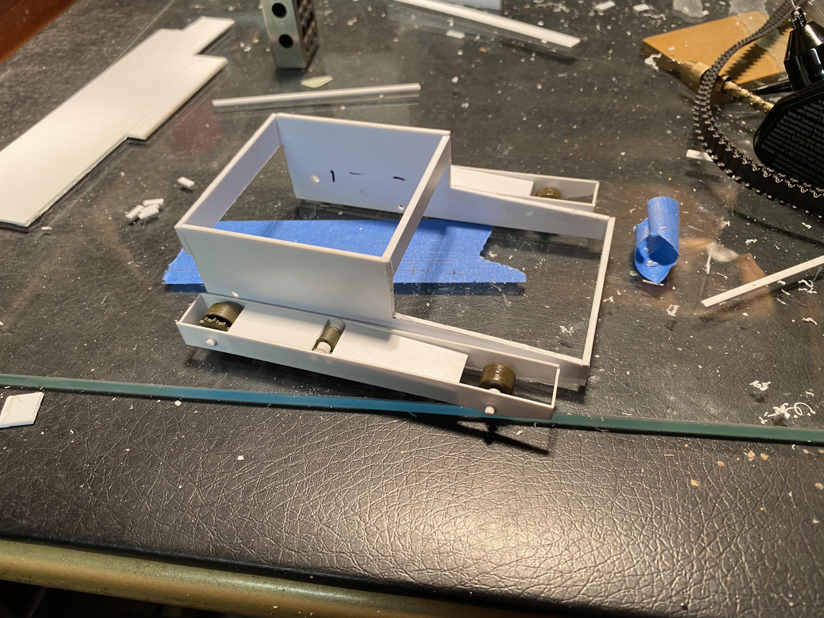

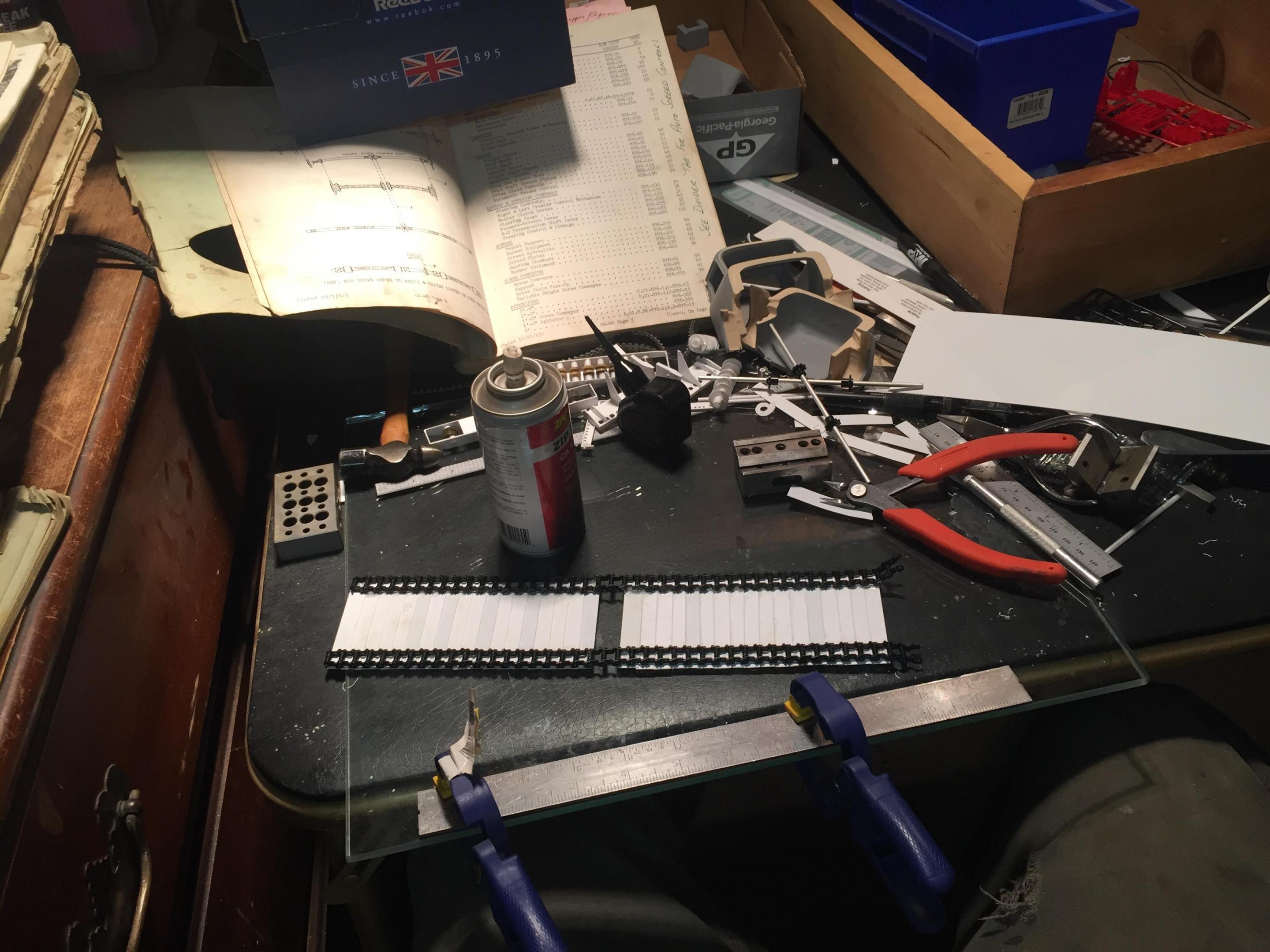

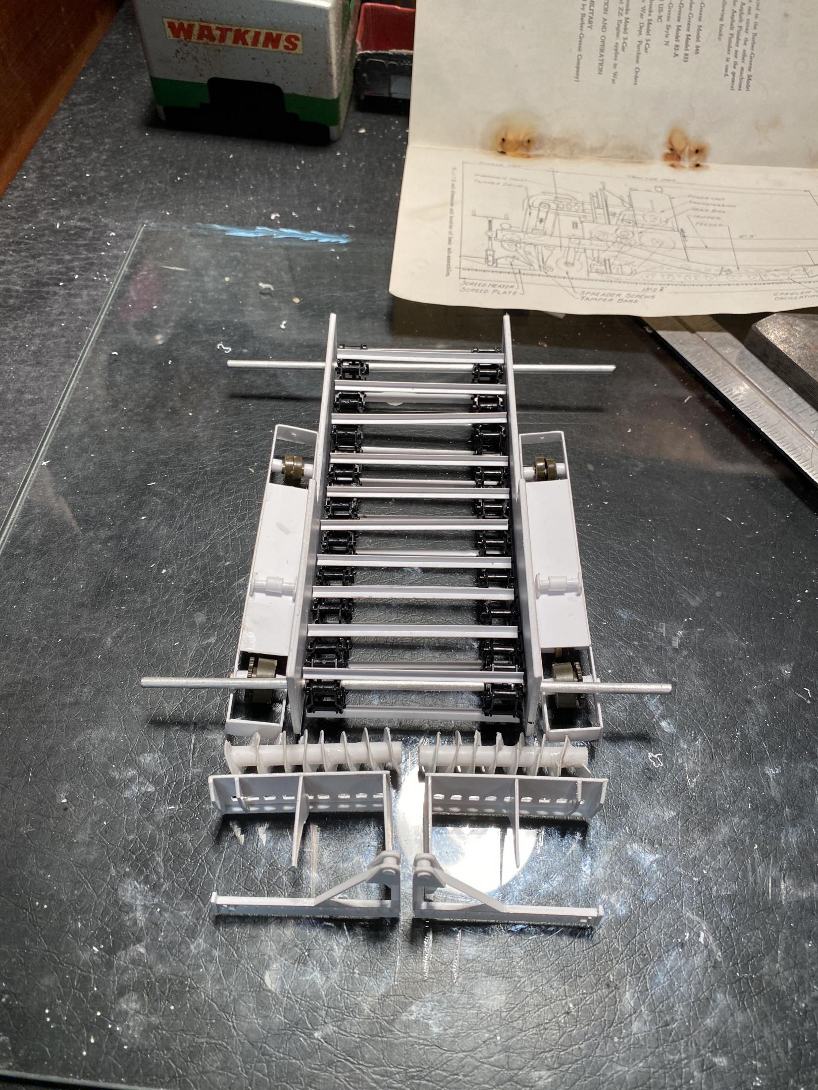

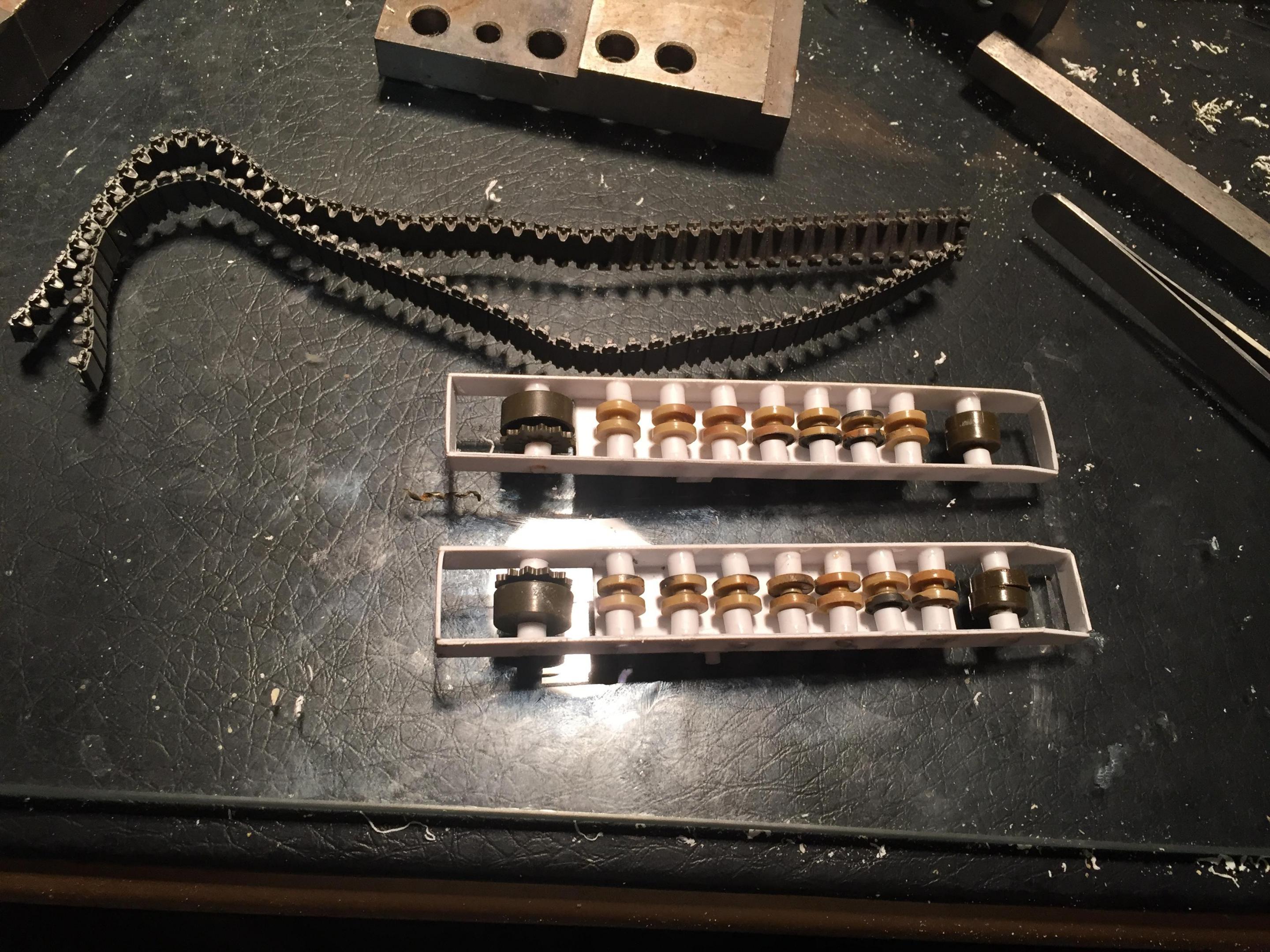

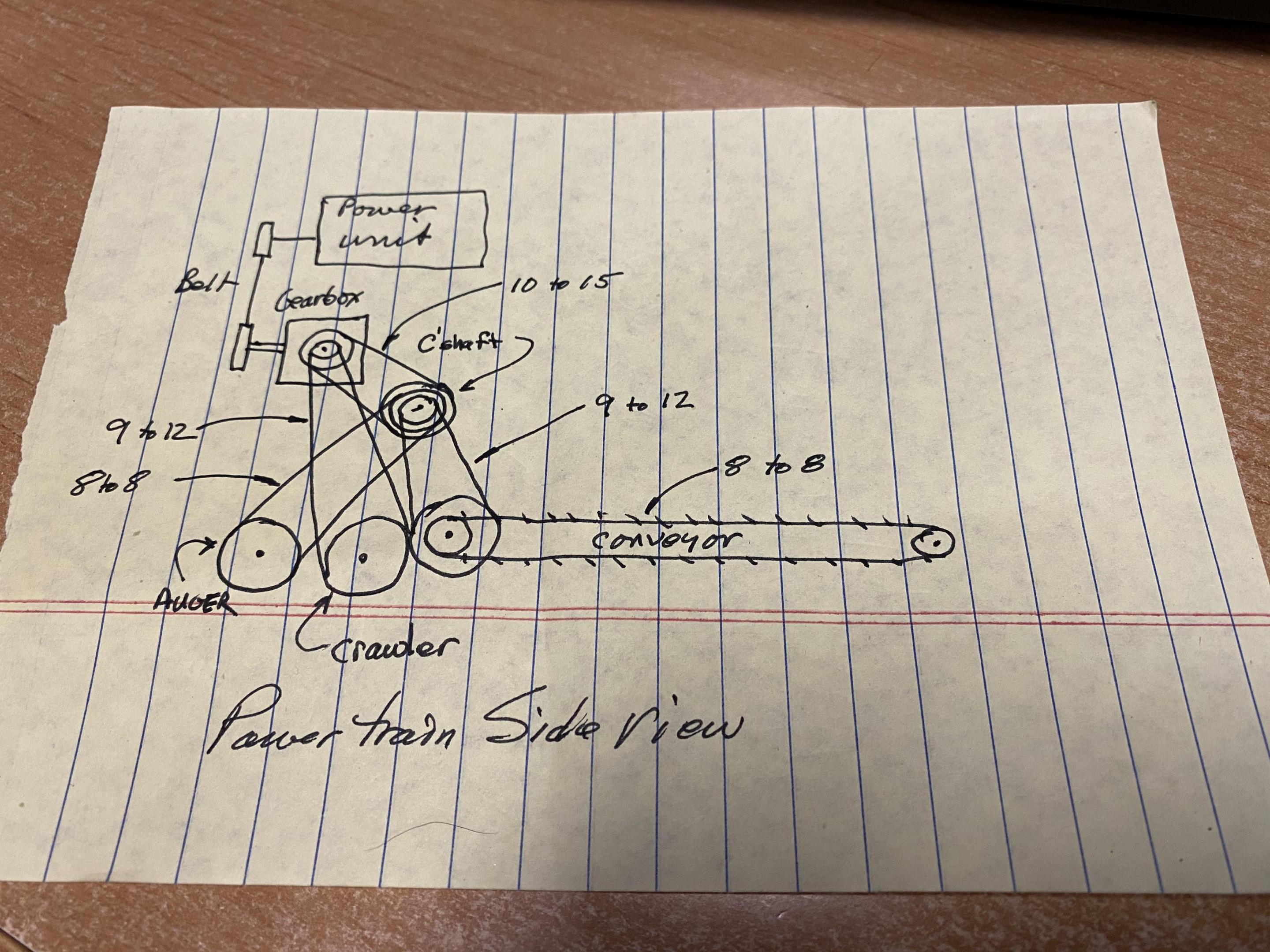

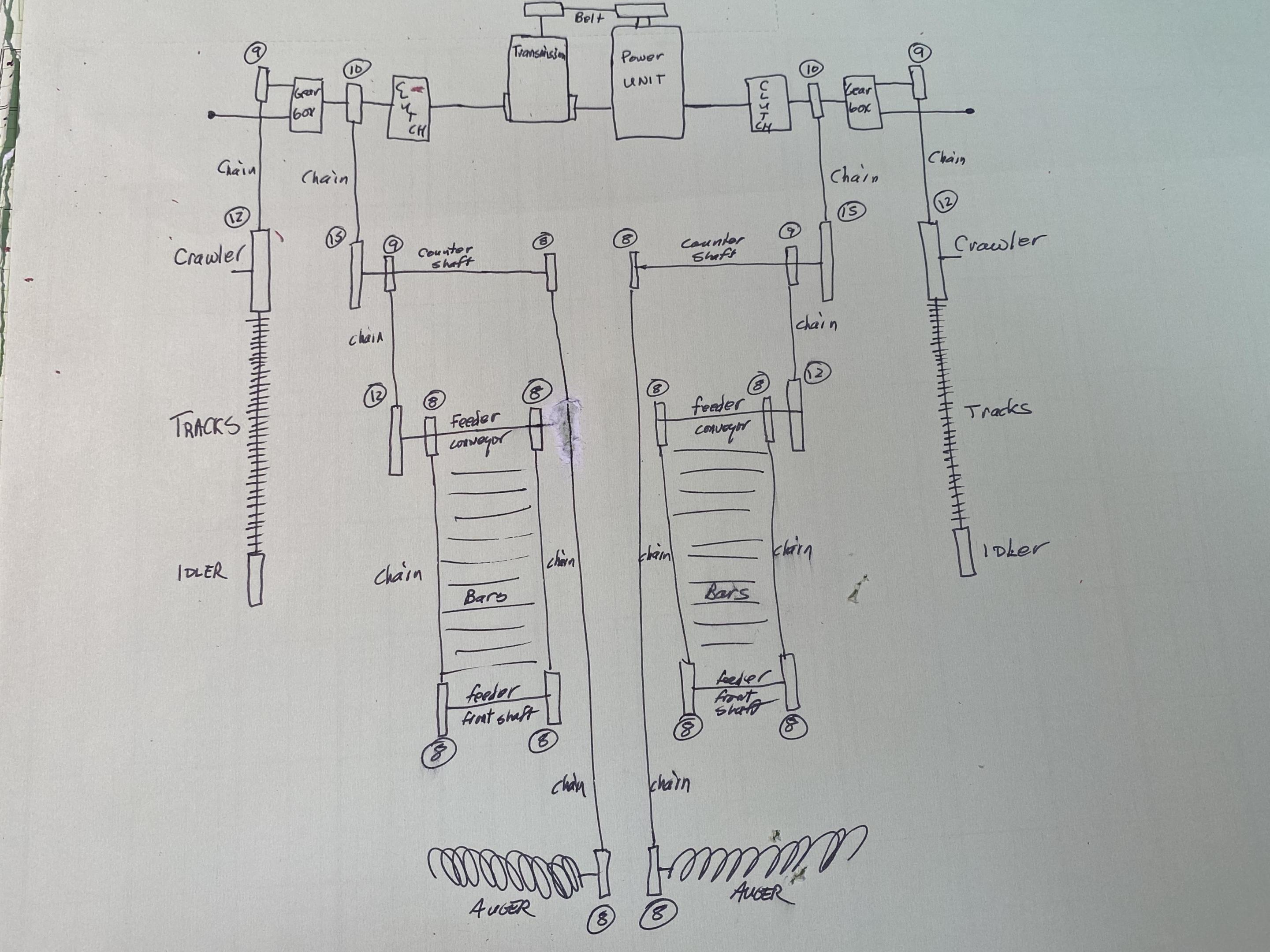

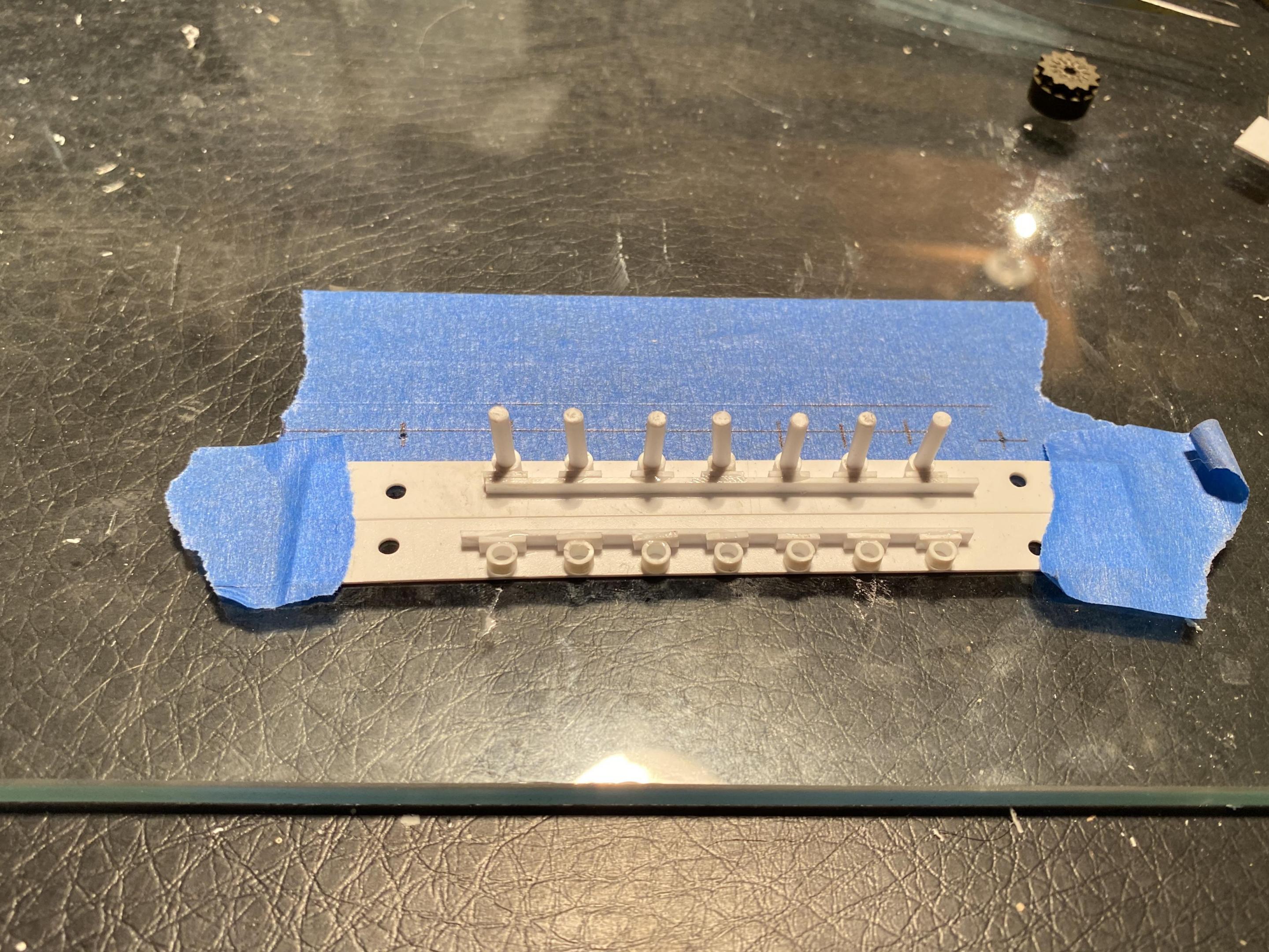

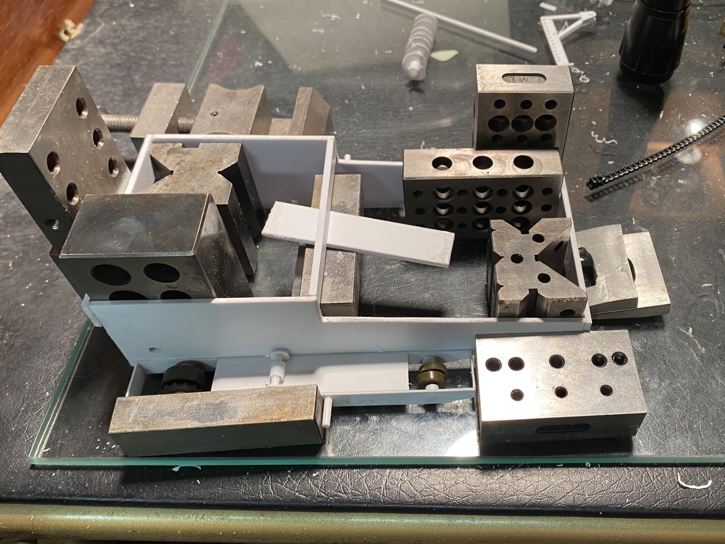

Well, those of you who have seen my “on the workbench” projects before, know that I very often take about two steps back for each step forward until I get well along in the build. So, not to disappoint, I just took a BUNCH of steps backwards! I was simply not happy with the drag bar feed conveyor as it was sorely out of scale.  So, I took a step back and decided to use chain that will be more in scale, that Charlie Rowley told me about.  It will be a real chore to attach the drag bars but it will look SO much better.  Then, when I made THAT adjustment, I made the main frame more to the proper scale as well.  Then to just add a bit of excitement to the mix, I rebuilt the crawler frames to use miniature pillow blocks just like the real deal, instead of simple shafts stuck to the side plates.  So...... here is the updated main frame, and the new crawler frames.  Also shown is the power train diagram with all of the gearboxes, clutches, shafts and countershafts, sprockets and chains and the feed conveyor, augers, crawlers etc.  Needless to say, a pretty complex build.

Charlie, now I don’t feel so bad, seeing as even the best has the same issues!! Of course, PART of my reversal was due to finding out about the MUCH more in-scale chains from Micro-Mark from you!  Can’t wait to see that old ‘ Binder in person!
