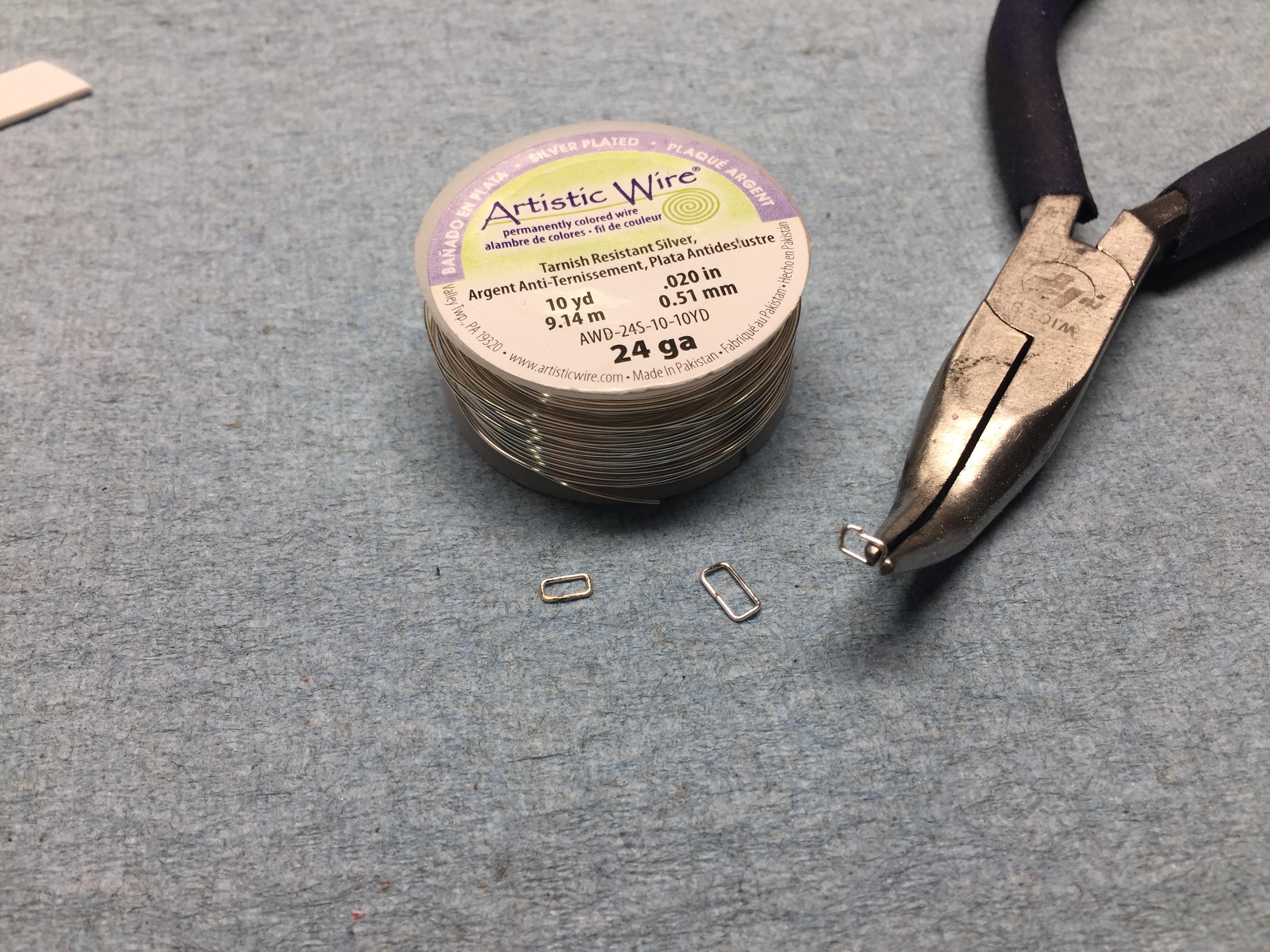

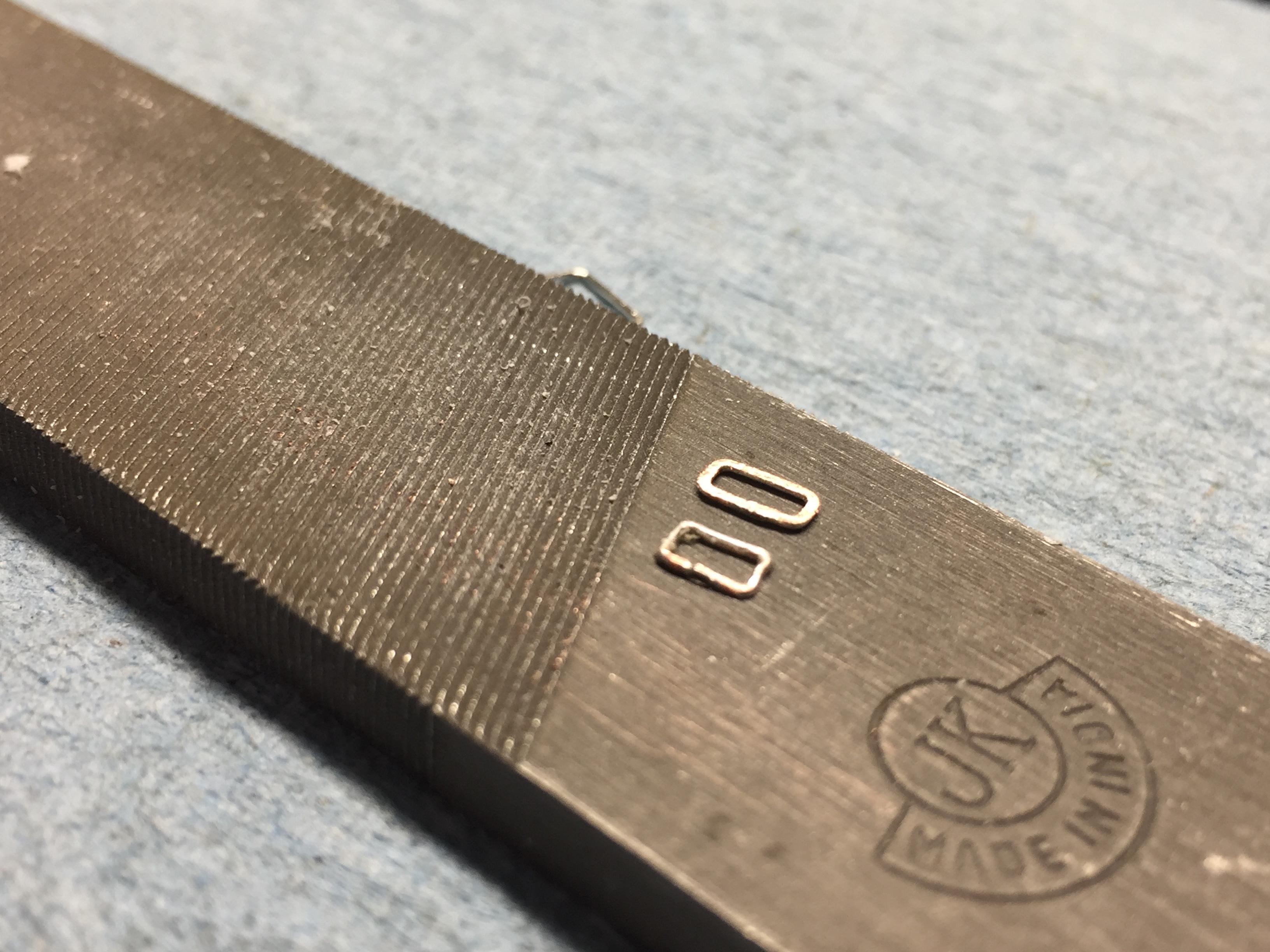

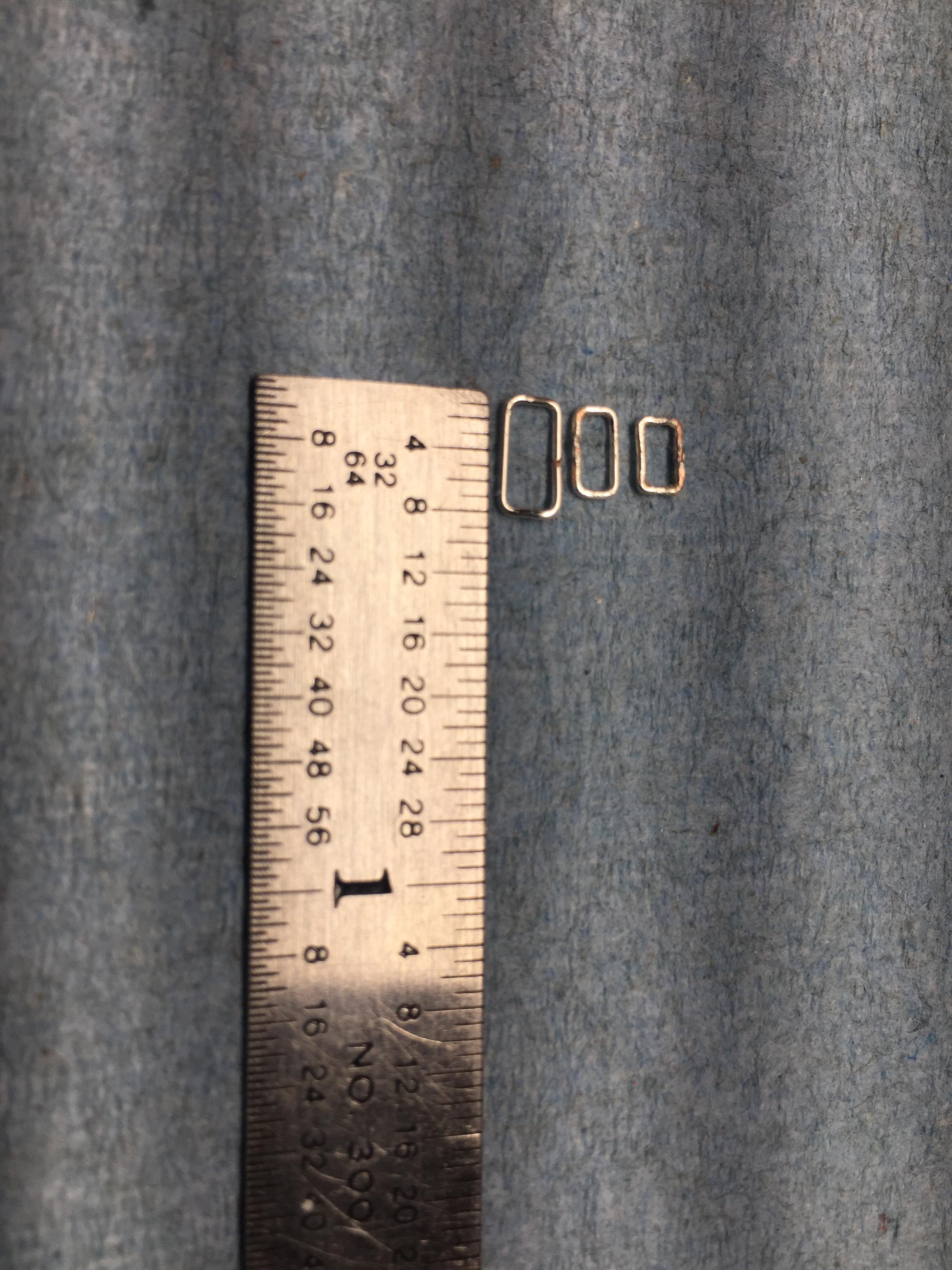

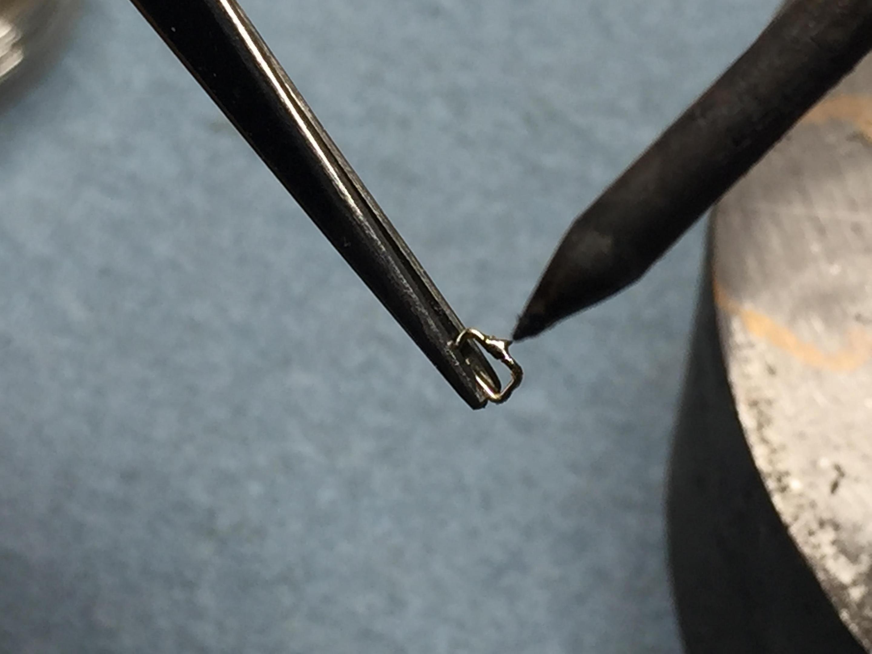

NOBLNG Posted January 17, 2020 Posted January 17, 2020 I recently had to make some side marker lights for a mustang build. It turned out well enough that I thought I would share it here. I first made some tiny rectangles out of 24 ga. Artists wire. I soldered the butt seam together and filed it smooth. I then dragged it across a large metal file until I had a half-round profile instead of round wire.

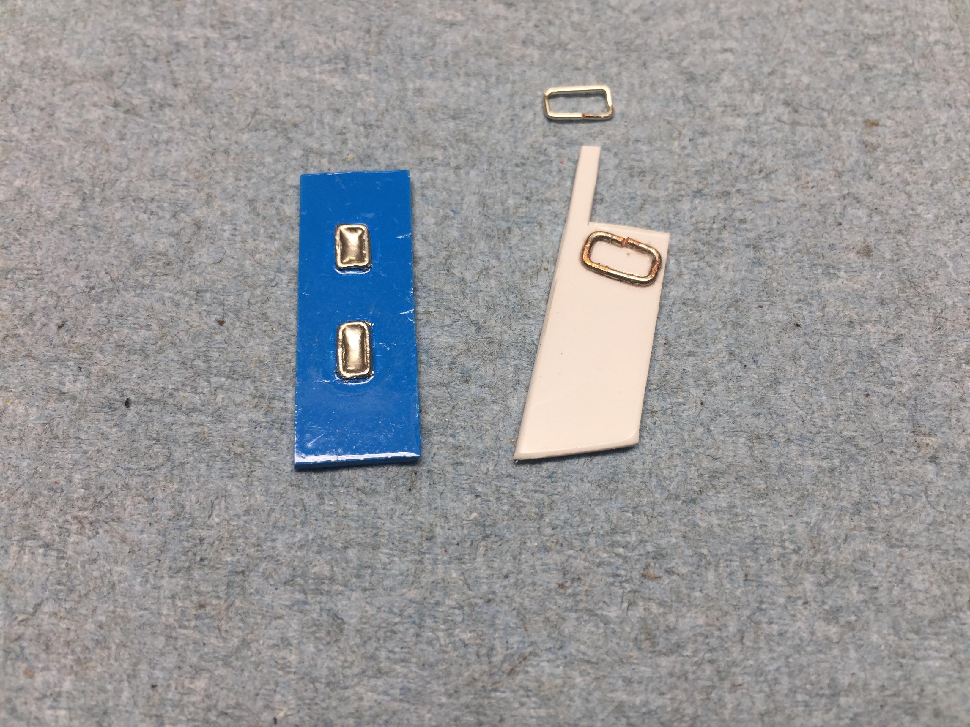

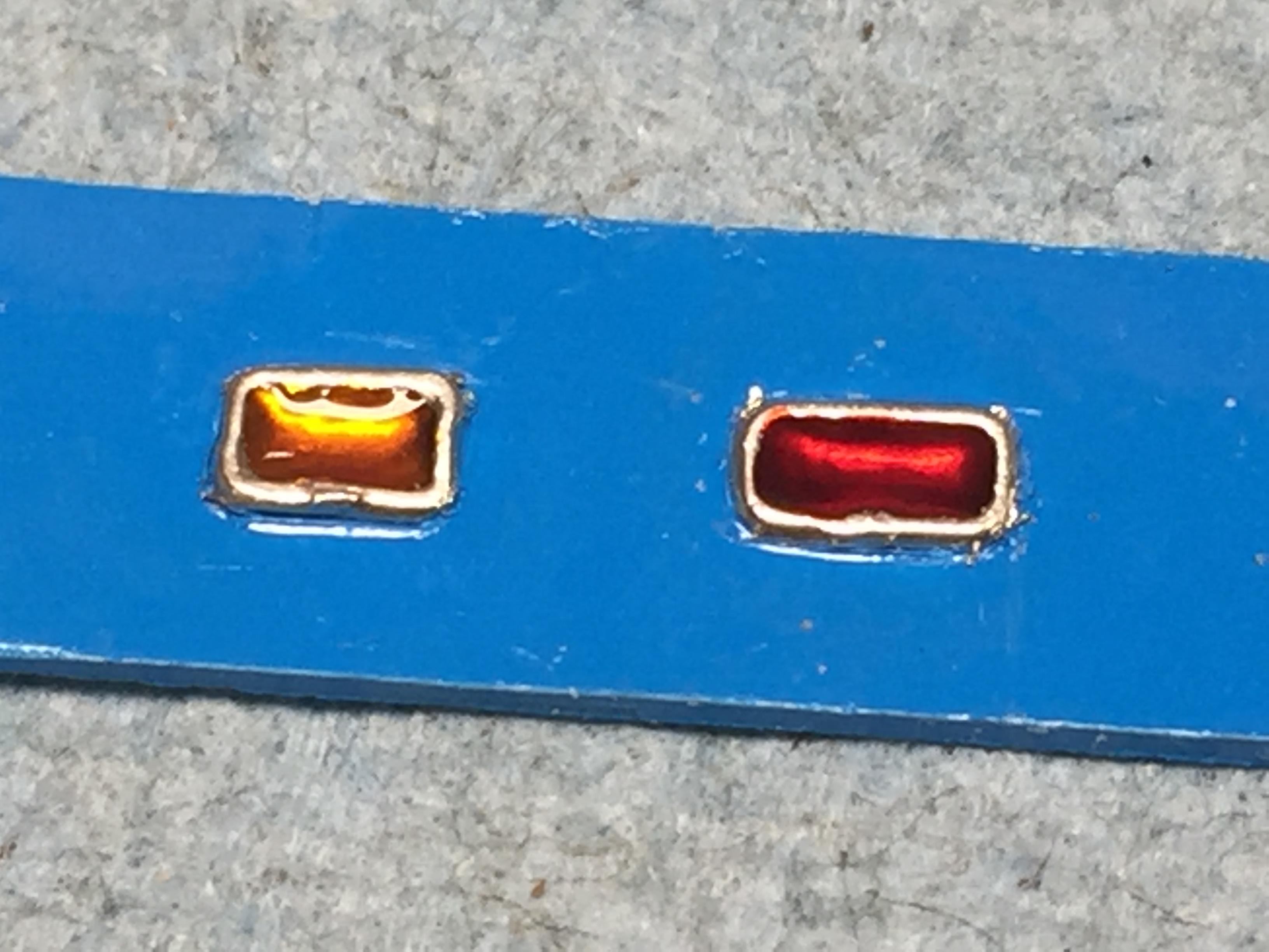

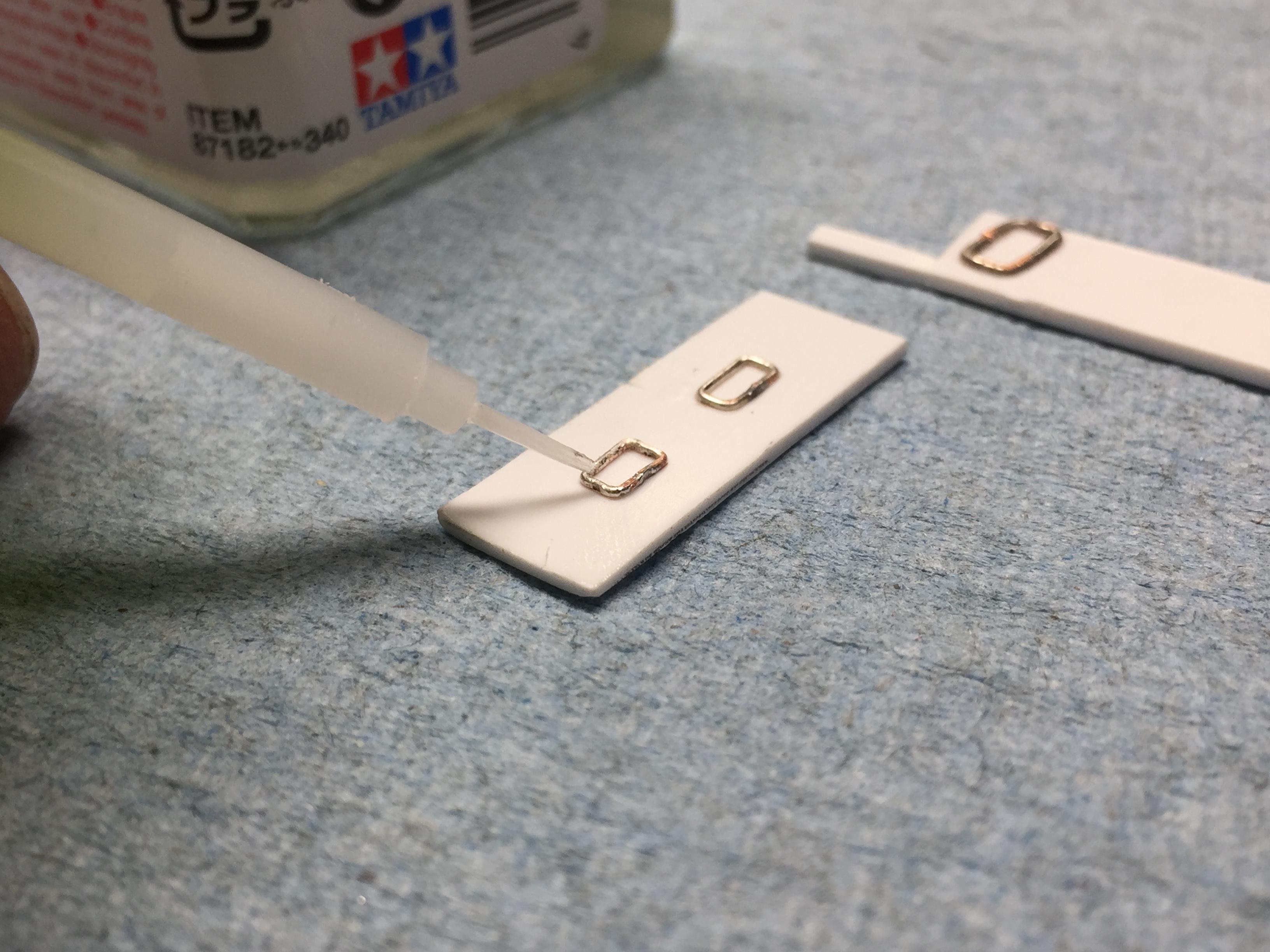

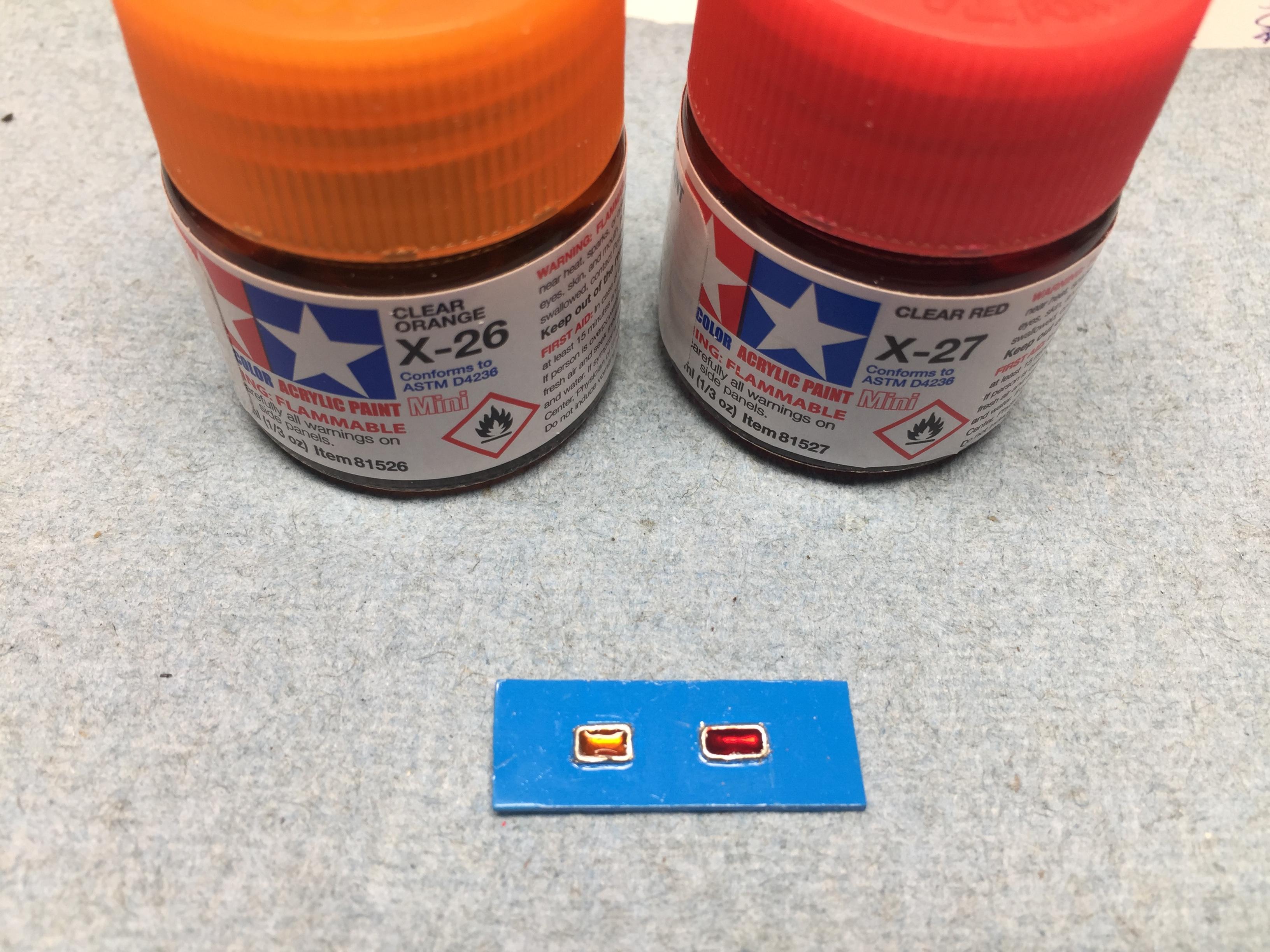

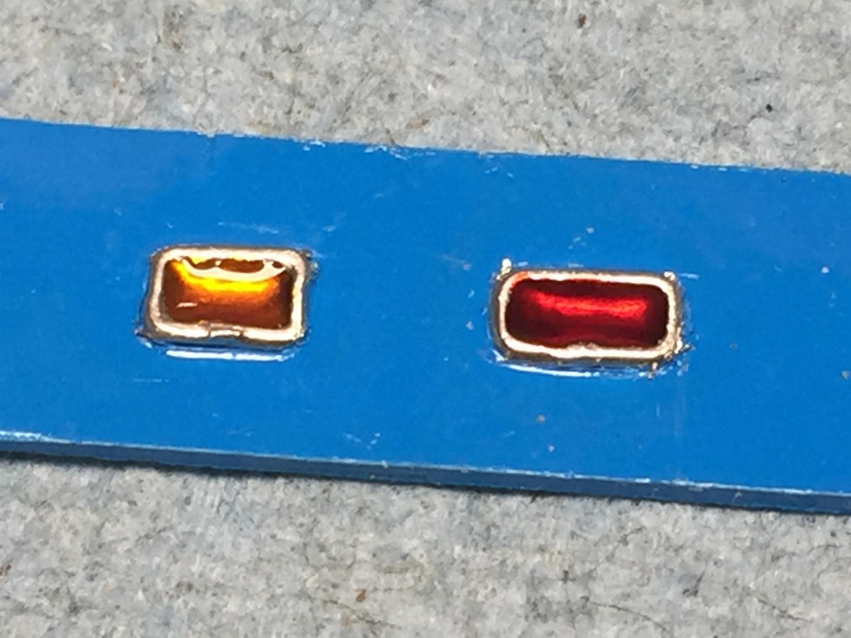

NOBLNG Posted January 17, 2020 Author Posted January 17, 2020 It can then be glued to the model with your favorite glue. I used a tiny drop of Tamiya extra thin. After painting the Mustang, I scraped the paint off of the frame and interior area and added the transparent paint. On this test though, I just foiled over the whole thing and added the paint over top of the foil. Hope this helps someone!
SfanGoch Posted January 18, 2020 Posted January 18, 2020 Great idea, Greg. I make D-rings in a similar manner. A suggestion regarding flattening them. Instead of using a file, get yourself a 4" diamond sharpener. Place the bezels on the sharpener and, applying finger pressure, move them back and forth. In addition to getting a smooth, flat surface, the wire will be polished. Plus, you can use the sharpener to resharpen your used hobby blades.

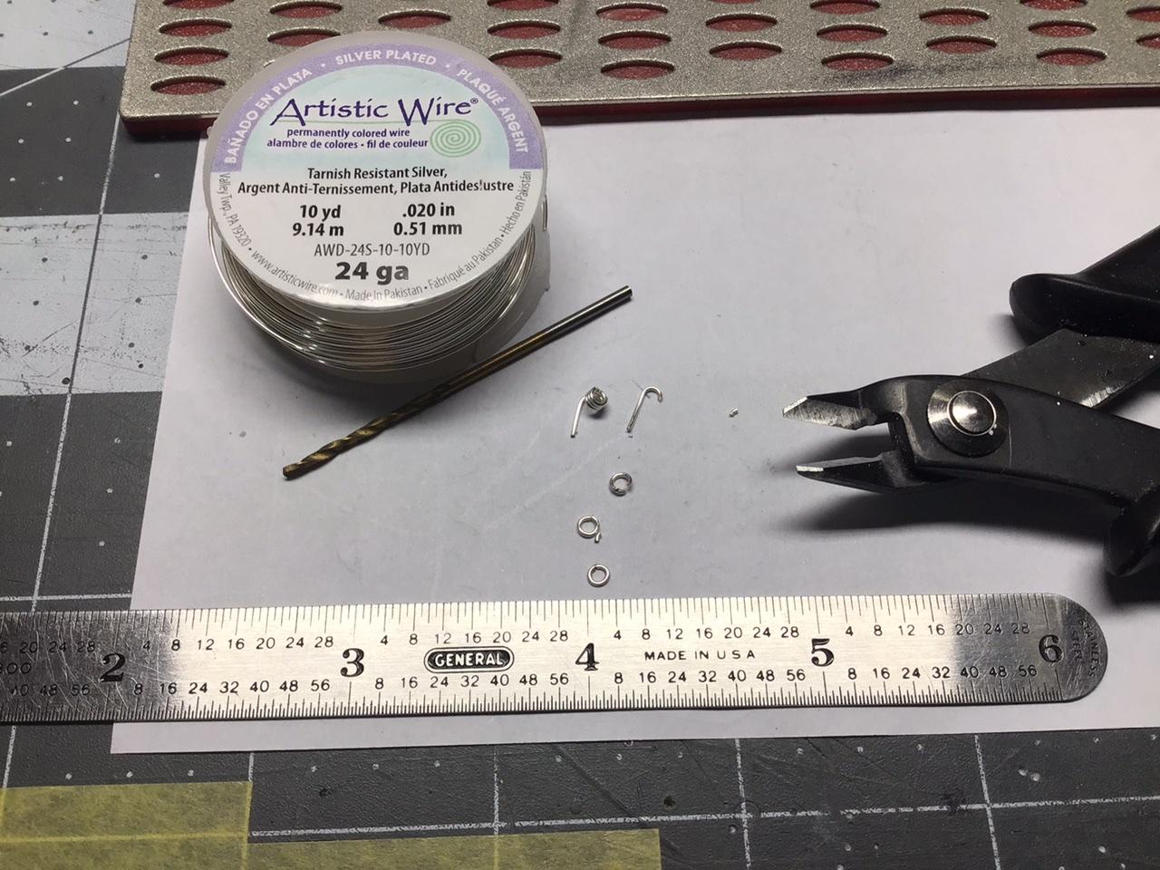

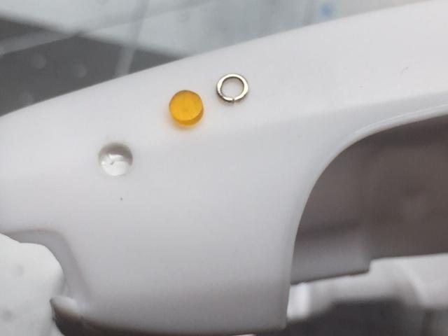

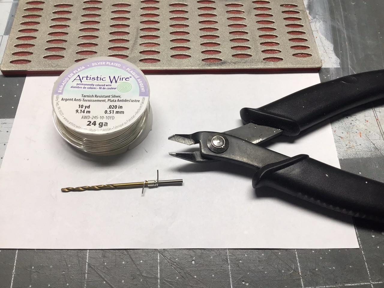

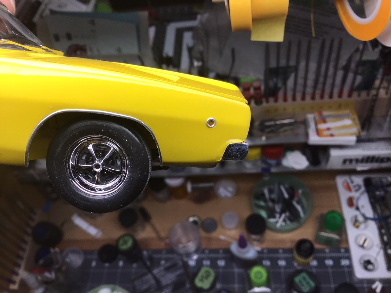

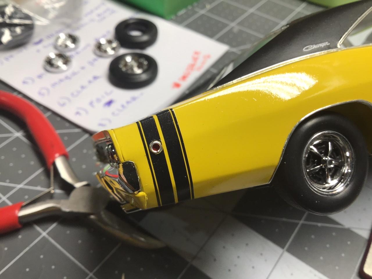

NOBLNG Posted October 12, 2020 Author Posted October 12, 2020 (edited) I figured I would add to this thread since these new markers turned out so well. I drilled a 0.098” hole in the body and glued a small backing patch inside. The lens I made from clear red sprue and a busted amber lens I found. They are slightly smaller so they will fit the hole after paint. They also sit slightly below the surface. The bezels are 0.020” wire wrapped around a 0.058” drill bit and snipped into rings with my nippers. I sanded the rings to half thickness on a diamond hone (thanks Joe) and they fit nicely in the hole in the body. A touch of clear canopy cement holds everything in place. I did not solder these ones Like I did the rectangular ones and although hardly noticeable with the naked eye, the camera picks it up. Perhaps a slight dab of epoxy and a touch of molotow would make the seam invisible? Edited October 13, 2020 by NOBLNG

NOBLNG Posted October 13, 2020 Author Posted October 13, 2020 Actually this method could be used for any round bezel...headlights, tail lights, guages. You just need the appropriate size wire and drill bit.?
