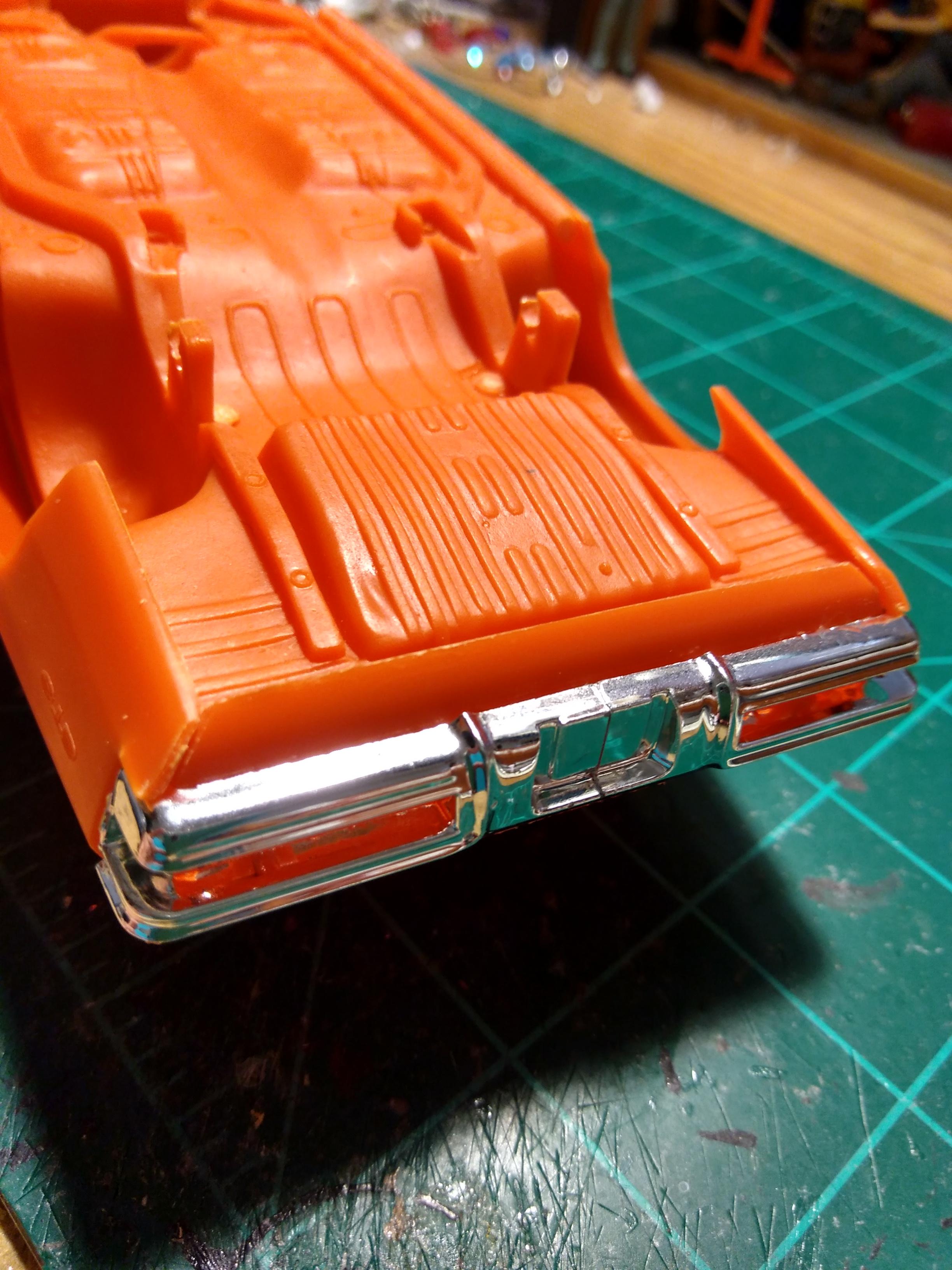

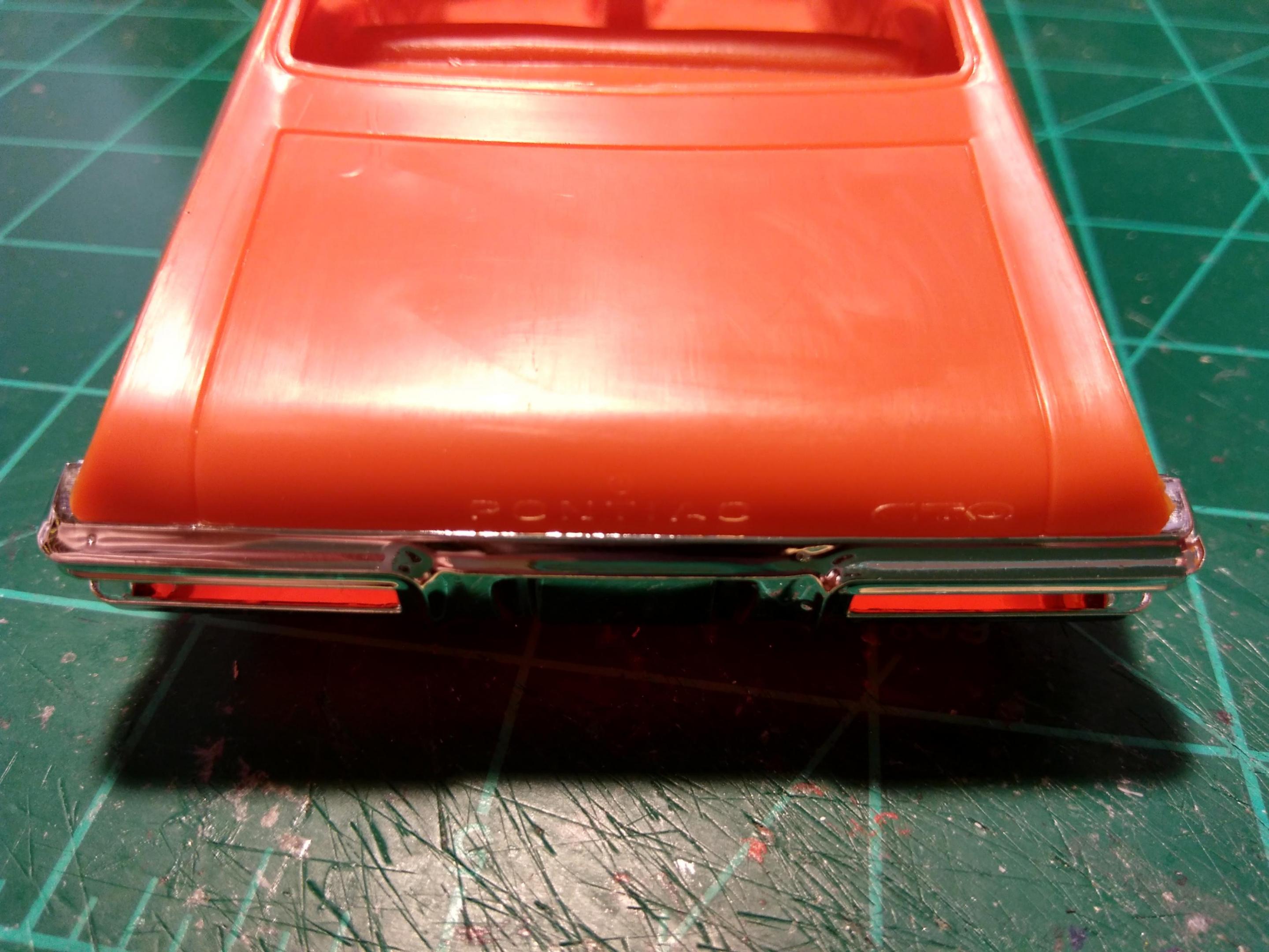

Rotorbolt73 Posted January 28, 2020 Author Posted January 28, 2020 Wow oldcarfan, that's different way of correcting the body. Great work there ! Didn't know it was that far off correct proportions. But too late for me..Already narrowed the bumper to fit..much in the same way you did yours. It works and can be done by those that don't have the skills to modify a body like that. So continuing on.... Another well known issue with this kit is the rear bumper that is too wide. Which has already been mentioned here. Each side sticks out about 1/16th on each side . It is supposed to be flush to the body. It must be narrowed to fit the body better.

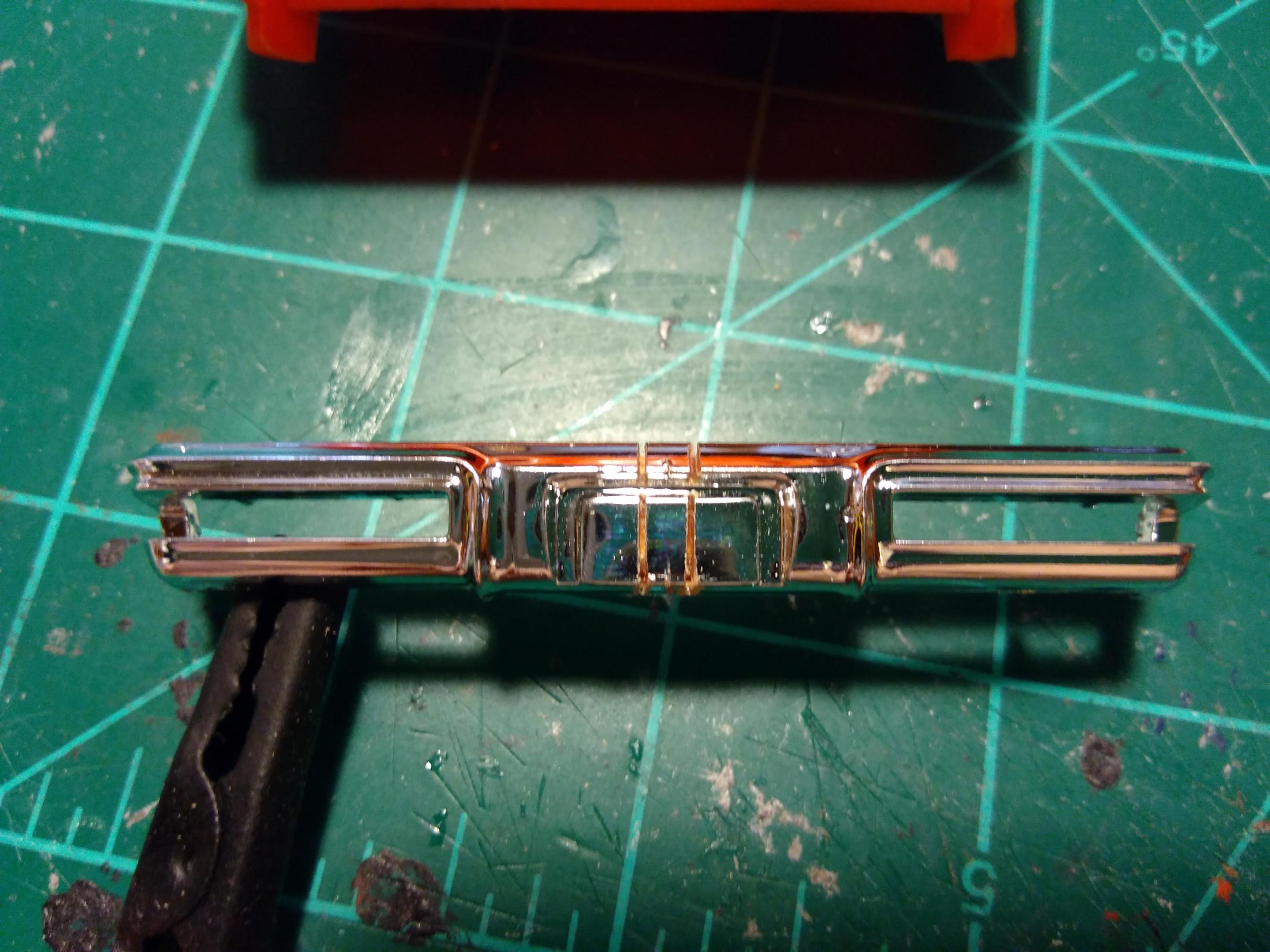

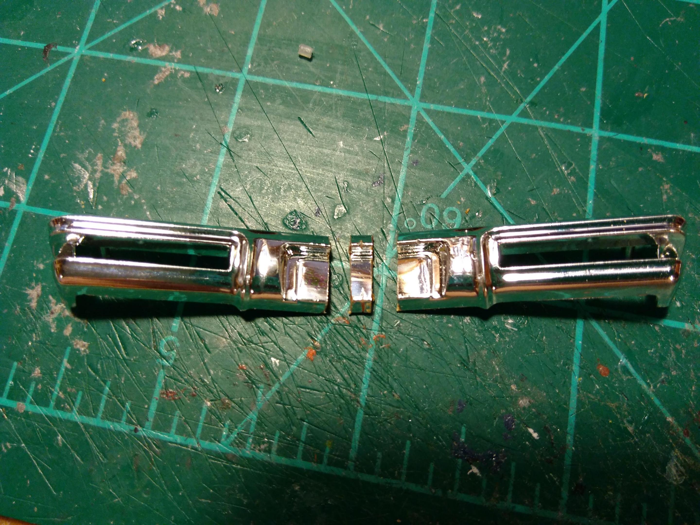

Rotorbolt73 Posted January 28, 2020 Author Posted January 28, 2020 After looking at several pics of the real cars, I noticed the kits bumper opening for the licence plate is wider than it need to be. Just like oldcarfan mentioned above.. So I decided to shorten it by removing a section right in the middle.

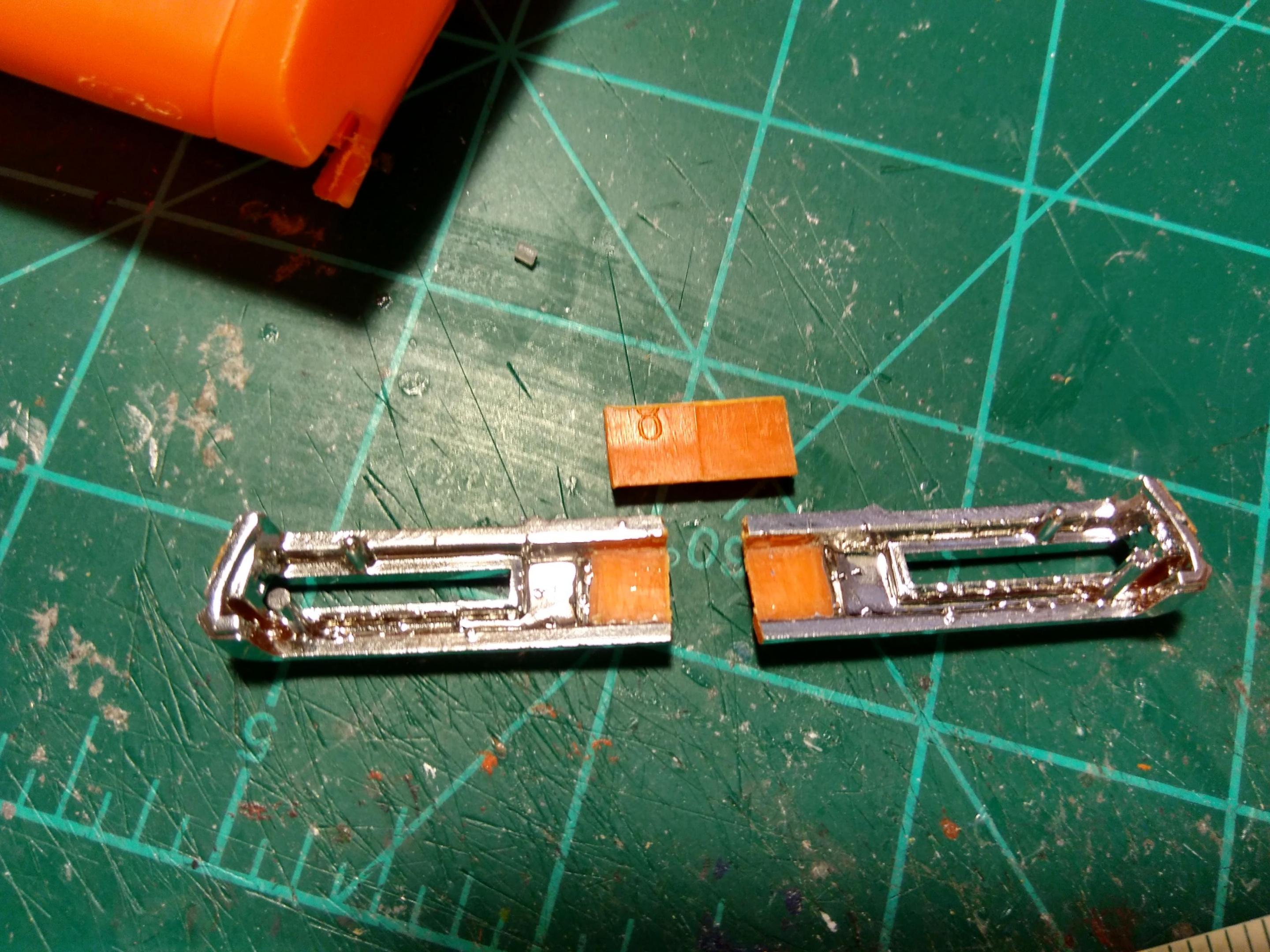

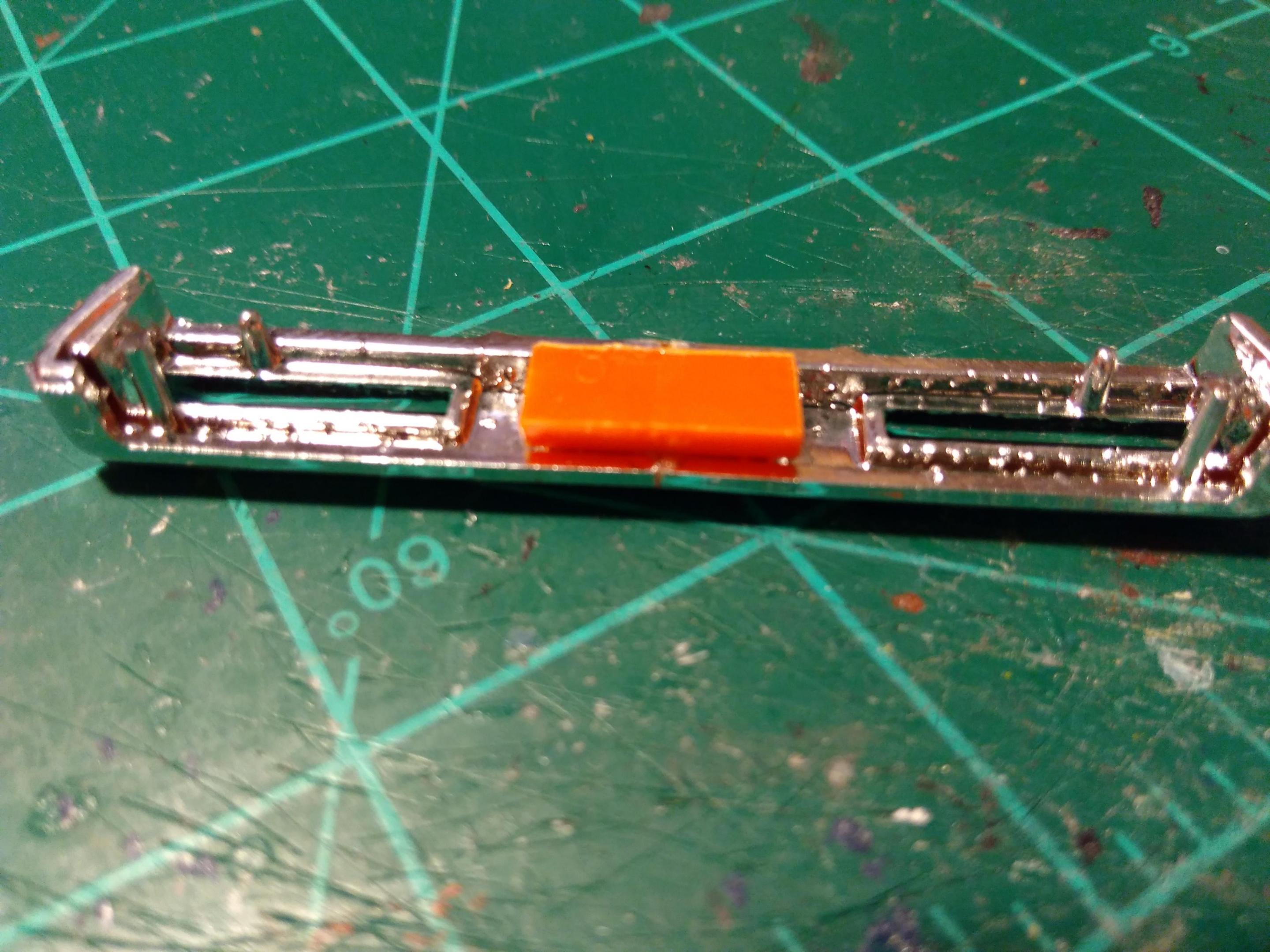

Rotorbolt73 Posted January 28, 2020 Author Posted January 28, 2020 (edited) First I make a center mark and then two more marks 1/16 on each side of center. These are the cut lines. Tricky part is keeping them parallel as you slowly cut. Once cut, you will have removed 1/8th from the center. Important note: do not forget to include the width of your razor saw in the total width removed. I forgot and ended up taking 1/32 extra out and thus it is a hair narrower than I expected . But oh well..? Edited January 28, 2020 by Rotorbolt73

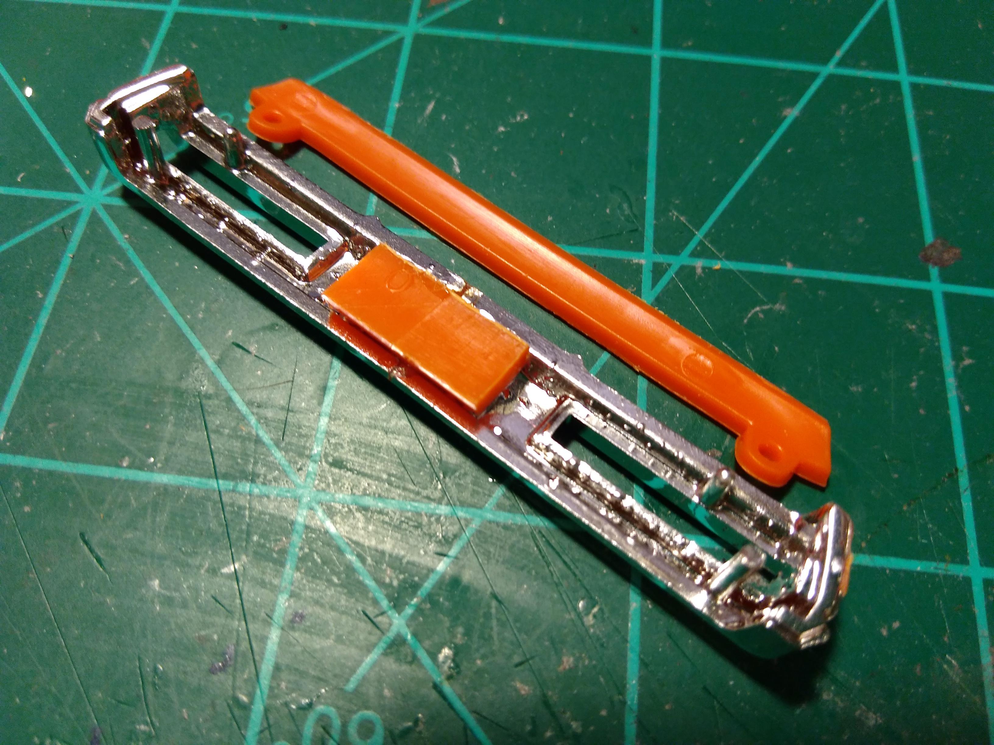

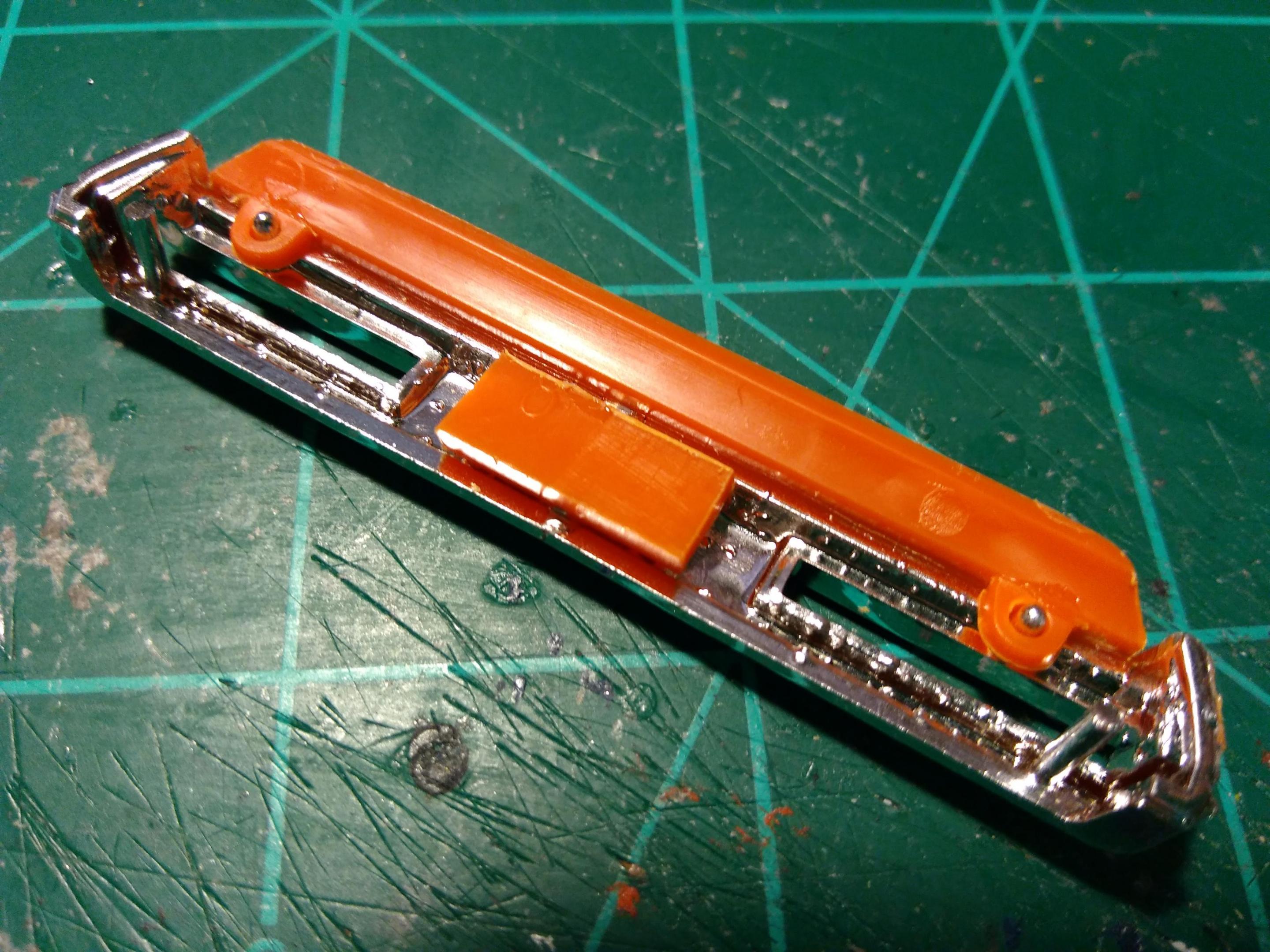

Rotorbolt73 Posted January 28, 2020 Author Posted January 28, 2020 Remove the plating from the back side and glue the halves back together. Using the removed hood brace piece used to make the chassis plate spacers earlier, cut a section to glue to the backside of the bumper halves to keep it straight and strengthen the joint.

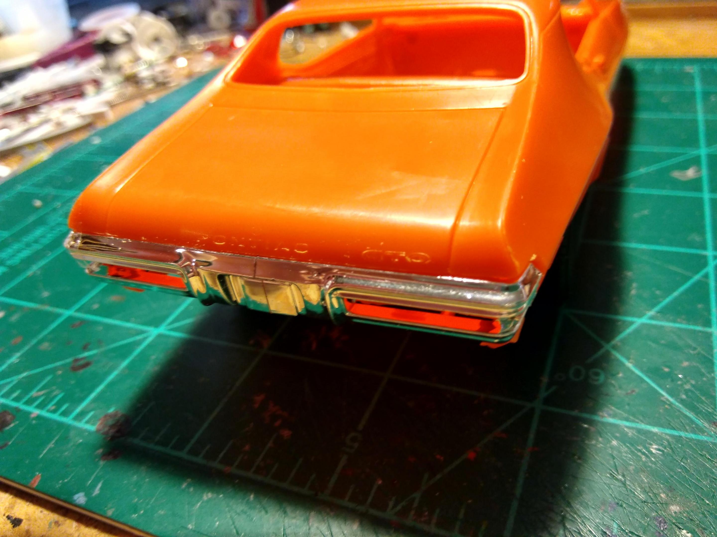

Rotorbolt73 Posted January 28, 2020 Author Posted January 28, 2020 Checking the fit to the body ..much better. Note the join seam in the middle. The licence plate will cover most of it.the little join line showing on top will have to be accepted as is.

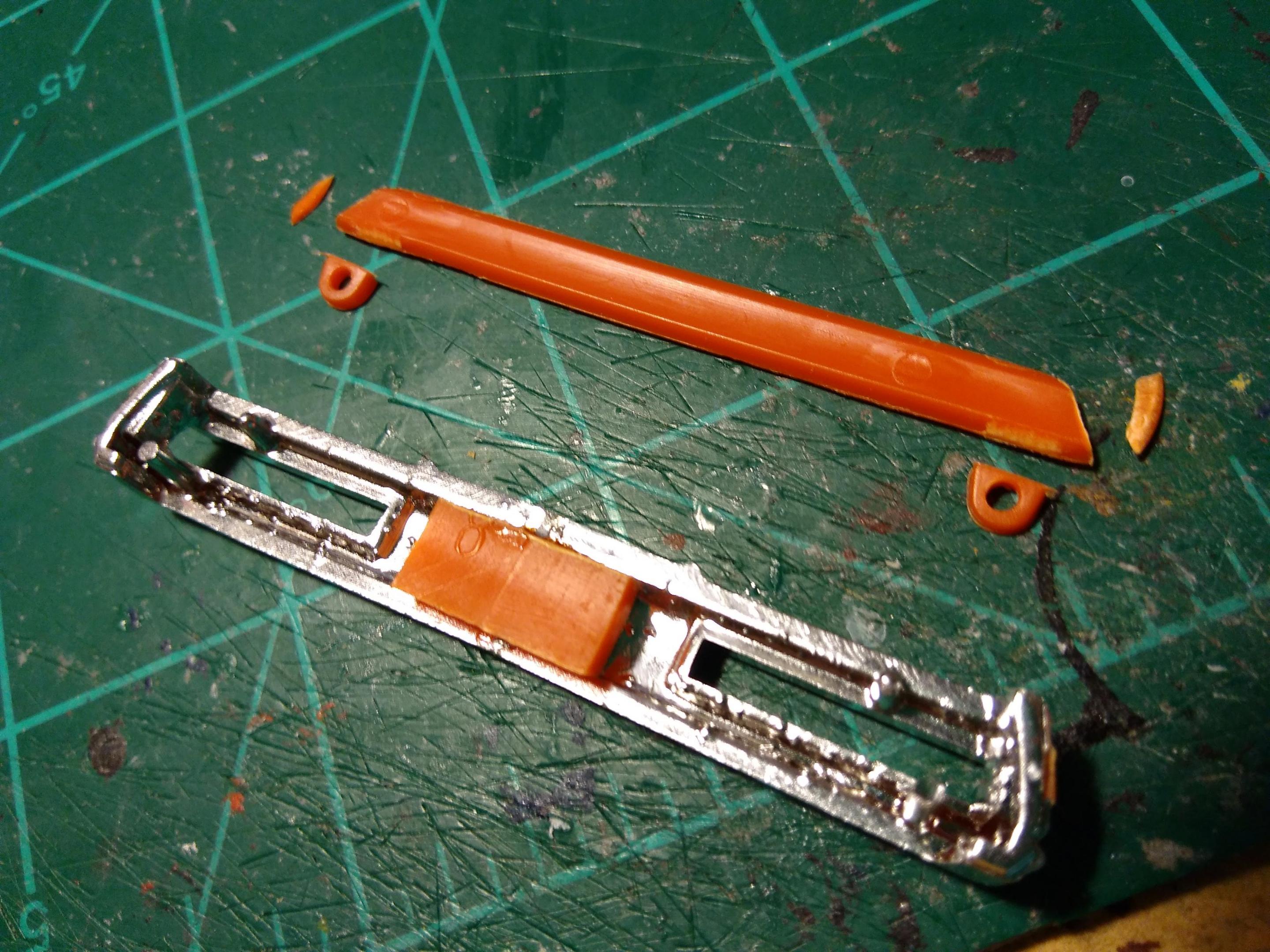

Rotorbolt73 Posted January 28, 2020 Author Posted January 28, 2020 (edited) Now another item to be modified is the lower rear valance panel. Since the bumper is narrowed , the mount tabs do not line up to secure the valance to the bumper. Start by cutting off the tabs from the valance and glue them back on so they will line back up. Also trim fit the valance to fit between the lower quarter panels as it doesn't fit to well as is. Valance panel now fits the modified rear bumper. Edited January 28, 2020 by Rotorbolt73

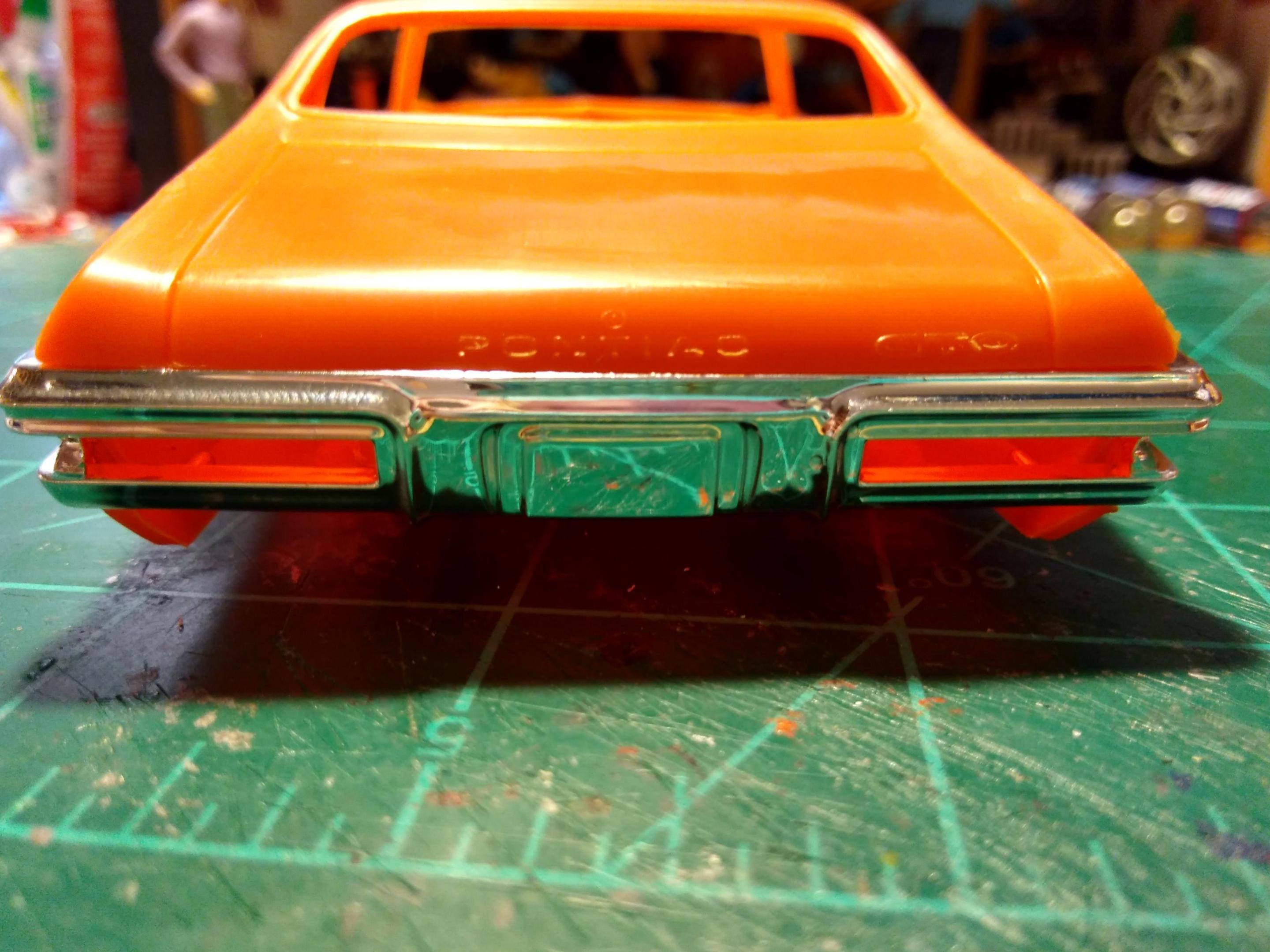

Rotorbolt73 Posted January 28, 2020 Author Posted January 28, 2020 Test fit the assembly to the body. Much better now.

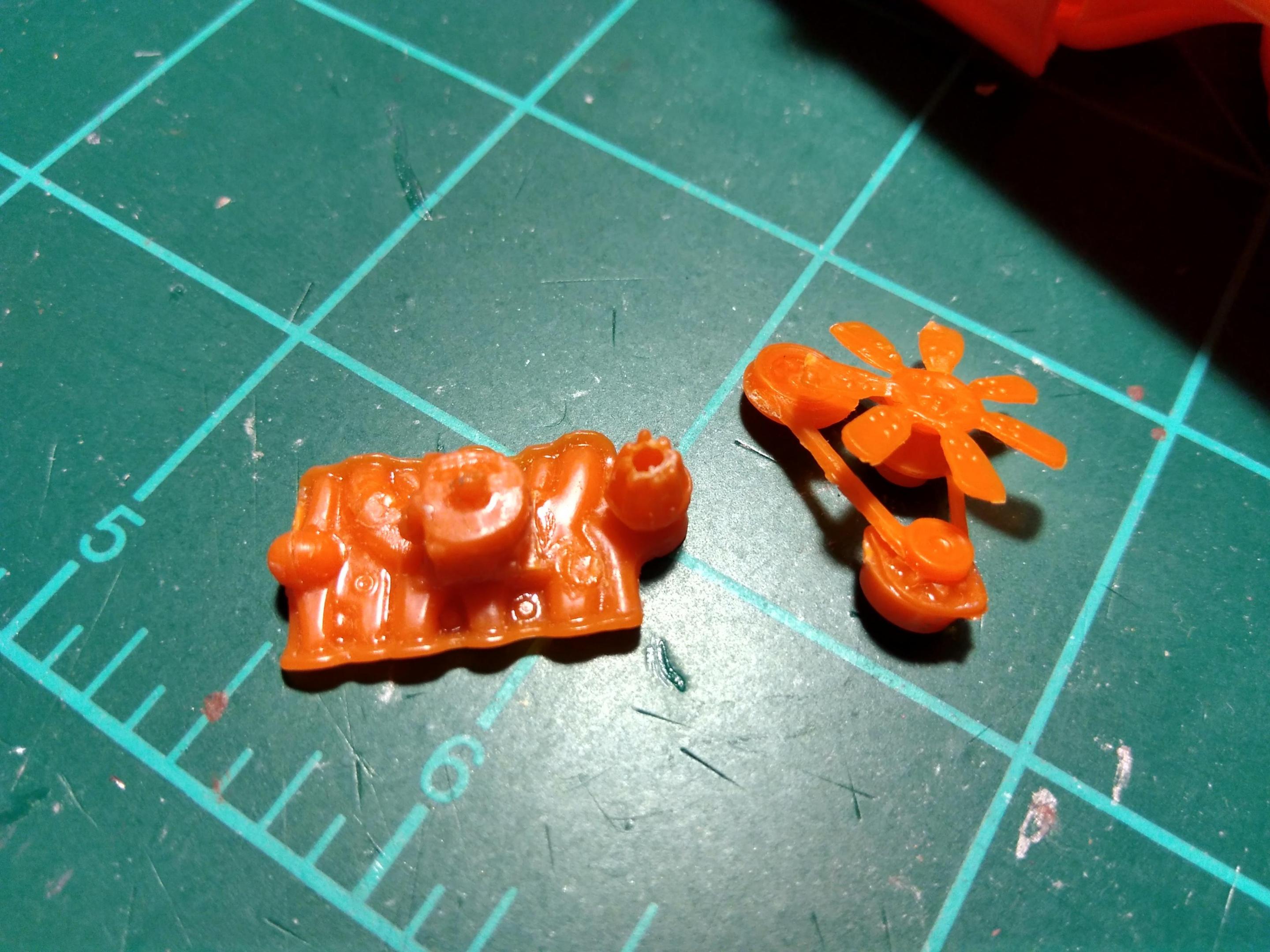

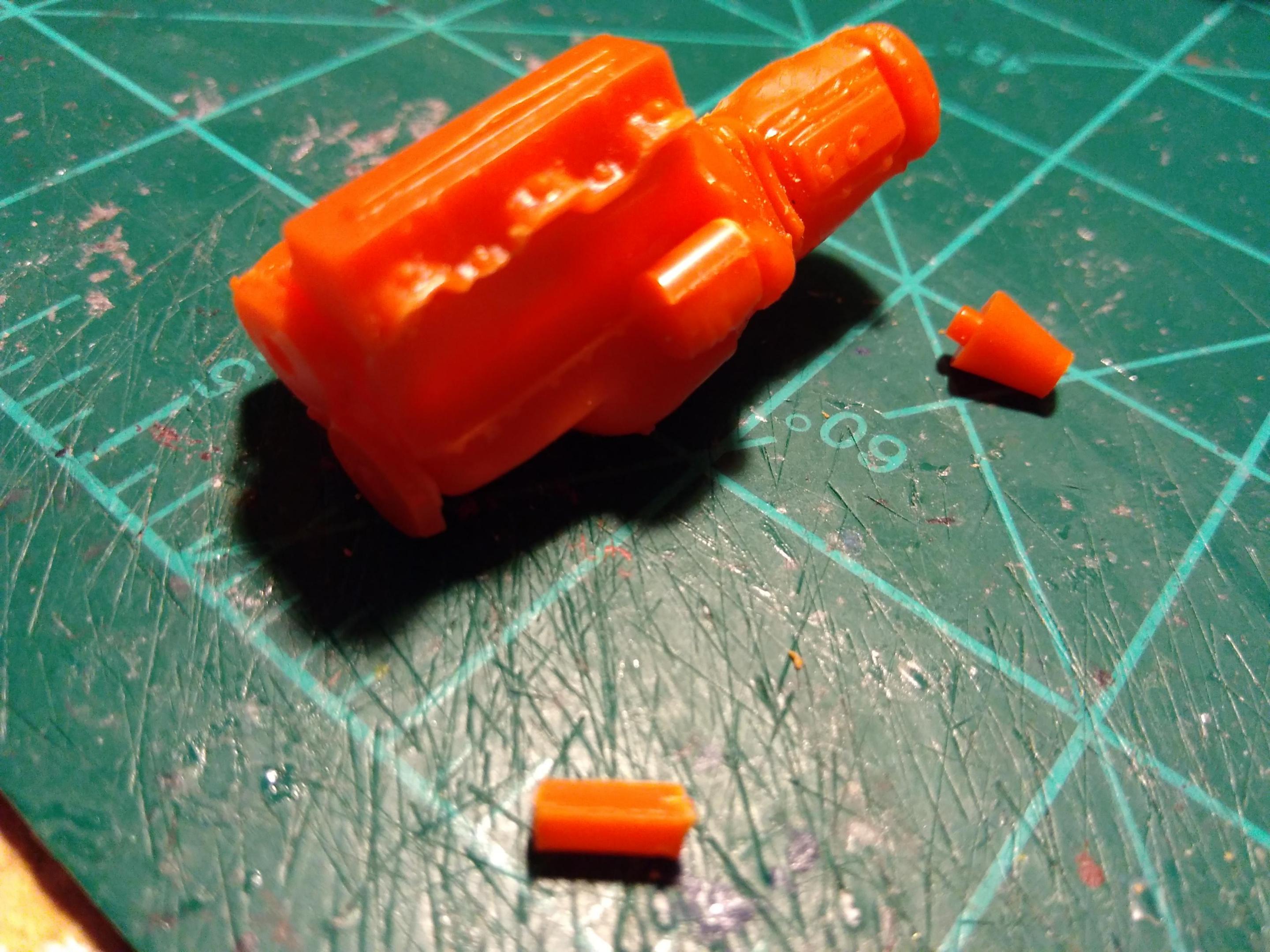

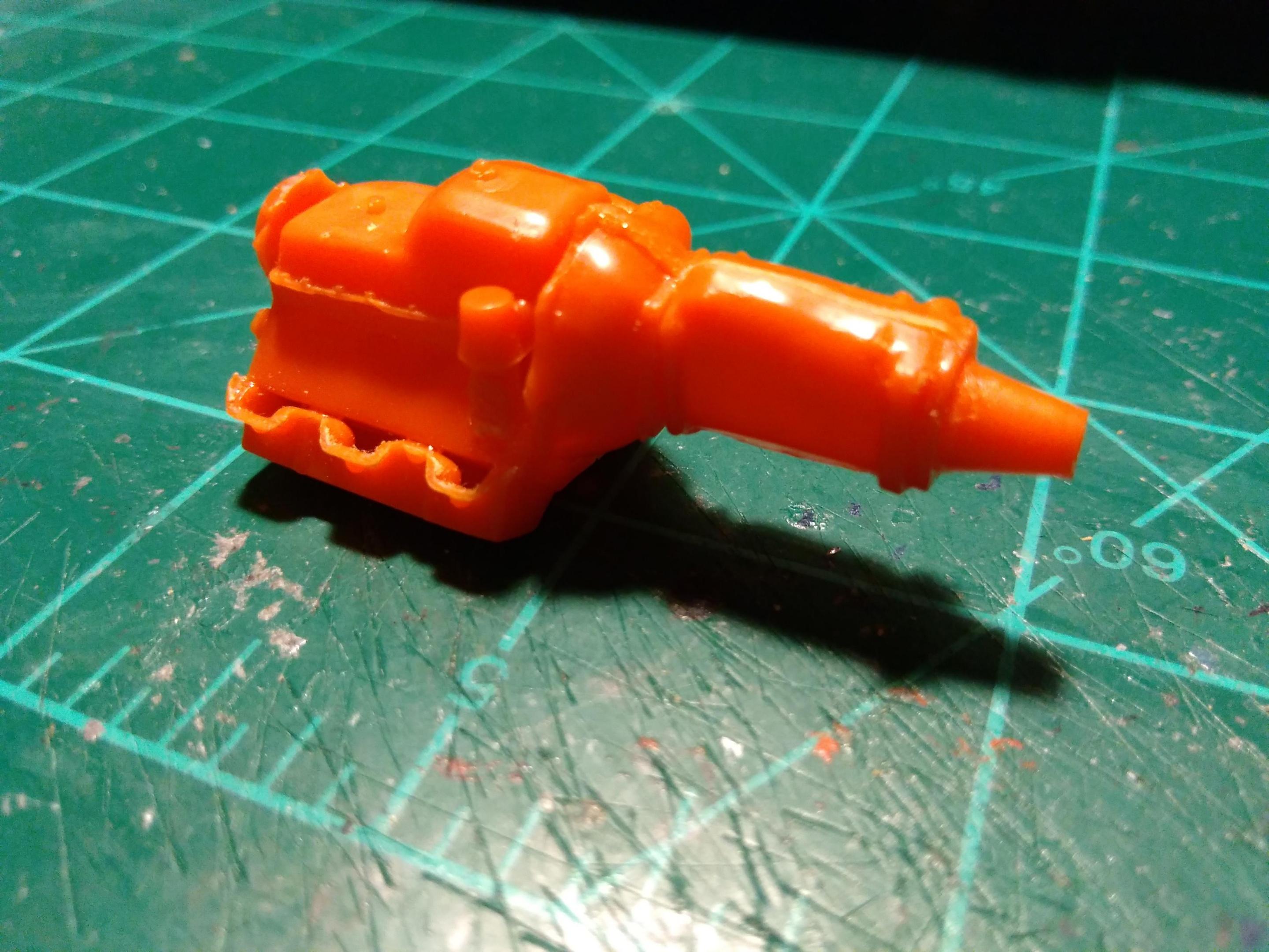

Rotorbolt73 Posted January 30, 2020 Author Posted January 30, 2020 Might use a smaller one. Just have to dig around for something . Got the engine assembled up after trimming off flashing. Put the intake , carburator and alternator in a cup of LA awesome to strip the chrome off those parts. The transmission was missing the tail shaft and looked odd. There was this cone shaped part on one of the part trees . Instructions do not show or mention what it is or for. So I decided to use it as the missing transmission tail shaft as it works pretty good for the purpose.also, the starter and oil filter are molded in with the oil pan. When installed , there is a gap between the block and starter half..and the oil filter is just hanging there on the other side with nothing to mount to..I cut a section of tree sprue to make the upper half of the starter and made a block mount section above the oil filter. I had to do some minor trim grinding on the chassis plate trans tunnel to clear the trans tail shaft and to give some clearance for the drive shaft to attach to the transmission later. I also went ahead and glued the front valance panel to the body.

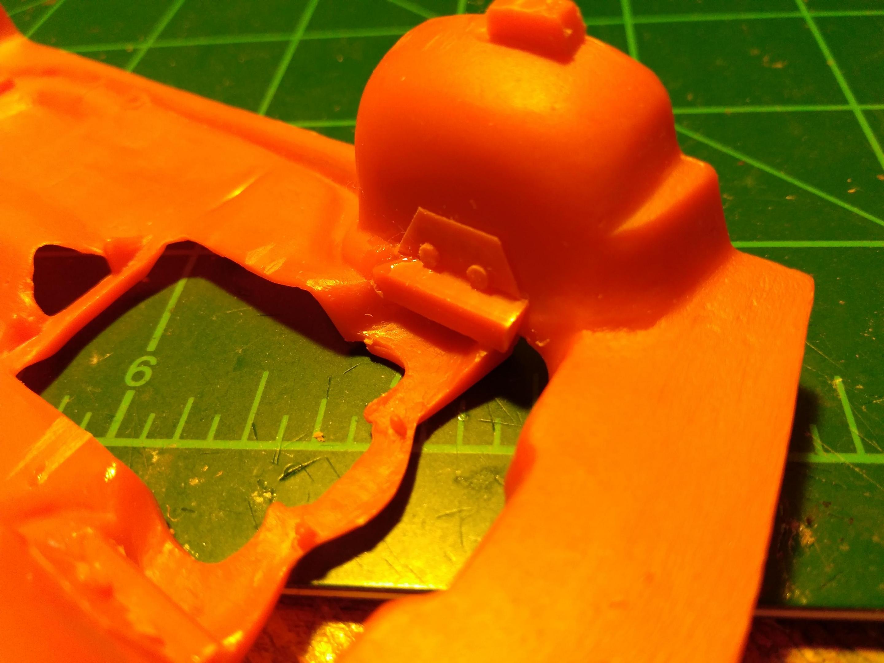

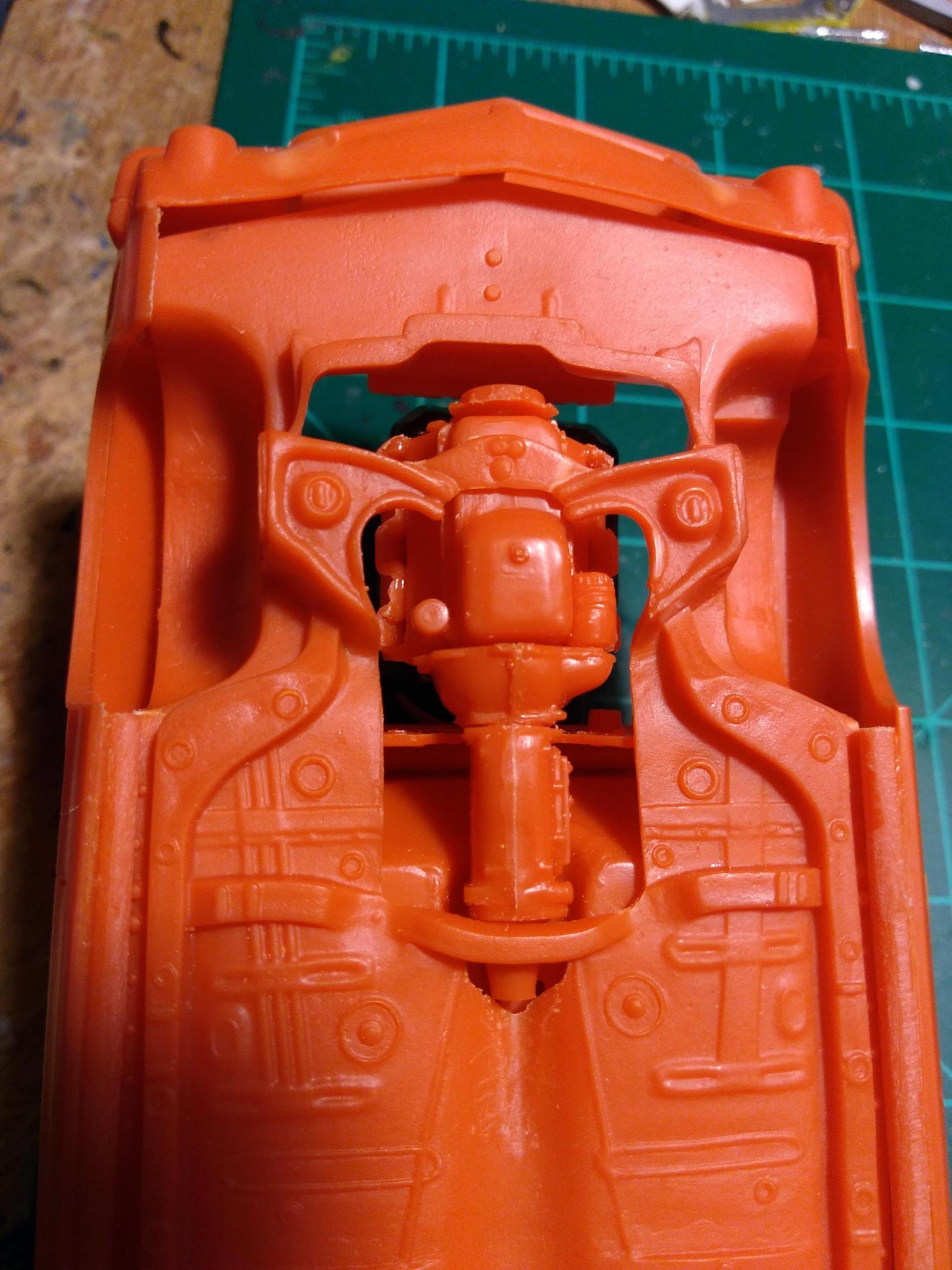

Rotorbolt73 Posted February 10, 2020 Author Posted February 10, 2020 Been busy at work lately, do not much progress as Id like. The void in the engine bay on either side of the engine bothered me. So I used the last section of the square brace I had been cutting from along with some sprue flashing and more small slices of wheel back posts to make the section of missing frame rail and a arm dust flaps and arm mount posts. Looks better than nothing..

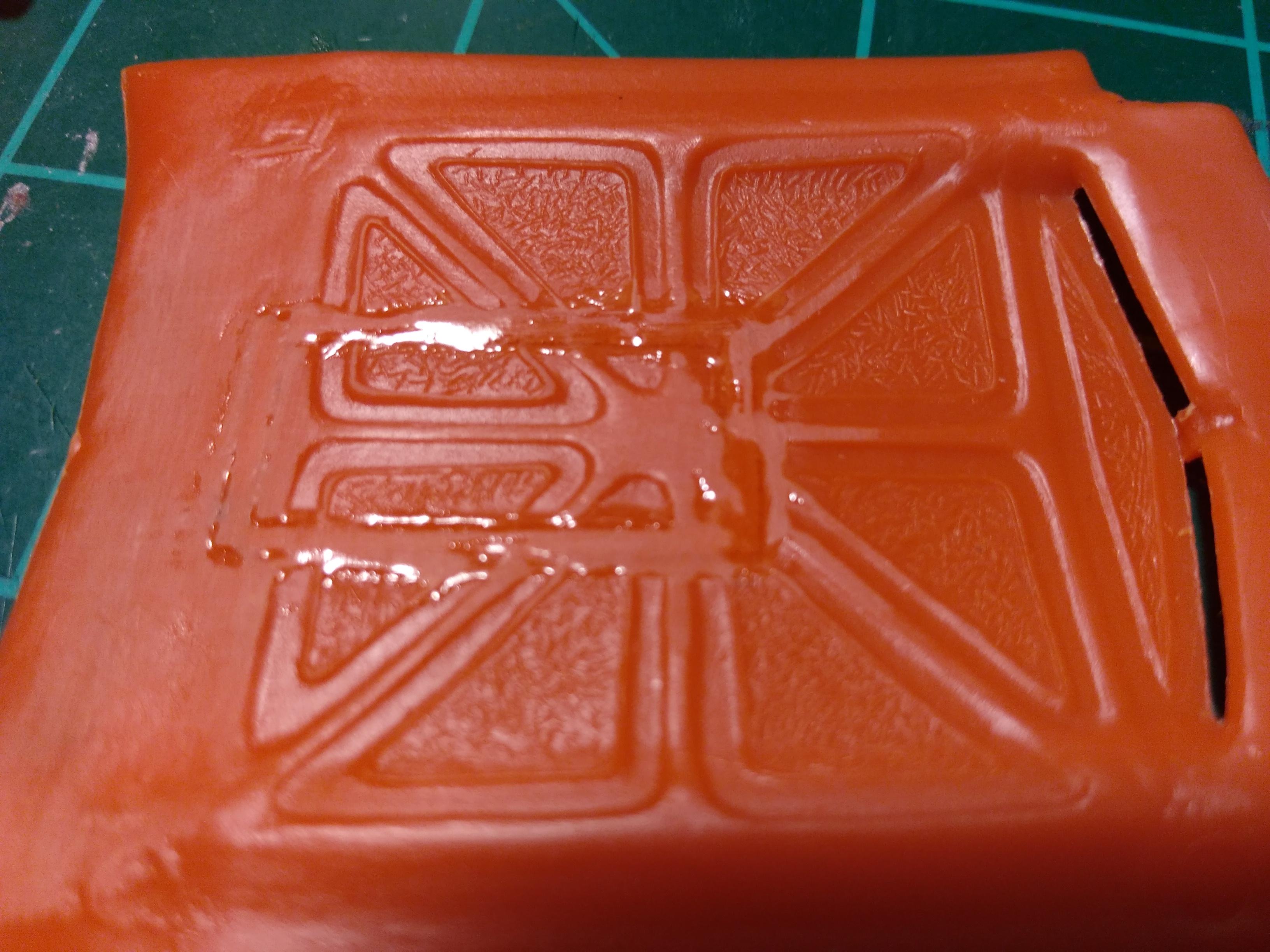

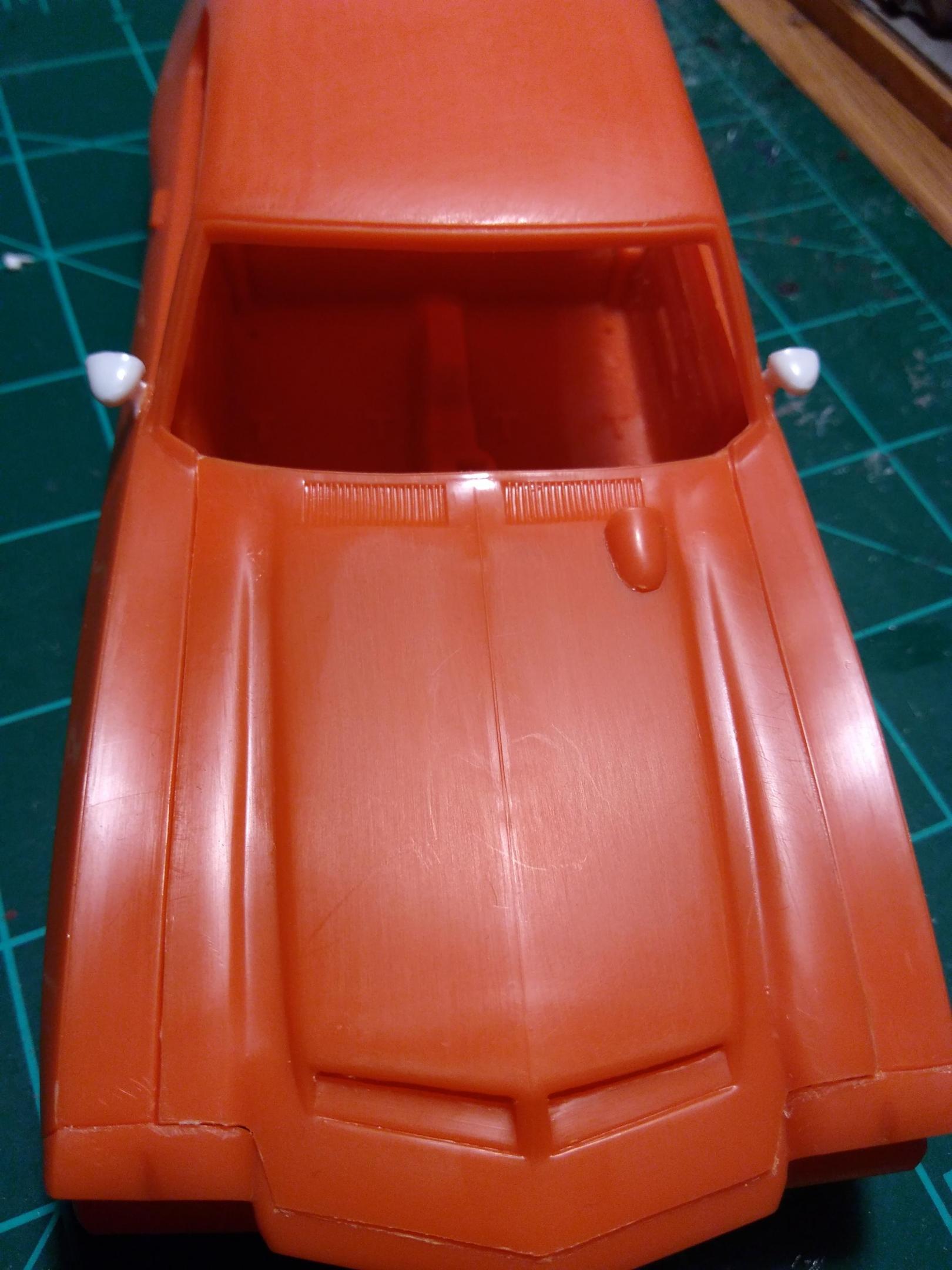

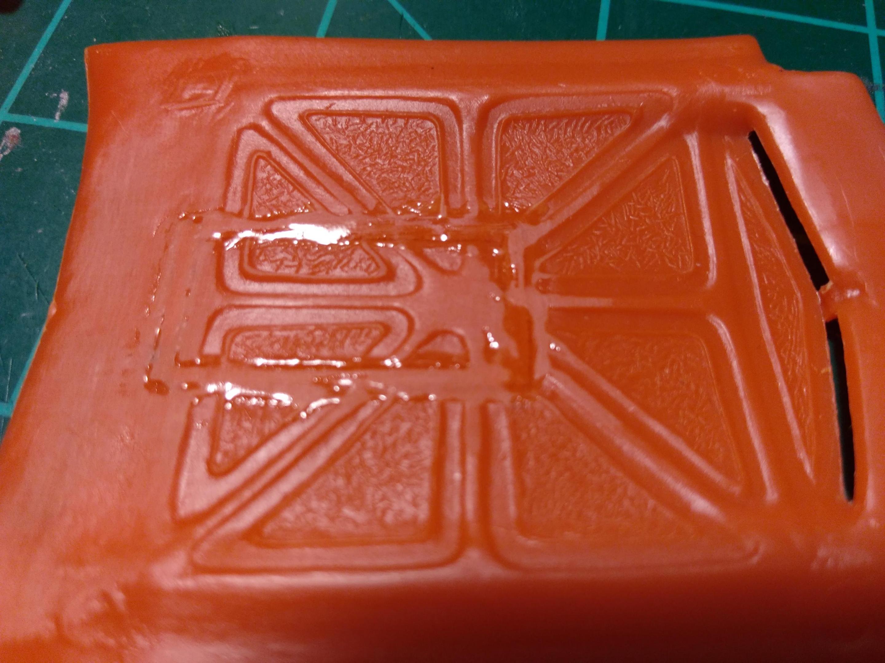

Rotorbolt73 Posted February 10, 2020 Author Posted February 10, 2020 (edited) The backside of the hood has these deep recesses molded in for cutting a hole to clear the optional supercharger in older issues . I didn't like them showing so prominent , so I cut thin strips from the parts sprues and glued in to fill it in. I then sanded the obvious looking cut out area showing on top of the hood to hopefully flatten out that spot . I glued the hood tach in place as well. Also, the kit is missing door mirrors. So I found some in my parts and glued them on per reference pictures of the real cars. I mentioned earlier that I had stripped the chrome off the intake and carburator . It was some pretty tough chrome and took a couple days to come off. The intake had two wierd holes molded in the runners for some unknown reason, so I filled those in with small pieces cut from those wheel back rod posts . There is also no radiator hose in this kit..so I cut a piece of sprue to make a waterneck to connect a hose to later. I went ahead and glued the carb and distributor on. Drilled a hole in the distributor for wires. Also assembled up the fan and alternator on the belt pullies. Edited February 10, 2020 by Rotorbolt73
slusher Posted February 10, 2020 Posted February 10, 2020 What kind of glue did you use on the hood patch, Matt?
Rotorbolt73 Posted February 11, 2020 Author Posted February 11, 2020 17 hours ago, slusher said: What kind of glue did you use on the hood patch, Matt? Just regular old fashion testors orange.
