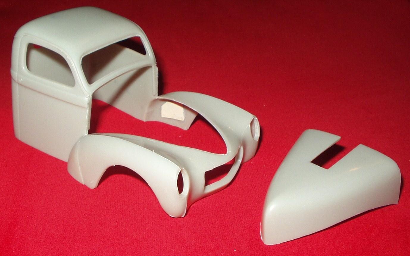

Roadrunner Posted January 29, 2020 Author Posted January 29, 2020 By and large, one of the worst things about some of these old kits (this one dates back to at least 1963, as far as I am aware), are the fairly prominent molding seams; necessary for sure, but still a pain in the neck. Also, a lot of aircraft modelers tend to complain about flash;... Ha! They should try building an old car model.

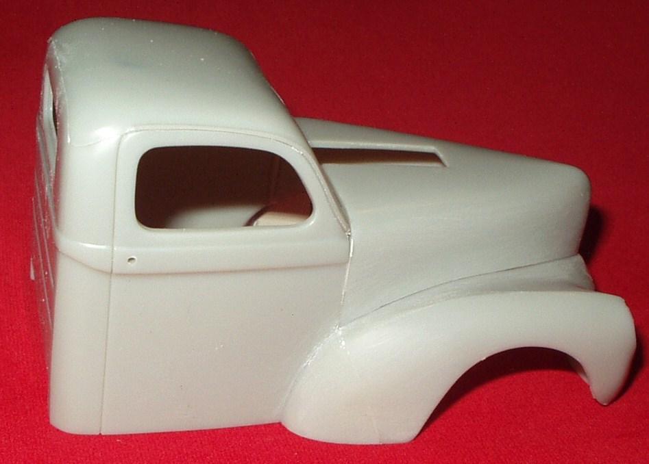

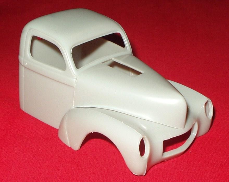

Snake45 Posted January 30, 2020 Posted January 30, 2020 And that's not the half of it! That flip front end fits only slightly better than the one in the MPC '57 Vette gasser, which is to say, not at all! I ended up gluing the thing on solid and then cutting the hood away separately, and the whole front end now looks 100% better. And I've still got a LOT of work to do on the wretched backbirth!
Roadrunner Posted January 30, 2020 Author Posted January 30, 2020 I'm working on the rear and front body parts right now and noticed the same problem with the Coupe kit; the front and rear don't really line up well at all, so I'll be epoxying them together (it's a curbside anyway), then correcting any alignment problems. Also, for whatever it's worth, I'll be removing the raised fender seams at the rear, then re-scribing them to look more like the actual car.

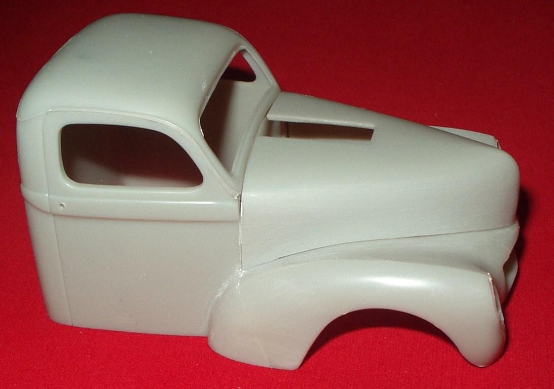

Roadrunner Posted February 1, 2020 Author Posted February 1, 2020 (edited) Front end, while not yet 100% complete, has been tidied up a lot; still some sizing/cleanup to do around the grill area. (This shot reminds me of a happy face, for some reason.) As has the rear. I'm debating whether or not to scribe in the fender attachment lines, front and rear. It seems the Revell '41 Willys has these correct, whereas this AMT kit does not. Edited February 1, 2020 by Roadrunner

magicmustang Posted February 11, 2020 Posted February 11, 2020 (edited) On 2/1/2020 at 3:32 PM, Roadrunner said: Front end, while not yet 100% complete, has been tidied up a lot; still some sizing/cleanup to do around the grill area. (This shot reminds me of a happy face, for some reason.) Great work so far. One thing that always bugged me about the AMT Willys verses The Revell version is the shape of the hinged front body piece. It looks to large compared to the rest of the body. Like Snake45 did, I have scribed off the hood on mine and the fenders look okay. It's was the hood, it's too tall. I plan on sanding down the lower edges until it looks better. Edited February 11, 2020 by magicmustang
Snake45 Posted February 11, 2020 Posted February 11, 2020 12 minutes ago, magicmustang said: Great work so far. One thing that always bugged me about the AMT Willys verses The Revell version is the shape of the hinged front body piece. It looks to large compared to the rest of the body. I have scribed off the hood on mine and the fenders look right. It's was the hood, it's too tall. I plan on sanding down the lower edges until it looks right. Great point, I'll have to look at that on mine. Also, the character line on the doors should carry forward onto the hood, and they don't. Hmmmmm, I wonder if both these problems could be solved at the same time--Cut the top of the hood away with a razor saw, chop it a little, and then narrow the sides a bit before gluing it back on? This would also allow more of the blower scoop to show, which would be a good thing.
magicmustang Posted February 11, 2020 Posted February 11, 2020 (edited) 10 minutes ago, Snake45 said: Great point, I'll have to look at that on mine. Also, the character line on the doors should carry forward onto the hood, and they don't. Hmmmmm, I wonder if both these problems could be solved at the same time--Cut the top of the hood away with a razor saw, chop it a little, and then narrow the sides a bit before gluing it back on? This would also allow more of the blower scoop to show, which would be a good thing. Also, a good idea. Although, I will probably just extend the BMF strip along the hood where the character line should be.. Edited February 11, 2020 by magicmustang
Roadrunner Posted February 11, 2020 Author Posted February 11, 2020 Interesting points. I doubt that I'll try to adjust either issue, but still good to know. The '40 Willys gasser photos that I've gathered so far, seem to be a mix of full tilt front ends and traditional hood arrangements, so I'll just go with what the kit offers.
