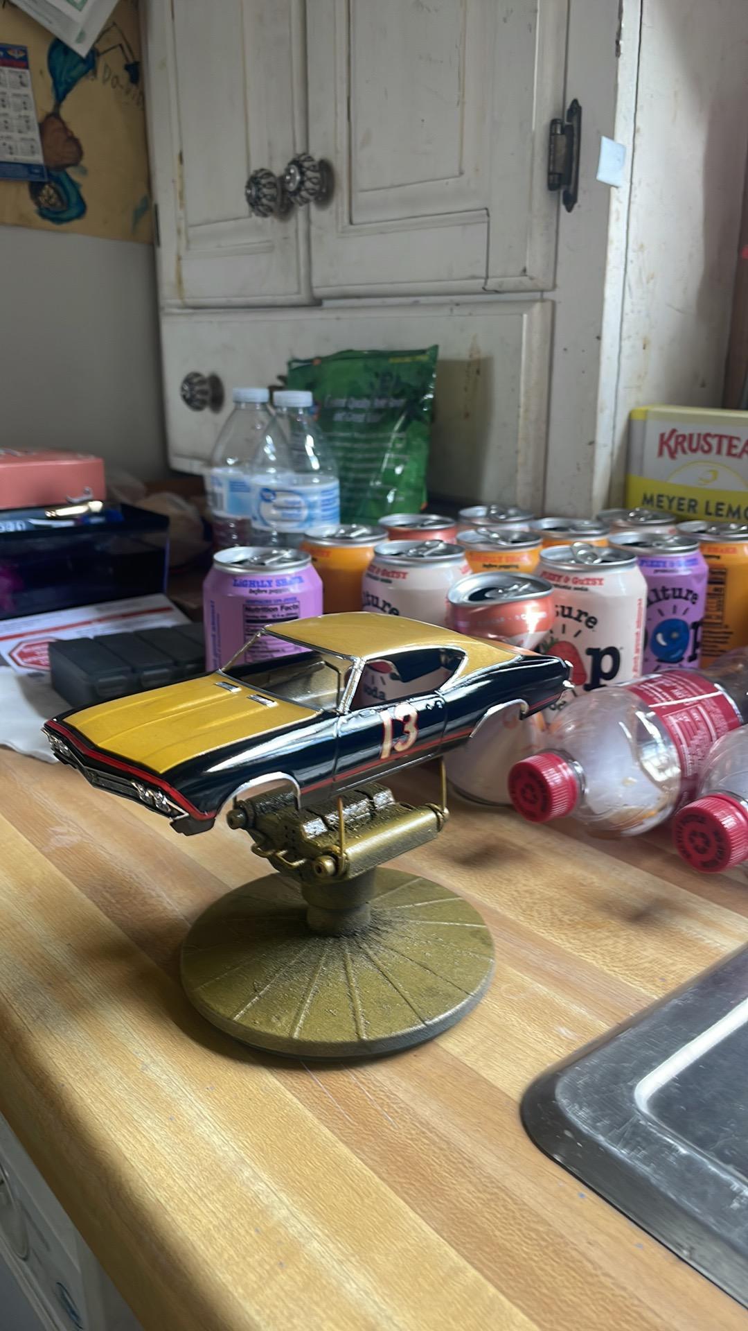

I just today discovered that Goo Gone, quite easily removes BMF excess glue residue, which is excellent to know. I have yet to try it on a lacquered finish, but will report my results when I do.
OK, a scrap hood was sacrificed for this experiment. Painted and clear coated (with Testors lacquers, and no prep at all), then a patch of BMF applied and burnished. I'll give this a couple of days, then see if the Goo Gone has any affect at all on the lacquer, and I'm betting it will not.
