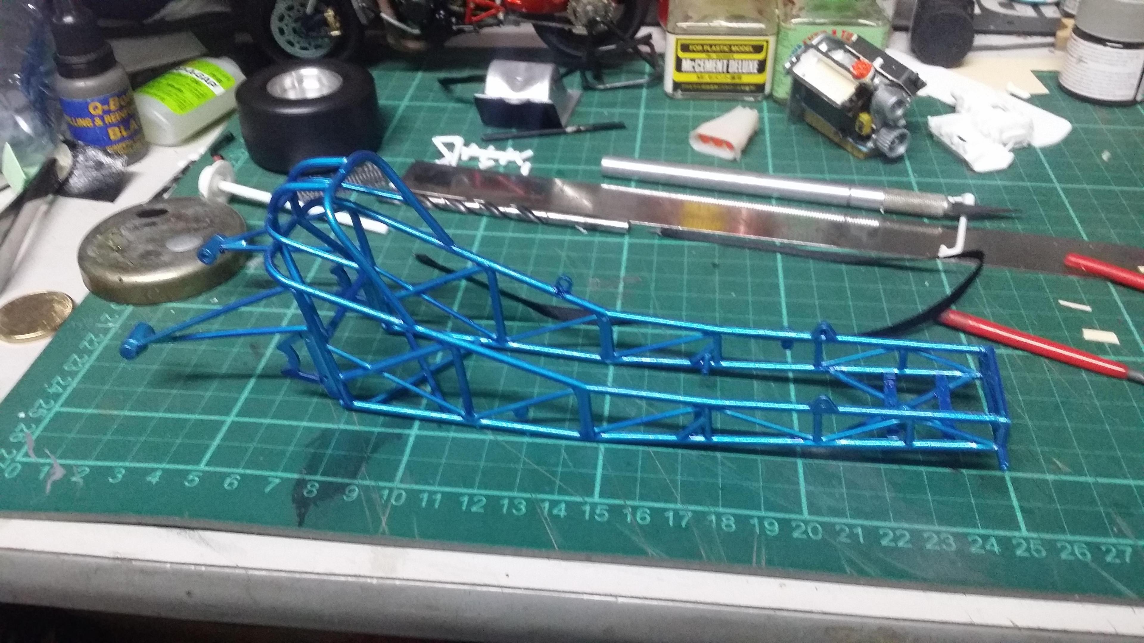

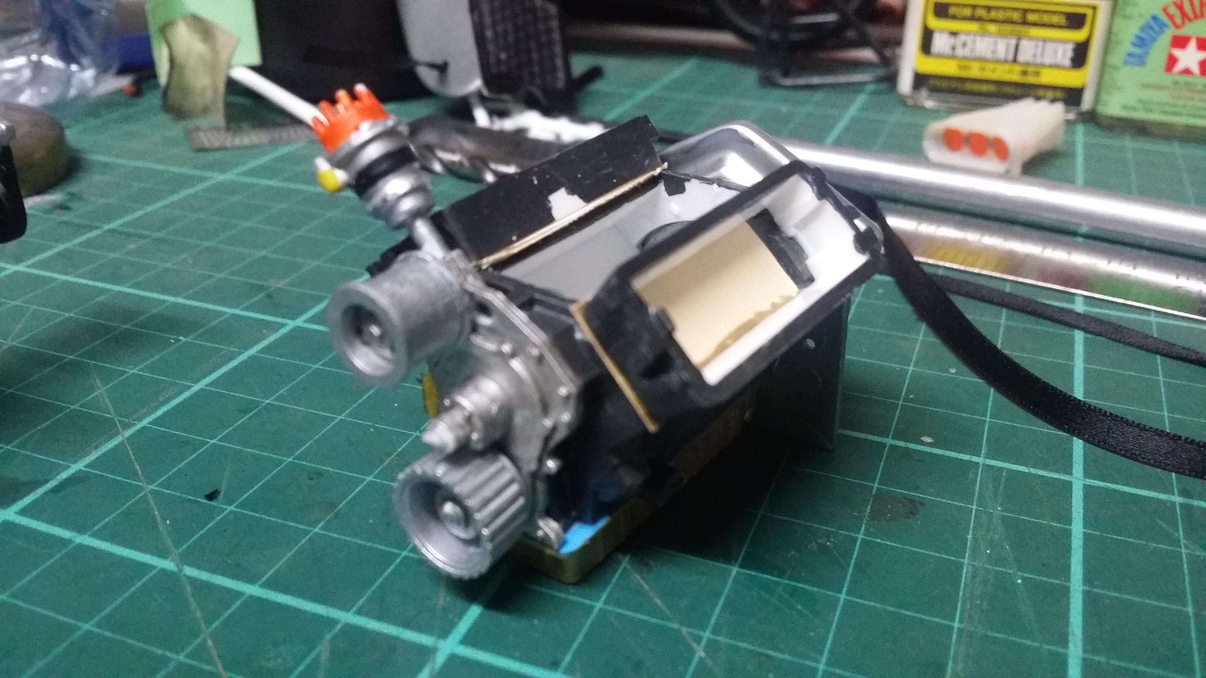

1320 Posted April 12, 2020 Posted April 12, 2020 Hey guys, I just started a new build, Revell's 1/16 hawaiian kit. I assembled the chassis and while doing so dropped the height of the roll cage and raised the rear end mounts to fix the ride height issue these kits have. I also started on the engine and added gaskets to the oil pan and heads. I also wanted to make the wheels as I hadn't done a 1/16 set before so I started on those. They'll be a satin centreline in aluminium which I'll do in my 60 year old wobbly lathe. I roughed out one of the rears and I might do a front next. It won't be nearly up to the standard of some of the projects here but I'll keep the build realistic for me to do in a reasonable time frame. Thanks for looking. Jim 1

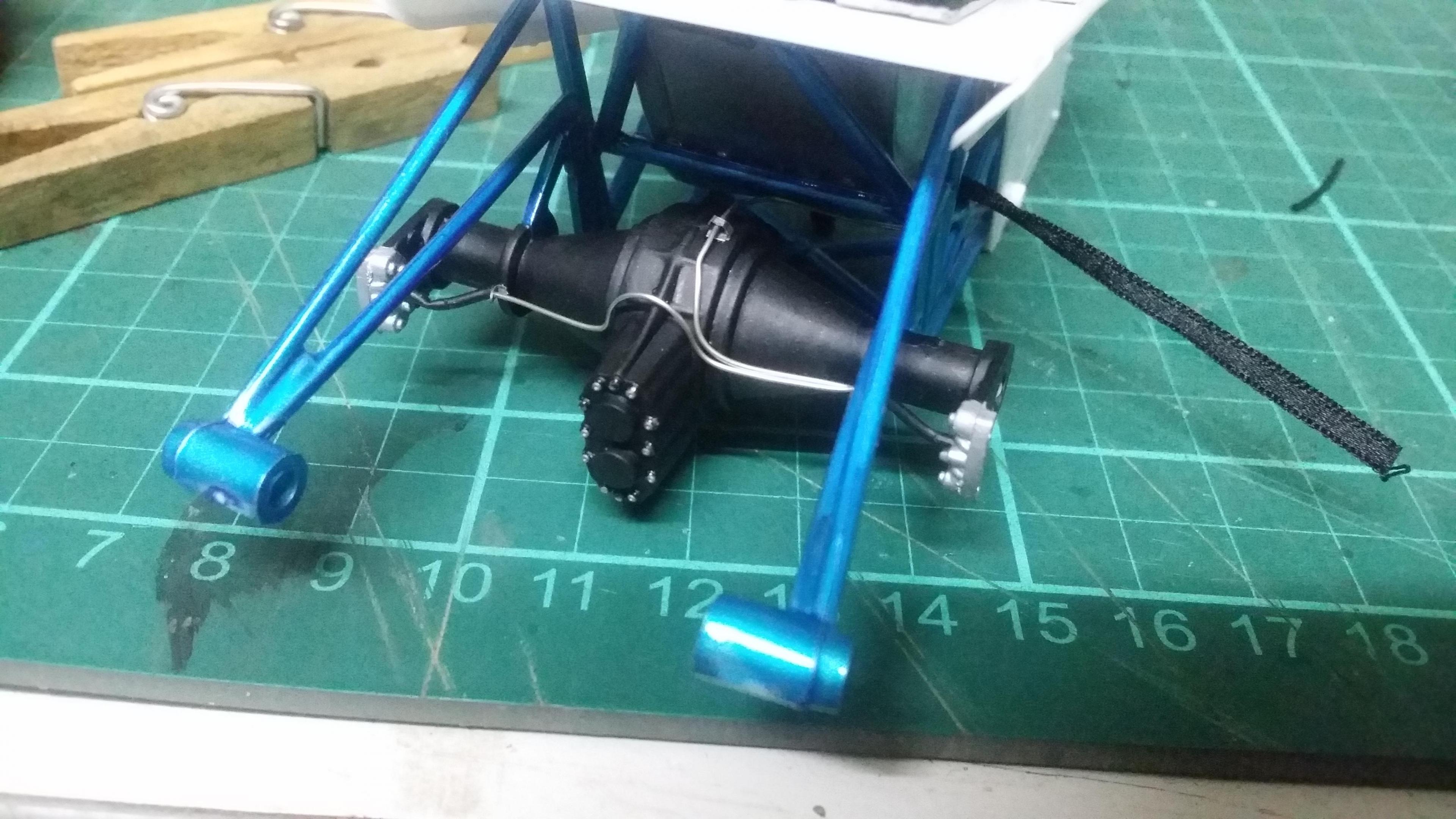

1320 Posted April 14, 2020 Author Posted April 14, 2020 Hey guys, I'm really enjoying this build. The following pics show what I've been up to. Made a rear brake line which came up ok. Took a few tries but it will do. I drilled wheel stud holes in the rear wheel then moved onto the front ones. So I now I have one of each. No stud holes on the fronts, I used some PE bolt heads instead. Also got the harness finished in the seat area, now I have to attach it to the chassis. It's a 1.12 scale MFH harness but it looks ok I think. Not too large. Thanks for looking Jim 1

1320 Posted April 17, 2020 Author Posted April 17, 2020 Thanks Majel, I'm really happy with the wheels so far, hopefully I can match the other two because I do it freehand. The brake line is .025" stainless safety lock wire with the kit black rubber hose on each end. The brackets are 3 x 1.12 moto GP exhaust spring hooks. Thanks for looking Jim

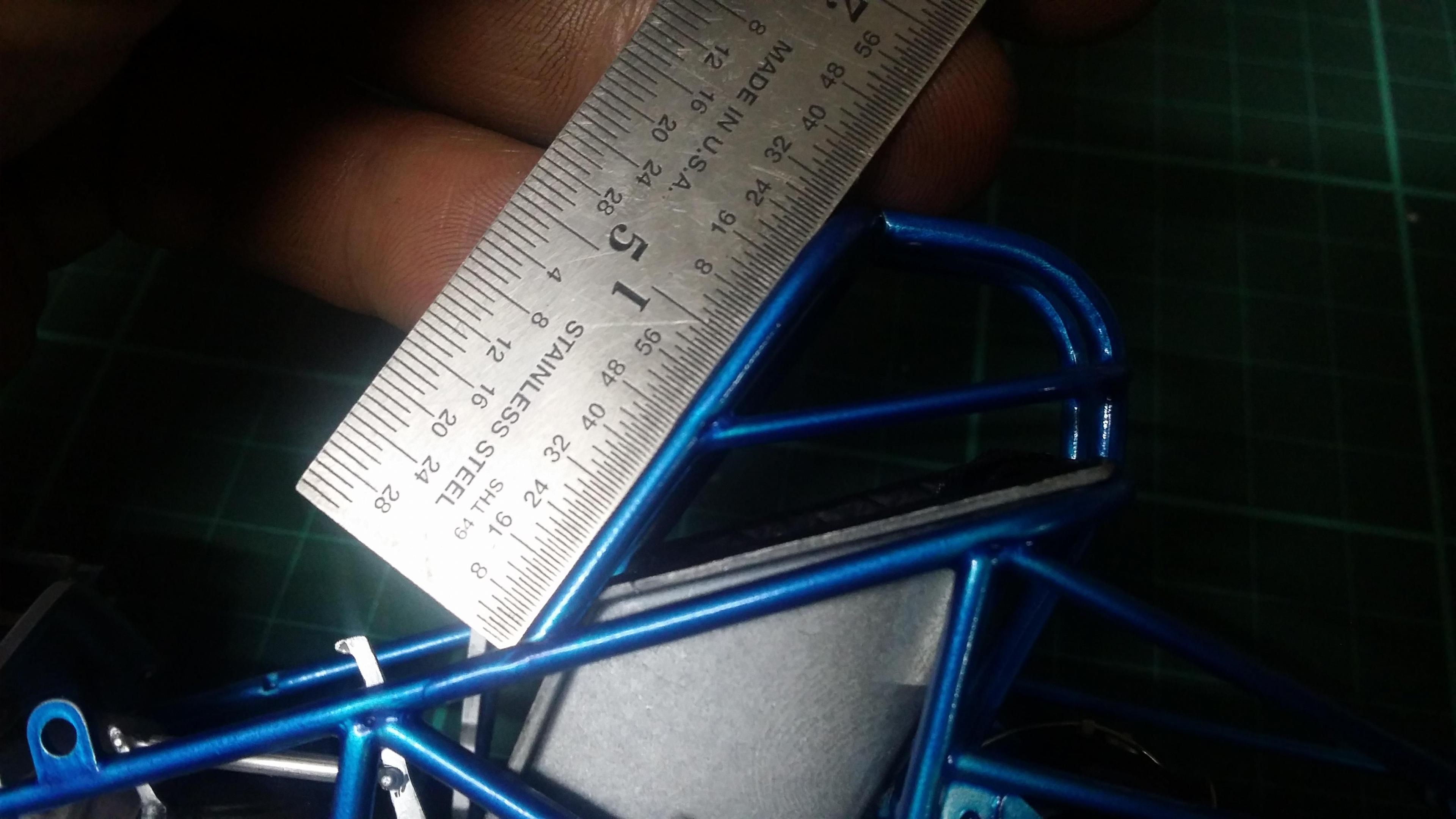

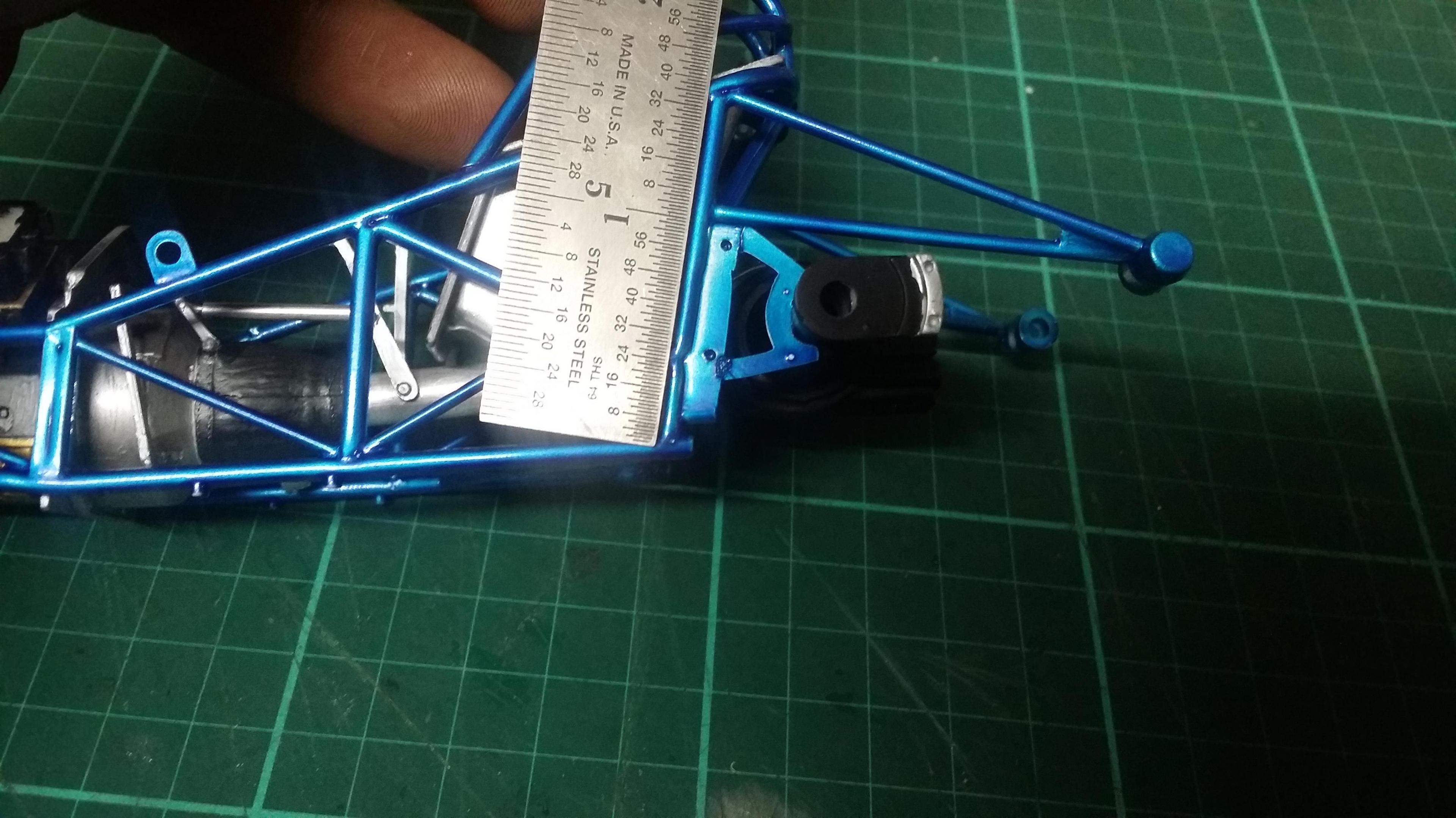

1320 Posted April 20, 2020 Author Posted April 20, 2020 Thanks Roadrunner and DPNM, I really appreciate the kind words. DPNM the kit isn't 'off' as such but when built has a very high ride height. If you look at reference pics of funny cars from this time, they sat pretty high but these kits build up really high! I'm not usually someone who builds for historical accuracy but more about building what I think looks good. For that reason this kit will sit as low as it can which will definitely be lower than the real deal ever was. I'll post some pics of the areas I've changed so you can compare to your kit. The rear end mounts, the cage drop and the rear body mount are the start. After that the front body mount and seat need fixing. 1

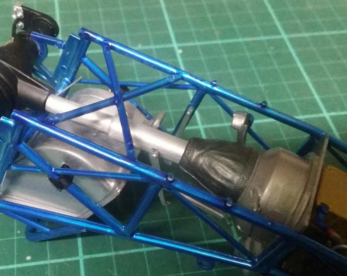

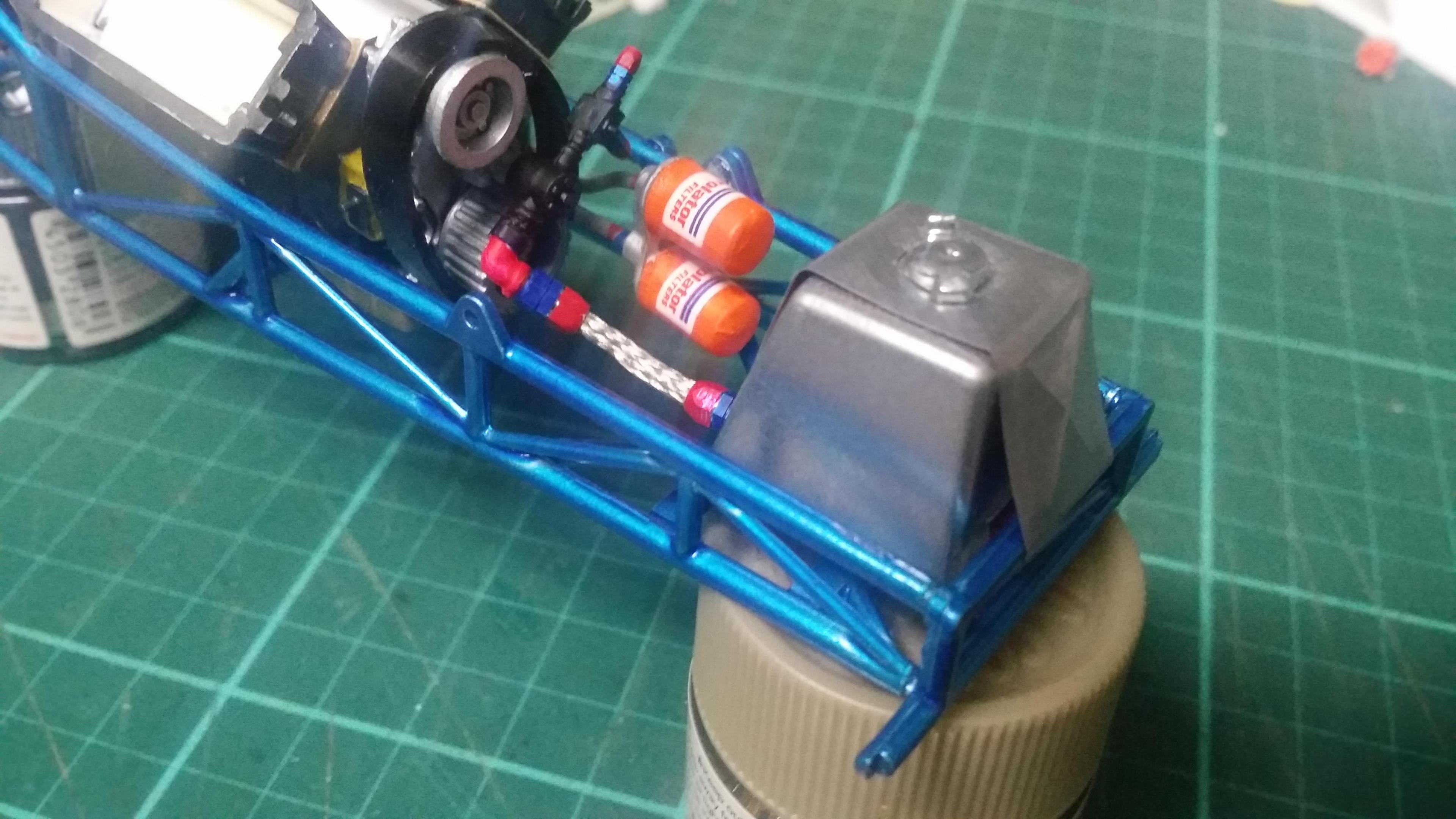

1320 Posted April 20, 2020 Author Posted April 20, 2020 I haven't been back to the lathe yet to finish the remaining wheels but haven't been without results. I fitted the engine oil lines, filters and fuel tank, then made a supply line to the fuel pump. I made a fuel tank hold down strap from a coke can and tried bead rolling. It came up just ok but I'll keep it on there otherwise this build will take years. Because I changed the ride height the seat needed modifying for drive shaft clearance. You can see the relief in the front of the seat and I pushed the base up also. I didn't like the kit drive tube much so found two aluminum tubes that would telescope and fitted those. Thanks for looking. Jim 1

DPNM Posted April 20, 2020 Posted April 20, 2020 Thank you very much for adding the pics so I have a better understanding on what you've done so far Jim. Your ruler intrigued me also. Looks so much like it would be good for working in scale I bought a small one.

1320 Posted April 21, 2020 Author Posted April 21, 2020 15 hours ago, DPNM said: Thank you very much for adding the pics so I have a better understanding on what you've done so far Jim. Your ruler intrigued me also. Looks so much like it would be good for working in scale I bought a small one. Glad it clicked a gear for you! Being an engine and carb guy day to day means quite a few tools that cross over to models! Jim
