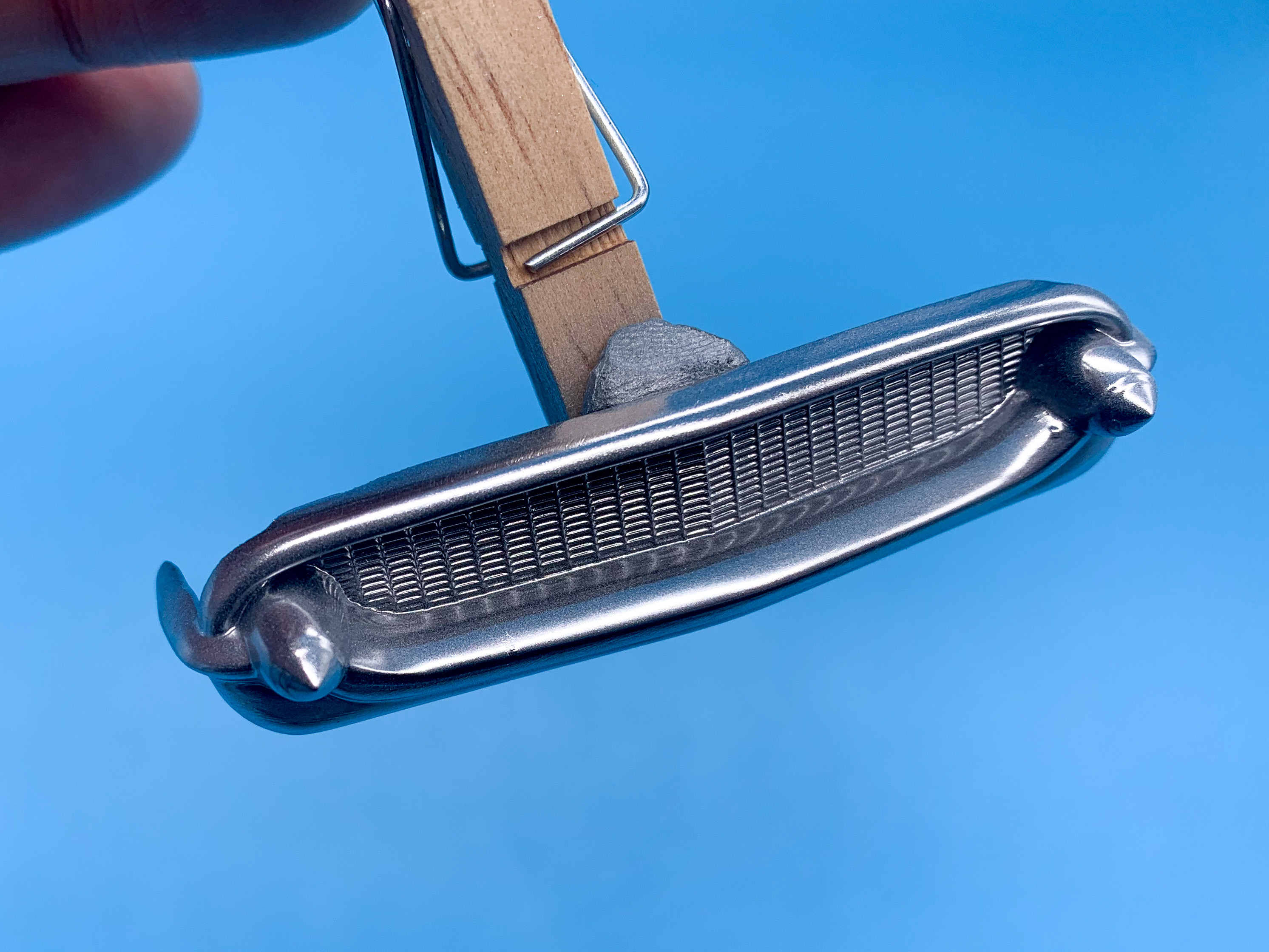

First experiment, misted on over black enamel, straight out of the bottle:
Not bad - kind of has that polished metal look but not what I would call chrome.  I let it try for an hour or so in the dehydrator to see if it got any shiner, but nope.

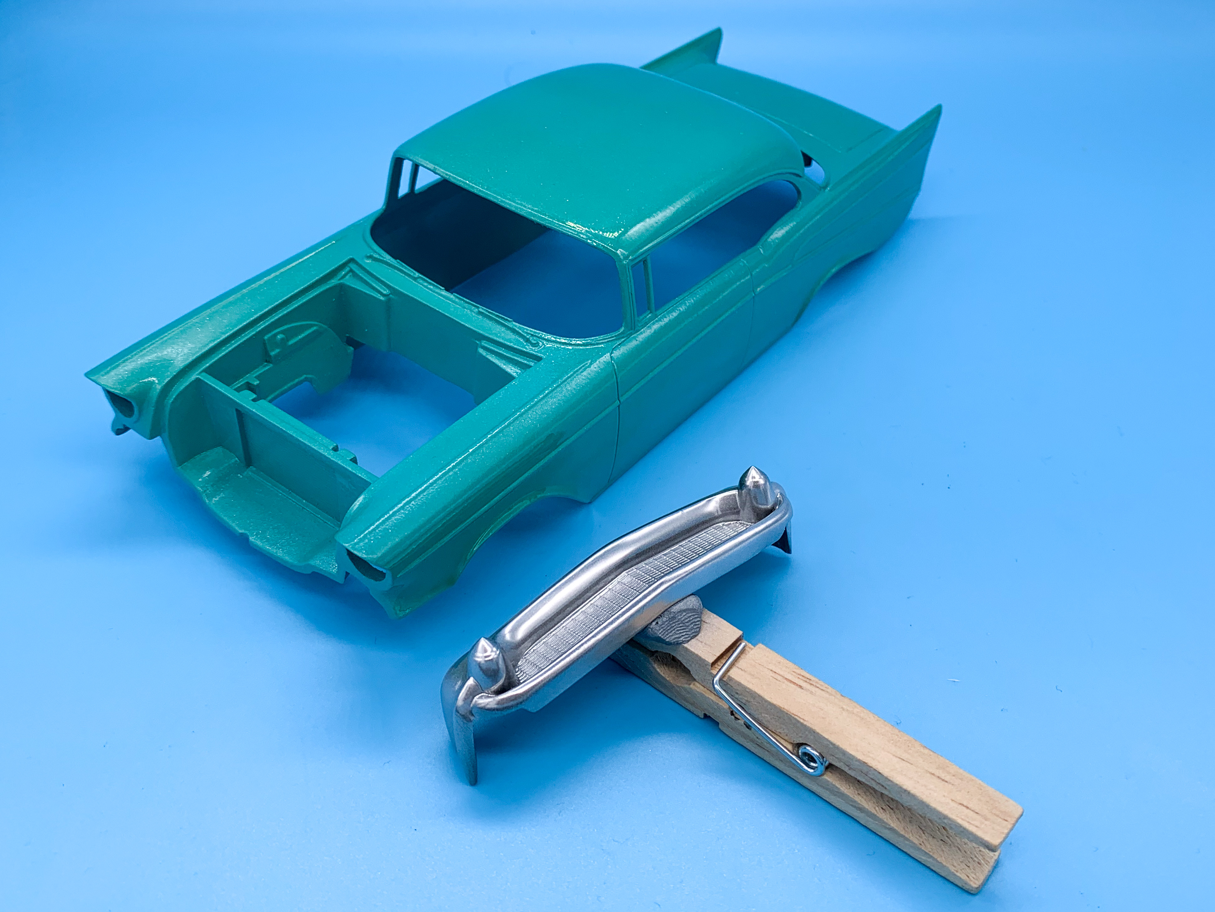

Next experiment, a couple of drops of Createx airbrush thinner to let it mist and atomize out of the airbrush a little better, shot over black enamel again:
Shinier!  It laid down smoother, atomized better coming out of the airbrush and is definitely a better result than shooting it unthinned.

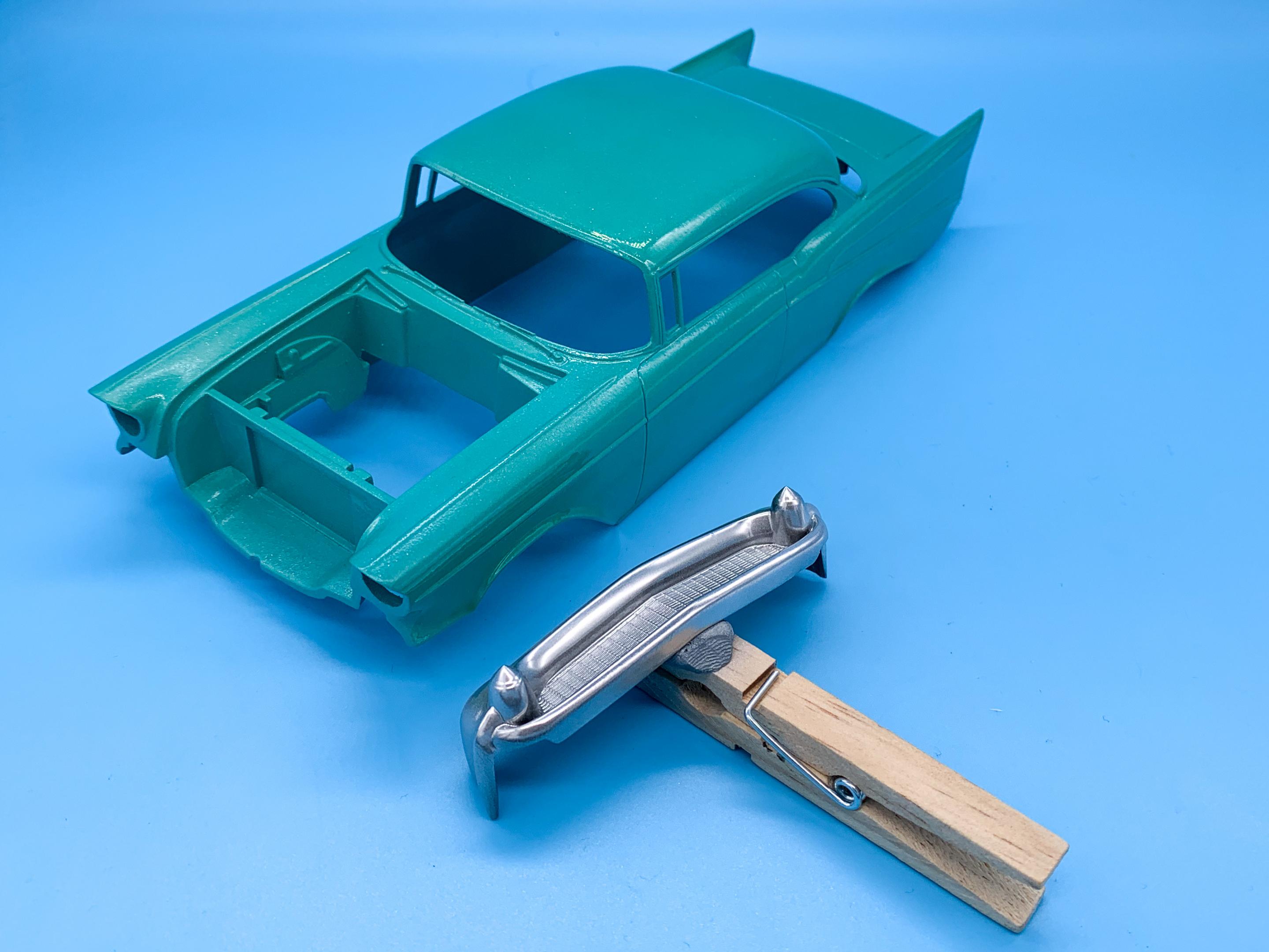

Next experiment, this time thinned with a couple of drops of Sunnyside lacquer thinner:
Way better!  Actually got something approaching chrome this time.  It has a little bit of a haze to it, which is something I tend to get with Spazstix too (although not Alclad)…which, if it’s like Spazstix I should be able to buff out to a really nice reflective chrome finish.  I’ll let the parts dry for a couple of days and see if a polish-job improves them further.
Overall, I’m not blown away by this stuff so far, but I don’t dislike it either - it’s better than I thought it would be!  Not necessarily any better or worse than Spazstix / Alclad - just different!

In your photos it seems to lack some resemblance to chrome, but as with any of these types of paints they seem to need some experimentation. It does however have an excellent polished metal look, a little dark for aluminum but it still looks good and has numerous possibilities.  I'm definitely going to order some and give it a try. When rumors of airbrushing Metalizers being discontinued started a number of years ago I stocked up quite a bit but never hurts to have an alternative or even another variation for metal finishes. Thanks for the photos and review.
I agree, it’s not quite a perfect mirror finish like you’d hope.  And if you have to shoot a black base like you would for Alclad and then add lacquer thinners to make it even more like Alclad then I guess I may as well use, well, Alclad ?
As you rightly mention though, it’s nice to have different sheens and colors for these metal finishes - I mix between Alclad and Spazstix a lot because to my eye they have their own looks somewhat.
I’m hoping that after a couple of days I’ll be able to buff these parts with a q-tip like I like to do with Spazstix and they’ll really start to pop…I’ll report back if it works (or, indeed, if it doesn’t…)
