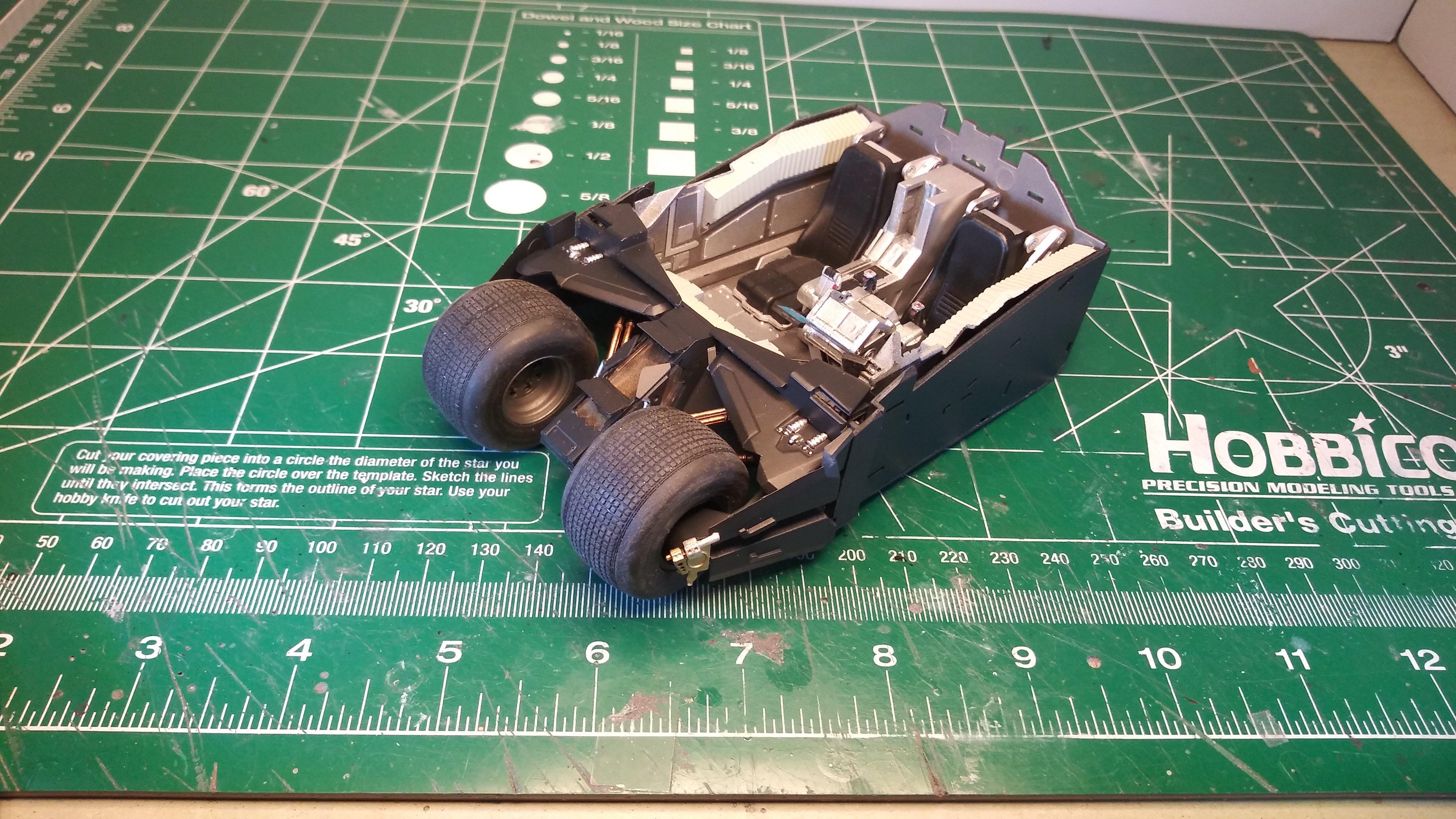

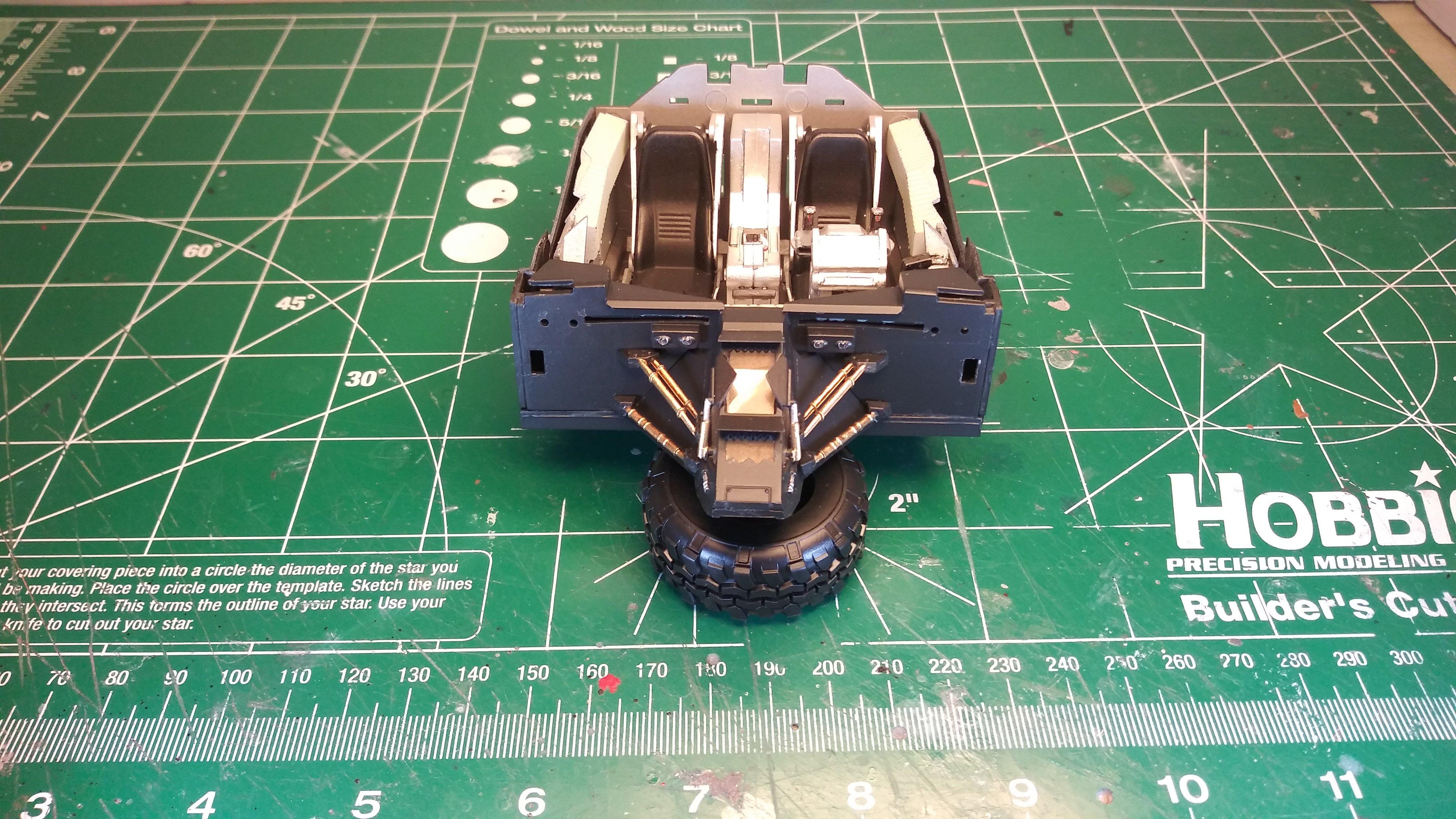

When I started building this kit, my desire (aside from adding another Batmobile to my collection) was to be able to complete a build within a reasonable amount of time. So far, this kit has provided me with a good balance of challenge and accomplishment. It's a rather simple kit but the unique design and structure add a bit of interest to the building of it.
Struts and braces added to the front.
Front suspension and wheels.
There's not a lot of clearance for the wheels.
But I guess that Batman knows what he's doing.
