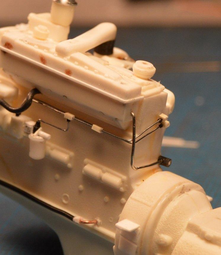

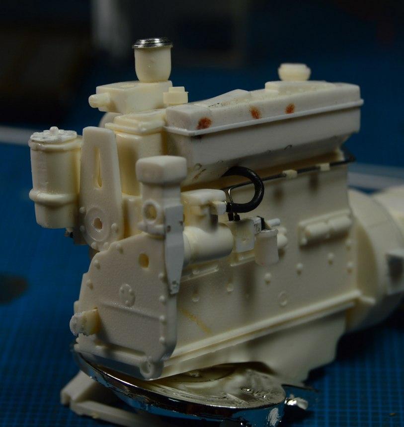

Straightliner59 Posted July 28, 2020 Author Posted July 28, 2020 Engine progress. I've added little details, and been filling sinkholes. There are fewer sinkholes, in Florida, than in this kit! I have also begun work on the pulleys, which was necessitated by the fact that some of the components didn't seem to want to fit with the kit belt assemblies. Except for the crank pulley/harmonic balancer/alternator be;t assembly, the rest of the belts and pulleys will be scratchbuilt. As always, questions, critiques and comments are always welcome! Thanks fer lookin'!

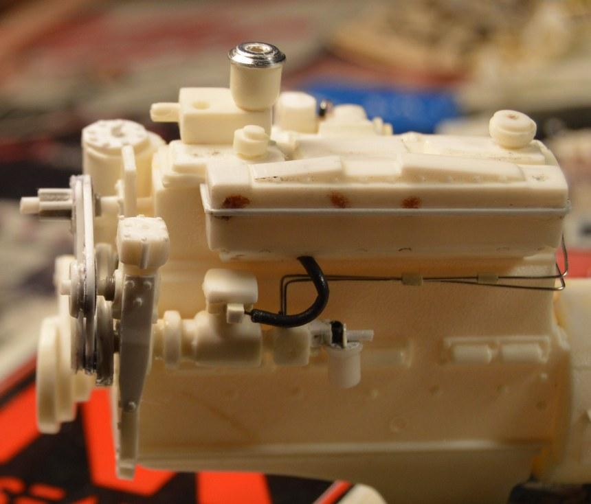

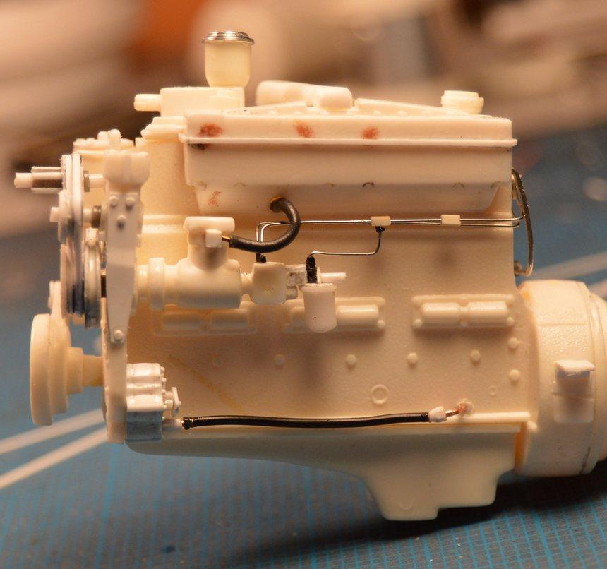

Straightliner59 Posted July 31, 2020 Author Posted July 31, 2020 More work done to the pulleys and compressor. I don't have photos, yet, but, the compressor is mounted.
Straightliner59 Posted July 31, 2020 Author Posted July 31, 2020 Thanks, Lee. With seemingly no two of these 350s alike, it's interesting, sorting out the plumbing on this thing, for sure! There are so many different things in so many different places, that, about all you can do is find the lines that are common between them, and install those.

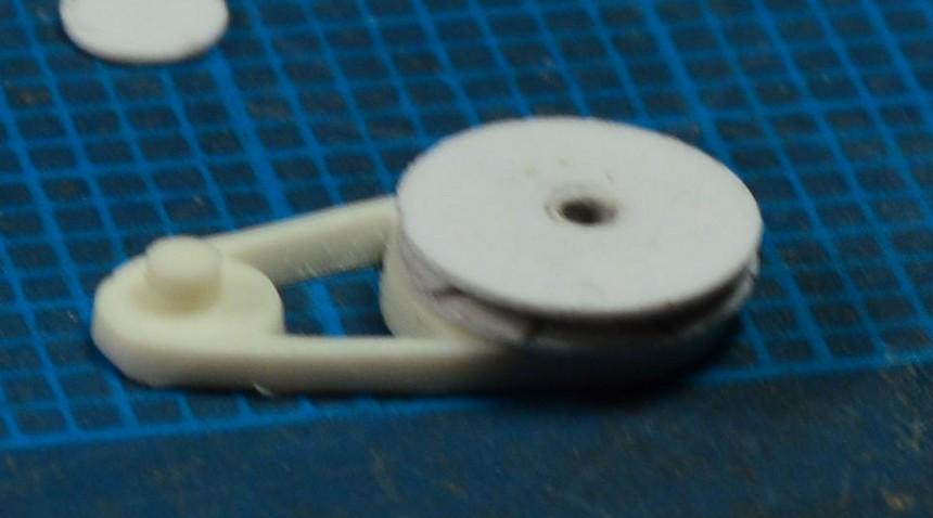

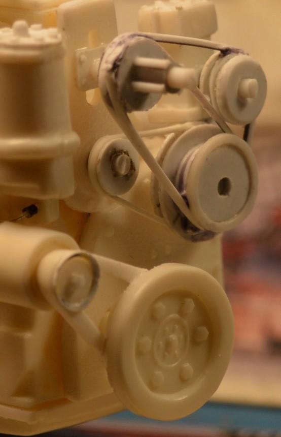

Straightliner59 Posted August 1, 2020 Author Posted August 1, 2020 A little more of the belts/pulleys assemblies. If I had larger diameter stock, on hand, I would have turned the pulleys on the lathe. Since I don't, I am using punched discs of alternating diameters, to make the pulleys. I've begun to make one of the belts. This is a flat belt. To re-create the v-belts, I plan to sand off one of the angles from some Evergreen triangular stock. Here, the now mounted compressor can also be seen. As always, questions, critiques and compliments are welcome!

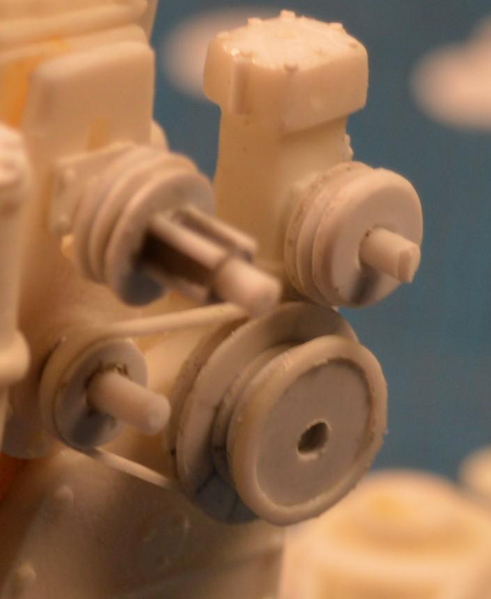

Straightliner59 Posted August 3, 2020 Author Posted August 3, 2020 I think the pulleys are mostly done, excepting some minor details. You can see the belt/pulleys for the crank and alternator, as well. It will be interesting, making v-belts from triangle stock, but, it should look pretty cool, when it's done. Looking to get the engine to the point of paint, so I can move along to the chassis. Questions, comments and critiques always welcome!

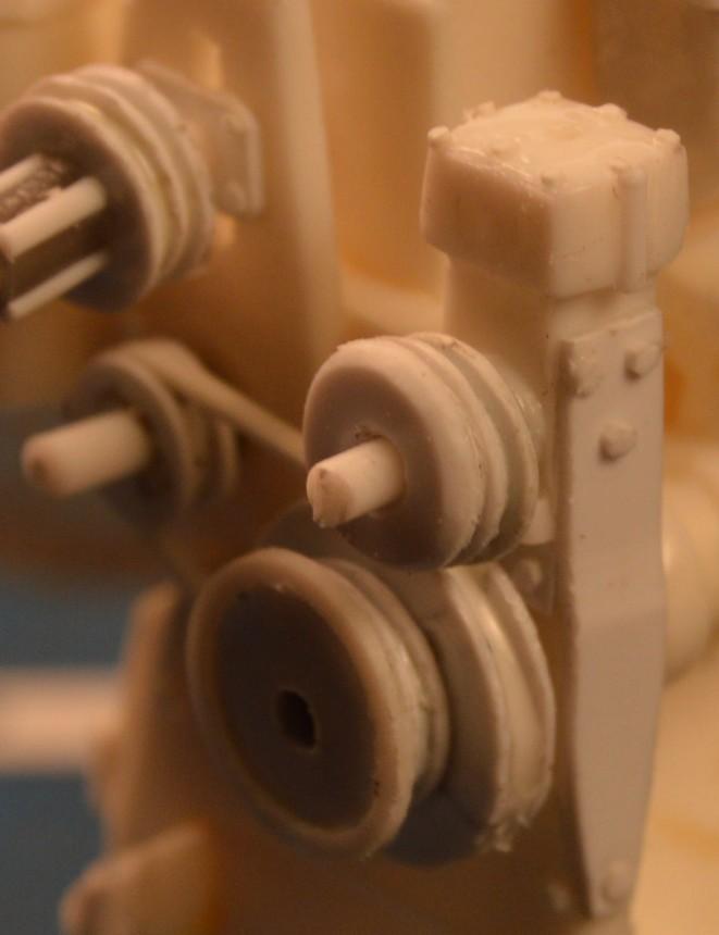

Straightliner59 Posted August 4, 2020 Author Posted August 4, 2020 Okay, they need some cleanup and adjustments, but, the belts are on! I used a no. 11 blade as an adze, to flatten one of the angles. I colored the flattened edge with a black Sharpie, so that I could easily see which side I wanted to be facing in. I made the belts with Plastruct .030" triangular stock. There is also a photo of the kit piece these belts replaced. As always, questions, critiques, and comments are always welcome! Thanks for looking!
Straightliner59 Posted August 4, 2020 Author Posted August 4, 2020 (edited) 1 hour ago, Mopar - D said: Your belts look good! Thank you, Dan. I think they're better than the kit parts, no? ? I got the joints cleaned up, on them, after I took these. Edited August 4, 2020 by Straightliner59
