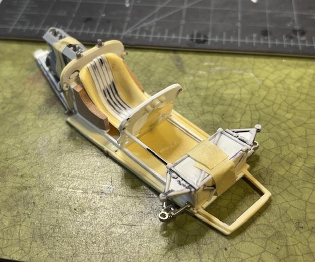

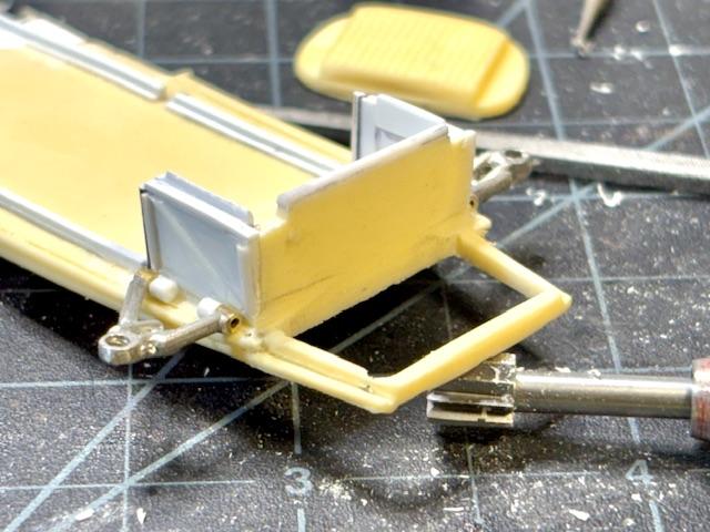

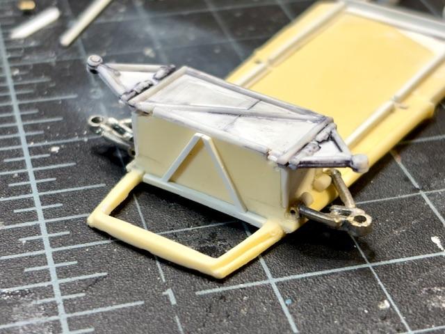

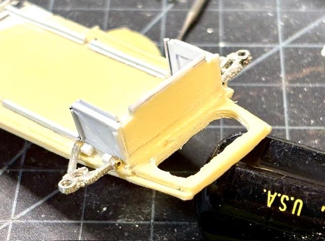

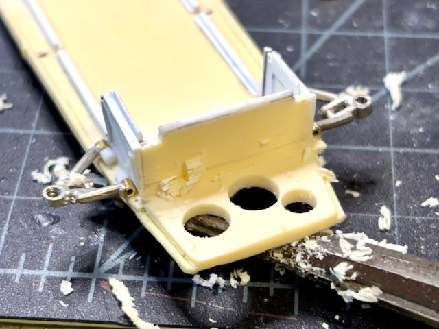

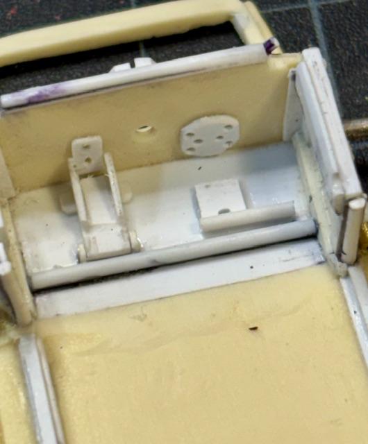

absmiami Posted April 7 Author Posted April 7 Since this was a curbside kit - the chassis plate extends forward past the first bulkhead to the location of the radiator - but as with most other open wheelers with forward radiators - this space should be open - i’ll make an oil tank and improve upon the kit radiator - therefore the surgery you see in these pix …

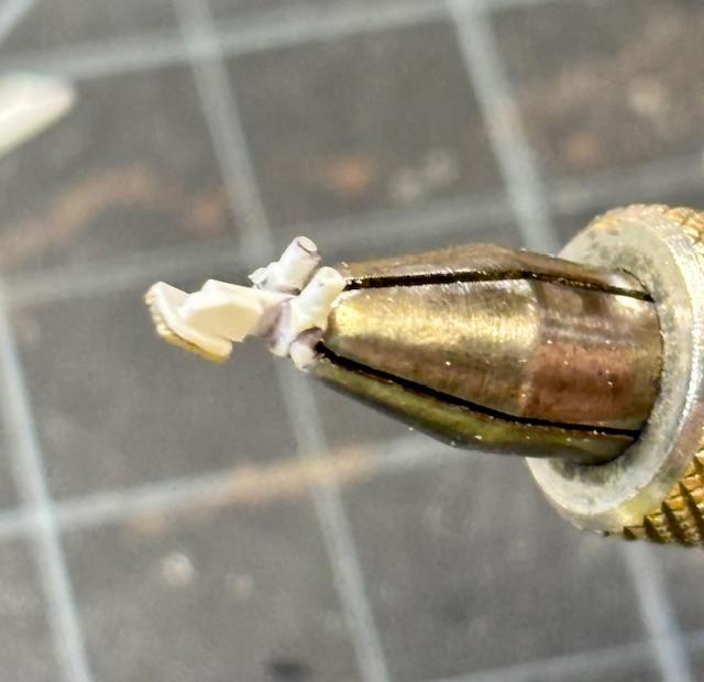

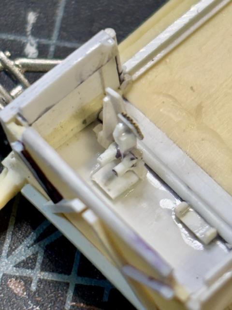

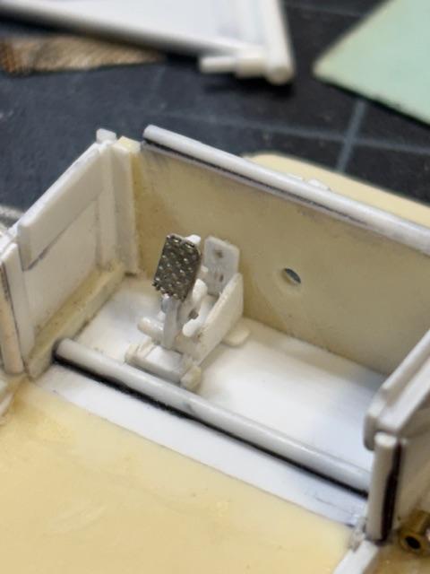

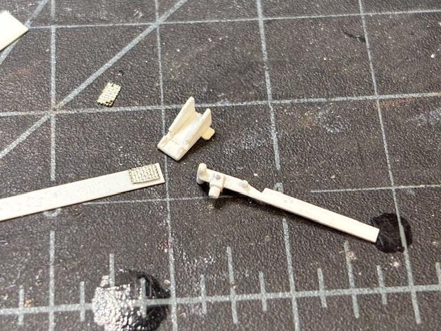

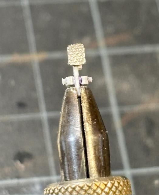

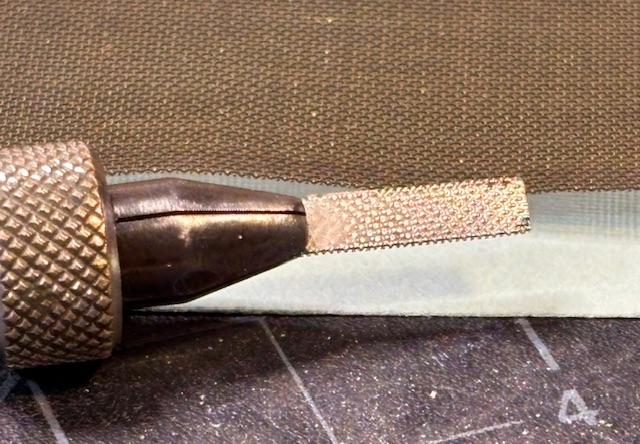

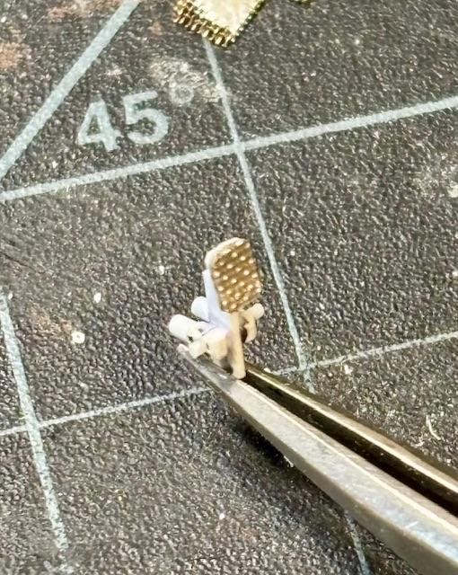

absmiami Posted April 7 Author Posted April 7 Pedals - clutch and brake pedals had cast non-skid surfaces - made these with some solder melted over some fine brass screen - 3
MarkJ Posted April 8 Posted April 8 Wow, Andrew. That's some thinking out of the box on making those pedals with the solder on a screen. Look perfect.

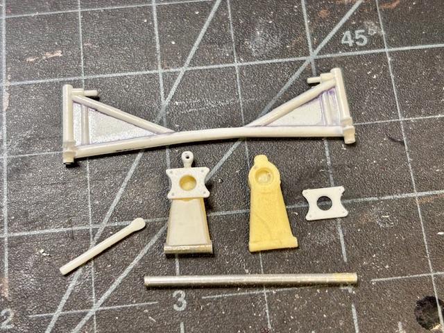

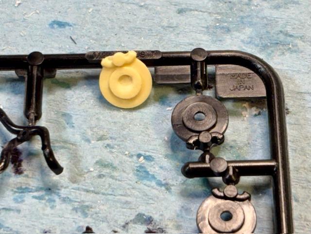

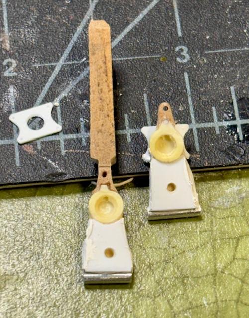

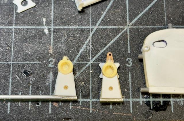

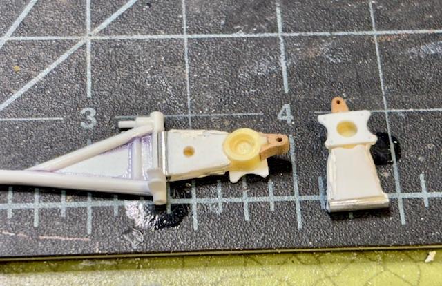

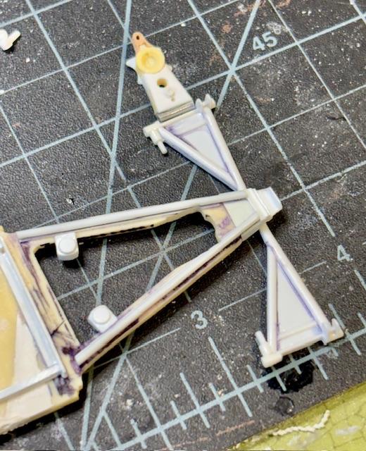

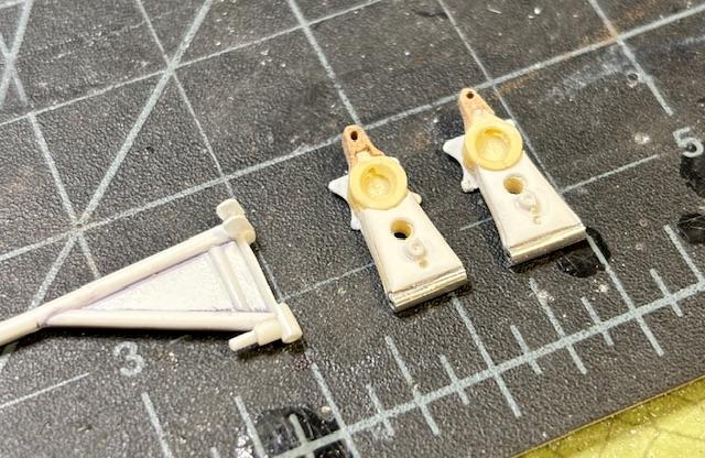

absmiami Posted April 11 Author Posted April 11 The rear susp uprights fr the kit need some changes …

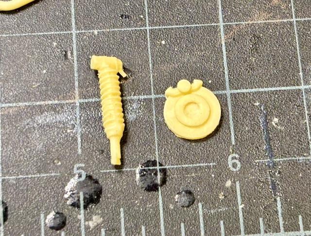

absmiami Posted April 11 Author Posted April 11 The brown material is Renshape - handy for reshaping the tip of the uprights - Evergreen strip to make a thicker part and add the flange that holds the disc brakes - the flange has flaps left and right because the component was made to be usable left or right …

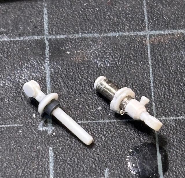

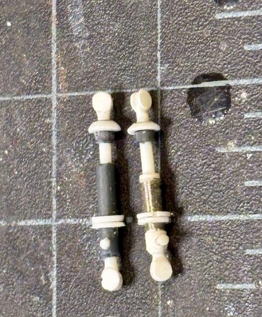

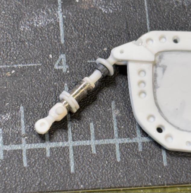

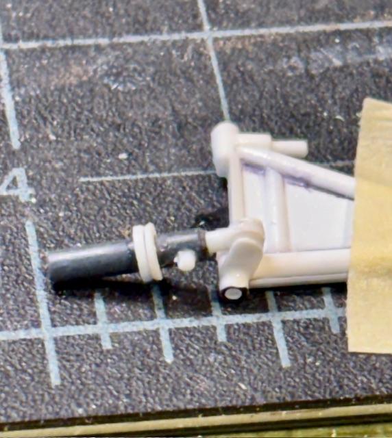

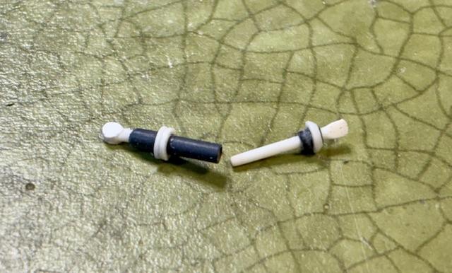

absmiami Posted April 14 Author Posted April 14 Kit rear susp shock on the right - new and improved shock body on the left …

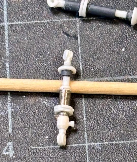

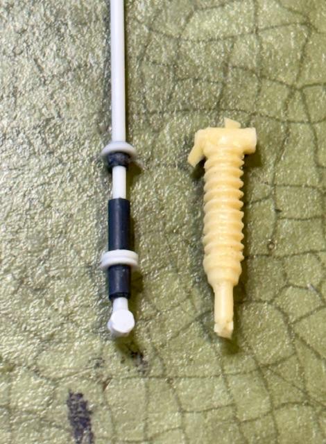

absmiami Posted April 14 Author Posted April 14 (edited) I then made a second shock with a wrapping of .005 wire to resemble the narrow pitched thread on the shocks - ill see if i can get these cast … Edited April 14 by absmiami Spelling

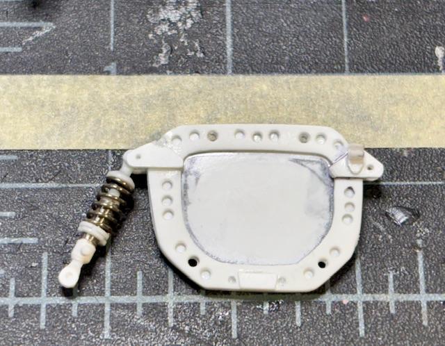

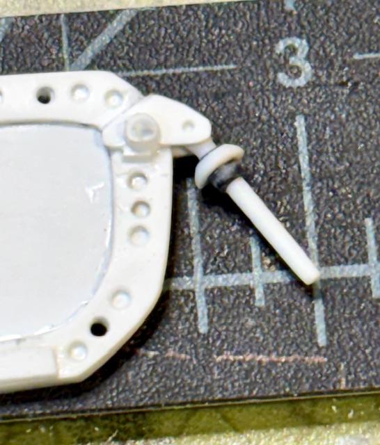

absmiami Posted April 14 Author Posted April 14 This is how the shock mounts to the bulkhead - i’ll rummage thru the parts boxes for some decent springs …
absmiami Posted April 16 Author Posted April 16 Springs are a PITA this one is from railroad scale guys - Precision Scale - correct width but too short -

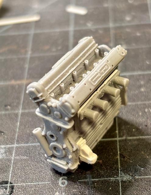

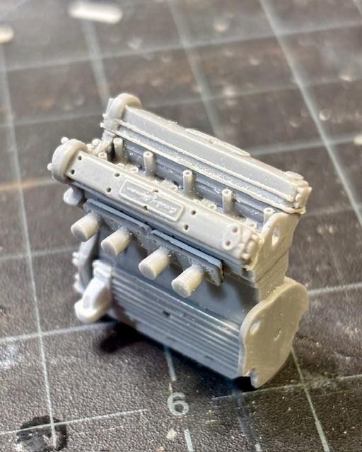

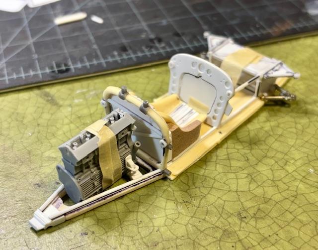

absmiami Posted April 17 Author Posted April 17 Engine w cyl head mockup - epoxied - to check the mounting height in the frame -
