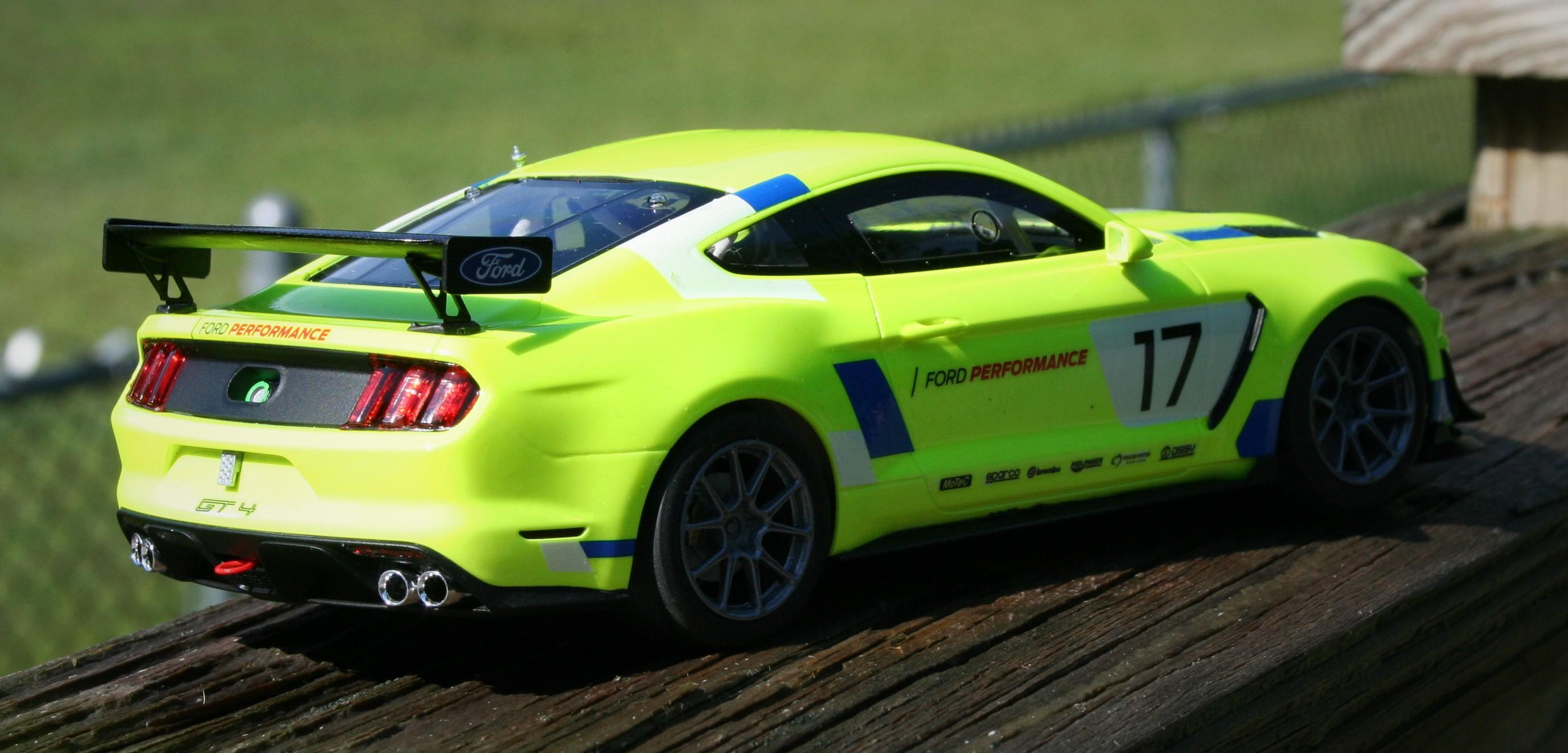

Penguins87 Posted July 11, 2020 Posted July 11, 2020 (edited) Well, here it is completed. Being it was my first I built it right out of the box to learn the good and bad of the kit. Kit is great. Came out OK but the door has two specs of something that came while clear coating. I learned to wait and put the side ground effects on after chassis is placed in the body. It fits tight and making the chassis hard to get in. Edited July 12, 2020 by Penguins87
Rich Chernosky Posted July 21, 2020 Posted July 21, 2020 Interesting choice of colour, can't miss that one on the track. Whose paint did you use and what clear coat. ??
Penguins87 Posted July 22, 2020 Author Posted July 22, 2020 I used Createx Wicked Colors, Flourscent Yellow and House of Kolor USC01 clearcoat. Love their clear. It self levels and requires very little polishing. However there was a learning curve to get it reduced for our scale projects. I've done a couple Nascar kits before the GT4 and used it. Seemed to go on to thick and kinda syrupy. They say mix 3-1-1 (paint, reducer, catalyst) probably perfect for full size cars. Looked good but I found (3-3-1) misted on is better. Doesn't build up as fast. More realistic to scale. Dries hard in less than 24 hrs.
Rich Chernosky Posted July 22, 2020 Posted July 22, 2020 I was curious because I have struggled with flourescents for years. By their very nature they are porous and absorb the solvents of any clear coat. Which changes their color and dulls them down. My solution was to go to a water-base clear. Krylon makes one in a paint called Lo-Odor. It dries very clear and builds nicely. Doesn't change the color of metallics or flourescents. It dries very hard but can take as much as 2 months to cure depending on humidity. So I am always looking for quicker solutions. Thanks for telling me. The artistry of modeling is in the paint...in my opinion.
Funkychiken Posted July 26, 2020 Posted July 26, 2020 cool mustang, and looks great in day-glow yellow!
Penguins87 Posted July 27, 2020 Author Posted July 27, 2020 Thanks all. I bought four more of these kits and some decals from Indycals. Doing the Volt car now. Painted interior on Saturday (AS20) and exterior yesterday (Gravity Colors flourescent yellow). Got to put down a couple coats of lacquer clear and polish out before decaling.
TonyK Posted August 9, 2020 Posted August 9, 2020 Very nice job. Thanks for the tip on the side pieces. Working on mine now and it looks like a typical Tamiya kit. Lots of detail painting and much of it won't be seen.
