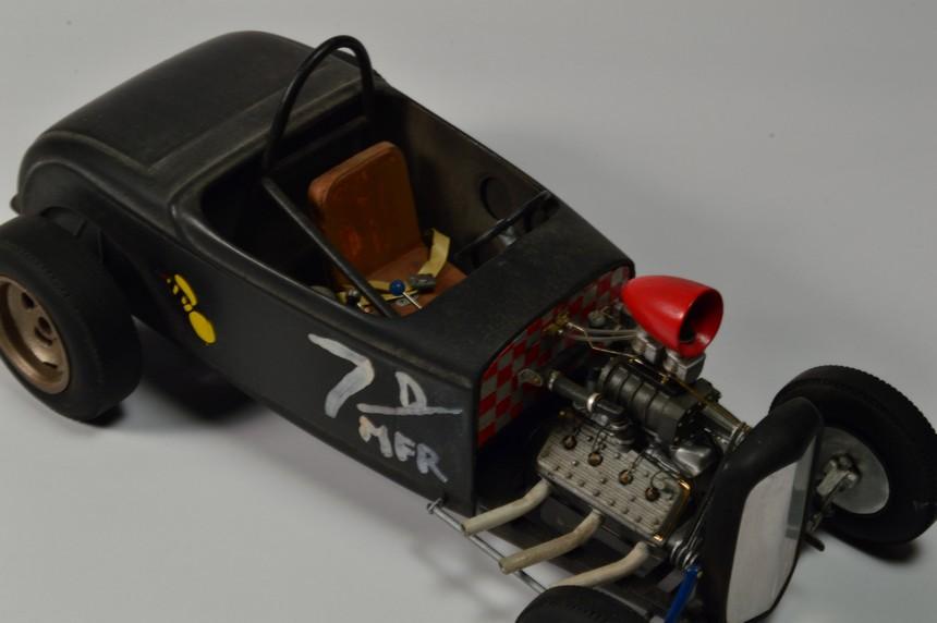

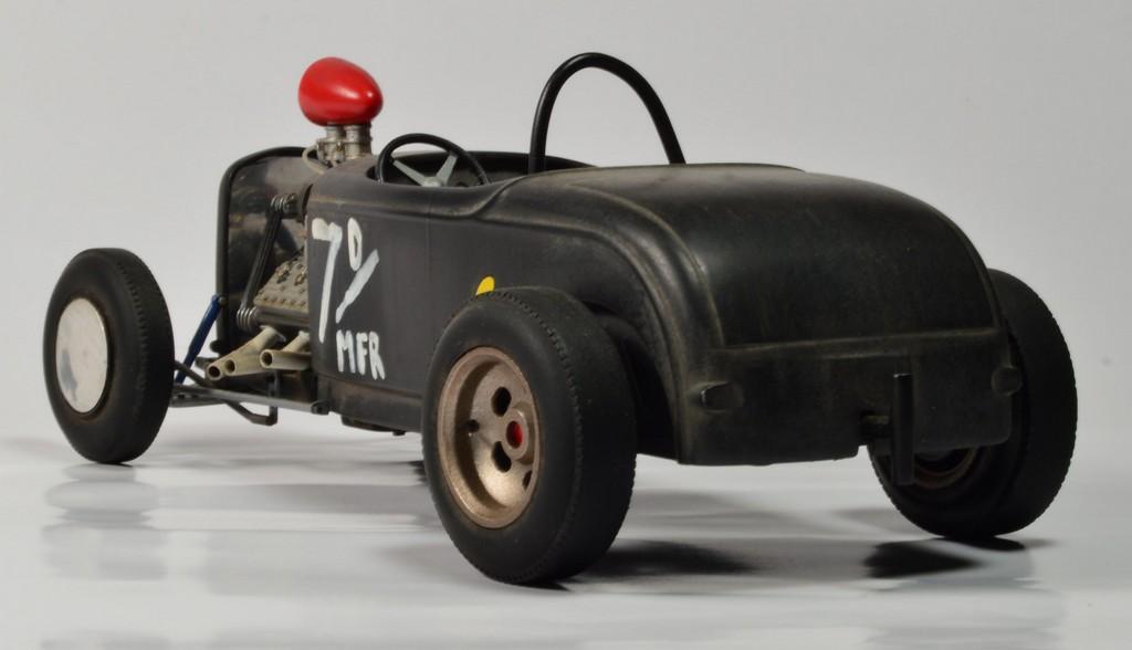

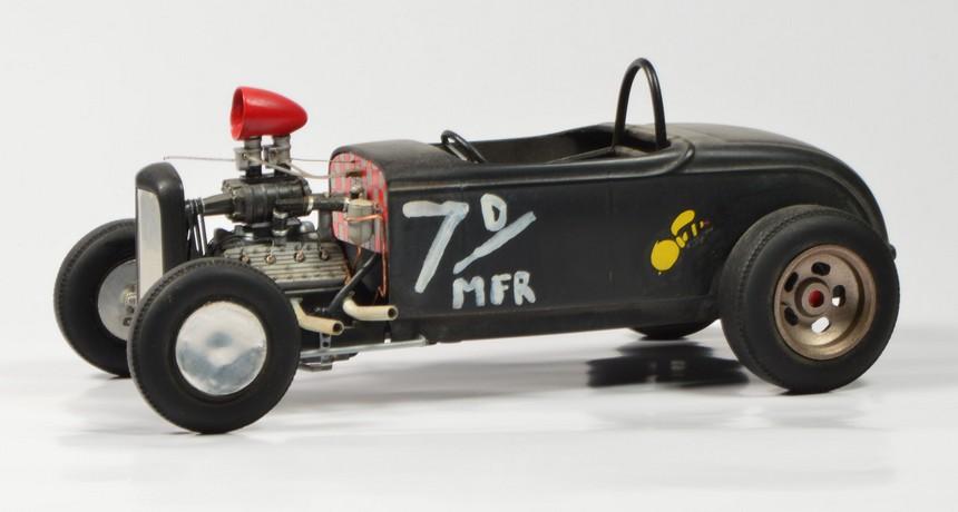

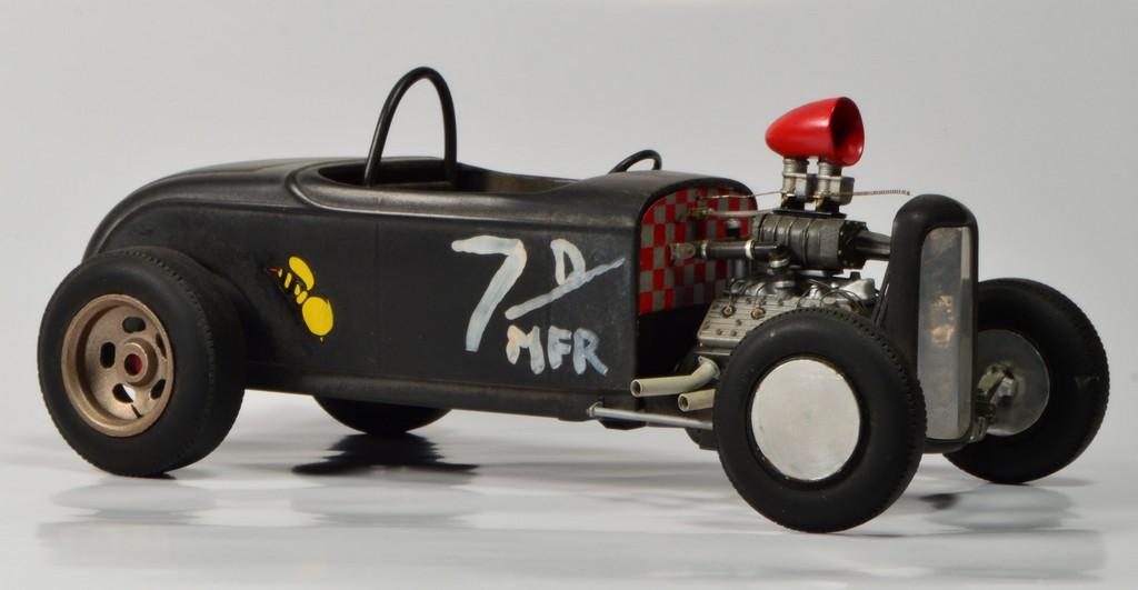

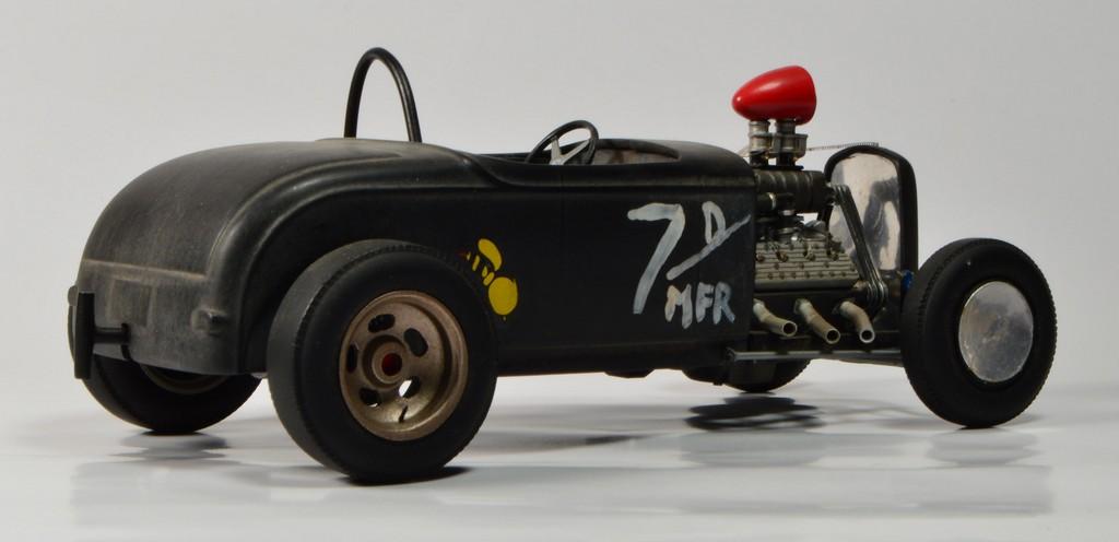

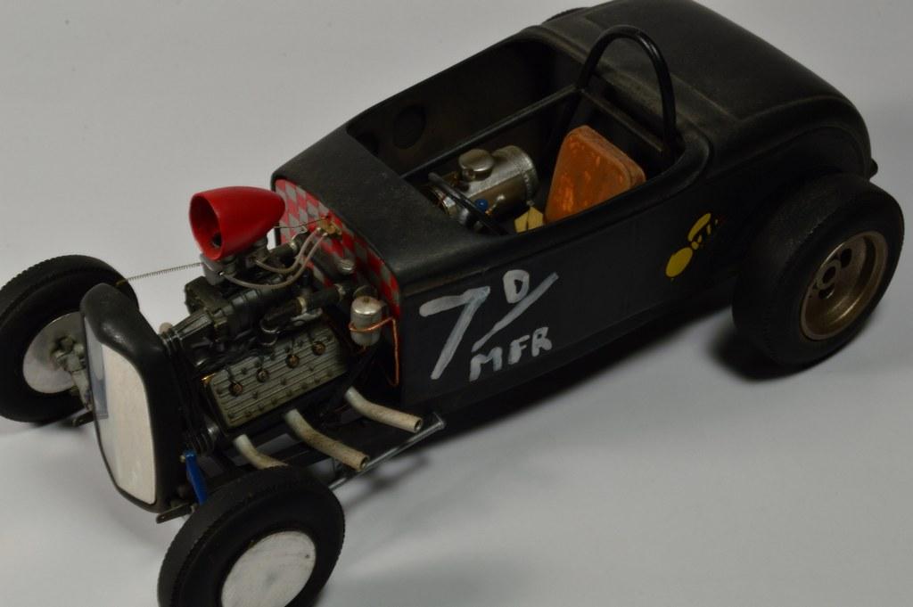

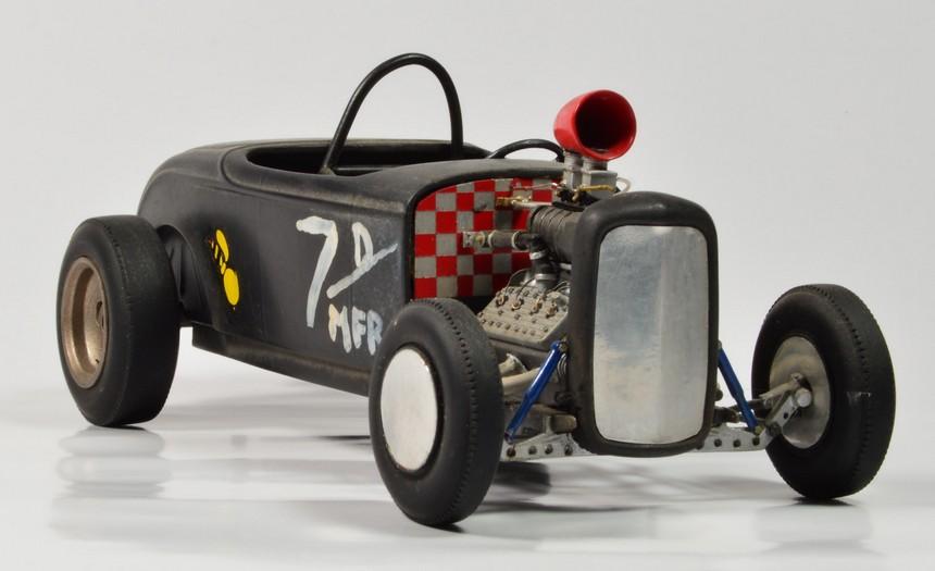

Straightliner59 Posted July 24, 2020 Posted July 24, 2020 (edited) Another segment of "New Pics Of Old Builds". This time, a '32 Ford roadster, built from Monogram's ancient "Drag Strip Hot Rod" kit. This one was built from the Selected Subjects release. I made the firewall and interior door panels from aluminum sheet. The engine is basically a detailed version of the kit's engine. I used foil from a Rolo candy, to make the head gaskets. The scoop is a headlight bucket from a '39 Chevy. I scratchbuilt the headers and linkages. The drive belts are electrical tape, wrapped around pulleys made by layering alternating sized discs of plastic, punched from sheet. The fuel tank, and hand pump are scratched from various diameters of rod and tubing. I used aluminum duct tape to replicate the "plumbers' tape" that holds the tank down. The seat and rollbar are both scratched. Wheels and tires are from the kit, with aluminum discs, punched from thin sheet. Questions and comments are welcome! Thanks for looking! Edited July 24, 2020 by Straightliner59 1
