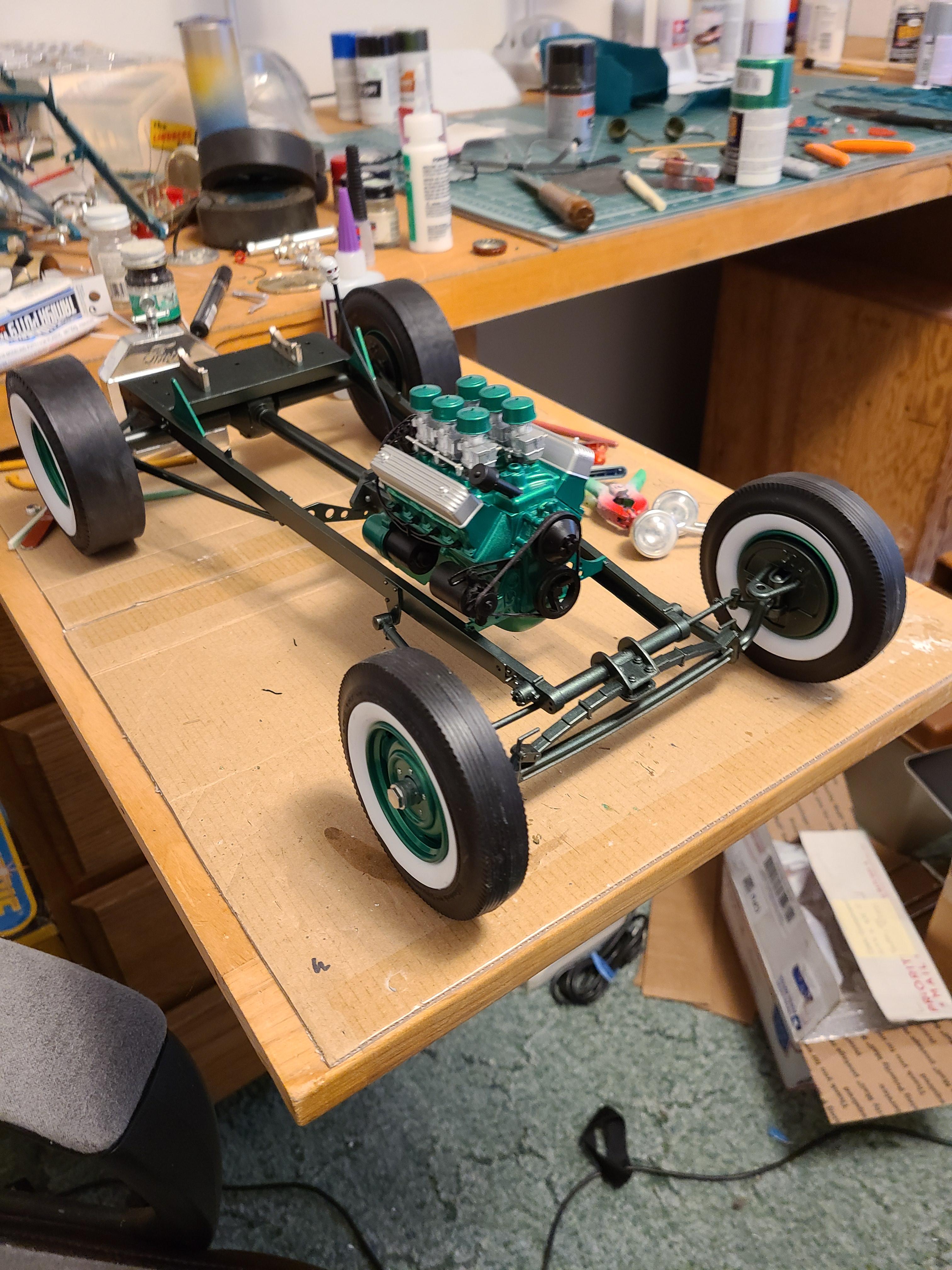

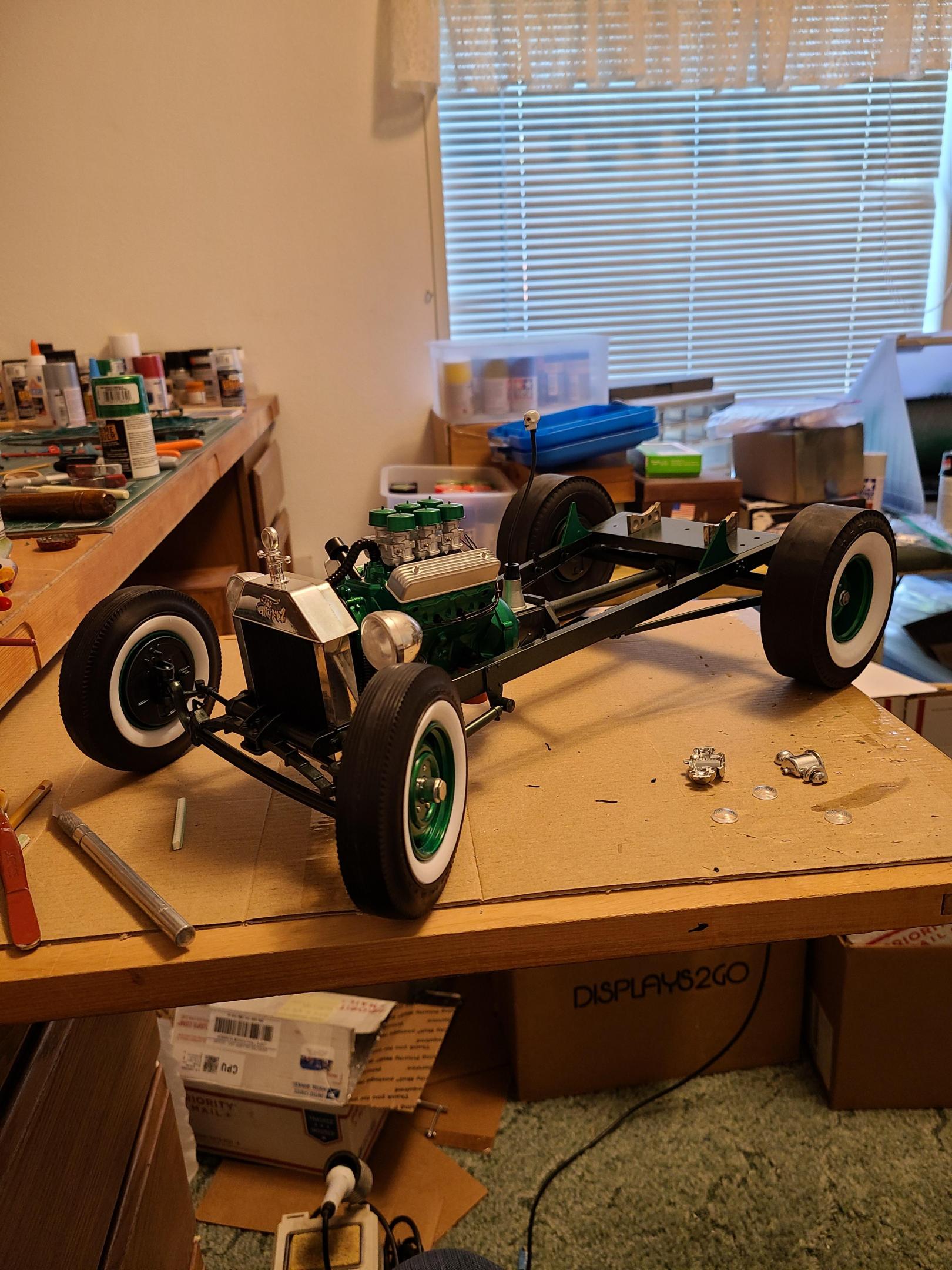

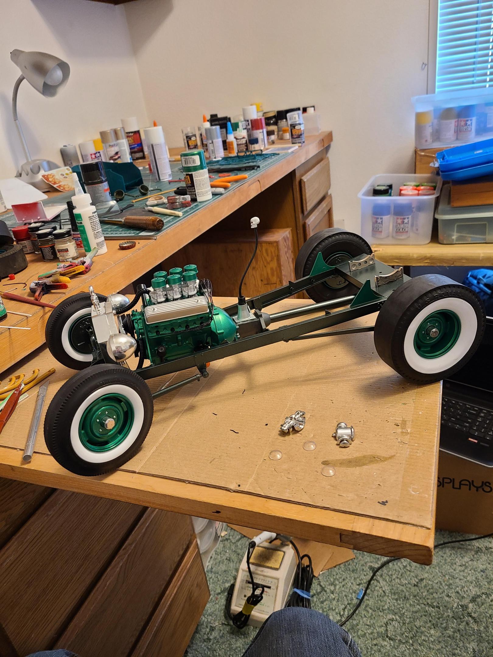

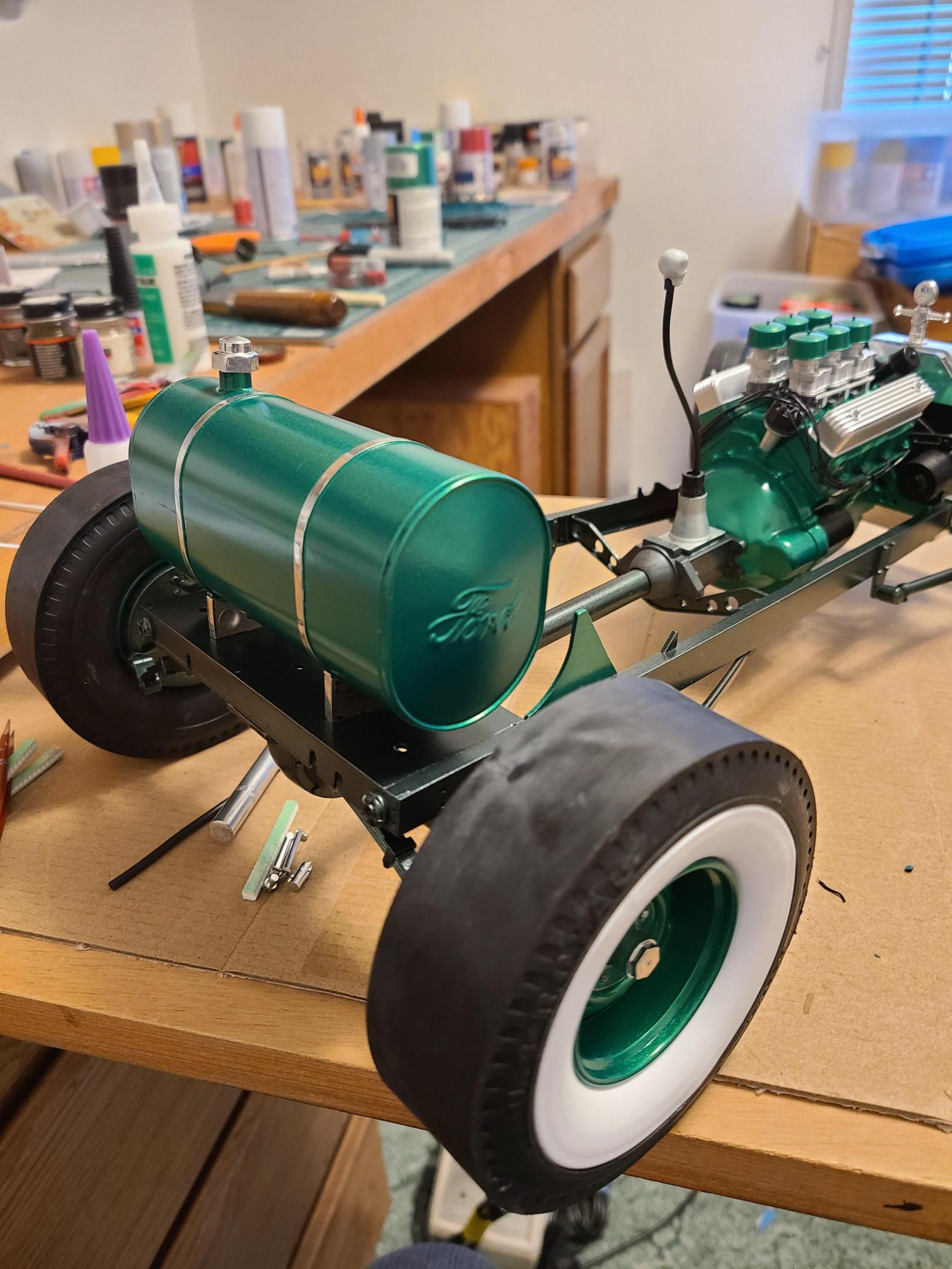

Sam I Am Posted October 14, 2020 Author Posted October 14, 2020 So all of the suspension, drivetrain, etc are installed. Now onto the body...
Quiet Eric Posted October 15, 2020 Posted October 15, 2020 Looks great!! Big scale is fun, just hard to find a place to put them when finished. Really like the green. For what it is worth...these early Ford transmissions to not have a seal like that for the shifter. It is a spring supported domed steel washer inside a collar/retainer. There would have been a rubber boot on the floor to keep the outside stuff from coming inside the car, but it wasn't really a seal of any sorts for the transmission.

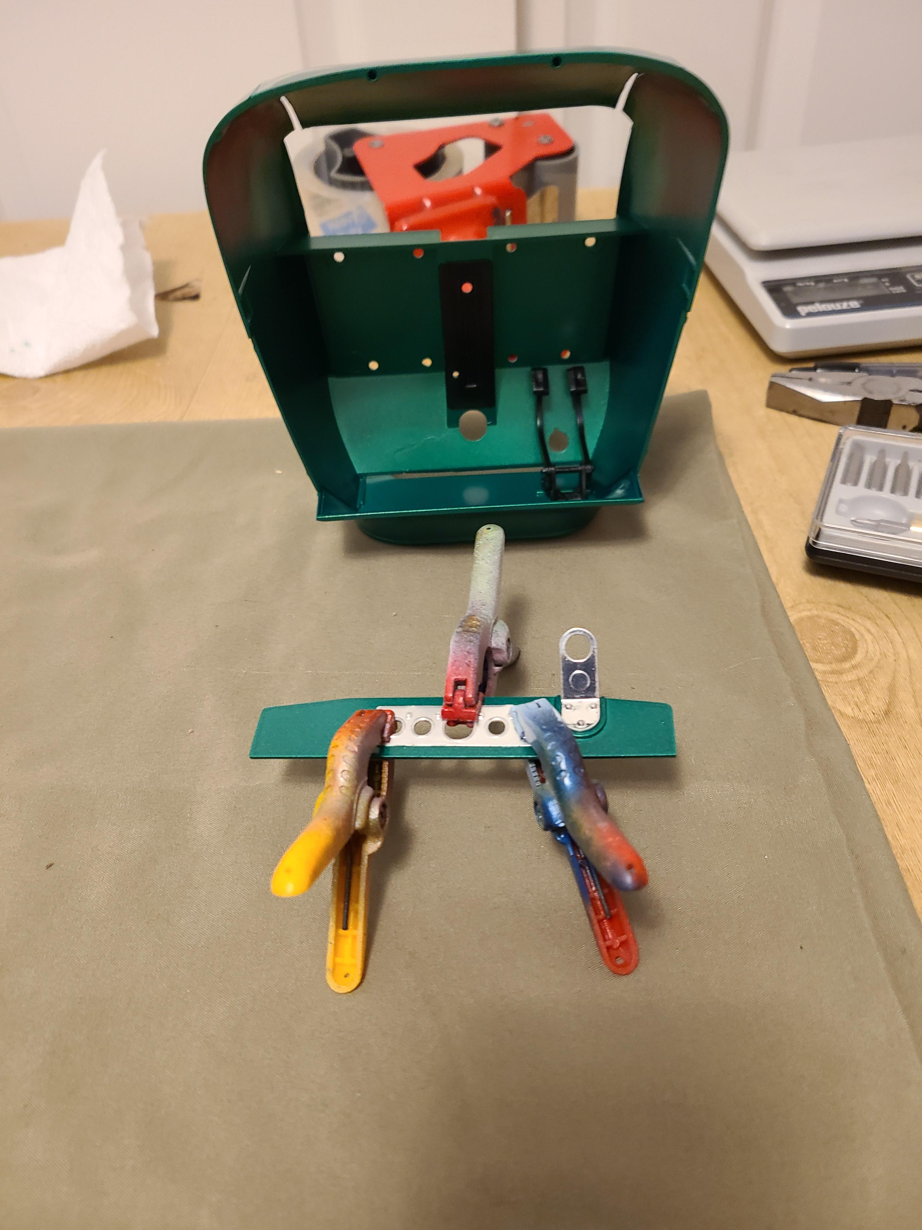

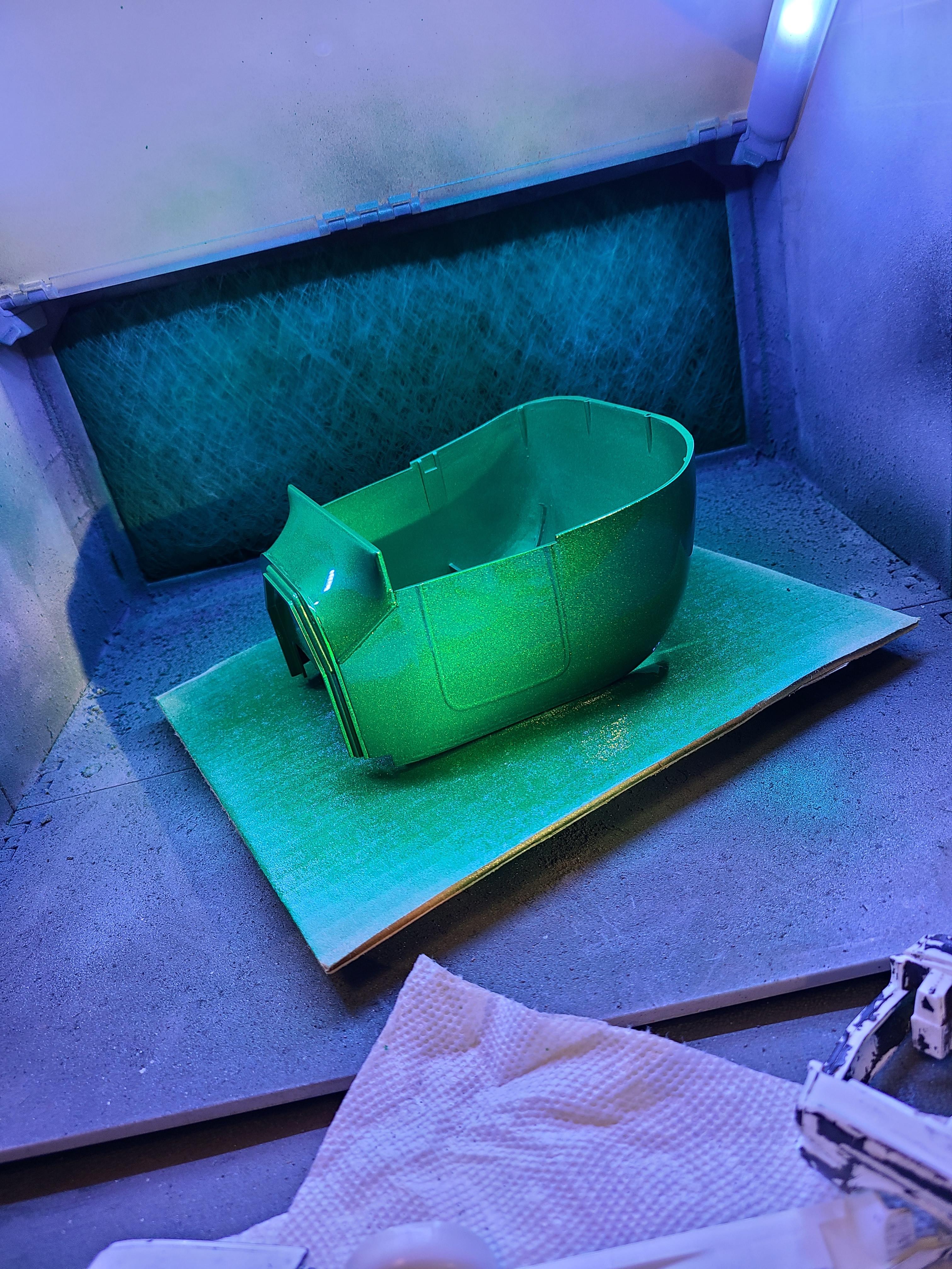

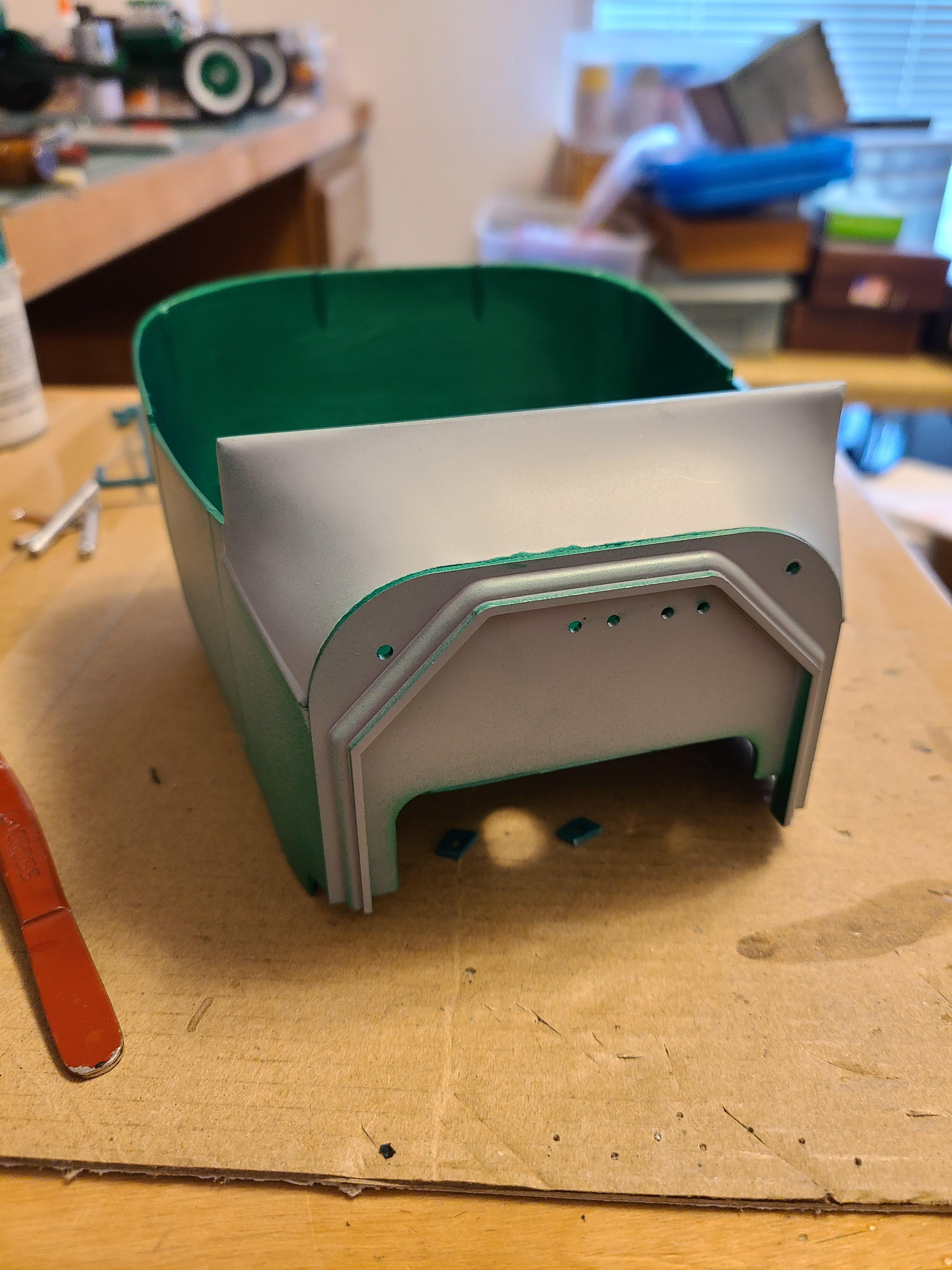

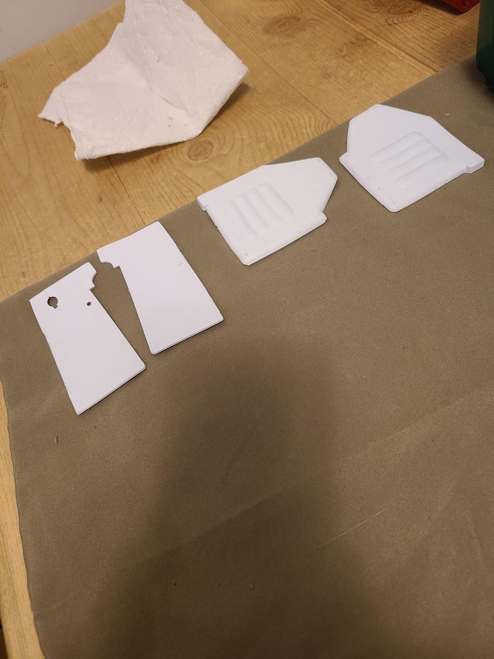

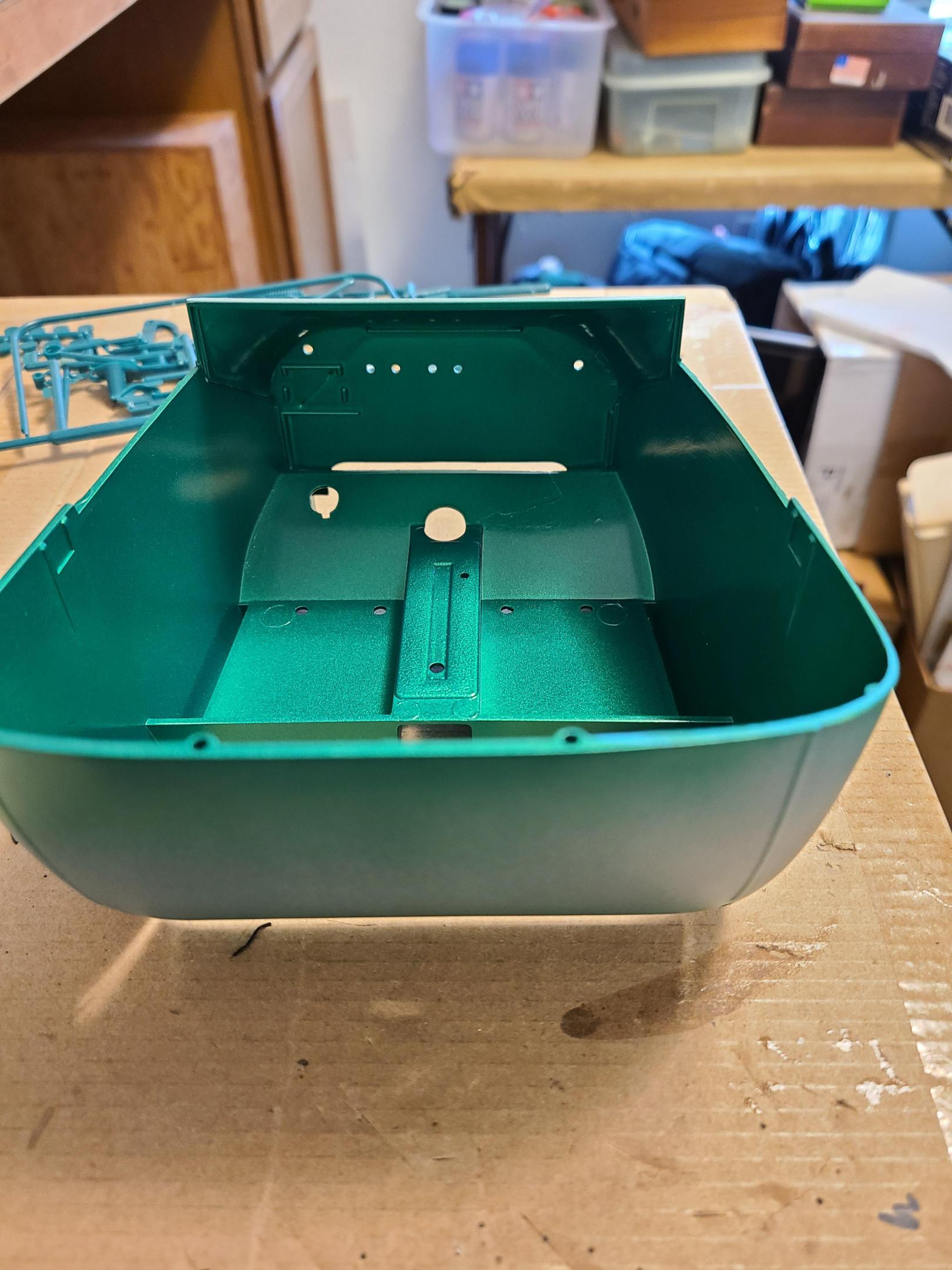

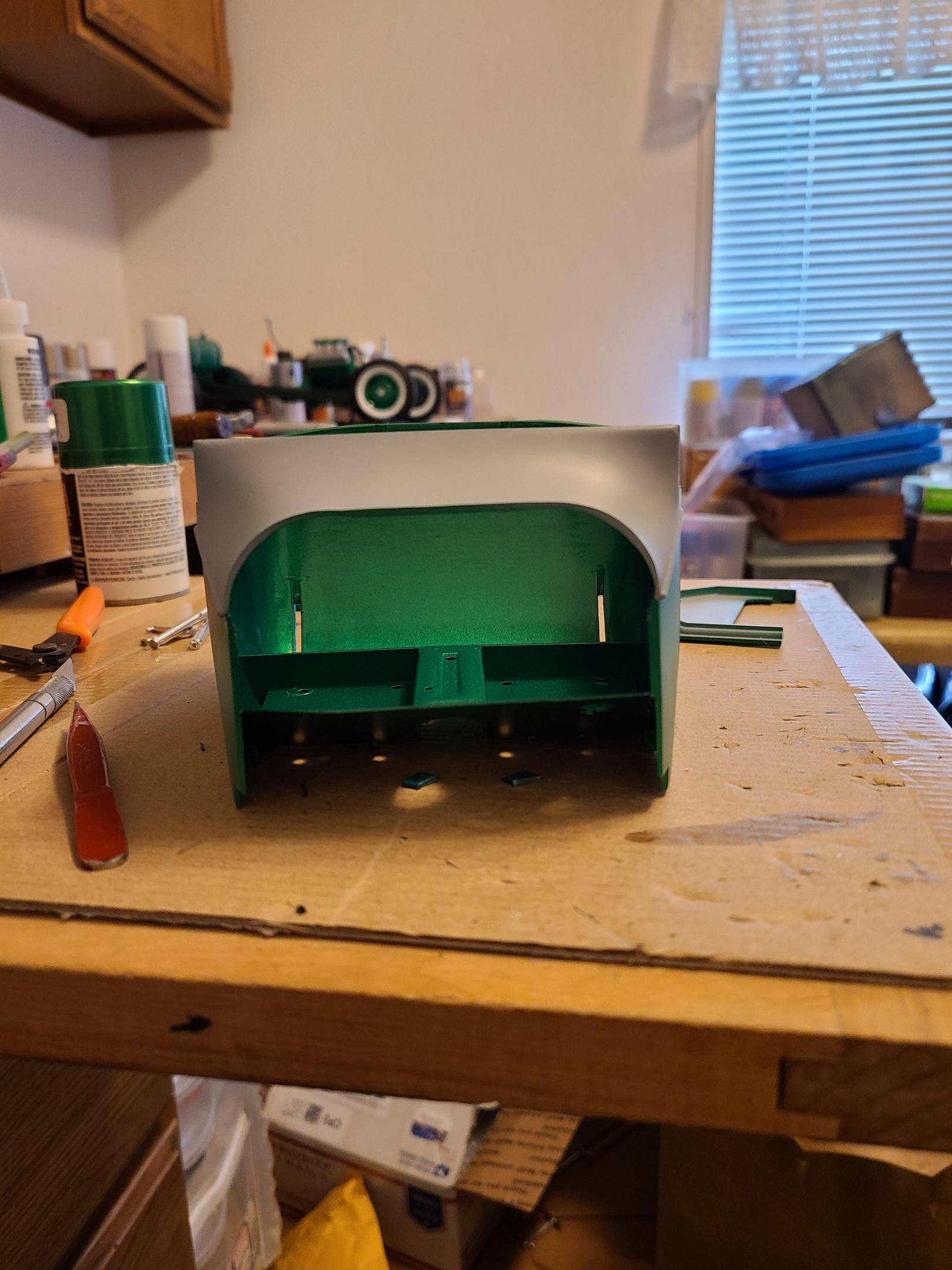

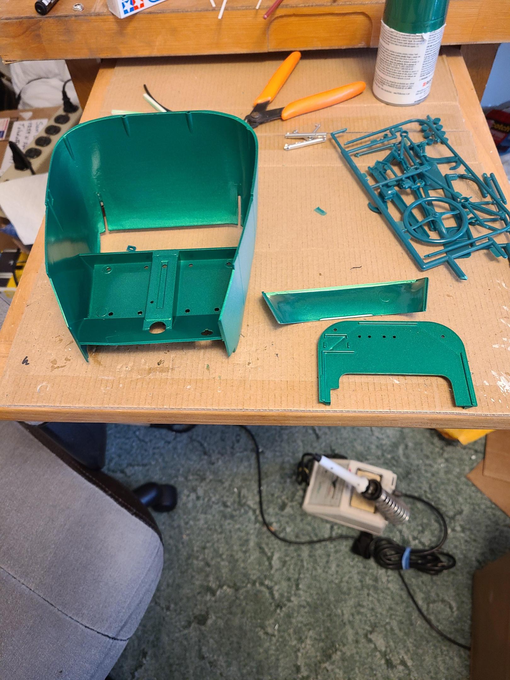

Sam I Am Posted October 23, 2020 Author Posted October 23, 2020 Thanks guys ! So I have been working with the body components, and have come to the realization that sometimes you just have to be content with warped plastic. This plastic has become so brittle with age that using the hot water trick didn't even faze it, still managed to crack the floor. Three pieces to the body, main bucket, cowl, and firewall. I primed all of them, and then painted the inside of all three, then assembled and painted the outside. Turned out pretty good.

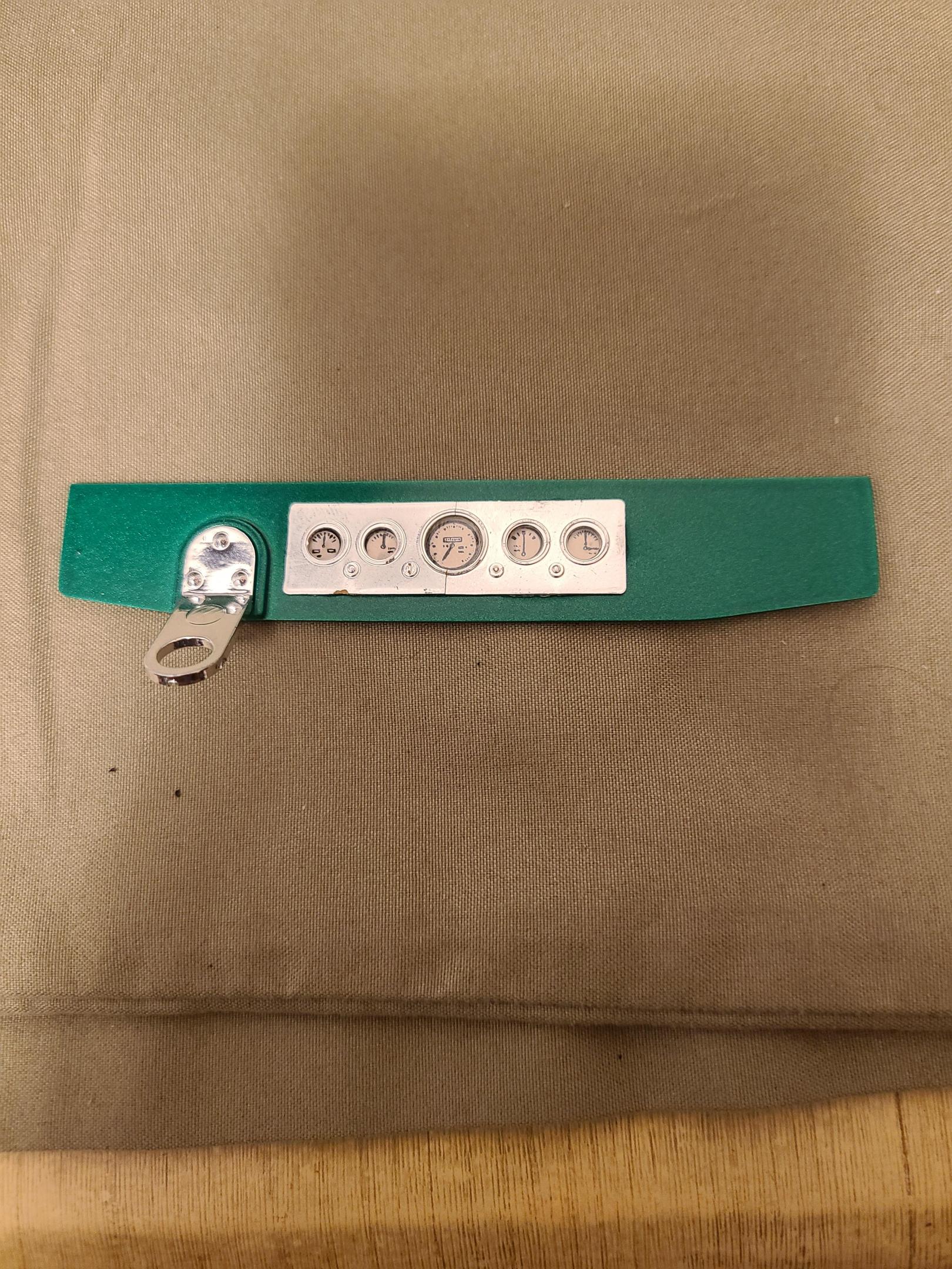

Sam I Am Posted November 4, 2020 Author Posted November 4, 2020 So it's interior time. I keep scrubbing the white rubbery parts with soft scrub with bleach and I think I can live with the results. Working with thin warped plastic is real fun. I sprayed a seal coat over the old instrument decals and will give them a try. They mount on clear plastic that fits in behind the chrome bezel.
Sam I Am Posted November 5, 2020 Author Posted November 5, 2020 Things that make you go hmmm. The instrument cluster had a clear plastic part that mounted into the gauge cluster from behind, and then the decals went behind that. The more I looked at the old yellowed decals the more I went hmmm. So I seal coated the decals in hope they would not disintegrate, left them on the paper backing and then glued them in place from behind with a little white glue. I think they came out pretty good, and since you can buy the real deal in antique white, they're spot on.

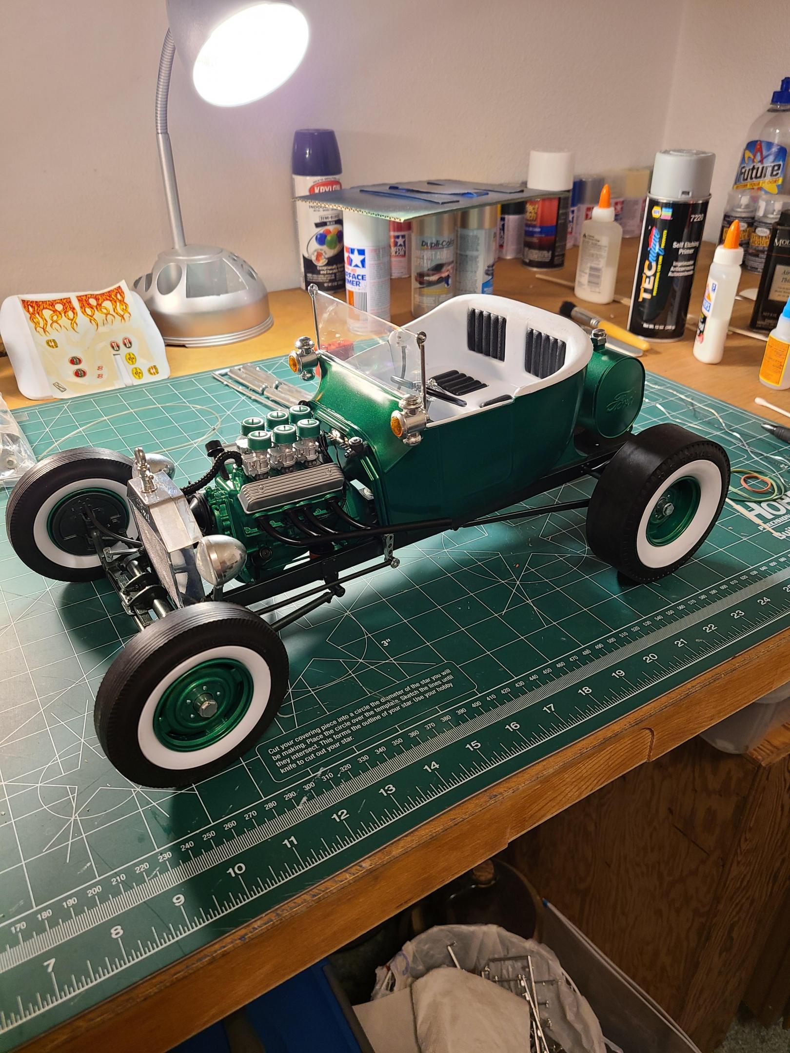

Sam I Am Posted November 9, 2020 Author Posted November 9, 2020 Almost done. Next pics will be in the gallery.
