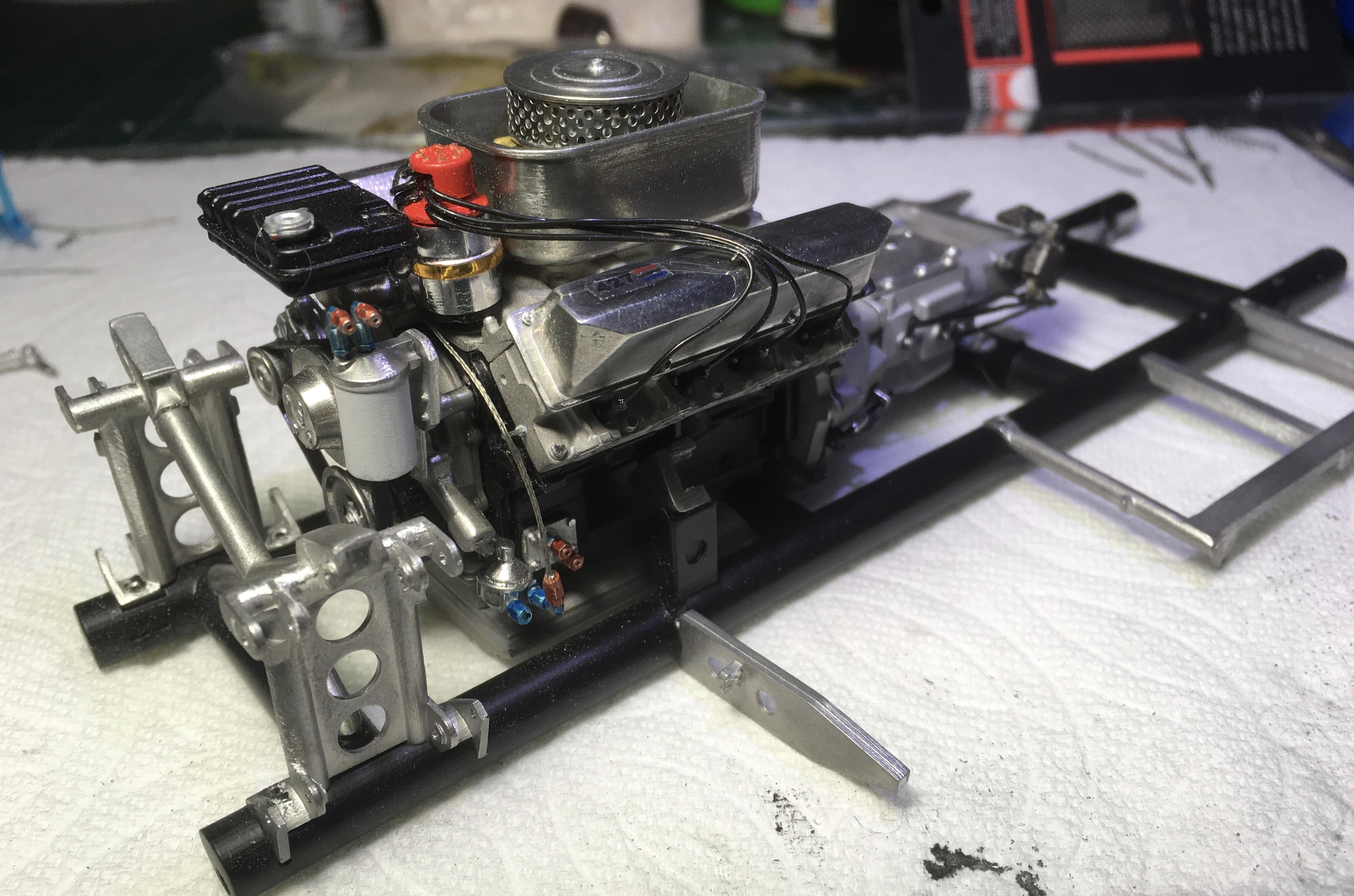

Brudda Posted September 30, 2020 Author Posted September 30, 2020 Cleaned up white metal parts, Put them into the polisher to remove mold release. Drilled out 48 holes. Check fit. Prime parts then paint trim black. Fit engine again. Always fitting. Try to stay about 5 steps ahead. But sometimes this is not enough.

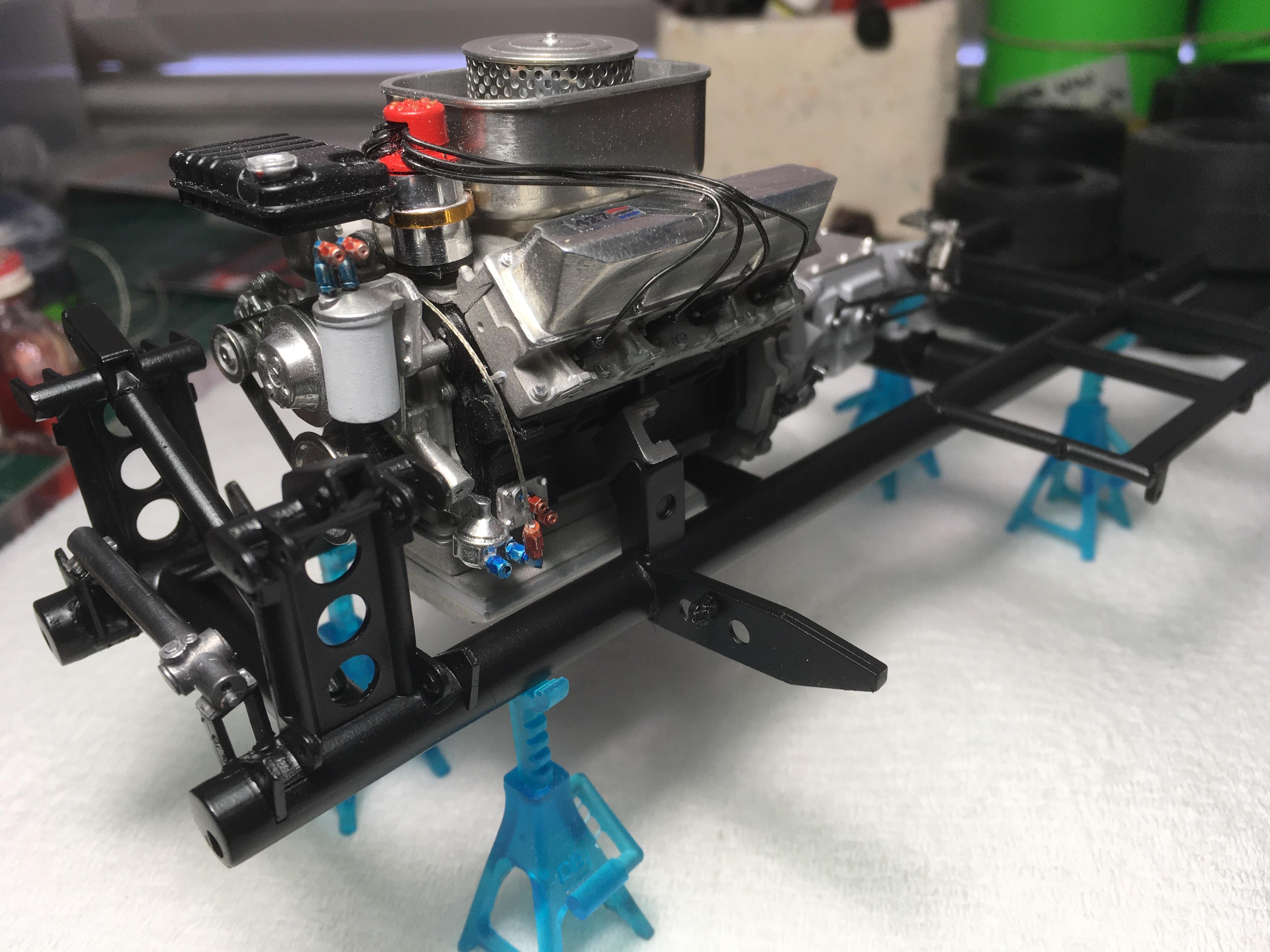

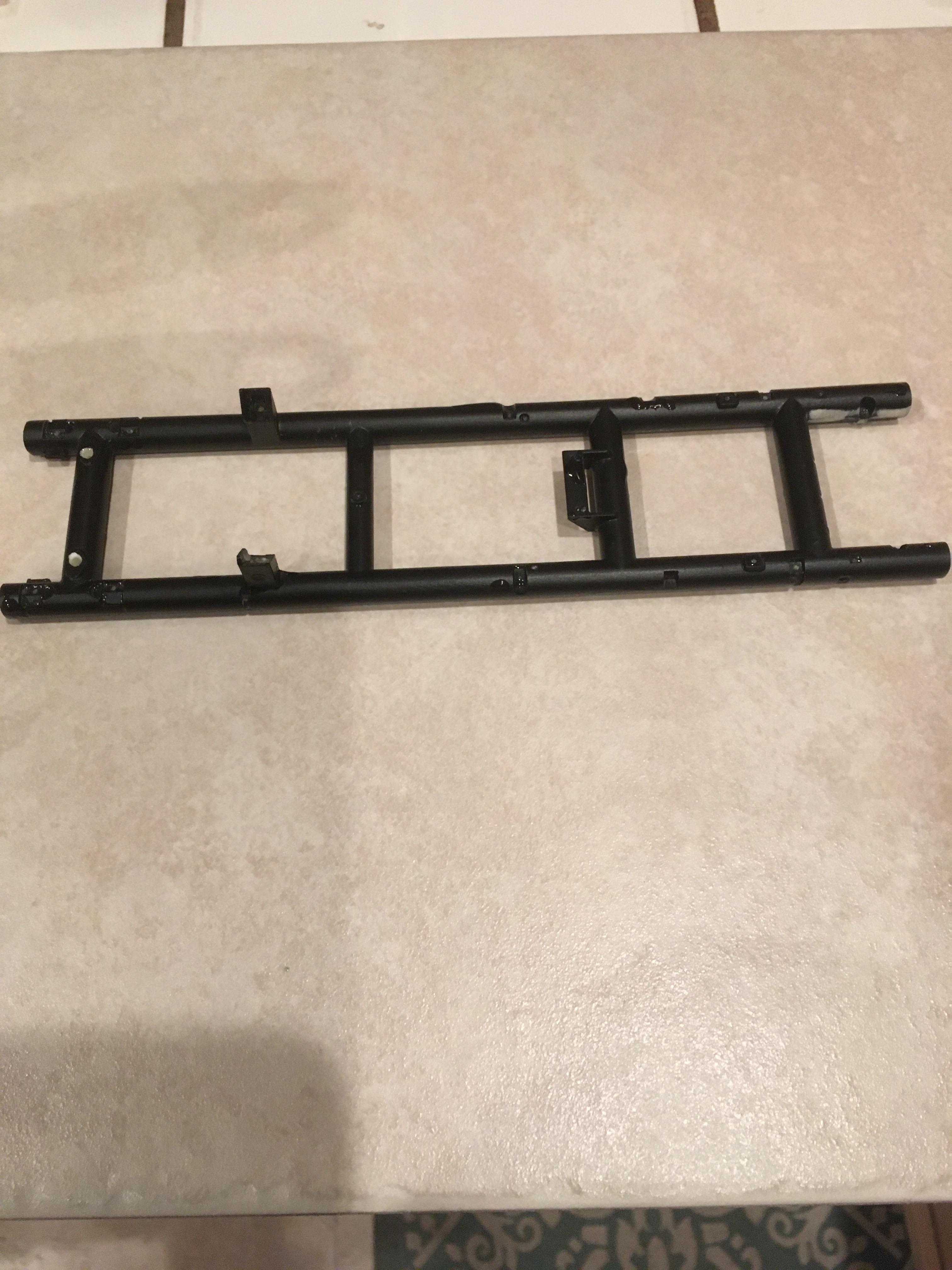

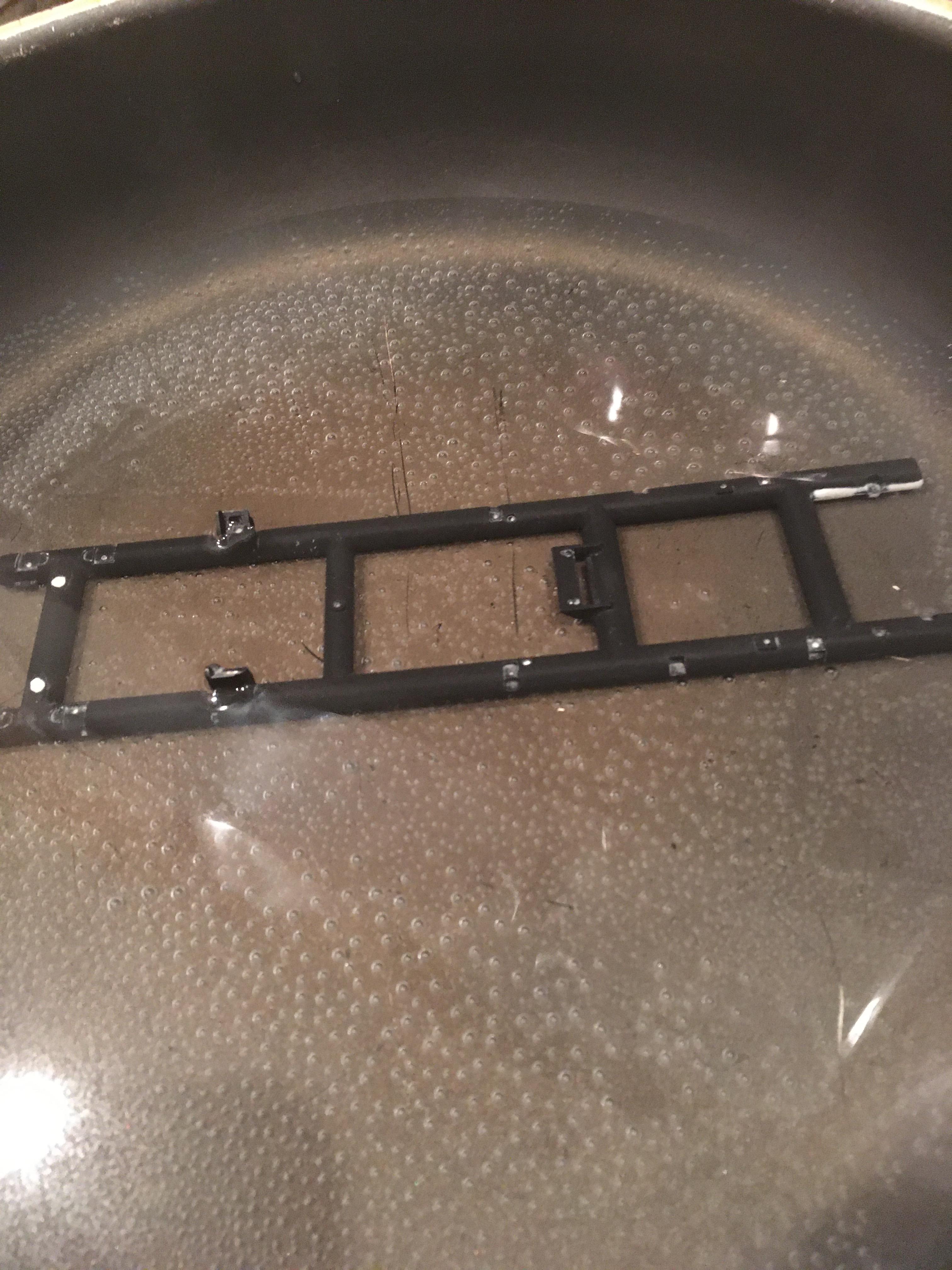

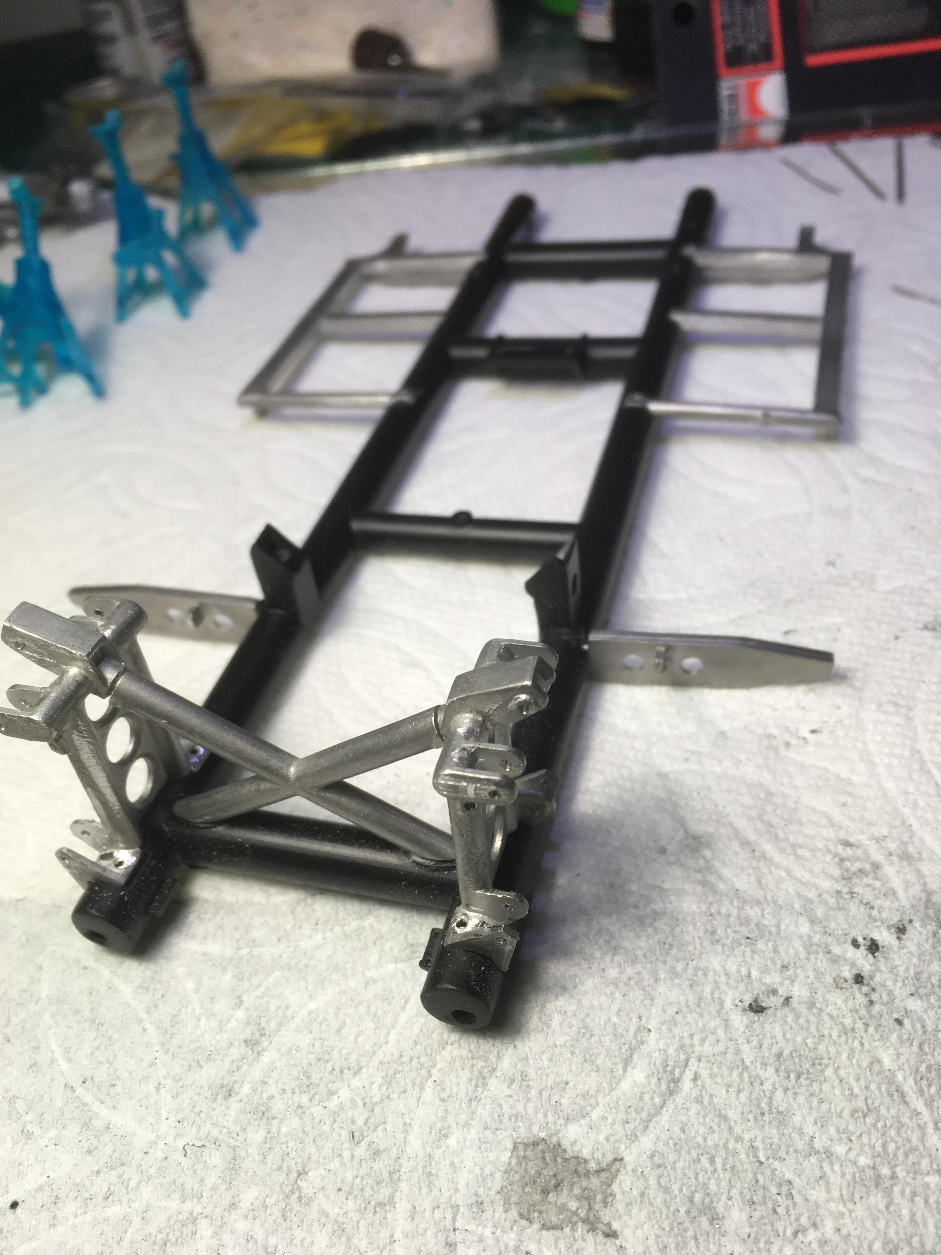

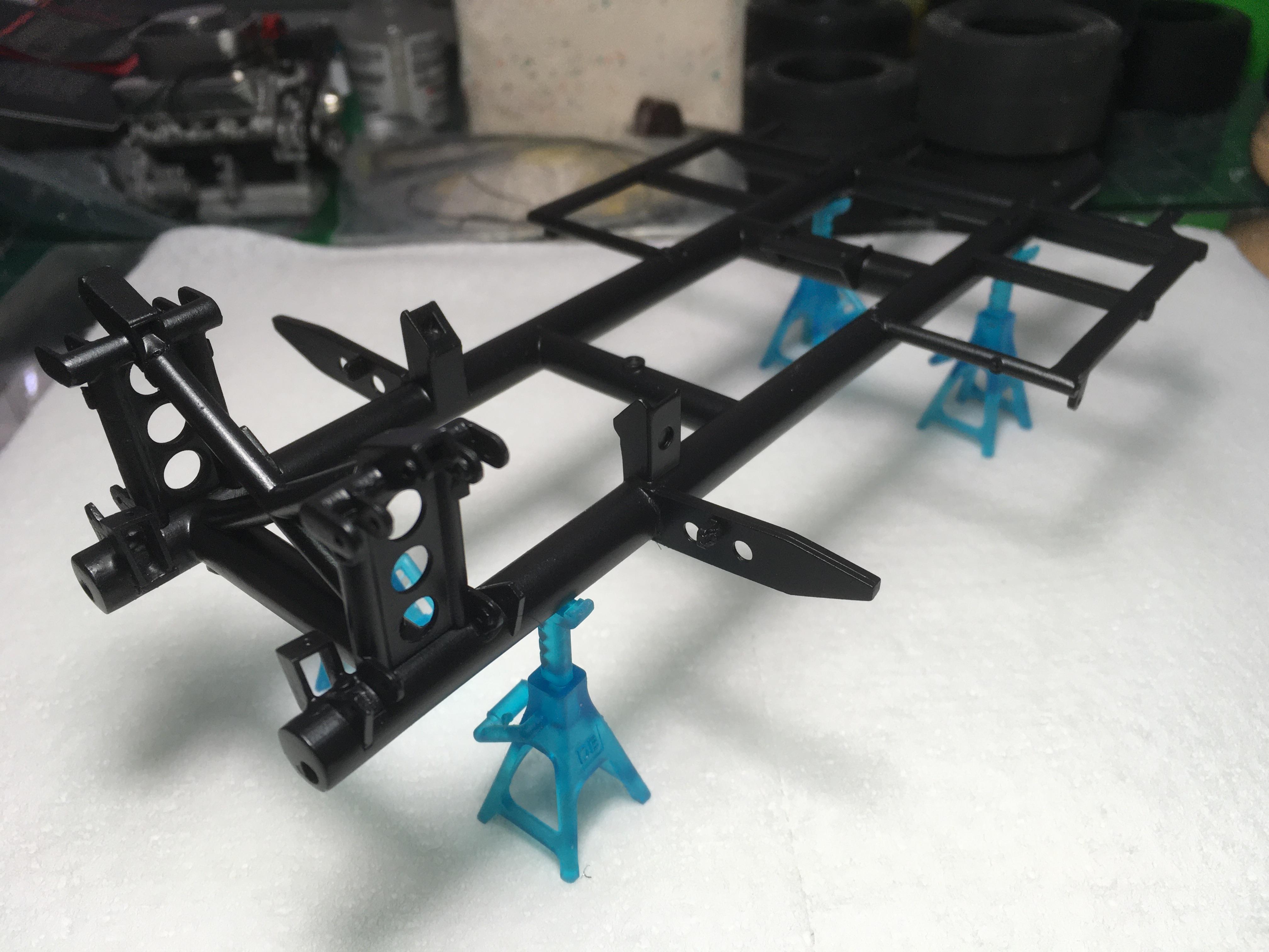

Brudda Posted October 3, 2020 Author Posted October 3, 2020 I made a mistake and did not check the resin frame. Should have known but assumed it was straight. Was wondering why parts were not fitting right. The frame was twisted. Boiled water in a pan. Put the resin frame in and waited a few minutes. Pulled out and twisted it back into shape. Put on a tile to check for straightness. Now straight. Can continue.
Brudda Posted October 3, 2020 Author Posted October 3, 2020 It works out when your frame is straight.

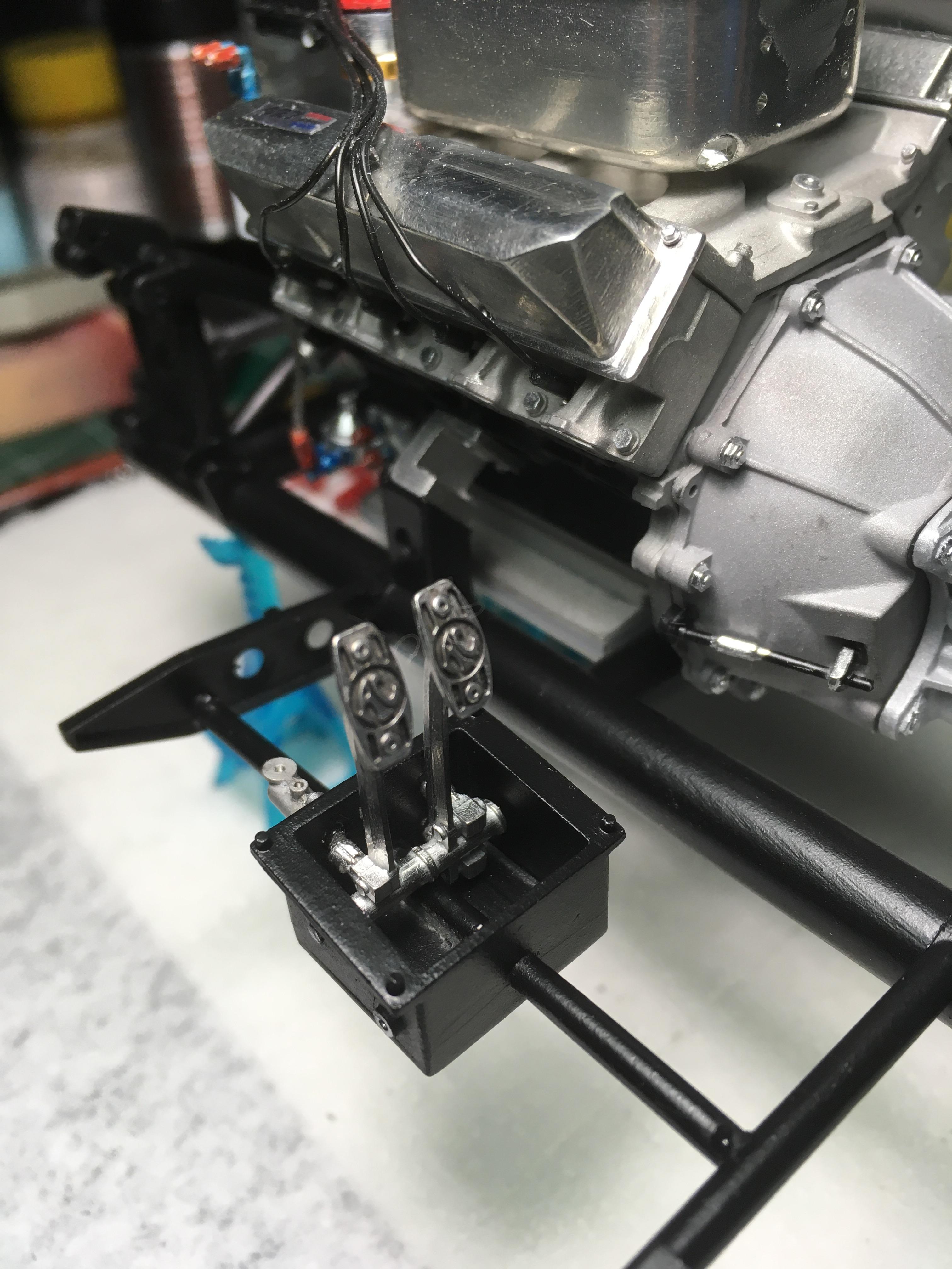

Brudda Posted October 4, 2020 Author Posted October 4, 2020 Thank you Deuces ll. Installed the pedals and mount. The pedals are cool.

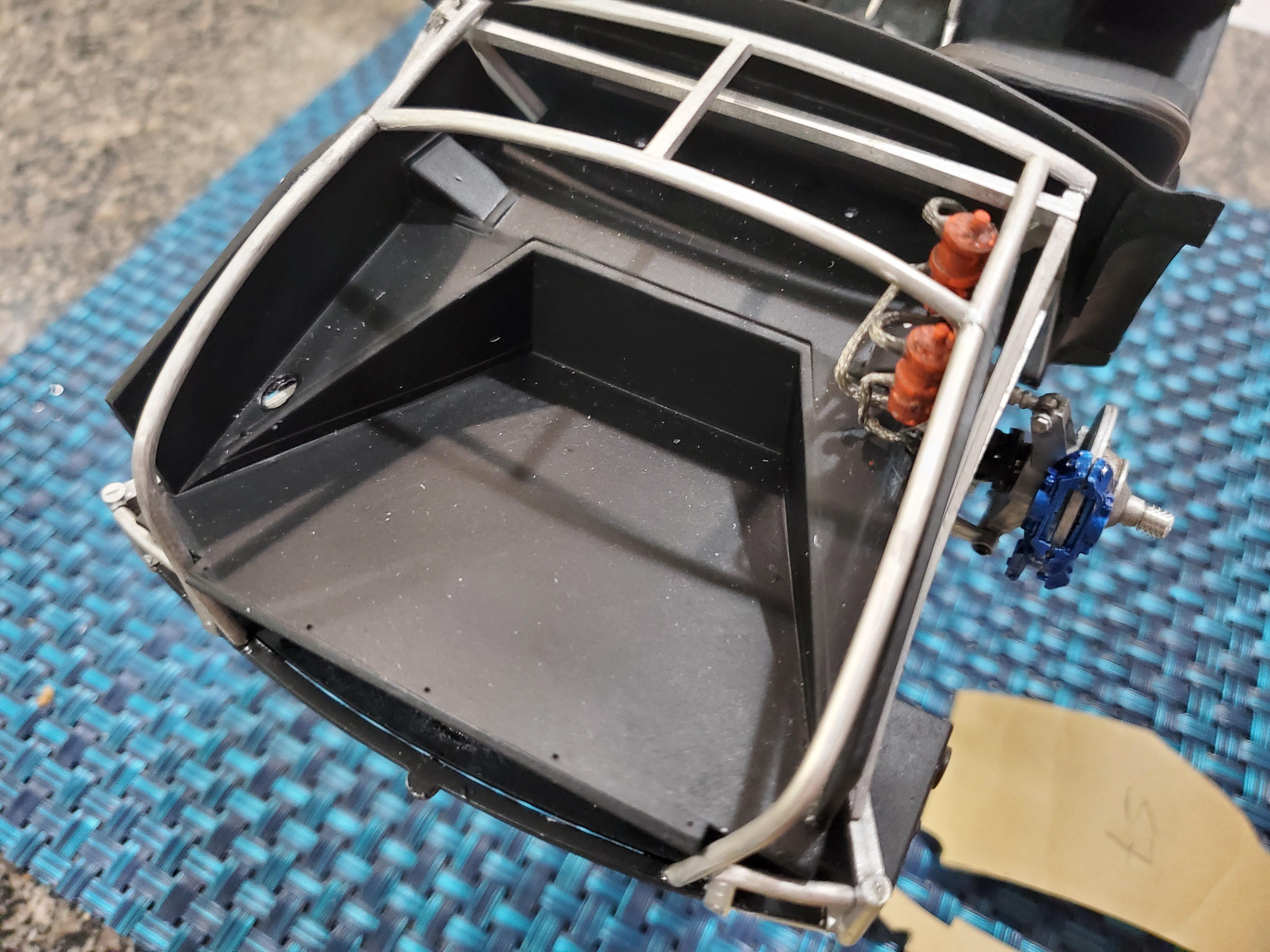

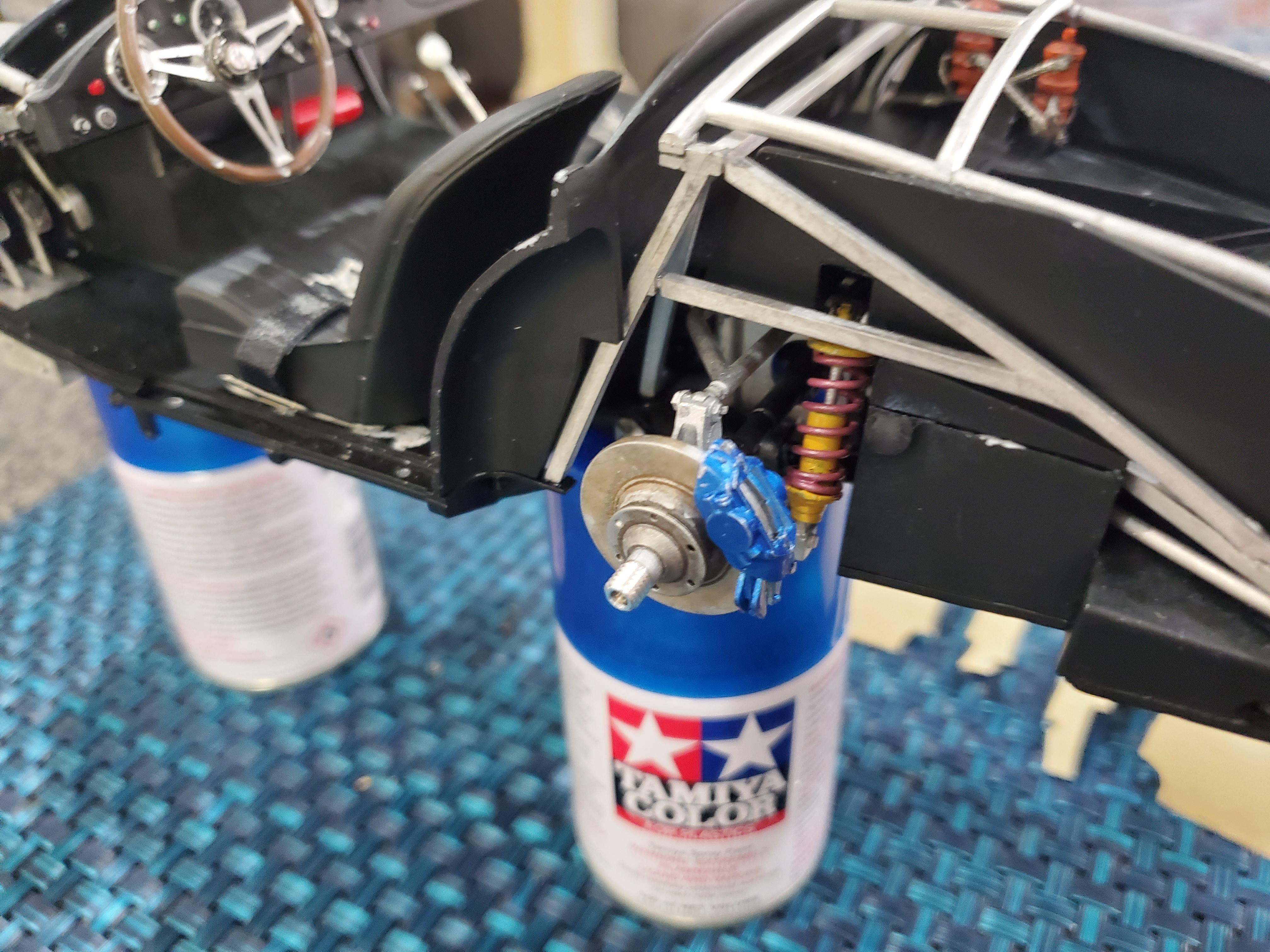

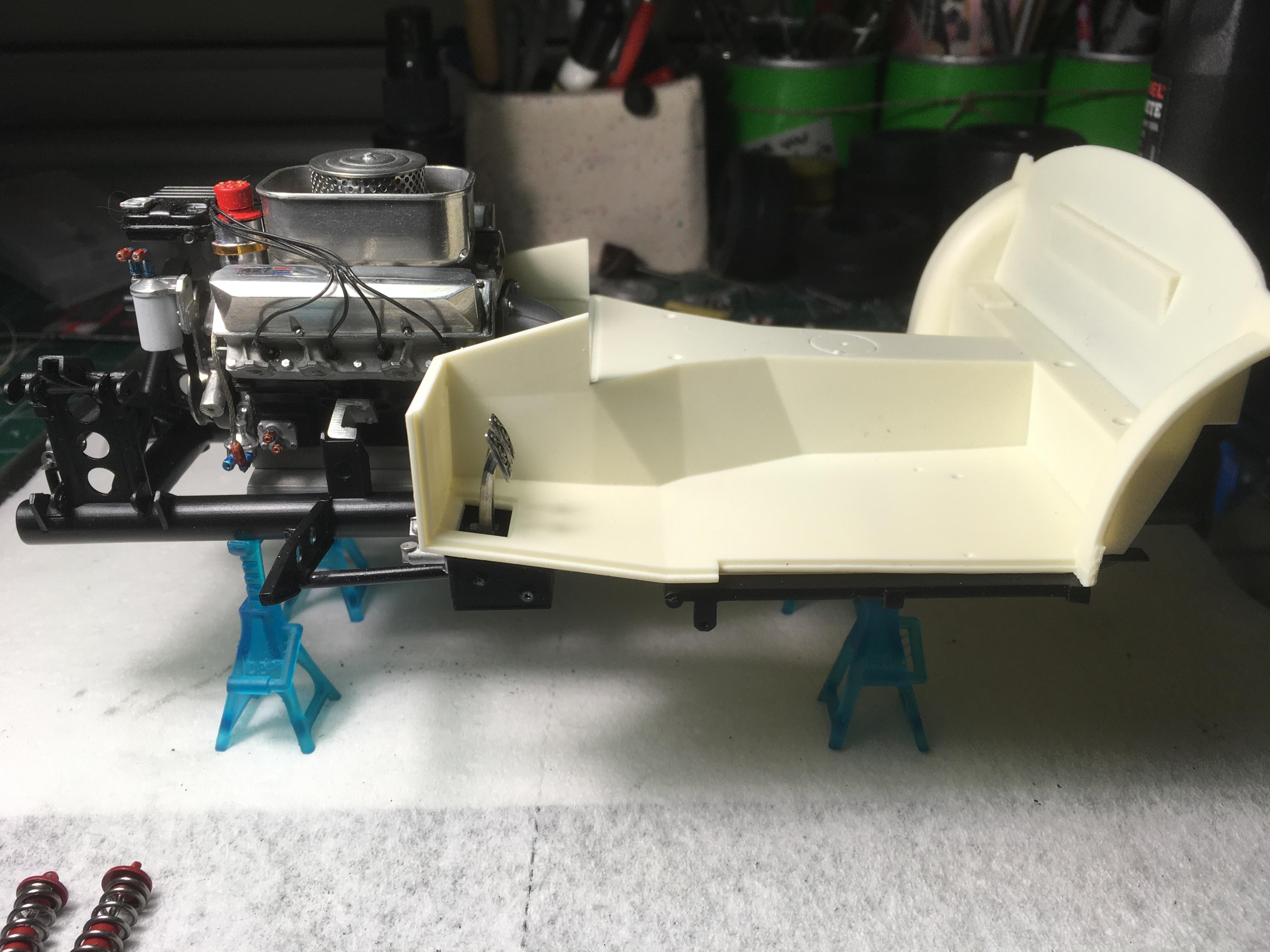

Brudda Posted October 4, 2020 Author Posted October 4, 2020 Fitting the interior floor pan. Had to drill more holes in the tube frame. Glad I fixed the frame as this pan would not fit. Have a little more confidence for the body to fit. But I know I will have to modify something. This step is way ahead of where I am now but if you do not fit it now, the future will be tough. Suspension next.

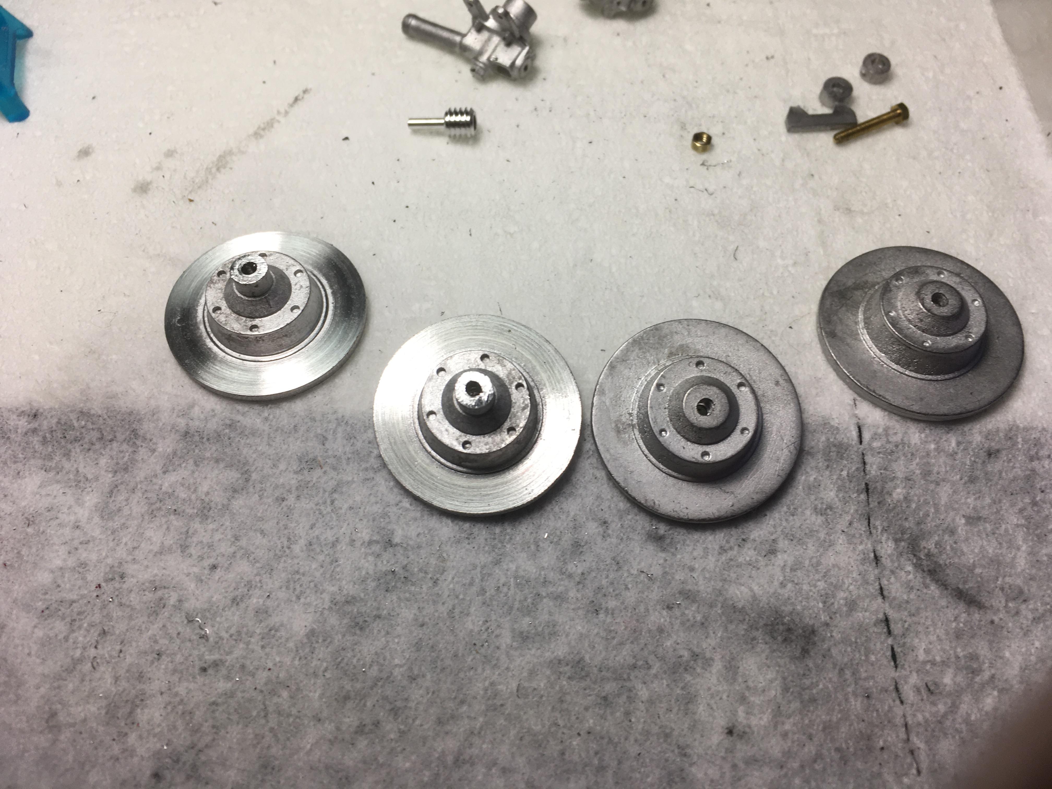

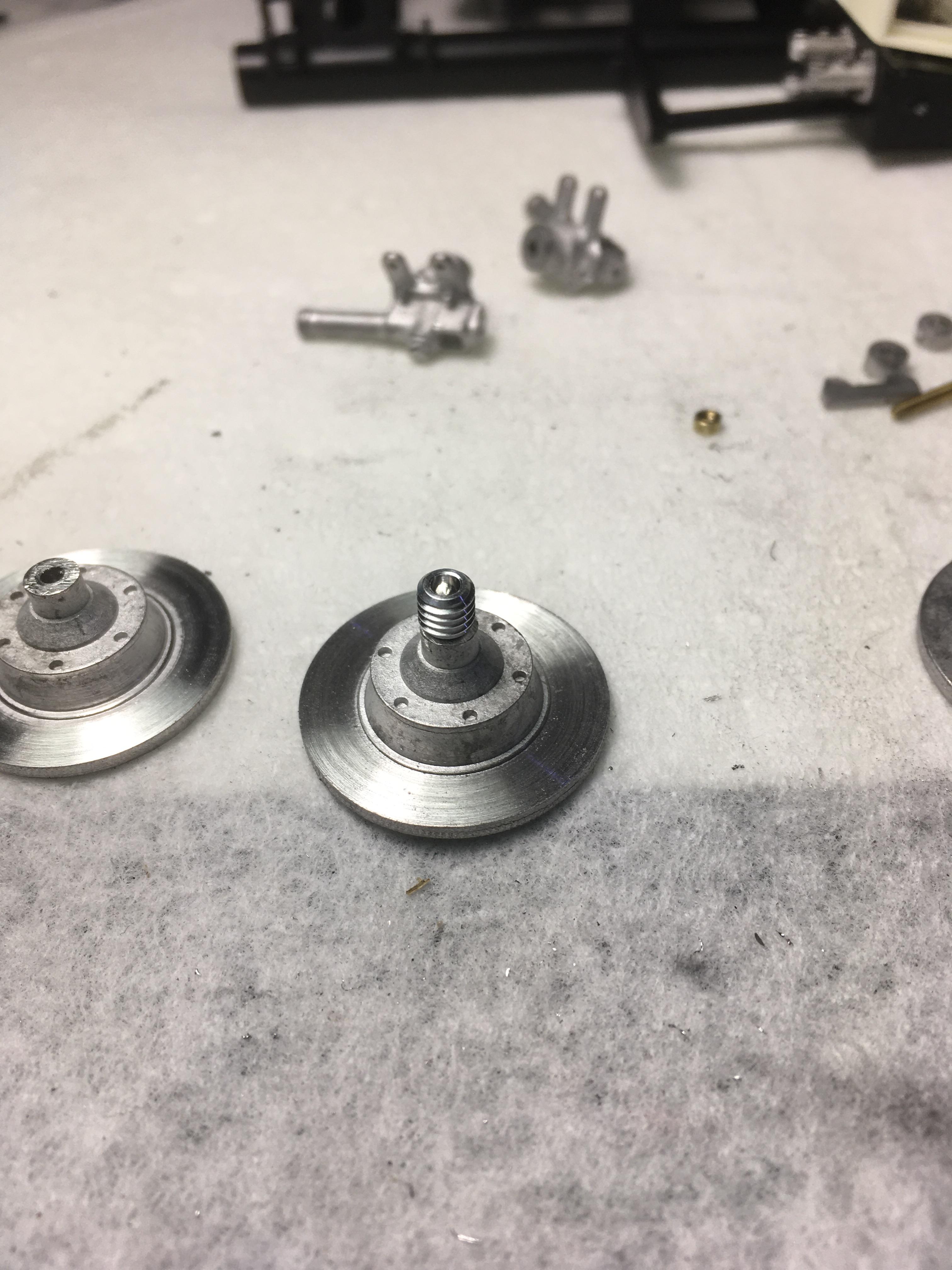

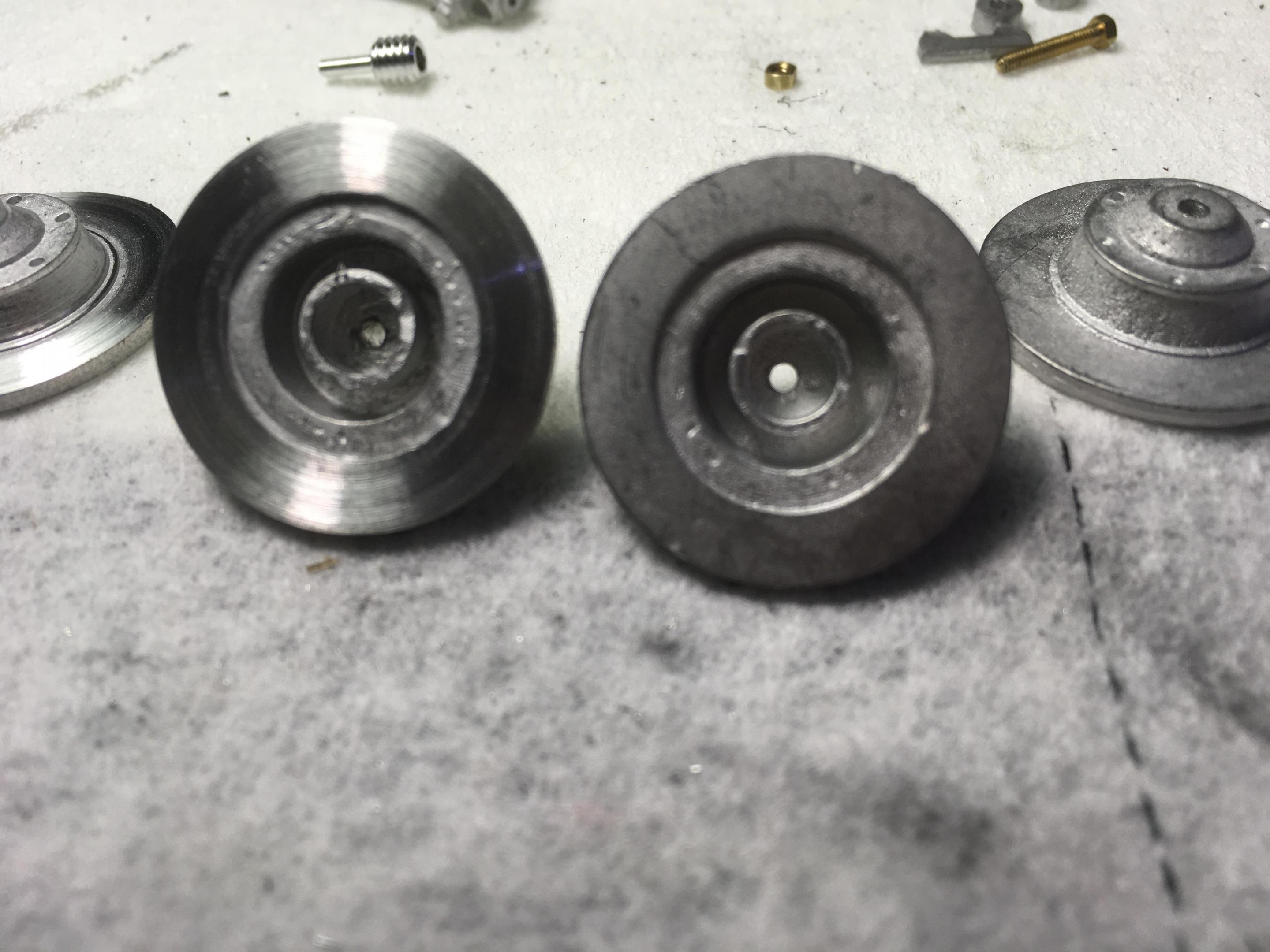

Brudda Posted October 5, 2020 Author Posted October 5, 2020 Turned two rotors. Compared to the unturned rotors
OldNYJim Posted October 5, 2020 Posted October 5, 2020 Aww yeah, that extra work on those rotors makes all the difference! Looking great!

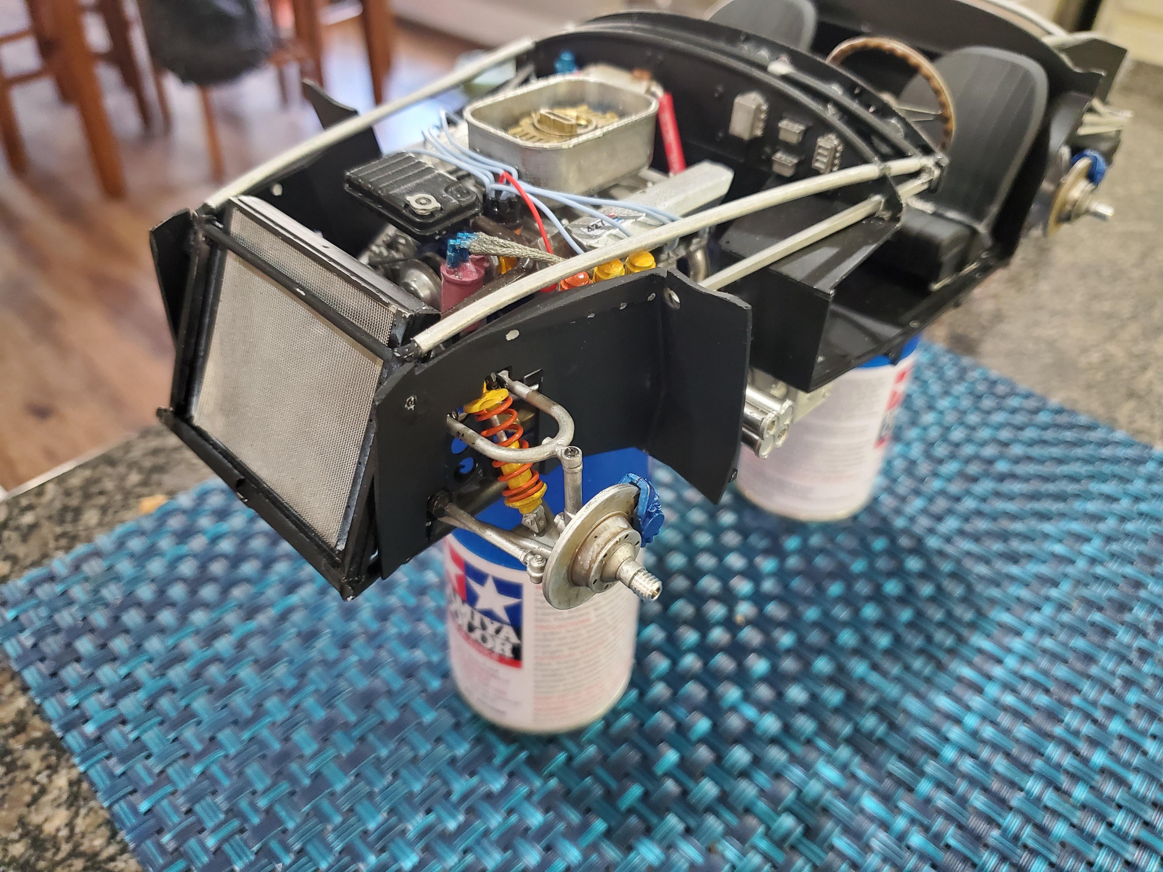

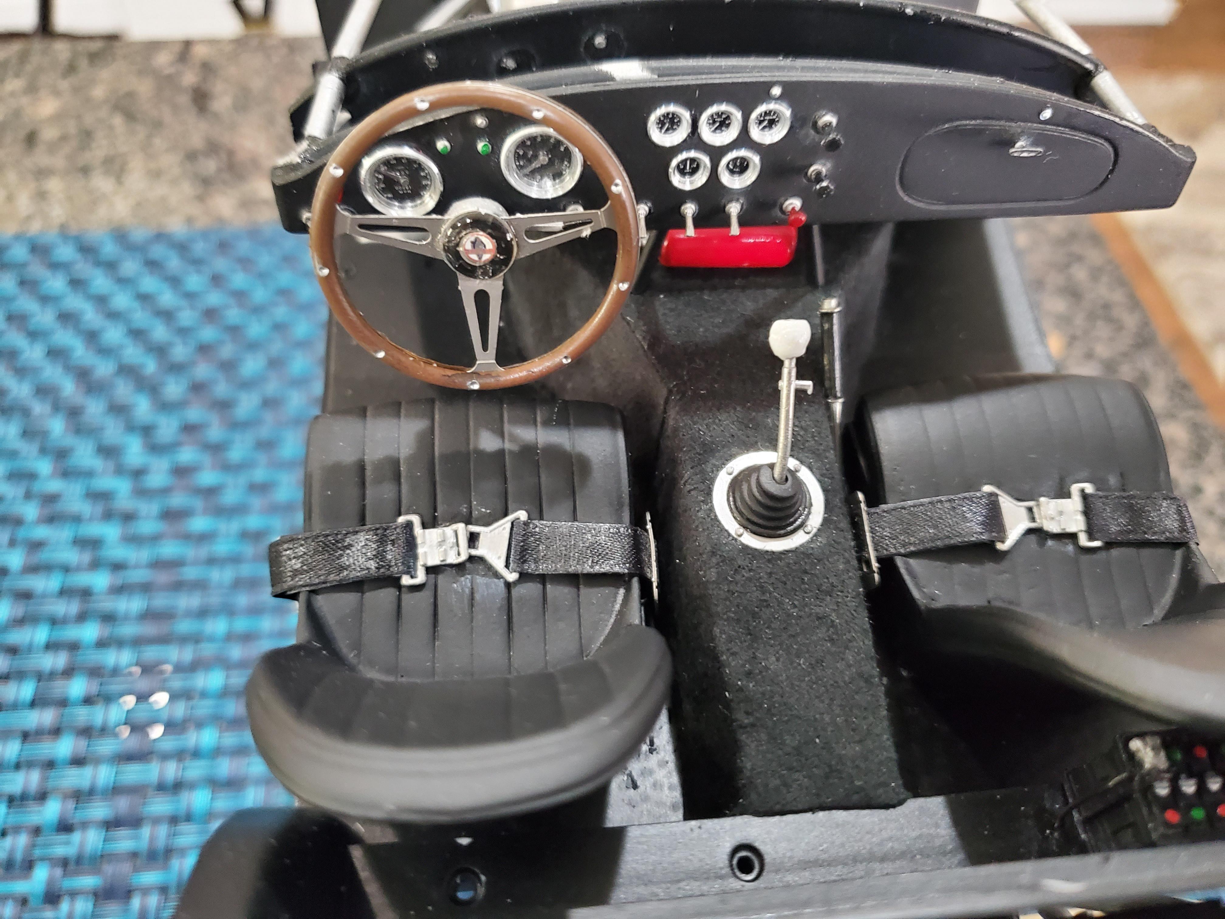

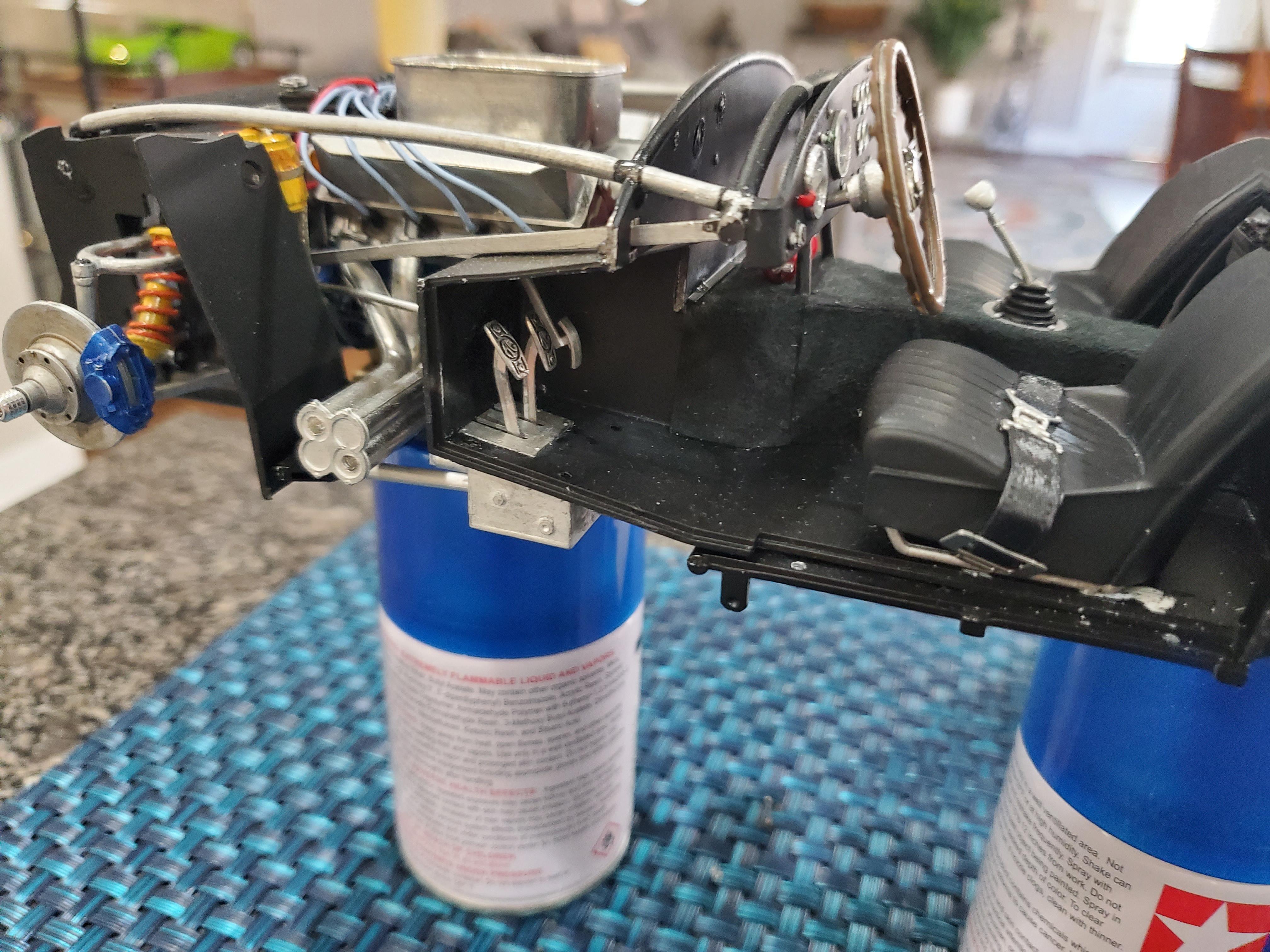

nazdrave Posted October 6, 2020 Posted October 6, 2020 (edited) OK, here are some more pics of the chassis build so far - please pardon the dust, etc. The seats are only in place and are not finished yet or fixed. I also have to finish the carpeting. The biggest problem that I ran into was all the distortion in the white metal parts. I would estimate that at least 50% needed to be "fixed" so to speak - that is to say carefully bent/finessed to fit right. This was especially so in the rear. My main ladder chassis member was straight right out of the box. I also have been having a time getting the hood hinge to work without scraping paint. It's hard to tell from the pictures but the rear springs and front springs are different colors - I did this just like my Factory Five build and some race Cobras I've seen (Factory Five spec racers) that do that so it's easy to tell the different springs with slight different rates. Right now, I am just about to apply the final coats of clear on the main body, hood and trunklid. Brudda, what were you planning to do as it pertains to crafting some kind of inner door skins. I have some adhesive backed trim paper from another model and I was thinking about cutting that to size and sticking that on. Also, I am really concerned about how I am going to cut out the windshield to make it fit and look right with so little margin for error. Edited October 6, 2020 by nazdrave

Brudda Posted October 6, 2020 Author Posted October 6, 2020 4 hours ago, nazdrave said: OK, here are some more pics of the chassis build so far - please pardon the dust, etc. The seats are only in place and are not finished yet or fixed. I also have to finish the carpeting. The biggest problem that I ran into was all the distortion in the white metal parts. I would estimate that at least 50% needed to be "fixed" so to speak - that is to say carefully bent/finessed to fit right. This was especially so in the rear. My main ladder chassis member was straight right out of the box. I also have been having a time getting the hood hinge to work without scraping paint. It's hard to tell from the pictures but the rear springs and front springs are different colors - I did this just like my Factory Five build and some race Cobras I've seen (Factory Five spec racers) that do that so it's easy to tell the different springs with slight different rates. Right now, I am just about to apply the final coats of clear on the main body, hood and trunklid. Brudda, what were you planning to do as it pertains to crafting some kind of inner door skins. I have some adhesive backed trim paper from another model and I was thinking about cutting that to size and sticking that on. Also, I am really concerned about how I am going to cut out the windshield to make it fit and look right with so little margin for error. Man that looks great!! On the doors, I was not going to do anything as far as interior panels. They were options on the original car. My buddy Mark has no interior door panels on his Original 289 cobra. Because I really did not know what to do , I was not going to have them. The windshield is another matter altogether. I might have something that might work. I’m going to polish the frame as best as one can and not turn it into a pretzel. I have some automotive clear double sided tape that is very strong that I use . I will try it and if it works I’ll let you know. I’m doing the suspension first then I’ll jump to the windshield I am wondering if it will turn out. I’ll keep you posted.

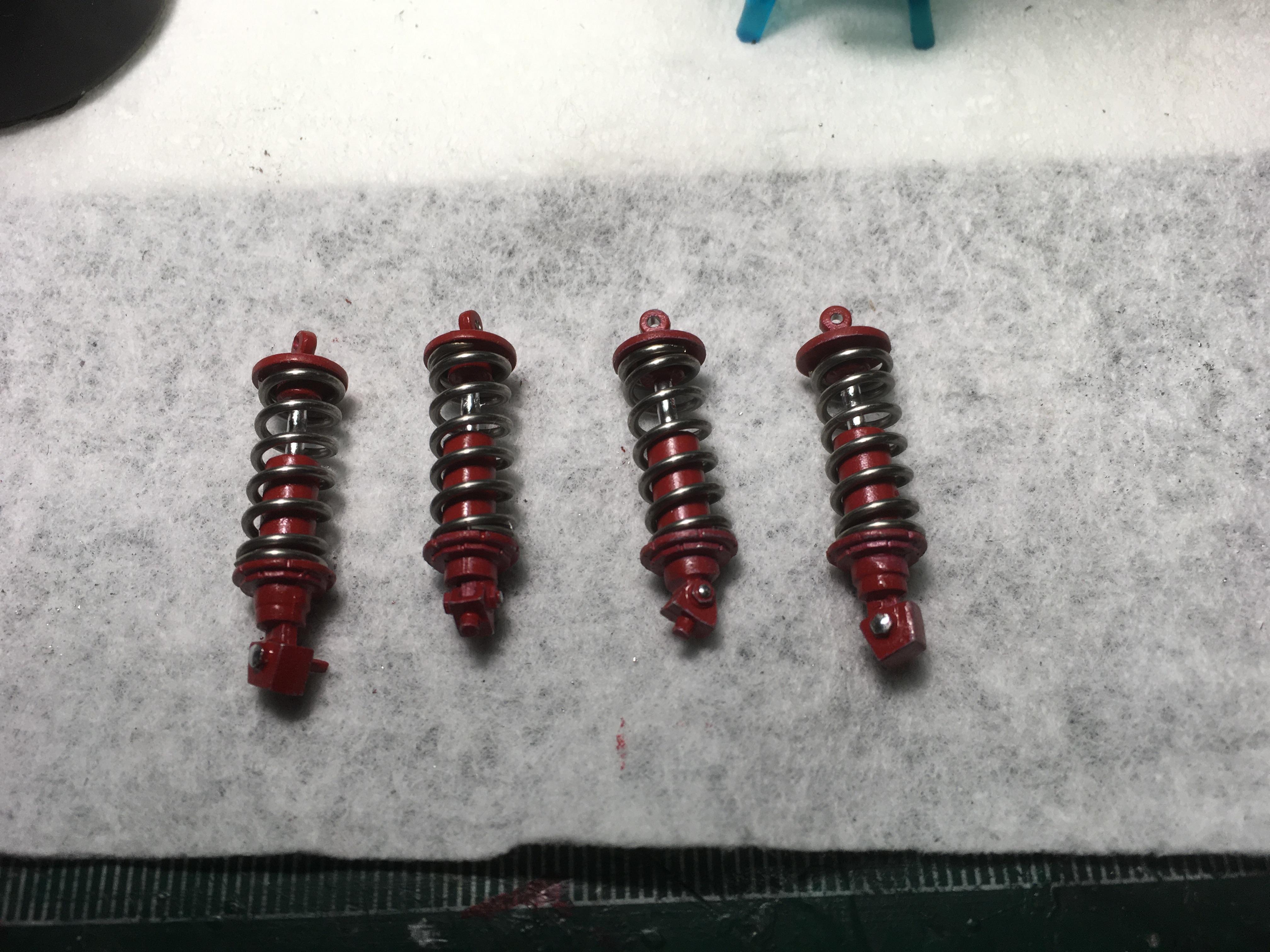

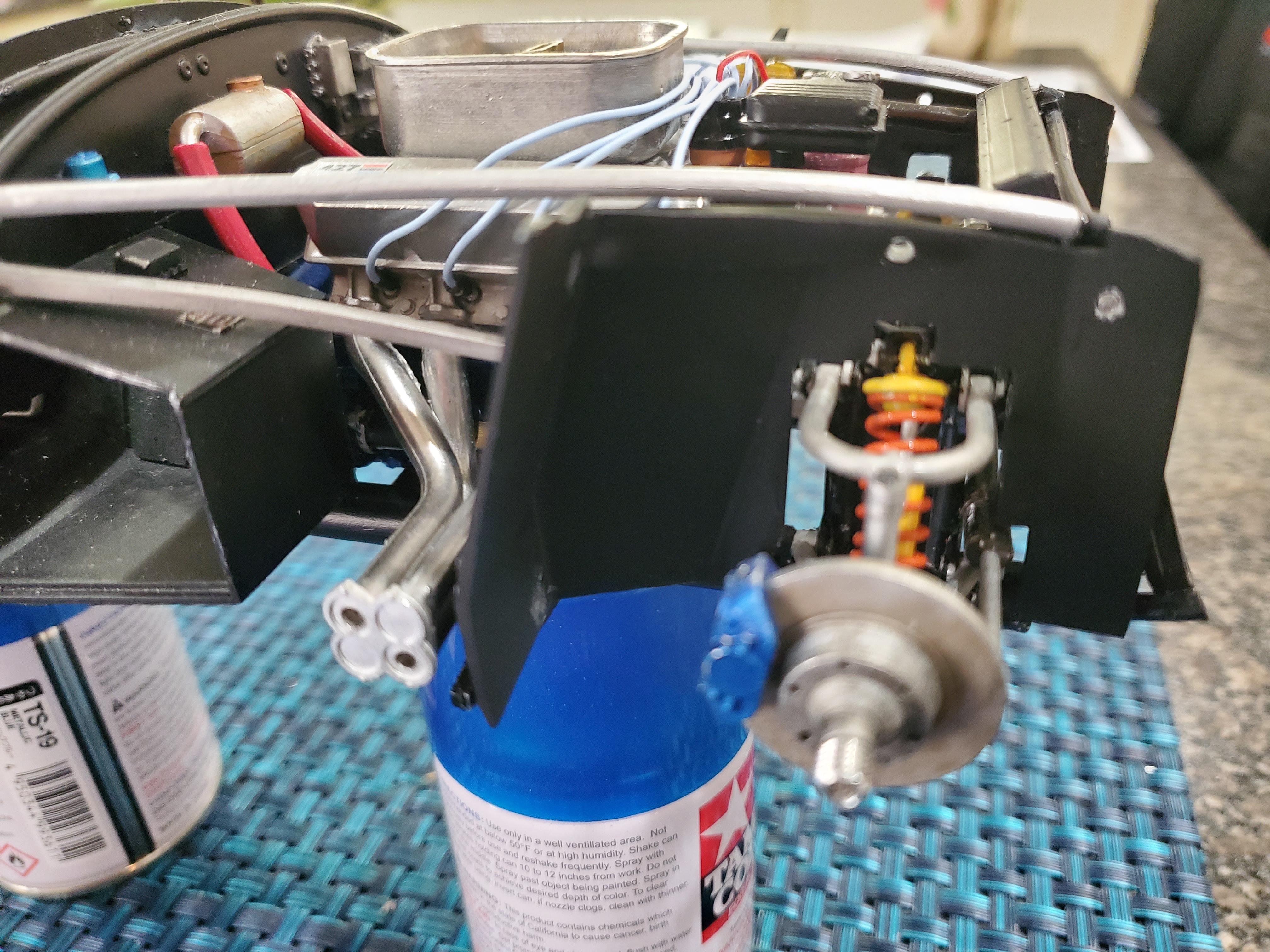

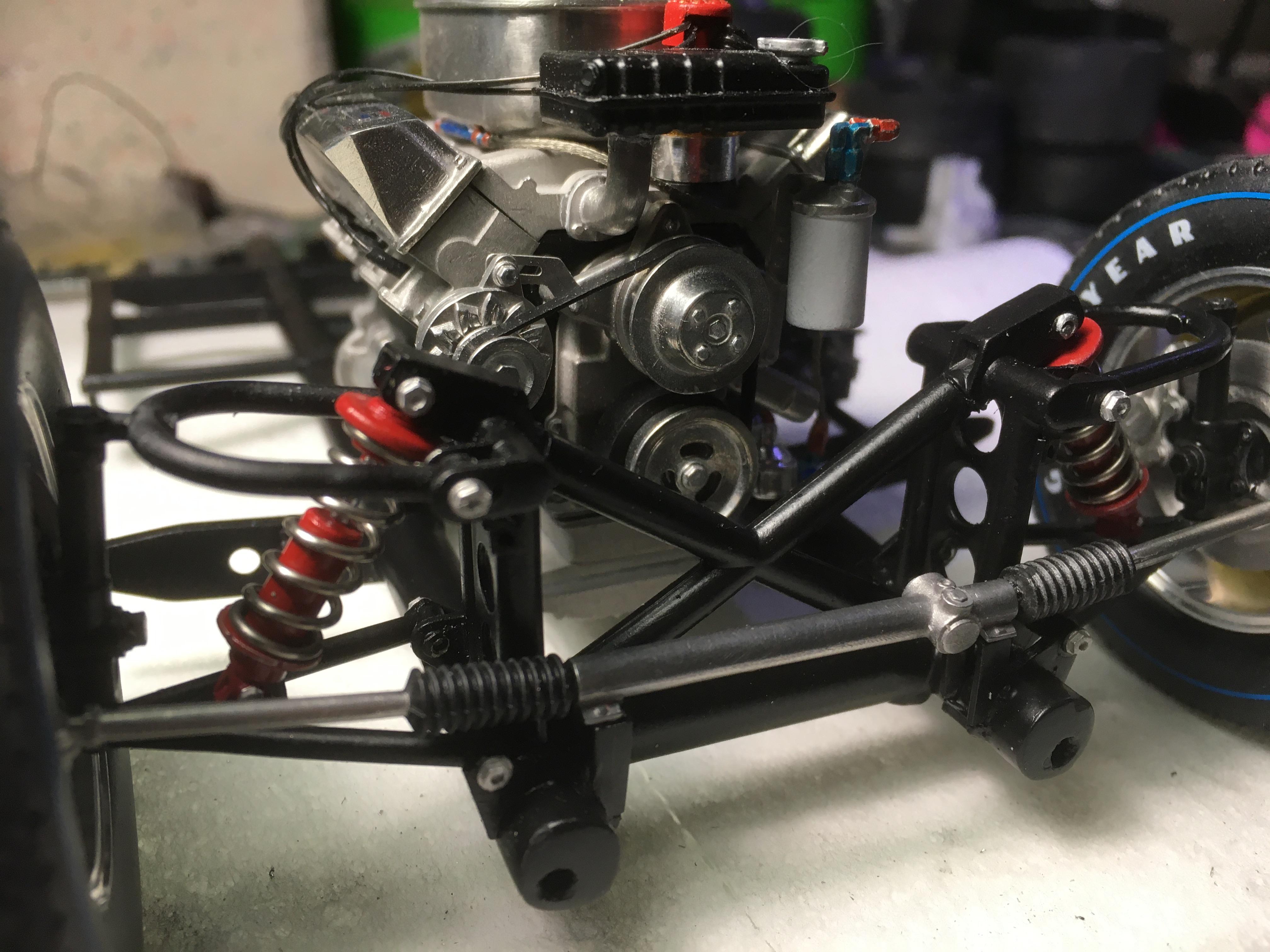

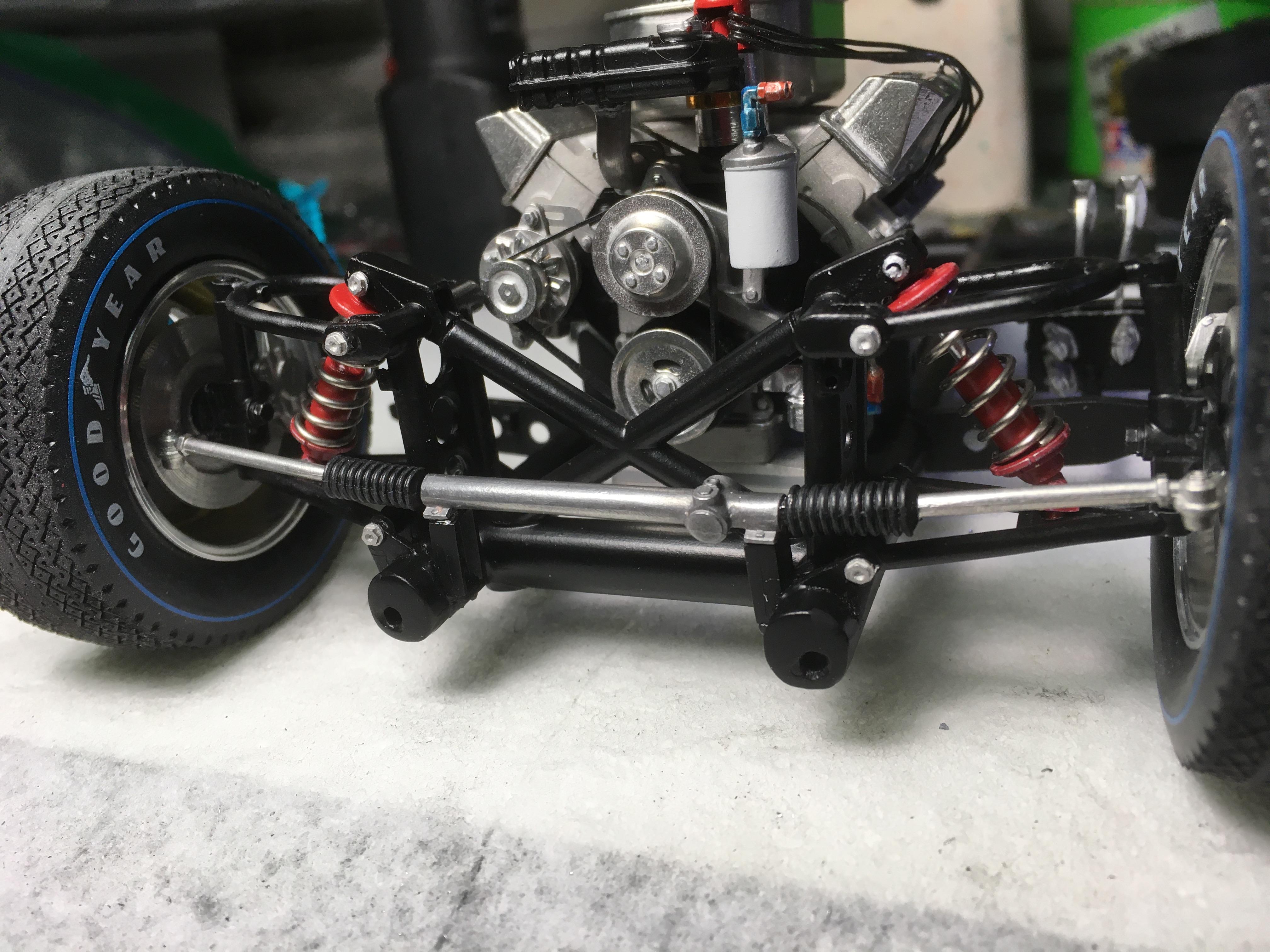

Brudda Posted October 7, 2020 Author Posted October 7, 2020 Front suspension and steering rack. Rear suspension next. Drilled 26 holes .

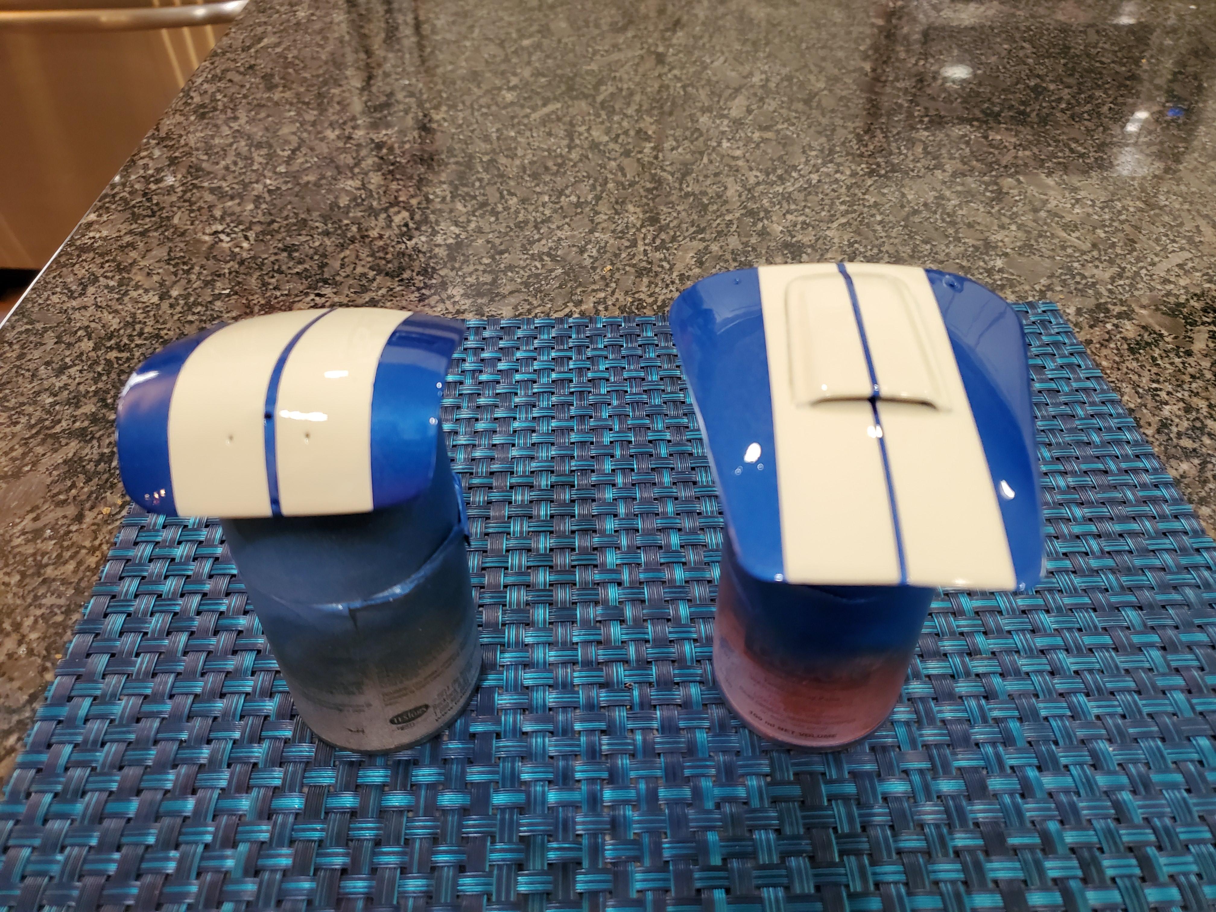

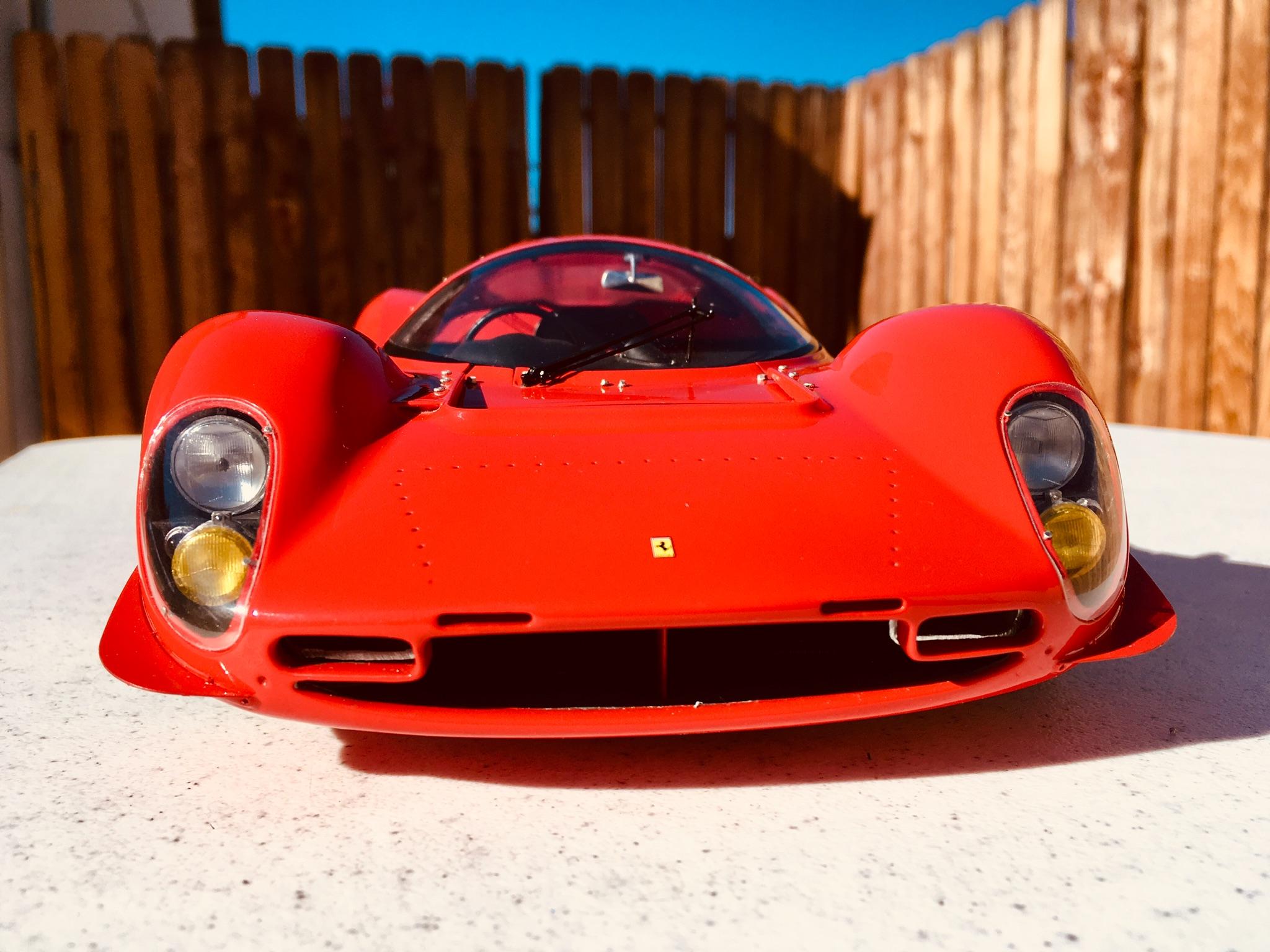

Brudda Posted October 7, 2020 Author Posted October 7, 2020 4 hours ago, nazdrave said: Thank you for your kind words, my friend. I agree completely - Tamiya is best bang for the buck and out-of-the-box fitment, but MFH is the best when it comes to accuracy and detail. They require a lot of finessing, but it's worth it! So, thanks for tip on the clear tape. I just ordered two rolls for myself. The headlight lenses on the Ferrari look perfect! You can't tell at all. I just finished spraying clear for the final time. Here are some pics of that - I have not yet started to wet sand and polish, but that will be next. The stripes look more yellow in the pictures than in real life. They are Tamiya Racing White which is an off-white/ivory shade. I’m going to learn a new technique on the windshield frame, My friend Mark is very very experienced in this metal. He is going to teach me “solder wiping”. Fills the imperfections in the white metal with solder and polished like it was chrome. Here is a example. The pieces that look like chrome are white metal that has been “solder wiped” sanded then polished. By the way , this is the level my buddy Mark is at. I’m still learning!

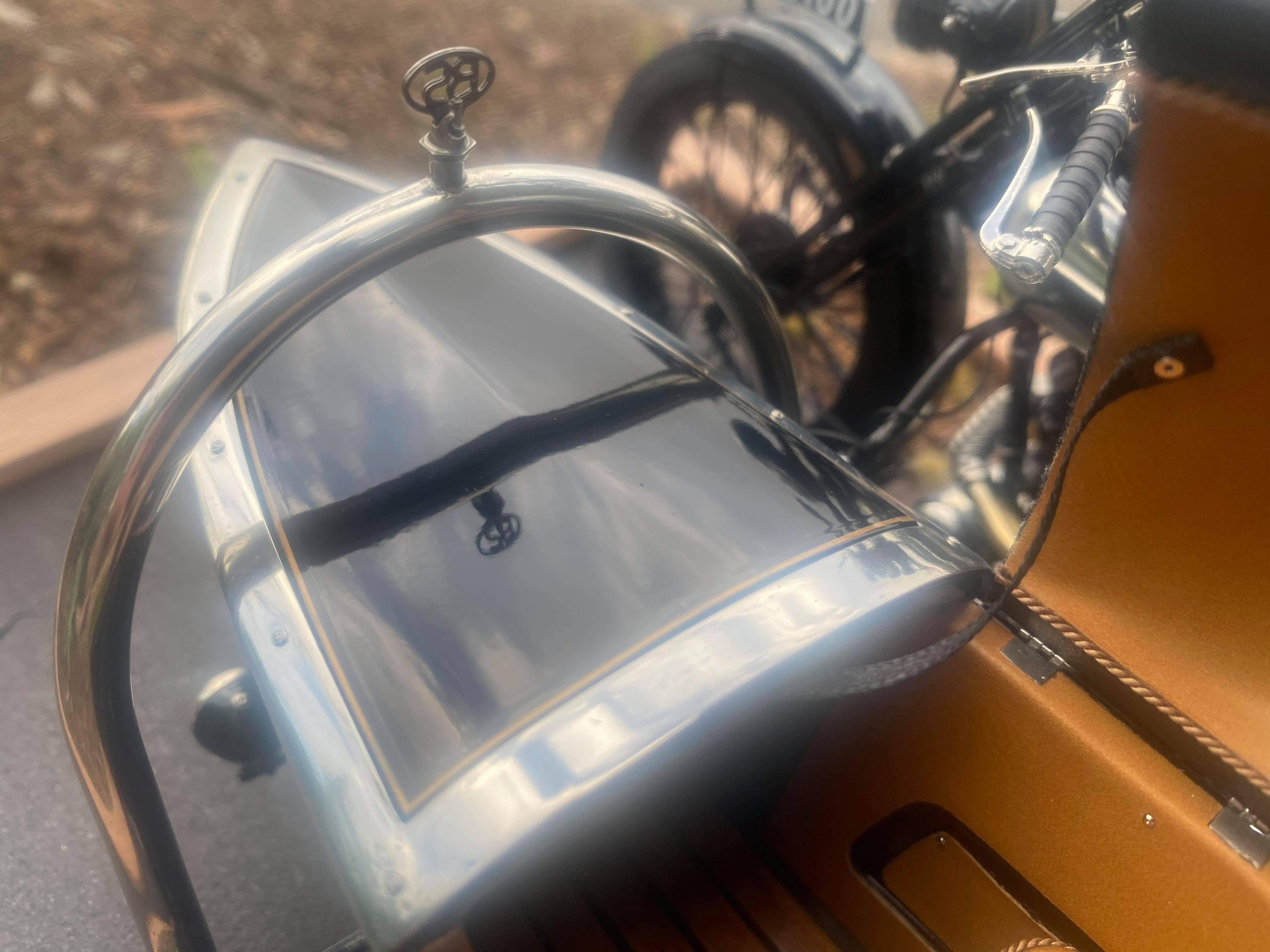

Brudda Posted October 7, 2020 Author Posted October 7, 2020 Just now, Brudda said: I’m going to learn a new technique on the windshield frame, My friend Mark is very very experienced in this metal. He is going to teach me “solder wiping”. Fills the imperfections in the white metal with solder and polished like it was chrome. Here is a example. The pieces that look like chrome are white metal that has been “solder wiped” sanded then polished. By the way , this is the level my buddy Mark is at. I’m still learning! By the way your clear is perfect. The color of the white stripes are also perfect. Wimbledon White. Some call it hounds tooth white. Your build is looking great
