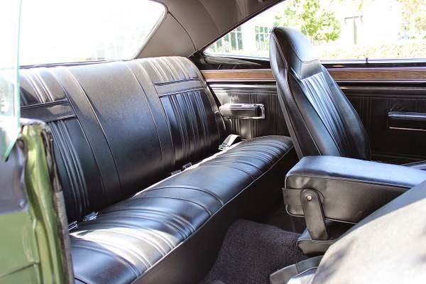

1 hour ago, gtx6970 said:
Be very careful in making the upper ridge section. In the 1/1 panel this pattern is VERY light  in person
Yeah, I know Bill, but I don't see any way to make it that fine.
Hopefully by the time the paint is applied, it will look close.
Even the original panels in the MPC kit are nowhere near that fine.
Steve
That lighter red part looks to be a solid sheet of embossed vinyl.

Most annual kits from the 60s that had both a hardtop and a convertible version have convertible interiors in the hardtop.  There are many  examples. This resin interior tub was no doubt mastered from a kit part.
Edited by Rob Hall

I'm likely going to buy one of those tubs (and the separate bench seat) for the '70 'Bee I have .
I wonder if one were to cut the rear bench down the centre ( in a "V" shape or a horizontal slice ) and moved the interior quarters outward a similar amount... how much trouble would that "bee" ?
Certainly , your '68 R/T (same pattern as the '500' trim , IIRC) is a different animal from the '70 pattern (both seating and doors / quarters) ... heretofore the challenge .
Harts Parts are excellent , at least in my experiences with his offerings .
