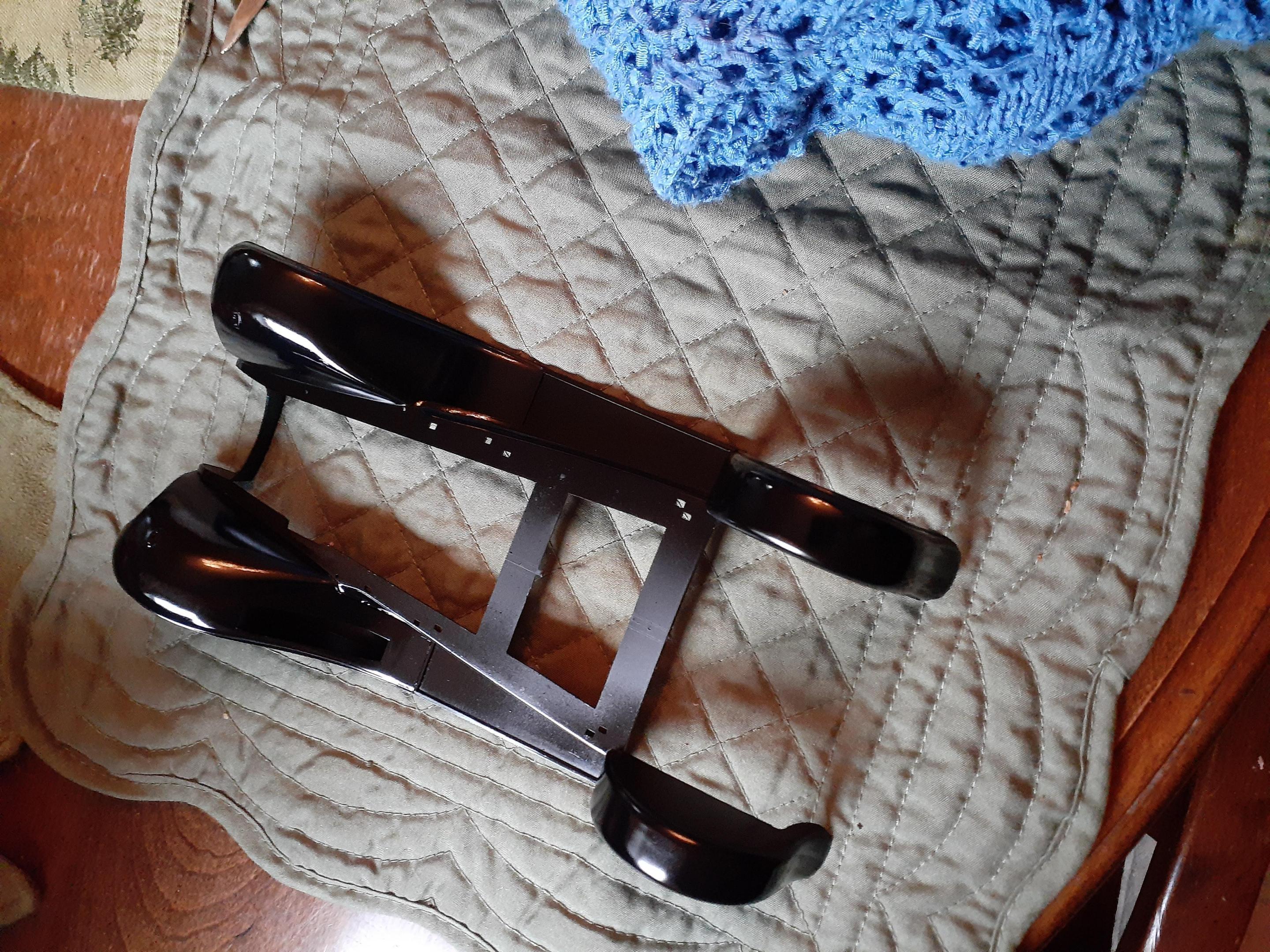

Dave G. Posted November 14, 2020 Posted November 14, 2020 My 1/16 Model A fenders with Tamiya black acrylic just out of the dehydrator after shooting the black. So this is straight from the airbrush, no polishing no anything but taking a picture. It's over Stynylrez black primer, shot 30 minutes before the black went on, that's the dark grey/black between the fenders. Shot them dried them everything all in took less than an hour. Just fwiw. This photo is considerably down graded from compression for email as well. The fenders are not wet, that's dry black paint, no clear coat, not polished..
Venom Posted November 14, 2020 Posted November 14, 2020 On 11/14/2020 at 1:13 AM, Dave G. said: My 1/16 Model A fenders with Tamiya black acrylic just out of the dehydrator after shooting the black. So this is straight from the airbrush, no polishing no anything but taking a picture. It's over Stynylrez black primer, shot 30 minutes before the black went on, that's the dark grey/black between the fenders. Shot them dried them everything all in took less than an hour. Just fwiw. This photo is considerably down graded from compression for email as well. The fenders are not wet, that's dry black paint, no clear coat, not polished.. Expand That come out nice David. I’ve seen you tube videos where people were able to achieve those same results with the Createx... I just can’t seem to achieve it myself. I wonder if air pressure has anything to do with it?
TransAmMike Posted November 14, 2020 Author Posted November 14, 2020 Wow Dave, that looks great, and no clear. Wow.

Dave G. Posted November 14, 2020 Posted November 14, 2020 On 11/14/2020 at 1:31 AM, Venom said: That come out nice David. I’ve seen you tube videos where people were able to achieve those same results with the Createx... I just can’t seem to achieve it myself. I wonder if air pressure has anything to do with it? Expand I'd be aiming for lower viscosity "and or" more flow out. Then air pressure. But I don't use Createx, so far be it from me without getting hands on to say how that is accomplished with Createx. I will say, I'm one to think and work outside the box sometimes.

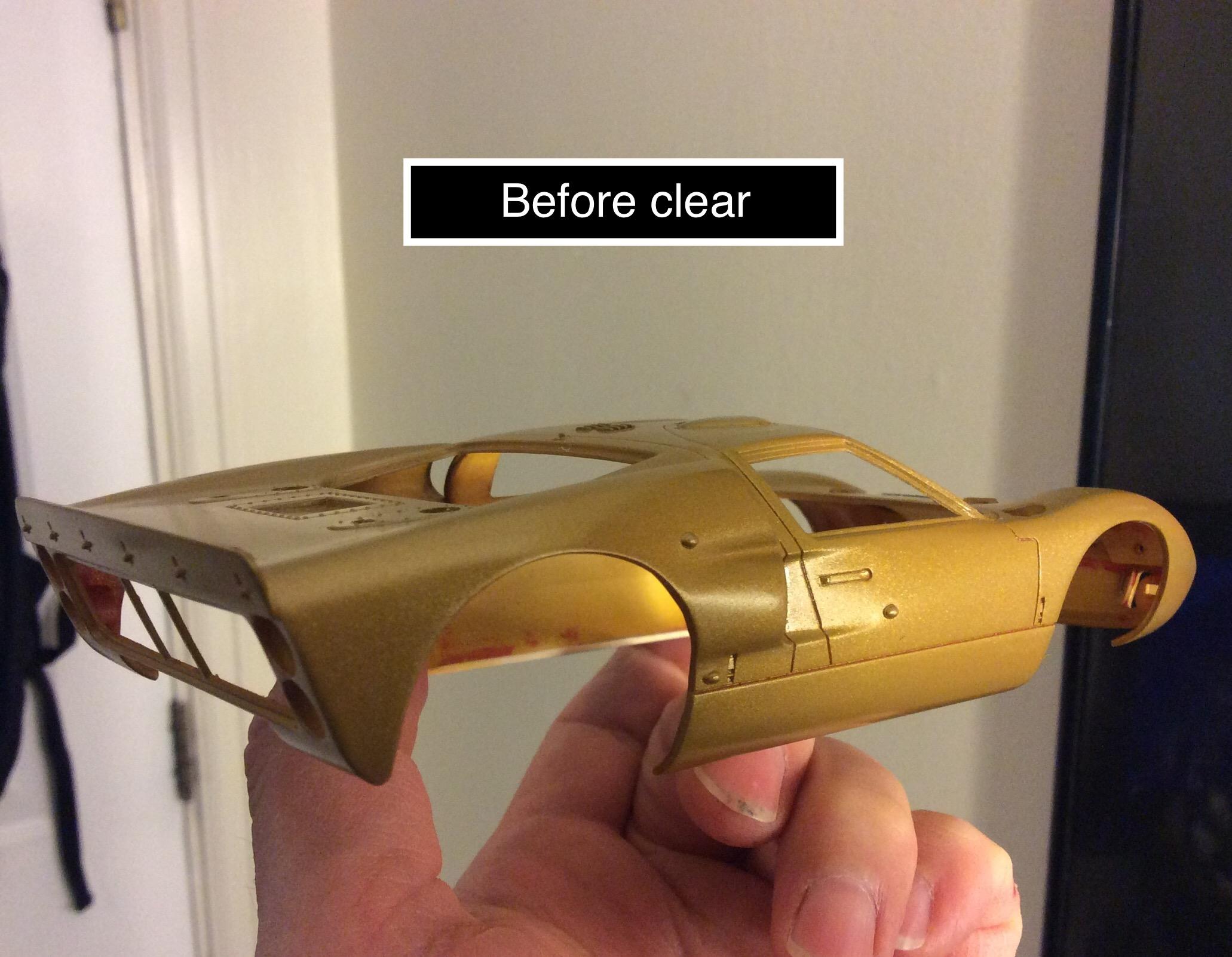

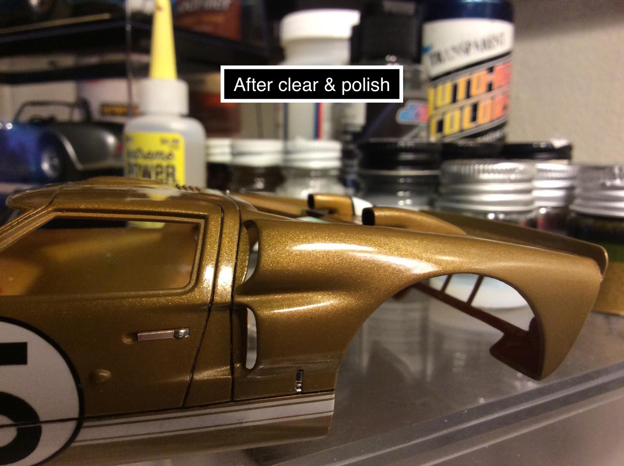

Venom Posted November 15, 2020 Posted November 15, 2020 On 11/14/2020 at 2:18 AM, TransAmMike said: Josh, you mentioned youdid a gold GT40. Any chance you could send a picture?? Would like to see the gold. Expand Don’t want to give the big reveal before it’s finished, but here’s an idea.
Dave G. Posted November 15, 2020 Posted November 15, 2020 That gold in terms of tone on the GT40 above ( which is turning out very nice) would probably be fairly close to the Oldsmobile gold but the Olds never had metal flake finish. It was a very fine metallic and a natural non clear coated finish as well..

Venom Posted November 15, 2020 Posted November 15, 2020 (edited) On 11/15/2020 at 12:56 PM, Dave G. said: That gold in terms of tone on the GT40 above ( which is turning out very nice) would probably be fairly close to the Oldsmobile gold but the Olds never had metal flake finish. It was a very fine metallic and a natural non clear coated finish as well.. Expand I took the pic last night under artificial living room lights. Under daylight conditions, the metallic isn’t so glittery. It looks very similar to this (below)... The color tone that is. But in terms of metallic, I don’t know how you would get the flake small enough to look this way on 1/24. I’m also not trying for that level of exactness, but just the right amount to be satisfying Edited November 15, 2020 by Venom Further clarification about color
Venom Posted November 15, 2020 Posted November 15, 2020 On 11/15/2020 at 4:54 PM, TransAmMike said: Very nice Josh, and what clear is that?? And Don, you are right about the metallic and thats why I like the pearl look. Expand 5620 and 4012 reducer. I mixed the gold myself.
