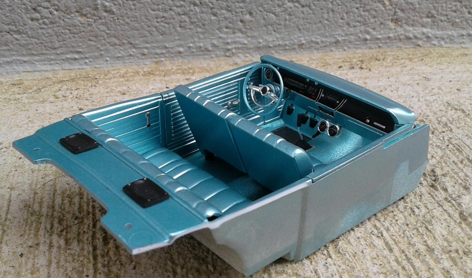

Plowboy Posted November 1, 2020 Posted November 1, 2020 I've done it. But, not in a Mopar. You basically add styrene to the sides and back. Split it down the center on the seat back, fill in the resulting holes and add brackets to the bottom to raise it off the floorpan.

Plowboy Posted November 3, 2020 Posted November 3, 2020 6 hours ago, 1972coronet said: Perfect ! Thanks much for mentioning the details (brackets) as well --- the devil's in the details . Do you have a standalone example of your semi-scratch-built bench seats ? No. All I have is a couple finished and installed.
Bills72sj Posted November 3, 2020 Posted November 3, 2020 1 hour ago, Plowboy said: Very nice detail work.
slusher Posted November 3, 2020 Posted November 3, 2020 2 hours ago, Plowboy said: No. All I have is a couple finished and installed. 66 or 68 Chevy? Roger you very talented and do about anything you want like Steve...
Plowboy Posted November 3, 2020 Posted November 3, 2020 5 hours ago, slusher said: 66 or 68 Chevy? Roger you very talented and do about anything you want like Steve... Thanx Carl! It's from my 66 Malibu sedan I posted a while back.
