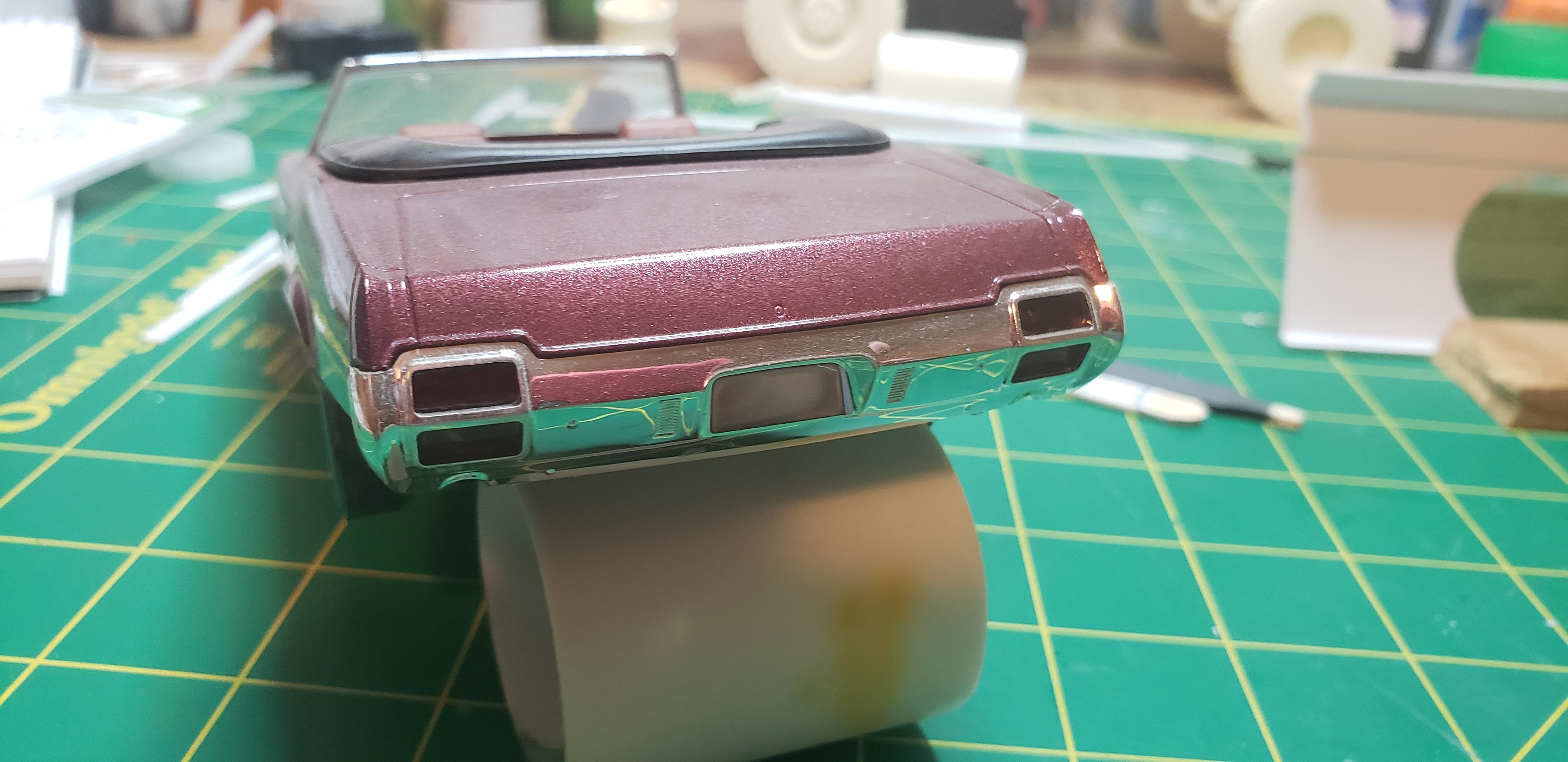

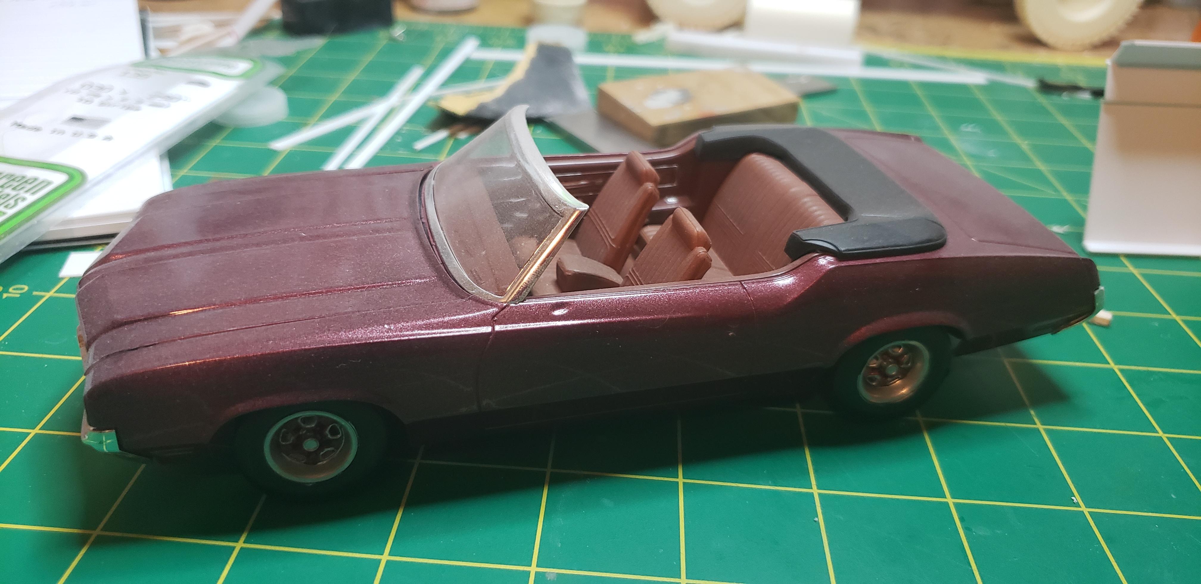

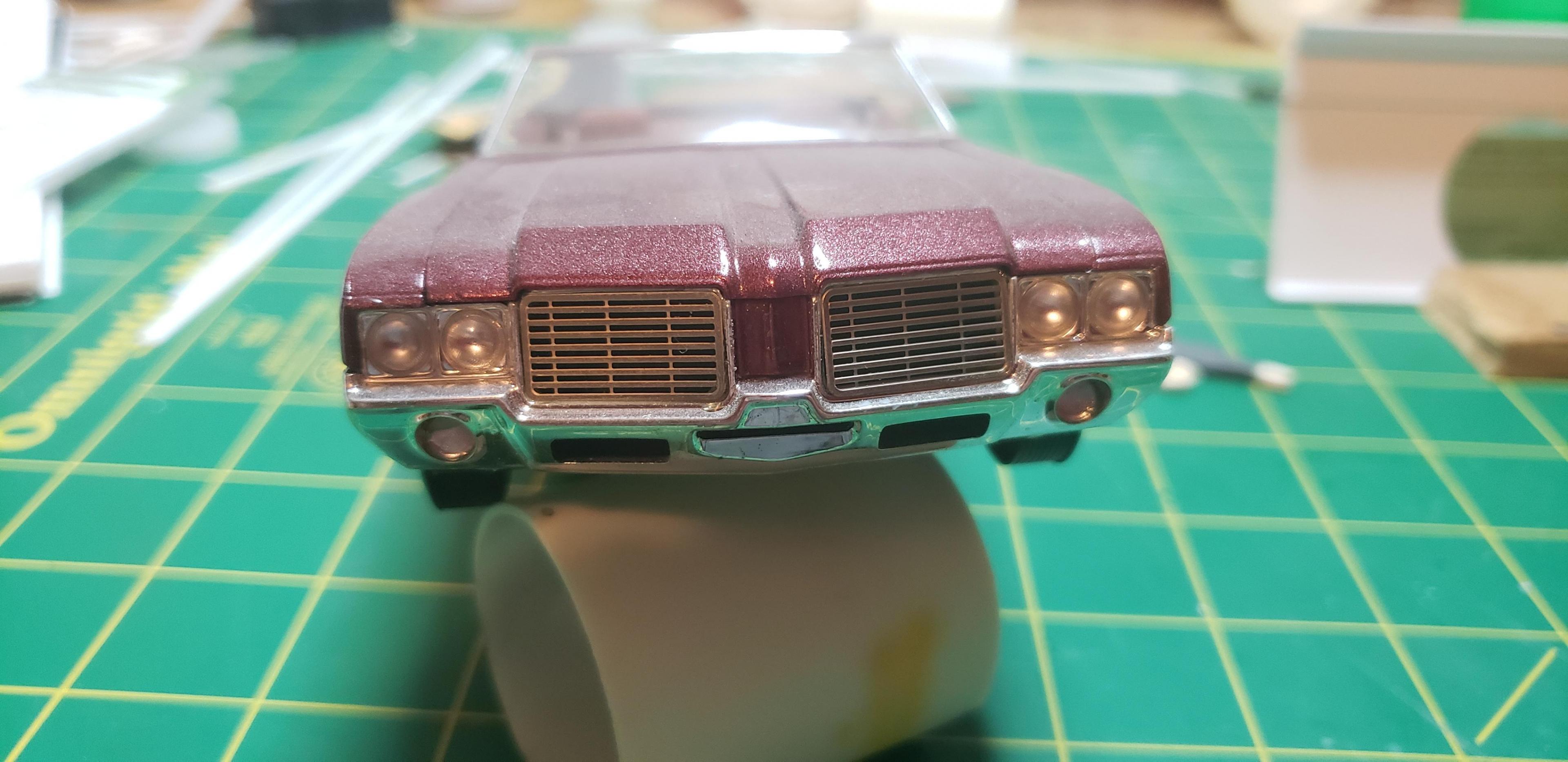

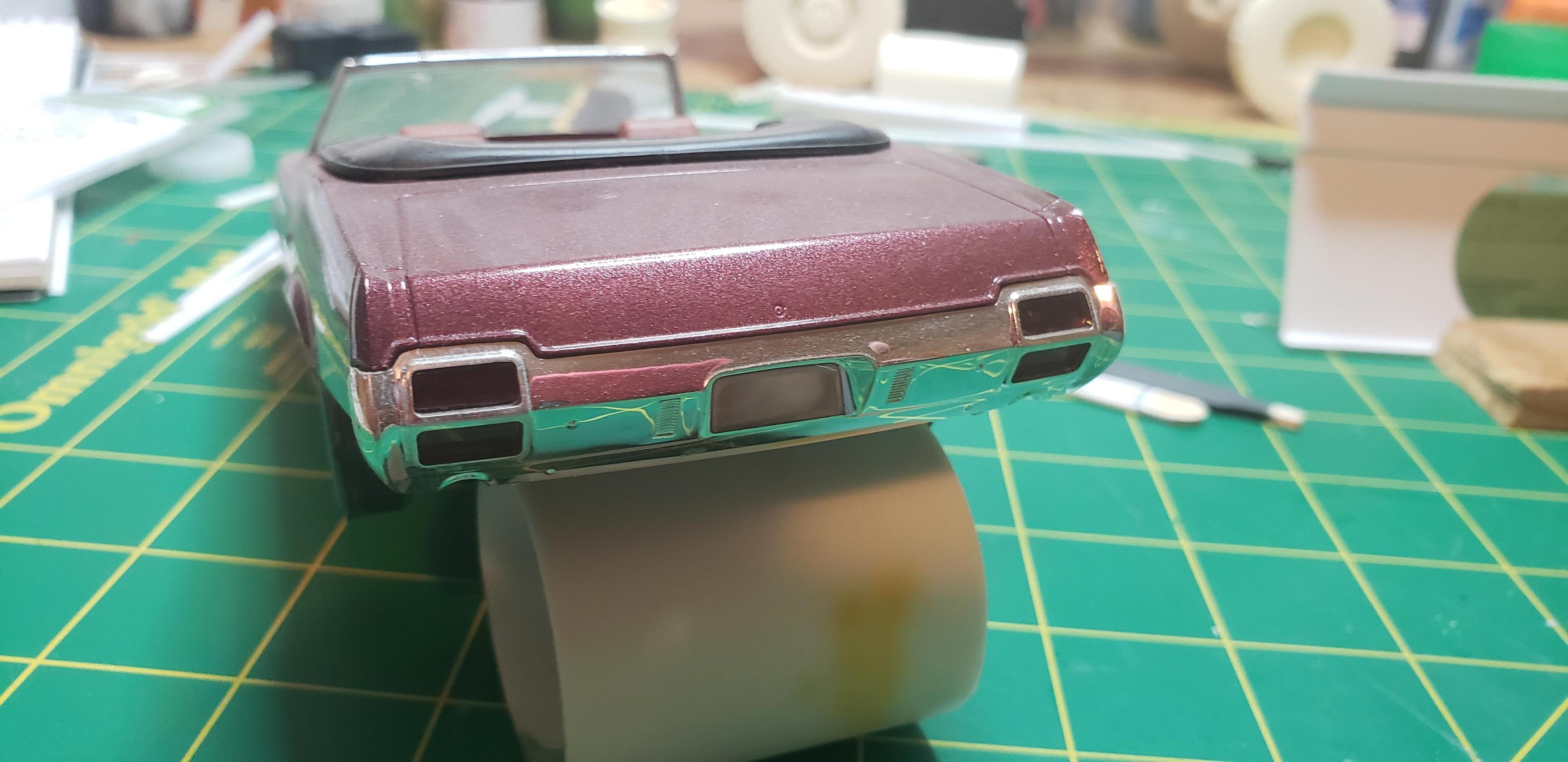

Here's my 71 replica of our convertible. The fella that restored the car back in late 90s used a deck lid off a 4 door coupe so mine doesn't have the individual letters

Not really its been on wip shelf for awhile , it was knocked off shelf when our siding was installed and lost a few parts
