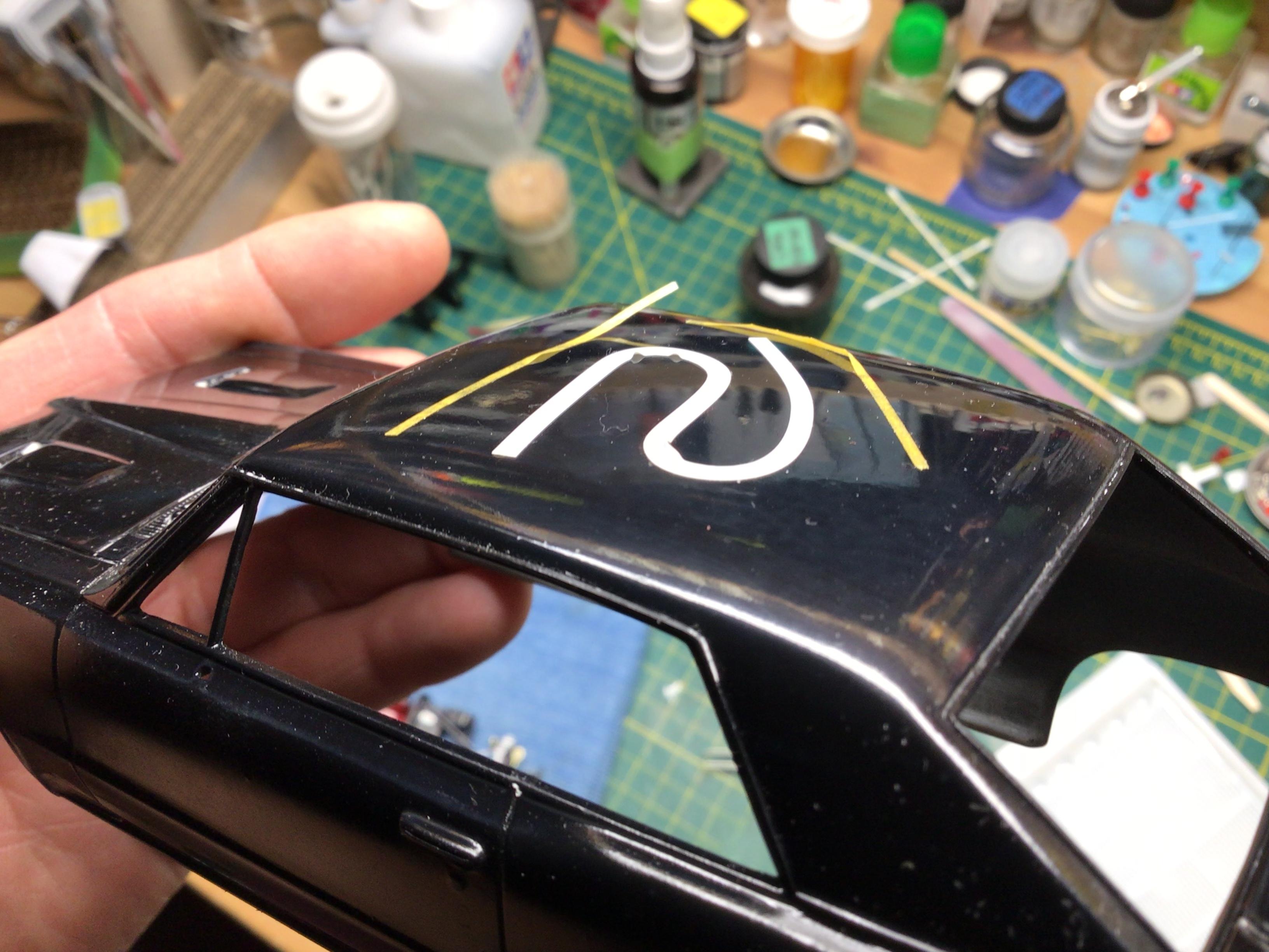

NOBLNG Posted November 27, 2021 Posted November 27, 2021 (edited) I know the orange 1mm tape is NOT Tamiya. Maybe Vallejo? It sticks OK, but does not do curves well at all. The white 2mm stuff does curves well, but since it is elastic, it will likely want to lift? I have not actually masked a paint job with either of them. I’ll leave them set for a while and see what happens. Edited November 27, 2021 by NOBLNG

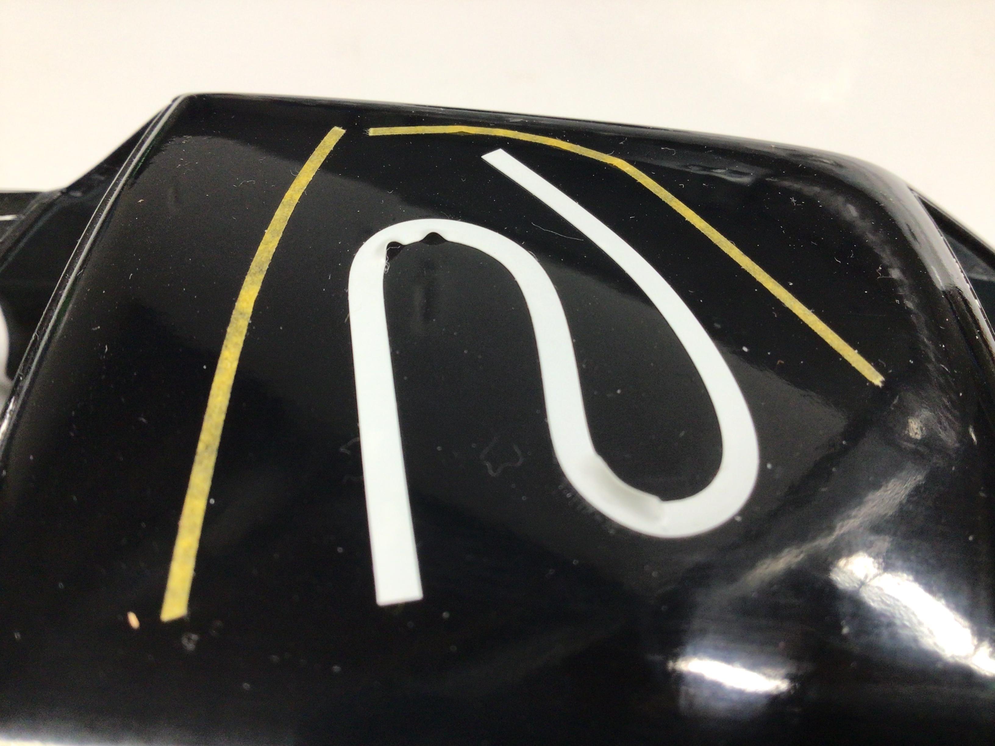

NOBLNG Posted November 29, 2021 Posted November 29, 2021 As suspected, the white plastic tape is lifting.
showrods Posted November 29, 2021 Posted November 29, 2021 Photo looks as if it's the yellow tape that's lifting LOL 1
OldNYJim Posted December 5, 2021 Posted December 5, 2021 How long was the white tape stuck down before it started lifting?

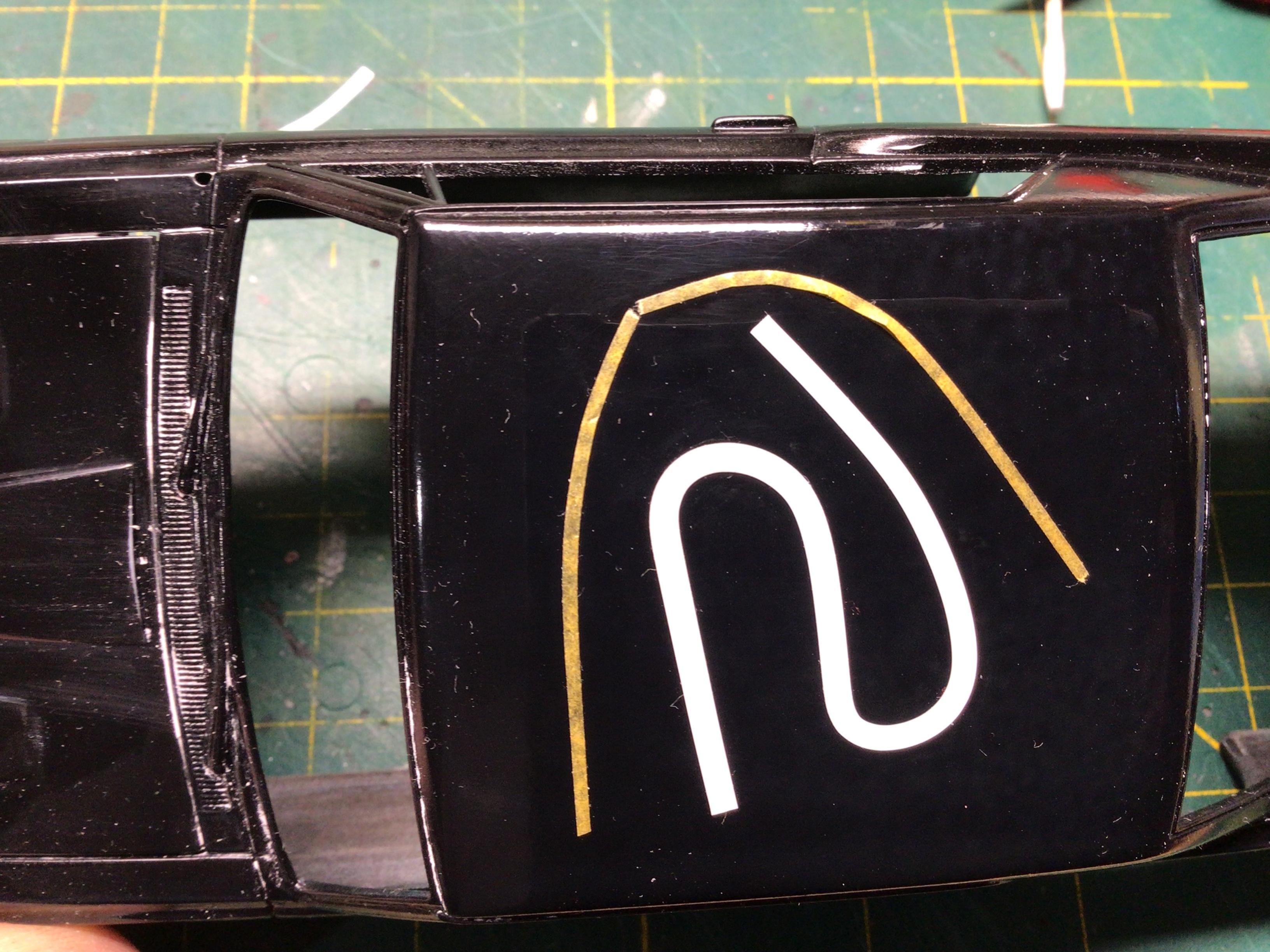

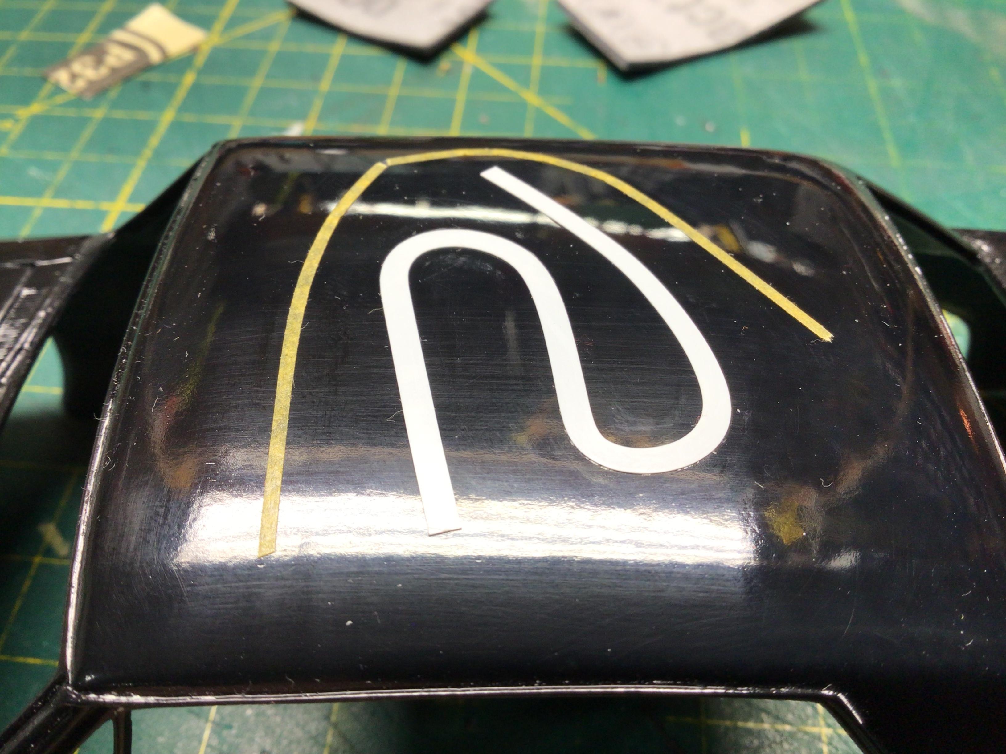

NOBLNG Posted December 5, 2021 Posted December 5, 2021 (edited) On 11/28/2021 at 7:22 PM, showrods said: Photo looks as if it's the yellow tape that's lifting LOL You know, I never even burnished the yellow tape down properly. I mostly laid it to see if it would curve. I re-set it after your post. 9 hours ago, CabDriver said: How long was the white tape stuck down before it started lifting? By the next morning it was lifted…so within hours. Pic taken just now. Edited December 5, 2021 by NOBLNG
