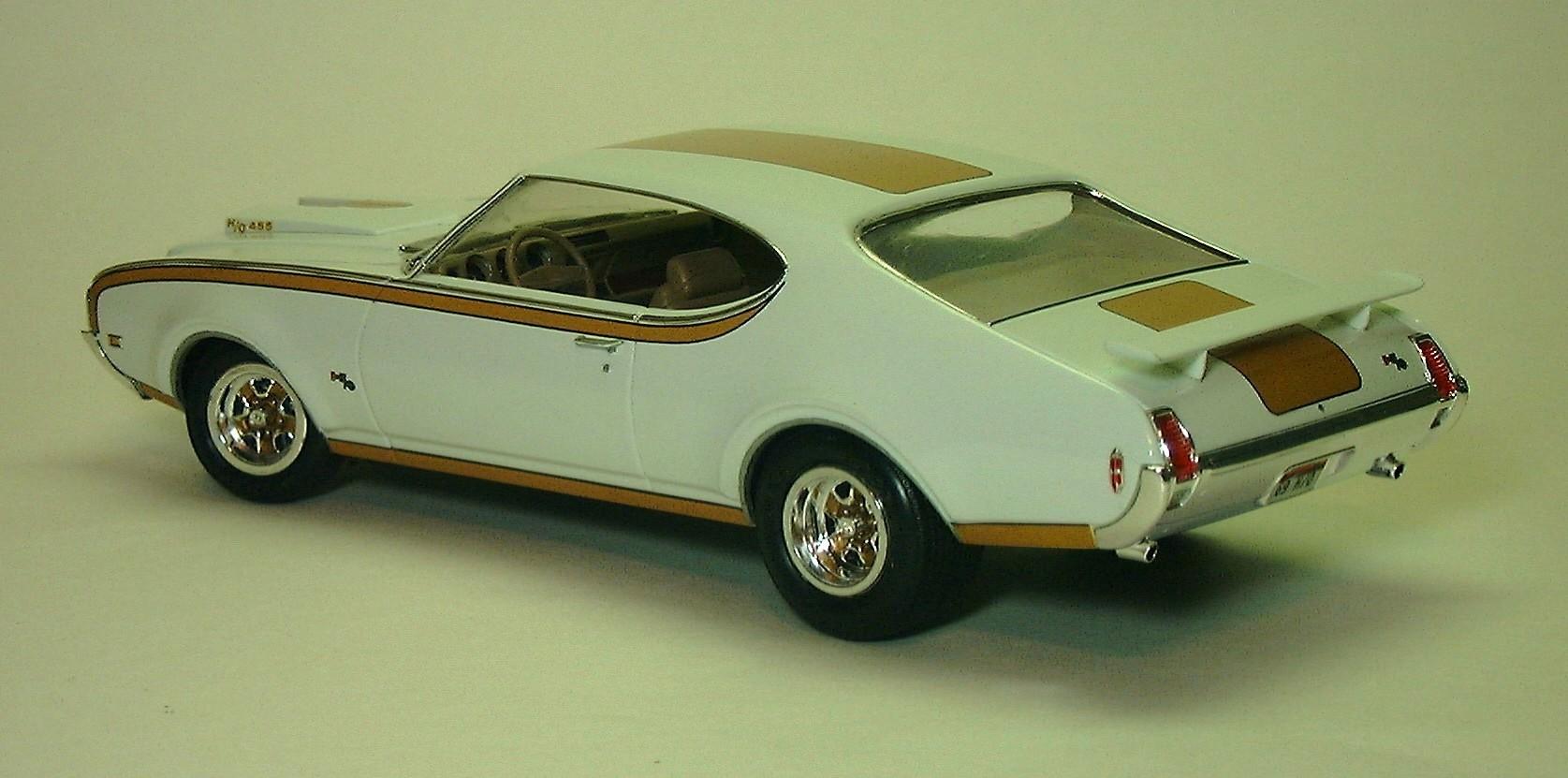

Toner283 Posted December 13, 2020 Share Posted December 13, 2020 As an additional tip, I know you are wanting to Pro Street yours but for a stock/mildly modified car there is a better chassis available than the original one from the 69 Chevelle. The AMT 69 Olds W30 chassis is a direct drop in fit. Basically no modifications and it will go under the 69 Chevelle and give you a far better modern tooled chassis. Probably the 69 Hurst Olds will also work but I have never had one of those to be able to verify it. Quote Link to comment Share on other sites More sharing options...
Bills72sj Posted December 13, 2020 Share Posted December 13, 2020 7 minutes ago, Toner283 said: As an additional tip, I know you are wanting to Pro Street yours but for a stock/mildly modified car there is a better chassis available than the original one from the 69 Chevelle. The AMT 69 Olds W30 chassis is a direct drop in fit. Basically no modifications and it will go under the 69 Chevelle and give you a far better modern tooled chassis. Probably the 69 Hurst Olds will also work but I have never had one of those to be able to verify it. I agree. The 69 Olds chassis is one of the most detailed chassis for GM A-bodies of that era. And yes the 69 Hurst Olds is just as detailed. I got some pretty decent sized tires under it without cutting plastic. My 69 Chevelle from the same kit as yours, required cutting out the rear inner fenders. I did not tub it. Quote Link to comment Share on other sites More sharing options...
SCRWDRVR Posted December 14, 2020 Author Share Posted December 14, 2020 2 hours ago, Toner283 said: Don't use the search feature on the site. It's basically useless. Check out this thread that Ace Garage Guy posted and use the tips in it. Much better search results. I will do that thanks, and for the info on the Olds chassis 2 hours ago, Bills72sj said: I agree. The 69 Olds chassis is one of the most detailed chassis for GM A-bodies of that era. And yes the 69 Hurst Olds is just as detailed. I got some pretty decent sized tires under it without cutting plastic. My 69 Chevelle from the same kit as yours, required cutting out the rear inner fenders. I did not tub it. Thanks for the info, I’ve been wanting to pick up a Cutlass I’ll have to buy 2 Quote Link to comment Share on other sites More sharing options...
