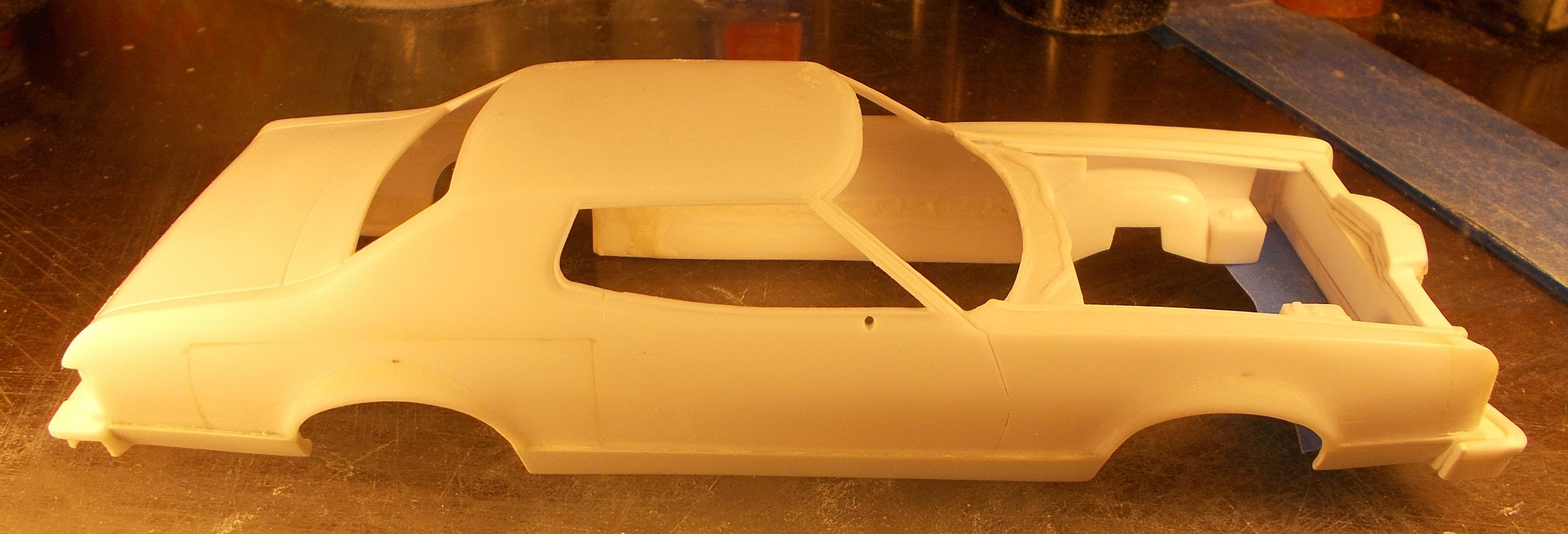

Repstock Posted December 28, 2020 Posted December 28, 2020 I know of a few others on this board who have taken on the project of building a 1976 Montego. I started the same project some time ago, and thought I'd share what I have so far of my take on the Montego.

Repstock Posted January 3, 2021 Author Posted January 3, 2021 I really hadn't intended to cast it, as some parts would be difficult to cast, but if there's that much interest, I could re-engineer certain things to make it castable. The one thing required of the buyer is to narrow the chassis a bit. While I was modifying the body, I went ahead and kinked the bottom of the body in some more. The Revell Torino doesn't roll under enough at the body bottom. (JoHan's does).
yellowsportwagon Posted January 3, 2021 Posted January 3, 2021 On 1/3/2021 at 9:51 PM, Repstock said: I really hadn't intended to cast it, as some parts would be difficult to cast, but if there's that much interest, I could re-engineer certain things to make it castable. The one thing required of the buyer is to narrow the chassis a bit. While I was modifying the body, I went ahead and kinked the bottom of the body in some more. The Revell Torino doesn't roll under enough at the body bottom. (JoHan's does). Expand I totally agree with you. On the roll under. That and the windshield shape irritates me on the Revell Torino. The Johan is spot on.

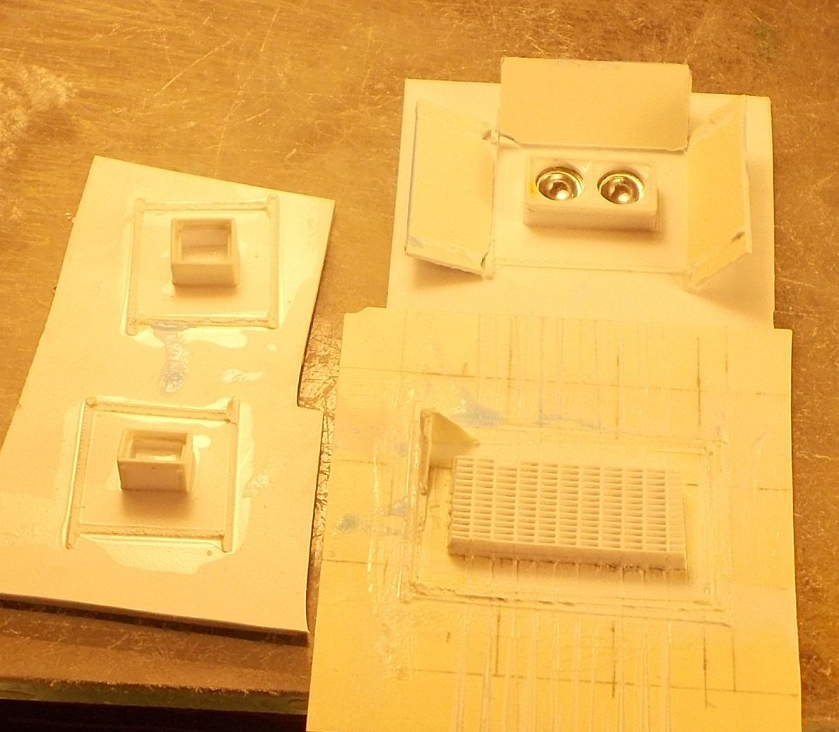

DoctorLarry Posted January 4, 2021 Posted January 4, 2021 Tom, did you use pre molded stock on the grille or do the bars individually?

steveracer Posted January 4, 2021 Posted January 4, 2021 What are the details on this? What did you start with, and what modifications were done to get this look? The tree know and Mercury were quite different bodies, and yours looks great - I want one too!
Repstock Posted January 4, 2021 Author Posted January 4, 2021 On 1/4/2021 at 1:06 AM, DoctorLarry said: Tom, did you use pre molded stock on the grille or do the bars individually? Expand I made a master for the grille pattern. I couldn't find stock with the right size rectangles. I also made a '73 grille for the new full-bumper Camaro kit.
Repstock Posted January 4, 2021 Author Posted January 4, 2021 On 1/4/2021 at 1:22 PM, steveracer said: What are the details on this? What did you start with, and what modifications were done to get this look? The tree know and Mercury were quite different bodies, and yours looks great - I want one too! Expand I started with the Revell Torino. The idea was, if I made a low-line Montego, the builder could use the interior right out of the Torino kit. I scaled the grille and headlights, and arranged the front end to get them to fit.I cut the front wheel wells out of a second Torino and used them for the rear wheel wells. I made the wheel well flares larger. I still need to do the back end, I'm waiting on some strip styrene to be delivered.

Repstock Posted January 4, 2021 Author Posted January 4, 2021 On 1/3/2021 at 11:59 PM, yellowsportwagon said: I totally agree with you. On the roll under. That and the windshield shape irritates me on the Revell Torino. The Johan is spot on. Expand Yeah, I decided to live with it so builders might use the Revell Torino windshield.
yellowsportwagon Posted January 4, 2021 Posted January 4, 2021 On 1/4/2021 at 2:01 PM, Repstock said: Yeah, I decided to live with it so builders might use the Revell Torino windshield. Expand Good idea
Repstock Posted January 4, 2021 Author Posted January 4, 2021 On 1/4/2021 at 2:57 PM, DoctorLarry said: Did you cast the grille pattern in resin? Expand Yes, but I had to assemble the sections. When the holes are that small, I have a real problem with bubbles in the mold forming in the cavities. I don't have a vacuum or pressure pot, so I can only do simple one-piece molds. I did the center eggcrate section for a '73 Chevy pickup grille, but the spaces on that one were larger than the Montego grille. The '73 Camaro grille I was able to do in one piece. All of the grille patterns were created using evergreen/plastruct strips.
DoctorLarry Posted January 4, 2021 Posted January 4, 2021 So you built it from evergreen, made a mold, and cast it? I have the same problem with small bubbles on dash boards, door locks, and grilles. I need to build a pressure chamber to do these things. I thinl on my 75 Century project the grille had something like 39 pieces. How do you glue them down? I find it hard to be neat and keep the small parts straight.
Repstock Posted January 4, 2021 Author Posted January 4, 2021 (edited) On 1/4/2021 at 6:25 PM, DoctorLarry said: So you built it from evergreen, made a mold, and cast it? I have the same problem with small bubbles on dash boards, door locks, and grilles. I need to build a pressure chamber to do these things. I thinl on my 75 Century project the grille had something like 39 pieces. How do you glue them down? I find it hard to be neat and keep the small parts straight. Expand It is hard. That's partly why I cast parts, if I screw it up, I try again. The first pic are parts for the Montego, the other is various other grille masters. Edited January 4, 2021 by Repstock
