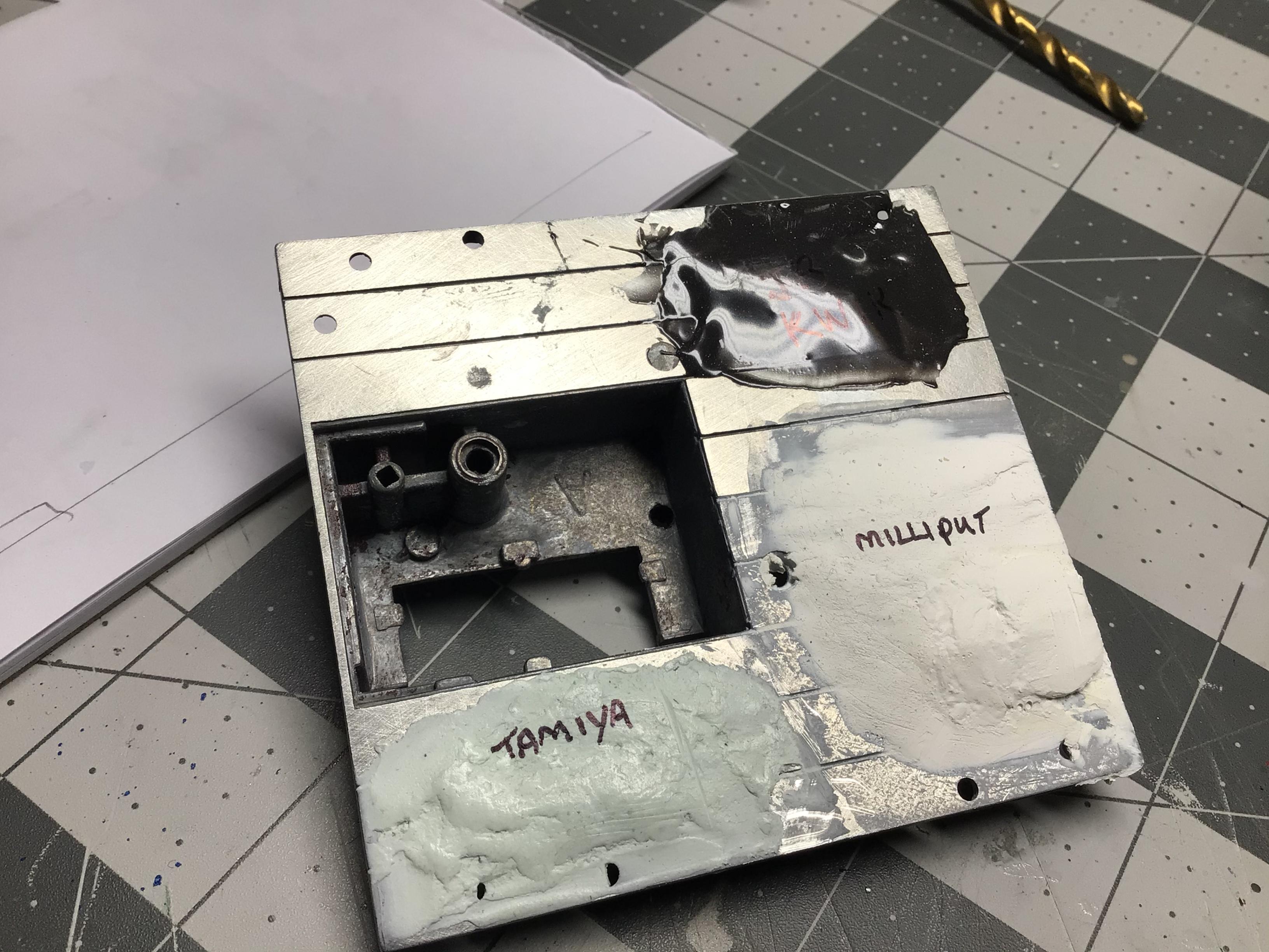

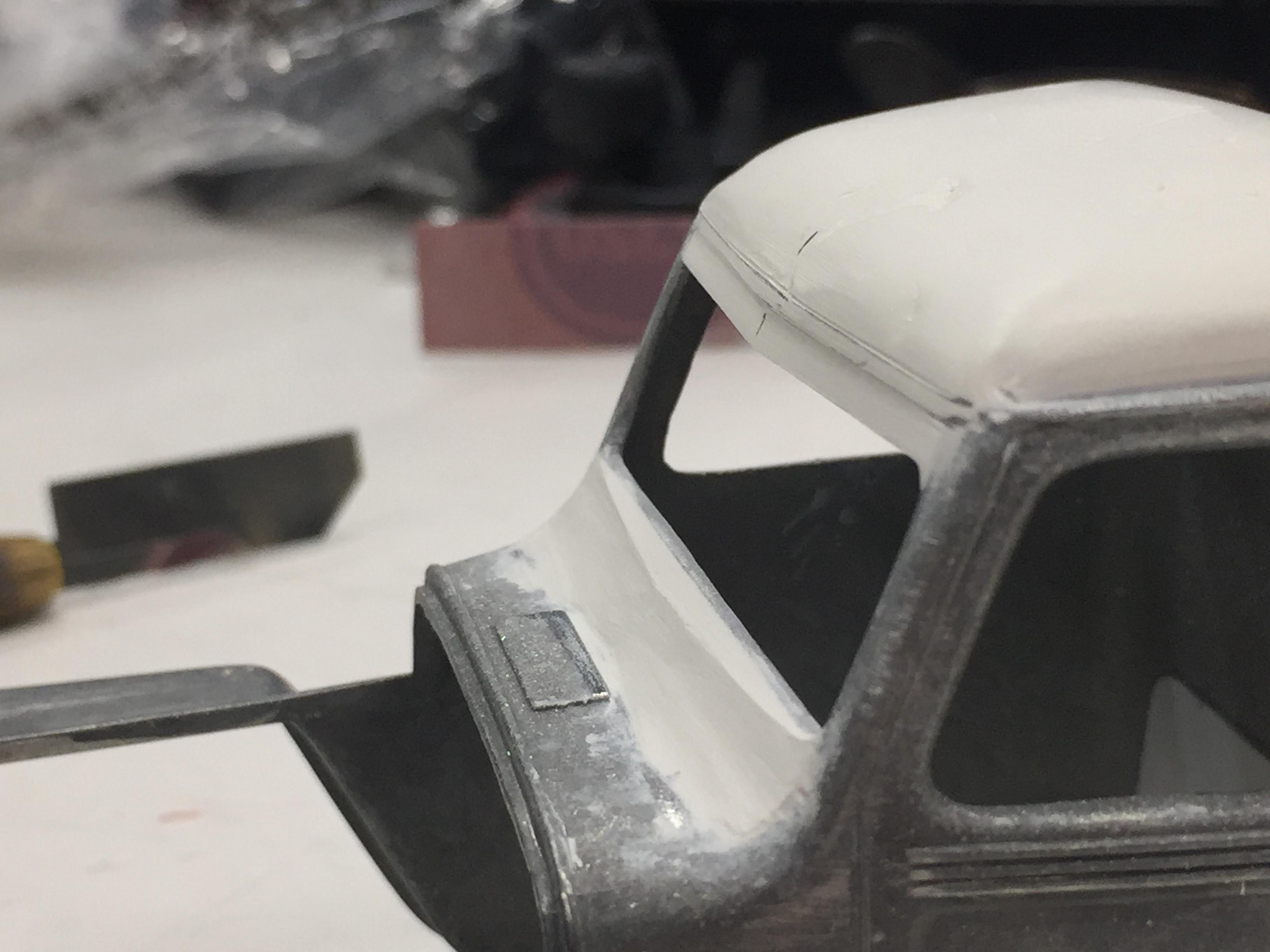

NOBLNG Posted February 7, 2021 Posted February 7, 2021 I used the super fine Milliput on my Willys cab. I did a test with it, Tamiya and JB weld. Note:The JB weld I used was the 5 minute type which is NOT what everyone on here recommends, and it never did harden completely. All three adhered very well to the metal. The Tamiya was a little stiffer and harder to mix than the Milliput and took a little longer to fully harden. The Milliput and Tamiya are now rock hard, but file and sand nicely. i would recommend either one. You could also drill a small hole at the tip of the fin and glue in a short piece of wire (guitar string would work good) to give the patch something to cling to.
