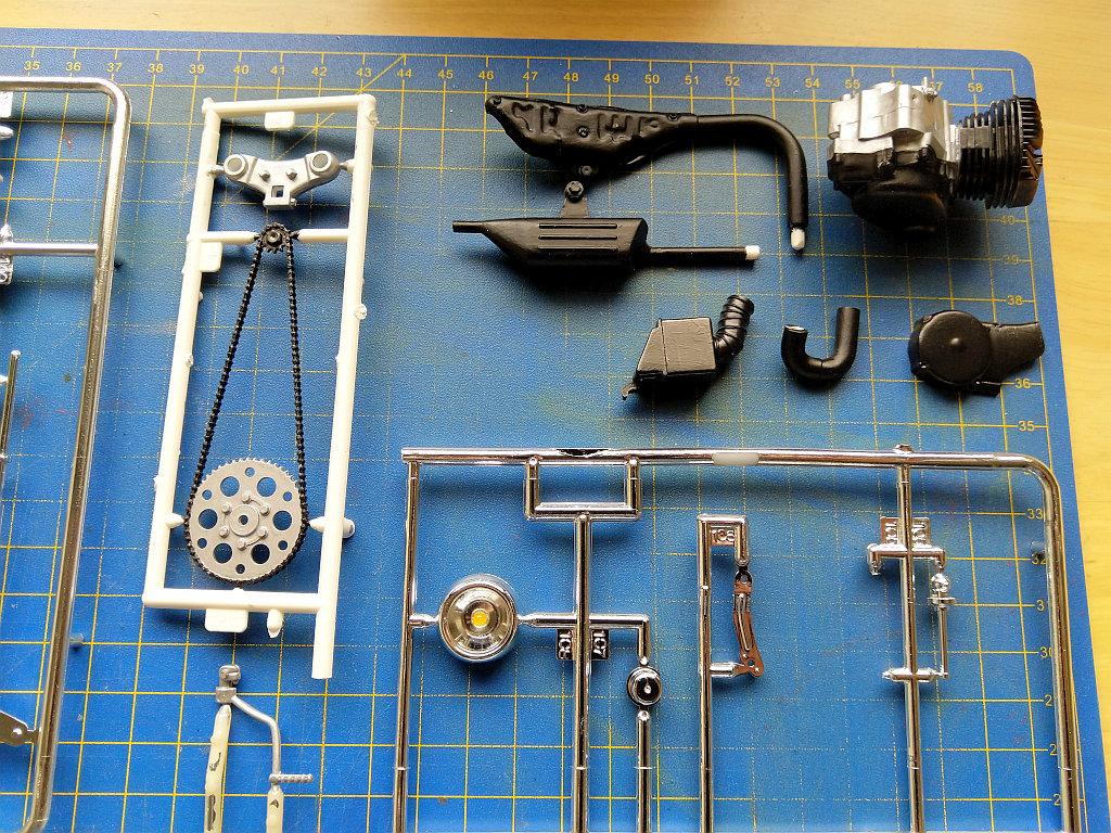

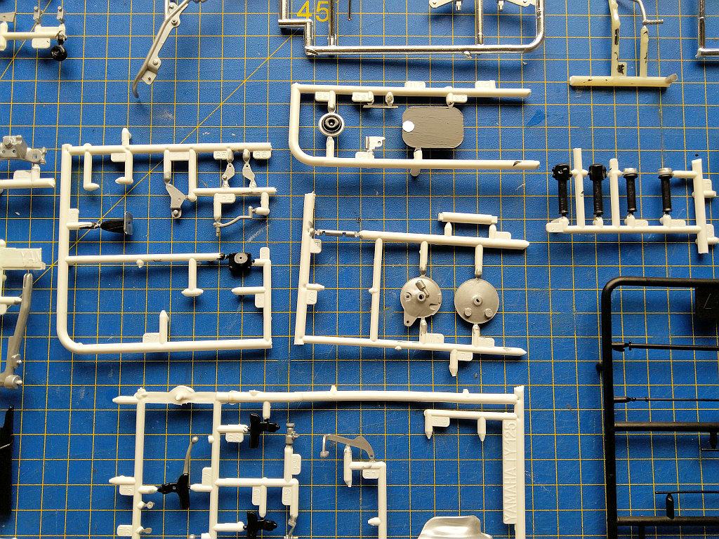

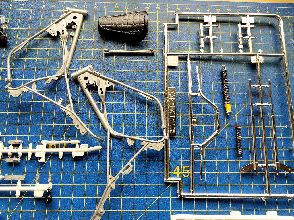

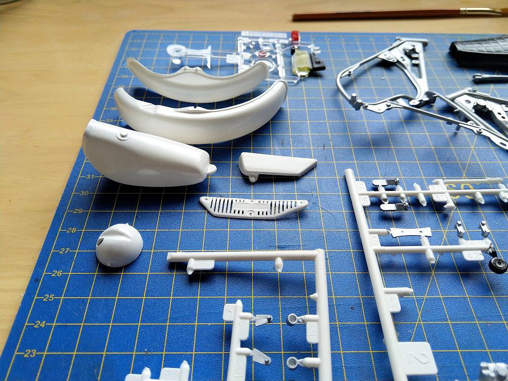

Rakentaja Posted July 20, 2021 Author Posted July 20, 2021 If I remember correctly, I used these products: Oven and grill cleaner (pic 1), a substance used to open a clogged drain (pic 3), a bleach , that is the same as chlorite (pic 2). The chromium came off quickly, but it took at least 24 hours for the varnish to come off. I don't remember exactly anymore. I have used the same fluids in the past without any side effects. I don't have any chrome parts tree to test. All the parts are painted and ready to install, but no rims. (Pics 4-7)
