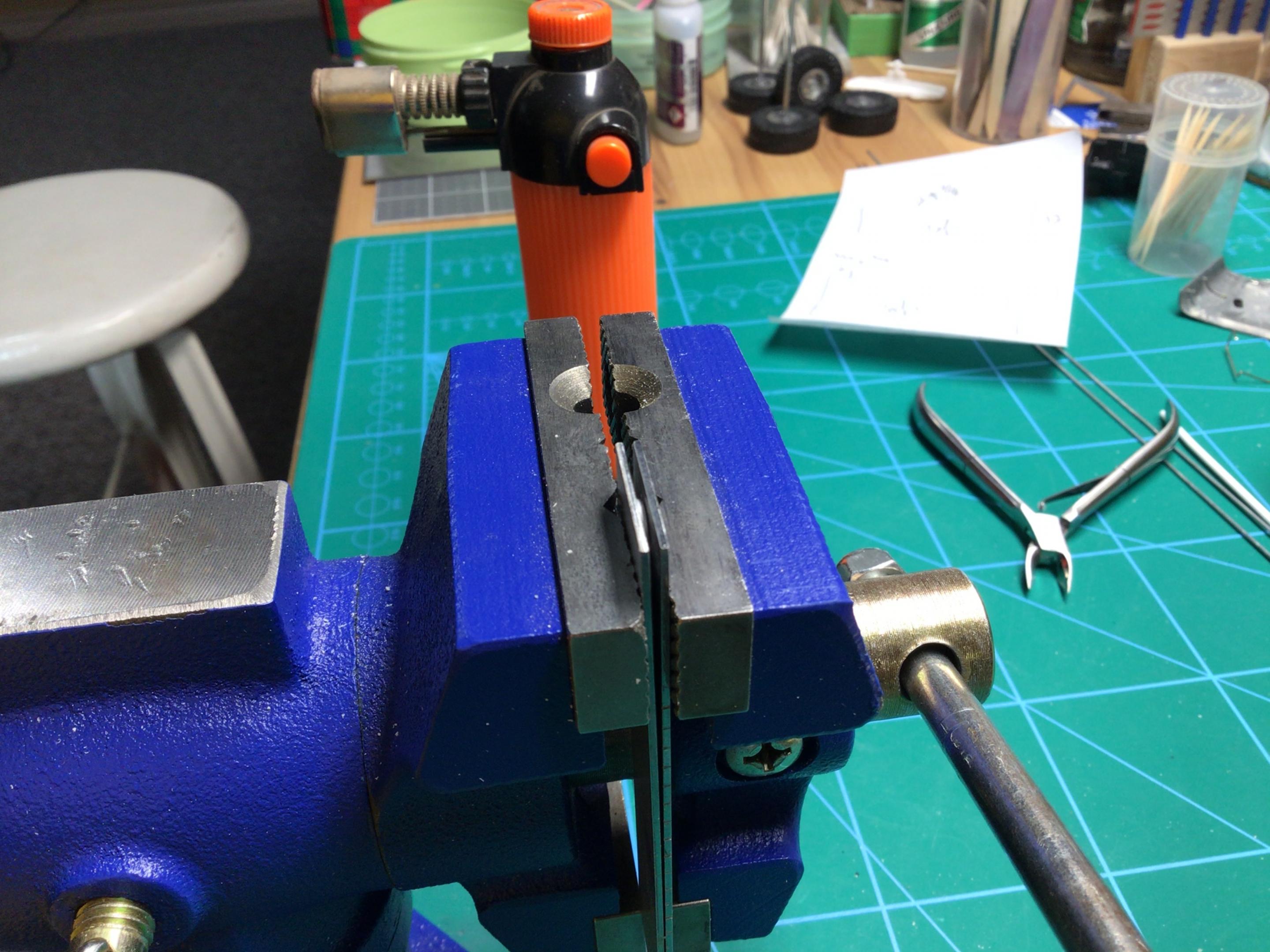

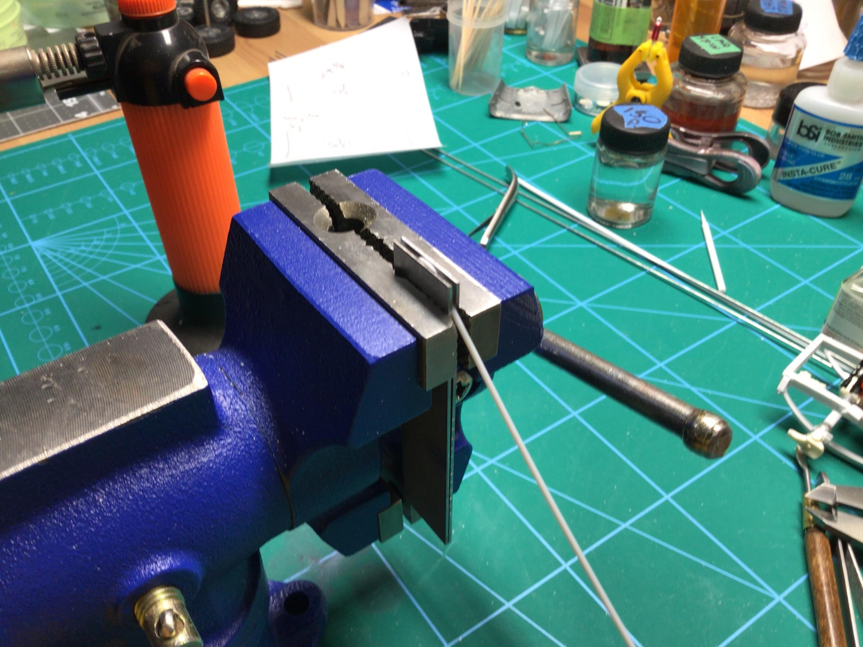

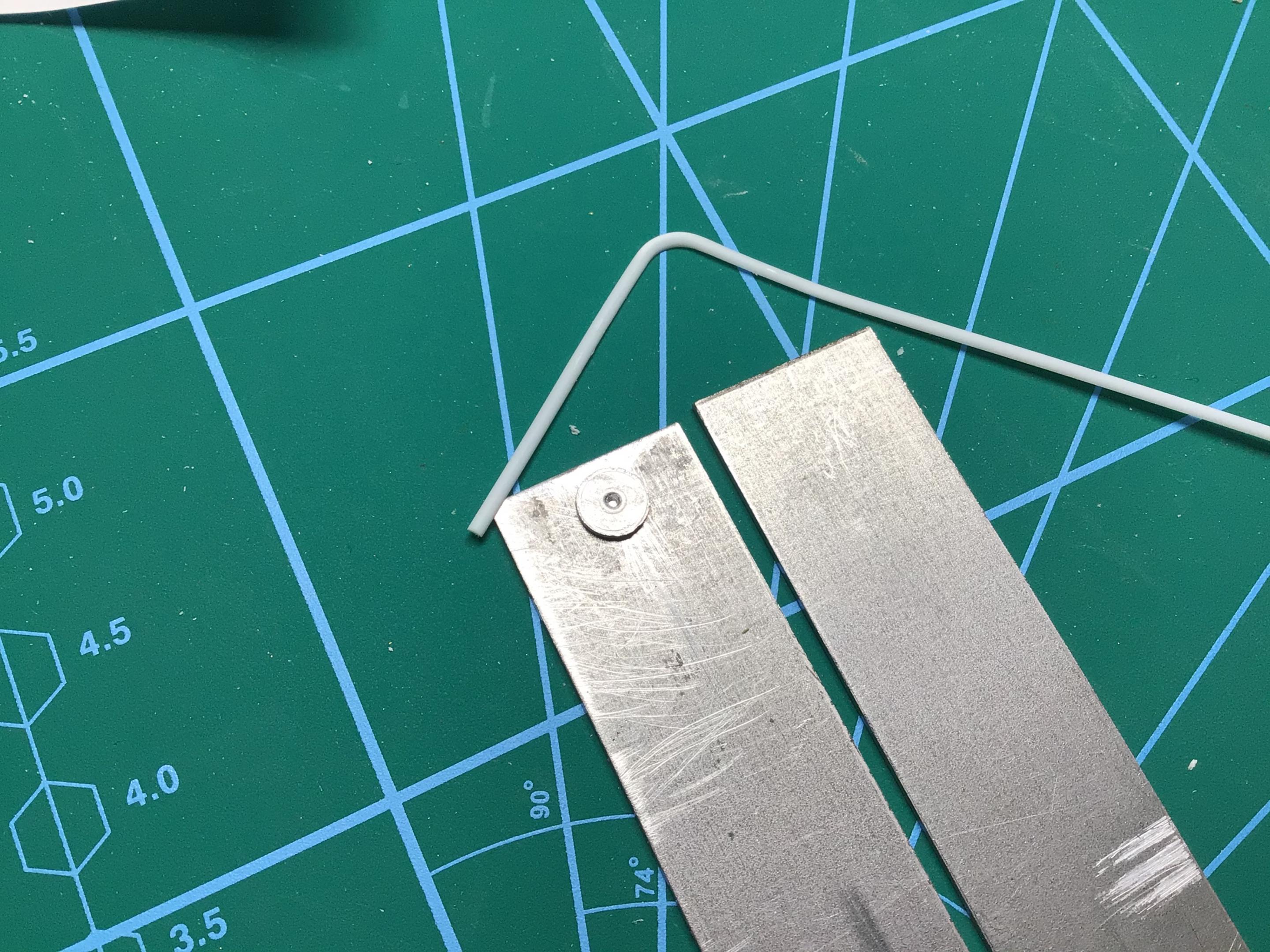

NOBLNG Posted May 1, 2021 Posted May 1, 2021 (edited) I just tried an experiment. I heated the two plates clamped in the vise slightly. Then put the .060” half round in and bent it around the .030” spacer. It stayed very nearly flat. Edited May 1, 2021 by NOBLNG

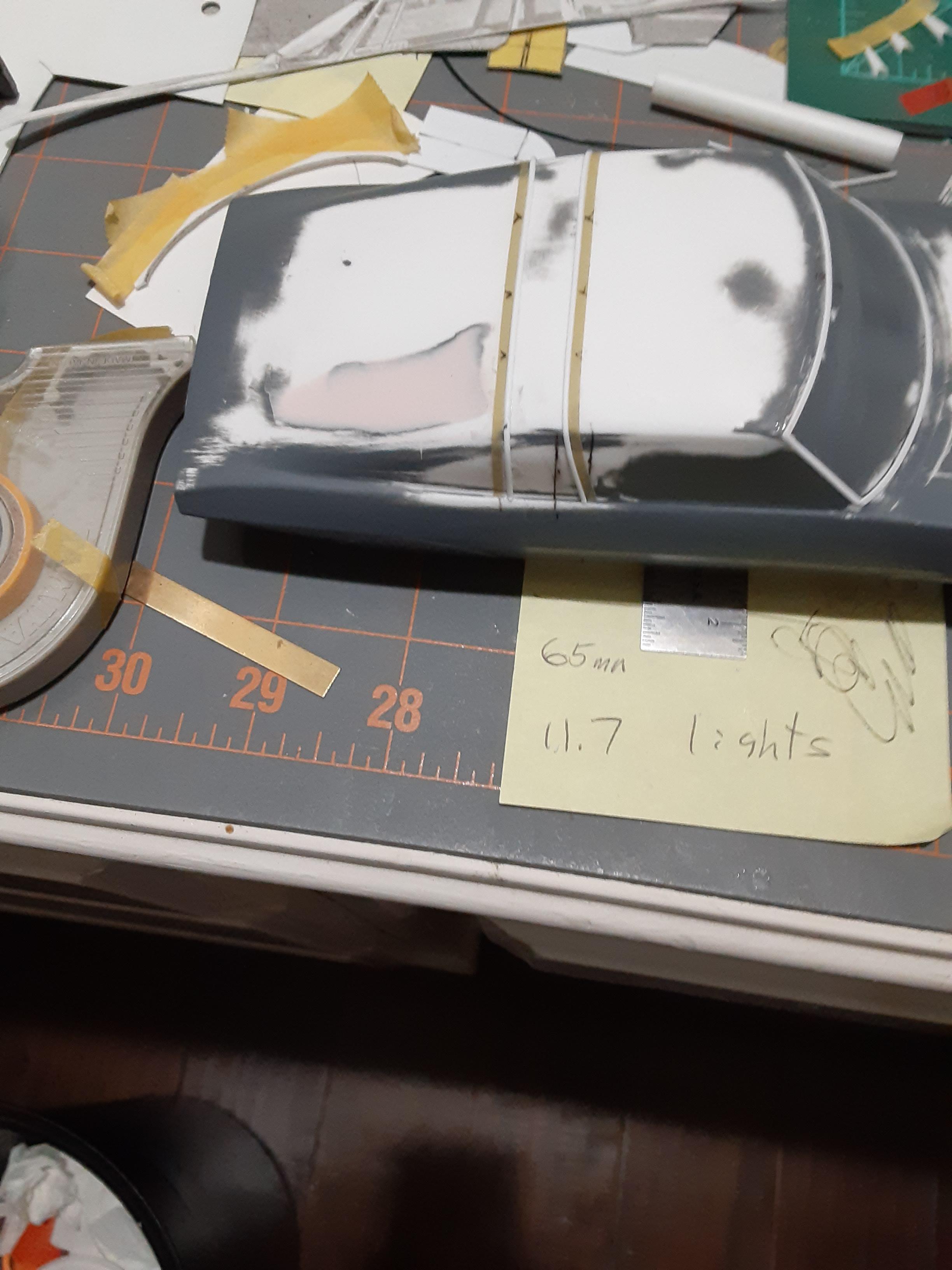

Len Woodruff Posted May 1, 2021 Author Posted May 1, 2021 Thanks guys for all of the input. The heated plates are nice. What I did with some success is to put the ca on the .040 flat side 1/2 round. Then stick it to the straight roof of the body. After the glue was dry I slowly used a thin wire to add more ca as I bent the rod around the roof to the side then cut it of. Here are some of the results.

Len Woodruff Posted May 2, 2021 Author Posted May 2, 2021 (edited) 1 hour ago, Chariots of Fire said: Len: Can you give us a look at what you are trying to do? That would help. There are several alternatives to trying to bend plastic that do not end in the plastic being in a stressed condition. Charles if you scroll up a couple of posts you can see the picture with the trim. Basically I am putting the trim across the roof and down the sides of the window area. While the rear piece is straight down the front piece has a angle to it. Edited May 2, 2021 by Len Woodruff

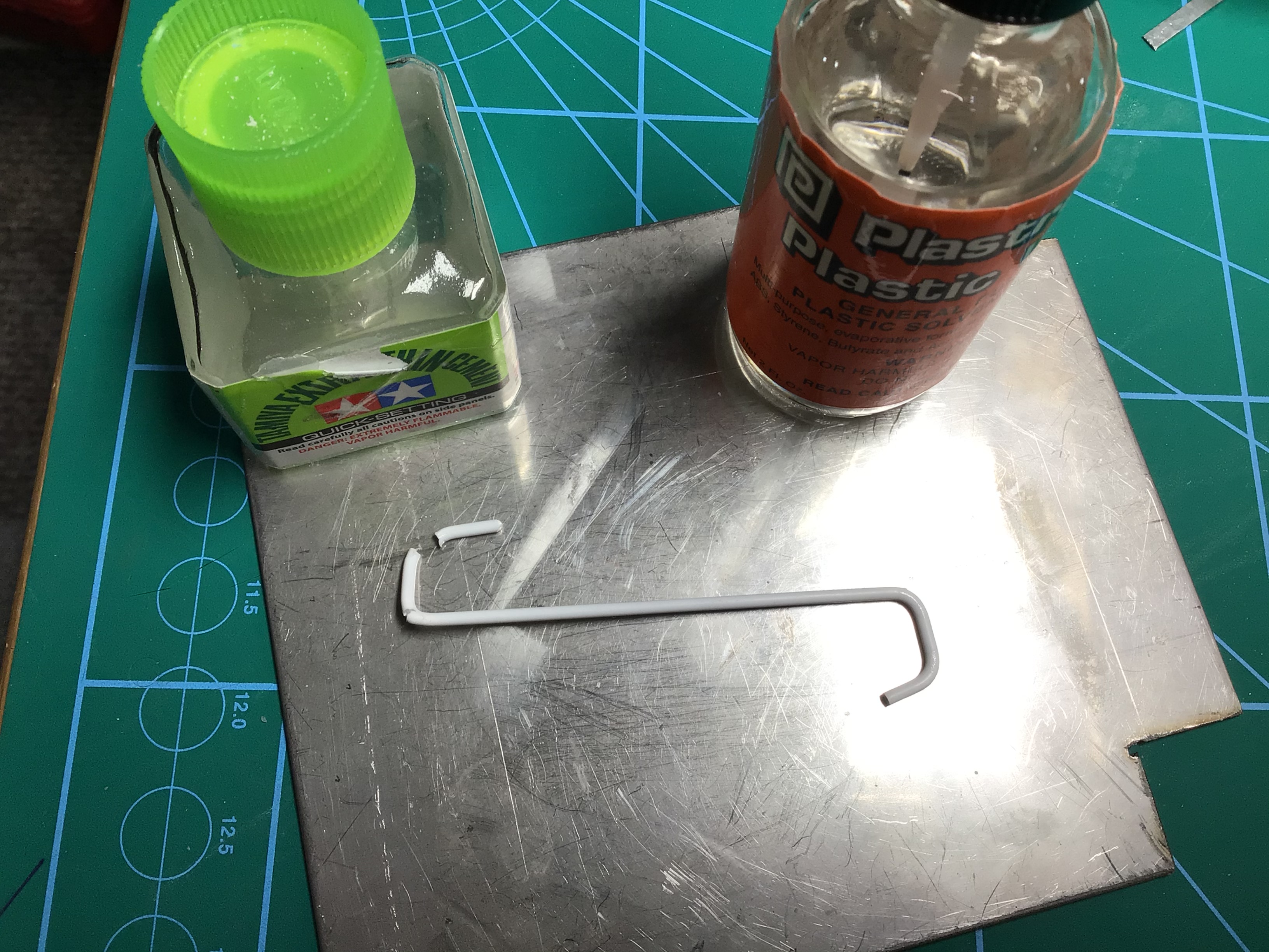

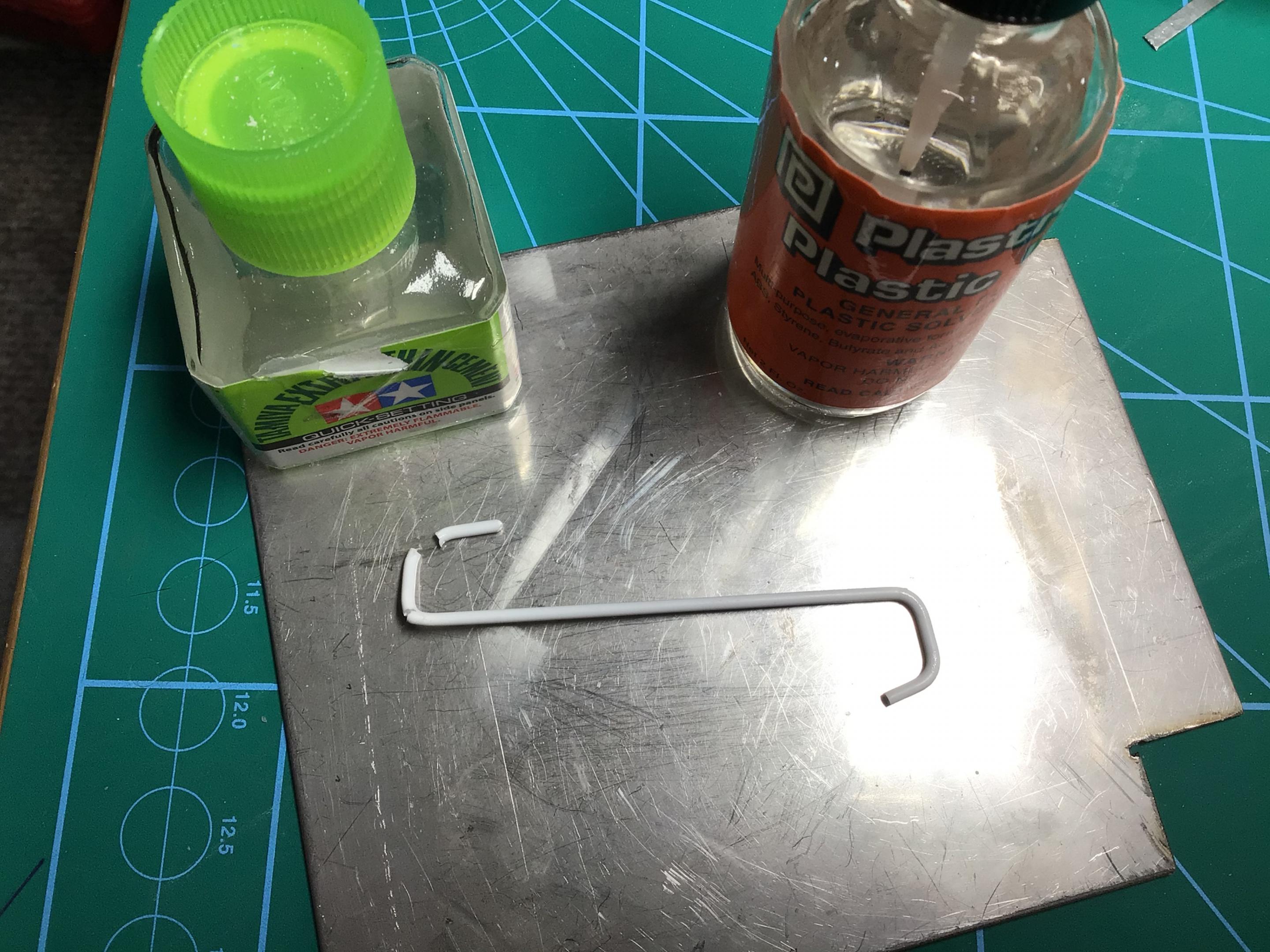

NOBLNG Posted May 2, 2021 Posted May 2, 2021 (edited) On a related note, I just tried another test with 1/16” round. The Tamiya QS cement made the bend snap. The Plastruct did not. I got the Plastruct on my last trip to the hobby shop cause it was on sale. I can see why because it sure doesn’t weld styrene together the way the Tamiya does!? Edited May 2, 2021 by NOBLNG
Len Woodruff Posted May 2, 2021 Author Posted May 2, 2021 1 hour ago, NOBLNG said: On a related note, I just tried another test with 1/16” round. The Tamiya QS cement made the bend snap. The Plastruct did not. I got the Plastruct on my last trip to the hobby shop cause it was on sale. I can see why because it sure doesn’t weld styrene together the way the Tamiya does!? I tried the Plastruct but it didn't really soften the plastic like I thought it would.
