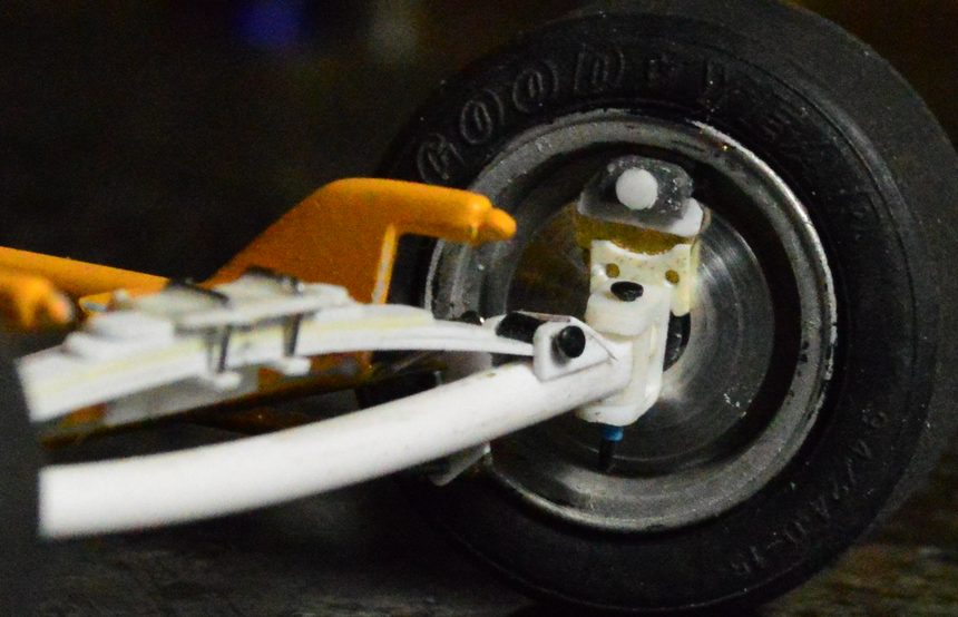

Straightliner59 Posted May 29, 2021 Author Posted May 29, 2021 I've been working on the front brakes (thus fleshing out the rears, theoretically making those easier). After wasting a bunch of time trying to clean up my castings, when all I needed were the calipers, the little light went on! I scratched them, instead. I still have a couple of tiny details to add, but the bodies of them are built, and I think they look pretty decent! Also seen here are the "brackets" added to the spindles to attach the brake assembly. Those will be contoured, when I disassemble the suspension for paint. The main body of the caliper assembly is Plastruct "H" stock, with one side sawed off. The rest of the assembly is various sizes of Evergreen rod and strip. Critiques, questions and comments are, of course, always welcome. Thanks for looking!

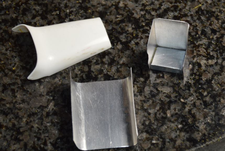

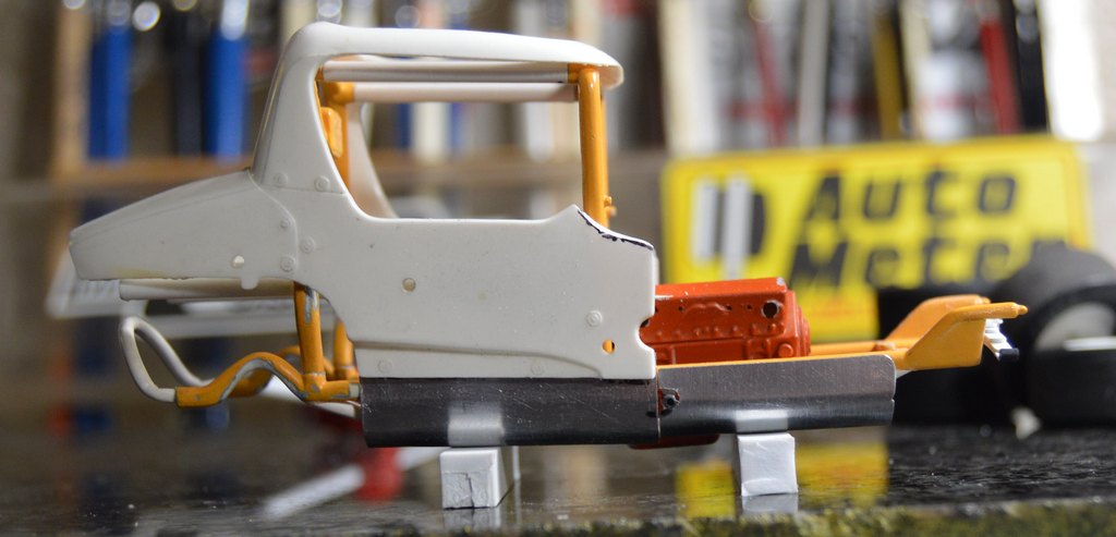

Straightliner59 Posted June 3, 2021 Author Posted June 3, 2021 I've begun sorting out the body. The "fiberglass" shell and aluminum belly pans' mounting should be fairly straightforward. I cut the pans to clear the oil pan. which can be seen, protruding beneath. I need to cut the bottom section of the track roadster nose from Revell's Model A pickup kit, to mate with the upper section. The lower nose section from my Edmunds kit is AWOL, so I'll need to wait until it's on the wheels again, to take measurements for cutting and fitting. I really enjoy working with sheet metal! Comments, questions and critiques are always welcome! Thanks for looking.

Straightliner59 Posted June 5, 2021 Author Posted June 5, 2021 Thanks for your comments, my friend. It looks kind of cool, looking down into the cockpit, with the belly pans, firewall and seat all aluminum sheet. I think it's going to be a bit tricky, fitting the dash panel. because it has to match the hood line, since there's no cowl. I really would like to do the hood from aluminum, as well, but, we'll see how that goes! I like the oil pan, under there, as well.

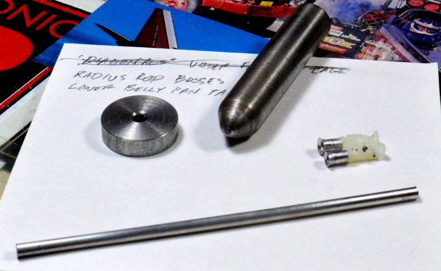

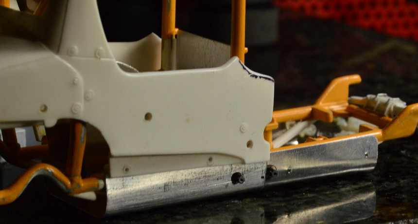

Straightliner59 Posted June 8, 2021 Author Posted June 8, 2021 Feels like I got lot done, yesterday morning, and overnight. I drilled a pair of rods to build the rear hairpins. I made a die to make the intake stacks for the carbs, along with a couple of test pieces. I added two new chassis tubes, to mount the bosses for the rear radius rods, and got those mounted, and drilled holes in the belly pan, to clear them. The lower body is drilled, along with the upper part of the rear pan, so that they can be pinned together. Next, I will fabricate and mount the tabs for the lower side of the rear belly pan, to match those already in place, for the front pan. Once those tabs are in place, I can begin cleaning up the chassis, to prepare it for paint. Since the body, itself is fiberglass, I will probably pick something from the Zolatone chart to duplicate for the inside surfaces of that. I also began covering the fuel tank with tooling aluminum. I have a technique I want to use on the weld seams. Anyway. questions, comments and critiques are always welcome! Thanks for looking!

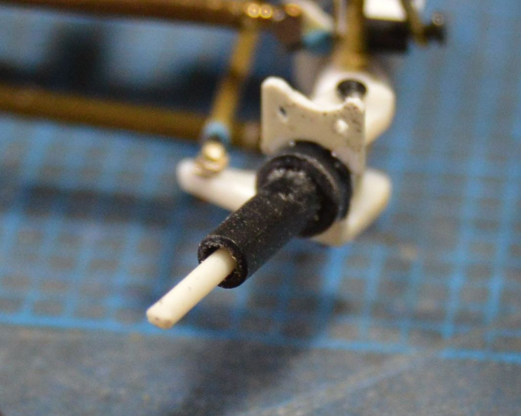

Straightliner59 Posted June 12, 2021 Author Posted June 12, 2021 On 6/8/2021 at 8:54 AM, AmericanMuscleFan said: Very clever idea for the carburetor stacks Daniel, you have never stopped to impress me my friend! I LOVE the aluminum work on the belly pan by the way. ? As always, I appreciate your comments, my friend! I have been making those flaring tools for over twenty years. They work nicely, but they almost have to be custom made to suit the specific application. Thankfully, I have a lathe, for that! I now have installed the mounting tabs, and have the pans and body pinned together. The body will be removable,while leaving the belly pans in place, for display. I have ordered tire lettering from Joseph, at Fireball (His stuff is absolutely the best!). As soon as those decals arrive, I will begin working on the tires and wheels. I am about to upholster the seat bucket using a new technique I want to try--and a new material. As always, questions, comments and critiques are welcome! Thank you, folks, for kindly dropping in! ?
