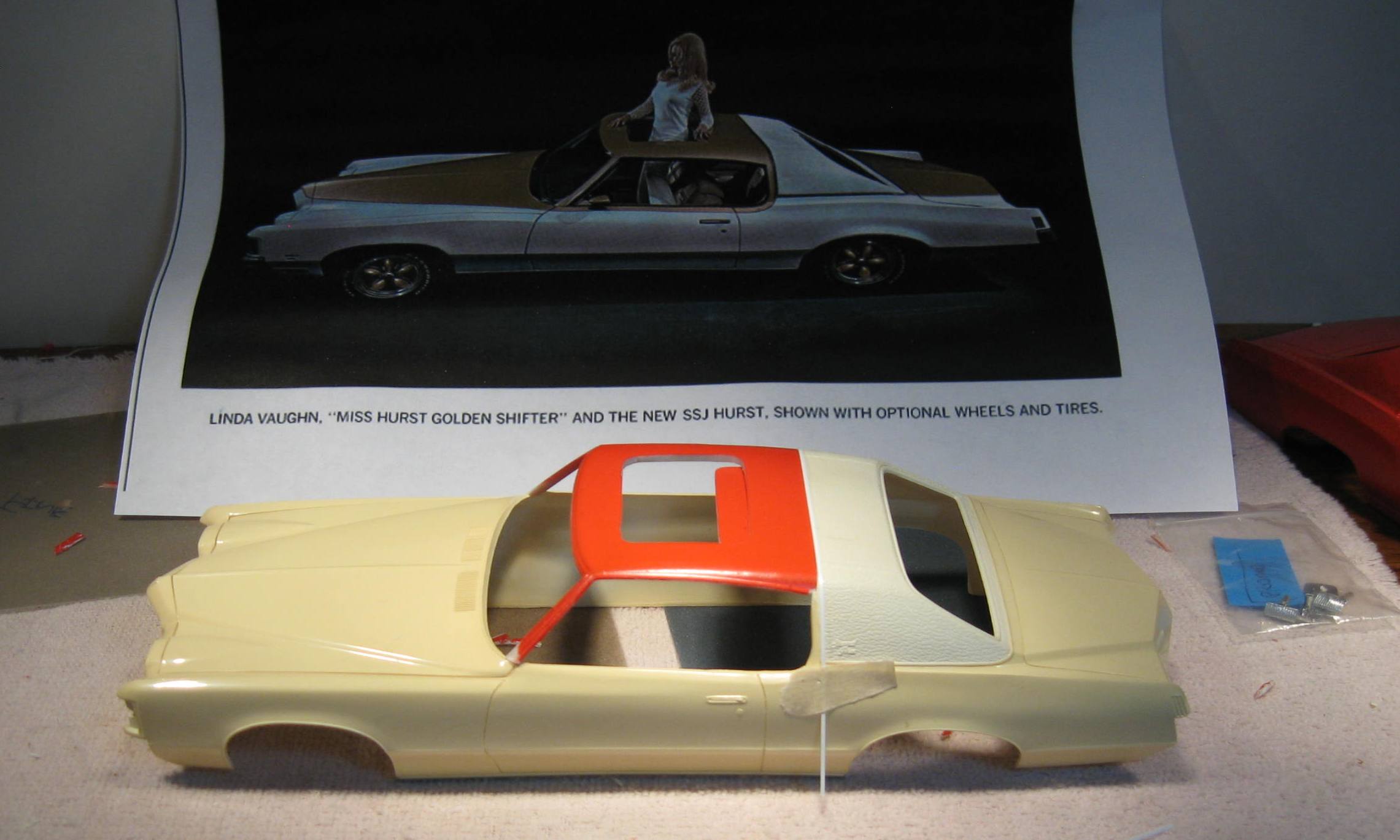

Monty Posted May 4, 2021 Posted May 4, 2021 (edited) I'm betting the kit drip moldings will be OK to leave as-is. The pieces at the base of the C-pillar look flatter, which is what I'm trying to replicate, but I want to make sure I get the closest size possible. I'd appreciate specific mfr P/Ns for any recommendation. Also, what's the best way to make those pieces join together at the trunk-end of the C-pillar? Edited May 4, 2021 by Monty

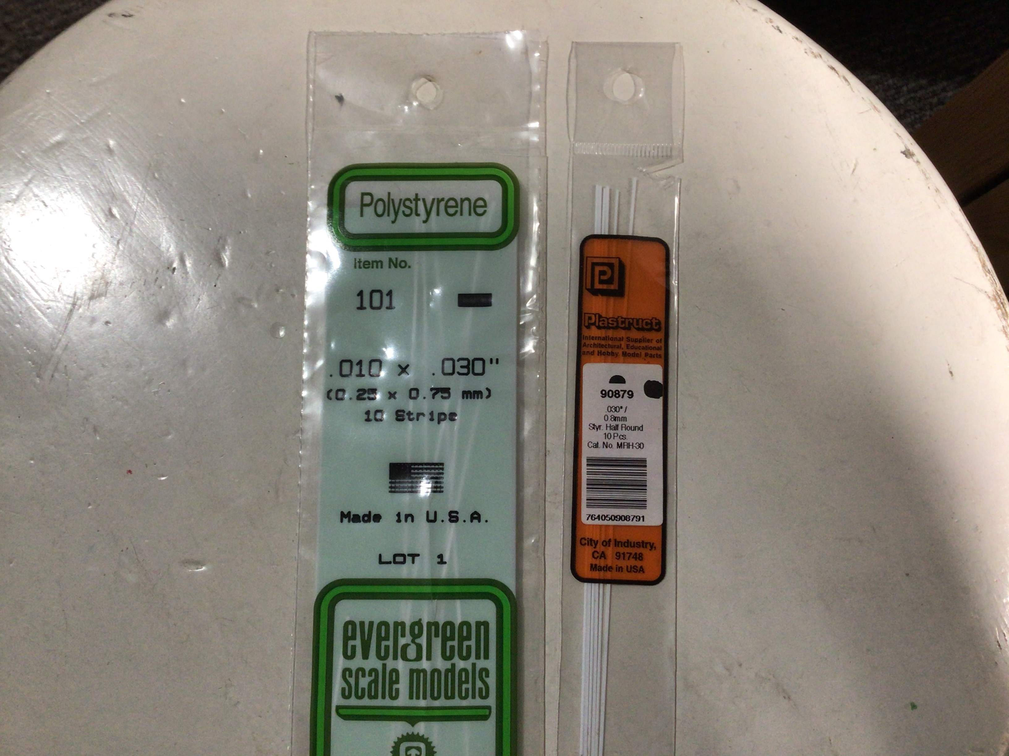

bisc63 Posted May 4, 2021 Posted May 4, 2021 I've had good luck with Evergreen brand H-O scale 2x4s: #8204 - .022" X .043" / .6mm X 1.1mm The little bit of extra thickness gives you something to shape if you don't need flat, sharp edges.

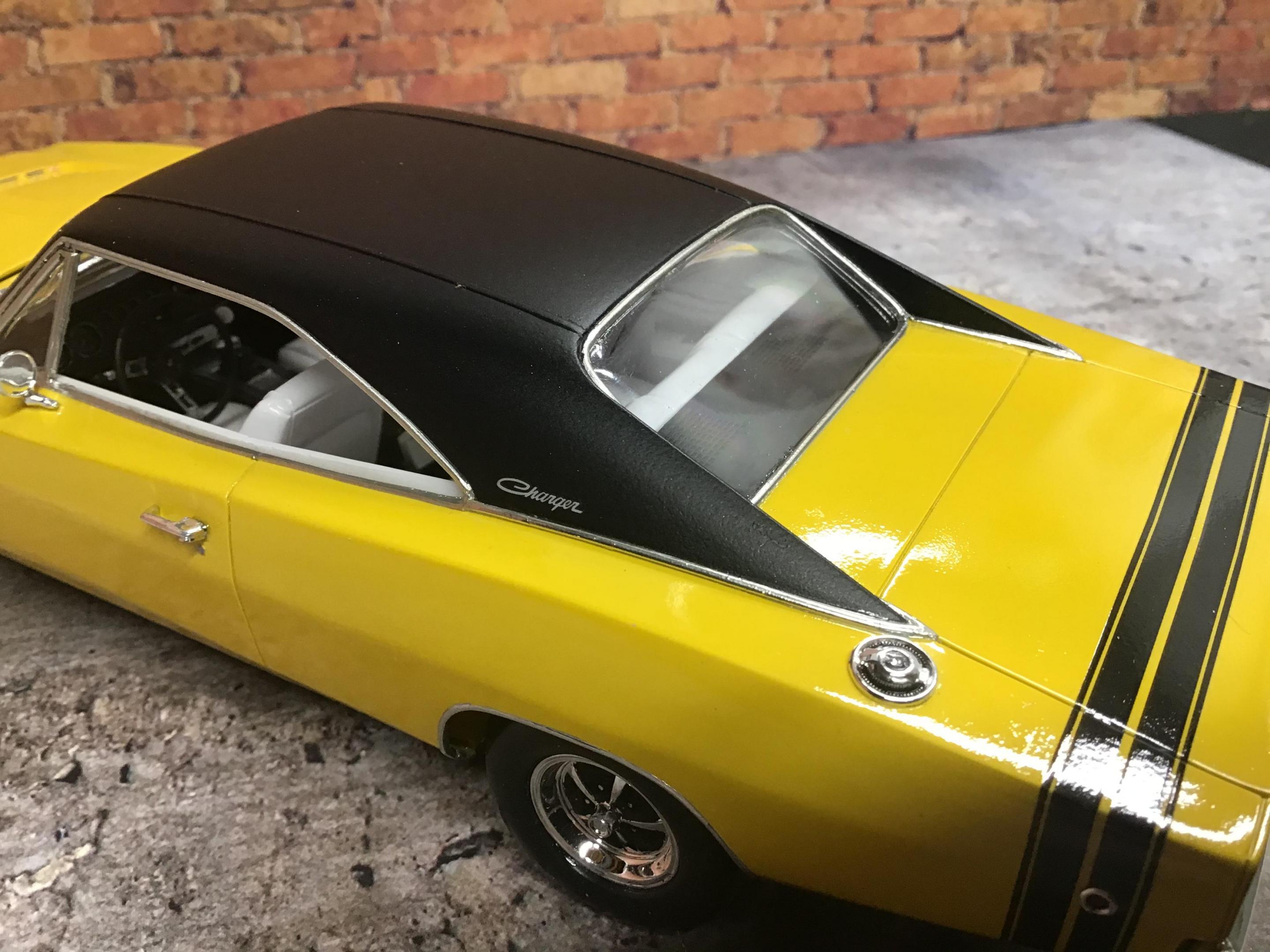

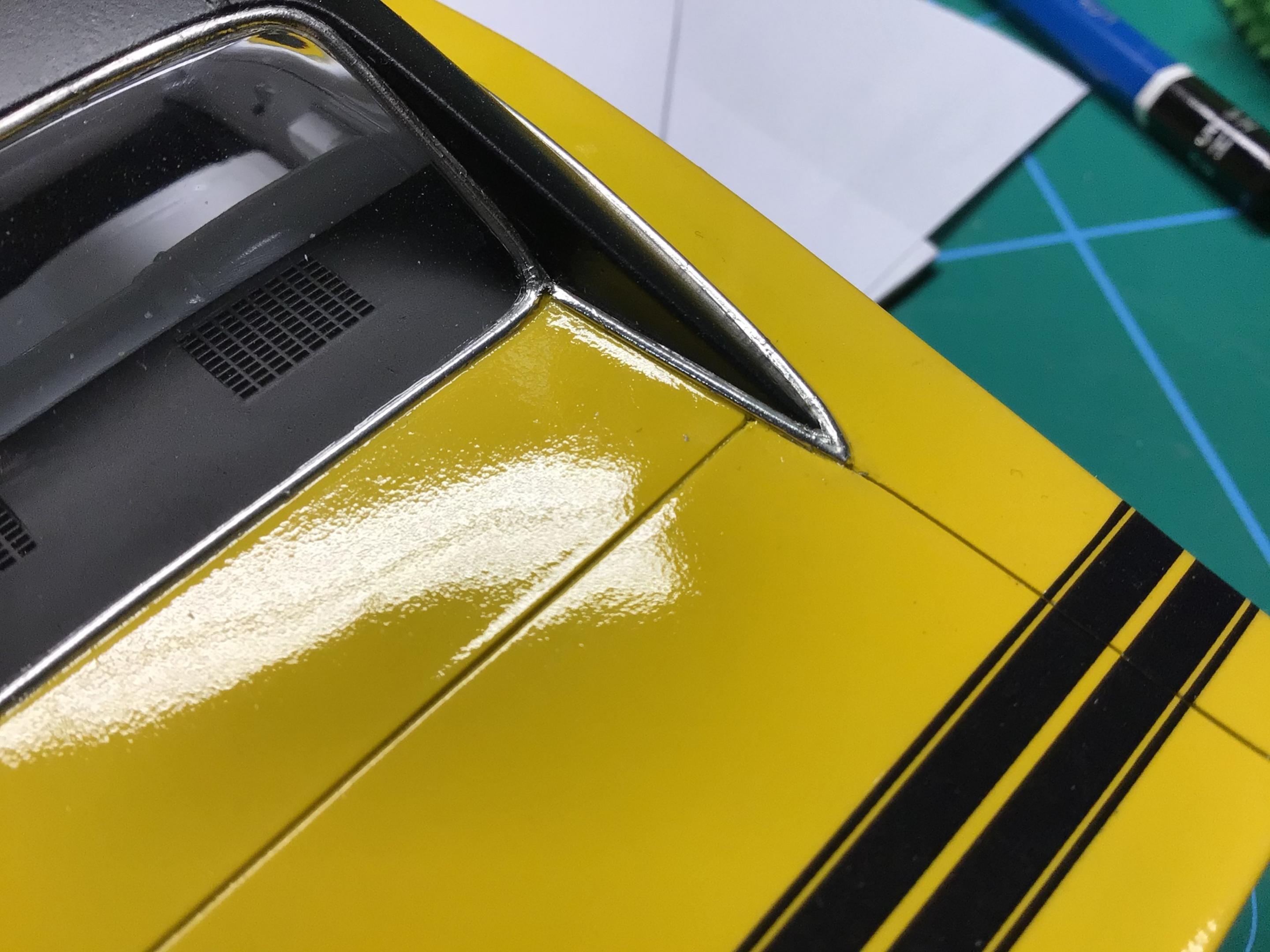

NOBLNG Posted May 4, 2021 Posted May 4, 2021 (edited) 11 hours ago, Monty said: I'm betting the kit drip moldings will be OK to leave as-is. The pieces at the base of the C-pillar look flatter, which is what I'm trying to replicate, but I want to make sure I get the closest size possible. I'd appreciate specific mfr P/Ns for any recommendation. Also, what's the best way to make those pieces join together at the trunk-end of the C-pillar? I think I used .010”x.030” flat strip for the seams on the roof, and .030” half round for the chrome trim. You can sand the half round slightly to make a half oval shape? I cut the first piece I installed just a hair long and glued it in place. Then made the second piece overlap it. Then with a very sharp (new) blade, I trimmed both strips with one cut. Edited May 4, 2021 by NOBLNG
Monty Posted May 4, 2021 Author Posted May 4, 2021 Thanks Greg! That should work perfectly. Your Charger looks stellar, BTW.
bisc63 Posted May 7, 2021 Posted May 7, 2021 Gorgeous work on that Charger, especially the roof! Nice scale realism.
