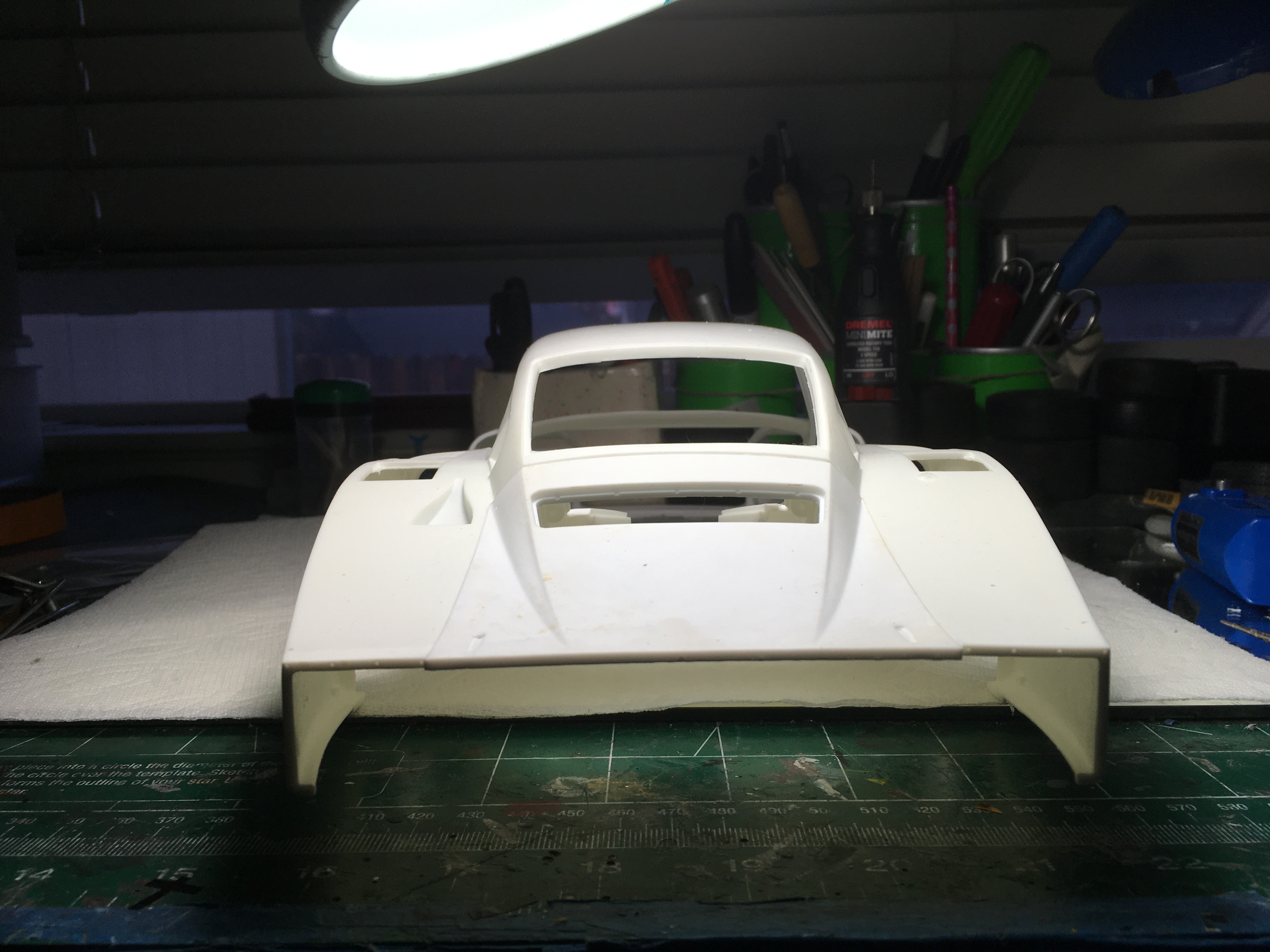

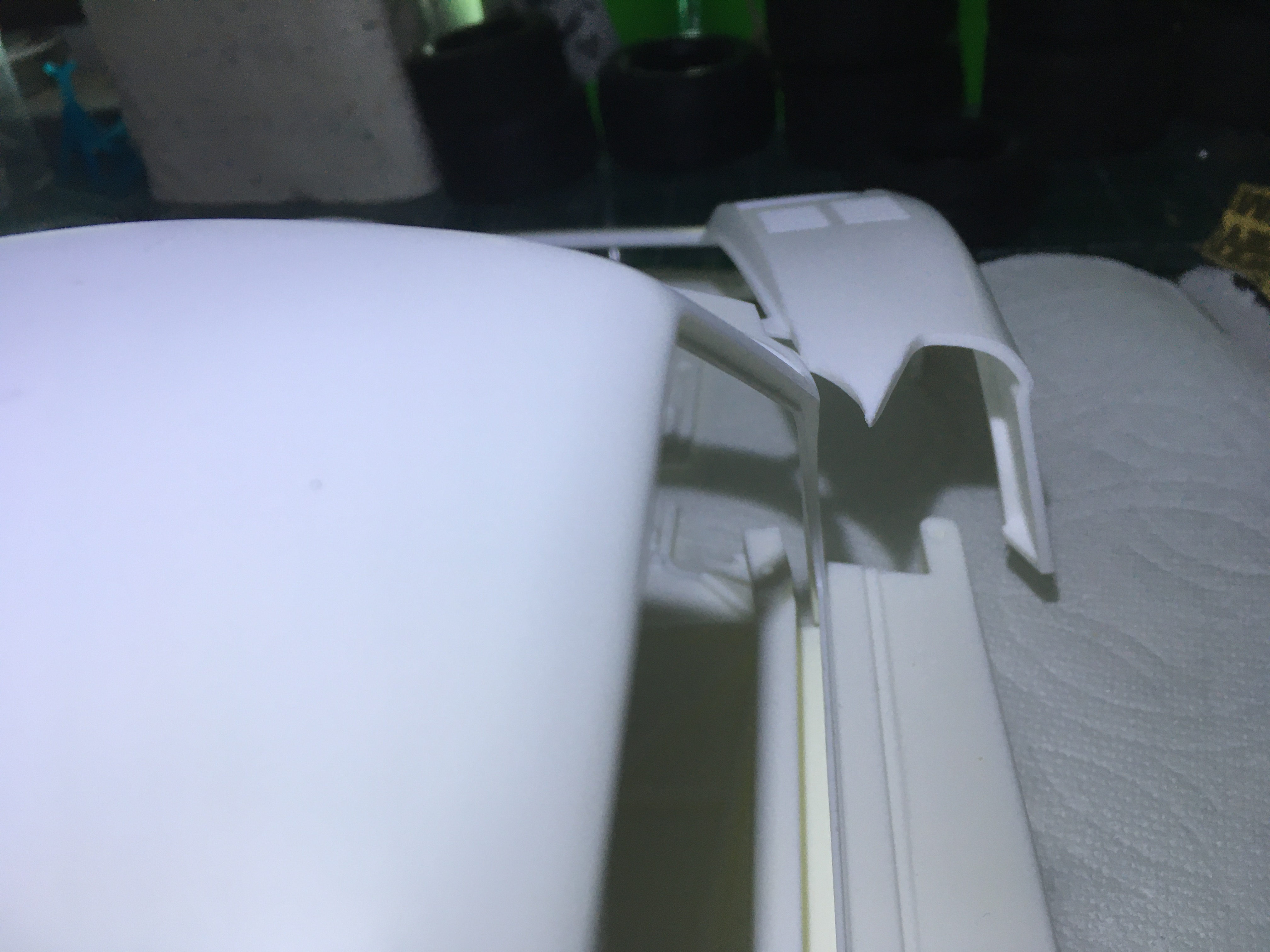

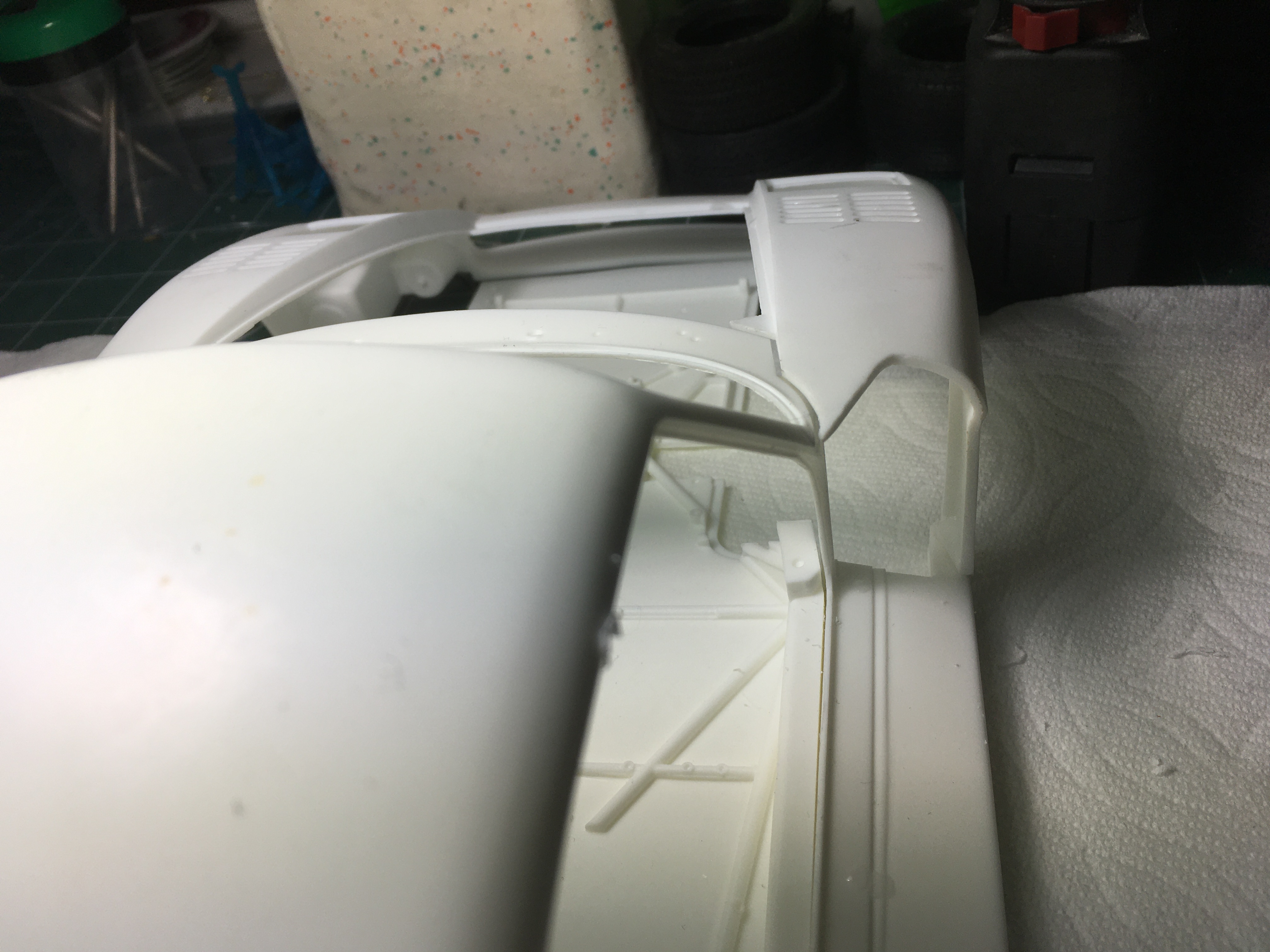

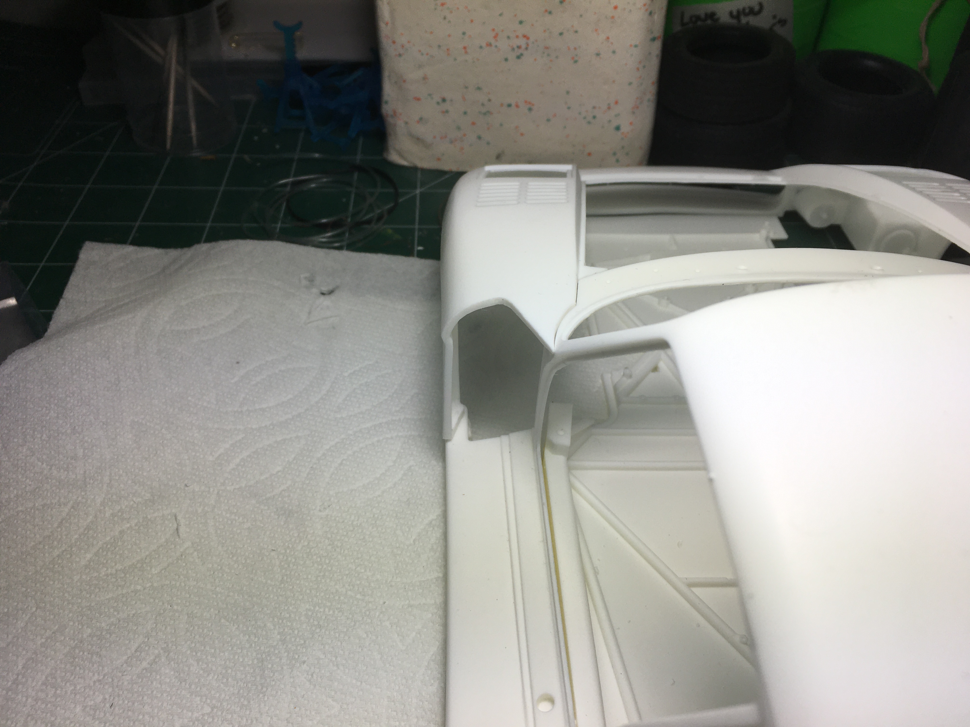

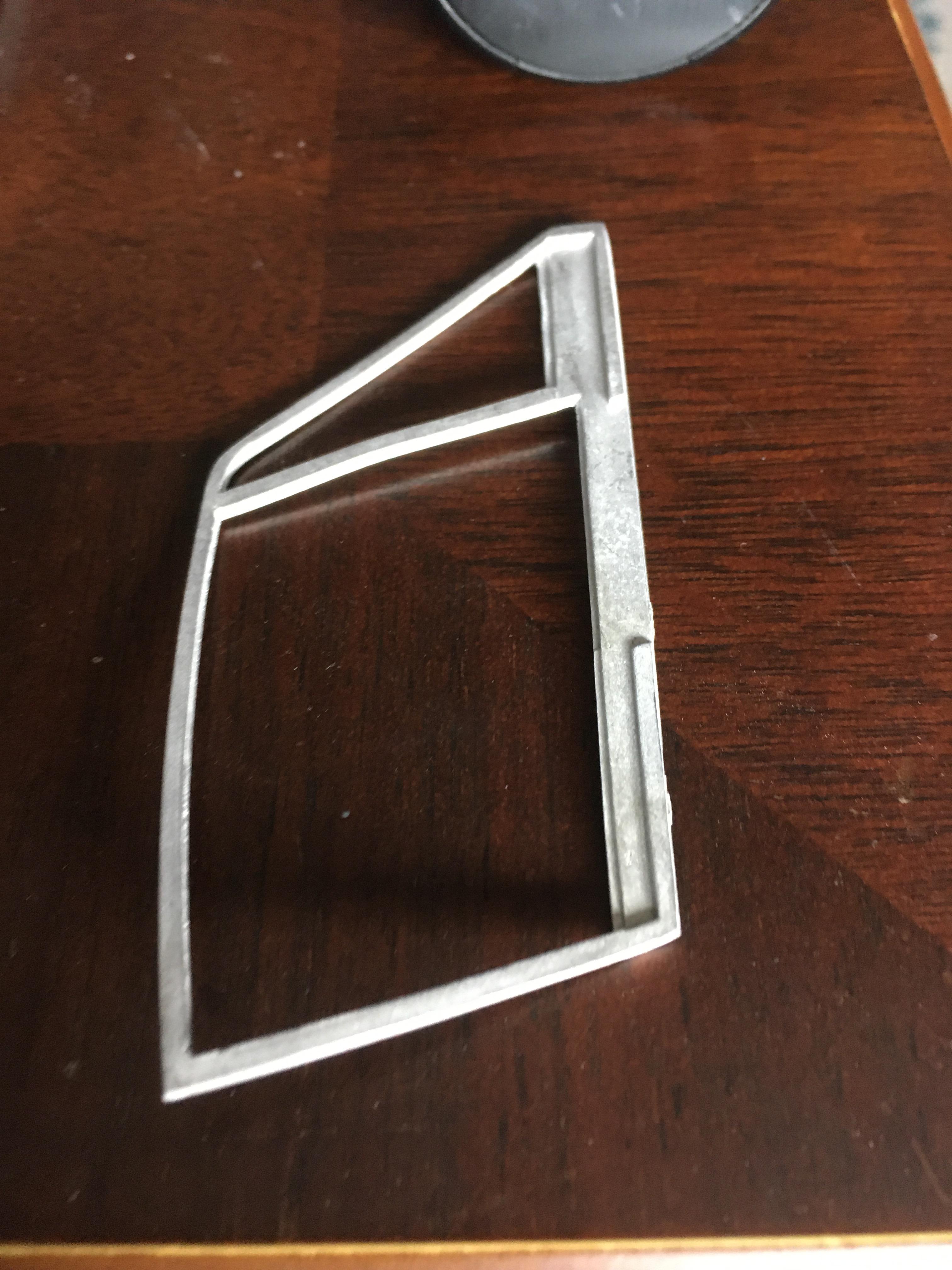

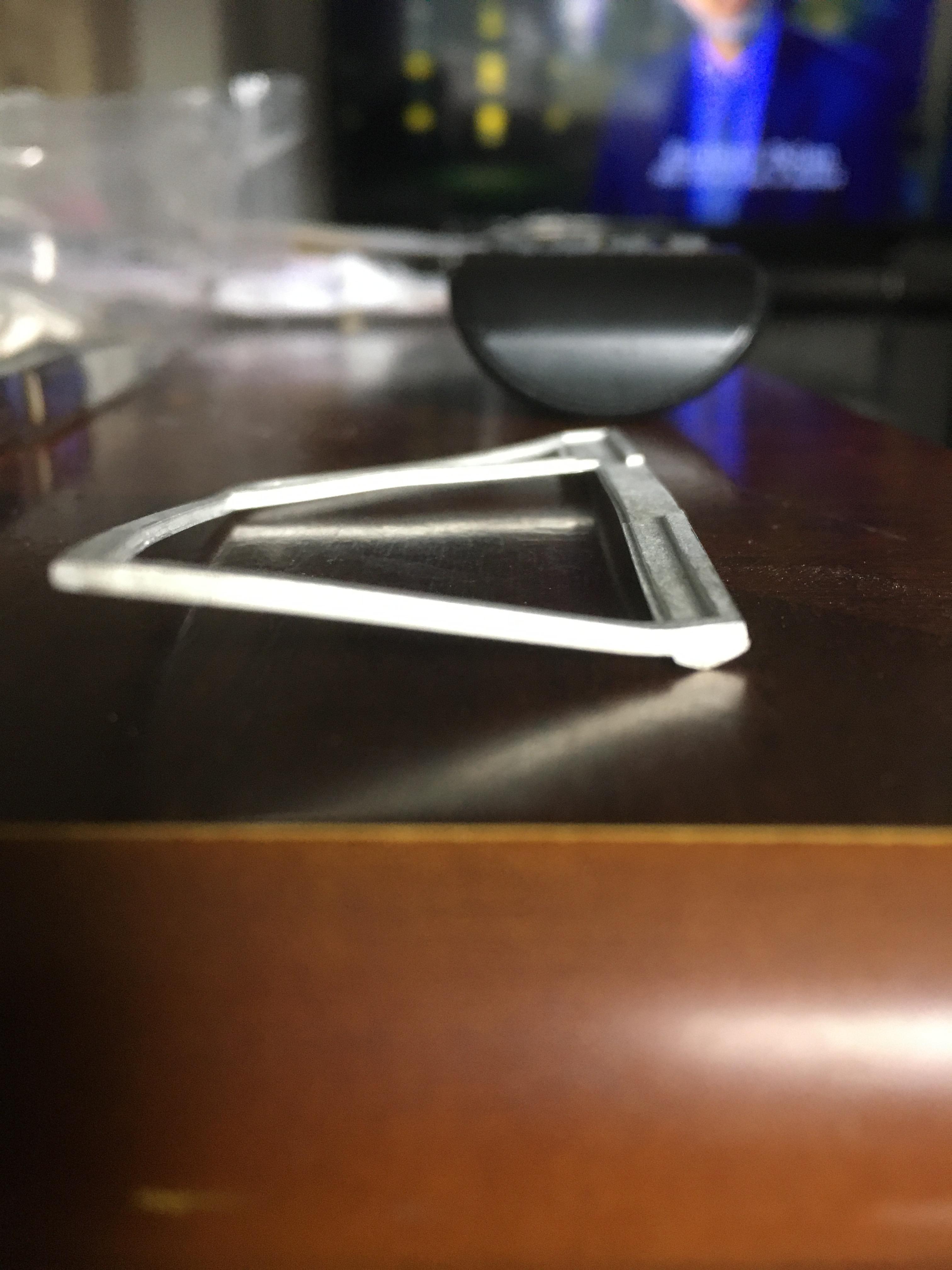

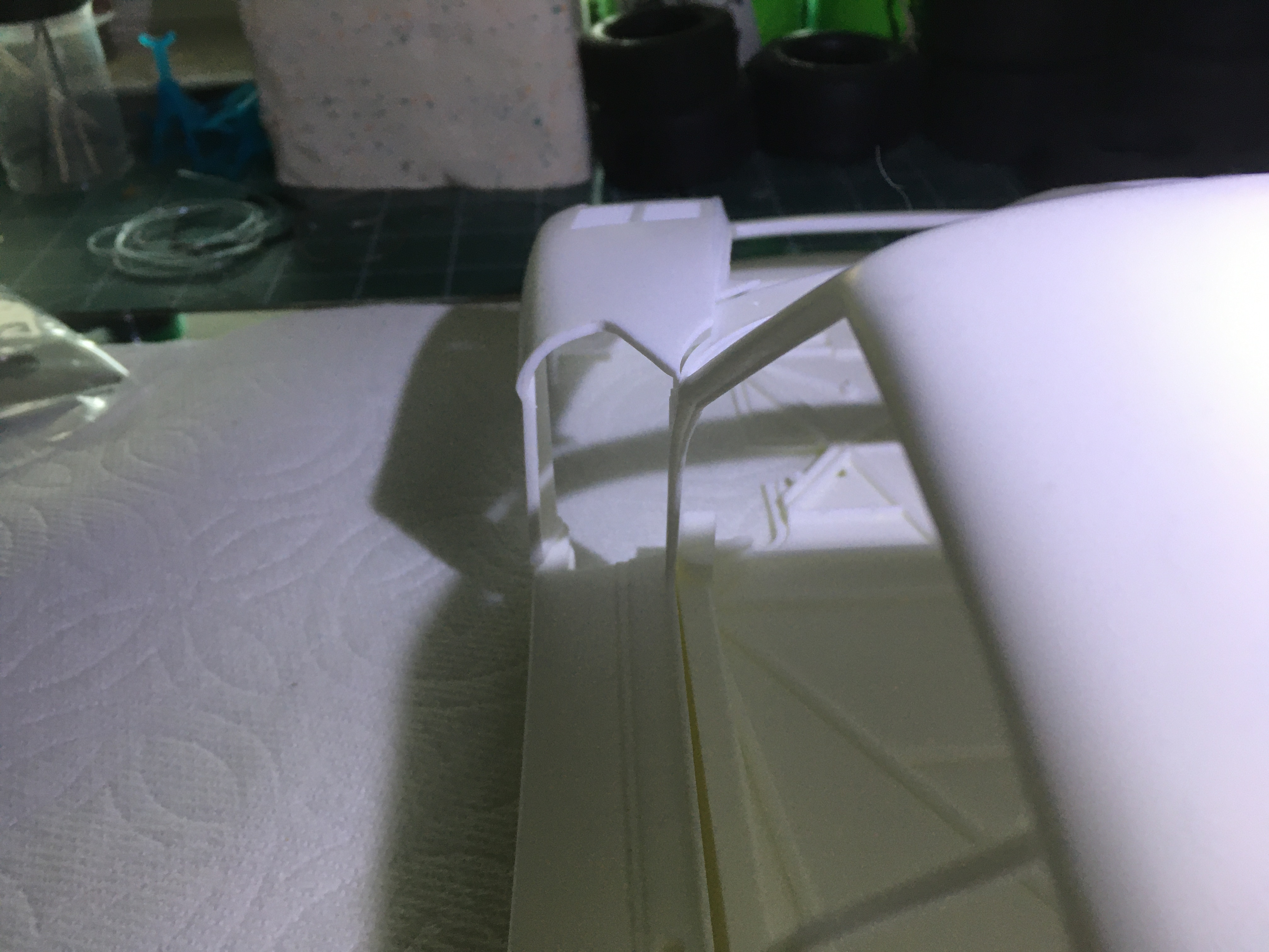

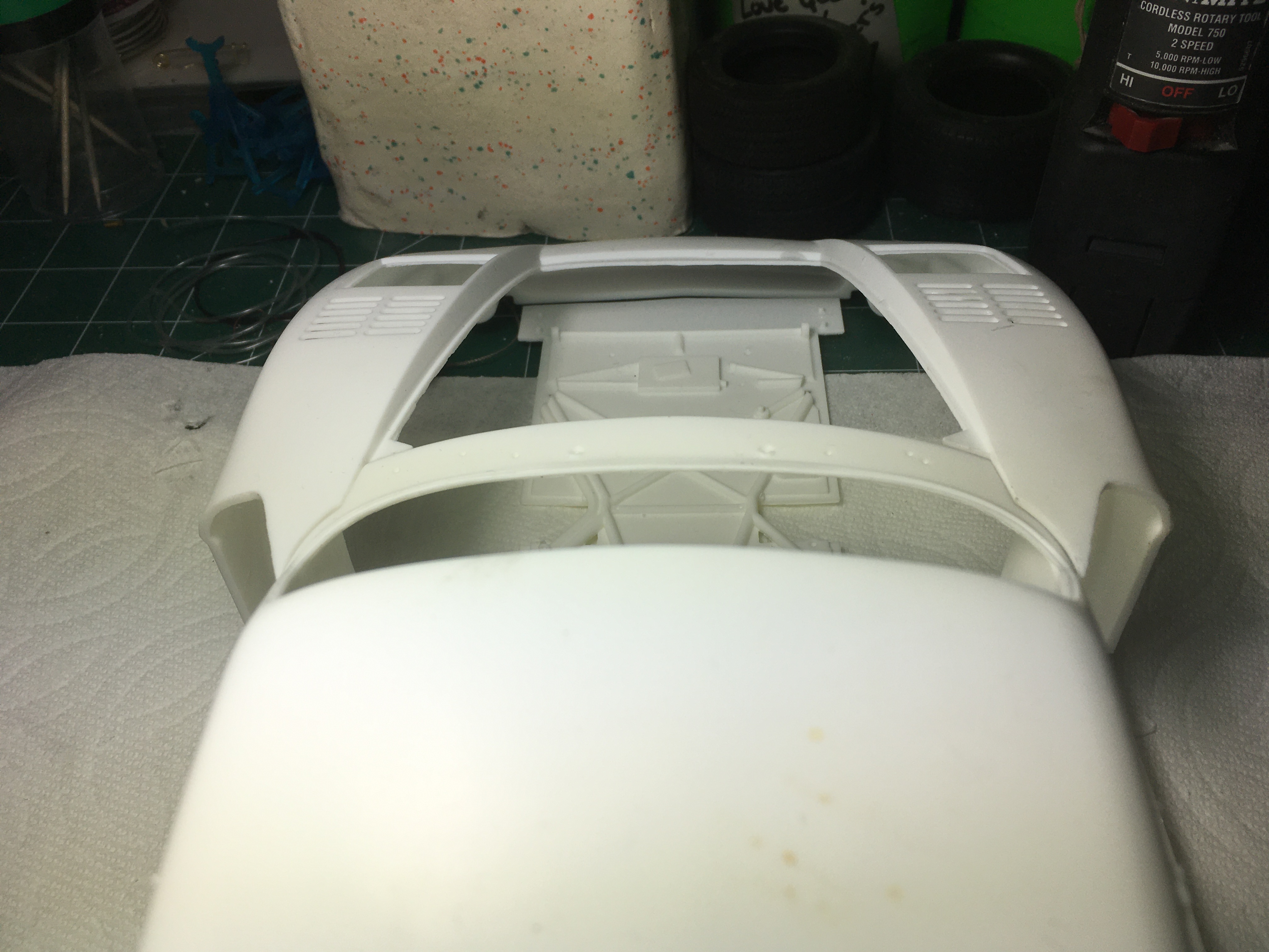

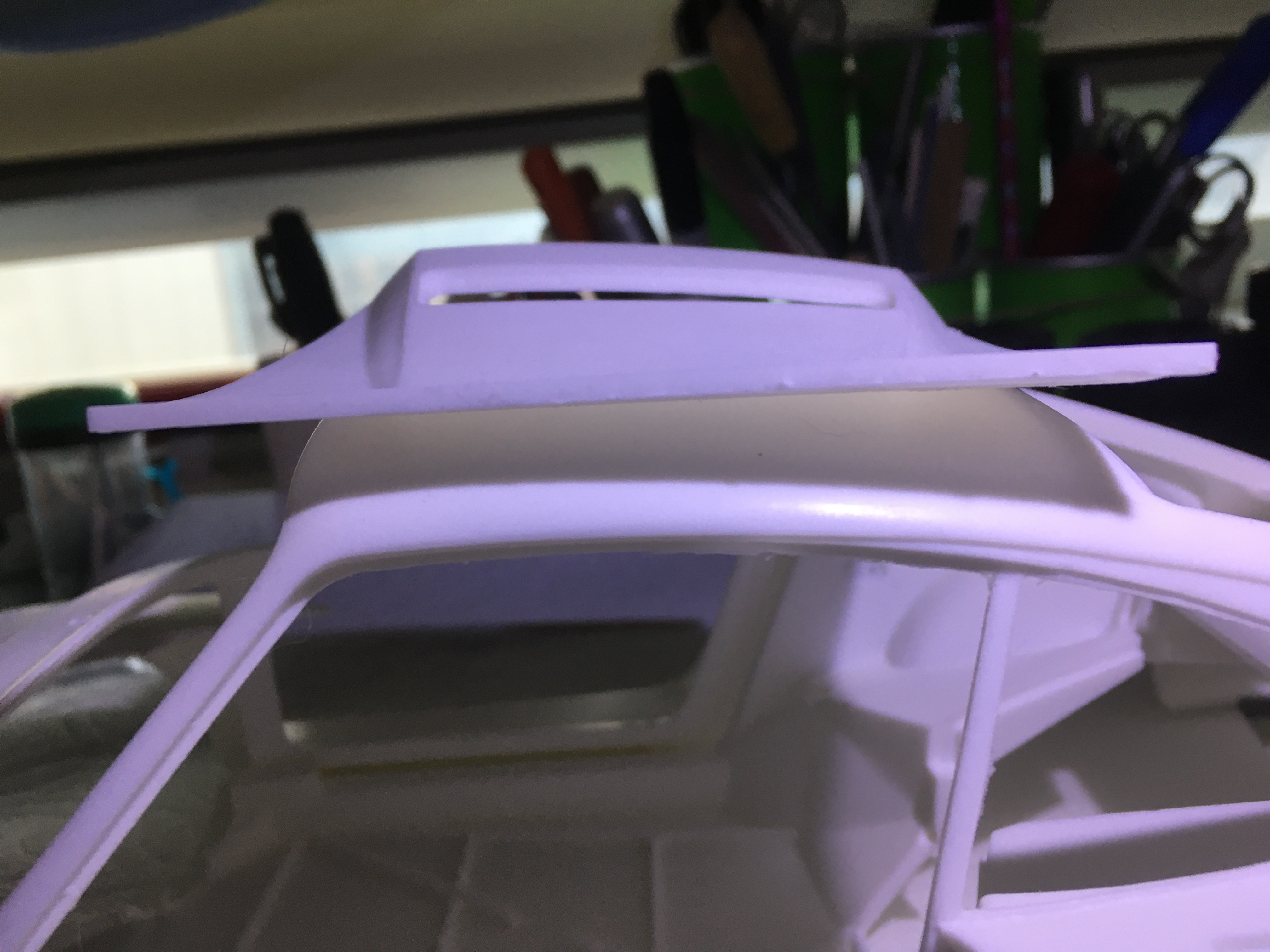

Well , not a great start. The deck lid is really warped and so is the front end. Sorting out the white metal and going to fix these problems before I start to build the engine. I like sports cars but really not interested in Porsche. They were funny and beetle like. Saw the 917/30 race at laguna when I was in high school.  I liked that one but the 911 stuff not so much. I’ll be building this and definitely learning.
This will be very interesting to watch. Shame about the body warpage. That looks tough to fix. It's a pretty significant problem for such an expensive kit.

Thank you guys. Yes Bainford this is troublesome. I wish mfh would package their kits better. Very nervous about the twist  on the body parts.

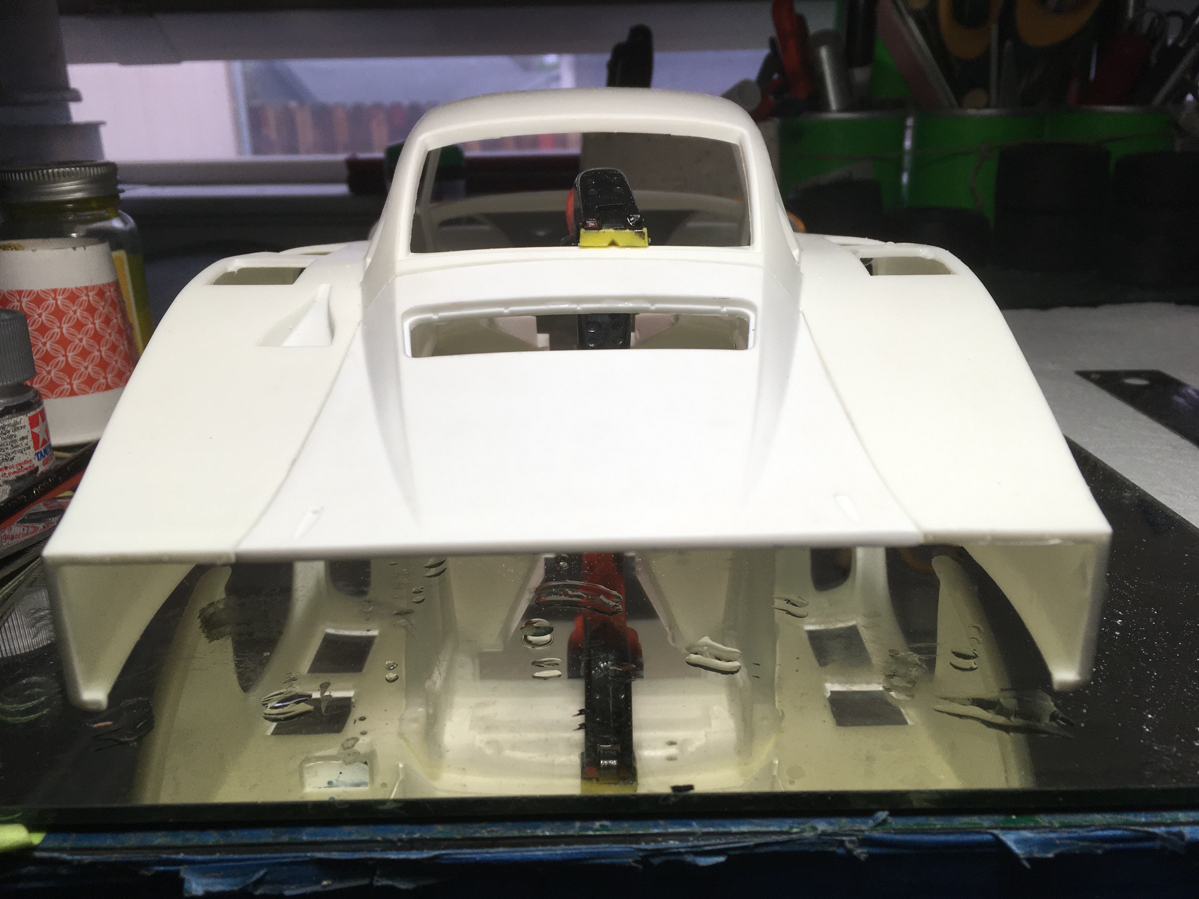

Thank you guys. I compared the bodies of 5 of the same kit and 2 were bad. The others were perfect. But I took a lesson from my friend Mark about resin warp in mfh kits. Did what he said and my body now is fixed, Boiled water and put the parts in for only 30 seconds , took out the part and massaged the part to shape. With gloves on of course. I was a little worried about this. Had a problem with my resin cobra frame. Was a twist . Boiled water and did the same thing. Left the frame in a little longer because it was thick. Well now going to sort out the white metal mess.

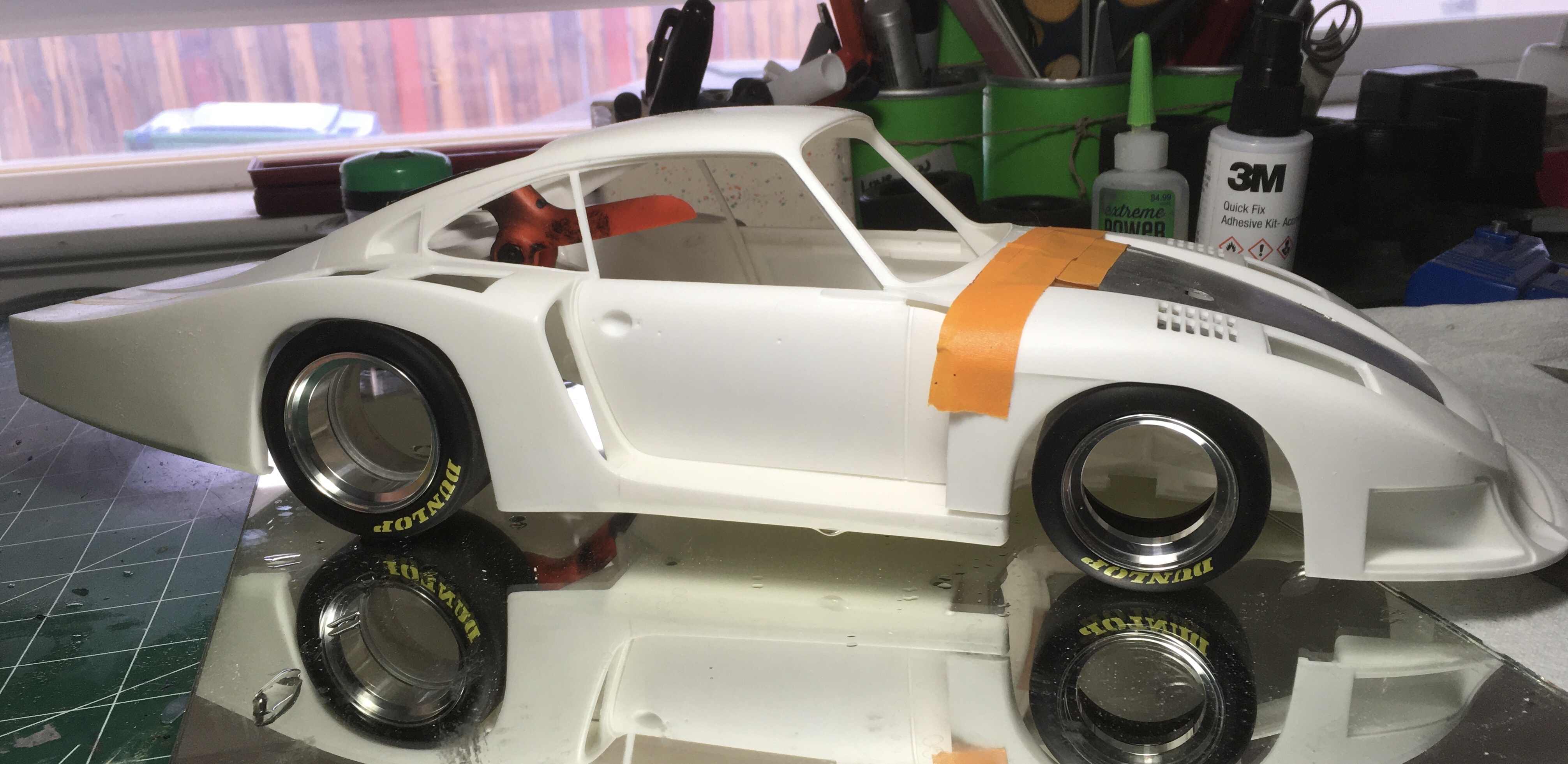

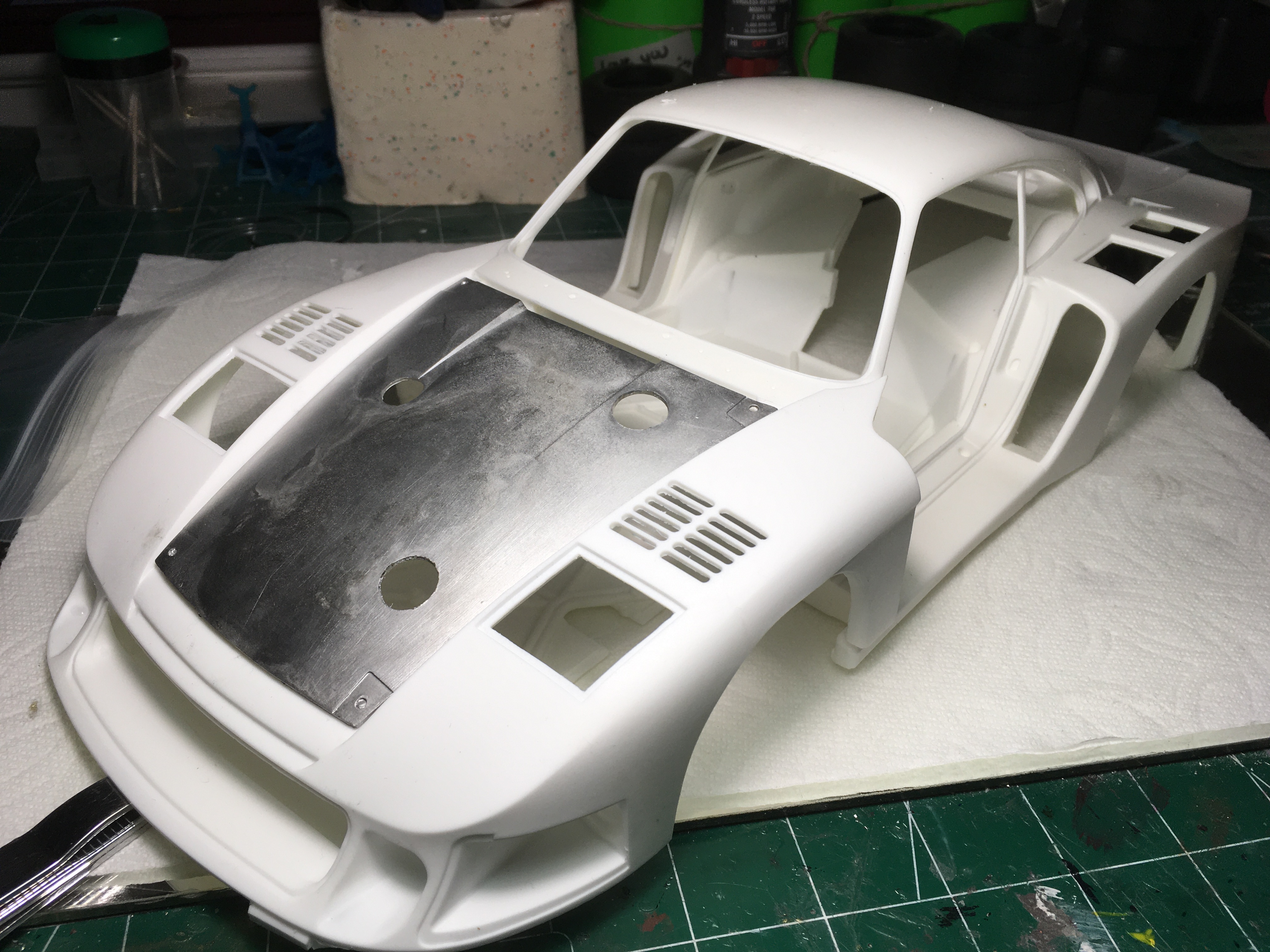

Cleaned up the rims and tires. Alignment of the body panels. The rear of the main body was a little warped so I started to put all the body panels on  to get a overall picture. Put the body on a mirror to see how out of shape things were. A little boiling water on the body here and there and held it into shape. So far looks straight. Starting to get into this. I read this car had 800 hp? 228 at lemans? Not your average beetle. I’m going to paint it gulf blue with orange. This car was never that color. I’m doing a “ what if” . Since there are so many martini cars and the rest of the group are doing the other cars, I thought a “what if car” might be fun. And especially do not have to copy any one particular race car. 07EBB27B-56CC-4322-AD5E-C503633E65FB.thumb.jpeg.8f12dabe1247b31b0240c60f264b634b.jpeg

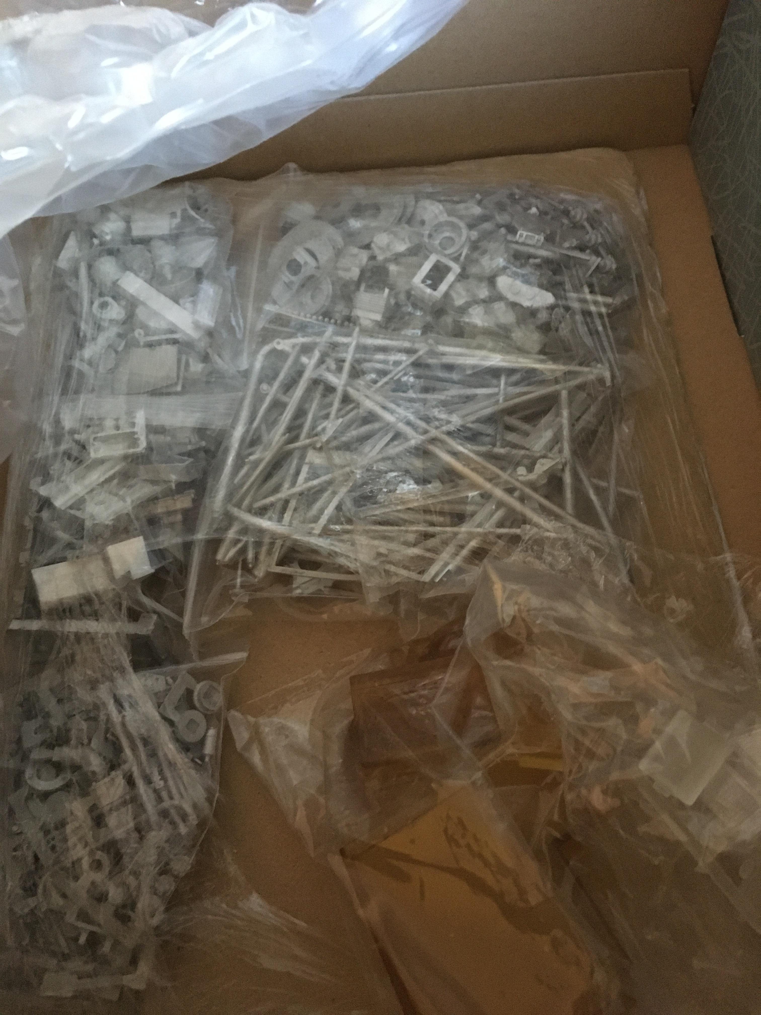

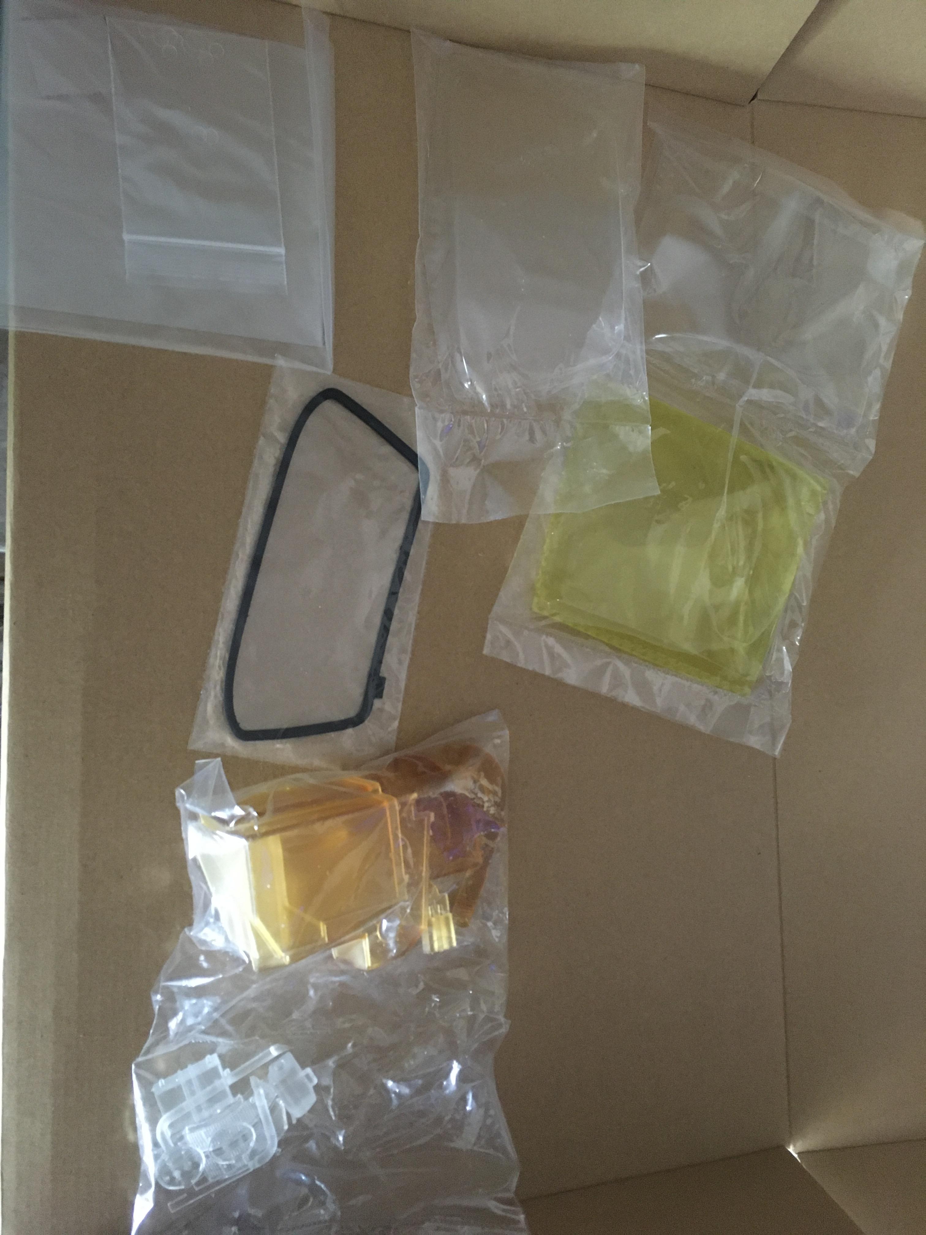

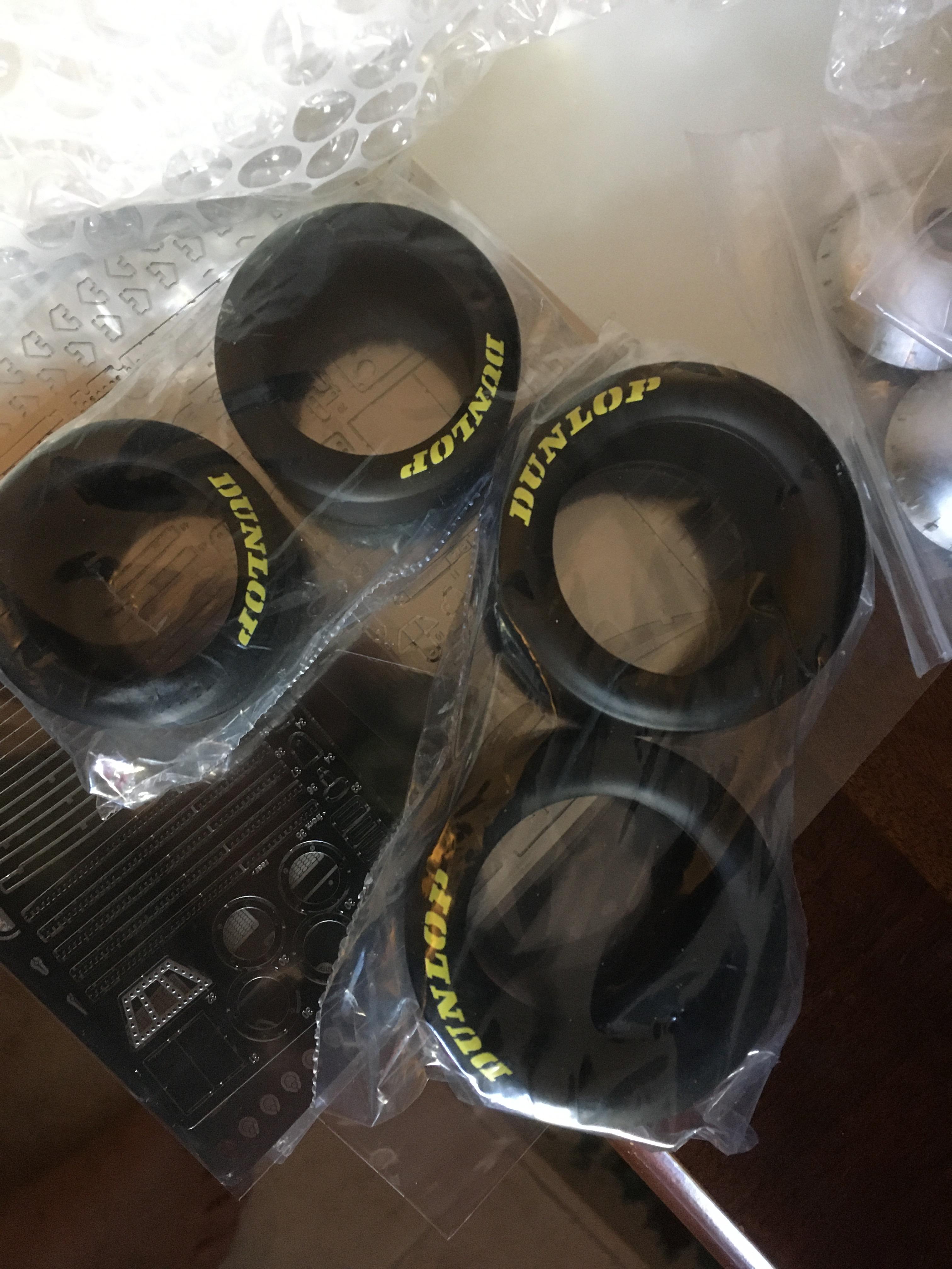

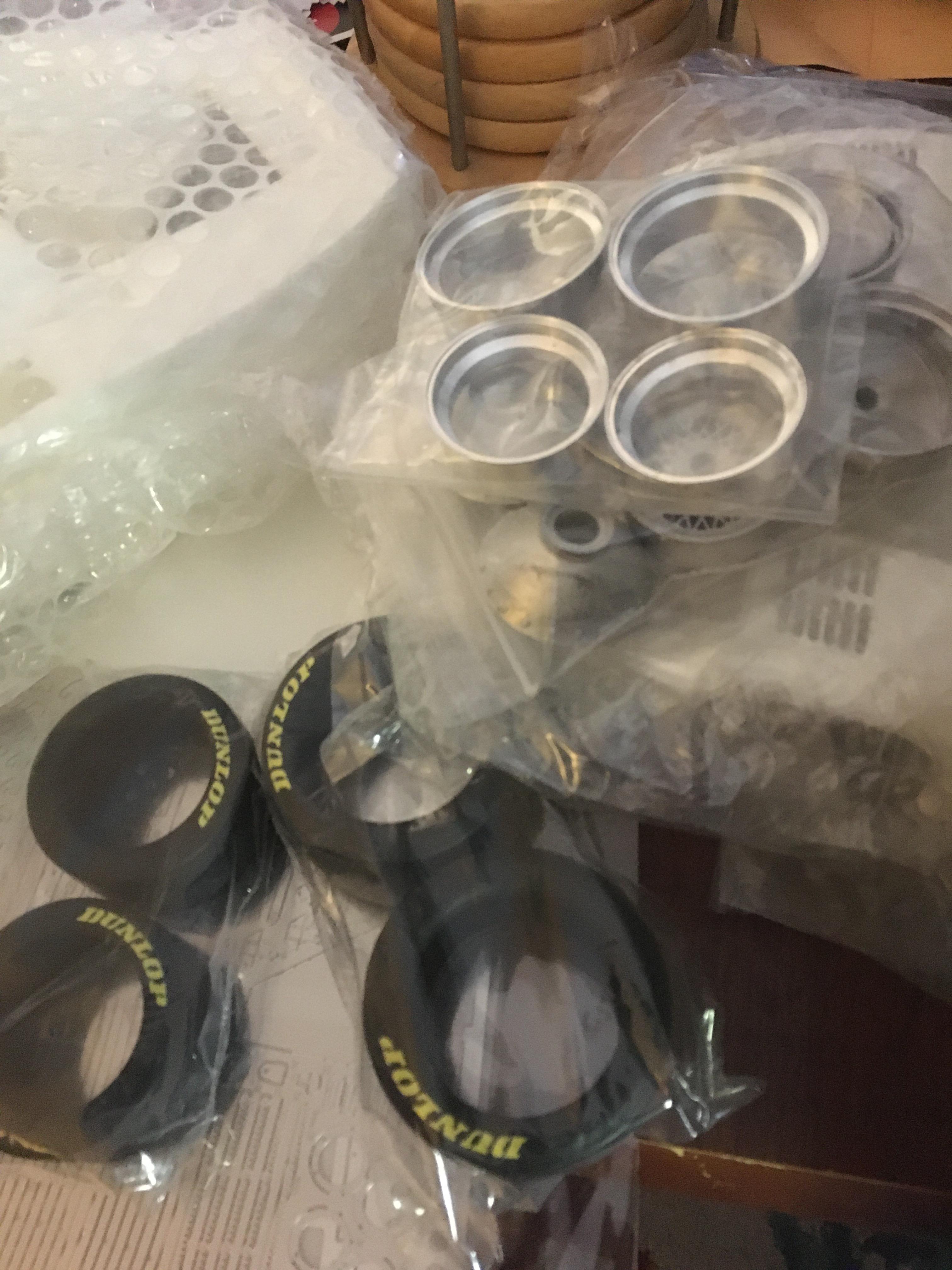

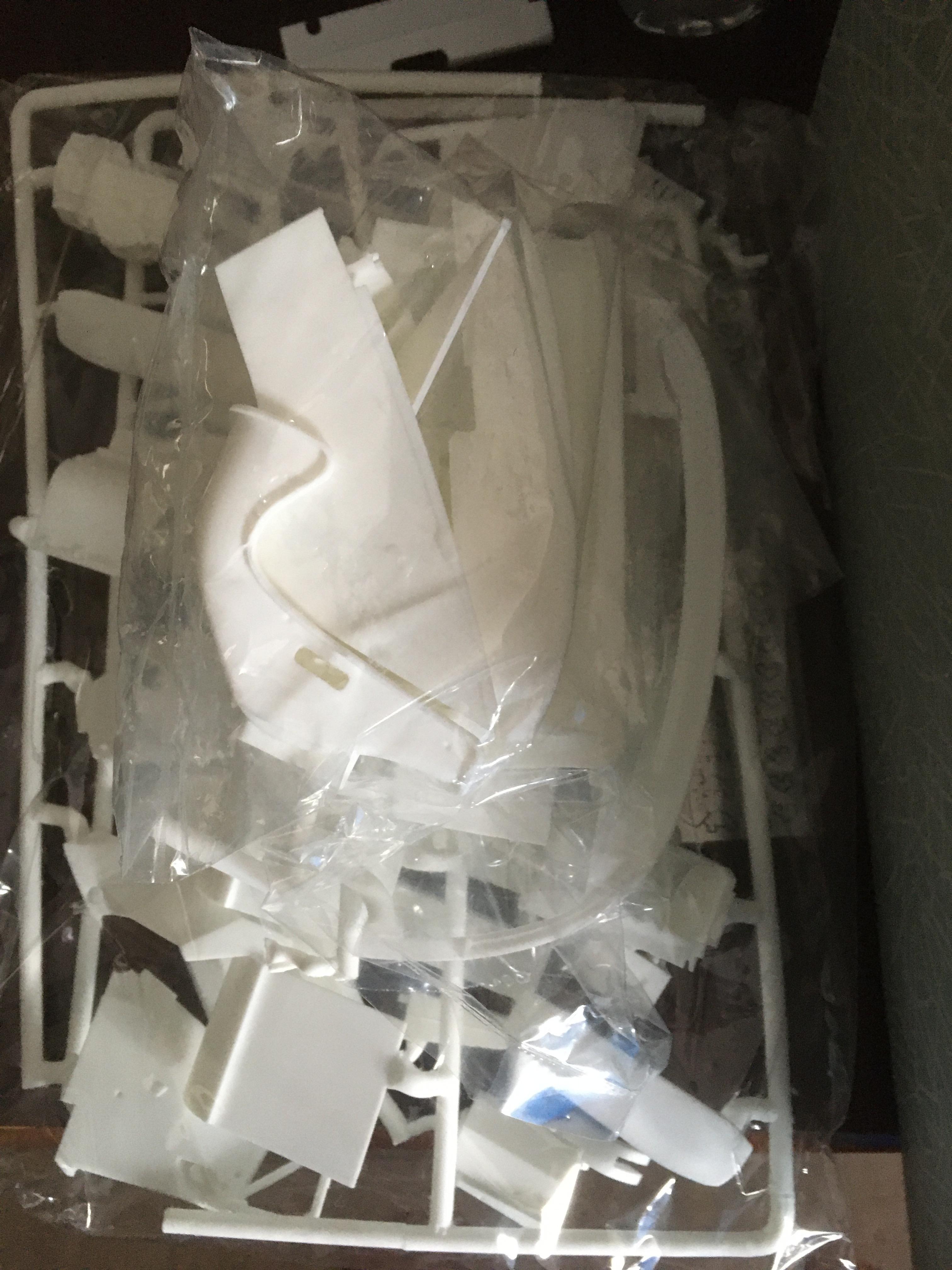

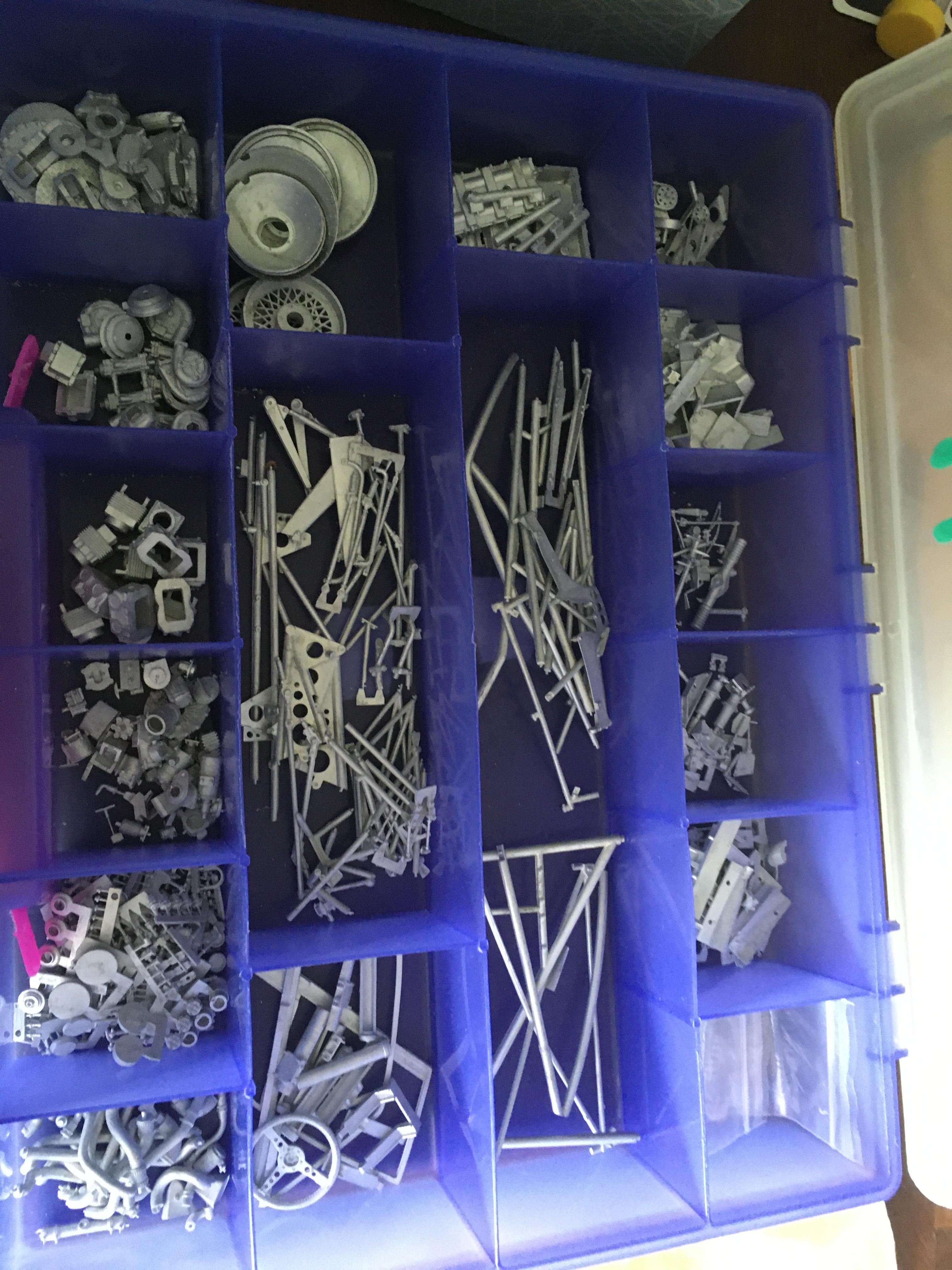

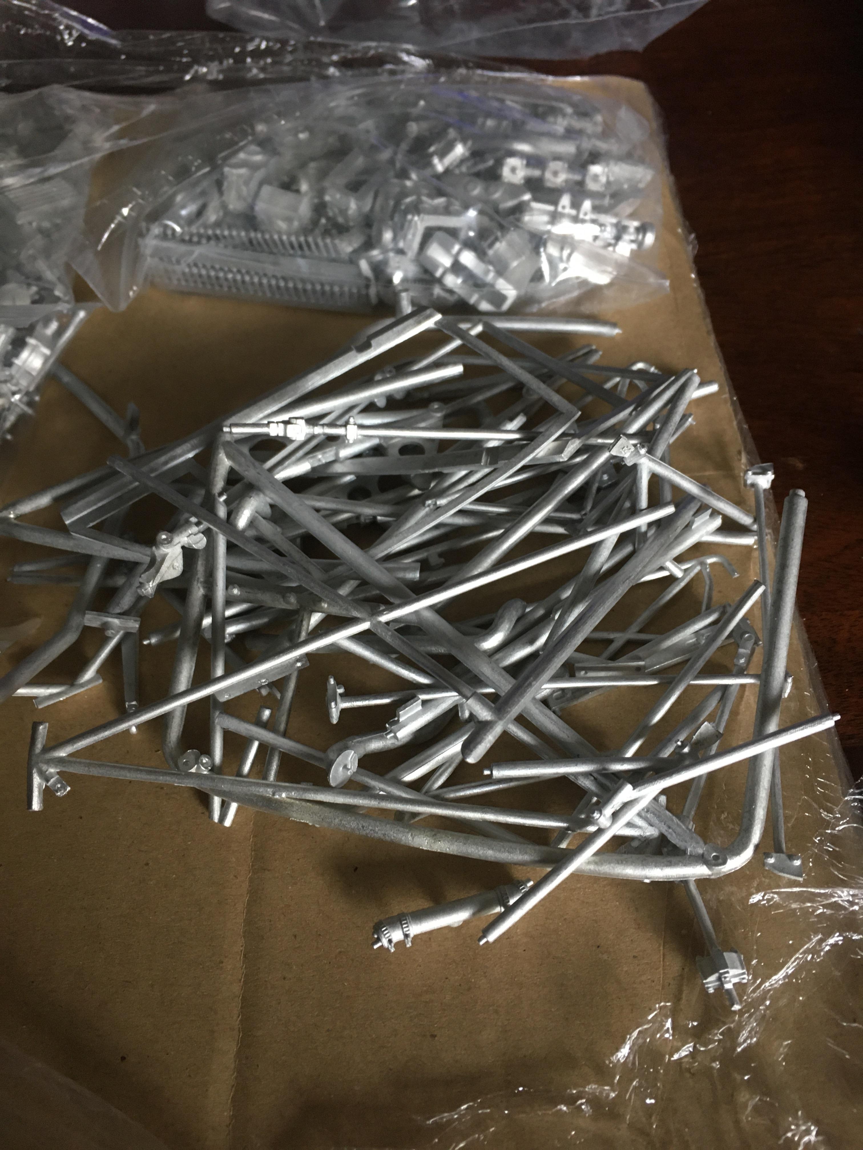

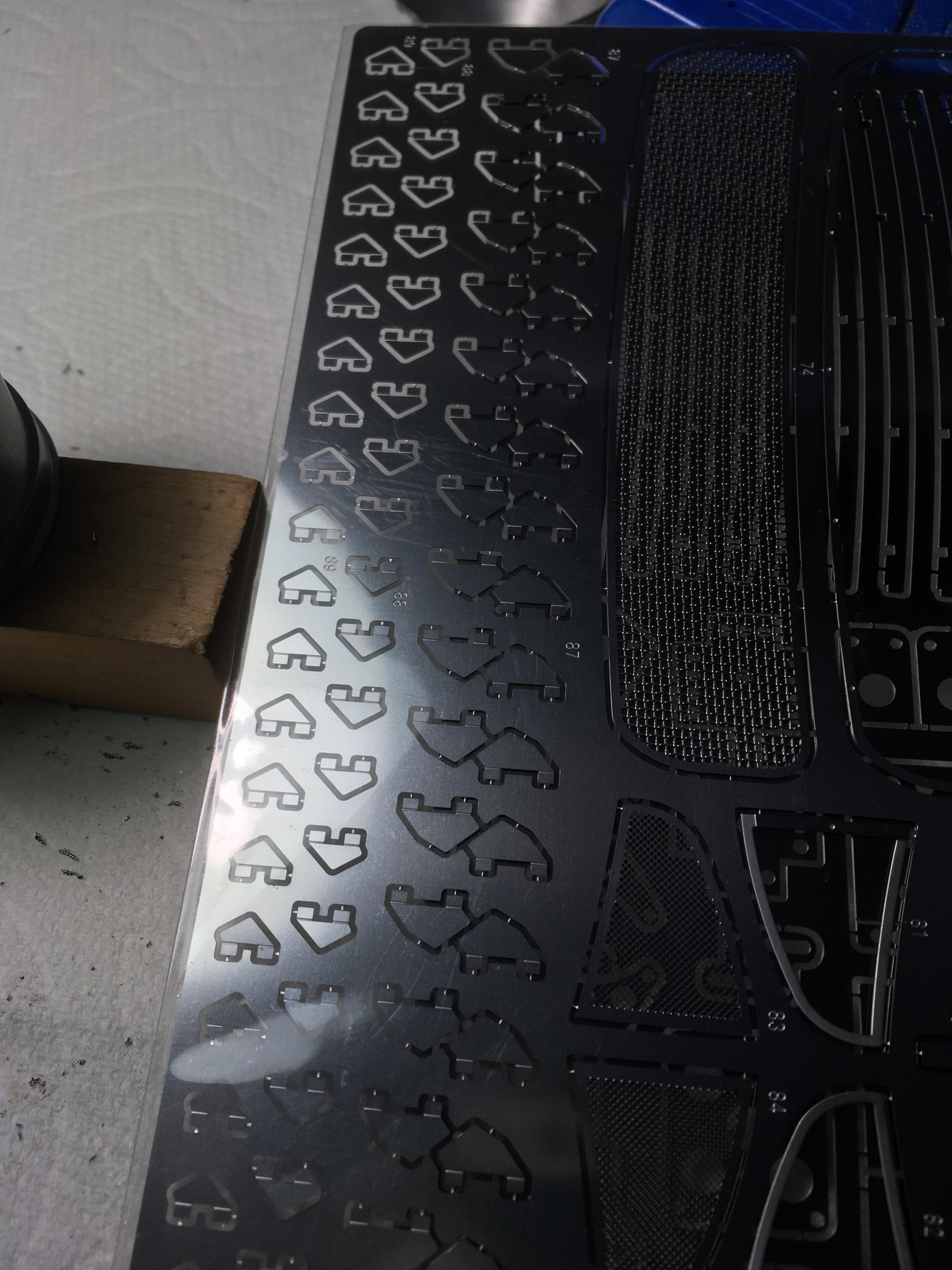

Hello Ray. These hiro kits are sometimes frustrating. Here is a pic of the parts and how they are packaged. No number reference. Just a pile of parts. It takes hours to sort this out and sometimes weeks to sort out the parts and fix things just to get started. Then on the other hand the detail is so real. After sorting out the parts you become familiar with them. Here are some pics of the parts. I put them in this container. This is my 3rd hiro kit and you start knowing what you need to do.

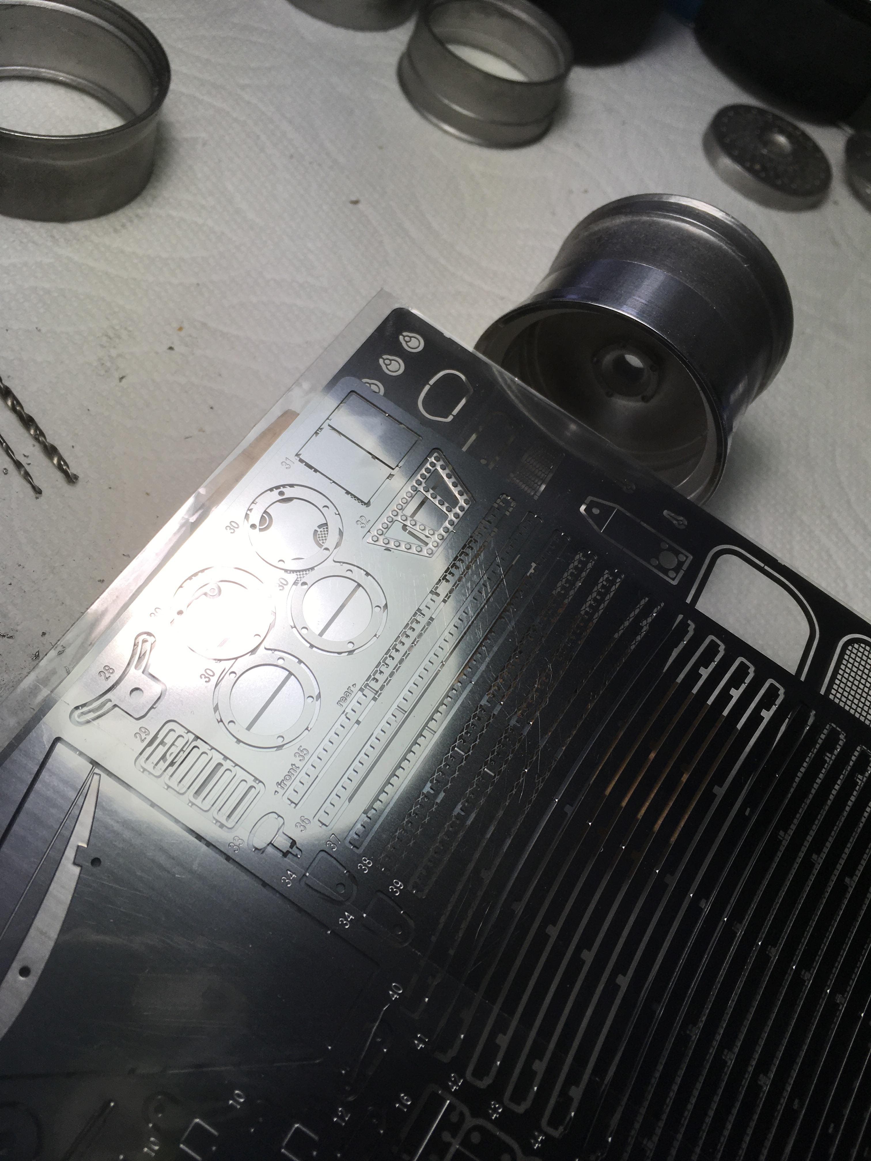

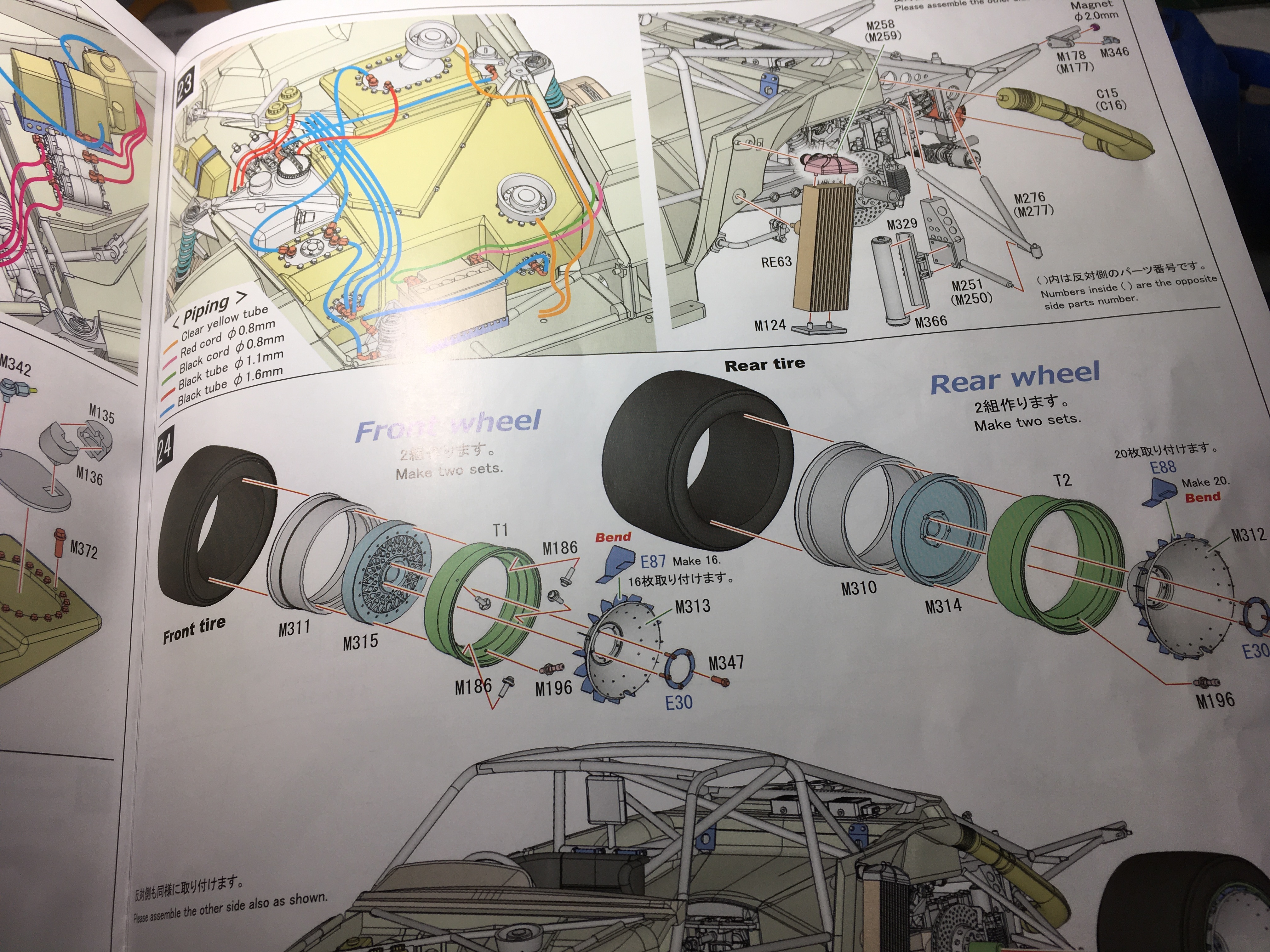

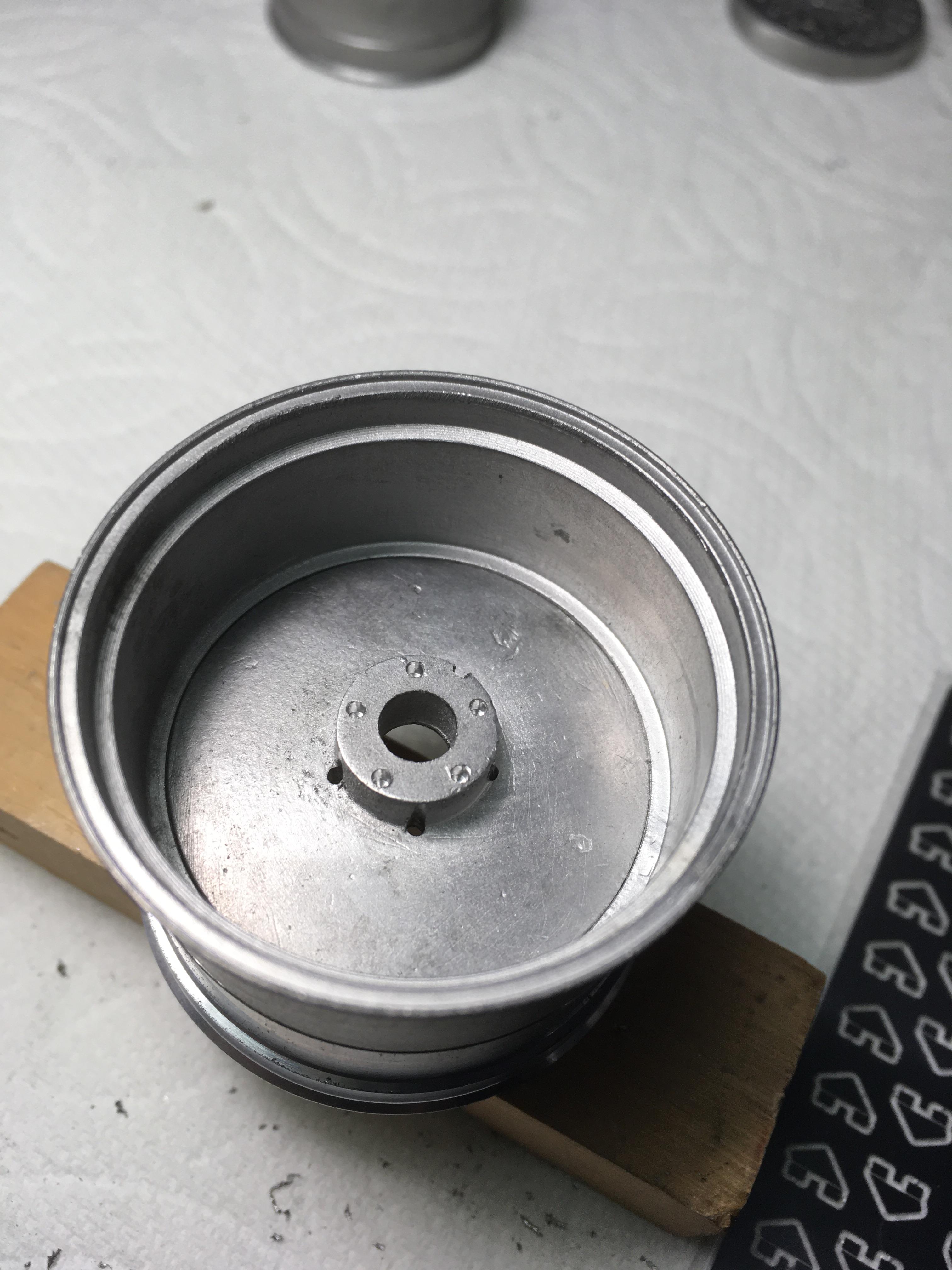

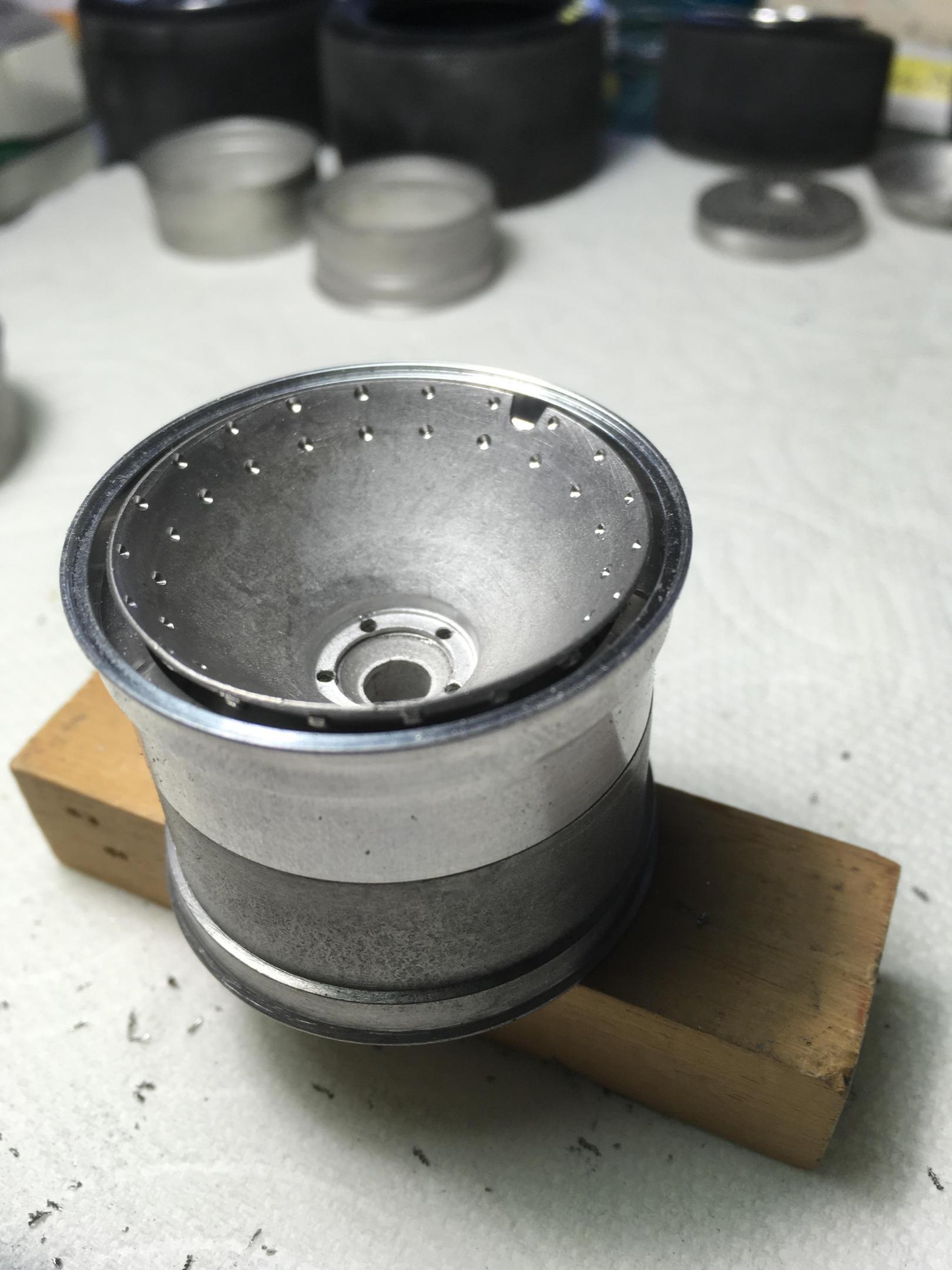

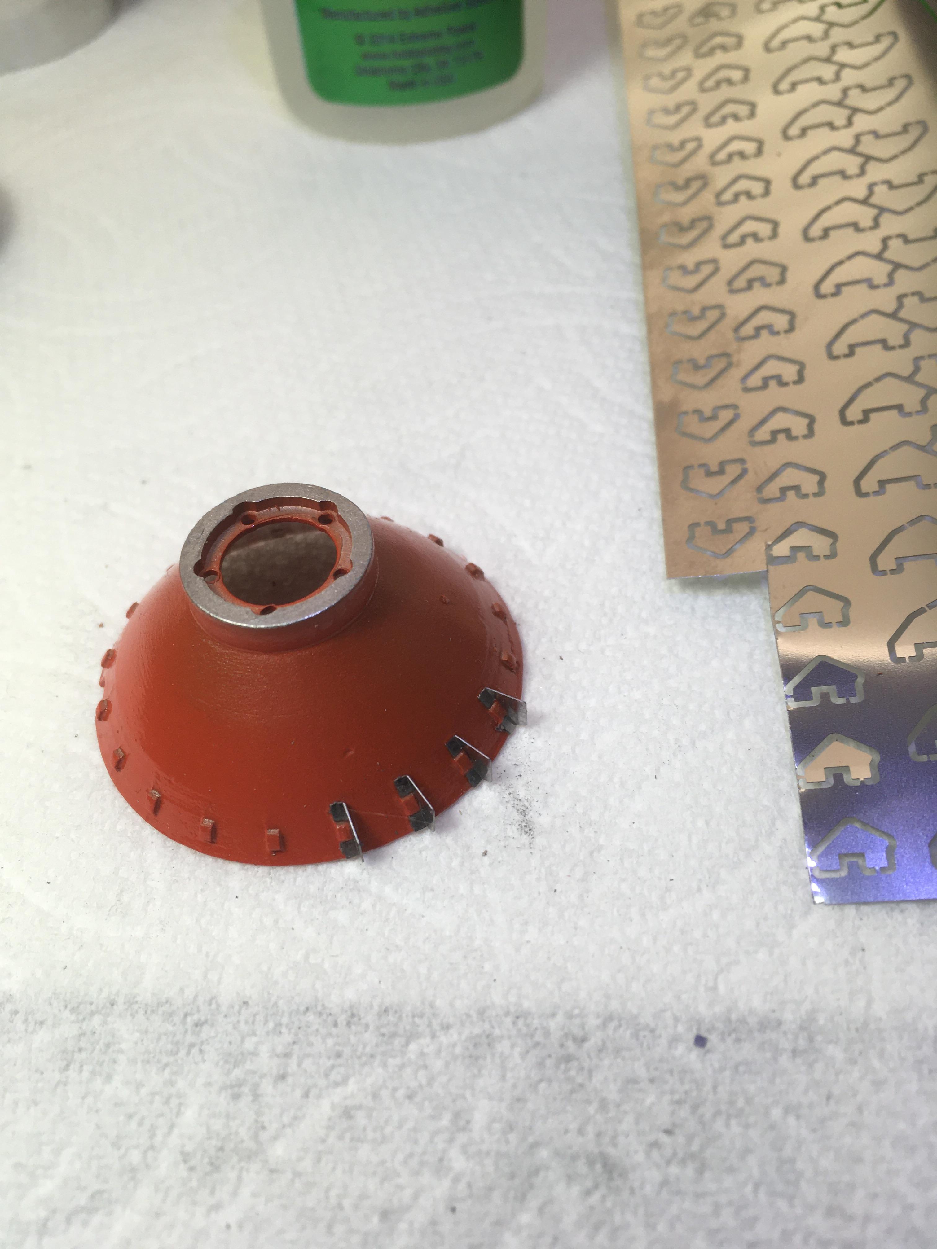

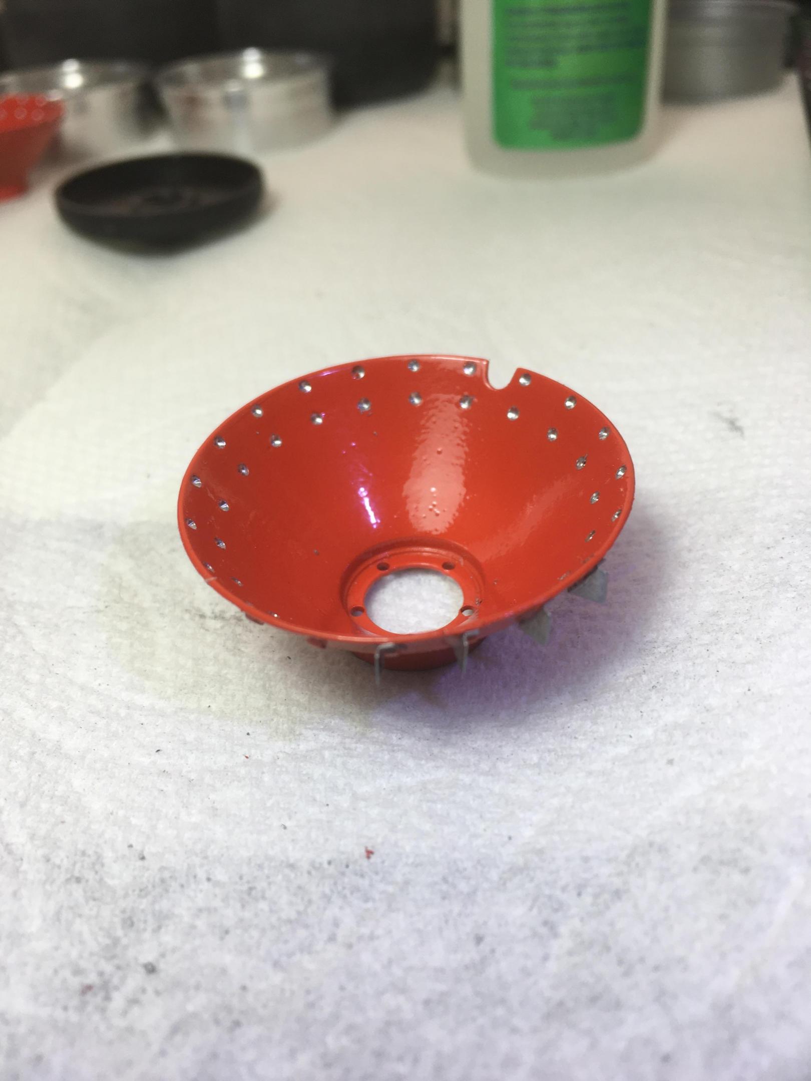

Here is the rear wheel. A lot of holes to drill. I’m going to have to get more drill bits. This operation will take awhile. A lot of pe fins to put on each wheel. CAFE9FAC-7396-46D0-B58C-22BB71CB81BB.thumb.jpeg.cea555e410c1aad77513a38bc7962eb3.jpeg

what color are going to paint the wheel center? Blue or orange. It may look good in black
Hello Chris, I’m going out of order. I am going to paint the wheels orange. Since I’m going the gulf colors route. But now I’m looking at a fluorescent orange. Just might go a regular orange color. Cannot decide. Was also thinking a pearl orange and pearl blue. I need to stop thinking
On 5/27/2021 at 10:49 PM, Bainford said:
I’m blown away by how complex that wheel assembly is.

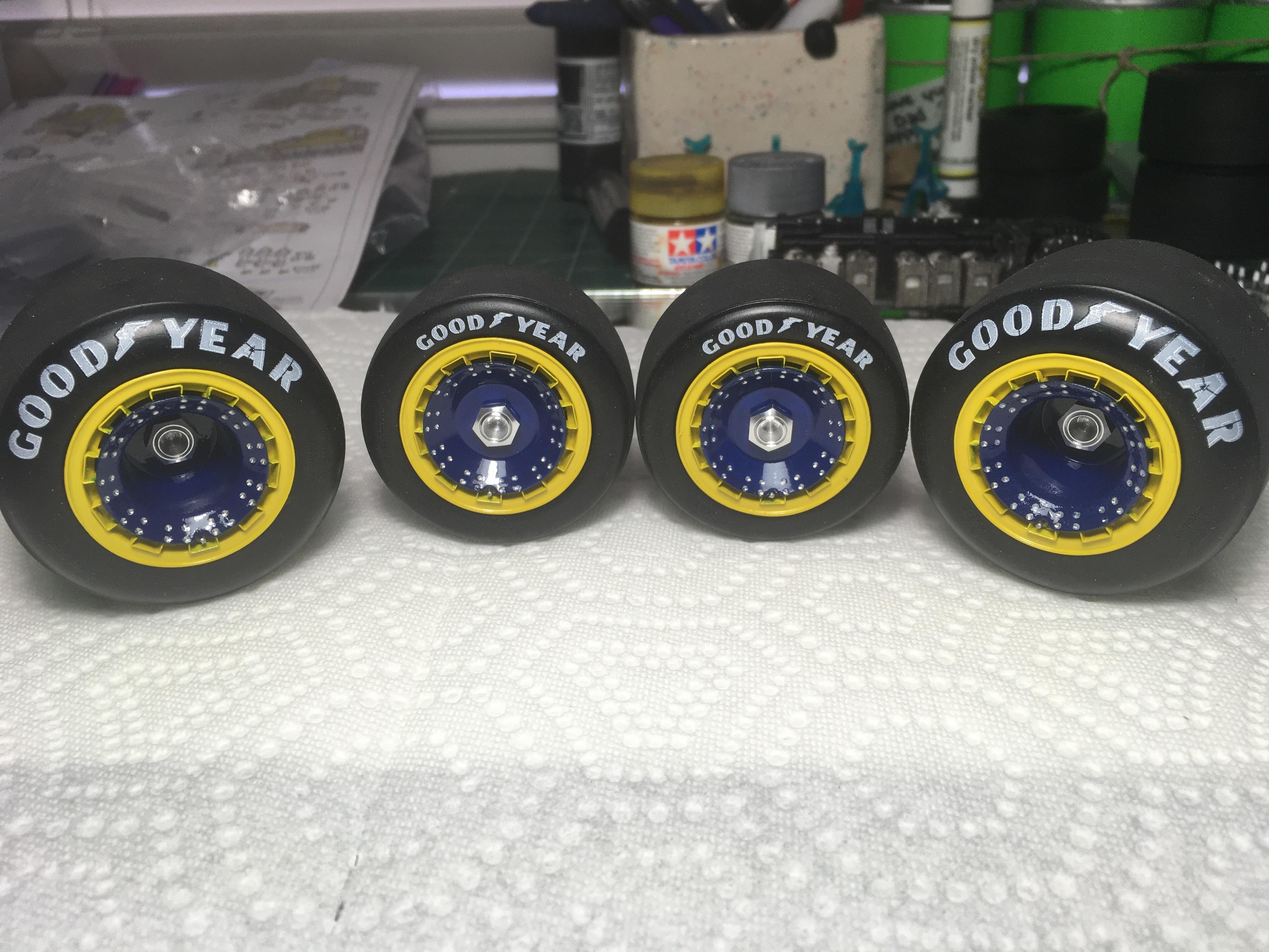

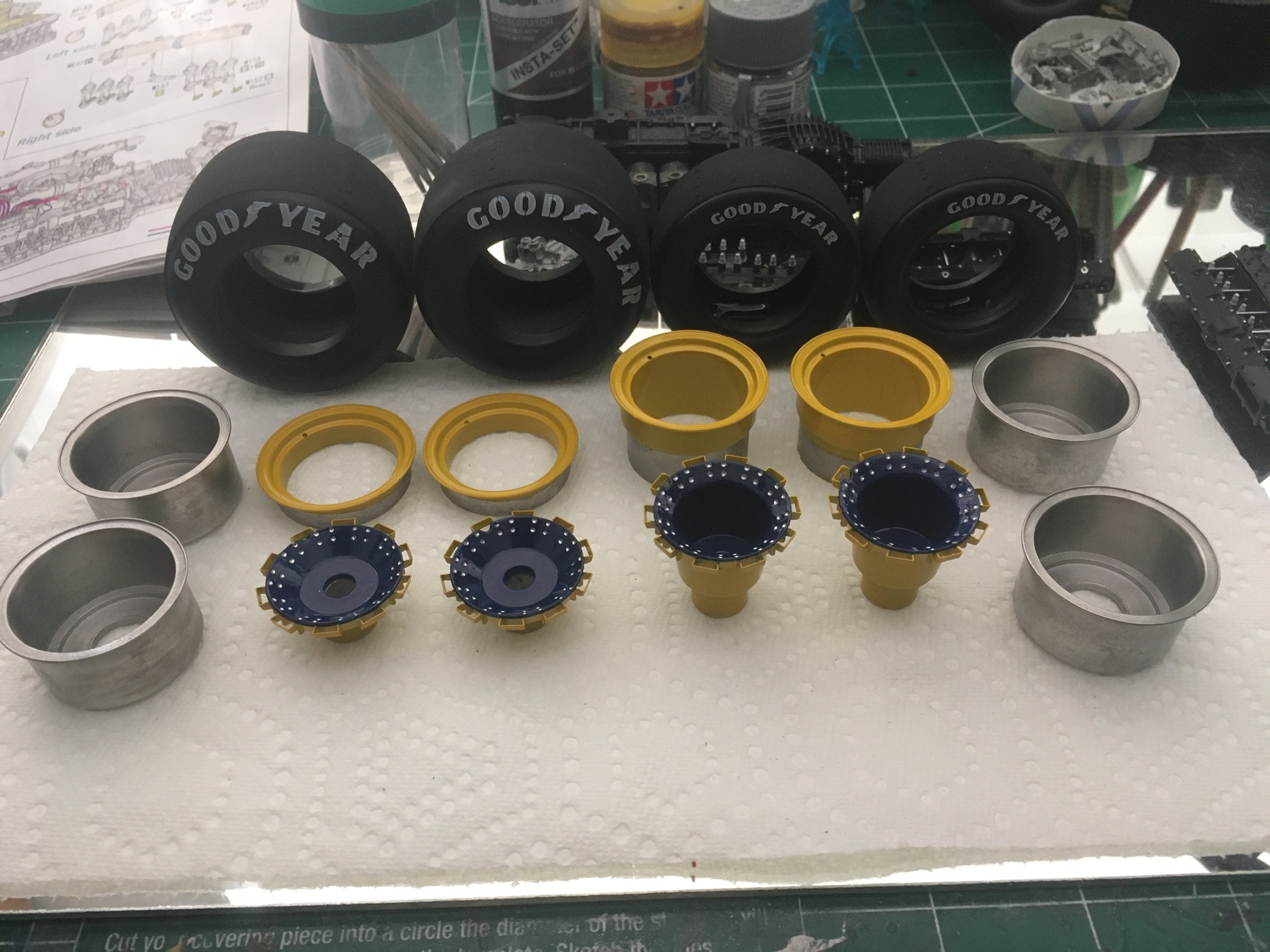

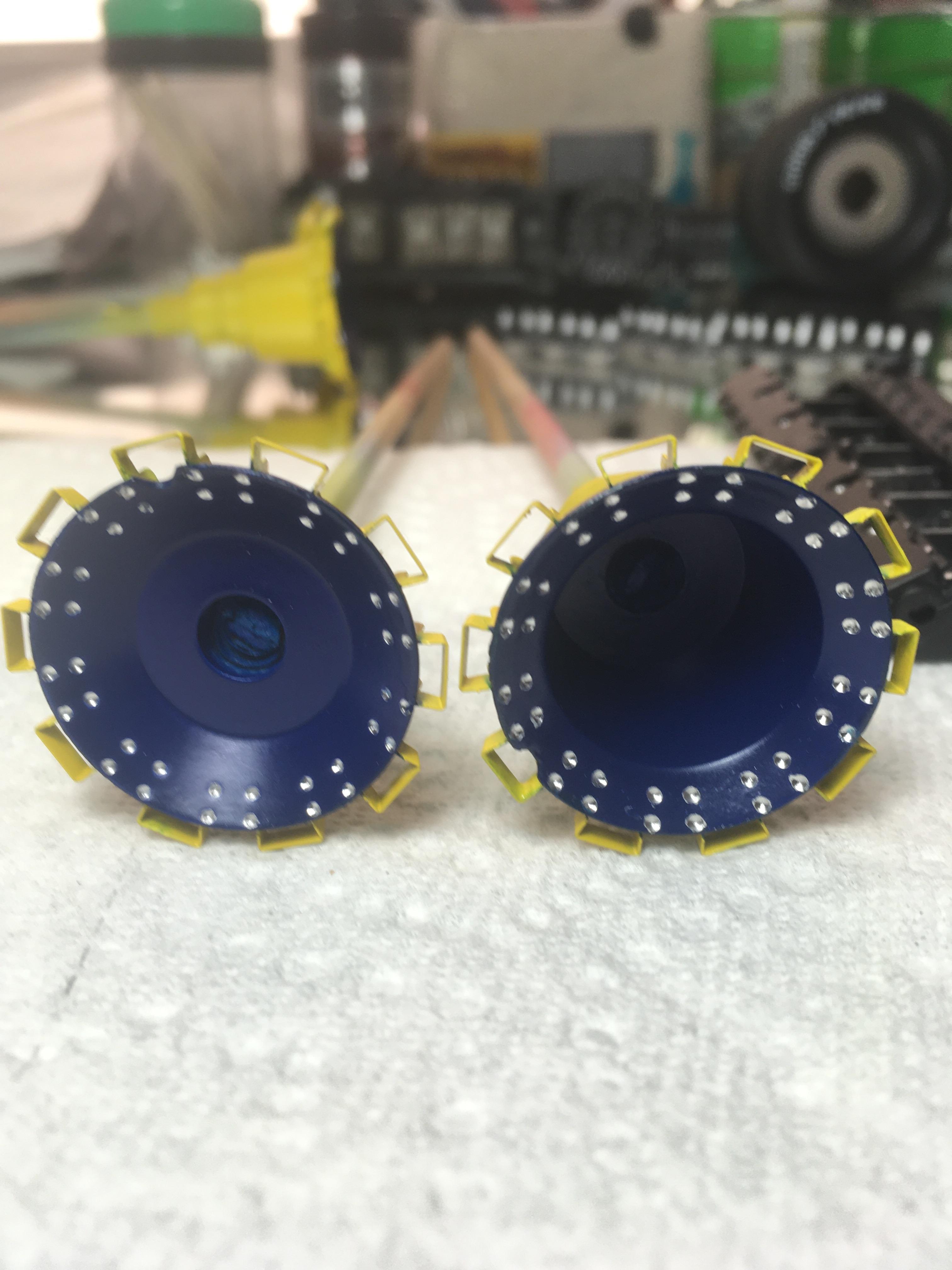

Hello Bainford. Porsche racing wheels are pretty cool and a little complex. As I am learning, Porsche does everything for a reason. Twenty fins each for the rear wheel. My 917/30 wheels are the same way. Painted the inside rim testors rattle can silver. The centers are trim black and the finned covers are orange. Redrilled the covers and now adding the pe fins. If you like detail, these MFH kits have a lot. I myself am not a detail guy. I like style and the shape of a automobile. I like to paint them.  Anyway here are some pics of the 917/30 wheels and tires.
