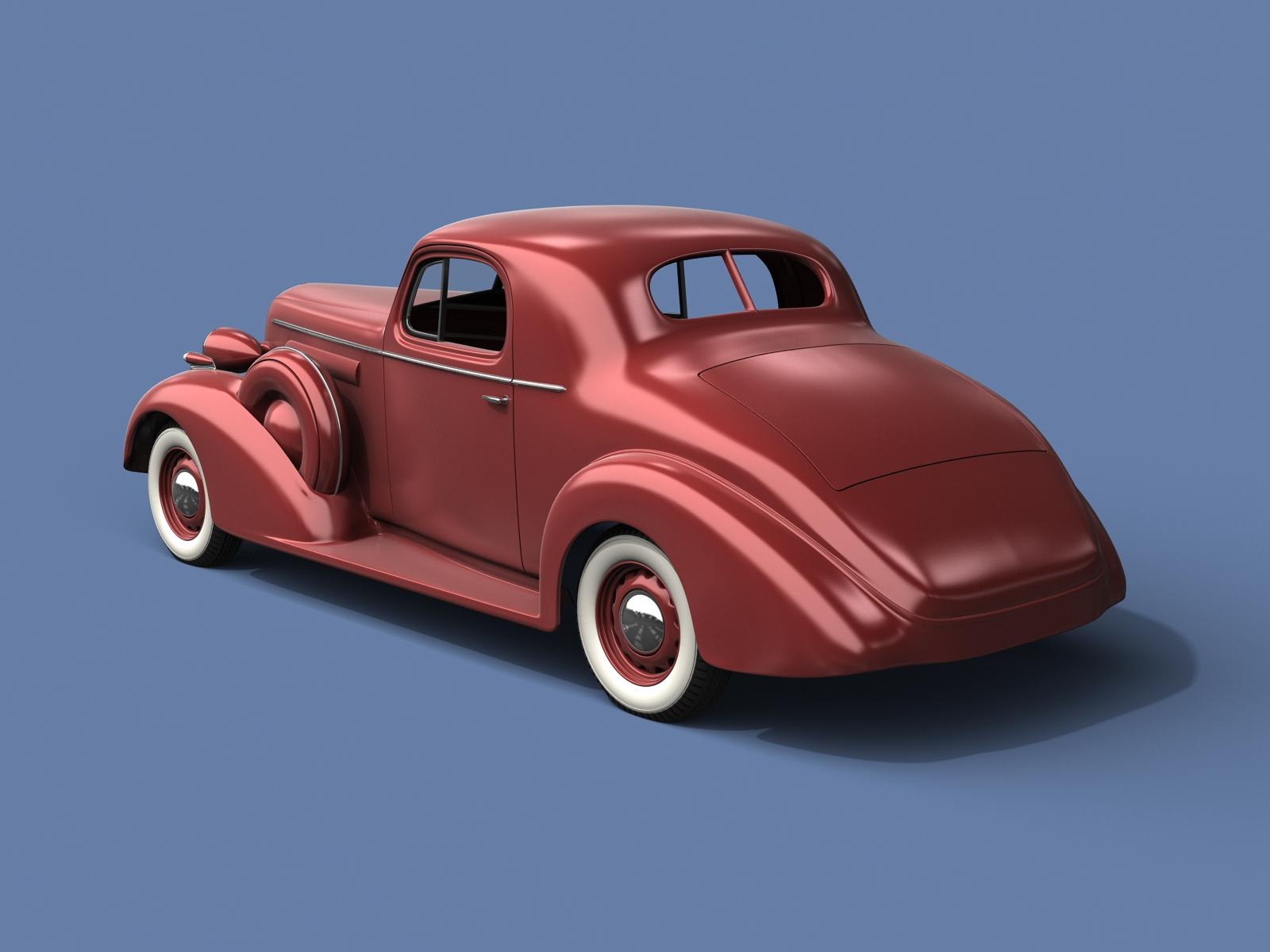

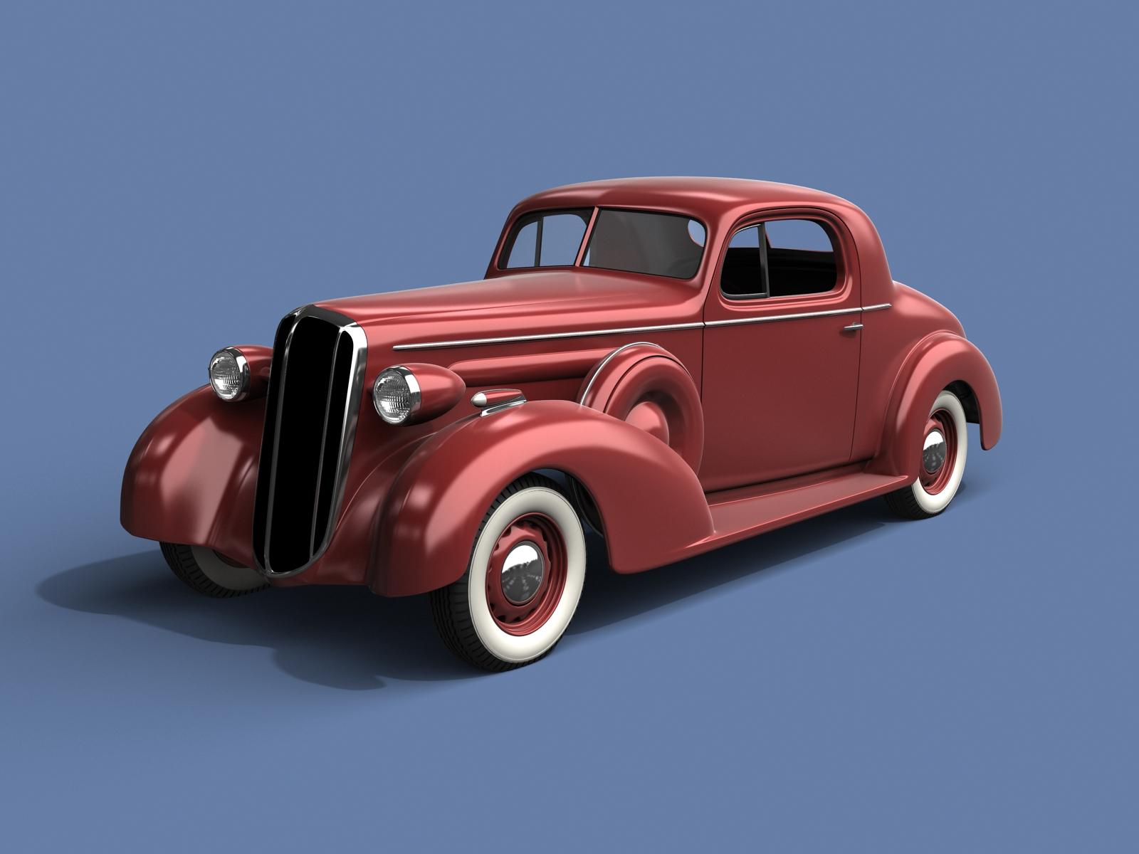

Dan's working on this for me. 1936 Buick Century coupe. Buick used the smaller Century and put the larger engine in it. Buick used a straight 8 over head valve engine. The car was very fast.  www.macsmotorcitygarage.com/buicks-factory-hot-rod-the-1936-century/
435115542_1070806083984360_1143347244504415584_n.jpg.569cca3d82a46b7366d571bcb29f99cb.jpg434951060_1090096722279334_3629360917829376451_n.jpg.4374ad0b039b9e172ea601686da7c08e.jpg434873873_992486238875218_8112621883707262045_n.jpg.60bc8a12bff6963737dcd0e395d6e298.jpg
Edited by my66s55
How do I get one of these??
Dan hasn't finished the file yet. What is it you, the file or the 3d printed car?

I would be interested in the file
