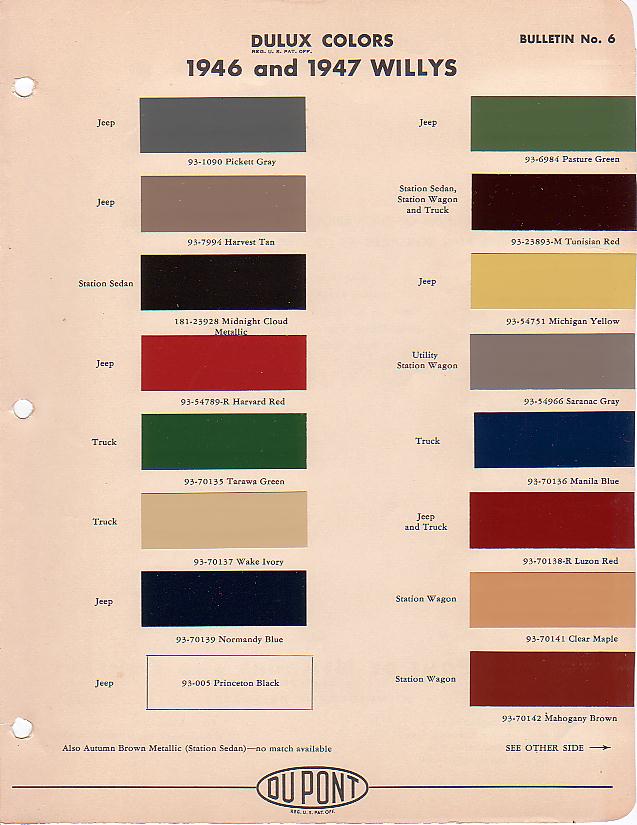

Tonite we got the last of the chassis work done.  The front and rear outer wheel pieces are now ready for installation and the chassis is painted.  Still having issues with trying to find a good OD color in a spray can.  I may try one of the auto parts stores to see what they have.  The newer model paints are too dark for this vintage vehicle.  Anyway here we are to date.

As for the spray cans, a local autobody supply shop should be able to mix up a custom spray can for you, I've had it done.  I like the one in this picture, "Pasture Green" as an example
