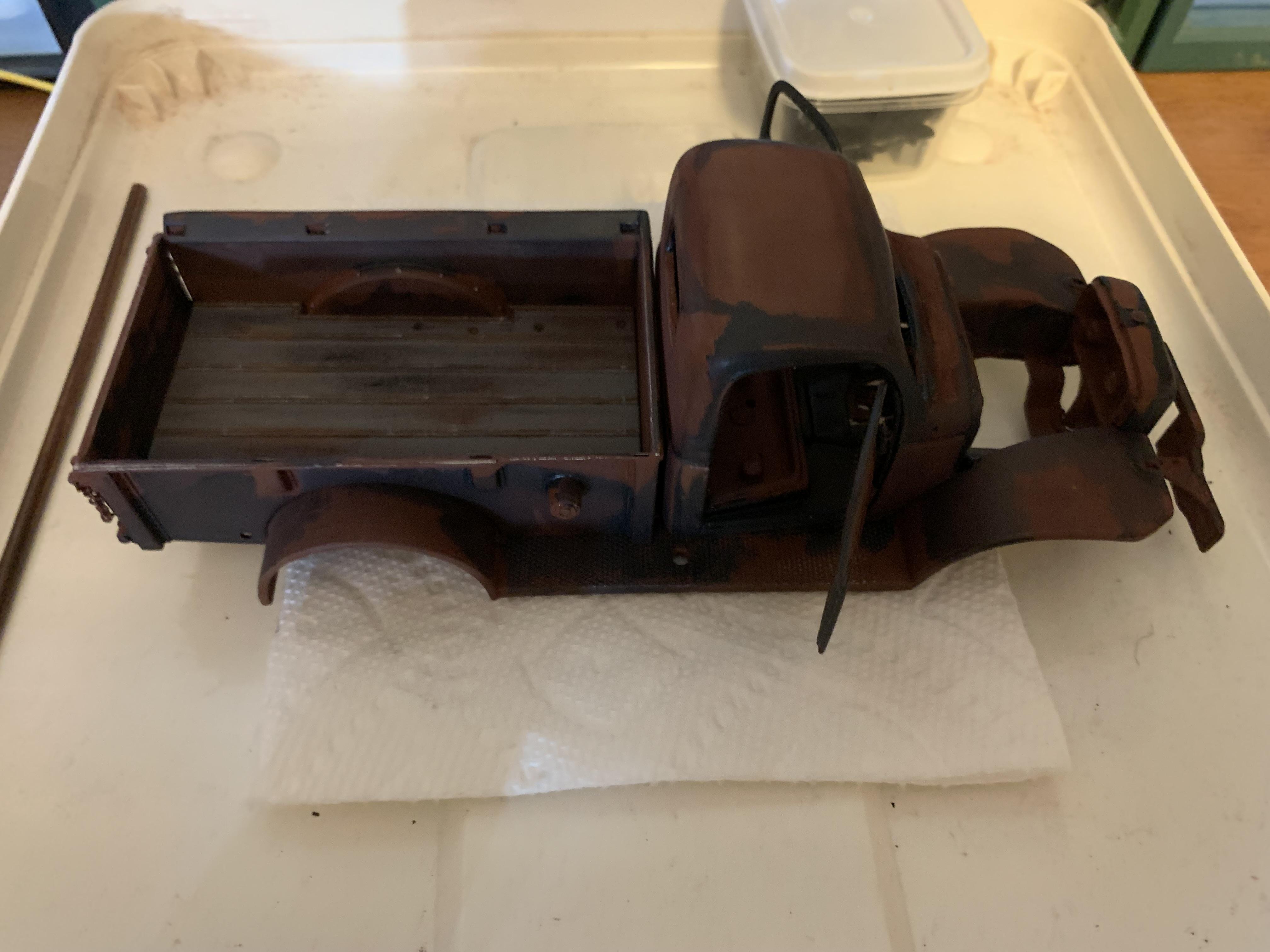

Got a lot of weathering done- still more to do, of course. Will need to grind more in the engine compartment to make the hemi fit, and also grind inside the grille to adjust the radiator fit (too close to the engine). Used white pastel to weather the tires and did more on the seat. Mostly done with pastel rubbed on the area then worked with my finger (best) or a q-tip (doesn't stick as well).

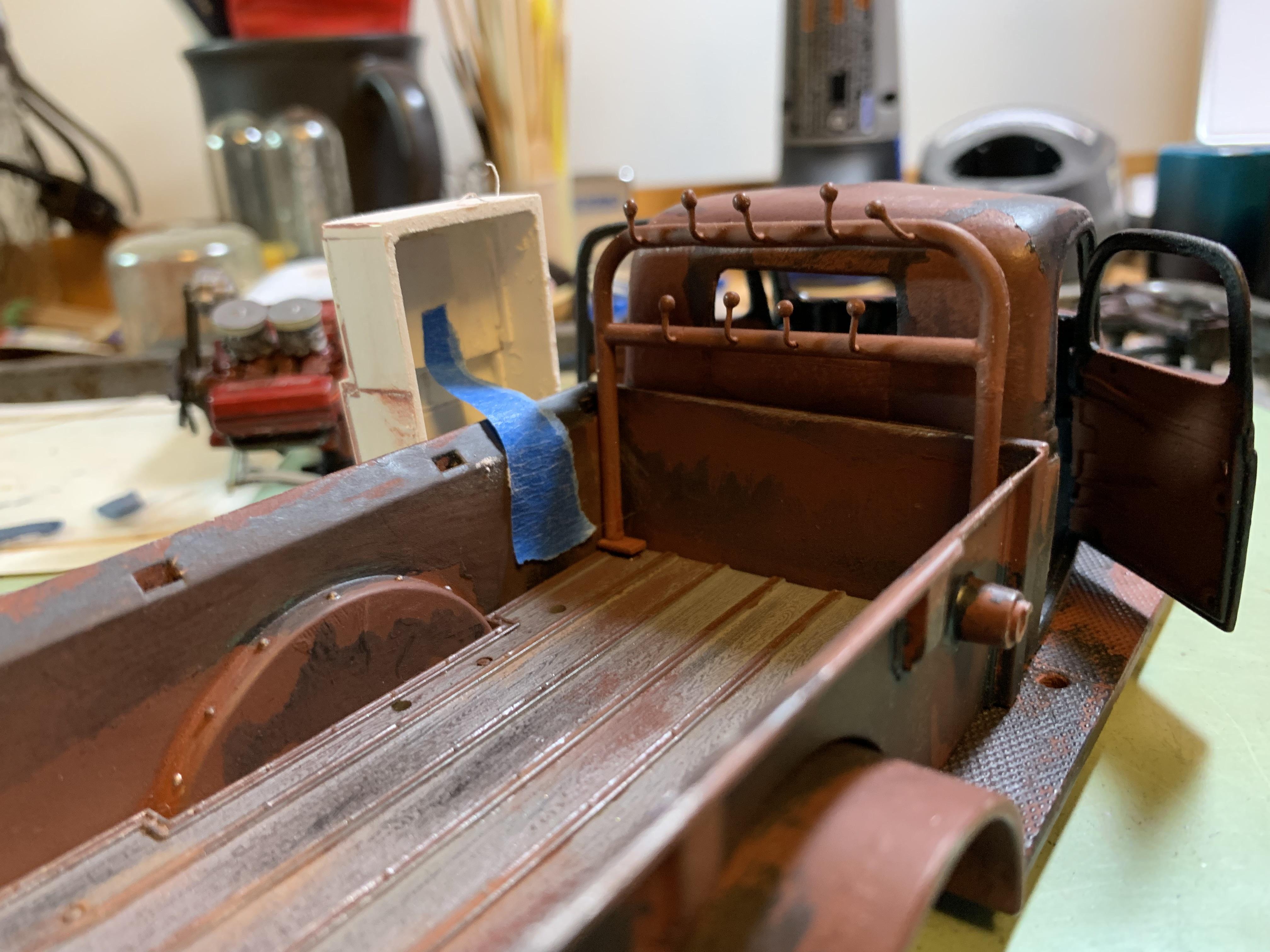

It's going to be a very weathered but very hard working truck. Named Babe after Paul Bunyan's blue ox. Made a headache rack from a roll bar. Cut down a tool box from the Nascar kits to fit on the running board. Dual vertical exhaust stacks through the running boards behind the cab. Cranked out windshield. And the hemi. Lots of chains, shackles, and tow hooks. And a trailer hitch. More pix when I get more done.

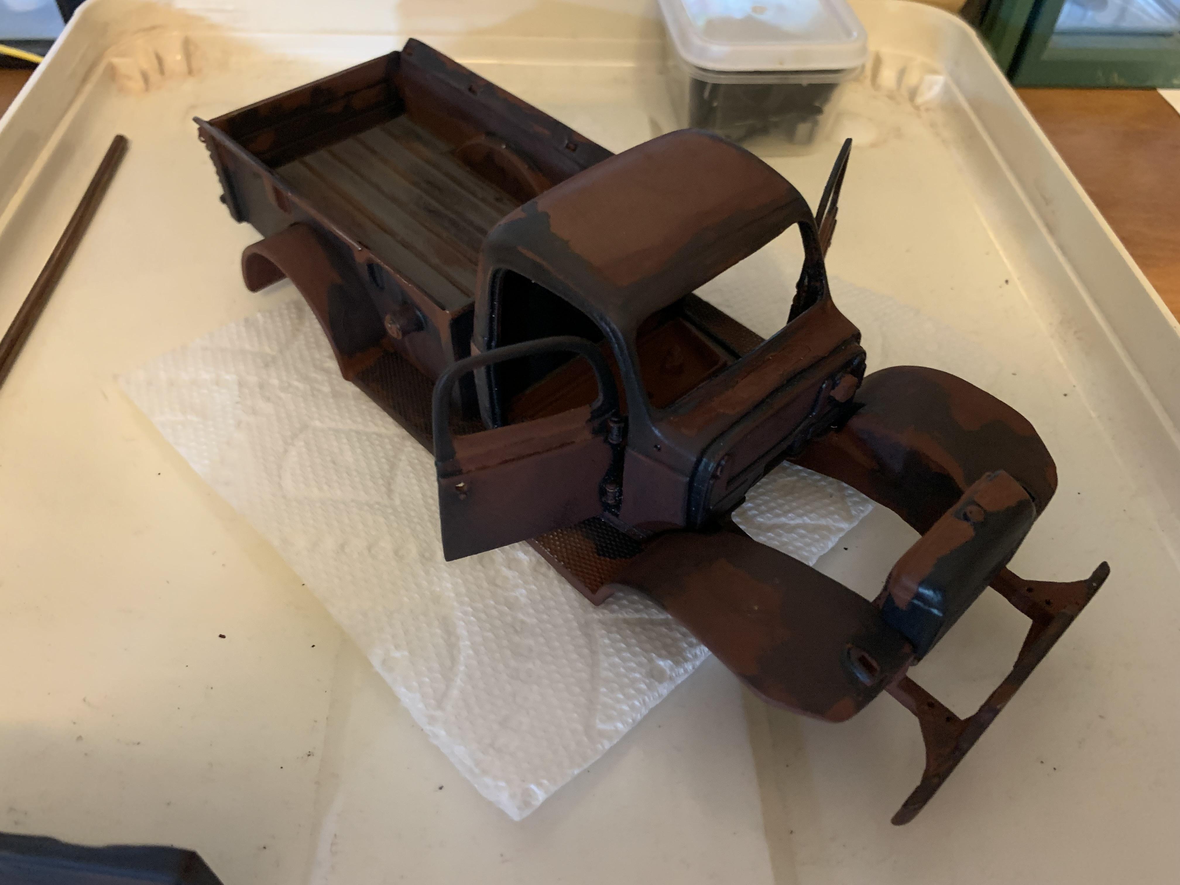

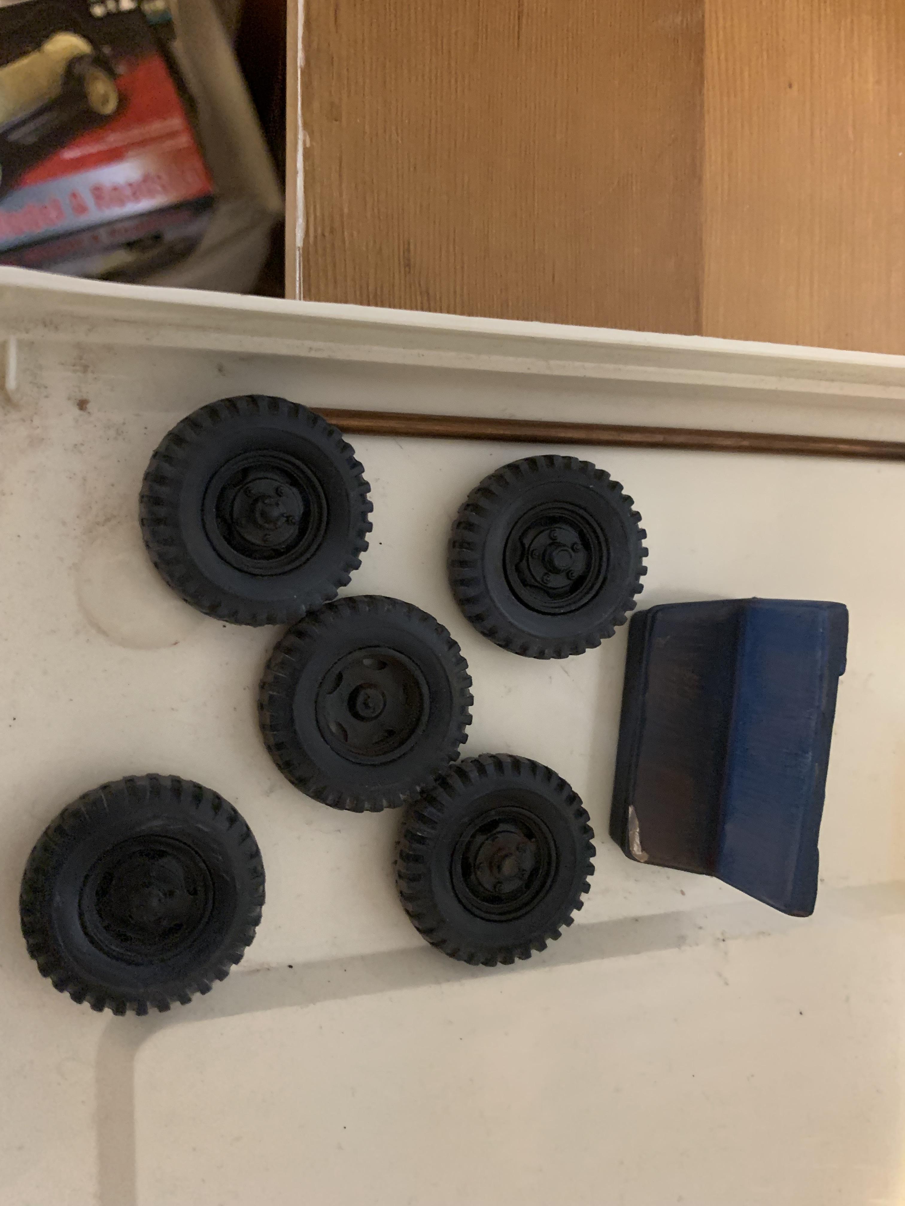

More progress- some of it pretty major- cut the hood sides from the rest of the hood using a jewelers saw I haven't used in years- my razor saw was too dull to cut this diecasting metal- especially tough in the hood, and when I removed the original paint a very different color from the rest of the parts- those were silvery while the hood pieces were almost a golden color and very shiny- and hard as steel! I had cut the wheels and tires off to weather them- decided it was time to reattach them- made short pins from sprue with a concave end going into the (brake drum?)- the hidden brake drum face was bored out with a conical depression and everything superglued together- we shall see if it stands up to the weight of all that metal! The hood sides will be attached to the hood top with two layers of transparent packing tape acting as a hinge, not quite reaching the front and back. This will leave small areas where I can glue over strips of styrene for reinforcing. We shall see!

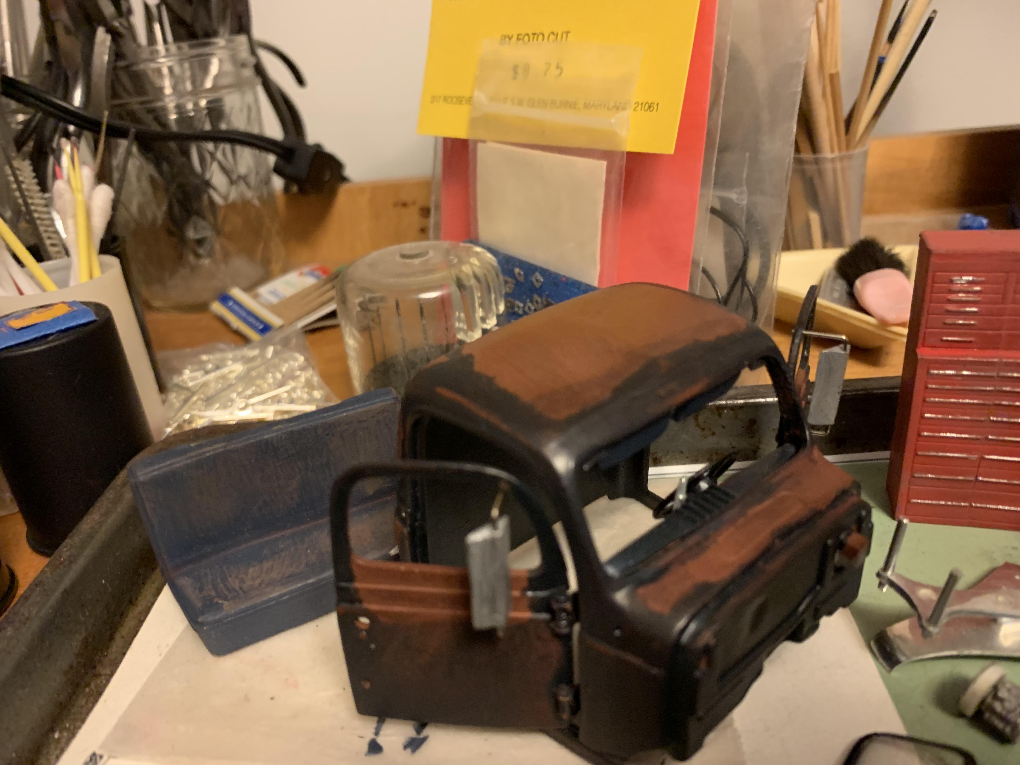

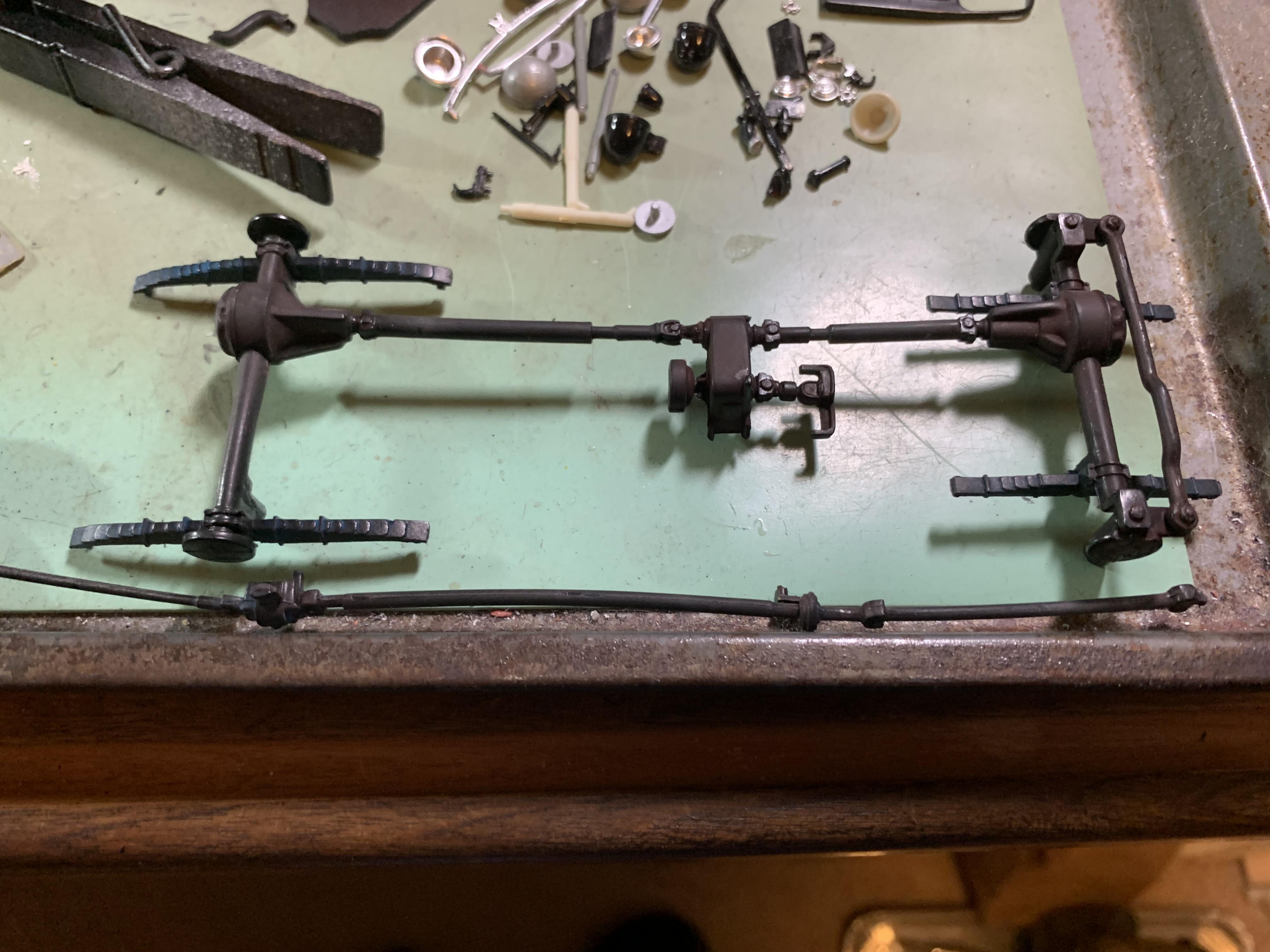

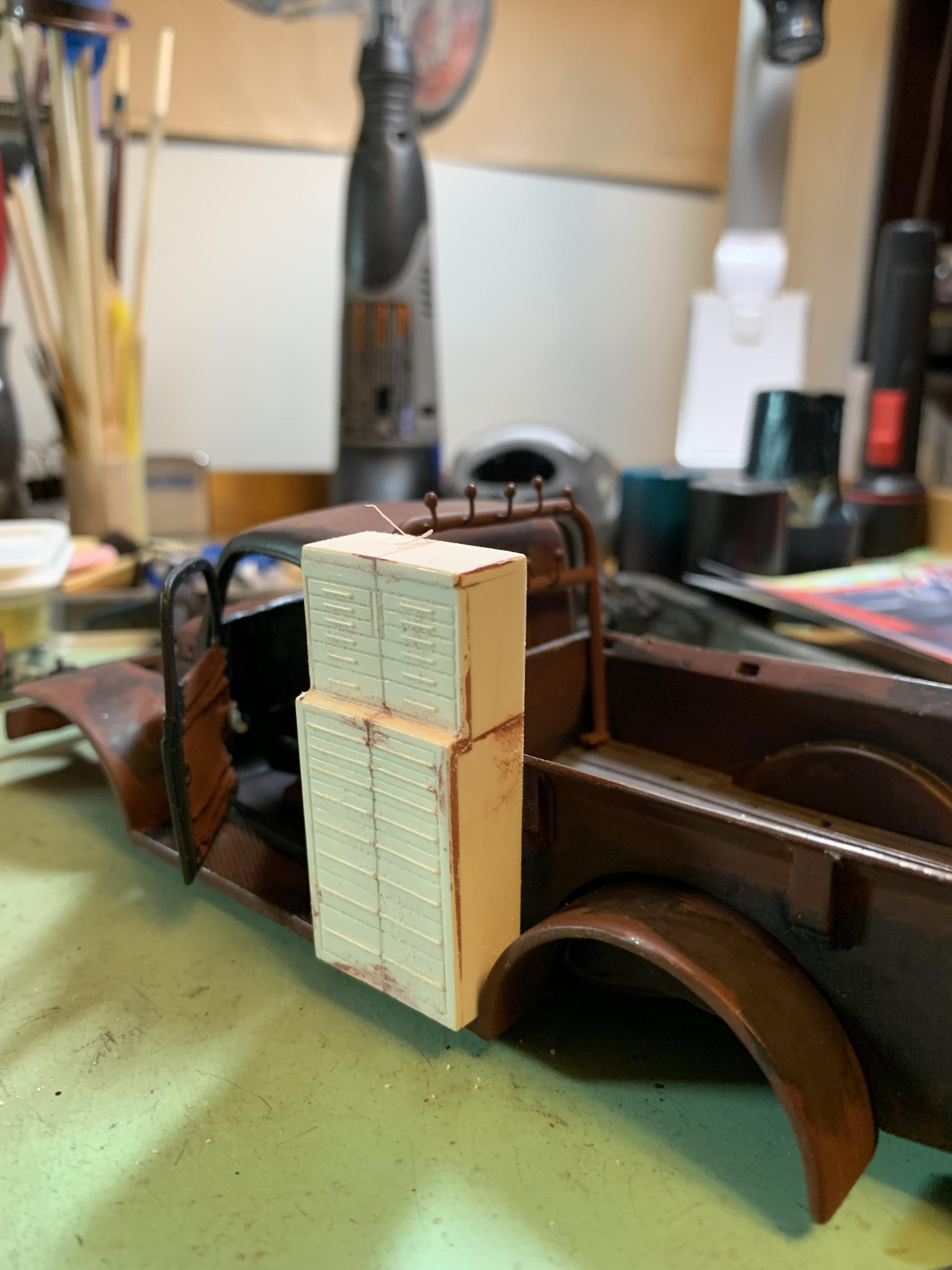

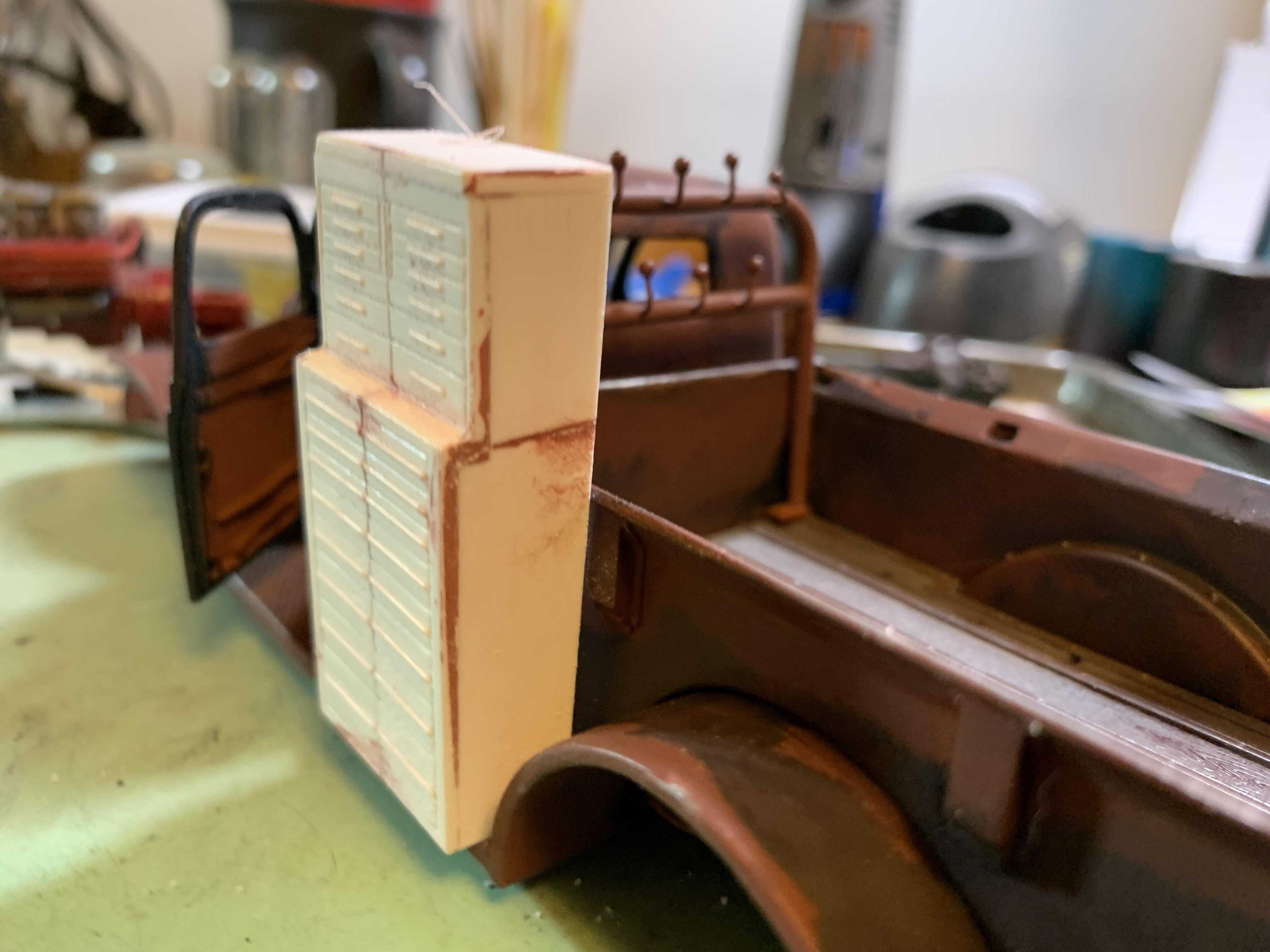

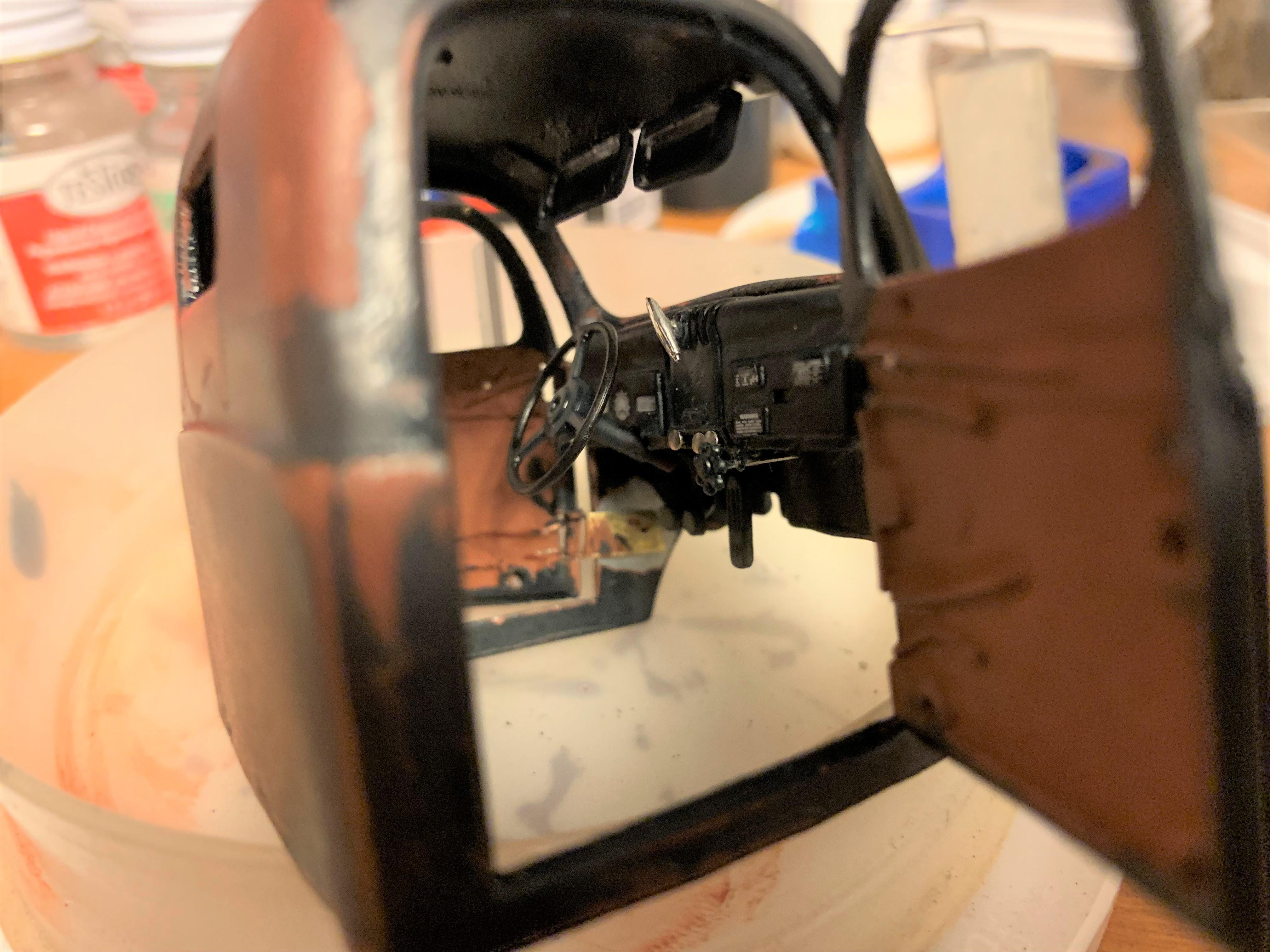

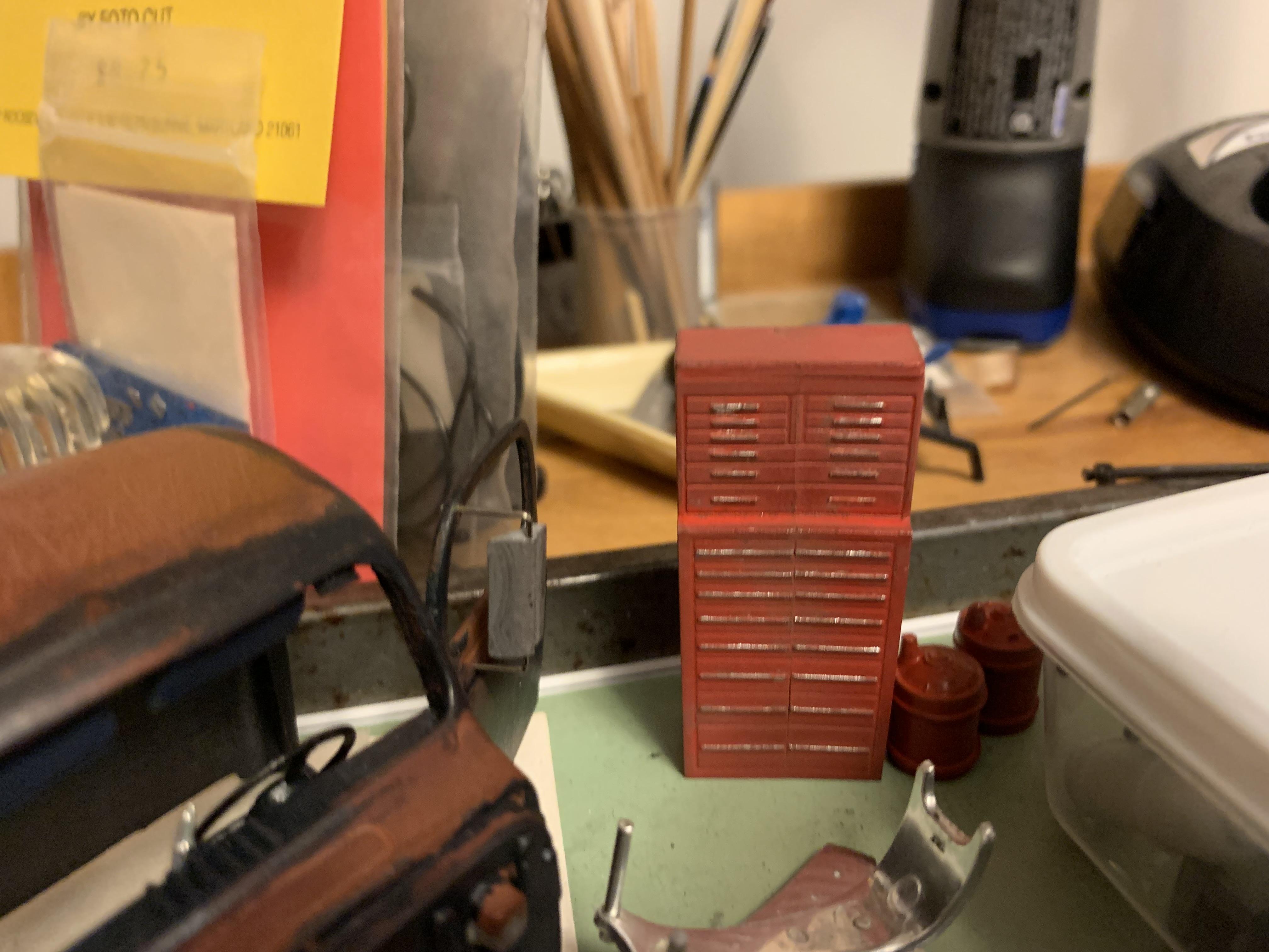

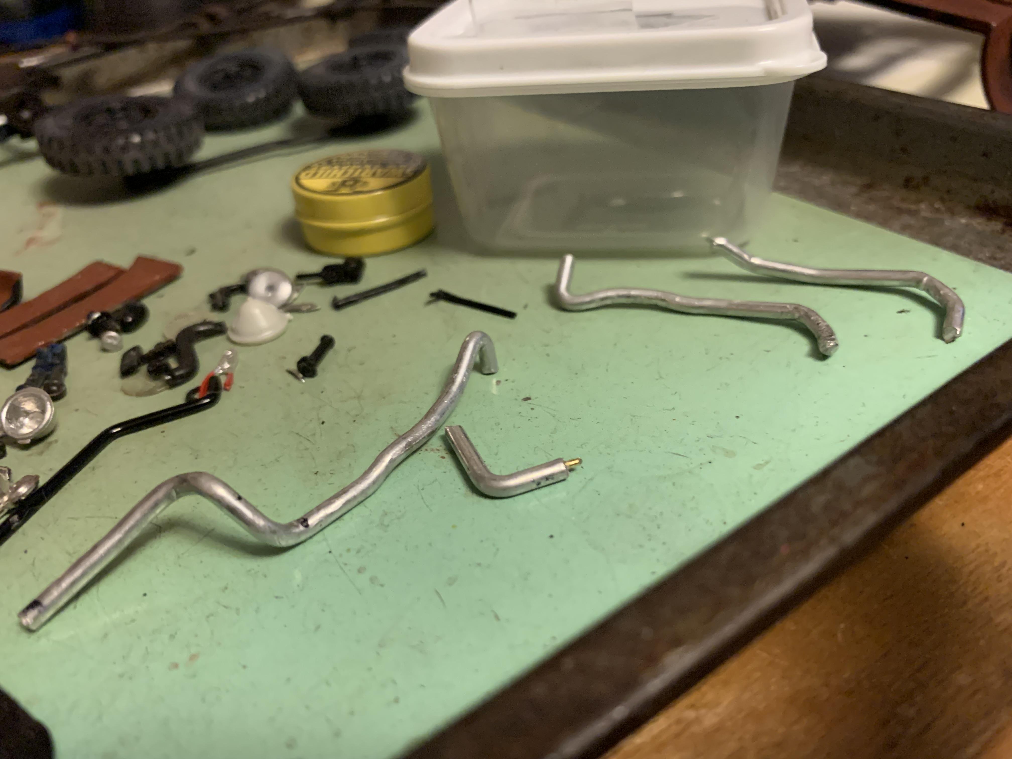

Got a lot done on the Power Wagon- rehung the doors (still don't quite close, but better), added the mirrors which actually can swivel on their brackets, detailed and installed the dash, and scratch built a transfer case cover and operating levers to replace the klunky original. Also bent up new exhaust pipes to fit the hemi exhaust manifolds.  They clear all the drivetrain and take off cases and shafts. They will connect to the vertical stacks. Weathered the tool box for the running board. Next big mini project will be hinging the hood sides- first idea using tape didn't work, needs more thought.

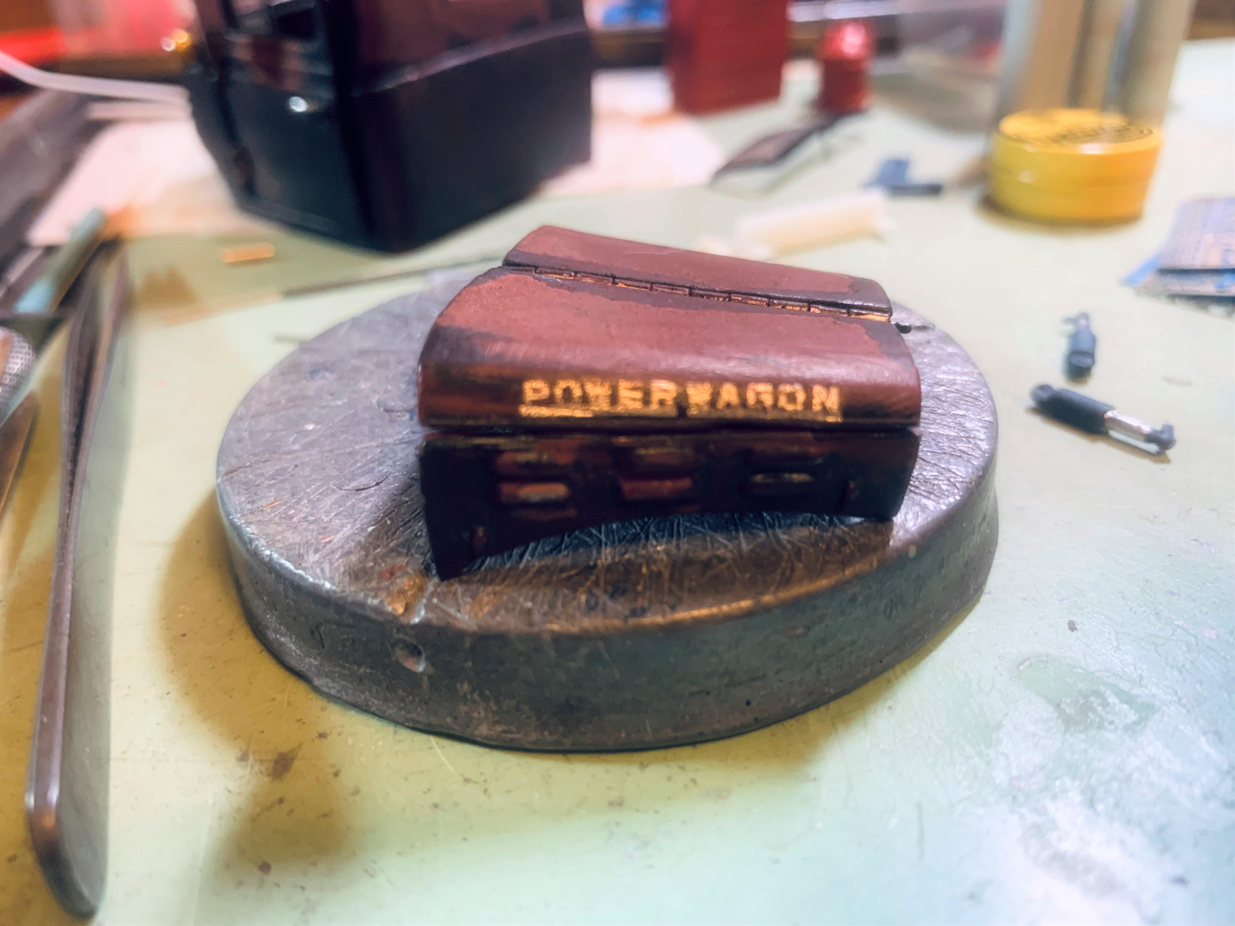

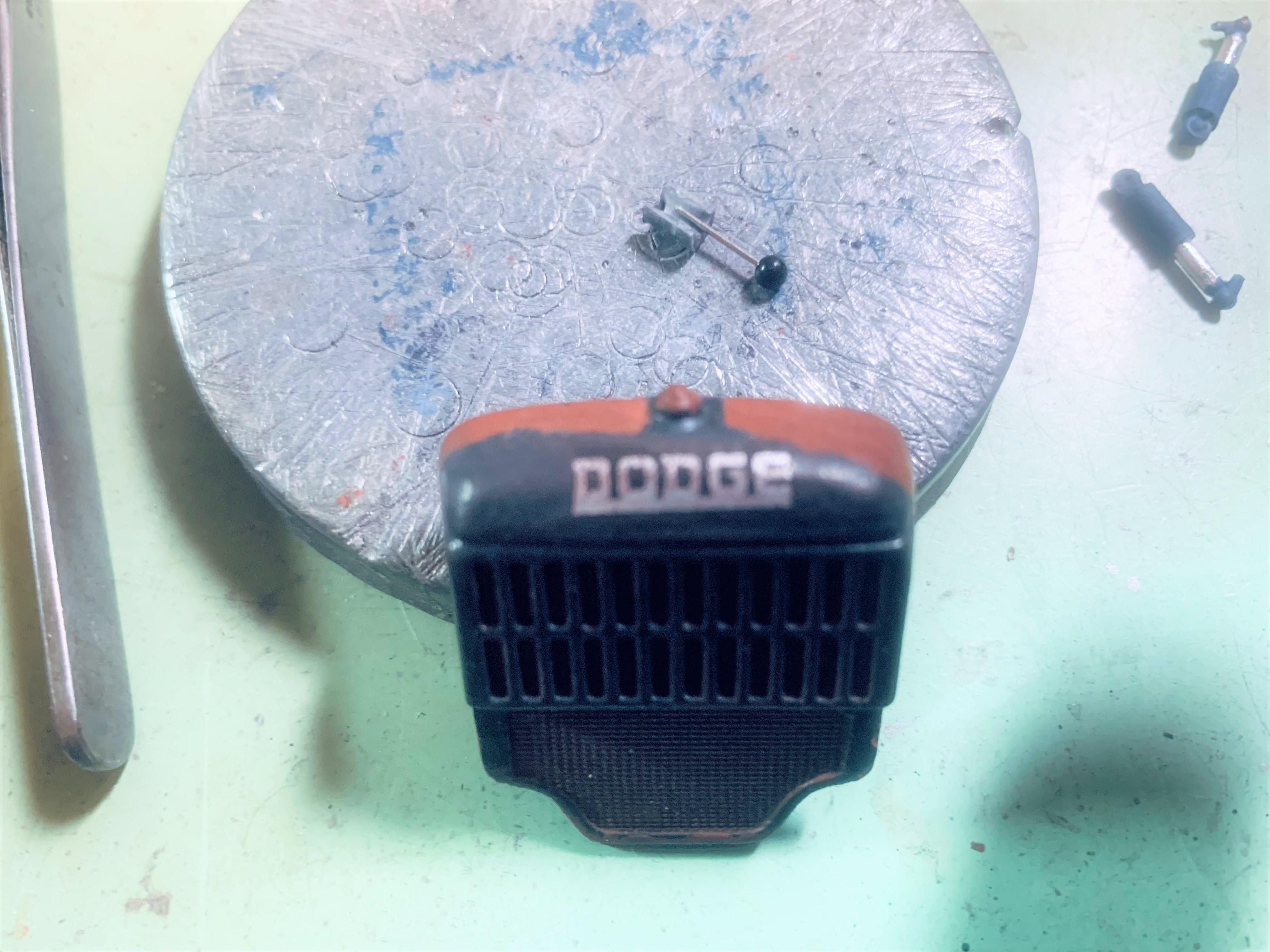

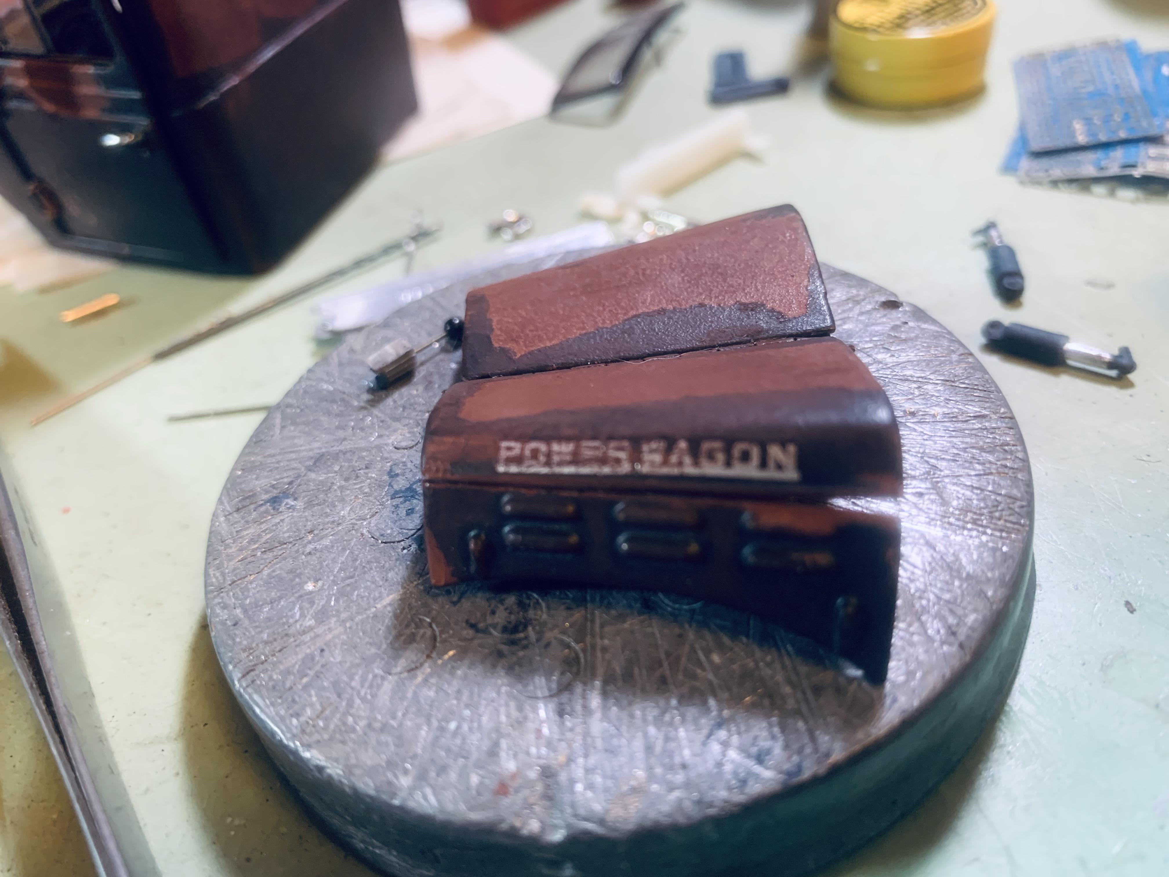

More progress! Beginning the dreaded final assembly! Installed the bed, still having a problem with the drivers side door on the cab. Got up the courage to finally add the Dodge and Power Wagon decals to the grille and hood sides- and then I weathered them! Also finished and installed the power drive for the rear winch mounted on the hitch assembly which of course will tow the trailer for the big boat! Onwards through the fog, forward never straight!

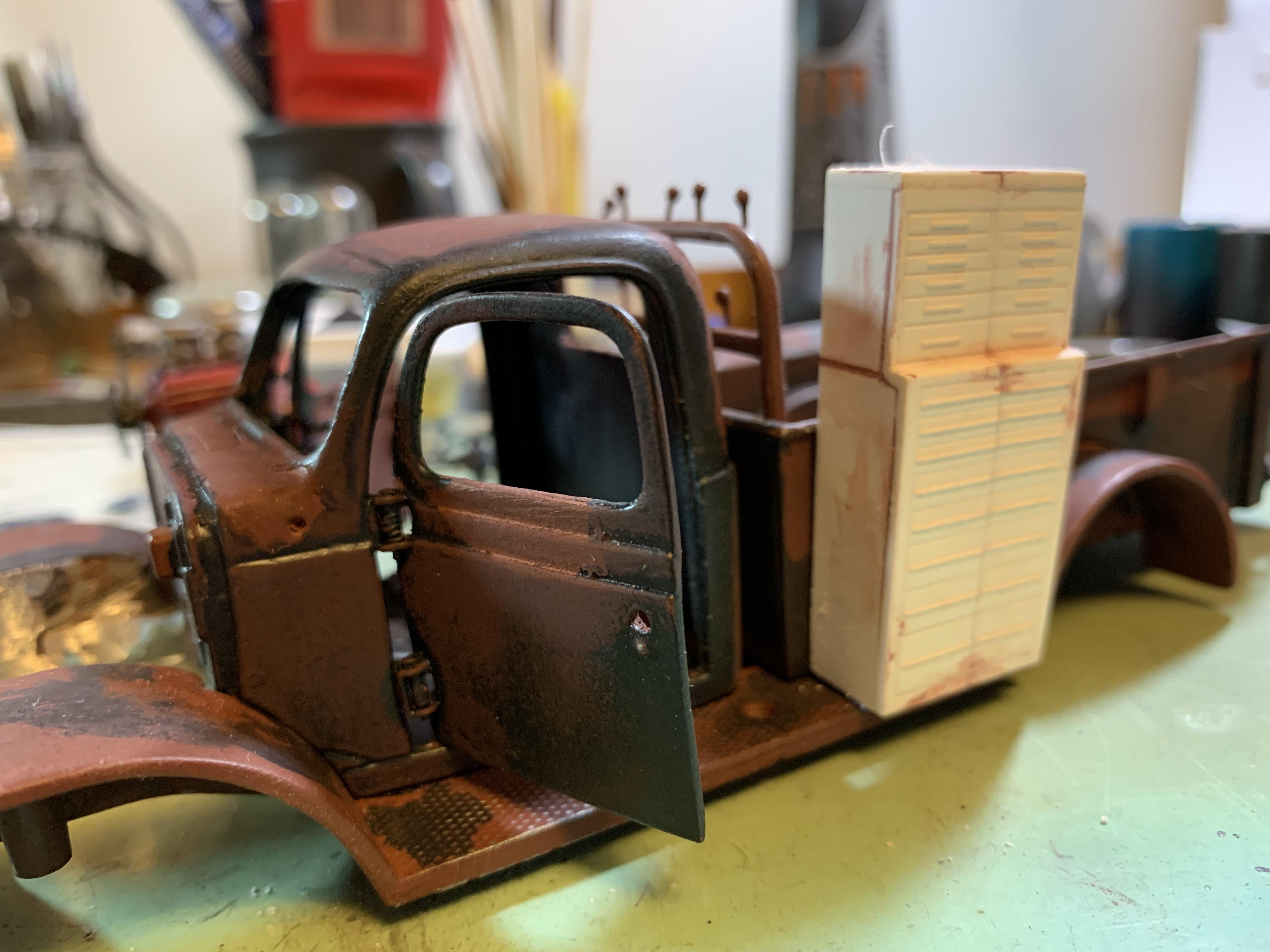

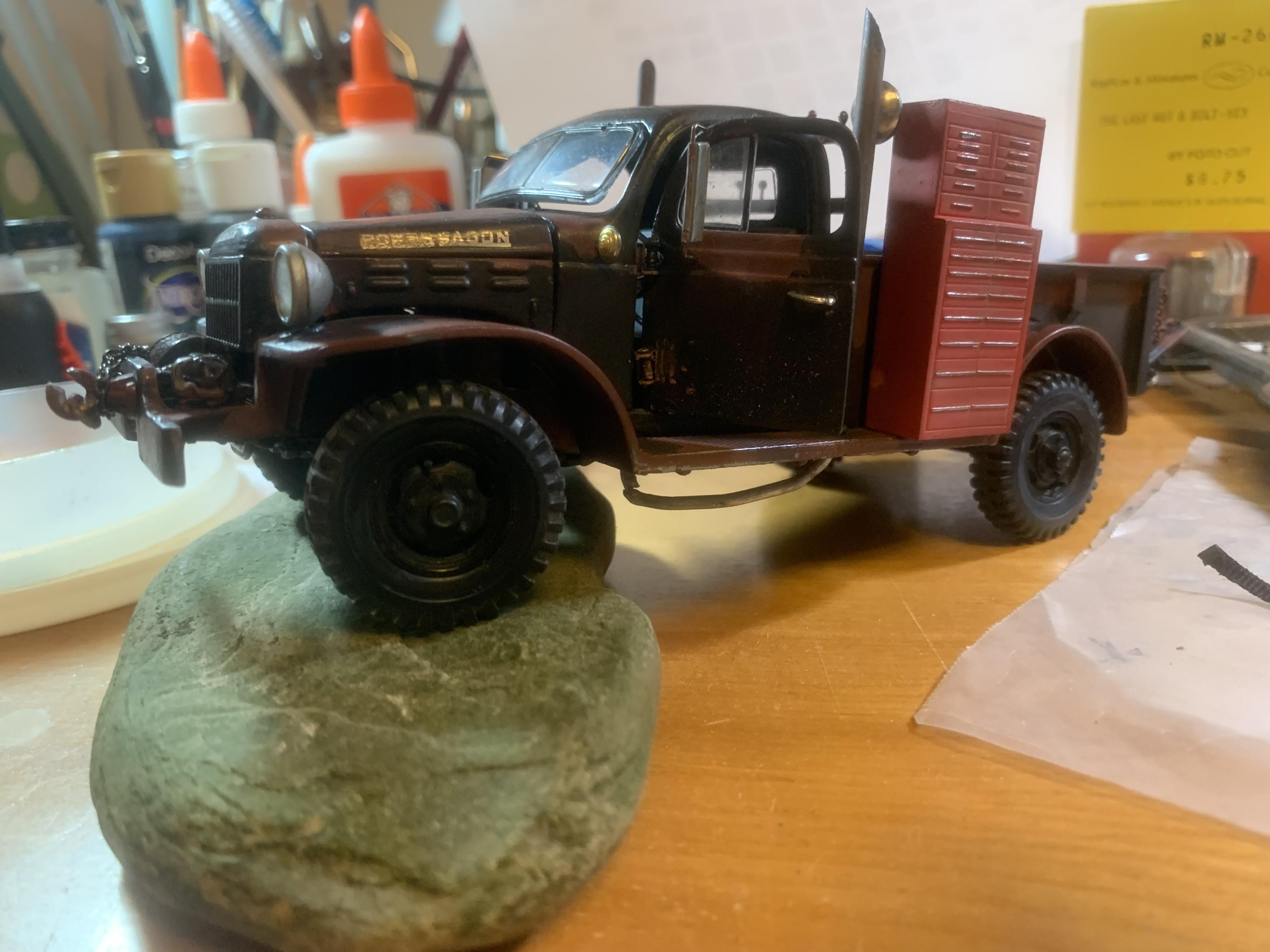

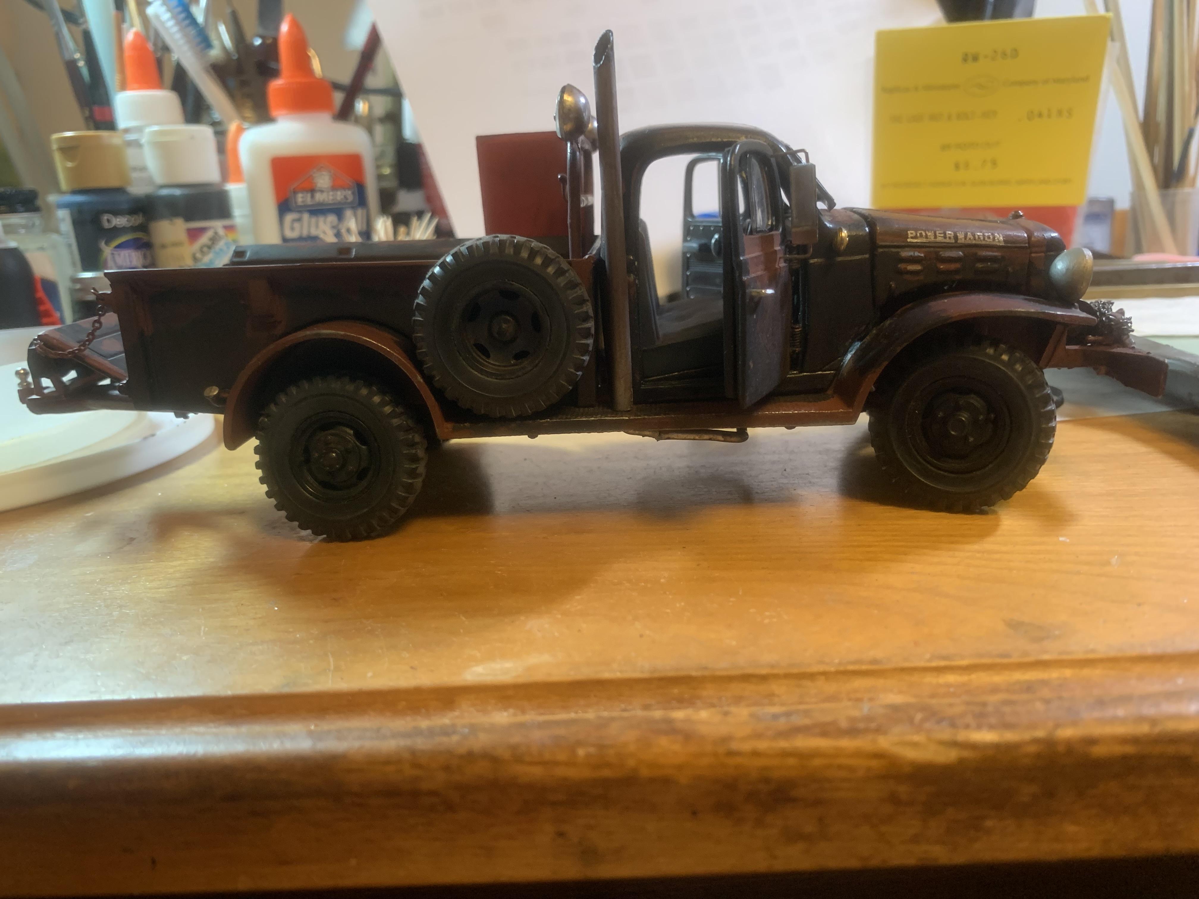

Togetherness is a wonderful thing- the Power Wagon is together! Still needs a lot of additional details and more weathering. Need to fabricate hold down straps for the tool box, stone guards for the head lights, chain attachments for the tow package, cable for the rear winch drum, chains, ropes, and bungee straps for the headache rack. and general mayhem in the bed!

Fully loaded, that tool box would be an anchor on one side of the truck.  Not very maneuverable & quite dangerous to drive.  Just sayin.
Don't worry- it will be counter balanced by the heavy tire and military style wheel as well as oxyacetylene tanks. These trucks could twist like a snake over rough terrain and carry serious heavy loads doing it.
If that box is filled anything like my 1:1 in the garage it would weigh about 1000 lbs.  Not anywhere close to a spare wheel & tire.  Not to mention it would be top heavy.  That's why you never see a set up like this in real life.
