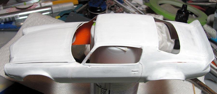

MarkJ Posted September 4, 2021 Author Posted September 4, 2021 Put my first coat of primer on with a brush. Went on a little rough, but I did not reduce it down any, so next time it should be a little smoother. Doesn't really matter because I'll be sanding it down to get rid of the nooks and crannys here and there on the body anyway. I will use white primer the second time around so I can detect low spots easier. Pretty happy with the using of the brush. Now I can paint in air conditioned comfort the same place I do the build.

MarkJ Posted September 6, 2021 Author Posted September 6, 2021 This primer, when dry, is an extremely hard surface to sand. I had to go down to 600 grit to actually cut into it and do any productive sanding. My next coat will be thinned, so hopefully there wont be huge brush marks. I will probably have to do more coats, but it will be worth it, to not have to sand so much. I will use the same body I used for the chrome moulding study, to get the thinner, which will be distilled water, just right. So I can come up with a smoother finish , and less sanding.

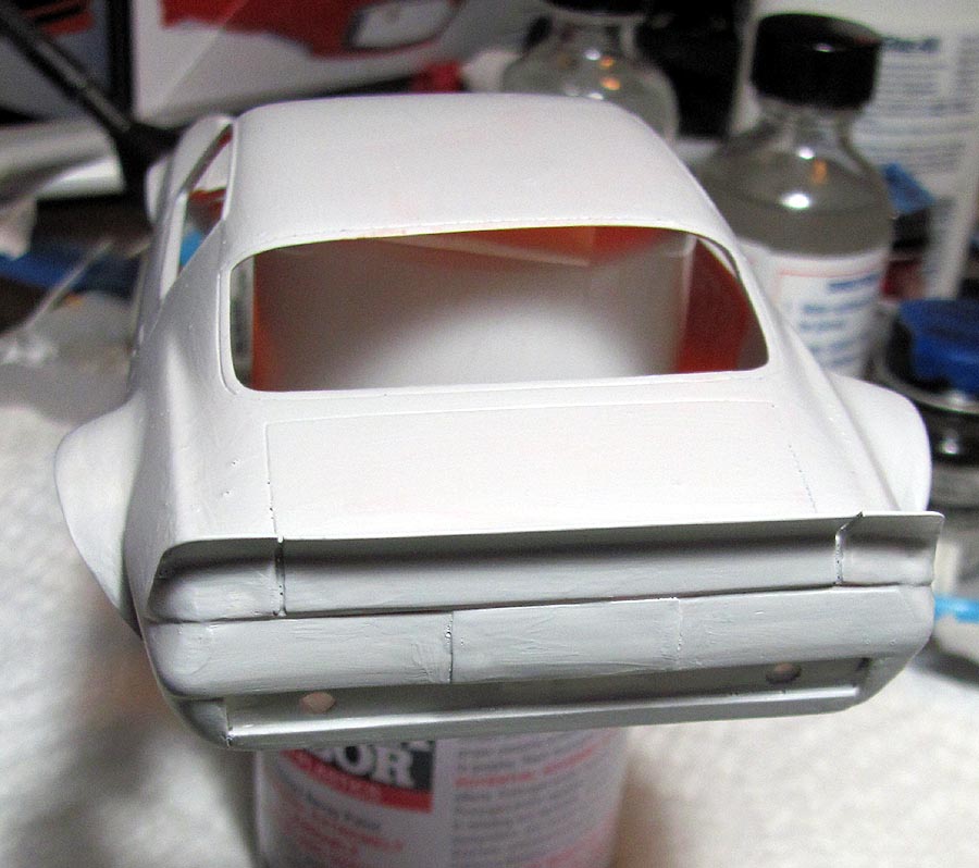

MarkJ Posted September 8, 2021 Author Posted September 8, 2021 I got a little too thick with the primer and started to fill up the door and trunk lines. I tryed to scribe the lines with my scribing tool and the primer did not come out of the groove cleanly . It just balled up down to the original orange plastic, so now I have a mess up, thats going to be hard to fix. I hate to have to strip the primer and start over again. Dont even know if the purple stuff will strip this primer.
Anglia105E Posted September 8, 2021 Posted September 8, 2021 4 hours ago, MarkJ said: I got a little too thick with the primer and started to fill up the door and trunk lines. I tryed to scribe the lines with my scribing tool and the primer did not come out of the groove cleanly . It just balled up down to the original orange plastic, so now I have a mess up, thats going to be hard to fix. I hate to have to strip the primer and start over again. Dont even know if the purple stuff will strip this primer. Oh no, Mark..... disaster strikes when you least expect it...... This sort of thing has hit me so many times with my most recent build. So hard to deal with ! I find that sleeping on it, and come back to the workbench the following morning with a fresh approach usually helps. David

MarkJ Posted September 8, 2021 Author Posted September 8, 2021 5 hours ago, Anglia105E said: Oh no, Mark..... disaster strikes when you least expect it...... This sort of thing has hit me so many times with my most recent build. So hard to deal with ! I find that sleeping on it, and come back to the workbench the following morning with a fresh approach usually helps. David Thanks, David. I know one thing. There is no way I'm stripping and starting over.
Anglia105E Posted September 8, 2021 Posted September 8, 2021 1 minute ago, MarkJ said: Thanks, David. I know one thing. There is no way I'm stripping and starting over. I would be thinking the same, having got this far into a lengthy build. White primer is a good idea, and then you should be able to see where this is going. David

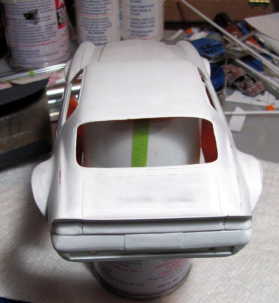

MarkJ Posted September 15, 2021 Author Posted September 15, 2021 I've been having a problem with priming which you will see in the latest photos. I put the primer on with the brush and then to get rid of the brush strokes I wet sand. In order to get rid of the stokes, I end up sanding back down to the gray primer or even the orange body. I have decided on my next attempt to dab the primer on instead of brush it on. Maybe it will flow out better and I wont have to sand as hard to get a smooth surface to apply the color coat. I'm not giving up on using a brush.
Pierre Rivard Posted September 15, 2021 Posted September 15, 2021 (edited) Courage my friend. It took me a while. From my experience if you see a brush stroke when applying, the paint is still too viscous. Stop ans wash the body immediately. Dilute the pain more and apply a thinner coat...if that makes sense. Edited September 15, 2021 by Pierre Rivard
MarkJ Posted September 15, 2021 Author Posted September 15, 2021 2 hours ago, Pierre Rivard said: Courage my friend. It took me a while. From my experience if you see a brush stroke when applying, the paint is still too viscous. Stop ans wash the body immediately. Dilute the pain more and apply a thinner coat...if that makes sense. That makes perfect sense, Pierre. I've been playing with different strokes and thinning of paint and finally started getting good results when I got to 7 drops of thinner to 7 drops of primer. I used a smaller brush and made short dabby strokes just trying to get the paint on without any brush marks. kind of pushing the paint along watching it carefully to keep it wet. knowing that when it dried it would be less thick and no brush marks. Hopefully I wont have to sand as much when this primer drys. Thanks for your input. If this works out okay I will report about it in the brush painter society thread.
