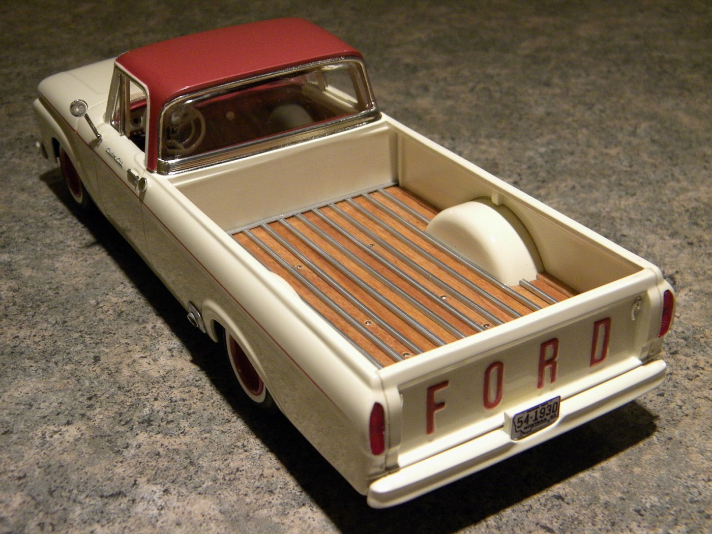

On this Ford, I  painted the body first, masked around the letters using BMF and then shot a light coat of color, followed by clear coats.
Not the easiest solution, but it worked well for me.
Steve
Steve, any more pictures of this beauty around?
53 minutes ago, thatz4u said:
Super nice...you have any more of these?
More pictures, or more models?
I have plenty of photos and can always take more, but this is the only early 60s Ford truck that I have outside of a 1960.
Steve
Steve
