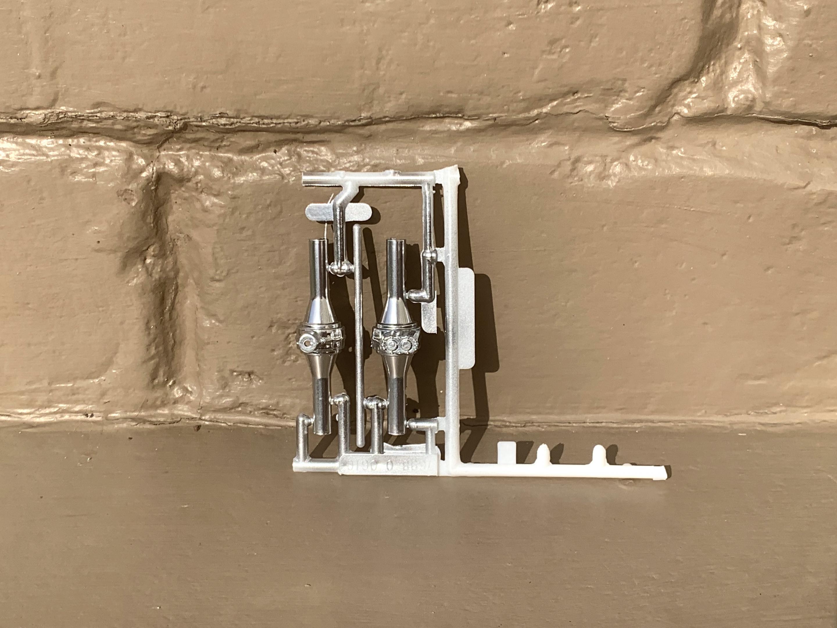

hedotwo Posted August 18, 2021 Posted August 18, 2021 I did a test a while back with airbrushing Molotow, letting dry extensively, then using brushed on Gauzy Intermediate and both airbrushed and brushed on S-02. My experience showed that the Gauzy went on extremely smooth and leveled nicely but dulled the nice Molotow shine. I tried airbrushing the S-02 on a number of test spoons but just couldn't get it to lay nicely even after varying psi and light/med/heavy coats. Finally I brushed on the S-02 and it came out acceptable in my opinion but still lost shine. So... seems the S-02 will retain more shine than the Gauzy if you can get it to lay smoothly. I'm still going to try another airbrush test with the S-02 however. As you can see by the before pics of the Molotow spoons (taken maybe a week after spraying) outside there's no denying that it can give a pretty nice shine. I've also added before and after pics of the Gauzy and S-02 test spoons.
TransAmMike Posted August 19, 2021 Posted August 19, 2021 8 hours ago, hedotwo said: I did a test a while back with airbrushing Molotow, letting dry extensively, then using brushed on Gauzy Intermediate and both airbrushed and brushed on S-02. My experience showed that the Gauzy went on extremely smooth and leveled nicely but dulled the nice Molotow shine. I tried airbrushing the S-02 on a number of test spoons but just couldn't get it to lay nicely even after varying psi and light/med/heavy coats. Finally I brushed on the S-02 and it came out acceptable in my opinion but still lost shine. So... seems the S-02 will retain more shine than the Gauzy if you can get it to lay smoothly. I'm still going to try another airbrush test with the S-02 however. As you can see by the before pics of the Molotow spoons (taken maybe a week after spraying) outside there's no denying that it can give a pretty nice shine. I've also added before and after pics of the Gauzy and S-02 test spoons. I guess it's my old brain, but I'm a bit confused on the different applications. What is the first picture; both look awesome?? The last picture looks kinda dull. So which had the best chrome-like shine Rich??
hedotwo Posted August 19, 2021 Posted August 19, 2021 (edited) First pic is the two spoons after air drying for maybe a week, with no clear. Second is one spoon before brushing on Gauzy. Third is after the Gauzy had dried. Fourth is the second spoon before brushing on S-02 and the last pic is after the S-02. Sorry for the confusing post. Edited August 19, 2021 by hedotwo
69H.O.Firebird Posted August 19, 2021 Posted August 19, 2021 (edited) I have found that it's best to not clear coat molotow. Edited August 19, 2021 by 69H.O.Firebird
TransAmMike Posted August 19, 2021 Posted August 19, 2021 Well clearly (no pun intended) it looks like no clear is the winner, just wonder tho it in time it would dull out.
hedotwo Posted August 19, 2021 Posted August 19, 2021 What I do is to make sure I do all my pre-fitting of bumpers after body painting and before the Molotow gets laid. That can eliminate alot of handling and the risk of dulling. It definitely pays to leave the pieces air dry as long as your patience allows. I have a pile of tight, soft cotton gloves that help too. Molotow might not fit everyone's needs and that's fine. I know from experience that a refill bottle lasts a long time and that's good for my retired income ?
Bainford Posted August 20, 2021 Posted August 20, 2021 15 hours ago, hedotwo said: What I do is to make sure I do all my pre-fitting of bumpers after body painting and before the Molotow gets laid. That can eliminate alot of handling and the risk of dulling. That is my method as well. If Molotow is going to be used on the exterior of a build, I plan carefully when and how the part will be mounted to reduce the amount of handling. The bumpers on my Pantera project will be chromed with Molotow, then mounted late in final assembly without the Molotow ever being touched.
