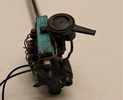

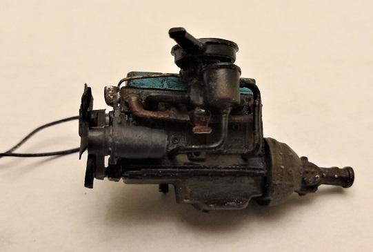

I did a replica of my dad's old 62 Biscayne and wanted a period-correct engine to put in it.
I took the stovebolt engine and fabricated an intake manifold to match the correct setup, as well as a valve cover, air filter, and oil bath oil filter.
Not perfect but I think I came pretty close.
  • Like 1
With plenty of oil/dirt on the PowerGlide, that works.  Not that Stovies were markedly leaky, only average.  My SBC's like to drool from the front and rear seals, even with the new type.  Gaskets and shellac sealants were pretty mediocre, back in the day.  I find that going much beyond adding plug wires is hard for me at age 76, tho the VA gave me carpal tunnel on my right wrist;  sometimes I do fuel lines, etc.  Looks good in a very use way!
